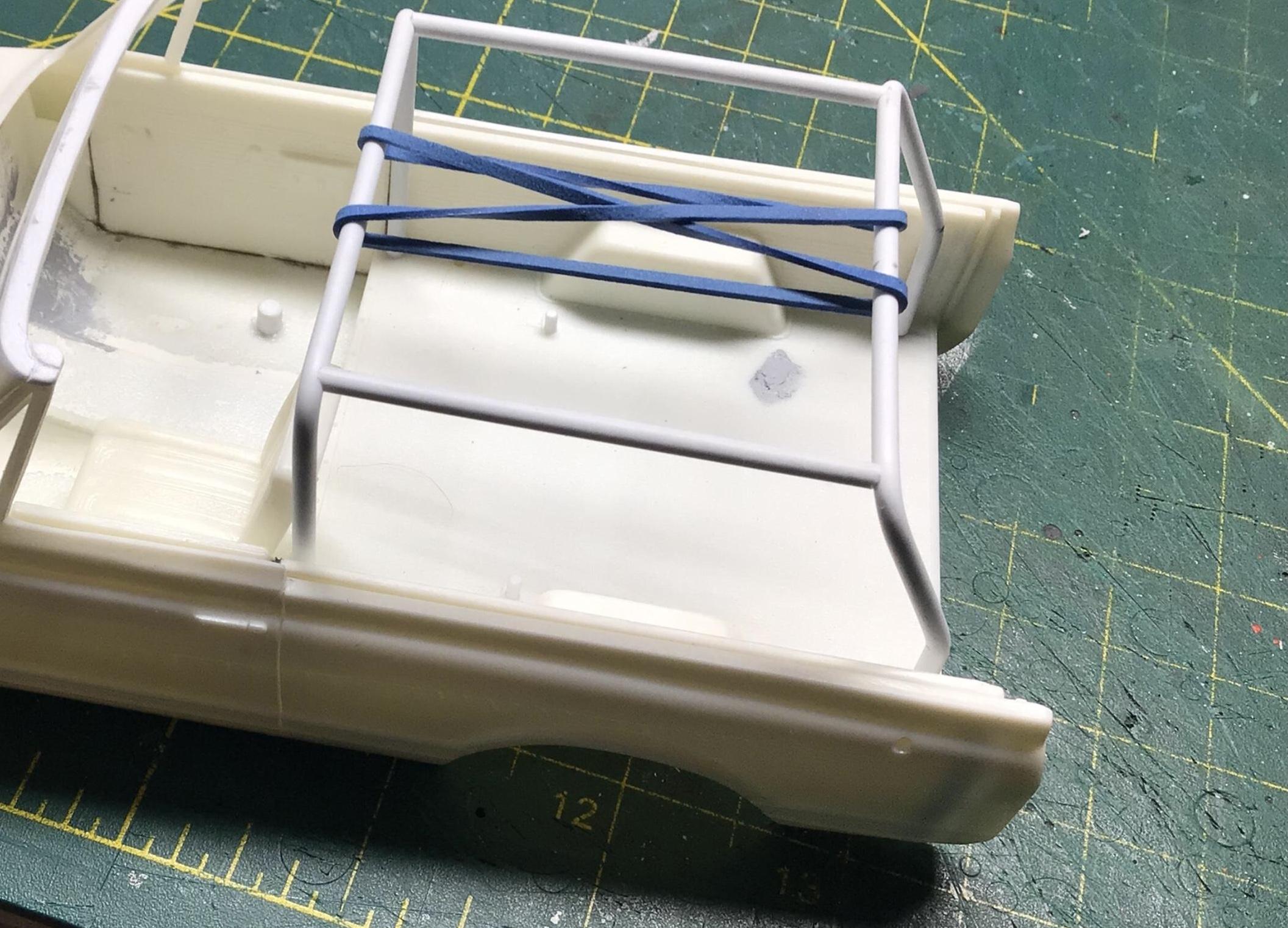

Ace-Garageguy Posted February 8, 2024 Posted February 8, 2024 (edited) Sorry...can't help you on the Plas-T-Rod. Sounds great. EDIT: Hmmmmm...I wonder if this was the magic stuff: https://www.perigeedirect.com/products/maven-plastics-pvc-gray-flexible-semi-rigid-plastic-welding-rods-coils-reels Plain old Evergreen or Plastruct styrene rod is pretty much the universal choice for 1/24-1/25, though a few more accomplished builders use brass rod and tube, or aluminum Tig welding rod. Smaller diameter styrene rod (up to about .080") will take reasonable radius bends cold without cracking if you work slowly and carefully, but not the larger rod. It also tends to spring back, so some form of heat-tempering after bending works best for me. I've developed several methods to make clean small bends in larger rod, mostly using heat at some point in the process. I built this cage for a road-racing Chevelle using styrene rod. Here's some more specific info: Edited February 8, 2024 by Ace-Garageguy 2

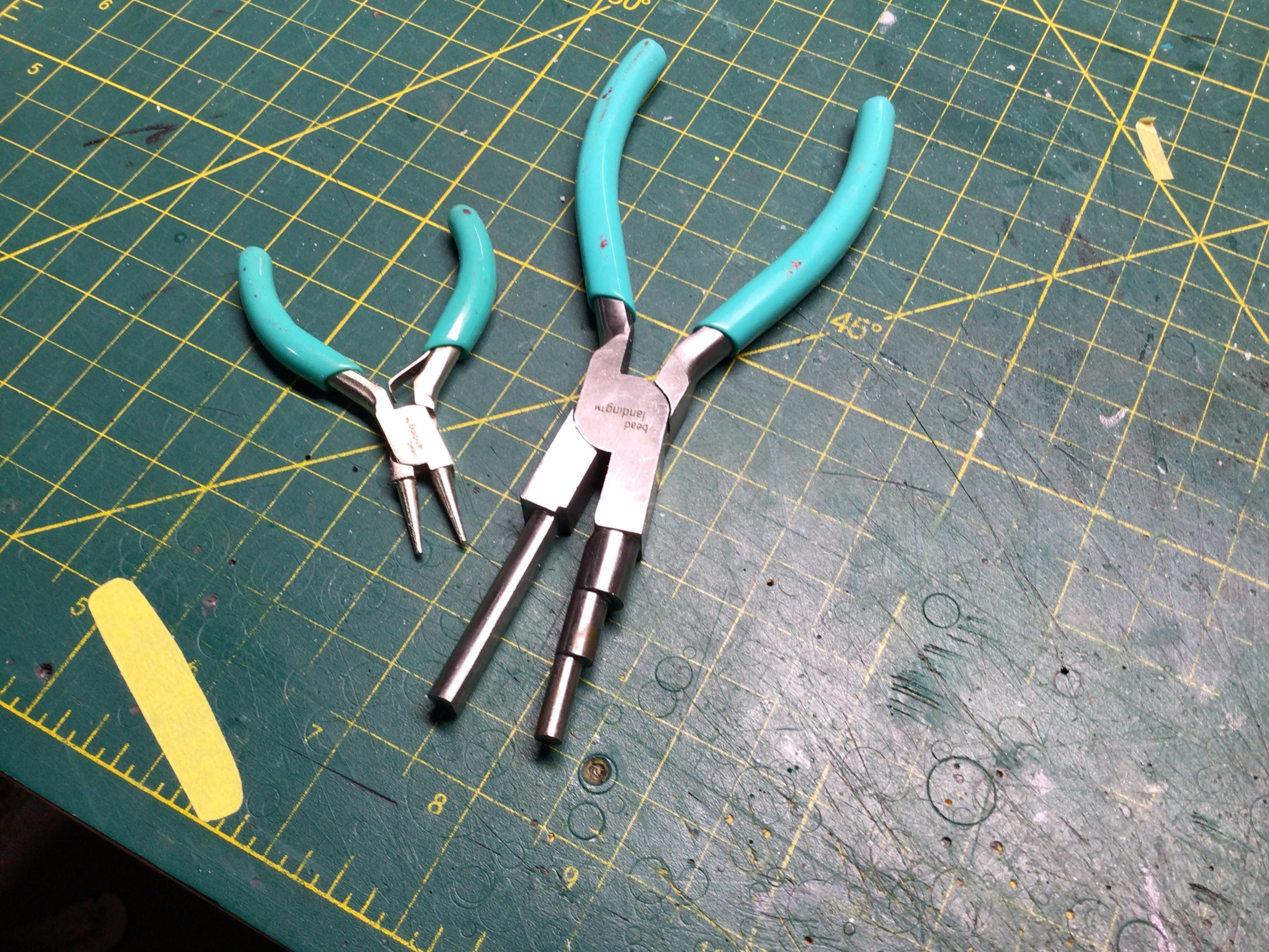

NOBLNG Posted February 8, 2024 Posted February 8, 2024 If you’re planning to do a fair bit of tubing work, a set of bending pliers will make things easier. I got these at Michaels in the jewelry making section. 1
