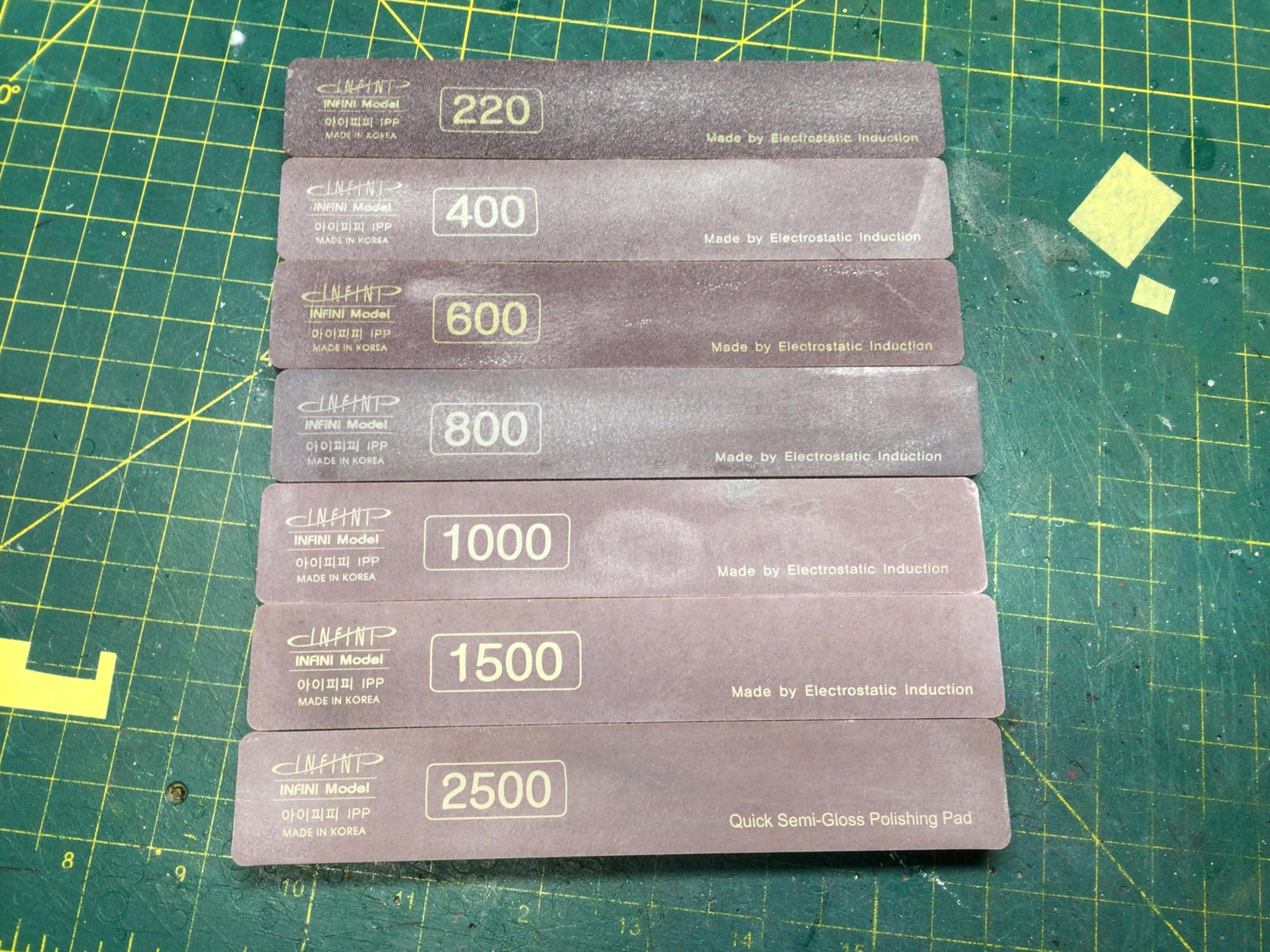

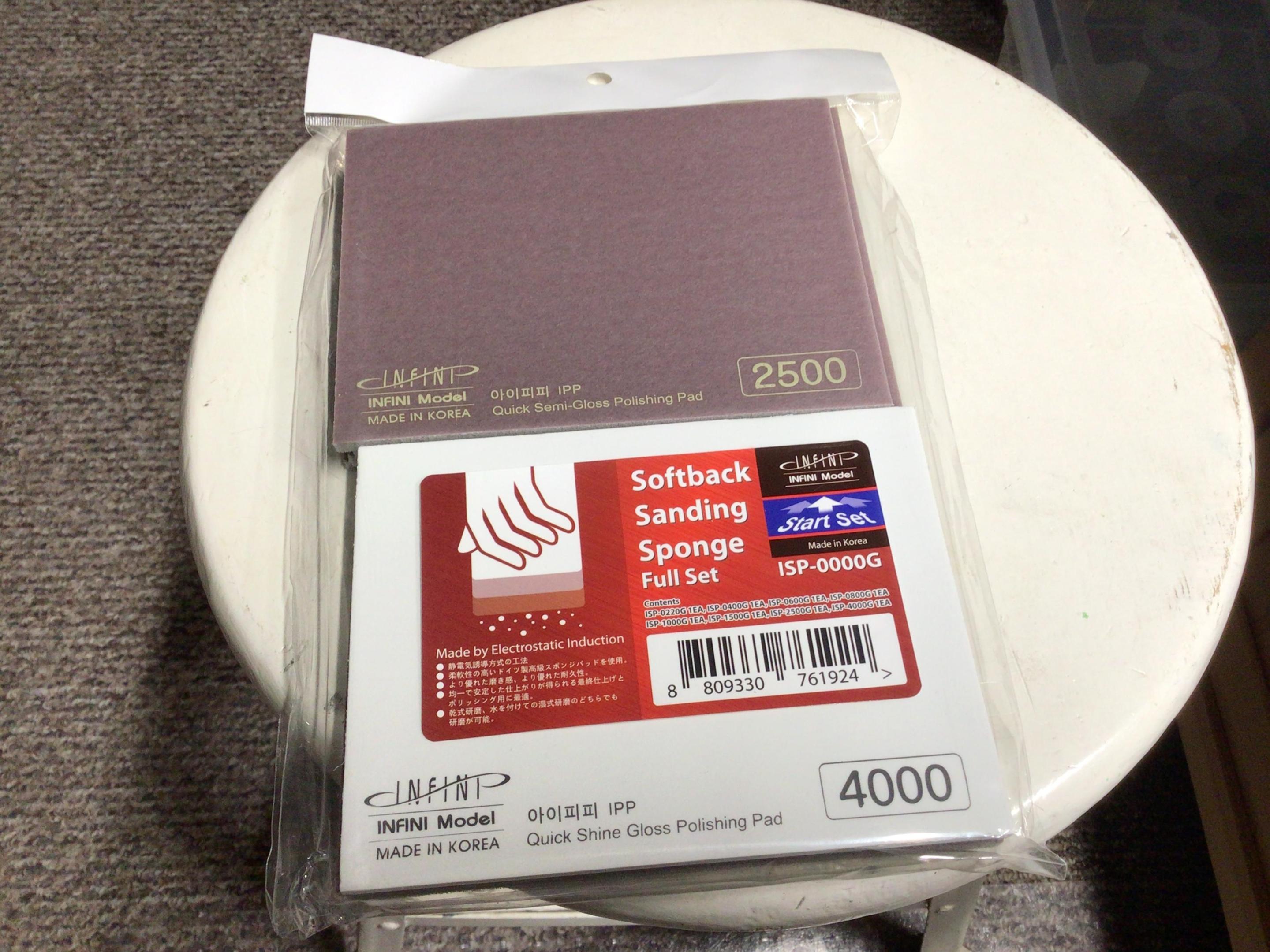

NOBLNG Posted February 13, 2024 Posted February 13, 2024 (edited) These are what I use, but I don’t normally wet sand much. Edited February 13, 2024 by NOBLNG
