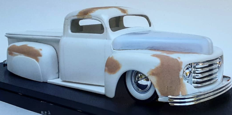

Ferbz Posted February 28, 2024 Posted February 28, 2024 (edited) I do alot of custom body work and have used DAP brand Plastic Wood for relatively large areas and/or thicker shaping and molding. I've used it for MANY years without incidence. It does not shrink or swell under the most active types of paint(like automotive lacquer)with proper primering and final paint prepping. I use small amounts of acetone to thin it as needed. One caveat is that it often requires a spot glazing putty pass as part of primer/paint prep to fill any pinholes and/or fine sanding scratches, which you would often need to do anyway when doing any type of custom bodywork. For this I use the tube 3M Acryl-Green spot putty. Neither of these require figuring out how much hardener to use or long hardening/drying times, which I find super convenient. I also use CA glue/baking powder for filling small imperfections, cut lines, holes, etc. If you try Plastic Wood for yourself, do not buy the tube as it tends to dry out before you end up using the majority of it. Instead, buy the small 4oz. can for $10 or less. Available at most big hardware stores (like Home Depot, Lowe's, etc). Edited February 28, 2024 by Ferbz 1
Ferbz Posted February 28, 2024 Posted February 28, 2024 2 hours ago, Ferbz said: I do alot of custom body work and have used DAP brand Plastic Wood for relatively large areas and/or thicker shaping and molding. I've used it for MANY years without incidence. It does not shrink or swell under the most active types of paint(like automotive lacquer)with proper primering and final paint prepping. I use small amounts of acetone to thin it as needed. One caveat is that it often requires a spot glazing putty pass as part of primer/paint prep to fill any pinholes and/or fine sanding scratches, which you would often need to do anyway when doing any type of custom bodywork. For this I use the tube 3M Acryl-Green spot putty. Neither of these require figuring out how much hardener to use or long hardening/drying times, which I find super convenient. I also use CA glue/baking powder for filling small imperfections, cut lines, holes, etc. If you try Plastic Wood for yourself, do not buy the tube as it tends to dry out before you end up using the majority of it. Instead, buy the small 4oz. can for $10 or less. Available at most big hardware stores (like Home Depot, Lowe's, etc). Is it ok that I show how I use these here? This 50 ford pickup custom had quite a few body mods where I first used Plastic Wood to fill things like fender lines and other low areas, or locations that need shaping. I sanded the Plastic Wood to shape then an initial coat of light primer revealed pinholes and sand scratches which were then filled with 3M spot putty. Another coat of primer and sanding shows any areas needing further putty/primer fine tuning so that final primer and wet sanding can begin. After final primer and wet sanding the final paintjob covers it all up. This may seem a bit painstaking and rigorous but after years of trial and error, this is how I use Plastic Wood and 3M spot putty to get the custom body work as straight as I can for the paintwork without it ever ghosting thru or cracking, etc. Hope this helps! 1
