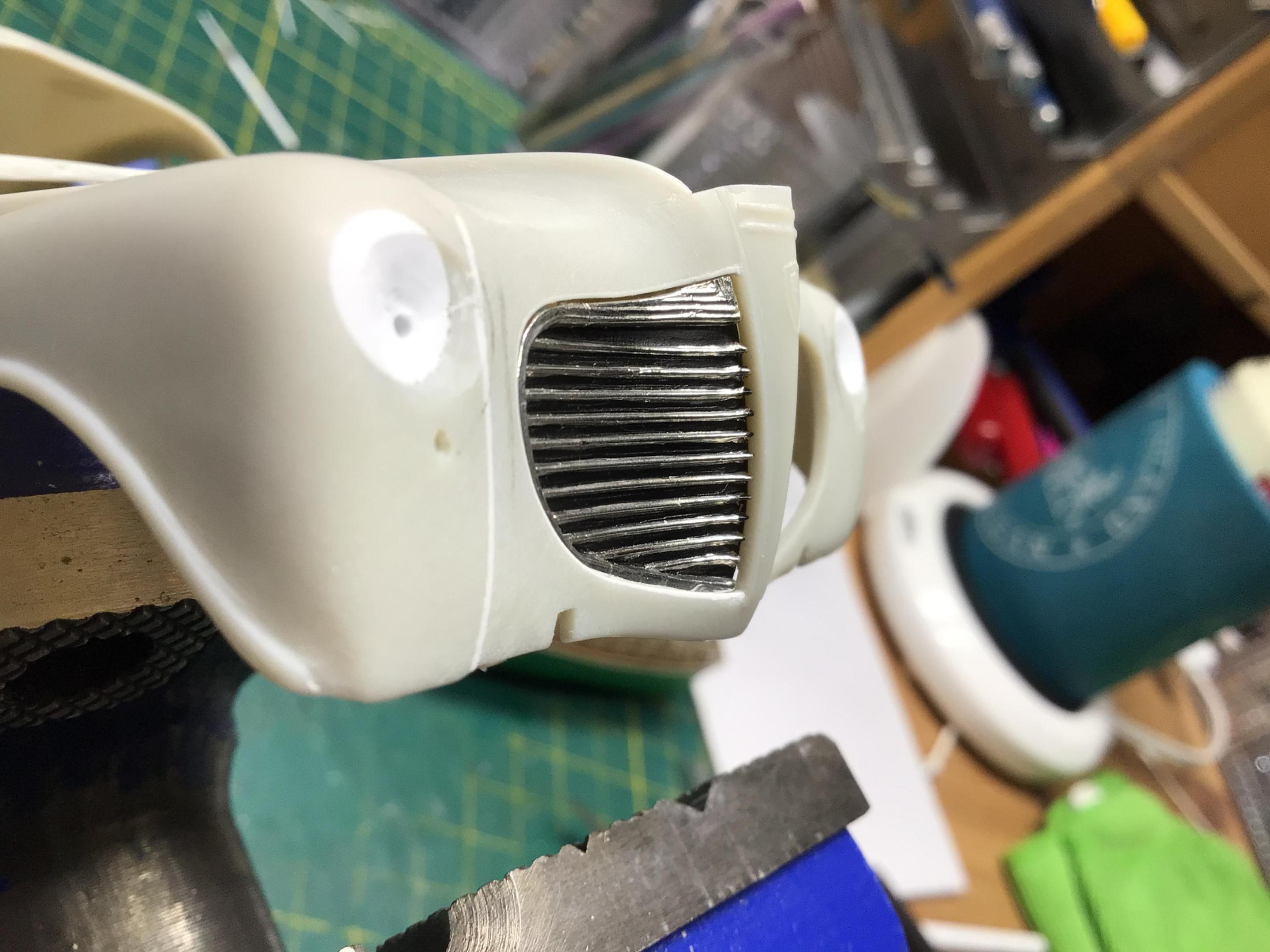

I sprayed the grills with Chrom and after a few days in the dehydrator, I  dipped them in Pledge. I didn’t sand the grooves well enough, so I stripped the passenger side one, sanded it a bit better and then foiled it. I am amazed how well the foil stretched and covered it.  Before I stripped it, I did a test of painting the slots with XF-1 flat black. It wasn’t easy even with a 16/0 liner brush.? I might try painting them black, then foil, then remove the foil from the recesses.

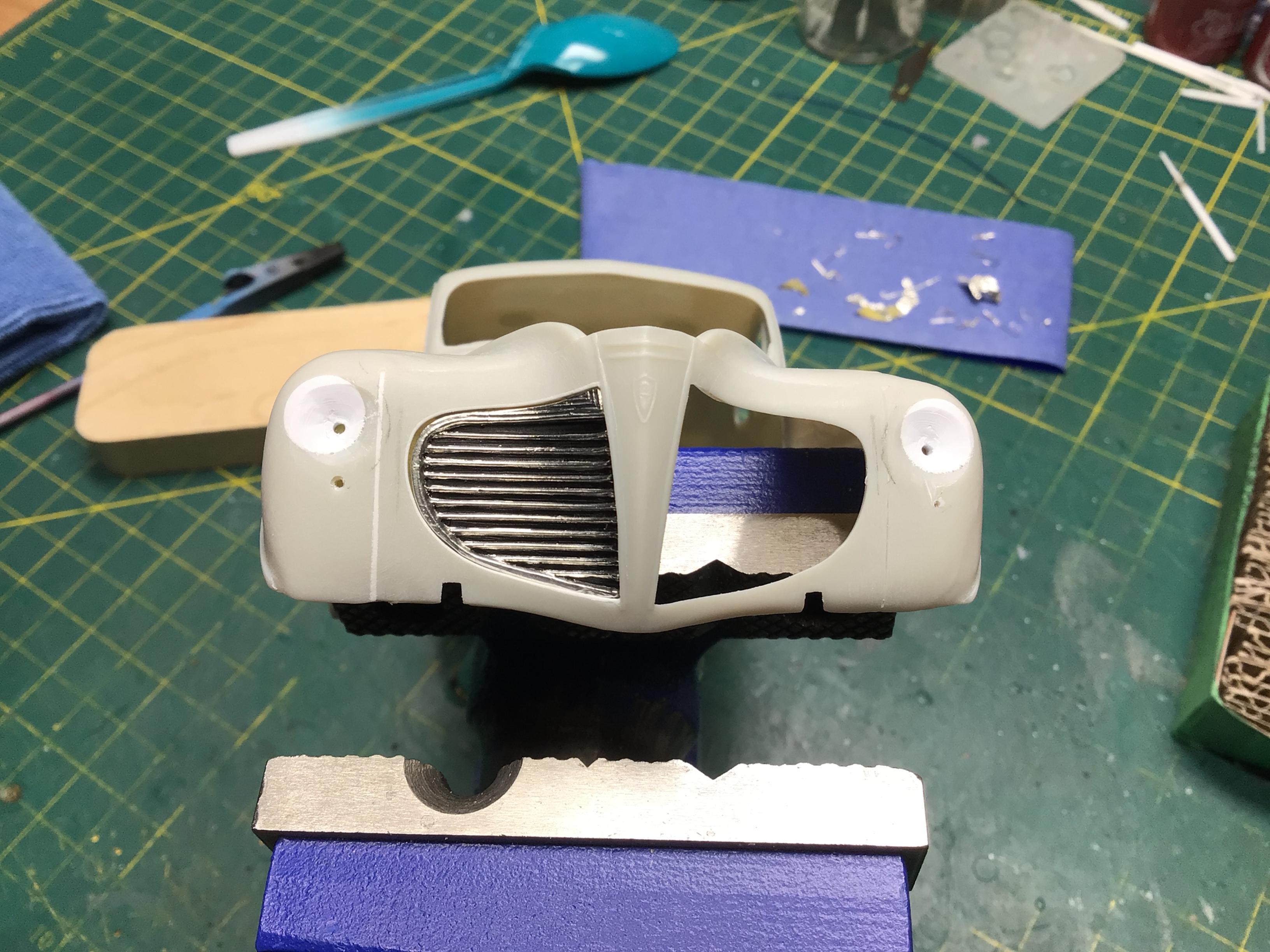

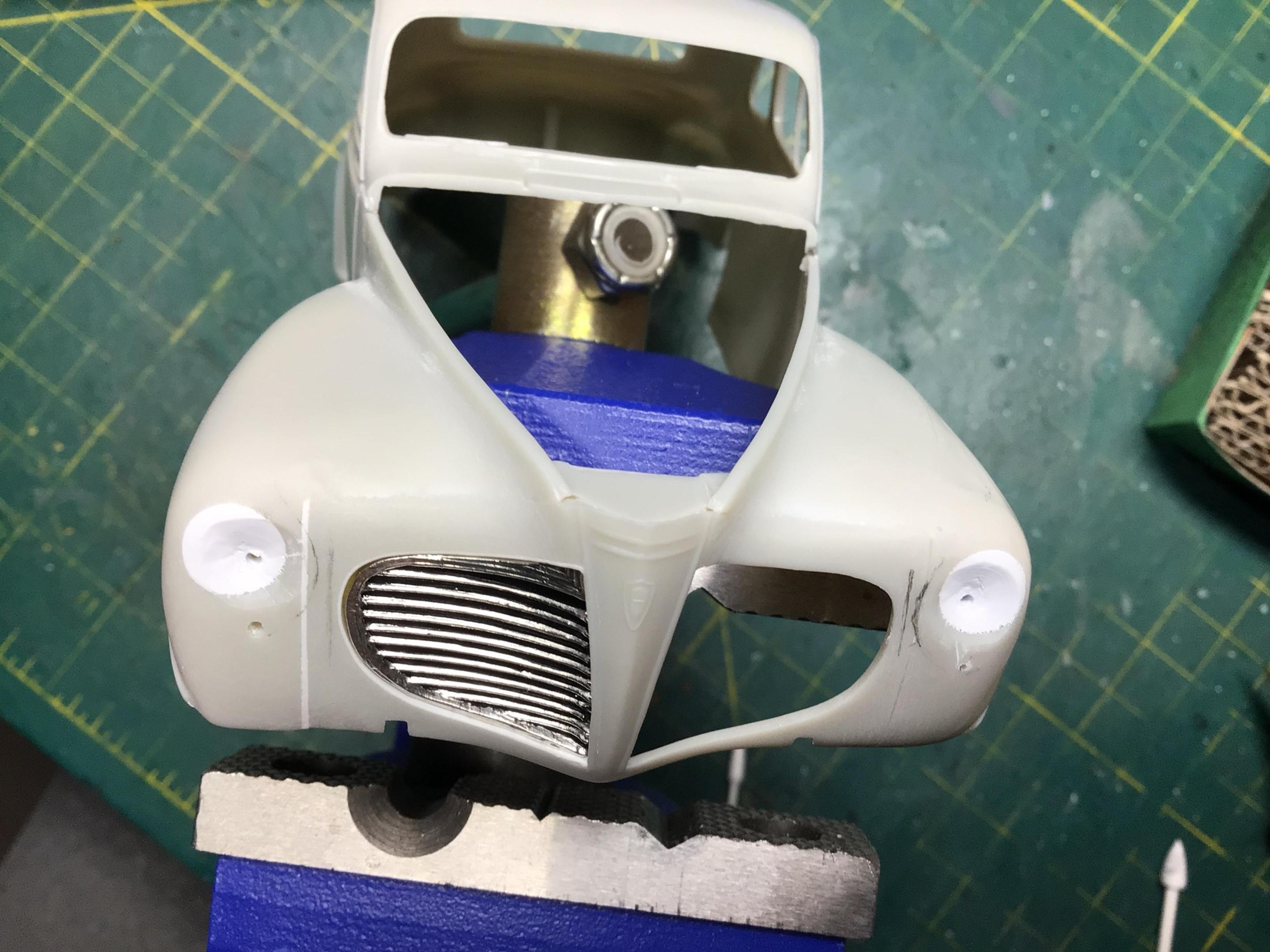

Here is my first attempt at the paint under foil method. The foil is a little precariously attached at the center. If the foil doesn’t want to stay put well enough, I may foil it completely, then paint it completely, and then remove the paint where necessary with a pointy swab as per Jim’s suggestion.?

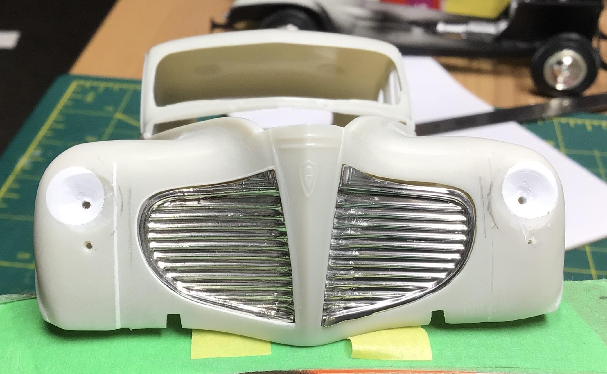

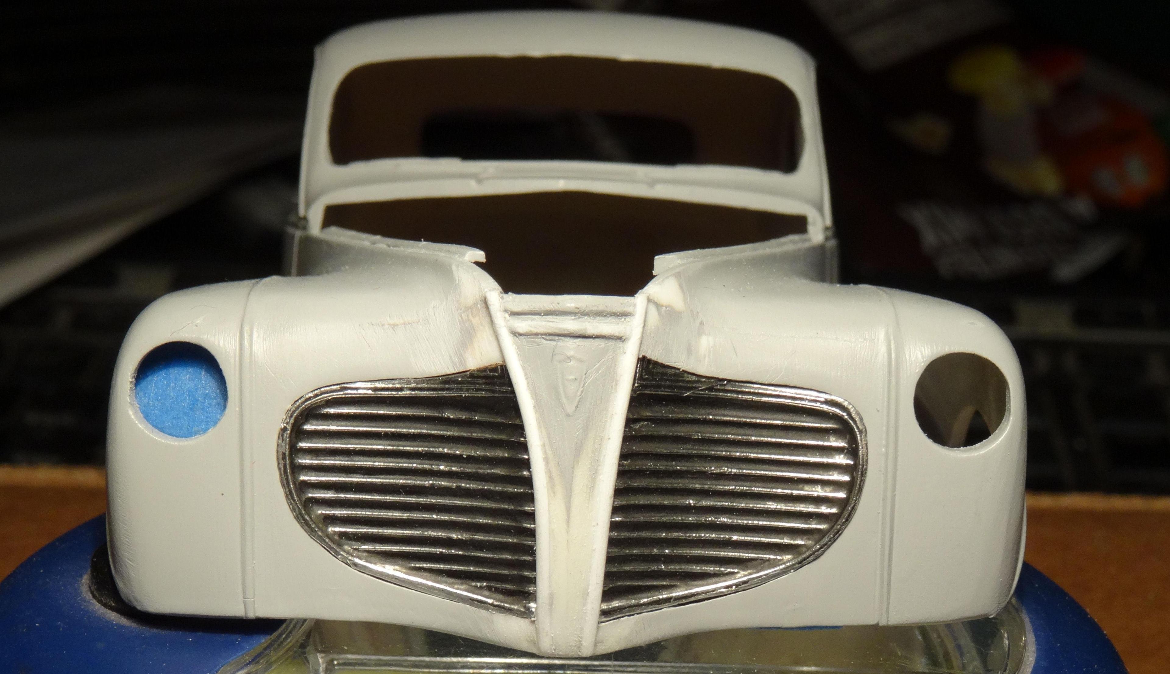

Well, I took a stab at painting the grill black and then going over the chrome with Molo. It worked but I didn't feel the bars stood out enough. Then I tried BMF on the grill and then sprayed it after with some flat black. Rubbed off the high spots and these are the results. Aside from a slight wrinkle in the drivers side foil and maybe being a little light on the black, I think I can live with this.
