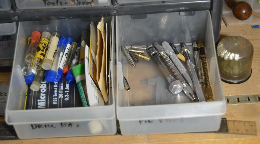

ColonelKrypton Posted February 17, 2024 Posted February 17, 2024 Recently, while working on a project, I broke my last #67 and #66 size wire gauge number drills which prompted me to sort through my collection of spare drill bits. To my frustration I discovered that I had in some way screwed up and found that a number of the drills in my small wire gauge number drill stand ( one of those round one with the clear plastic dome top ) had gotten mixed up - wrong size in the wrong place, duplicates of the same size all or some of which where in the wrong place (etc) - seems that I had just gotten lazy and careless Out with the micrometer and an hour later the set from #60 though #80 has been sorted out, now complete with several holes needing replacements. I am a bit fussy about tools, especially cutting tools that I come to rely on. I have 6 sets of drills, fractional sizes to 1/2", number drills #1 through #59, letter drills, and an assortment of larger and smaller metric. I don't mind spending money on good quality tools - buy cheap, replace many times. I have a good selection of the popular 1/8" shank carbide PCB drills in metric size 0.3mm up to ( I think ) 3mm. These are typically good quality, sharp, work well for model building, but are brittle and the smaller sizes are easy to break - sometimes too easy. These drills are handy and good value BUT not always the best choice. My bunny hunt over the last few days has been to find some suitable decent quality replacement wire gauge number drills. There are still quite a number of quality US drill makers ( Triumph, Precision Twist Drill, Titex, and others ) but these are high end products with prices to match often $5 ( low end ) to $20+ ( high end ) prices per drill bit. That is not what I need. There are common small drills to had on eBay, Amazon, and your local hobby store some seem OK, but many are just a waste of time. A recent purchase of some Asian source number drills was disappointing as the drills were good for one hole and were so soft they easily bent - into the bin whey went, not even worth using once then tossing out. Which brings me around to my question - in the middle between the cheap Asian and the very expensive industrial drill bits, two brands seem the most common, Excel and Gyros. Price wise they are about the same but before I give one or the other a try I was looking for any nay, yay, or meh from the learned Model Car Mag forum members? cheers, Graham

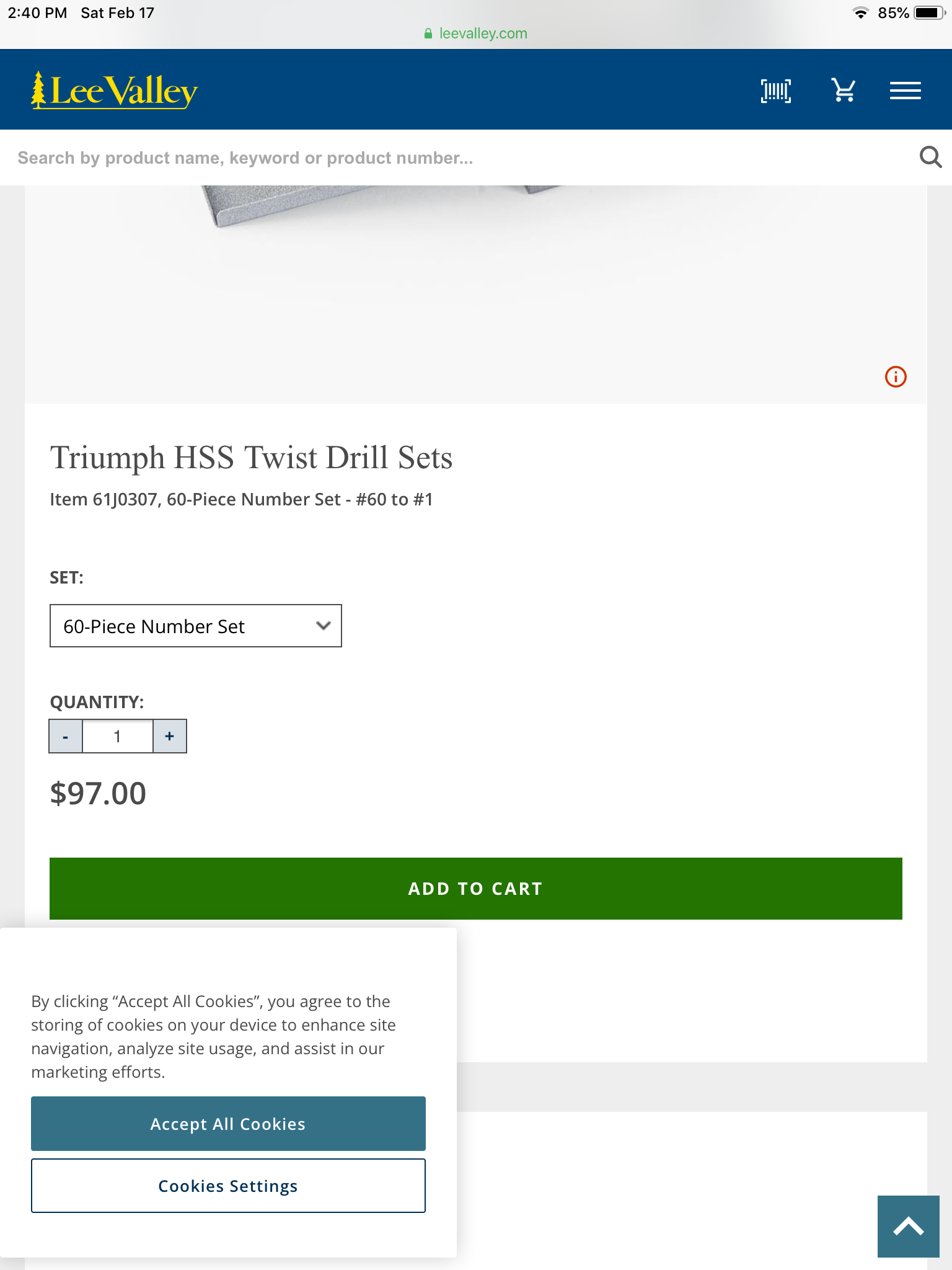

R. Thorne Posted February 17, 2024 Posted February 17, 2024 (edited) Probably a tad prejudiced, but the Triumph hss bits that I have used in the garage for the past 50 or so years and in modeling for about 7 years are gonna be tough to beat. I have broken 0 of these in modeling. Are the newer bits as good as my old ones? Probably not, but still? As for the price, I am confused about your pricing of 5 to 20 dollars apiece. A quick search revealed this 60 piece number set from LeeValley that averages a buck and a half apiece. Edited February 17, 2024 by R. Thorne 1

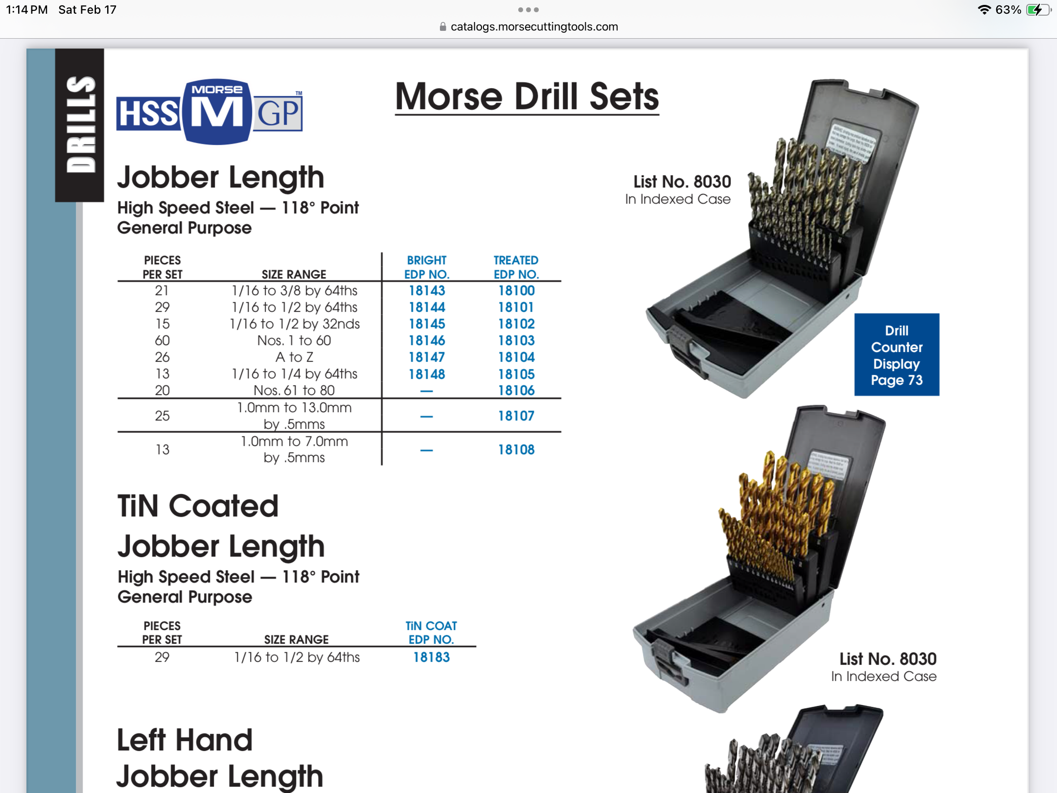

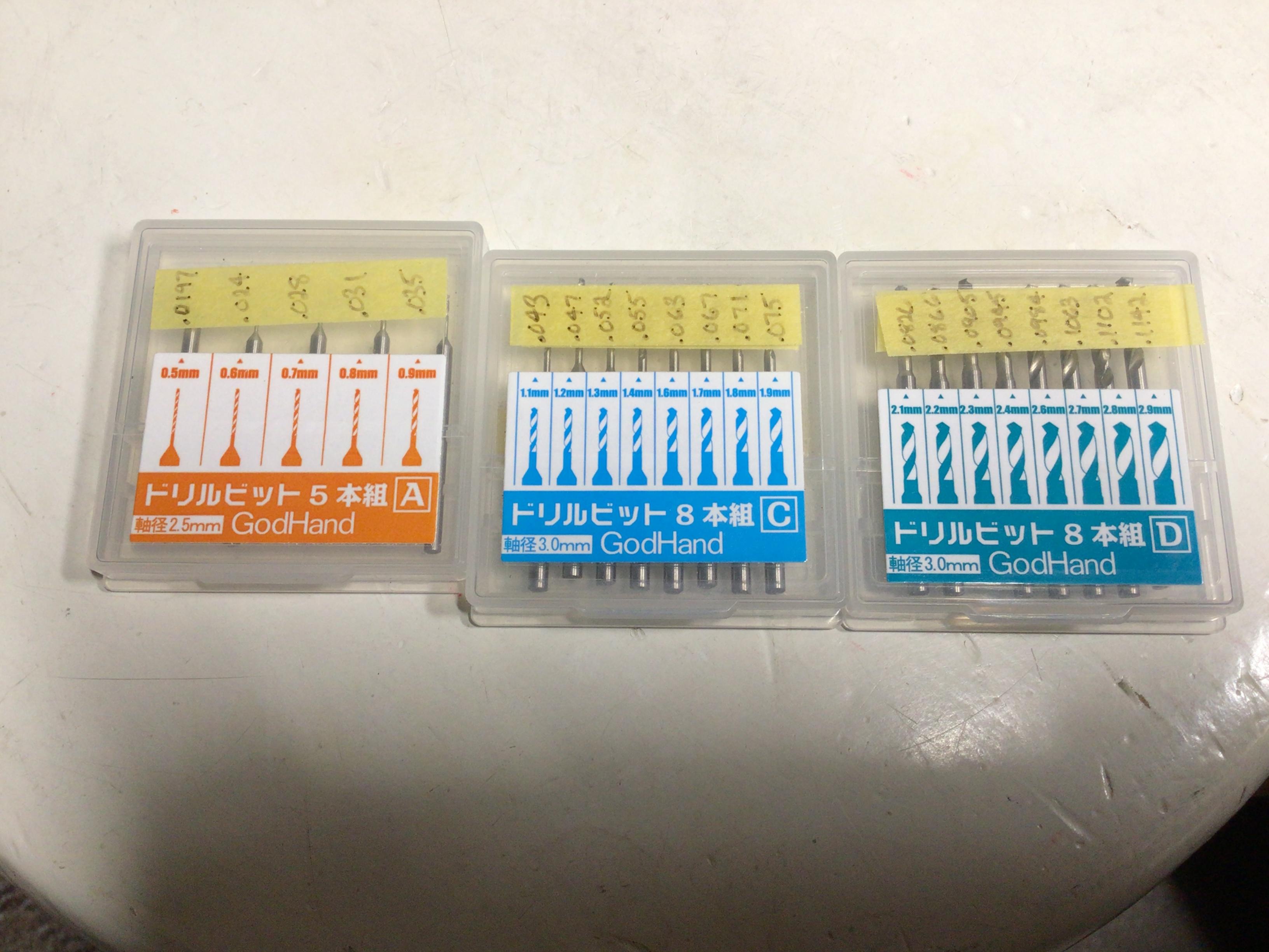

NOBLNG Posted February 17, 2024 Posted February 17, 2024 Morse makes good quality bits. You would have to locate a supplier. McMaster Carr maybe? It looks like you can but 12 packs of individual sizes or the #61-80 set. That said, I like my Godhand drill bits. I also have a set of nice Vallejo #61-80. 1

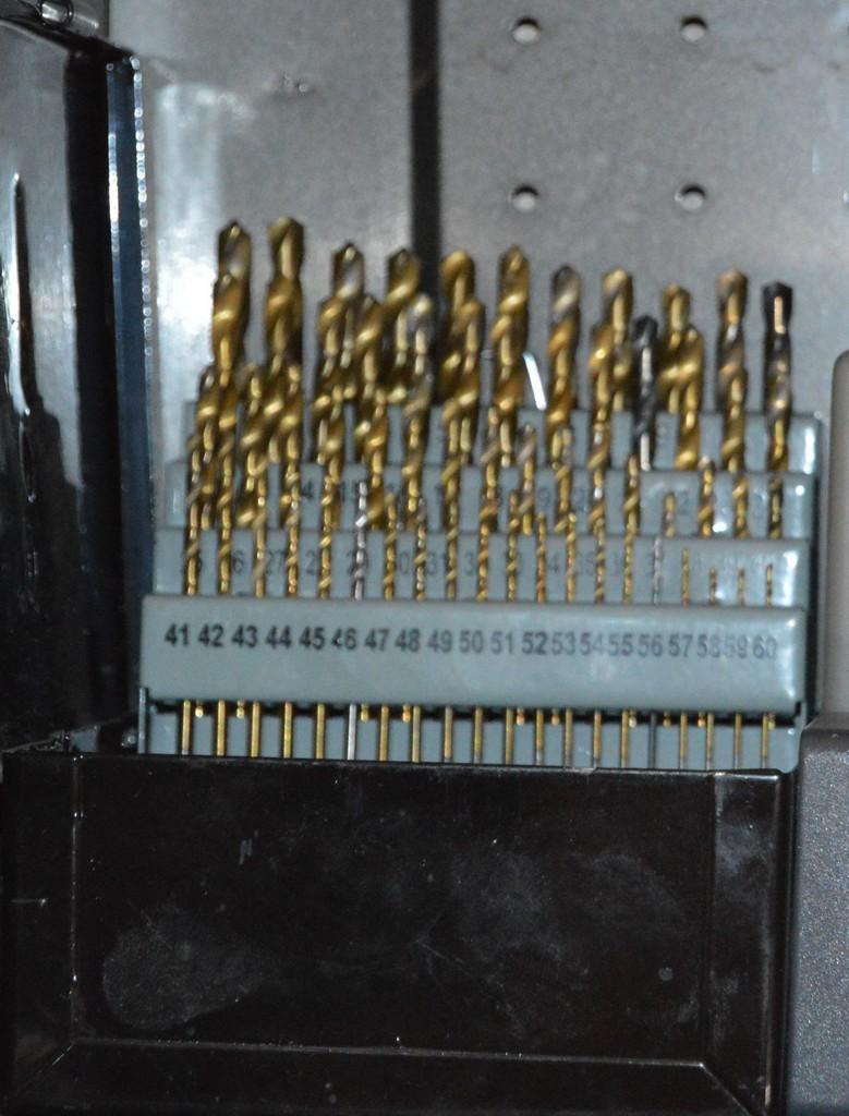

Ace-Garageguy Posted February 17, 2024 Posted February 17, 2024 (edited) Back in 2011, I bought a set of wire-gauge bits in a Huot-labeled index, as below. I do NOT know if the set shown/advertised is the same as what I've got, as offshore manufacturers/importers/resellers are not shy about lying. EDIT: They're apparently USA made. https://www.amazon.com/Viking-Drill-Tool-43460-Bright/dp/B001EHGI1I I only use them for drilling styrene, soft aluminum, and occasionally brass and diecast pot metal. So far I have only broken two. They are hard enough to stay sharp for a reasonable period, and flexible enough to resist breaking if used in a pin-vise. The two I broke were 100% from operator error, and my local HobbyTown usually has "Walthers" branded packs of two bits for replacements, which have been of comparable quality so far. I also have a couple cheaper sets labeled "Forney" that seem to be of perfectly acceptable quality as far as plastic modeling work goes, and come in a nice plastic index. I found them at well-stocked True Value hardware stores. https://www.amazon.com/Forney-60239-Mini-Drill-20-Piece/dp/B000GAV9SG Edited February 18, 2024 by Ace-Garageguy 1
ColonelKrypton Posted February 17, 2024 Author Posted February 17, 2024 3 hours ago, R. Thorne said: As for the price, I am confused about your pricing of 5 to 20 dollars apiece. Industrial suppliers, carbon steel vs HSS vs carbide vs cobalt - no name supplier stock vs US brand name vs German brand name vs Swiss brand name. Same size drill bits just targeted for different users ( high use production machine shop vs occasional use home workshop ). Godhand markets good stuff as does Tamiya - these are all re-branded products from good Japanese suppliers. I have a likeness for the 3/32 shank metric drills used by the jewellery bunch. I have a set of Busch in vandium steel from 0.5mm through 2.3mm and I will continue to use these over the Chinese 1/8" shank carbide PCB drills which I will not be replacing as I use them up. All that said however, my hunt was on for some good quality wire guage size number drills between #60 and #80. Speaking of wire gauge - Do you know where these number drills get their # from? I don't and it seems that detail has been lost through the years. It seems however that this start in the UK in mid to late 1800's based on the Stubs iron wire and Stubs steel wire gauges which are somewhat different and these in turn relate to the later Birmingham wire gauge system. Confused? Confusing? I am. Thanks for all the replies. cheers, Graham 1

ColonelKrypton Posted February 18, 2024 Author Posted February 18, 2024 (edited) 5 hours ago, Bugatti Fan said: There must be plenty of drill bit equivalents in Metric or Imperial that should be available and easier to source. Indeed, close but sometimes close isn't close enough. I like to work a lot with brass usually soft soldered usually with Stay Brite silver bearing solder and occasionally hard soldered ( or brazed if you prefer ). Brass is a nice material to work with BUT the cutting tools geometry, for best results, is different from that for ferrous materials and even the likes of polystyrene. https://handycrowd.medium.com/drilling-brass-the-easy-and-safe-way-f1494d449d3a https://kdmfab.com/brass-drilling/ https://www.watchrepairtalk.com/topic/18286-drilling-brass-not-as-easy-as-youd-think/ I have a drill set of 1/16" through 1/2" drills in 1/64" steps that I use exclusively for brass and each bit has been modified like that shown in the first link above. I have not had much luck modifying bits smaller than 1/16" in a similar manner hence the reason I occasionally break these smaller size bits when working brass. My compromise is to use decent quality HSS bits. Those very nice, sharp, and brittle carbide PCB bits tend to break far to easily so it's a good thing they are inexpensive and work in a pinch - they are too sharp and grab too easily in brass. 5 hours ago, Bugatti Fan said: Carbon Steel bits are perfectly alright if drilling plastic, brass and aluminum. HSS (High Speed Steel) better on tougher materials like steel, but perfectly good on plastics, brass and aluminium. Interestingly, carbon steel bits, at least good quality ones, are less expensive, harder ( hence more brittle) and sharper than HSS types but carbon steel bits are subject to work annealing if used heavily and allowed to overheat whereas HSS are not. There are even drill bits having tip geometry for softer materials like aluminum and plastics. They have tip geometry with a smaller included angle ( i.e. pointier ) https://www.fine-tools.com/aluminiumbohrer.html But for our use the compromise is to use the more common types and in that they work just fine. cheers, Graham Edited February 18, 2024 by ColonelKrypton 1
