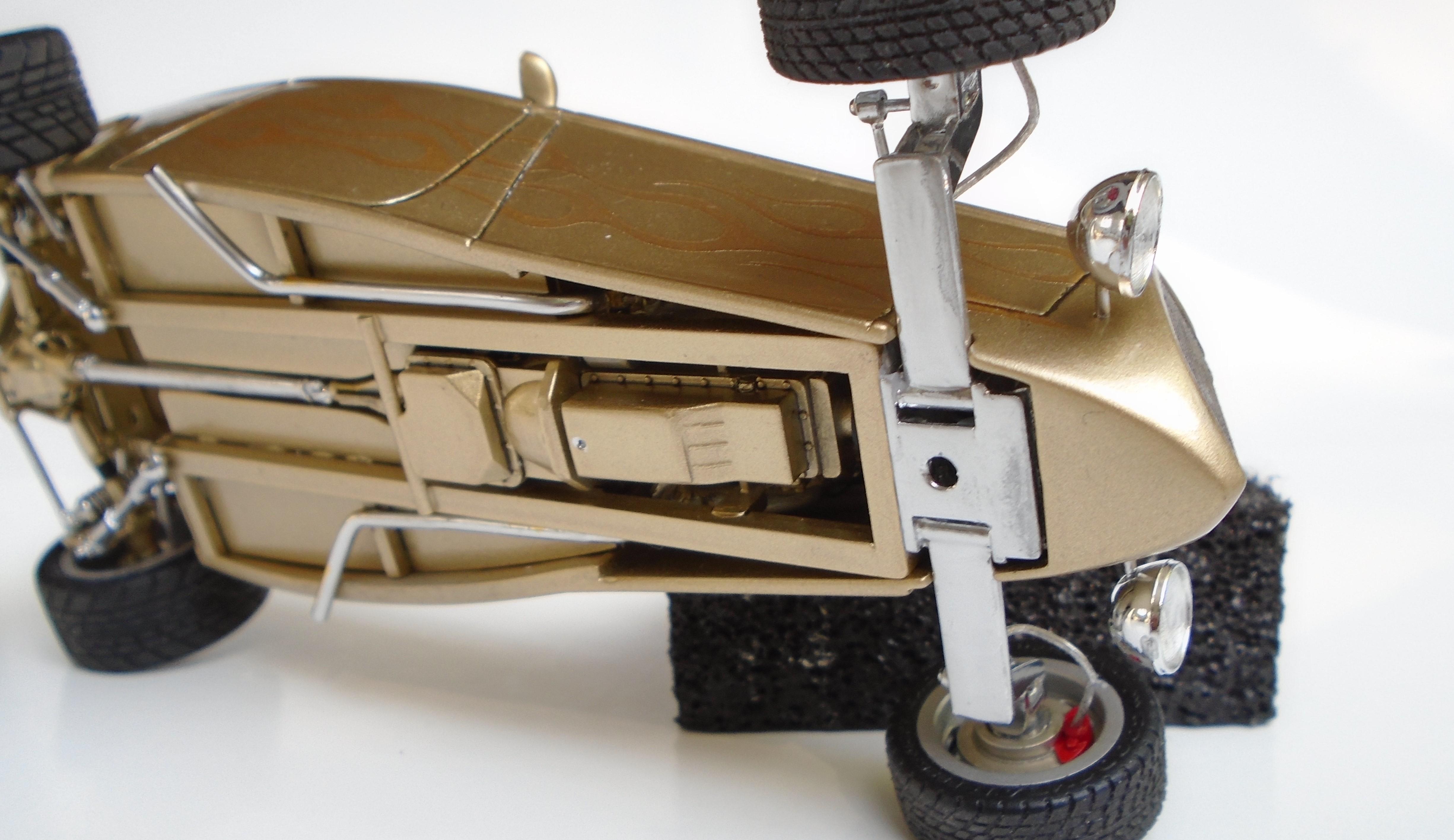

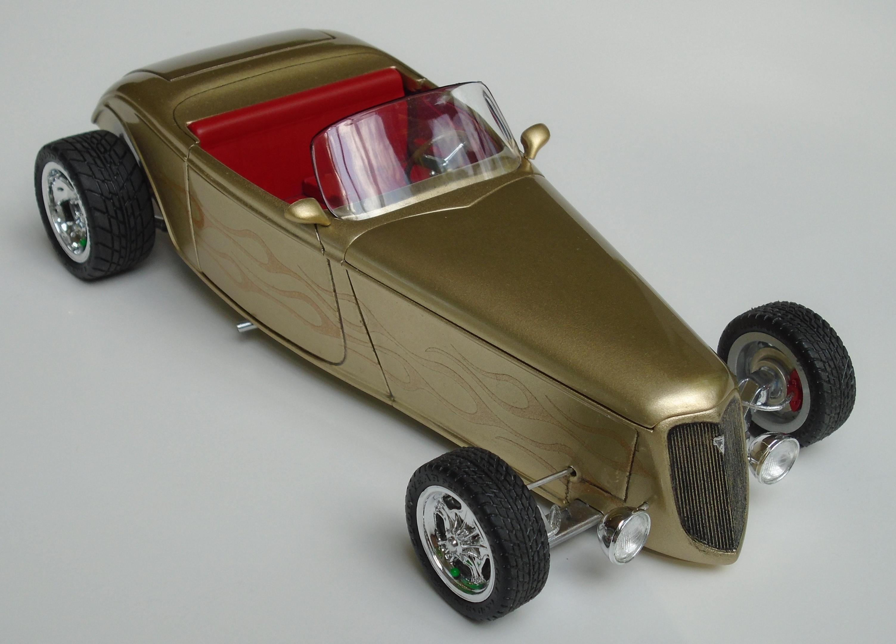

Claude Thibodeau Posted February 21, 2024 Posted February 21, 2024 Hi! I had good results applying Molotow's chrome, from the refill bottle, not the pens. Pour some in a small container, use a number two brush, and apply VERY WET on the part, only once, with minimal overlap. It works fine (see front suspension on roadster below). Do NOT retouch what you just applied, or it will show streaks and dull sections. If you absolutely have to apply a second coat, wait at least a week, and make it LESS WET than the first, to avoid too thick a chrome surface. Good luck! CT

1hobby1 Posted February 22, 2024 Author Posted February 22, 2024 3 hours ago, Claude Thibodeau said: Hi! I had good results applying Molotow's chrome, from the refill bottle, not the pens. Pour some in a small container, use a number two brush, and apply VERY WET on the part, only once, with minimal overlap. It works fine (see front suspension on roadster below). Do NOT retouch what you just applied, or it will show streaks and dull sections. If you absolutely have to apply a second coat, wait at least a week, and make it LESS WET than the first, to avoid too thick a chrome surface. Good luck! CT That’s a sweet looking build… it does look great brushed on. I think I’m convinced to try the BMF first. This way if it’s not to my liking I can always peel it off as well. I appreciate you sharing this. I may end up going this route depending how the BMF goes.

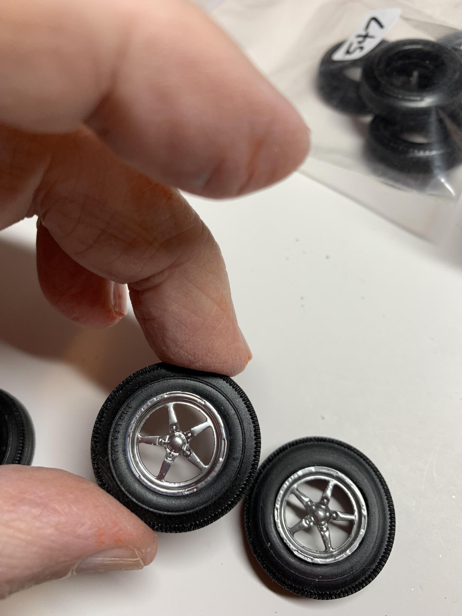

R. Thorne Posted February 22, 2024 Posted February 22, 2024 (edited) Well, I’m kinda partial to the GreenStuffWorld (non air brush version). Daubed this on with a micro brush. Edited February 22, 2024 by R. Thorne Non air brush 1

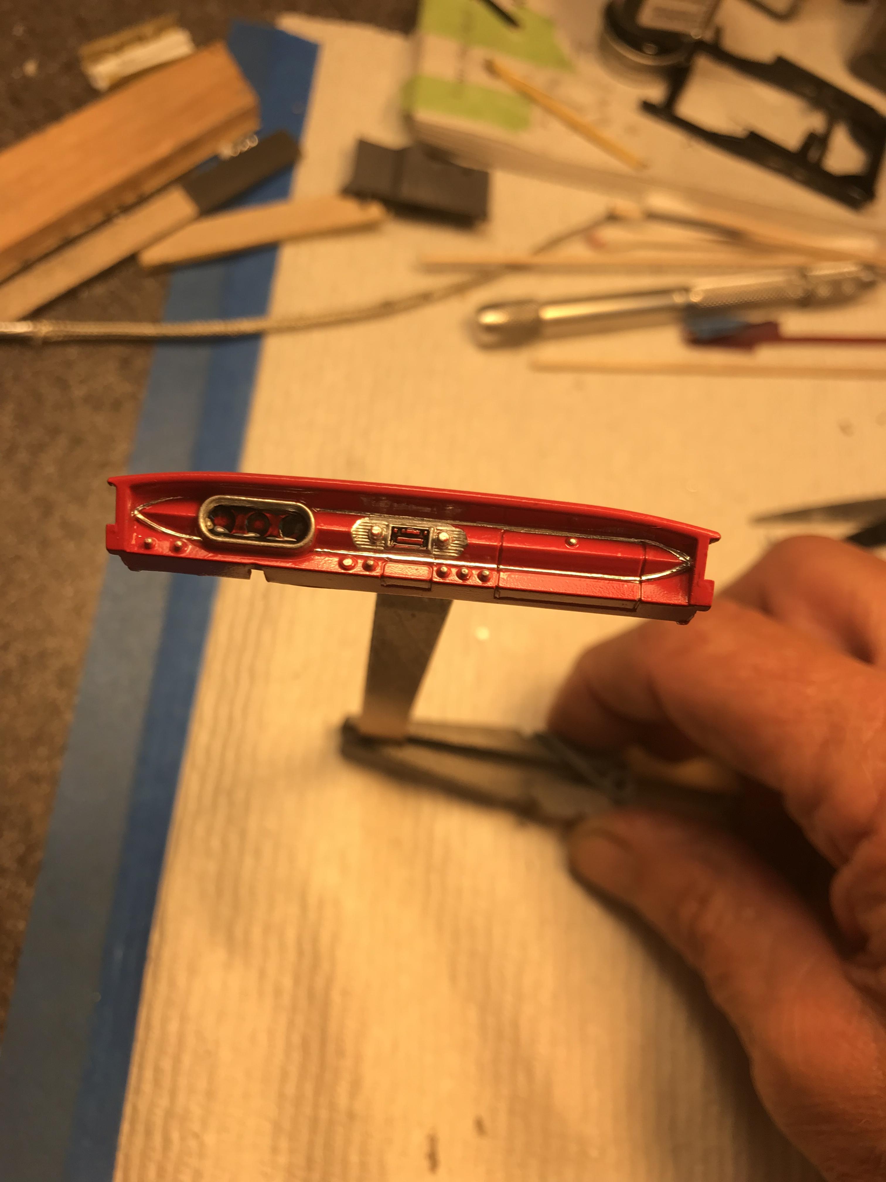

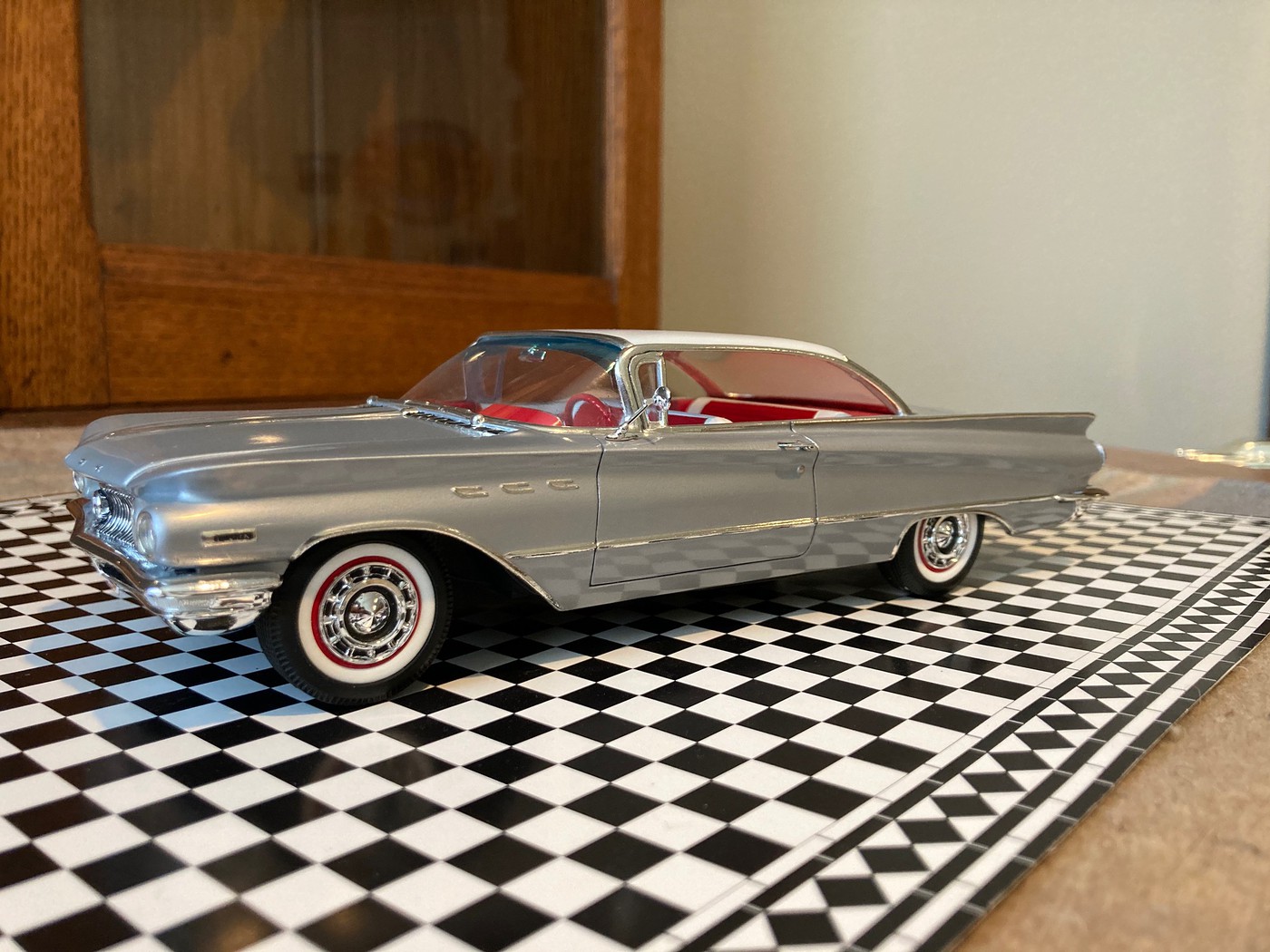

Oldriginal86 Posted February 24, 2024 Posted February 24, 2024 At 63yo. my hands aren’t as steady as they once were so painting small details is not in the cards. BMF gives me a chance. I use a single edge razor blade to trim the foil. The trim on the inner edge of the dash pictured was done with foil. I could have never painted that. 2

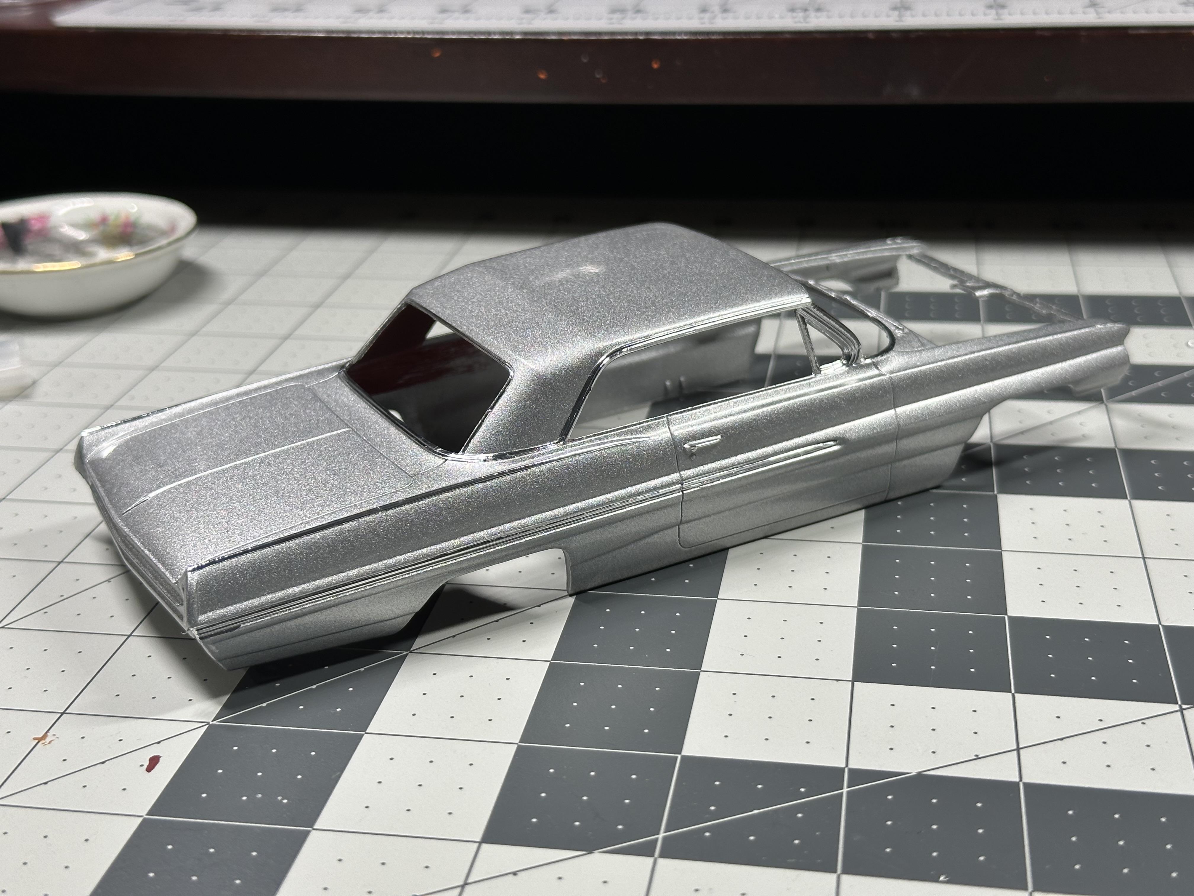

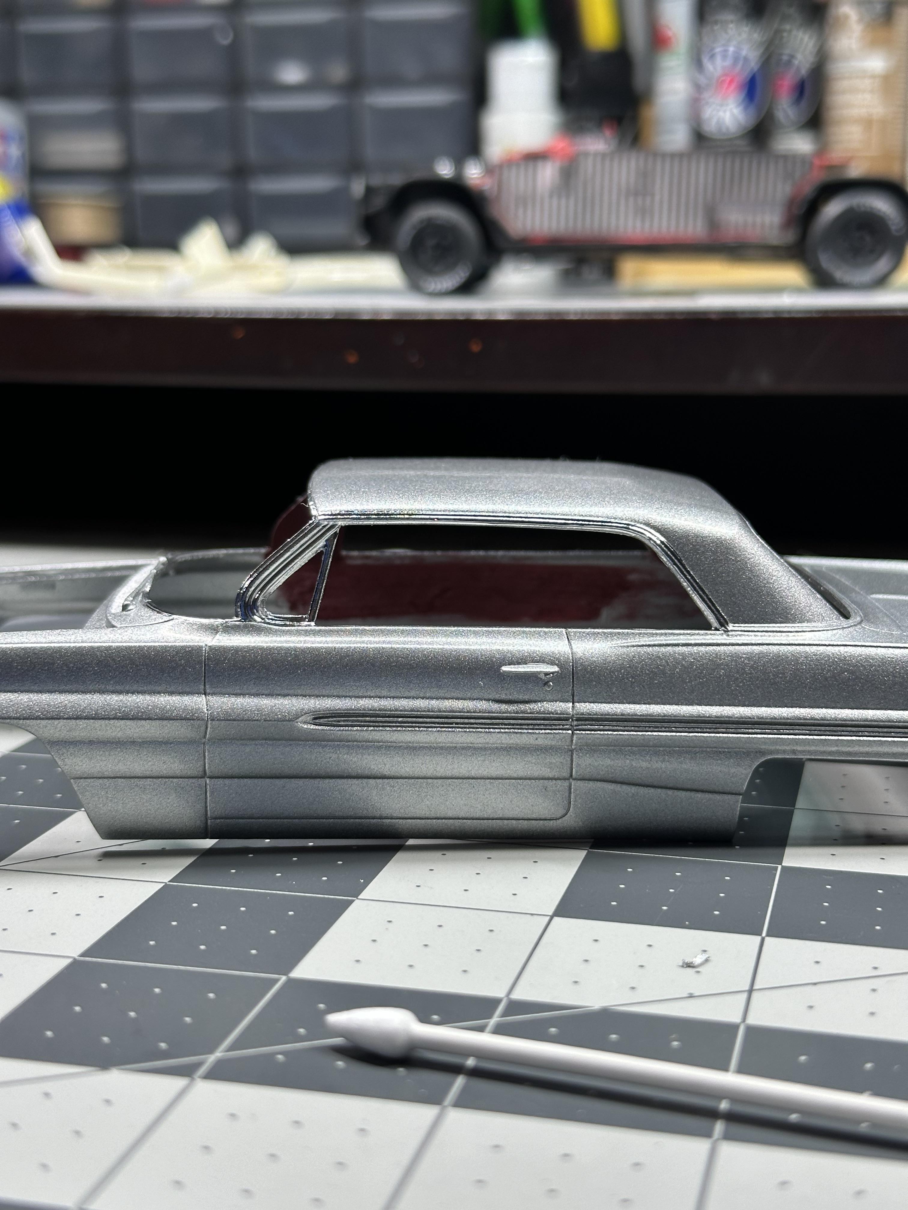

1hobby1 Posted February 28, 2024 Author Posted February 28, 2024 Thank you all for the advice. Although, I probably wasted more than needed, and possibly thought about throwing the car out the window lol… I do agree this does give the separation in color I was looking for. One side down! Thank you again model friends.
JollySipper Posted February 28, 2024 Posted February 28, 2024 That looks really good! Foil is actual metal, so nothing else is gonna look as realistic as it does......... 1
StevenGuthmiller Posted February 28, 2024 Posted February 28, 2024 Looks like you have it down. As the saying goes, “anything worth doing is worth doing well”. There’s easy, and then there’s good. Steve 1

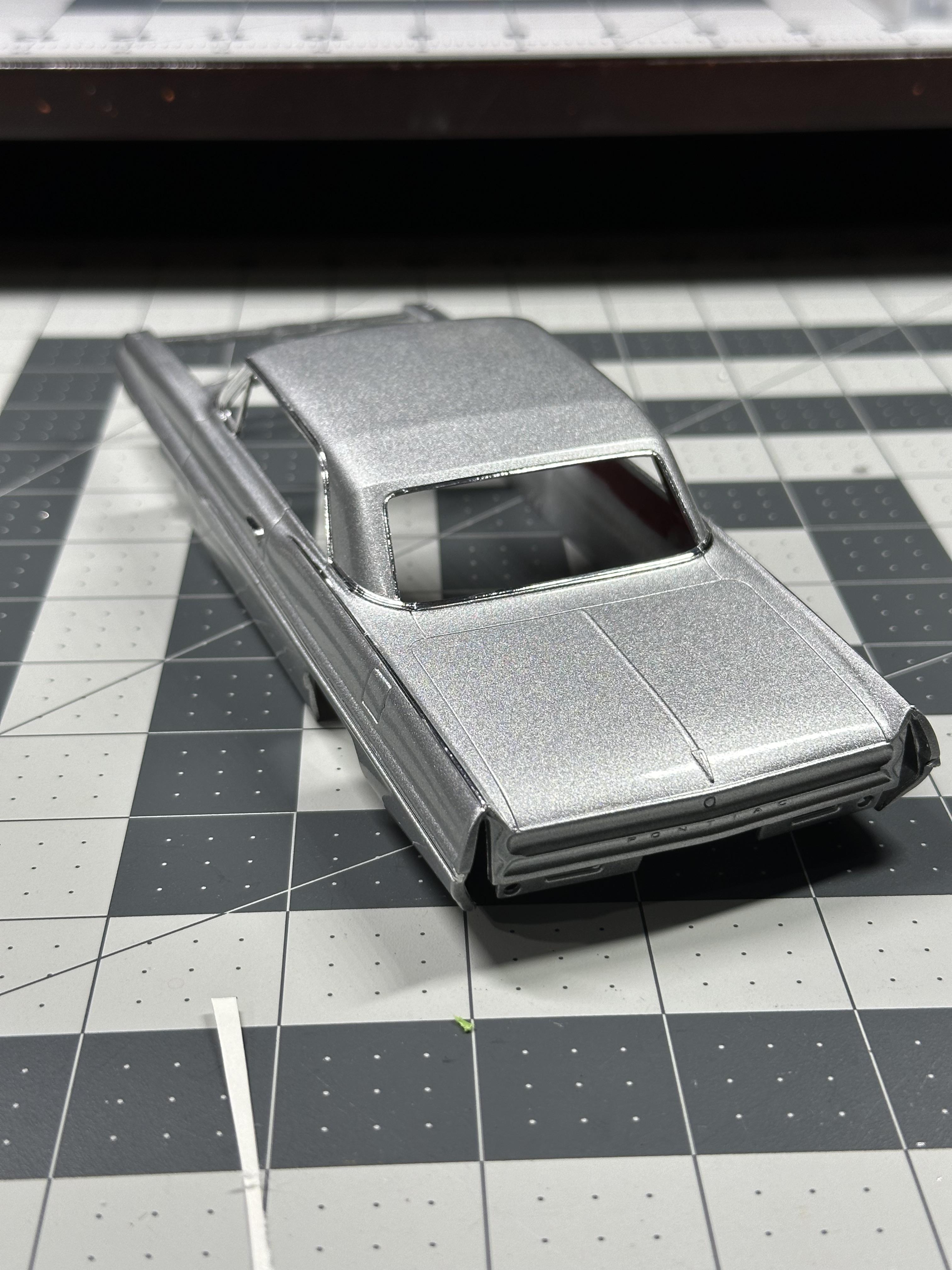

1hobby1 Posted March 2, 2024 Author Posted March 2, 2024 She’s all done. Thank you everyone for the input and advice. Almost time to wrap up the build. Remind me to never do chrome on silver ever again… my eyes got tortured LOL ?
