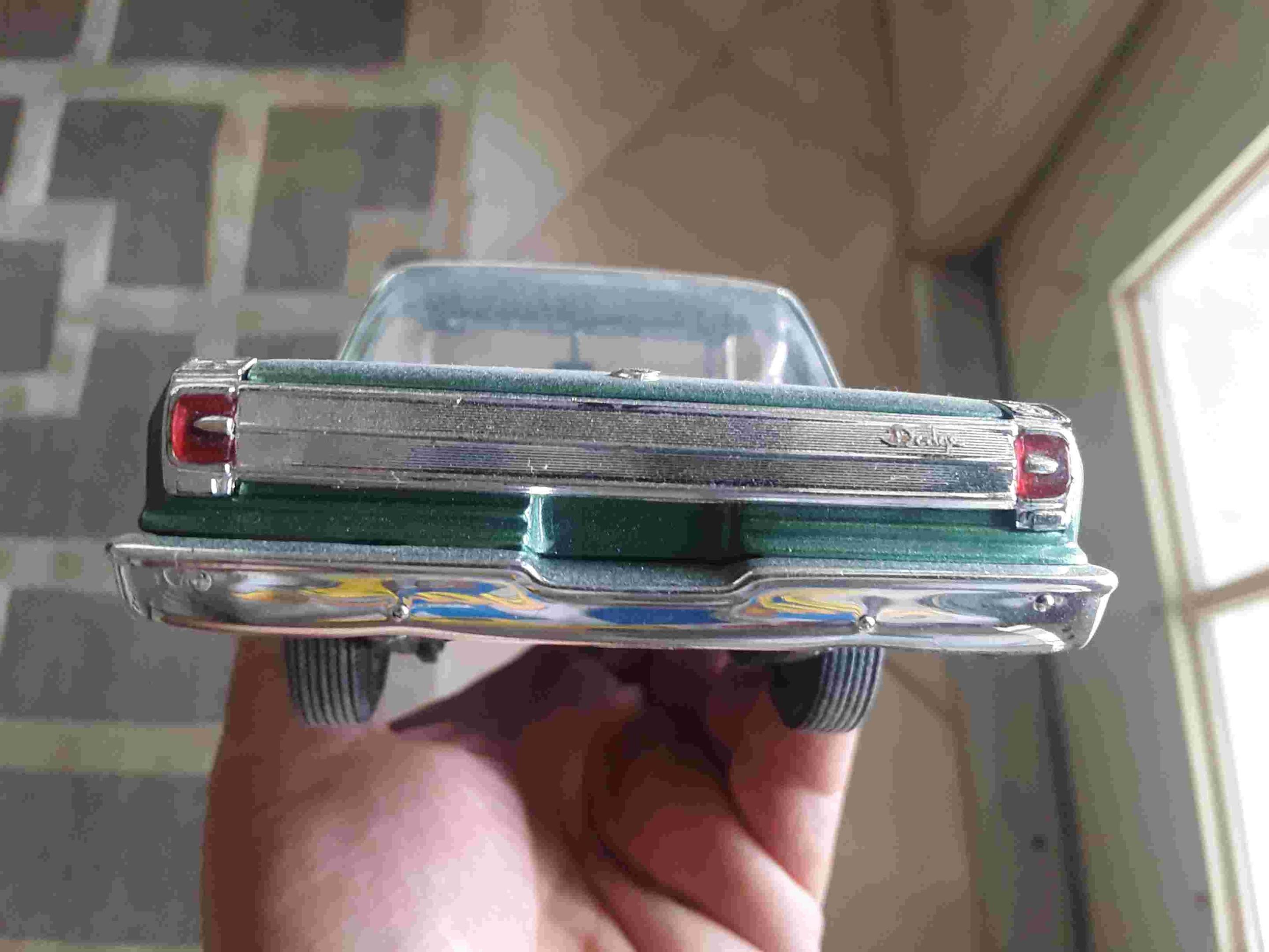

GMP440 Posted February 22, 2024 Posted February 22, 2024 If you have a Polar Lights 65 Coronet trunk panel, maybe you could modify that. Could work well for you.

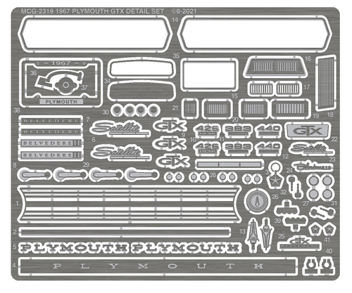

Exotics_Builder Posted February 22, 2024 Posted February 22, 2024 (edited) Can you not modify this detail for a 67? Edited February 22, 2024 by Exotics_Builder
gtx6970 Posted February 22, 2024 Author Posted February 22, 2024 1 hour ago, Exotics_Builder said: Can you not modify this detail for a 67? I could probably use part of something like that. But the grille is going to be too narrow. I will have to see if I have one of these photo Etch kits. Of not...order one. At a minimum I can use it for emblems
