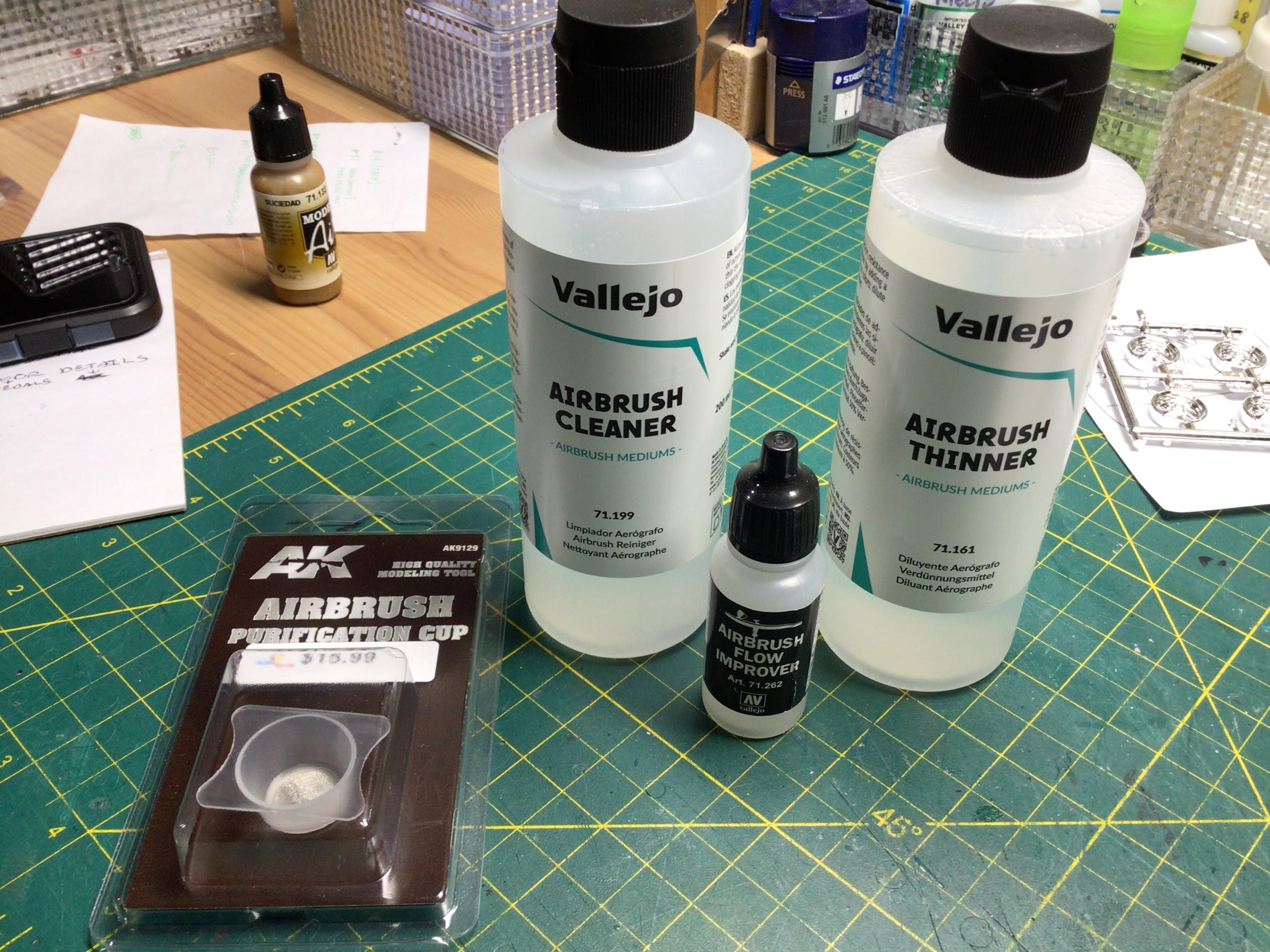

NOBLNG Posted February 22, 2024 Posted February 22, 2024 (edited) I am certainly no paint expert, but I know enamels can be thinned with lacquer thinner…but it smells!I use mostly lacquer, but am getting more into acrylics lately. I am using Vallejo airbrush cleaner for cleanup after spraying acrylics. It works nicely. Others may have their own concoctions? Edited February 22, 2024 by NOBLNG

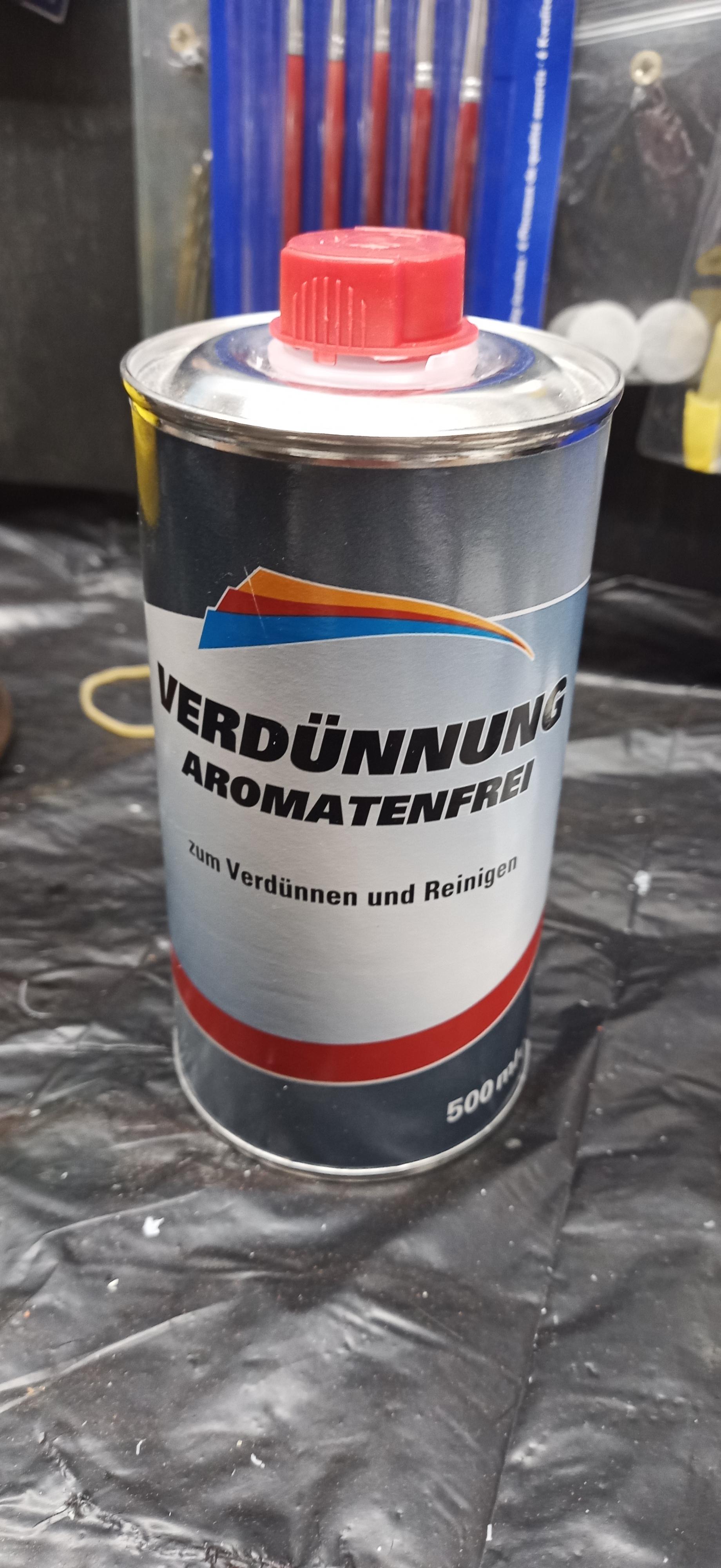

Jürgen M. Posted February 23, 2024 Author Posted February 23, 2024 Hi, I promised to take a picture of the solvent can I bought. It's from a German hardware store chain called "Bauhaus". I searched the whole Isle of cleaners, detergents and solvents till I discovered that can saying aromatics free. I'm not a chemist but I know that aromatics are highly poisonous and are known to cause cancer! I've had my share of that so I always was careful with the solvents I had been using! Anyway, I saw the can but of course I couldn't just open it to smell the contents. So I took a small can just in case it wouldn't work the way it should. But it did. I was really surprised. And that performance with no smell is just perfect! I recommend it truly. Try anything without aromatics. Should work out! But first try the smallest container Just in case. OK, I talked a lot, now here's the product: It says "thinner, free of aromatics. For thinning and cleaning". Tomorrow I'll get more! ? Have a good night! 1
peteski Posted February 23, 2024 Posted February 23, 2024 Are the ingredients listed on the label? Usually chemical bottles have those listed. It is probably what we call Odorless Paint Thinner. It is petroleum based and still has a slight odor. Can likely be used for solvent based enamels (like Humbrol and Testors PLA enamel). I don't airbrush acrylic water-based paints because they are difficult to clean out of the airbrush.

Jürgen M. Posted February 24, 2024 Author Posted February 24, 2024 (edited) Here's the back side of the can. It says isoprafine and aliphatic hydro carbons. (I looked that one up).? And this is the water based clear coat I use! Never had a better one! Edited February 24, 2024 by Jürgen M.
