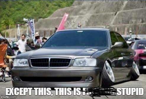

Earl Marischal Posted February 25, 2024 Posted February 25, 2024 I understand that a degree of negative camber can assist road holding, but surely excessive angles ruin tyres and are potentially dangerous? steve 2 3

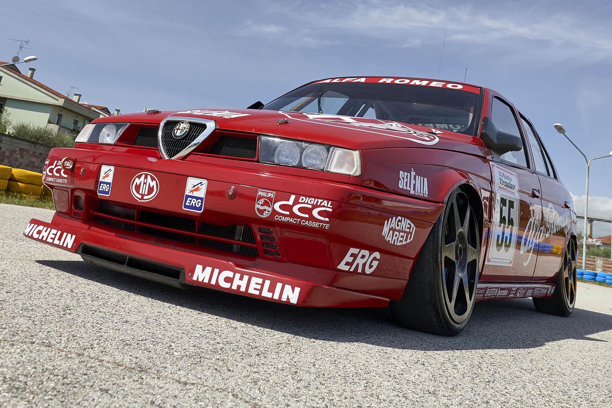

stitchdup Posted February 25, 2024 Posted February 25, 2024 photoshop but the why is because people want their boring sedans to look like touring cars because touring cars just look cool. 1
carsntrucks4you Posted February 25, 2024 Posted February 25, 2024 Speciality from Japanesse tuner. Absolutely senseless thats not photoshoped 2
Ace-Garageguy Posted February 25, 2024 Posted February 25, 2024 (edited) 3 hours ago, Earl Marischal said: ...a degree of negative camber can assist road holding, but surely excessive angles ruin tyres and are potentially dangerous? Yes, and yes. The degree of static negative camber that's beneficial is dependent on the specific design of the suspension geometry and the tires on the vehicle under scrutiny...and it's always a compromise between what's best for acceleration, braking, and cornering. The primary rational goal of any performance suspension modification is to increase traction. For any given tire, traction is increased by maintaining a contact patch between the tire tread and the road surface that is as large as possible. This is accomplished by keeping the tire tread flat on the ground, which happens when the wheel/tire centerline is perpendicular to the ground. Cornering produces lateral loads on the tires, a tendency to slide sideways, and maintaining as large a contact patch as possible on the outside tires in a turn, the most heavily loaded ones, can often be achieved by the introduction of varying degrees of negative static camber...again, depending entirely on the general design of the suspension geometry (strut, upper and lower lateral control arms, trailing arms, etc.) and tires. Unfortunately, many humans are content to operate on the "monkey see, monkey do" principle rather than make the effort to develop an UNDERSTANDING of what they're doing...because TLDR. The OP's illustration is of an idiot's car. Edited February 25, 2024 by Ace-Garageguy 4 2

peteski Posted February 26, 2024 Posted February 26, 2024 As I see it it is a fad done for looks. It often goes alone with narrower low-profile tires stretched unrealistically onto wide rims. It's a "bad boy" image. It wrecks the tire and ride qualities. The handling is likely not very good either. I don't shake my fists or yell at those - just roll my eyes. But whatever . . . if it makes those guys think they are cool, so be it. 1
niteowl7710 Posted February 26, 2024 Posted February 26, 2024 Sooooo...this is a thread about old fart Americans not liking things done in Japan to VIP style cars? The cars are on air suspensions fellas, they lose the ridiculous camber when they're at normal ride heights. It's no different than any other "bagged" car done in the good Ole U.S. of A where the point is to drag the car as low as possible when you're showing it off. Nobody says you have to like it. Nobody from the Government is going to force you to slamber your daily driver... This forum really will find nearly anything to complain about, sheesh go build a model... 4 3

bobss396 Posted February 26, 2024 Posted February 26, 2024 I worked with a guy that had a dropped VW of some sort with the negative camber. He wore tires out in record time. When I was doing alignments, cars with excess negative camber were impossible to get on the rack we had. I guess alignments are not important to them. 1 1

Rockford Posted February 26, 2024 Posted February 26, 2024 I'm not saying what anyone should or shouldn't do but the fact is that negative camber does have a use, indeed many production cars have a slight negative camber to help the outer tyre in a turn plant more squarely onto the ground. This improves cornering as the weight of the vehicle shifts to the outer side of the car in a cornering situation, however it's only ever a marginal amount of camber because it does have a negative impact on tyre wear and a vehicle spends most of its life in a 'straight ahead' position. Race cars exaggerate camber because they spend much more of their life cornering and at highspeed, (most racing drivers don't take the wife, kids and groceries around the track with them) and tyre life is much less of an issue for them. They subject the chassis to much higher forces than a road car, thus causing more suspension deflection, weight transfer, tyre deformation etc... so the greater camber angle helps to plant the outer, greater weight bearing tyres more squarely on the ground producing more grip and higher speeds. The changes in geometry of a low rider that someone mentioned earlier demonstrates what happens to wheel angles as a suspension deflects, especially a traditional double wishbone with unequal length upper and lower arms. Hope that makes sense. 1
