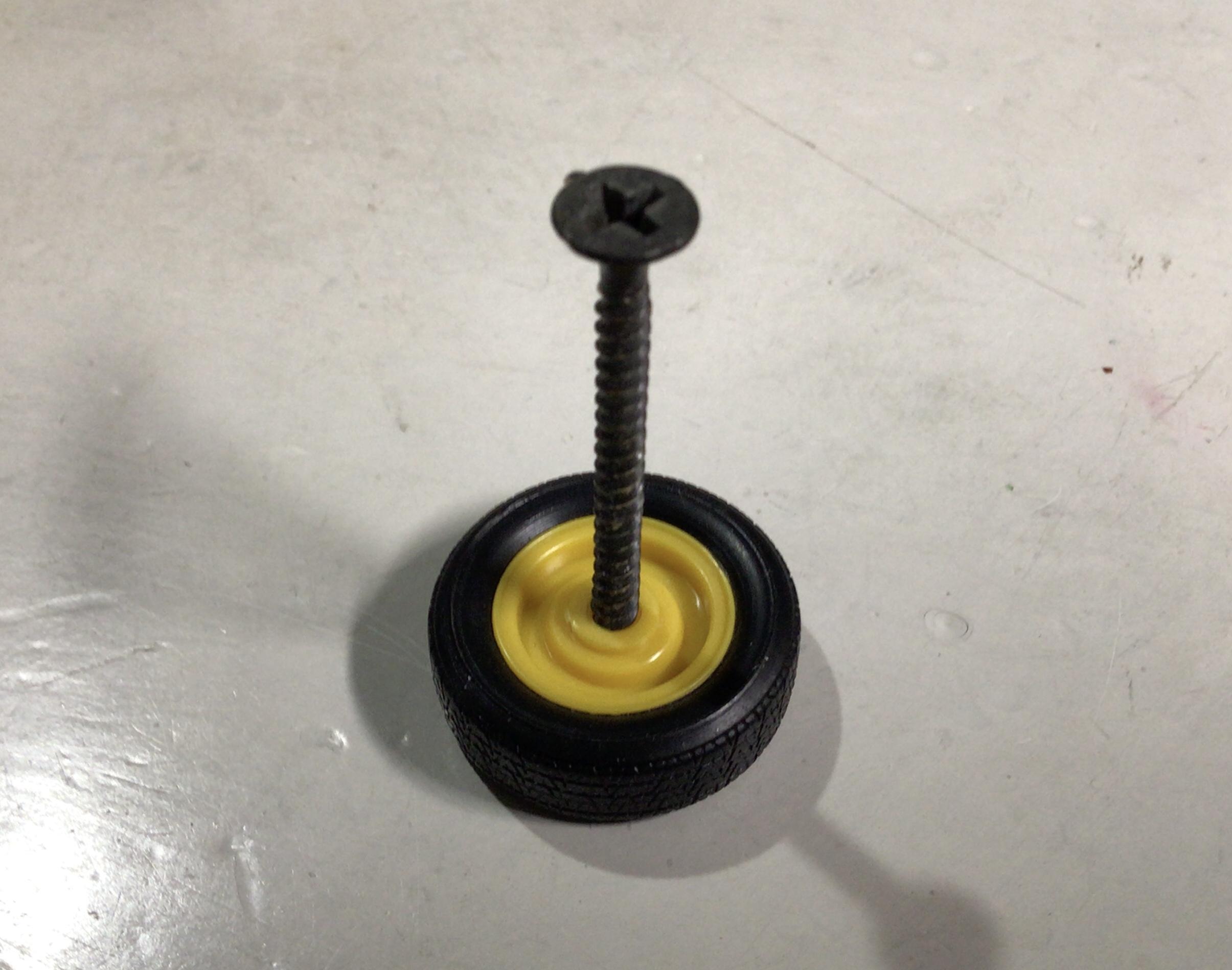

oldcarfan Posted March 2, 2024 Author Posted March 2, 2024 Reading the replies made me think and I went out and checked. The plastic does indeed have a sort of waxy feel to it not unlike Teflon in some ways. I have a couple of Bondo spreaders and they feel and flex like plastic I'm talking about. The plastic doesn't take cutting or sanding well at all. Out of curiosity, I tried an experiment. I scuffed up the leftover chassis of a parts kit and tried various things on it. I tried super glue, Bondo spot putty, two part epoxy, ketone, and some other solvent based cleaners. They had no effect on the plastic. It didn't bond the plastic and it didn't even distort it.
Ace-Garageguy Posted March 2, 2024 Posted March 2, 2024 6 minutes ago, oldcarfan said: Reading the replies made me think and I went out and checked. The plastic does indeed have a sort of waxy feel to it not unlike Teflon in some ways. I have a couple of Bondo spreaders and they feel and flex like plastic I'm talking about. The plastic doesn't take cutting or sanding well at all. Out of curiosity, I tried an experiment. I scuffed up the leftover chassis of a parts kit and tried various things on it. I tried super glue, Bondo spot putty, two part epoxy, ketone, and some other solvent based cleaners. They had no effect on the plastic. It didn't bond the plastic and it didn't even distort it. Good job. Nothing within the usual modeler's repertoire is going to stick to it then. Best figure out some way to pin the parts together, or find some other mechanical fastening method...small screws, etc.
