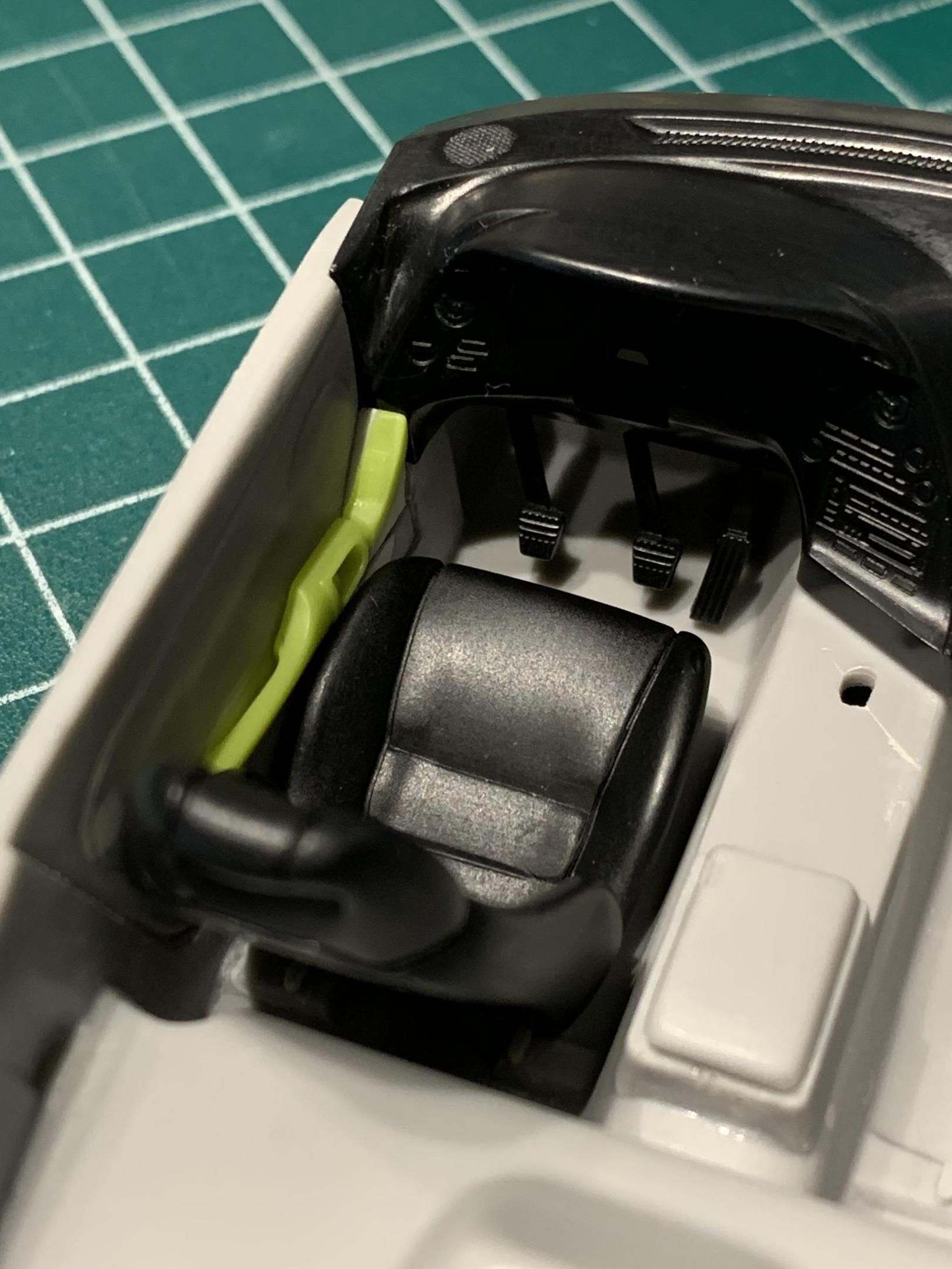

The Toyota Supra is a Tamiya kit, so I was very surprised to see the lack of detail on the door panel. The poor excuse for an arm rest and lack of power window/door lock buttons. Top left is the original cast interior. Top right is the transkit. Bottom pics are my attempt to add details.
Here is the door panel from AMT’s Supra kit. Since I have not yet invested in 3D printing, I will use the old school method.
I will be adding photo-etched power buttons and a nice DM photo-etched speaker grill.

Hi !
I was scratch building my own roll bar, to replace the one from the kit. Then took a break for the summer.
Have now started work again on my dream “Eleanor” build.
Will continue the Paul Walker Tribute builds come Spring ‘25 and finish the Toyota Supra (fully detailed accurately) and then start the silver Nissan Skyline !
