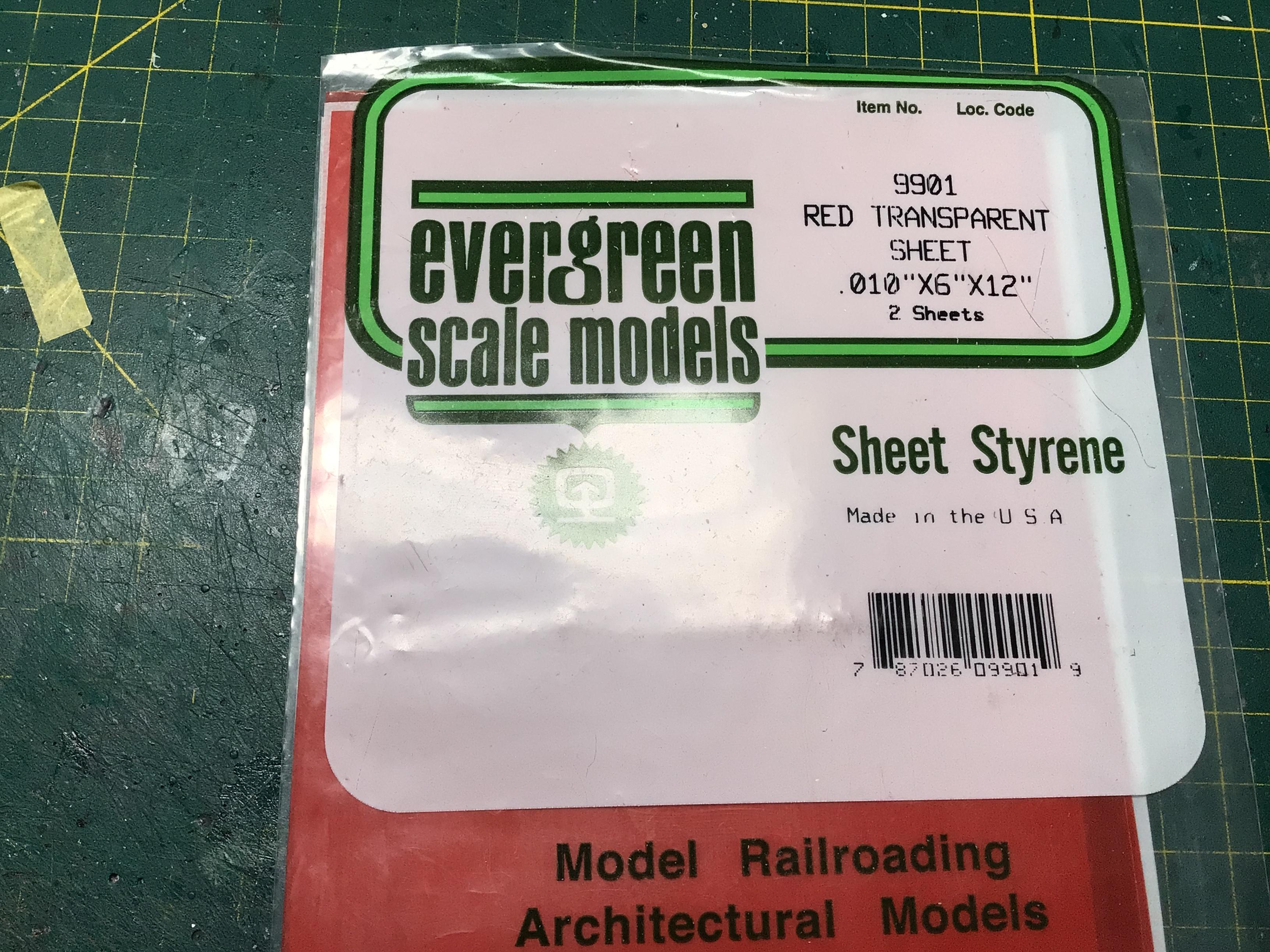

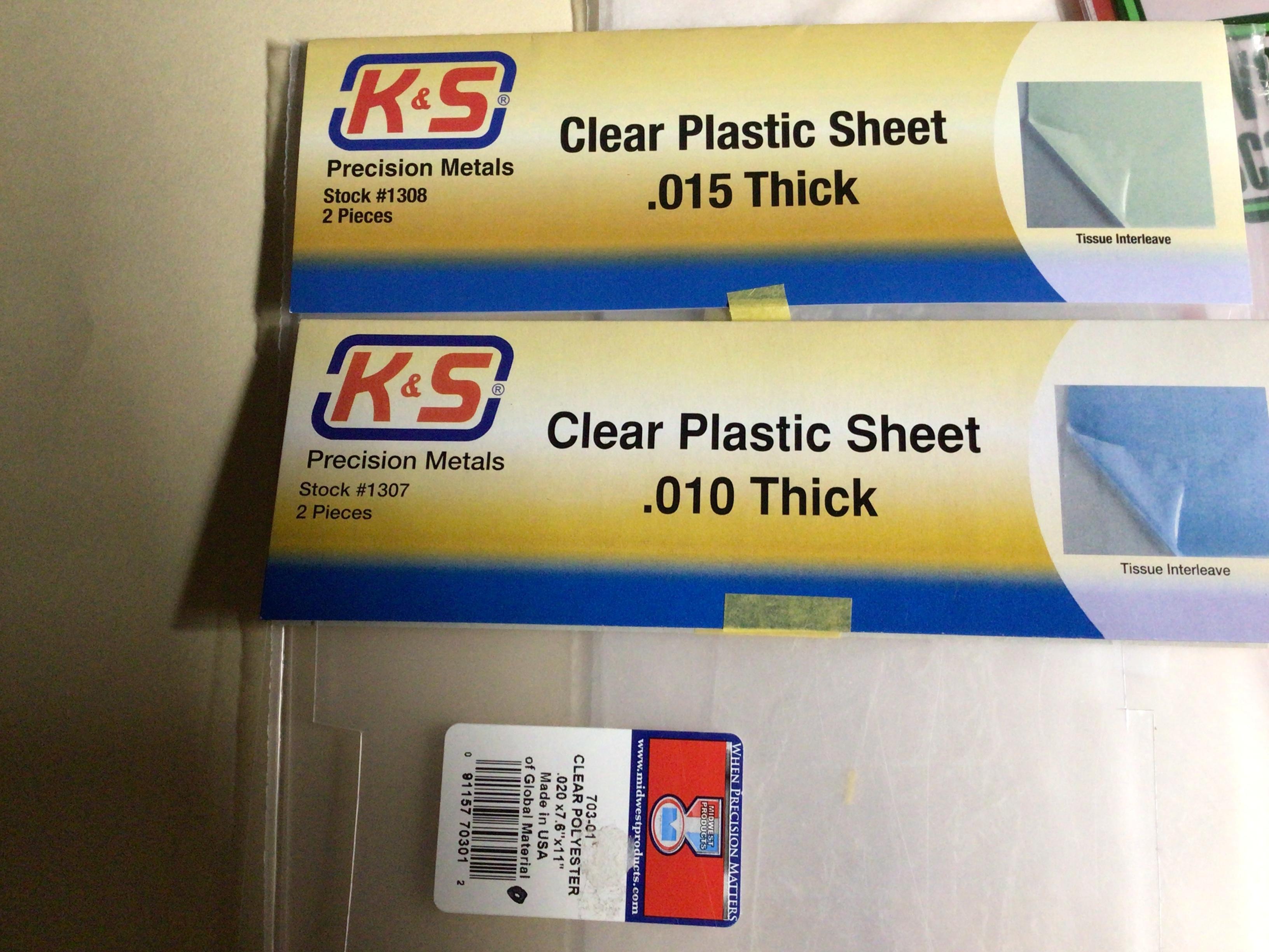

NOBLNG Posted March 9, 2024 Posted March 9, 2024 (edited) These are the sheets that I have gotten locally. The evergreen is red, but they must have it clear too I would think? The 0.010” is what I used for this ‘53 Corvette. Edited March 9, 2024 by NOBLNG
peteski Posted March 9, 2024 Posted March 9, 2024 (edited) The K&S sheets were very handy but it looks like they are discontinued. https://www.hobbylinc.com/htm/k+s/k+s1307.htm https://www.hobbylinc.com/htm/k+s/k+s1308.htm Looking at the K&S website it appears they no longer offer any plastic for sale - just metal. Edited March 9, 2024 by peteski
