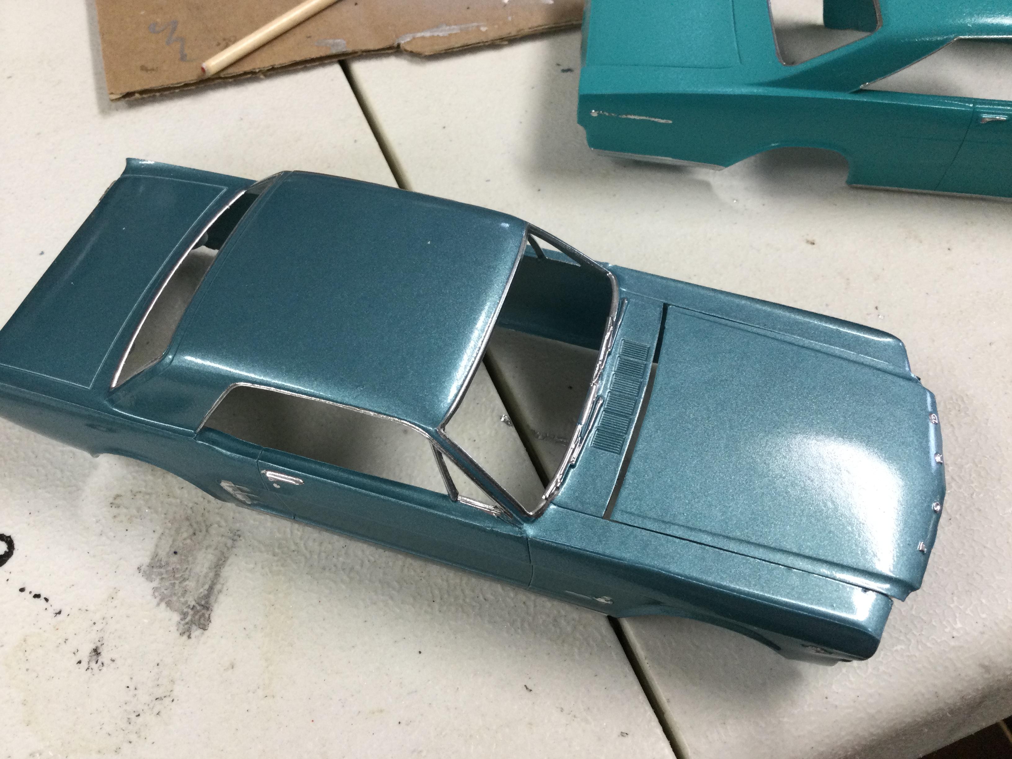

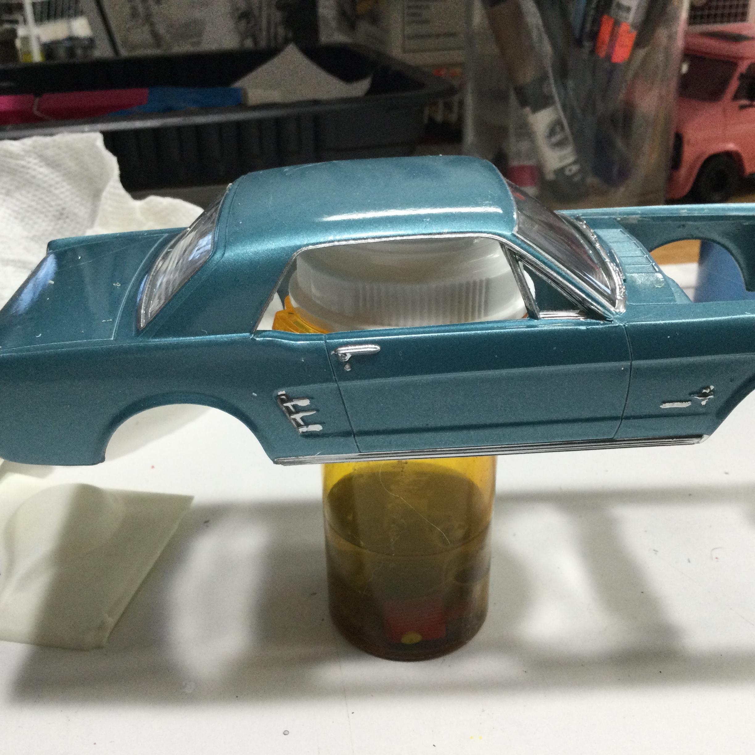

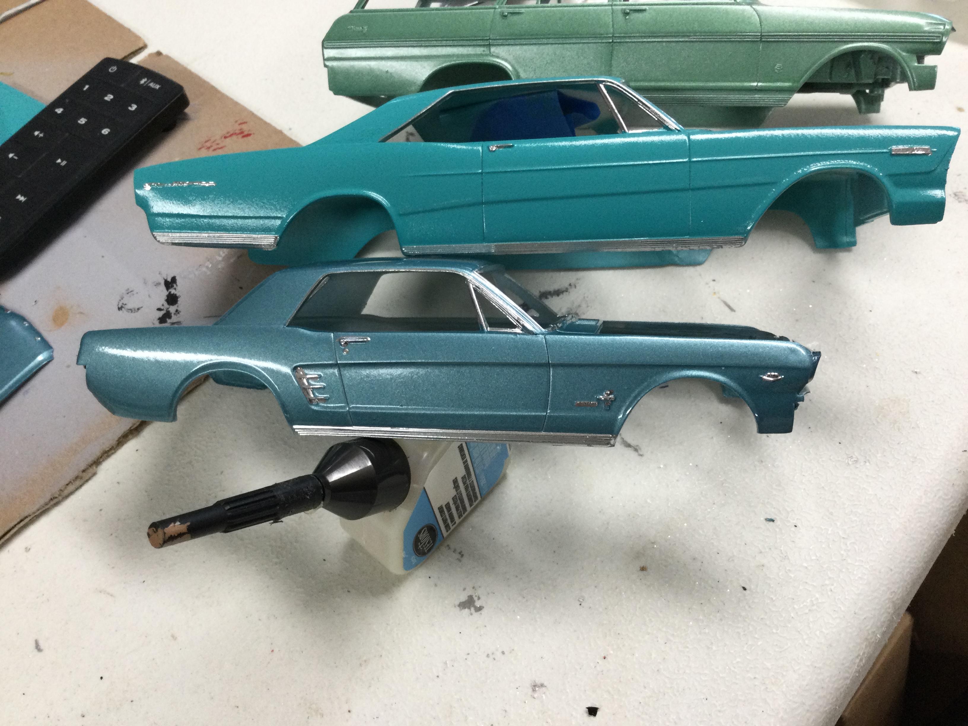

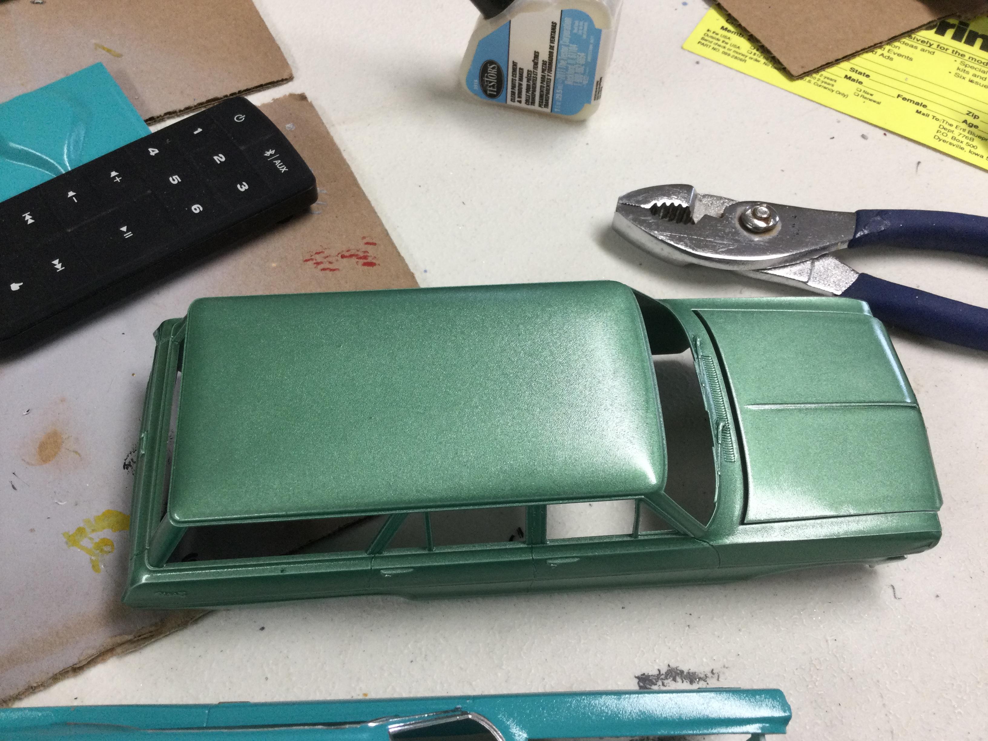

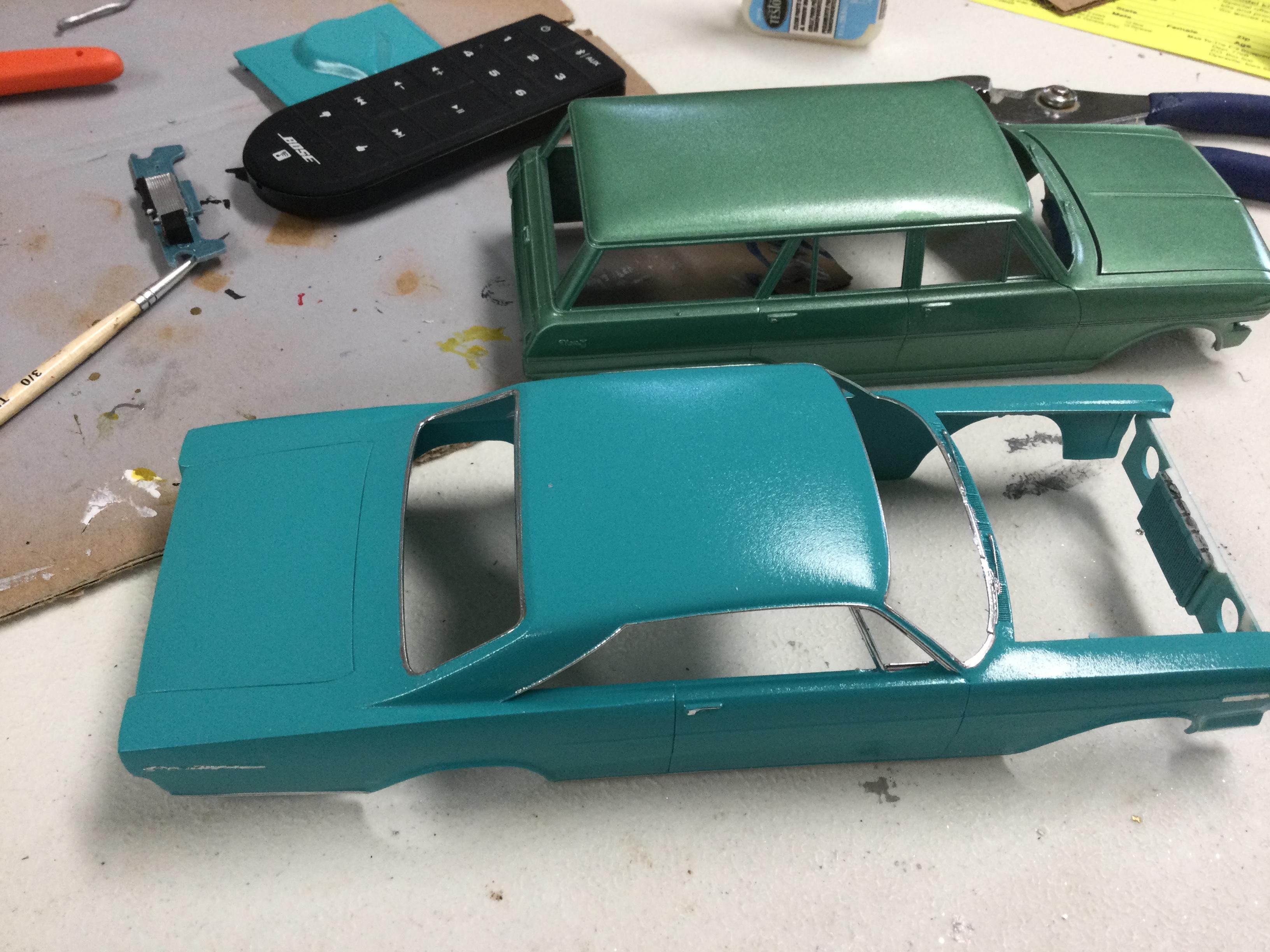

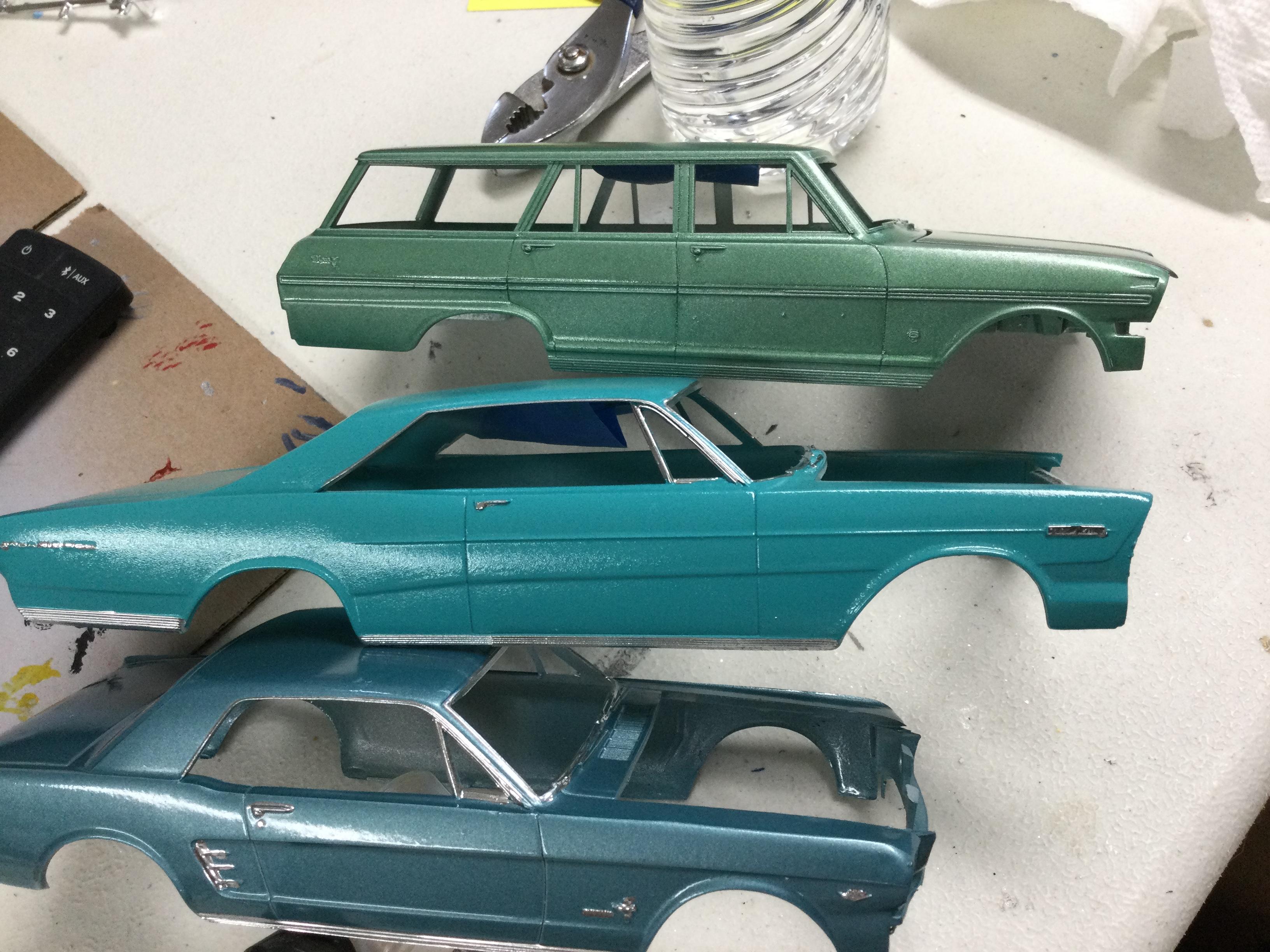

ewetwo Posted March 10, 2024 Posted March 10, 2024 I don’t know what is going on. All the same primer. Nova needs to be stripped again. Ford needs to be stripped again. But Mustang will be fine with some polishing. I had stripped the Ford and Nova in Super Clean before and the plastic looked all etched. I’m at a loss as to what is going on. Same primer on all of them. Can’t blame that I guess. Mustang and Nova both had paint that was ordered from the parts store. The Ford was Model Masters Turquoise Metallic Auto Enamel. And the Model Master doesn’t really look like metallic does it?
peteski Posted March 10, 2024 Posted March 10, 2024 I have never seen (Testors) Model Master paints attack or etch polystyrene or ABS plastic kits. Even applied without a primer. I have painted many kits over bare plastic using Testors and Model Master paints. Those paints are mild, specifically formulated for plastic compatibility. Unless of course something changed in the last few years. Still, these hobby paints are sold as such. Are you sure it is not the primer that is etching the plastic? 2
StevenGuthmiller Posted March 10, 2024 Posted March 10, 2024 Maybe I’m missing something, but I don’t see anything that couldn’t be addressed with a couple of coats of clear and a little polishing Steve 4
ewetwo Posted March 11, 2024 Author Posted March 11, 2024 There is 2 coats of Testers wet clear Steve. I've been waiting a month now for my polishing compounds to arrive from Amazon. The Ford was really rough and the Nova just looked horrible. I threw that can of paint out as I've tried to use it on the Nova twice and both times it looked awful. They are both back in the pond.

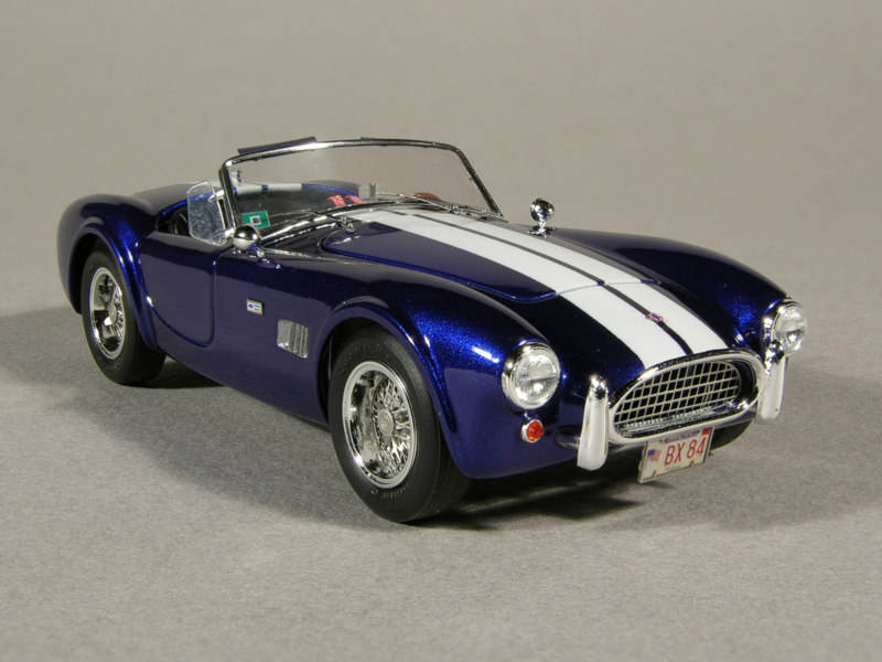

peteski Posted March 11, 2024 Posted March 11, 2024 6 minutes ago, 1972coronet said: Every time I've used Testors Wet Look Clear, it flashed (dried ?) in a dull - maybe semi-flat - finish. After colour sanding and polishing, it bore a nice gloss. Interesting. Here is my model. Yellow plastic body airbrushed with Tamiya fine white primer, nail polish metallic blue, and Testors Wet Look Clear top coat. It want on smoothly and glossy. No rubbing, no polishing. Maybe it was humid when you clear coated and it "blushed"? 2

1972coronet Posted March 11, 2024 Posted March 11, 2024 9 hours ago, peteski said: Here is my model. Yellow plastic body airbrushed with Tamiya fine white primer, nail polish metallic blue, and Testors Wet Look Clear top coat. It want on smoothly and glossy. No rubbing, no polishing. Maybe it was humid when you clear coated and it "blushed"? Quite likely - cold, definitely ( 30-40 degrees ) . But, it did polish nicely , regardless. Nice Cobra ! 1
ewetwo Posted March 11, 2024 Author Posted March 11, 2024 10 hours ago, peteski said: Interesting. Here is my model. Yellow plastic body airbrushed with Tamiya fine white primer, nail polish metallic blue, and Testors Wet Look Clear top coat. It want on smoothly and glossy. No rubbing, no polishing. Maybe it was humid when you clear coated and it "blushed"? Nice Cobra. Room temp 70 and humidity set at 35. Dupli-color gray primer in the short more expensive can. 1

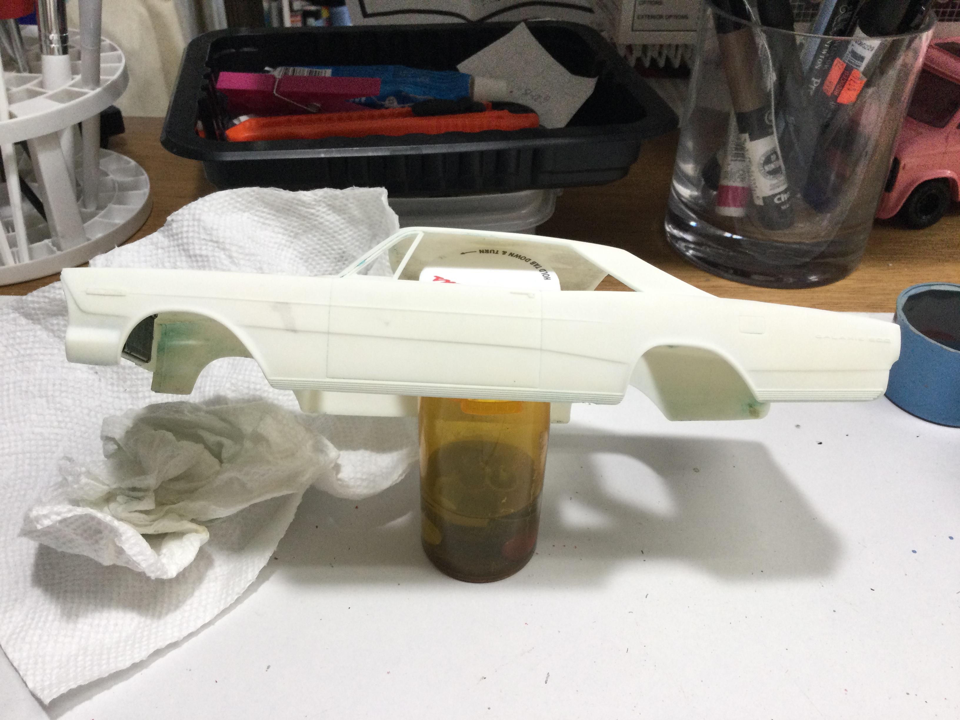

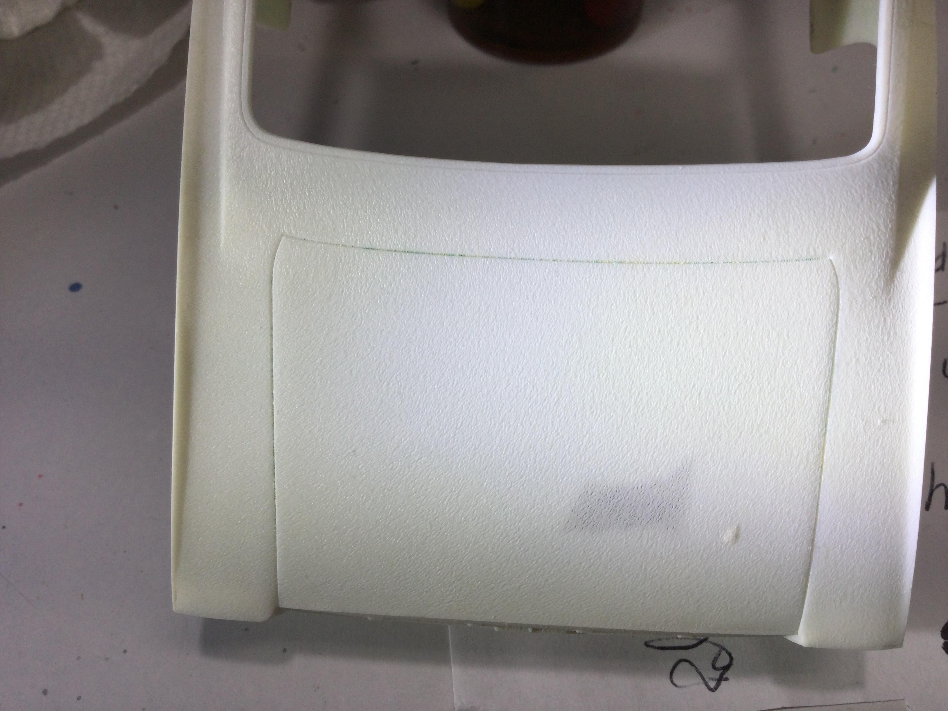

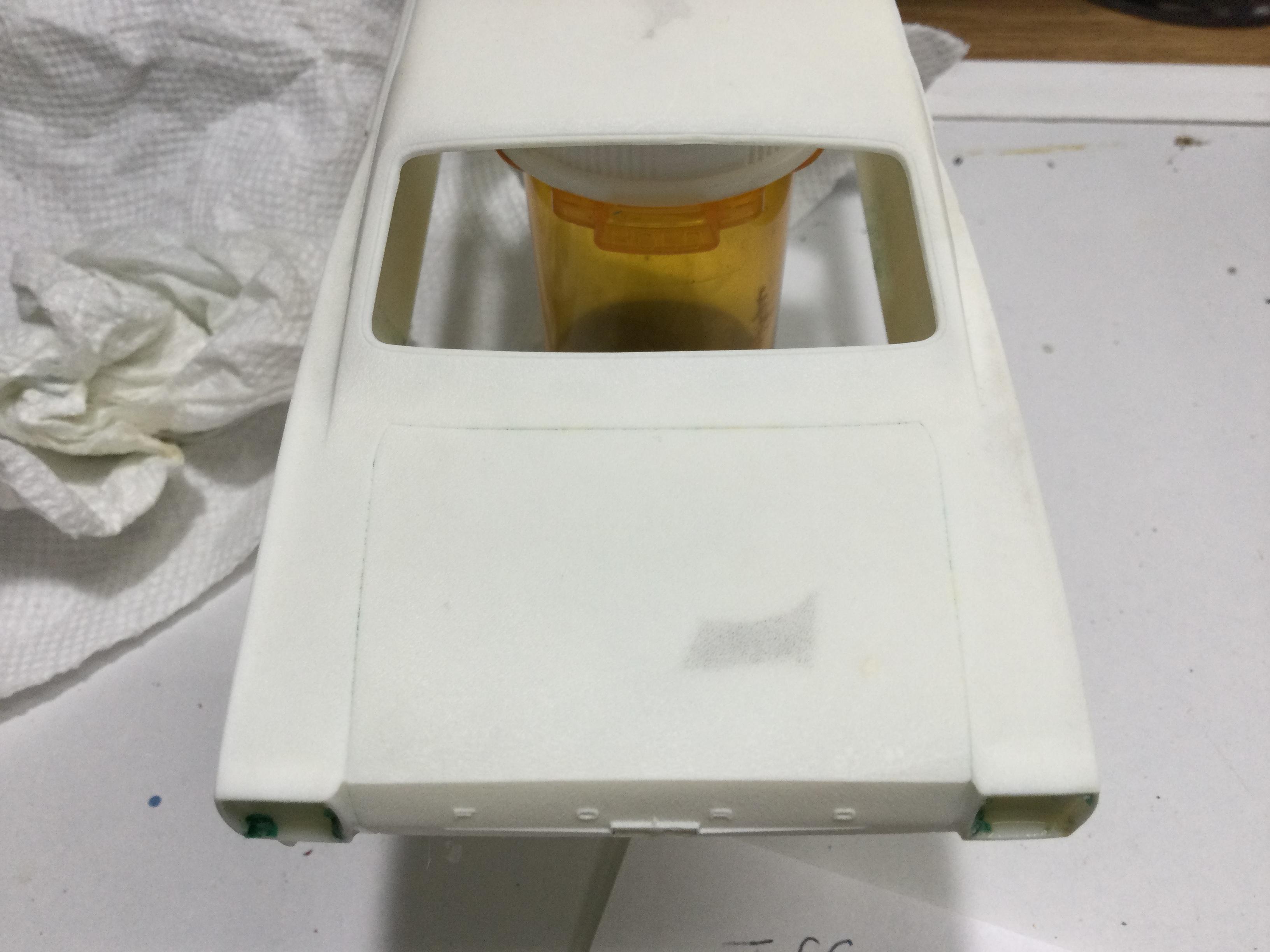

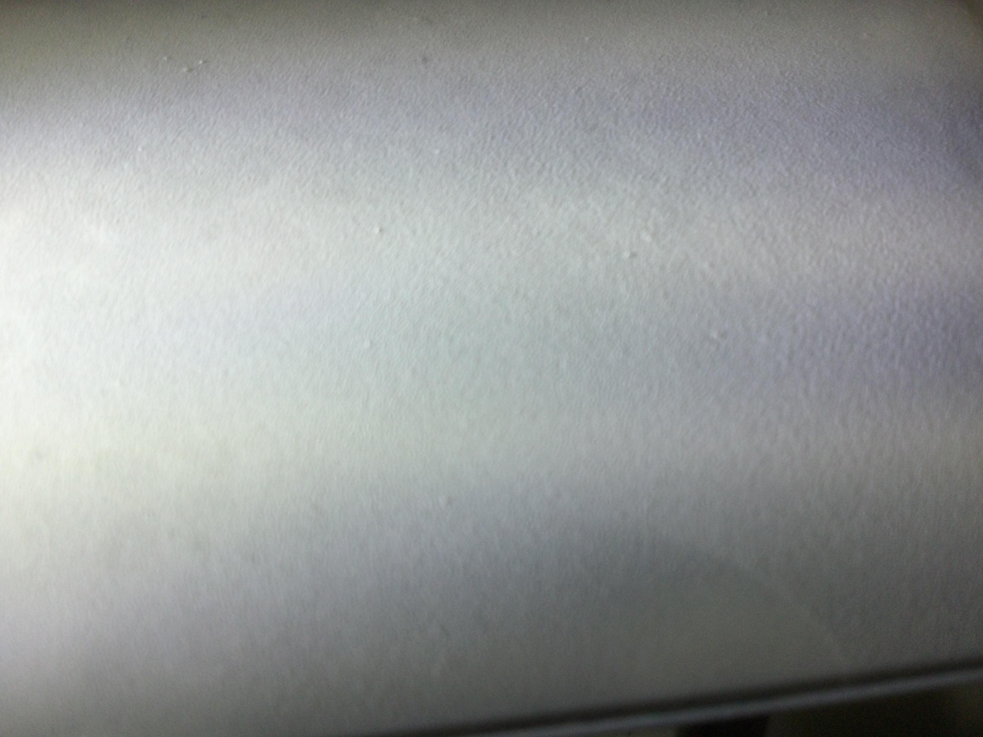

Carmak Posted March 11, 2024 Posted March 11, 2024 I am very curious to see pictures of the cars once they are stripped. If the paint actually crazed the plastic the surface of the plastic will no longer be smooth even after it has been stripped. Crazing is when the paint/primer reacts with the plastic. Removing the paint will expose the damage caused by the reaction but it will not remove the damage. If the plastic is smooth after striping, then I would look at a possible issue with the paint/primer. 3

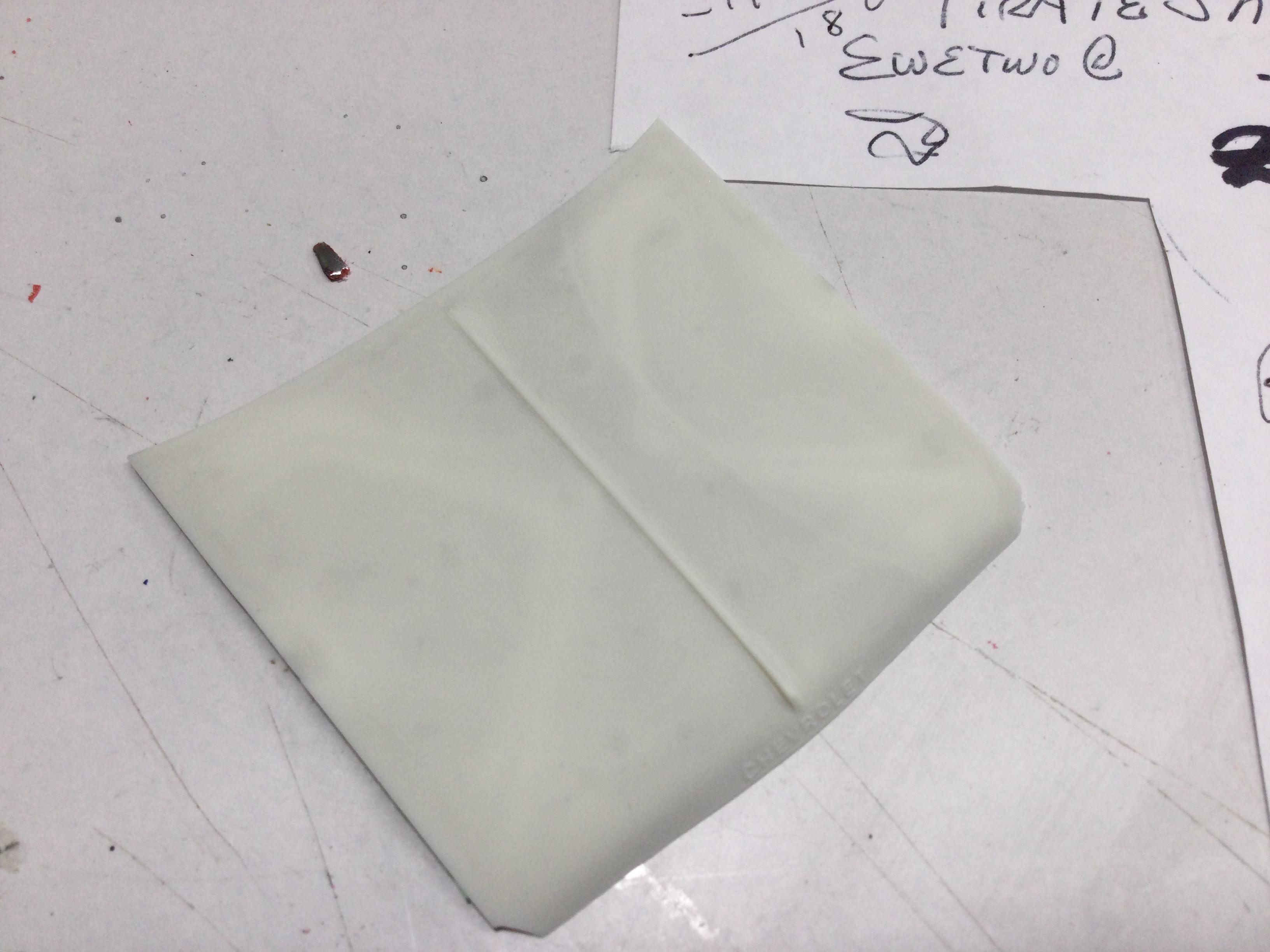

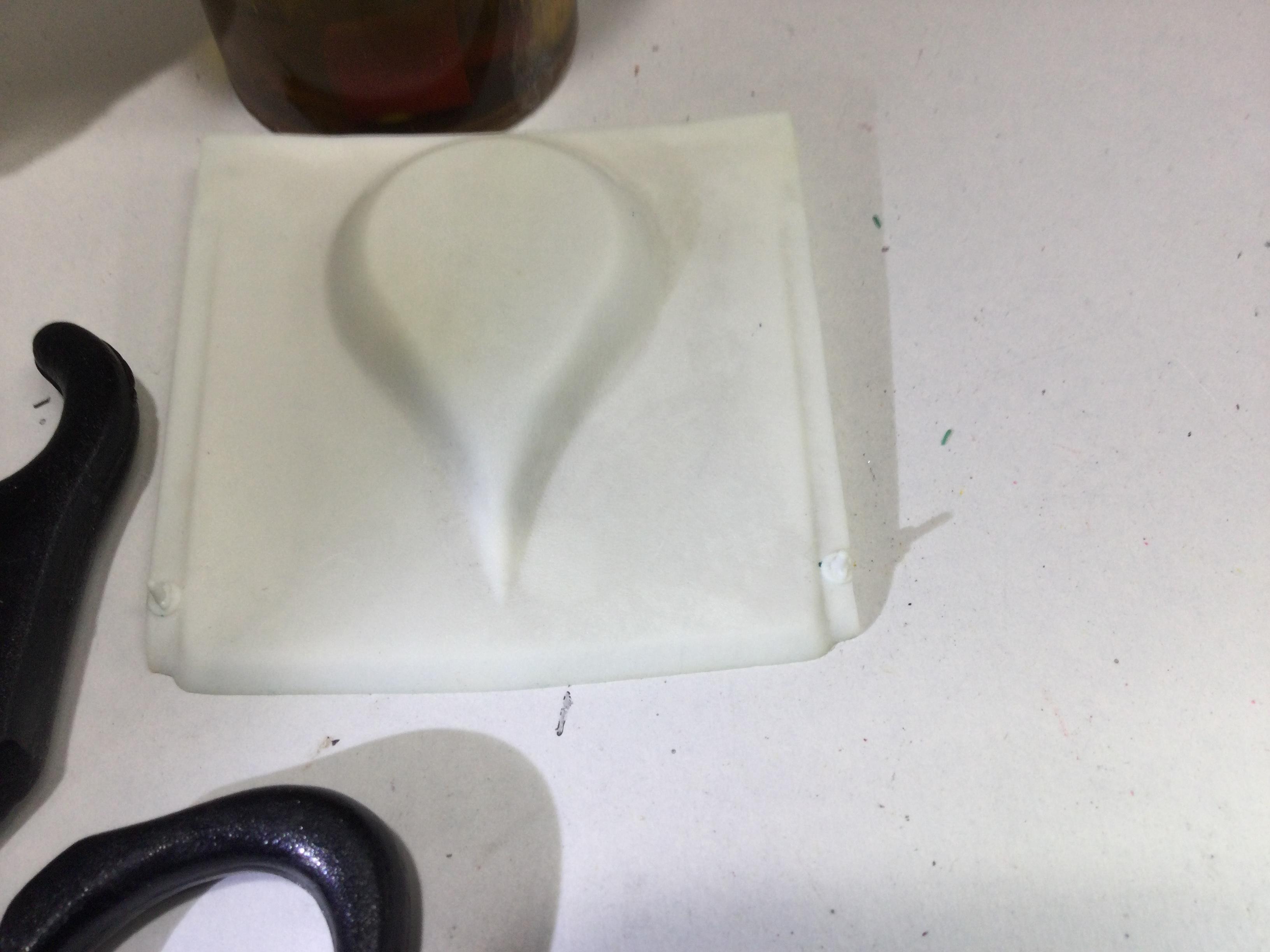

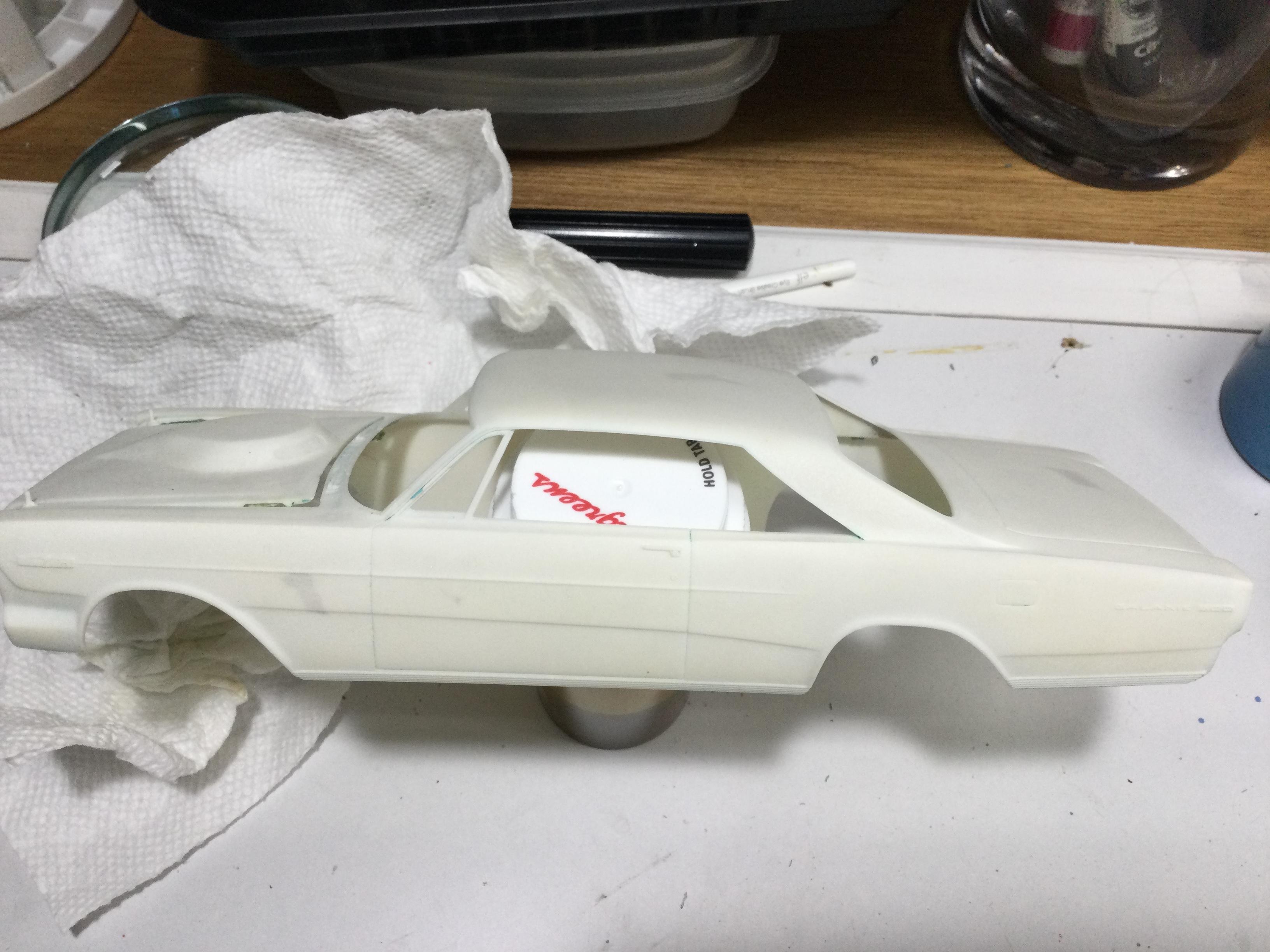

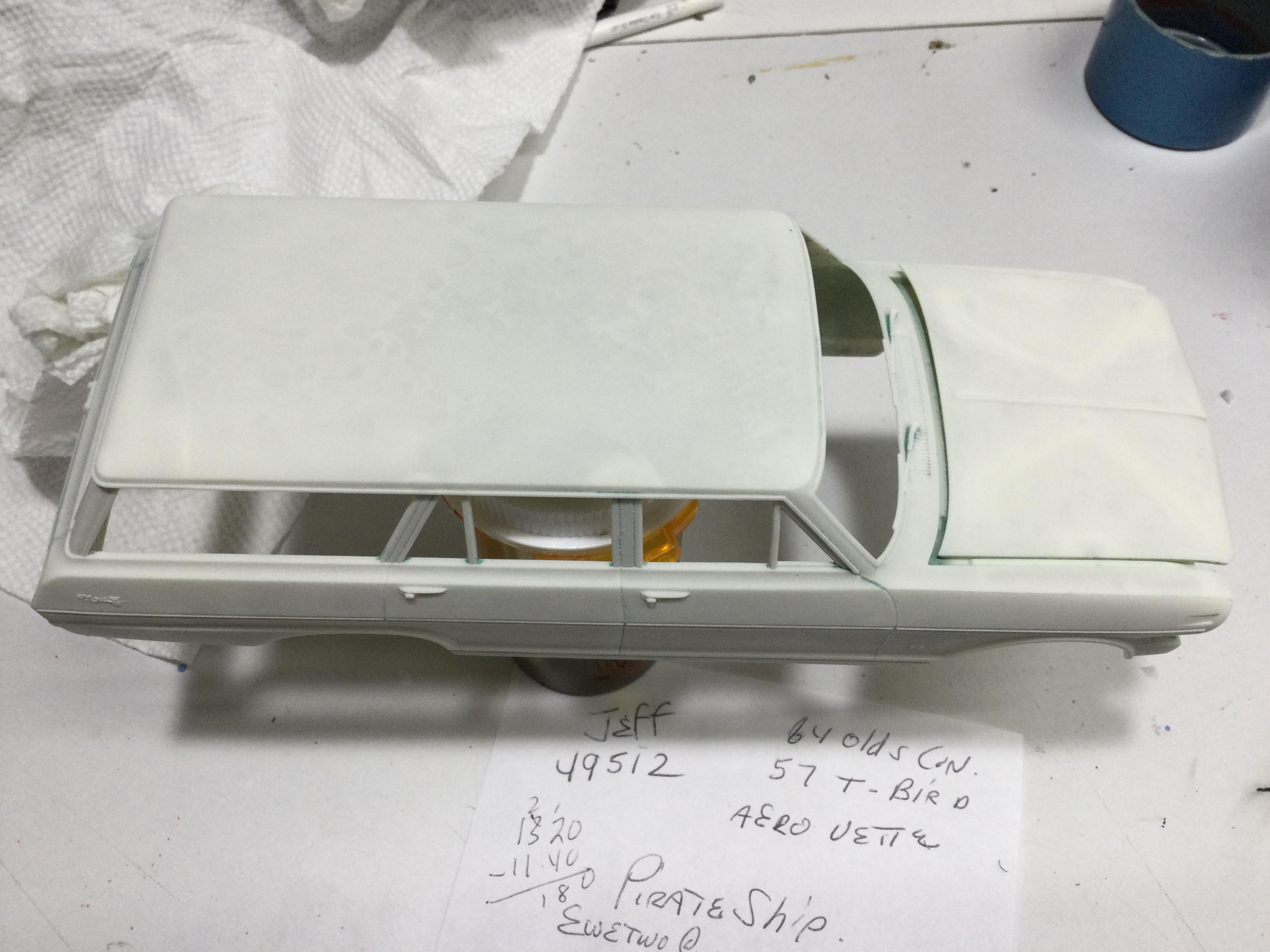

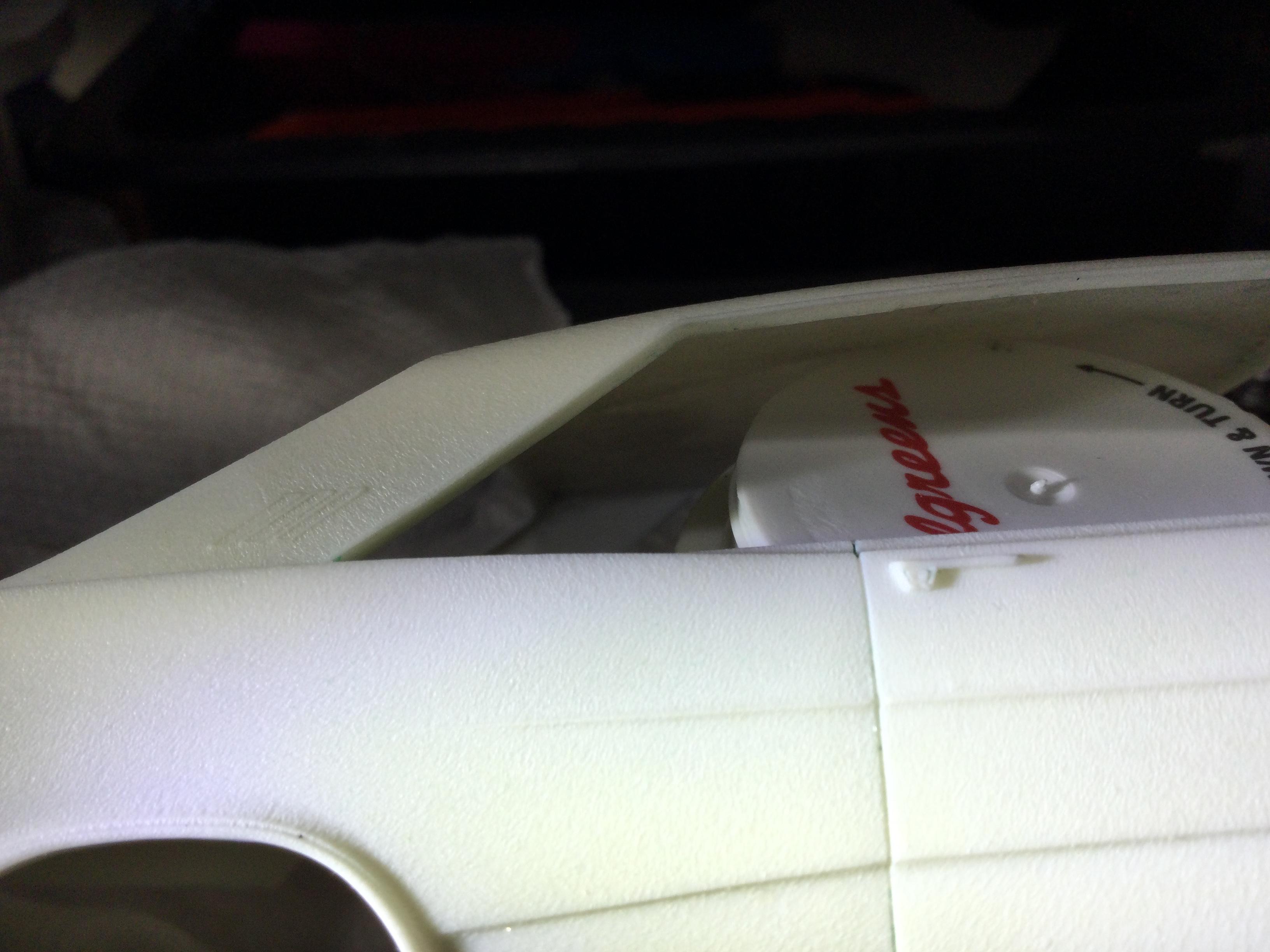

ewetwo Posted March 12, 2024 Author Posted March 12, 2024 Craig Cermak. Here are some photos for the Ford and Nova. Some from a distance and then really close to the plastic. Question. Since I’ve used Dupli-color primer In the short can with the dark gray cap exclusively. Did they change it? Is there something I need read on the can to know if it’s fit for lacquer? The Mustang in the photos was done at the same time as the Ford and Nova. Model Master paint on the Ford and special ordered cans of paint from the auto parts store special made to code colors on the Mustang and Nova. Have used both of those with no problem until now. The Mustang paint looks great. The Nova painted twice looked horrible. Different color I know but both ordered and bought at the same time.
Bainford Posted March 12, 2024 Posted March 12, 2024 (edited) That's some hard crazing. The plastic has been attacked by a hot solvent. That one car was not effected may have more to do with the plastic rather than the paint. Models from different manufacturers, different eras, or even different batches can have variations in the composition of their plastic. One kit may have the potential to resist the solvent, so may not be able to rule out the primer so quickly. Is anything else common to all three paint jobs? What about the paint thinner? If it's common to at least the crazed paint jobs, it could be a culprit too. Just spitballing Edited March 12, 2024 by Bainford 1
