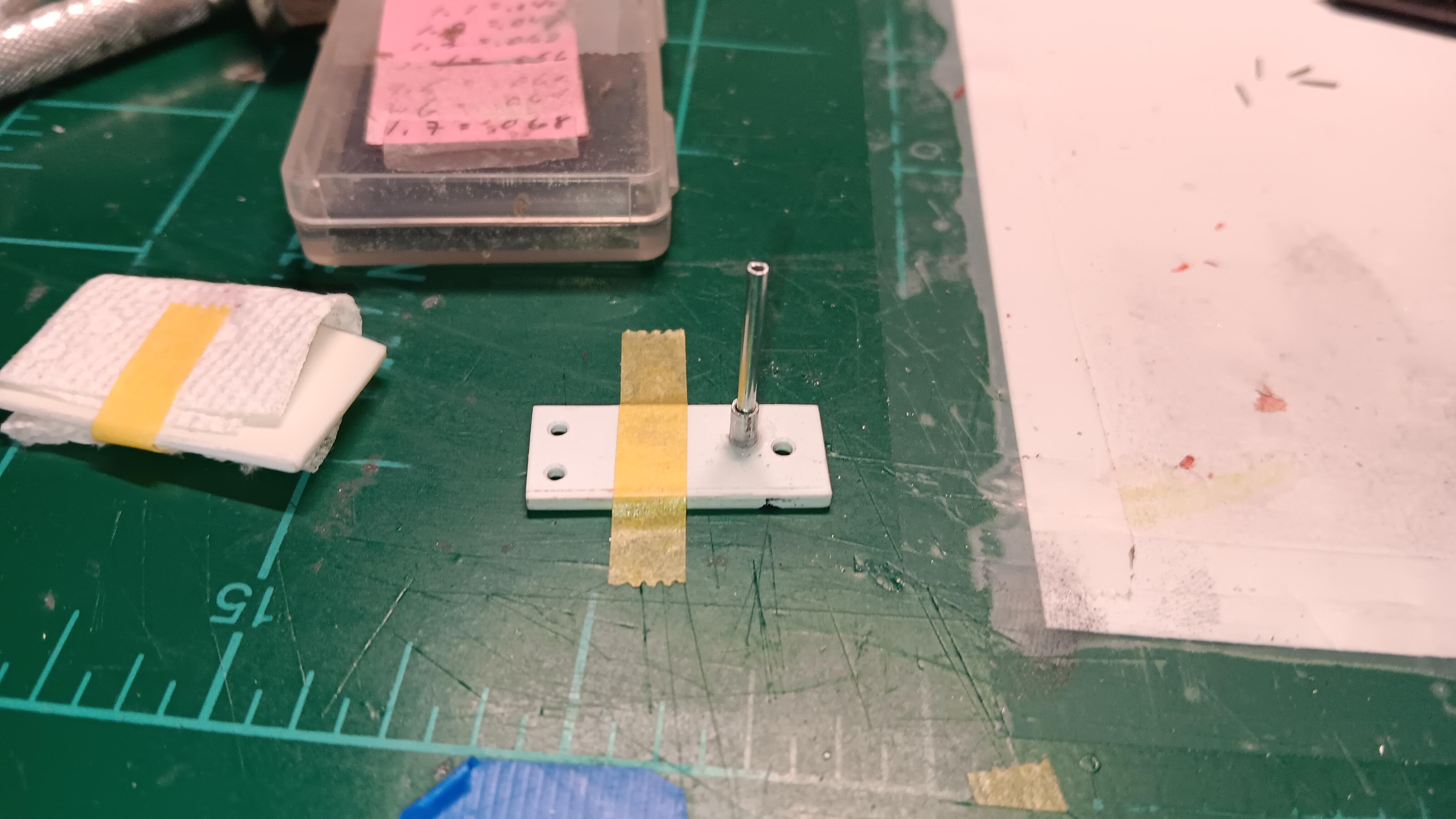

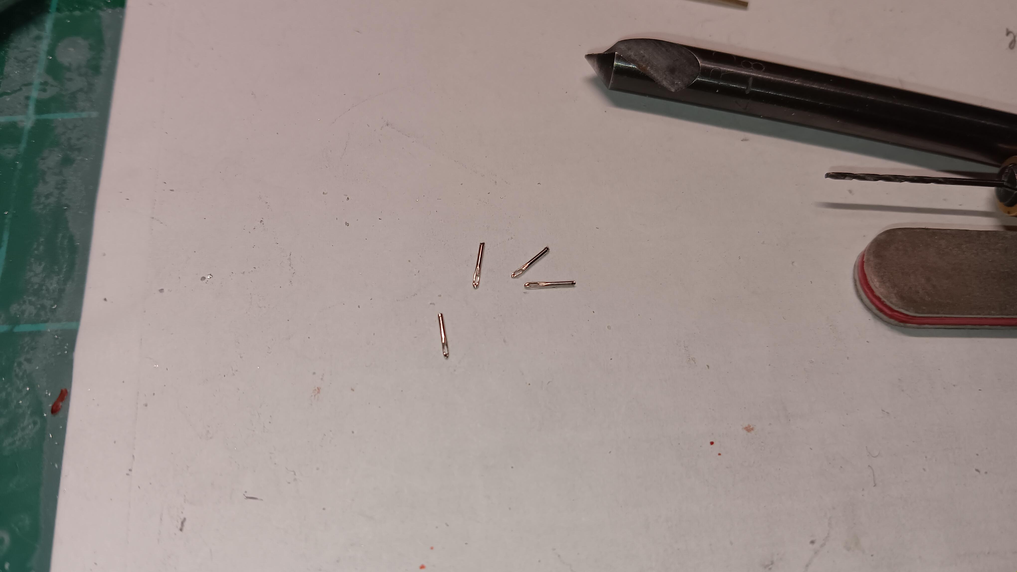

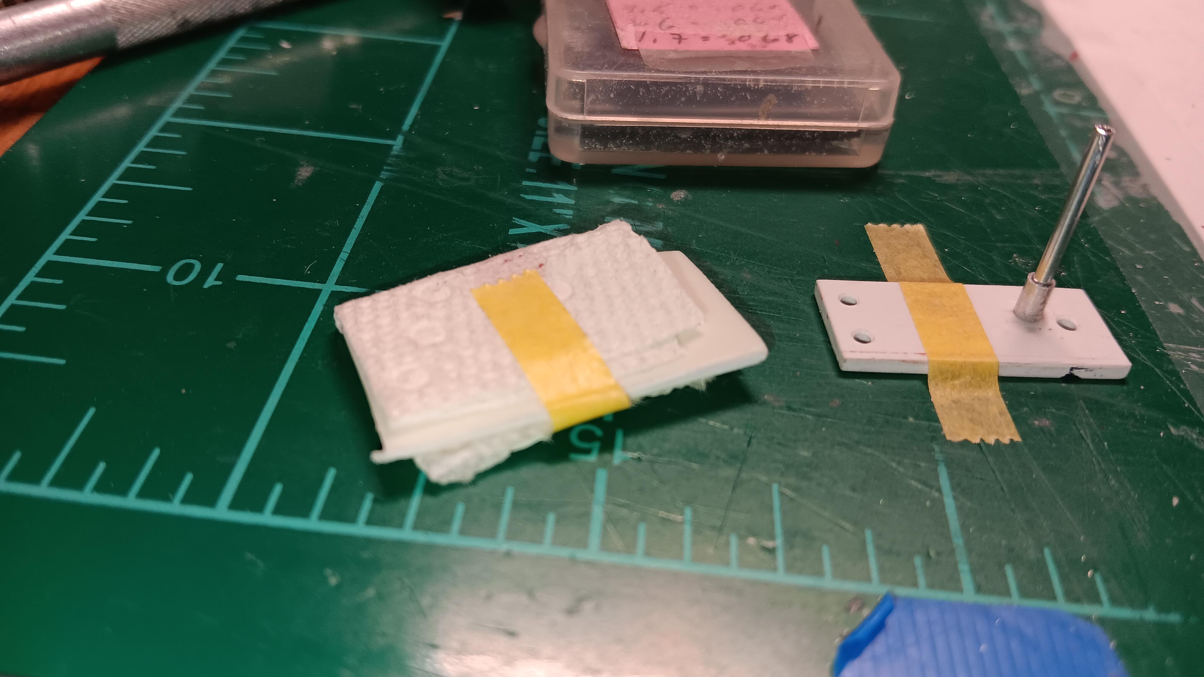

bobss396 Posted March 21, 2024 Posted March 21, 2024 In hindsight I could have used .020" brass wire, but these look more realistic. Sewing needles are hard and sharp, plus they are dangerous to handle. So I made up a little fixture from scrap plastic and .062" and .093" aluminum tubing. This allowed me to capture the sharp end. BUT.. the eye end will shoot out once cut. I tried a folded up paper towel.. no good, right into my finger. Then I sandwiched a piece of scrap plastic between the folds. It worked and they are all the same desired lengthm
NOBLNG Posted March 22, 2024 Posted March 22, 2024 Yeah you don’t want those flying off into the carpet!? You could make a loop of sewing thread through them to keep them from disappearing. 2
bobss396 Posted March 23, 2024 Author Posted March 23, 2024 I made up some flags of masking tape on the last of the batch. I have also taped the sharp ends to cardboard to make disposal safer. 1
