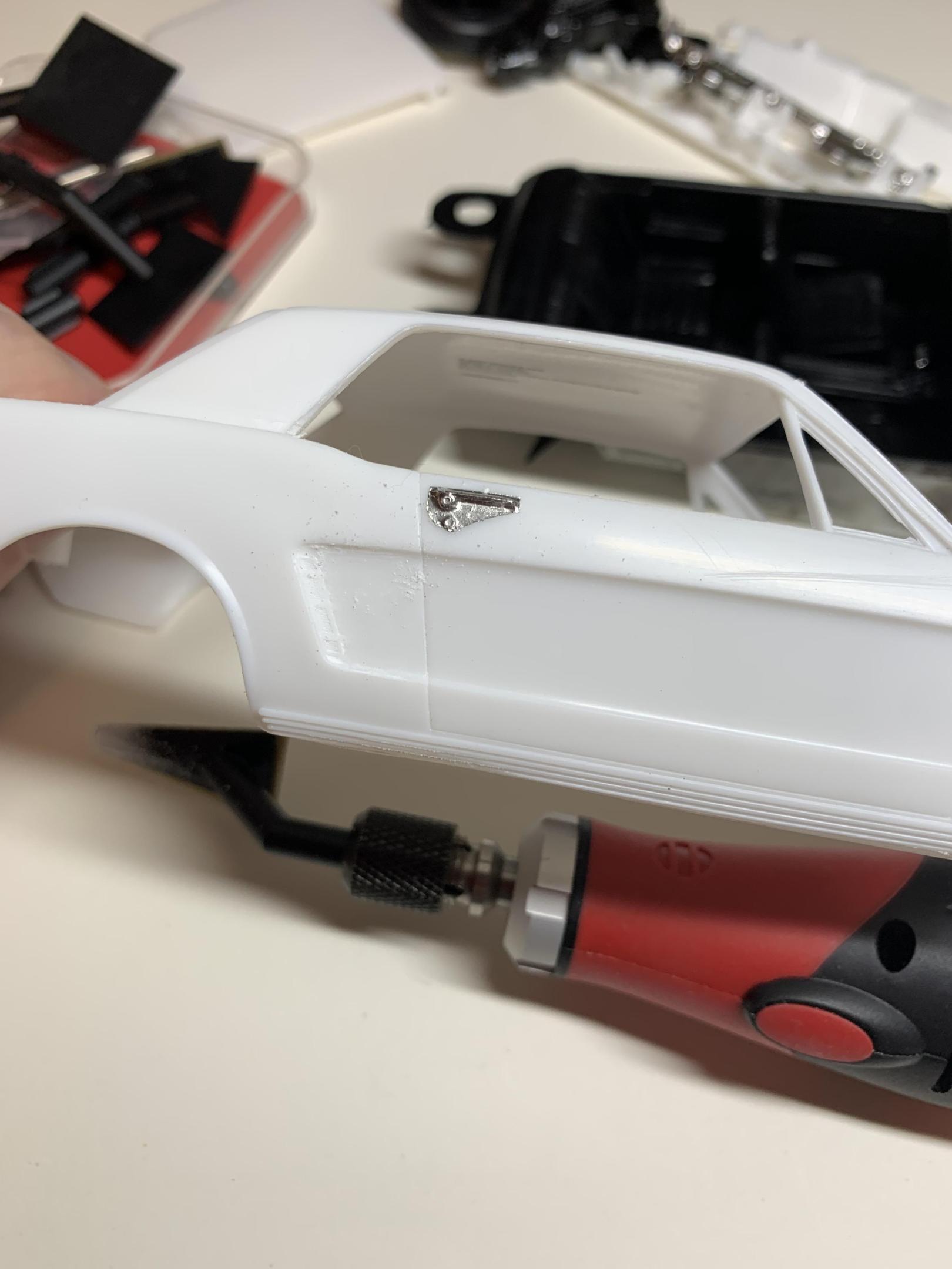

R. Thorne Posted March 28, 2024 Posted March 28, 2024 Just a couple of pics that might help and one of the things on the side of the car that I have removed. Of course, Ace is correct about the generator. 3

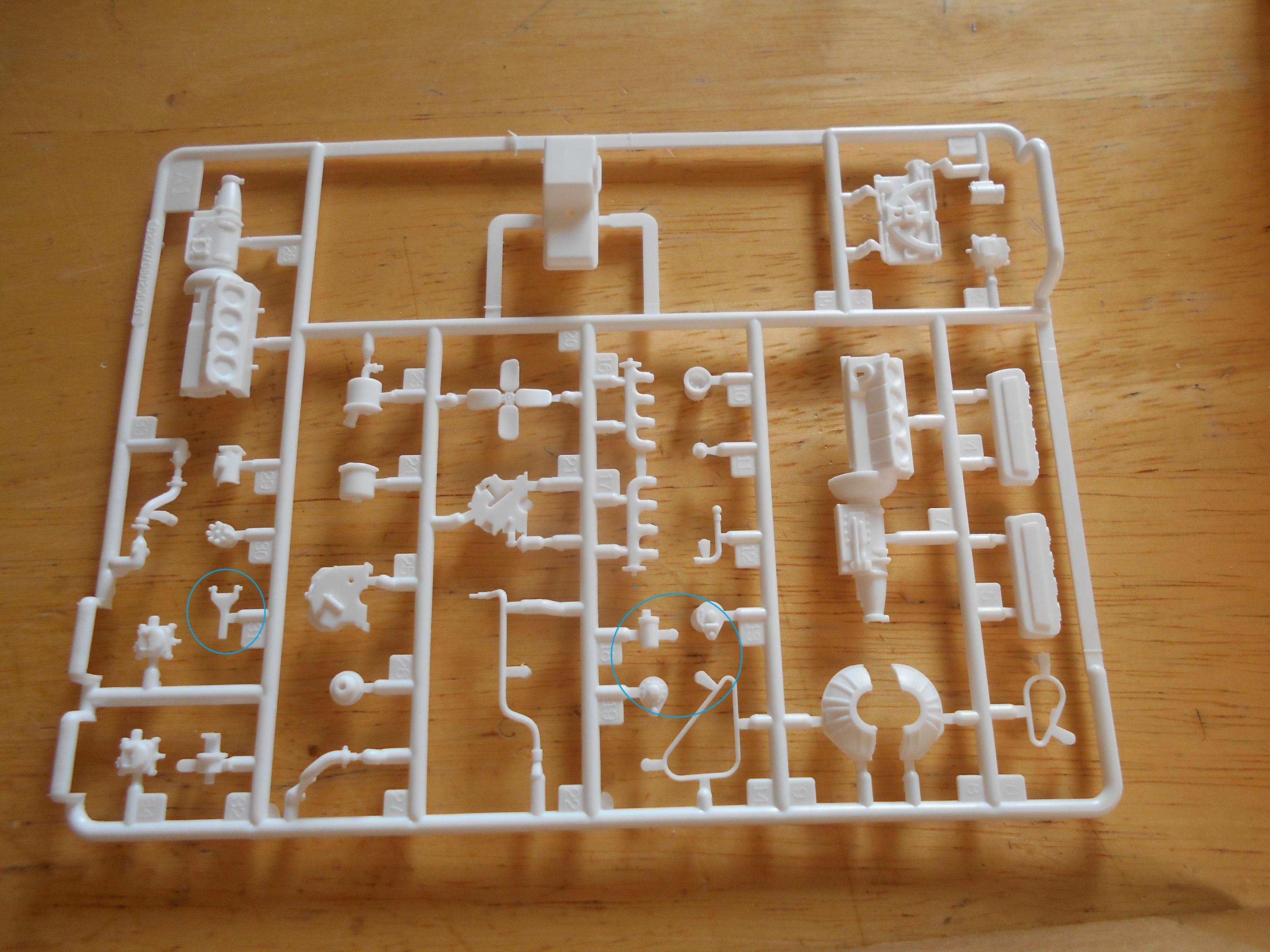

RancheroSteve Posted April 3, 2024 Posted April 3, 2024 On 4/1/2024 at 5:19 PM, mk11 said: Here's the trumpeter falcon parts... The generator parts are circled. The generator and bracket are some of the few accurate parts in that kit, IMHO.
