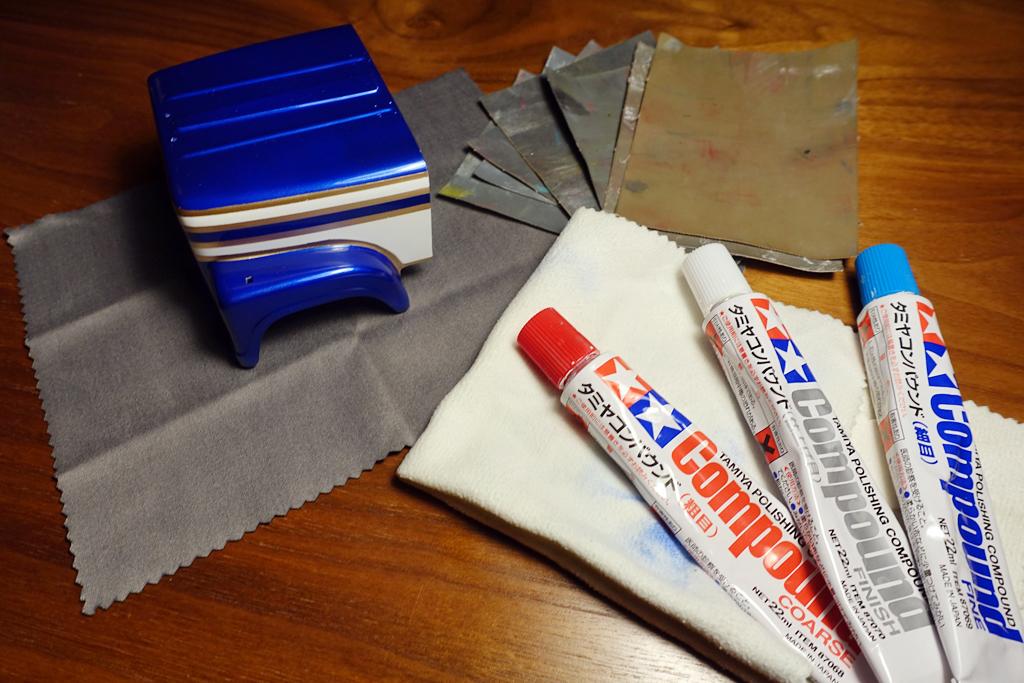

I strongly believe that if you can sand faster and better, you can finish your build quicker with higher quality. :)
I am sure you guys have your favorite tools for sanding, I thought I should share some of the sanding and polishing tools I use here.
A. I have a set of mini files and I use them on metal parts such as aluminum pipes and metal panels.  Nothing special, but they are produced in a smaller scale for our hobby.
B. This is something I recently started to use.  They are called nano glass files and they are made out of glass!  I mainly use these to clean and smooth out the parts right after they were cut from plastic part trees.  The big advantage is that they don't seem to wear out and can be washed with water!
C. This is sand paper with an adhesive backing. I have a foam block where I attach these to sand things extensively.  They do wear out fast, but I can swap them out quickly and continue with sanding work.  Economical, but they wear out quick.
D. I use these these the most, they are shaped like long sticks so I can sand things easily using a longer hand stroke.  It has useful hard straight edges.   I can also sand things by following part lines/edges.  Very useful and they come in various grit ranges.  Most of the time, I use 400#, 600#, and 800# the most.
E. They are sanding sponges and I use these to sand round shapes or contoured surfaces.  Very useful to prep body surfaces prior to painting session.  I find Tamiya sanding sponges last longer, but they tend to be somewhat pricey.
1. These are micro polishing pads and I use these extensively for polishing out painted surfaces.  They used to be "better" in quality 10+ years ago though.  The ones I get online nowadays do not seem to last long.  But I rely on them heavily for bringing out shine.  I start out with 3200# and go all the way to 12000#.
2.  These are my new favorite for polishing, but quite pricey.  They are from a company called "GodHandtool" from Japan.  They last longer and have thicker foam so you can press harder when polishing surfaces.
3. These are called micro polishing cloth and I use these to polish tight spots.  I fold these to reach tight areas.  Very valuable.

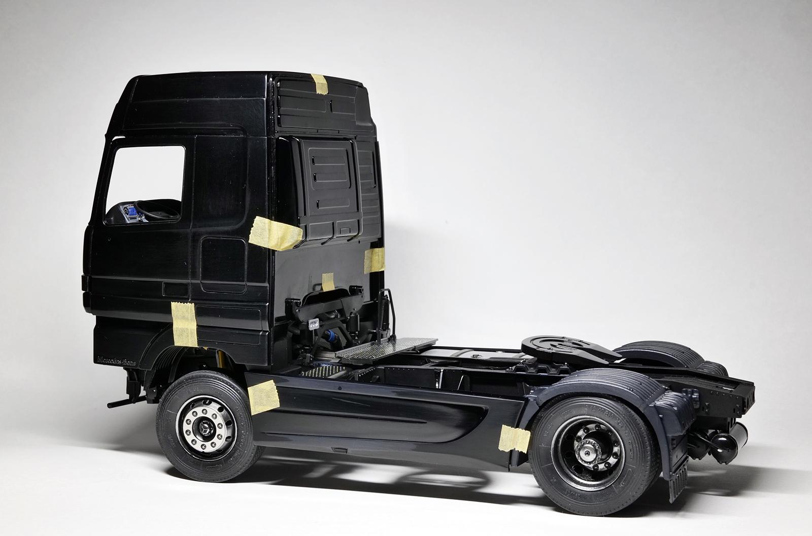

Still need to fine tune and repaint some parts to my linking, but the chassis is shaped up now.
All four corners are still touching and the frame is leveled.  The truck stand is parallel too.
I will focus on painting the cab and exterior parts next.

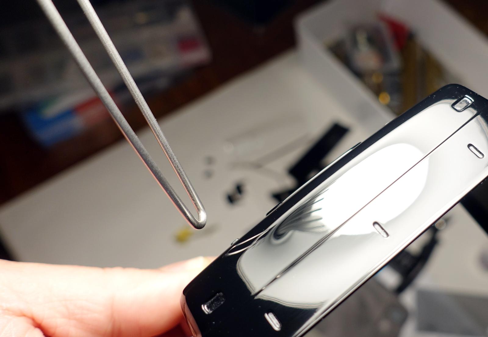

I think I am ready to tackle the polishing work of the main cab.  Thankfully, the paint has minimal orange peel and it is quite reflective already.  I think I made the right decision to spray things in multiple sessions without applying any heavy coat.
This is the close up photo of the painted surface.  I have not done any polishing at this point.
Now I will further even out the surface by using high grit polishing pads (8000# - 12000#).
These three polishing compound tubes work quite well to bring out decent shine.  I have used automotive polishing compounds as well, but they tend to be more aggressive on our kits.
There is some learning curve to use these properly, but the end result is something quite satisfying.  Patience is needed too and it is all about carefully repeating the work little by little.
I would skip the polishing steps when weathering is being done to the vehicle, but I tend to find the polishing effort very rewarding and enjoy working at it.   And this is probably why most of my trucks are built clean. :)
My first polishing effort done and the deep black shine is starting to come out.
Unfortunately, it has its downside having this black painted truck- I am leaving all kinds of fingerprints and every time I handle the cab, it is leaving fine scratches!
This is something I didn't expect to happen at this stage as I still have many assembling steps to complete.
Try using medical gloves. I always have used them for painting and discovered that they were especially useful when handling higloss parts.
No fingerprints at all. But be sure to use a tight fitting size!

That is a great idea, Jürgen.  I was just going to apply some kind of swirl remover at the end.
I will need to start wearing latex gloves when handling the parts.

6 hours ago, youngtiger1 said:
Are you polishing with those Tamiya compounds between each layer of paint?
Most of the times, I would just try to correct obvious paint defects (mostly removing dirt/dust) only using polishing pads (4000#, 6000#, and 8000#) after I apply a coat of paint.
I did not use the polishing compound between coats for this build, usually I use them on the final coat (in this case, my clear coat).
But I think there is no rule stating that you cannot use between the coats though.
The compounds do leave white residue, so careful cleaning is always necessary prior to applying next coat of paint (warm soapy water cleans them quick).

Thank you for answering my questions above. What brand polishing pad are you using? I have to still add these to my modeling tools and there are many to choose from. Again, TIA.
  • Thanks 1
Hey Mike,
I think the “Micro Mesh” is the actual name of the company.  But it is somewhat pricy.  I bought mine from Micro Mark.
If you Google search, I think many online places should carry.
Many places offer similar polishing pads though, I think even a local Hobby Lobby store should have their own.
I found this one (the grits do go up to 12000 which is ideal):
https://www.hobbylobby.com/Crafts-Hobbies/Model-Kits/Paint-Brushes/Micro-Finishing-Cloth-Abrasive-Pads/p/108354?gad_source=1
The concept is similar to polishing an actual car paint, it just that we need to work at it on a smaller scale model.  :)

I am trying to wrap up the build, but still many small items are left for me to address.
The building experience has been nothing but pleasure.  I think the kit itself is challenging and the building procedures are quite rewarding.
I will try to challenge building one of the trailers next time.
I only wear these when I am painting, but I had to wear these while assembling the truck to keep the painted surface clean.
To be honest, I don't think I want to build another black painted vehicle again.
It requires so much TLC during the build process, it is slowing everything down for sure.

I tried to assemble the cab with cabin in it, but there is an odd problem.  The cabin isn't sitting correctly and one side is slight higher.
I will grind off the "top" side of the cabin.  I had a similar issue with Italeri's MP4 as well, so go figure...
I decided to go dark black and reworked on the sunshade/aero part.   I think it actually turned out okay after adding minor detais and silver accent stripe on the top.
