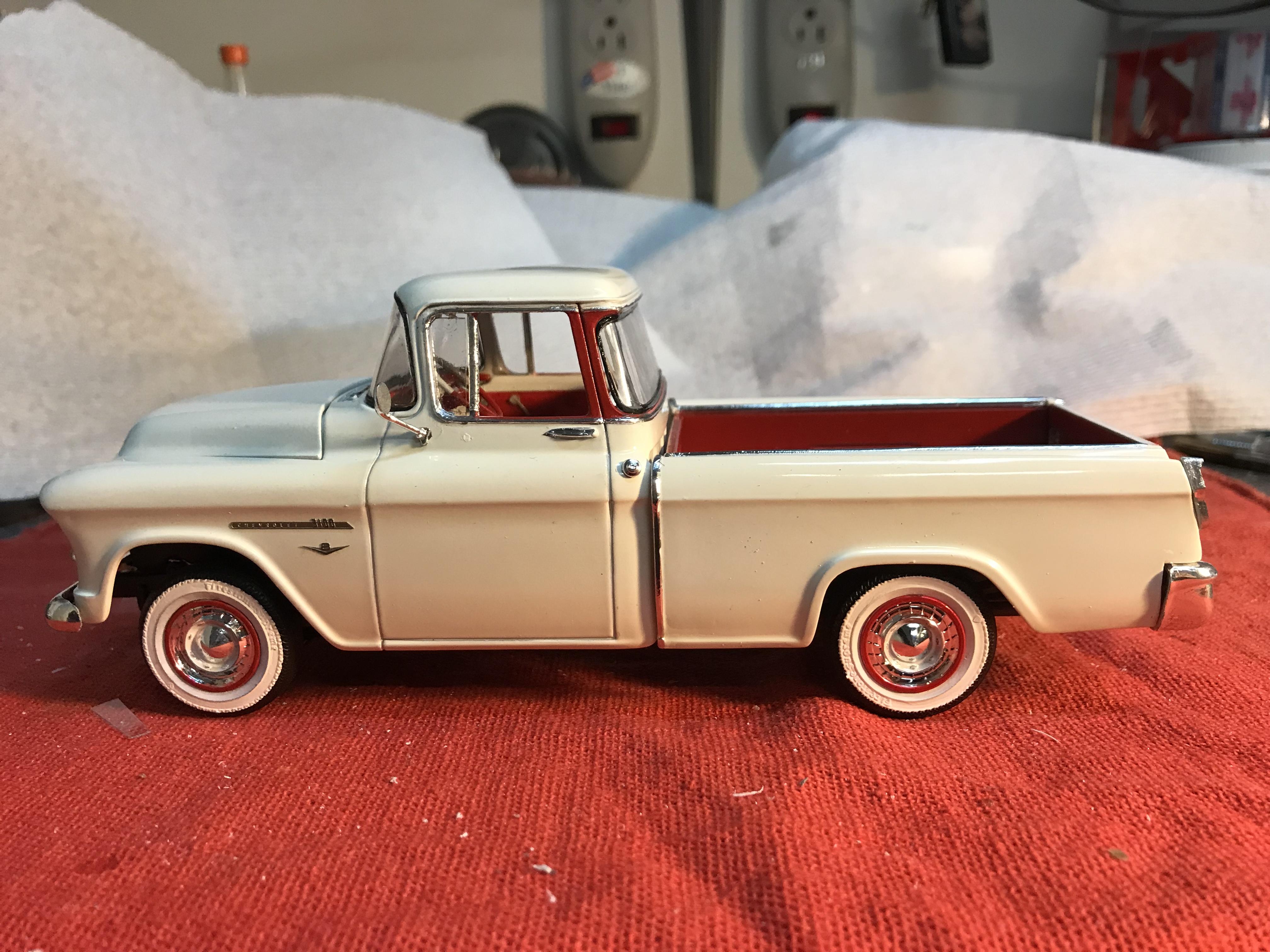

Jonathan Posted April 2, 2024 Posted April 2, 2024 (edited) Maybe this has been answered before, but if so, I can't find it. I've become fond of Tamiya spray lacquers, so I'm hoping I can stick with that. I was gifted an AMT 1957 Cameo some years ago and started working on it recently. I'd like to build it in Bombay White Ivory, which to my eye doesn't look like "pure white" at all (comparing this picture - note the body paint as compared to the whitewalls). Is Tamiya TS-7 "Racing White" too yellow? Other options? I recognize that colors on the screen can be much more subjective than in person, but was hoping someone had already been down this path and could share their experiences. Edited April 2, 2024 by Jonathan
64SS350 Posted April 2, 2024 Posted April 2, 2024 (edited) You are calling it...Bombay White, but the chart states Bombay Ivory, which in turn is definitely an Ivory. The truck pictured looks white to me, but if you want the Ivory, the Tamiya....looks close...but unknown until sprayed. Primer choice will effect the final color as well. Do some testing, it's always a reference for later use if not exactly what you want. Edited April 2, 2024 by 64SS350
gman Posted April 2, 2024 Posted April 2, 2024 Tamiya Racing White is closer to what you see in this example. If you have an airbrush and want to experiment, you can buy the bottled LP series Tamiya Lacquers (White, Racing White) and mix them together to tone down the brightness of the white and incorporate some of the ivory shades for a final colour more in between the two. Vintage reference paint chips can change colour over time, and lighting/camera will skew the colour of photographed subjects. https://www.tamiyausa.com/shop/tamiya-color-lacquer-10ml/lacquer-lp-2-white/10ml-bottle/ https://www.tamiyausa.com/shop/tamiya-color-lacquer-10ml/lacquer-lp-39-racing-white/10ml-bottle/ 1
espo Posted April 2, 2024 Posted April 2, 2024 Tamiya Racing White sort of looks like Vanella Ice Cream or sort of an off white, don't know if that would give you the color you're after. The TS-26 Pure White looks much like the Chevrolet Commercia Fleet White. 1
Jonathan Posted April 2, 2024 Author Posted April 2, 2024 (edited) 4 hours ago, gman said: Tamiya Racing White is closer to what you see in this example. If you have an airbrush and want to experiment, you can buy the bottled LP series Tamiya Lacquers (White, Racing White) and mix them together to tone down the brightness of the white and incorporate some of the ivory shades for a final colour more in between the two. Vintage reference paint chips can change colour over time, and lighting/camera will skew the colour of photographed subjects. https://www.tamiyausa.com/shop/tamiya-color-lacquer-10ml/lacquer-lp-2-white/10ml-bottle/ https://www.tamiyausa.com/shop/tamiya-color-lacquer-10ml/lacquer-lp-39-racing-white/10ml-bottle/ Comparing the paint to the whitewalls on that first image really makes the paint look more creamy white. That's helpful, I think. (Again, knowing colors on screen may look different than in real life.) I kind of feel like colors probably were not as brilliant then as they can be now. ---- 45 minutes ago, espo said: Tamiya Racing White sort of looks like Vanella Ice Cream or sort of an off white, don't know if that would give you the color you're after. The TS-26 Pure White looks much like the Chevrolet Commercia Fleet White. A while back - I did experiment once with Tamiya Insignia White, followed by one thinish coat of Pure White and ended up with this (seen here on a yet-to-be finished '57 Chevy). It looks a tad gray to me, but I think somewhere between Racing White and whatever this is may be what I'm after. I'd kind of forgotten that I'd started this kit. (good grief!) ---- 9 hours ago, 64SS350 said: You are calling it...Bombay White, but the chart states Bombay Ivory, which in turn is definitely an Ivory. The truck pictured looks white to me, but if you want the Ivory, the Tamiya....looks close...but unknown until sprayed. Primer choice will effect the final color as well. Do some testing, it's always a reference for later use if not exactly what you want. Thanks for pointing out my typo. And you make a good point, testing some spoons or the like for future reference. Edited April 2, 2024 by Jonathan

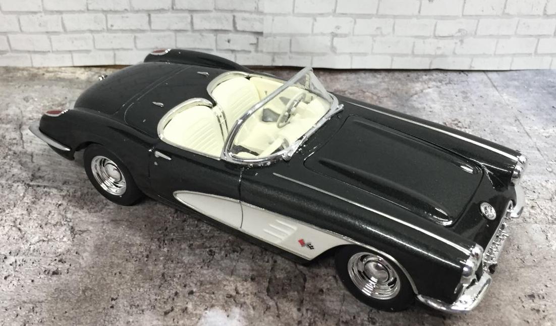

espo Posted April 3, 2024 Posted April 3, 2024 19 hours ago, Jonathan said: Comparing the paint to the whitewalls on that first image really makes the paint look more creamy white. That's helpful, I think. (Again, knowing colors on screen may look different than in real life.) I kind of feel like colors probably were not as brilliant then as they can be now. ---- A while back - I did experiment once with Tamiya Insignia White, followed by one thinish coat of Pure White and ended up with this (seen here on a yet-to-be finished '57 Chevy). It looks a tad gray to me, but I think somewhere between Racing White and whatever this is may be what I'm after. I'd kind of forgotten that I'd started this kit. (good grief!) ---- Thanks for pointing out my typo. And you make a good point, testing some spoons or the like for future reference. Hi Johnathan, I see what you mean about the roof on the '57 Chevy. I'll share a picture of a couple of builds with the color I mentioned to use as a comparison. I have used Tamiya White Primer as a base in both cases.
