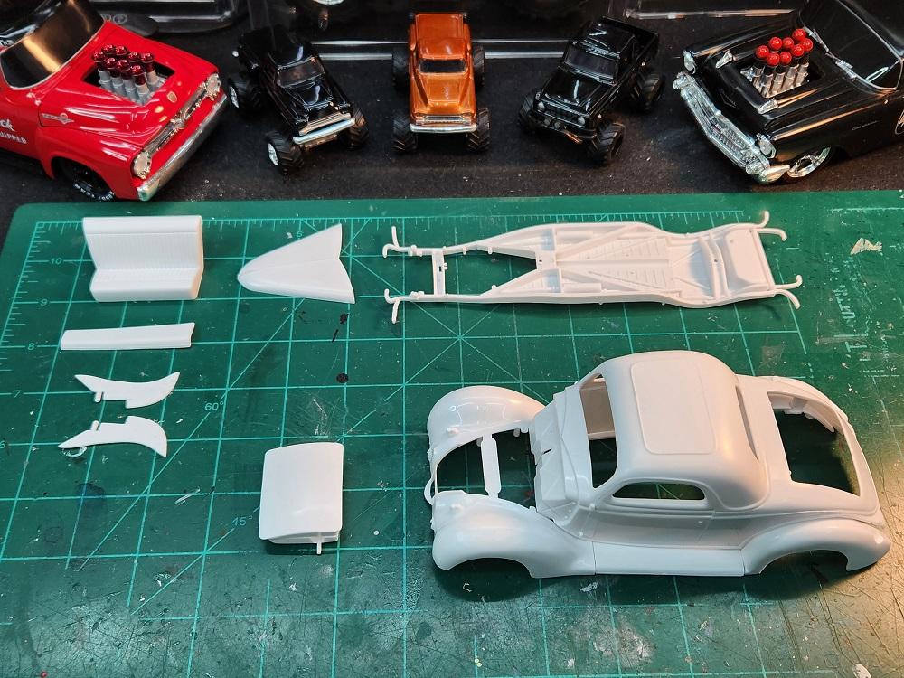

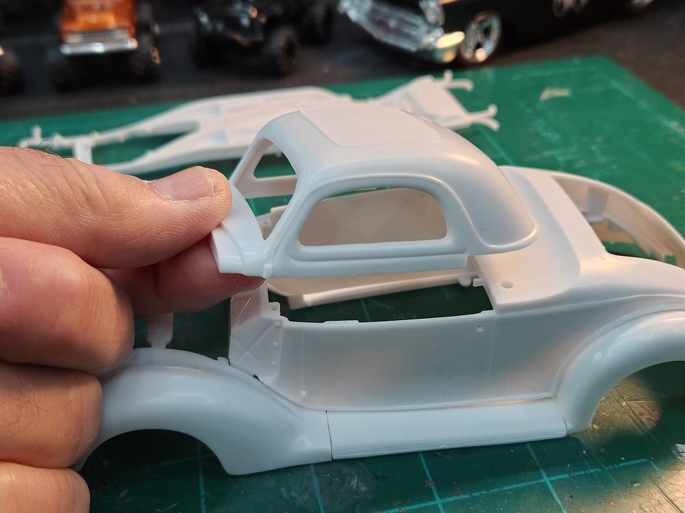

Zippi Posted April 4, 2024 Posted April 4, 2024 The next victim up on the bench is the Revell '36 Ford Coupe. This is a 2'N1 kit but I am opting for the Coupe vs the convertible. I've pulled some of the parts out to clean them up and start my fit issue process and this one is a little on the strange side. Looks like the rumble seat is sandwiched in between the body and fenders so it looks like all parts will have to be painted separately. Already I can see the body to fender fit is going to need some work to get a nice snug fit and the running boards do not fit very well either. I'm not a big fan of the body and top of the car being two piece as they do not fit right. I hate having major issues right out of the gate but let the games begin. 4
stitchdup Posted April 4, 2024 Posted April 4, 2024 if you slightly shorten the two tabs on the body, that mounts the rumble seat, you can get the body to fit better at the rear. there will still be a small gap but the gap will at least be even. you can get the fit even tighter if your not worried about keeping the rumble seat operational

Zippi Posted April 4, 2024 Author Posted April 4, 2024 4 hours ago, stitchdup said: if you slightly shorten the two tabs on the body, that mounts the rumble seat, you can get the body to fit better at the rear. there will still be a small gap but the gap will at least be even. you can get the fit even tighter if your not worried about keeping the rumble seat operational Thanks for the info man. Yeah, haven't taken a real close look at it yet. Just decided on this kit so lots to look at.

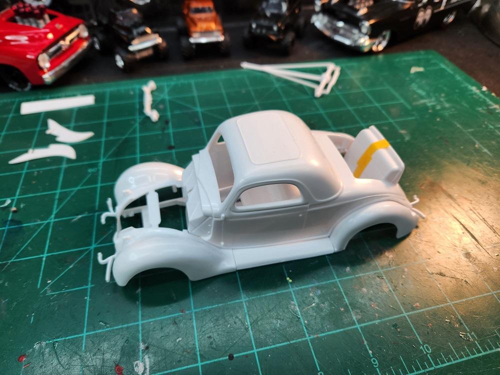

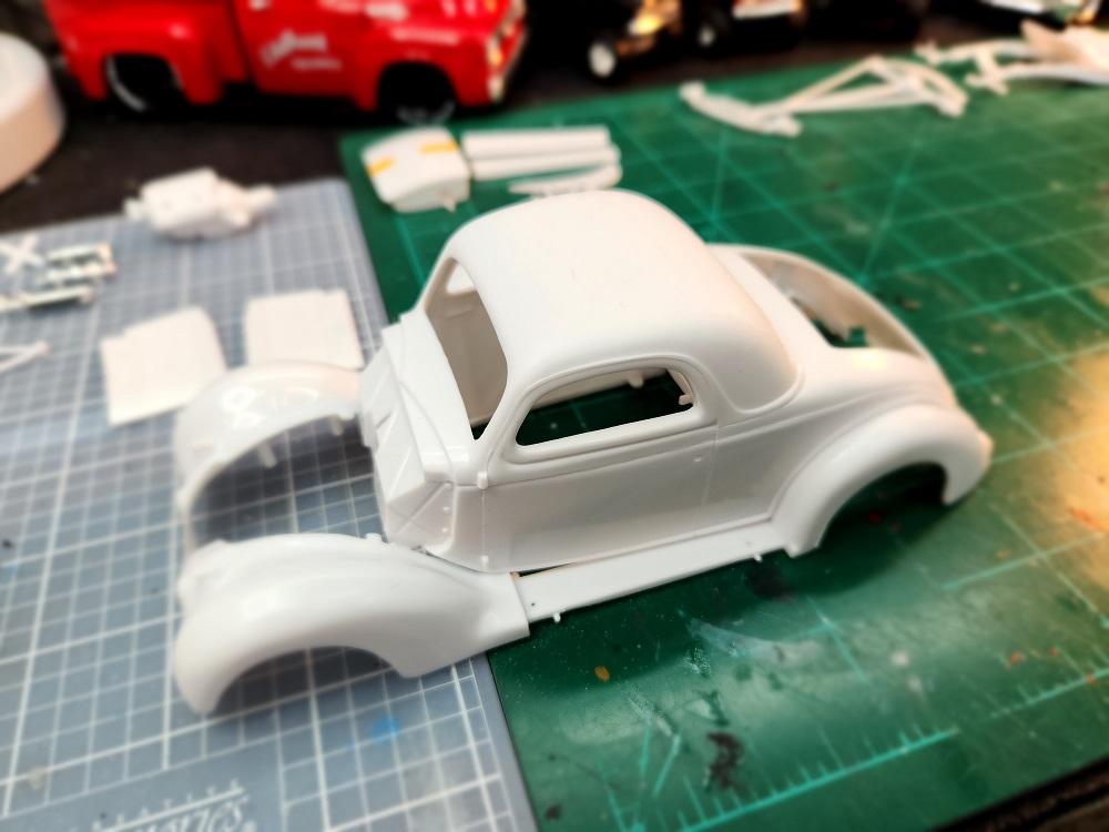

Zippi Posted April 5, 2024 Author Posted April 5, 2024 I've been doing a lot of mock-ups this morning. I think I have the rumble seat working ok and the body to fenders fitting pretty good. 5

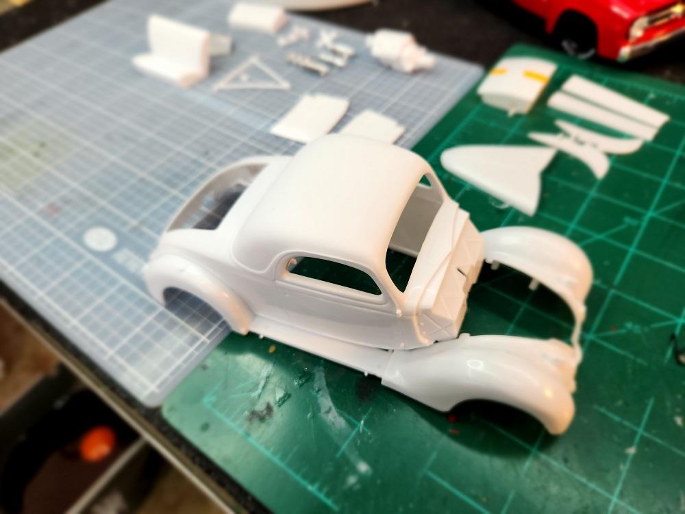

Zippi Posted April 6, 2024 Author Posted April 6, 2024 I glued the top on the body as the trial fitting show that I can still get the back glass in. The joints don't looks to bad and I decided to delete the insert on the top. More of a clean look for a Street rod.
