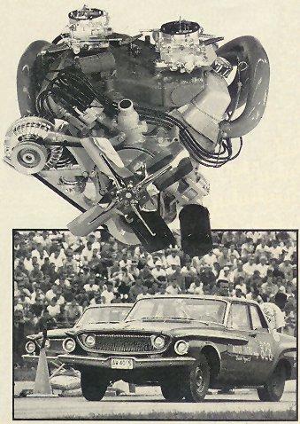

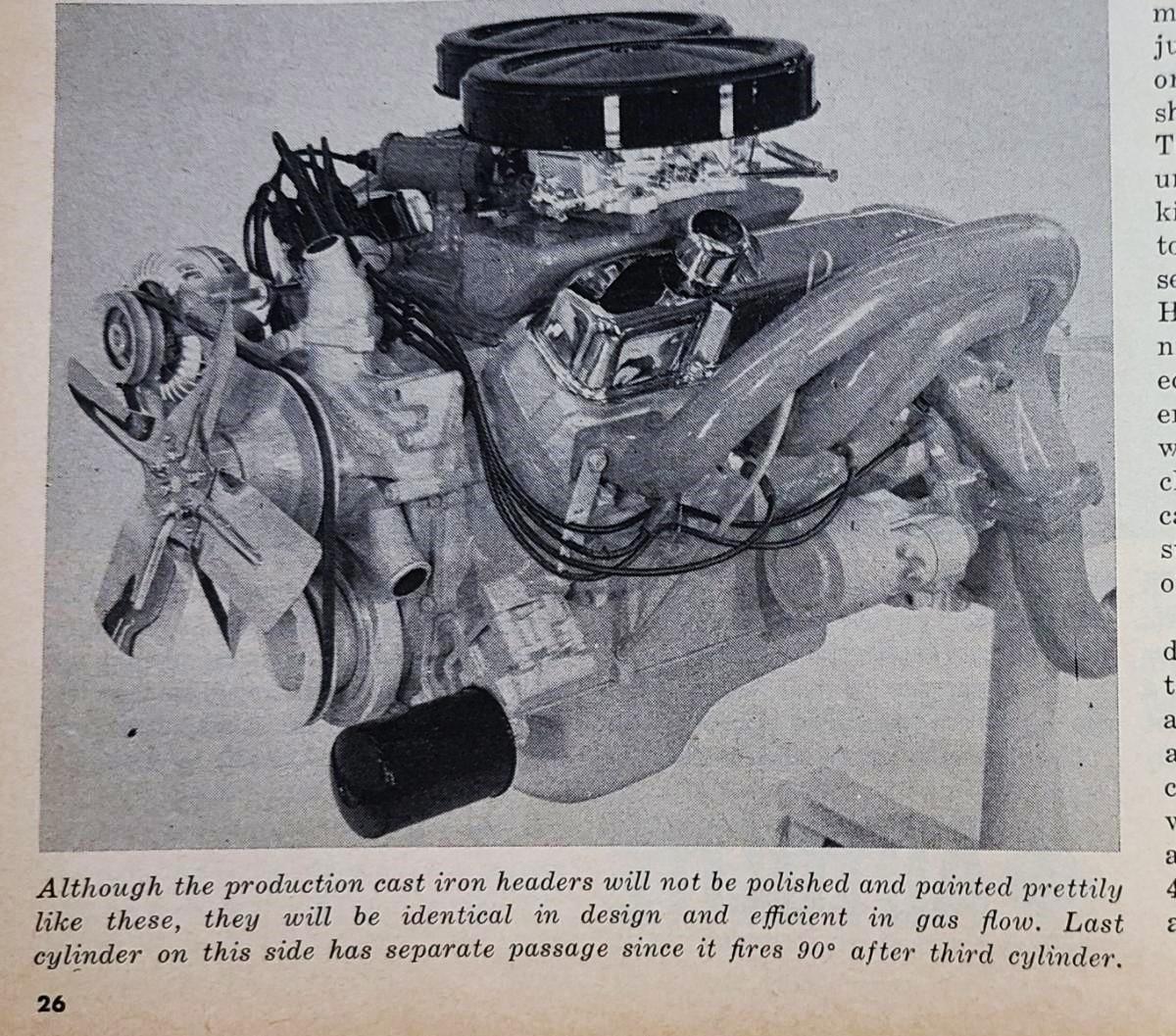

SpeedShift Posted April 17, 2024 Author Posted April 17, 2024 (edited) So a check of my ancient Hot Rod and other 62/63 era magazines turned up some pictures and info on the 413. That's one honking engine in that picture. I have no idea if there is a kit or an aftermarket resin offering of the 413. The 426 of Ramchargers fame is probably more well known. Not sure a Lindberg kit with a 426 might offer a reasonable starting point for the block. The cross-ram induction and headers would need to be crafted. Edited April 17, 2024 by SpeedShift 3

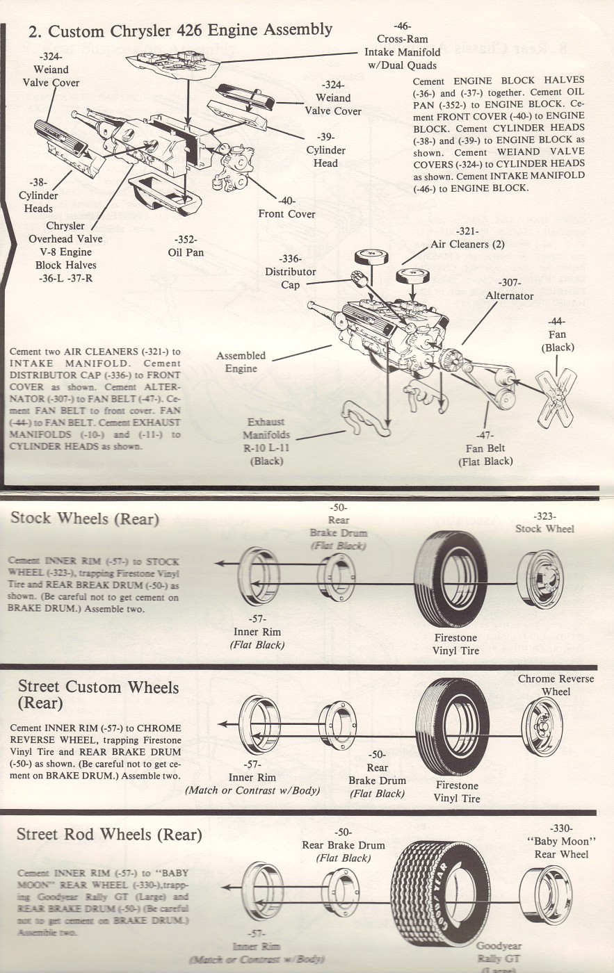

Ace-Garageguy Posted April 17, 2024 Posted April 17, 2024 (edited) 12 minutes ago, SpeedShift said: I'm pretty sure the 413 is a 1963 engine, although there may be dual quad manifolds with Holley 4 bbls in many kits. Looks like Bill confirms the 49 Mercury kit - check the side box panel - right there- thanks guys. '62 was 413. '63 went to 426. At least one set of Merc instructions calls it out as a 426, but the engines would be visually identical in 1/25. Edited April 17, 2024 by Ace-Garageguy 2

Ace-Garageguy Posted April 17, 2024 Posted April 17, 2024 (edited) 8 hours ago, SpeedShift said: Well, nonetheless, the 426 is in the lineage...'62 413, vs the '63 426. I have some history on the 426 as well, enough to sort out the differences if the 426 kit engine can be a starting point for a 413. Internal displacements would not be noticeable in a scale engine, header routing and induction system details between the two might be. The 413 wedge and 426 wedge under discussion here are BOTH "RB" engines, along with the 383(RB) and the 440, and in 1/25 scale you can't tell the difference other than external manifolding, and accessories. Nobody but the most hardcore Mopar guy is going to be able to tell the '49 Merc optional "426-440" with the short cross-ram intake and the cast iron upswept headers from a 413 with the short cross-ram intake and cast iron upswept headers...and even then, it's not likely there would be any visible and reliable tipoffs in 1/25 scale. EDIT: Hardcore Mopar guys, feel free to correct me. NOTE: The 426 Hemi is a different animal. Far as the '49 Merc kit engines go...believe me, the tooling wasn't changed from the kit that says the optional engine is a 426 and the one that says it's a 440. All they did was change what they called it, because they look alike. EDIT 2: This is rather like guys who'll sweat getting "correct" 383-stroker smallblock Chevy engines...when in fact every basic smallblock Chevy engine can pass for every other one in 1/25 scale, other than the one difference in the very early (265) blocks lacking the oil filter mounting. EDIT 3: Here's the Wiki page regarding the 413/426 Max Wedge engines. I most certainly do not believe everything Wikipee says, but this seems right IIRC. https://en.wikipedia.org/wiki/Max_Wedge Edited April 17, 2024 by Ace-Garageguy

SpeedShift Posted April 20, 2024 Author Posted April 20, 2024 (edited) And for anyone that wonders if the fuel injected 63 Vette ever really shutdown the Max Wedge Dodge Dart ..................... Shut Down: Revised Correct Mopar Version of Song (ornocar.com) And the real world evidence: Mopar Action magazine featured a 1962 Dodge besting the Sting Ray in its 1990 issue: Copyright 1990, Harris Publications, Inc. Used with Permssion. All rights reserved. High Performance Mopar magazine featured a Max Wedge again stomping the Corvette: Max Wedge Mania: SHUT EM UP AND SHUT EM DOWN Donnie Chapmans 1962 413 Max Wedge Dart whipped the Sting Rays in straight sets. by Jim Campisano Tom Sloe made everyone a promise. "Im gonna beat that Dodge," said the owner of a damn-quick 1964 fuel-injected Corvette roadster. He made this proclamation after the National Muscle Car Associations event at Milan Dragway in Michigan, where he lost three close races to Donnie Chapmans 1962 Max Wedge Dart. It followed a precedent that was set by Edison, N.J.s Ron Papaleo, whose 1963 fuelie got snuffed by the 413-powered Dart a month earlier in Darlington, S.C. But while Papaleo never came close to beating Chapman, Sloe did. Papaleos split-window coupe was more of a show car, while Sloes 1964 was tuned to the cutting edge. Still, Chapman beat him in five straight races, running a best of 12.64 to Sloes 13.37. Strong for a stock small-block Chevy, but not nearly enough to top Mother Mopar. What brought these warriors together was the NMCAs intention to breathe some life into the Beach Boys song "Shut Down." Everyone knows the story: Corvette meets Dodge, Corvette races Dodge, Corvette beats Dodge. Whoa. Were talking about a 13.5:1 compression ratio engine, dual- quad-fortified machine with a race-prepped TorqueFlite transmission. Does such a stout Corvette exist on this planet? We did a little homework before the first round of the event. In an old issue of _Hot Rod_ Magazine, we found a 1962 Vette that was running 12.63 in HGRA A/Sports. Modifications were limited to engine blueprinting, slicks and headers. In the same issue, we noted that the Super Stock ET record was held by Dick Ladeen of Portland, Ore., at 12.71. We figured we had some kind of horse race on our hands. Sloes machine was fitted with the most powerful incarnation of Chevrolets small-block, the 375-horsepower 327, and a Muncie 4-speed. Though his 1964 is not the showpiece that Papaleos Vette is, its still plenty nice. Chapmans 413 actually started life as a 361-equipped Tennessee state police vehicle. He had all the necessary parts available to make the car a 413 and figured, "Why not?" He built his Dart specifically for the NMCAs Shut Down series. Marshall Jeffers put the Ramcharger V8 together using stock factory goodies. Donnie maintains the only deviations from stock are an .030-inch overbore and a Racer Brown cam. The 727 TorqueFlite was also freshened up by Jeffers, and for good measure he added a TCI converter with a 3000-rpm stall speed. The 8 3/4-inch rear houses 4.30 gears. Body and paint chores were handled by Steve Elkens, who also refurbished the interior. The entire car, an undeniable show-stopper, was completed in two months time. Down in Memphis, home of Elvis Presley, barbecue cooking and mosquitoes with the tenacity of pit bulls, Sloe made good on his promise--sort of. In the first round, neither gentleman ran a particularly good race, but Sloe cut the better light and emerged the winner with a 14.211 at 101.63 to Chapmans 14.193 at 91.05. The Corvettes finally got on the scoreboard. Unfortunately for them, it would be the last time they would do so. In the next round, Donnie ran an unreal 12.27 at 109.38 to Sloes 13.15 at 104.48. "I put in a set of those Japanese spark plugs," said Chapman, explaining how he managed to knock .5 second off his previous low ET. From that point on, it was Dodge all the way, though Sloe did a commendable job driving the plastic Chevy. His last three races netted him ET slips that read 13.36, 12.96 and 13.41. Impressive but hardly up to the task, since Donnies times were 12.41, 12.51 and 12.69. As for Ron Papaleo and his 1963 split-window Vette, he was content to watch the action from the sidelines and take the events Best of Show award. Now the Beach Boys know why there was nobody meaner than the Little Old Lady from Pasadena. Source: Campisano, Jim. , Shut Em Up and Shut Em Down. High Performance Mopar magazine -- March 1991, pp. 14-15. Did you know? That Gary Usher, the writer of 409 by the Beach Boys never owned a 409, but DID own a new 426 Plymouth Hemi Superstock, which he conceded was much faster than a 409 anyway. ? (Source; The Illustrated Discography of Hot Rod Music 1961-1965 by John Blair and Stephen J. McParland, 1990, forward section) High Performance Mopa Edited April 20, 2024 by SpeedShift 1 1
