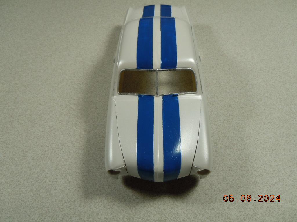

Bill Anderson Posted April 28, 2024 Author Posted April 28, 2024 Well, I got my striping tape and laid out two racing stripes and painted them dark blue. Ending up looking good, but I've got a couple spots where the paint "leaked", which bugs me as I went to extra effort to assure the tape was pressed down to give a nice seal. Anyway, I ordered a bottle of the pearl white and will use that for touch up. IMO, the stripes are the right size and the color is good, but the ol Ford just doesn't meet my expectations with that pearl white paint. I'm sure (?) that when its completed it will look better, but I don't think I'll mess with any version of white in the future. I will show a pic or two, but not until its complete. Thanks for your help!
Bill Anderson Posted May 6, 2024 Author Posted May 6, 2024 Well, it wasn't easy, but I decided to do the racing stripes and finally got it finished to my satisfaction. I did learn a couple of things in the process: - painting a vehicle pearl white (or any white) just doesn't look all that great to me. That really surprised me, and of course its all a matter of taste. - not all model masking tape is created equal. I started out using a black 1/4 inch tape and it leaked, causing me to repaint the white. I found a roll of orange tape (also 1/4 inch wide but just a hair wider than the black tape, and it was perfect with zero leaks. I cannot tell its brand or where I got it from (Hobby Lobby, Micro Mart ?) but it really works. Here is the painted shell, and if you look close you will see a couple places that had to be "fixed", but for my first attempt I'll let that go.

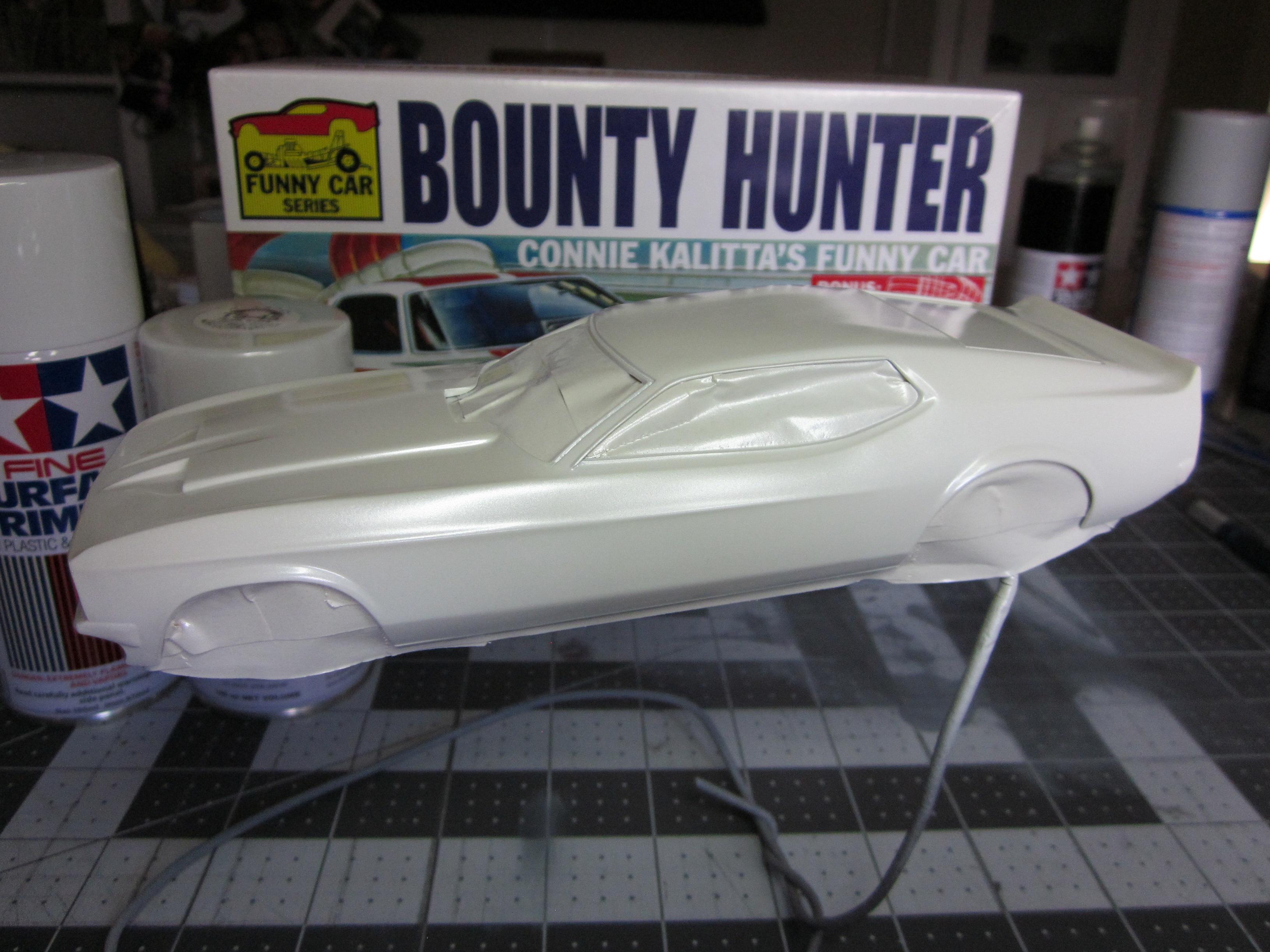

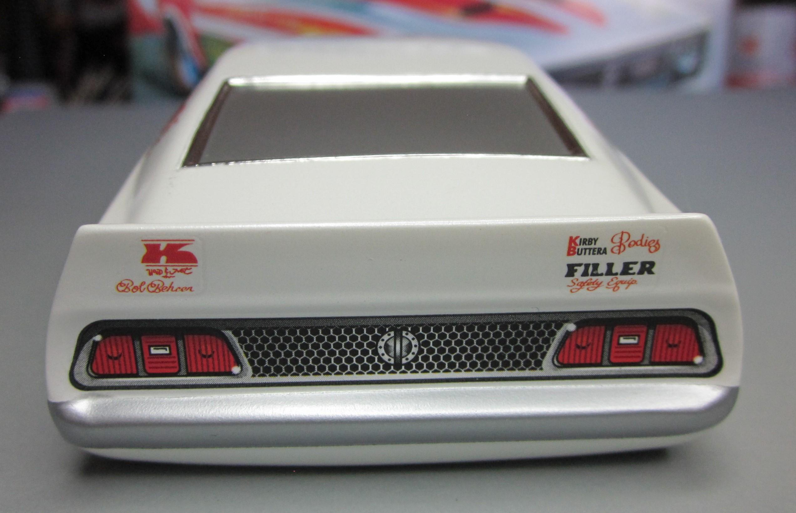

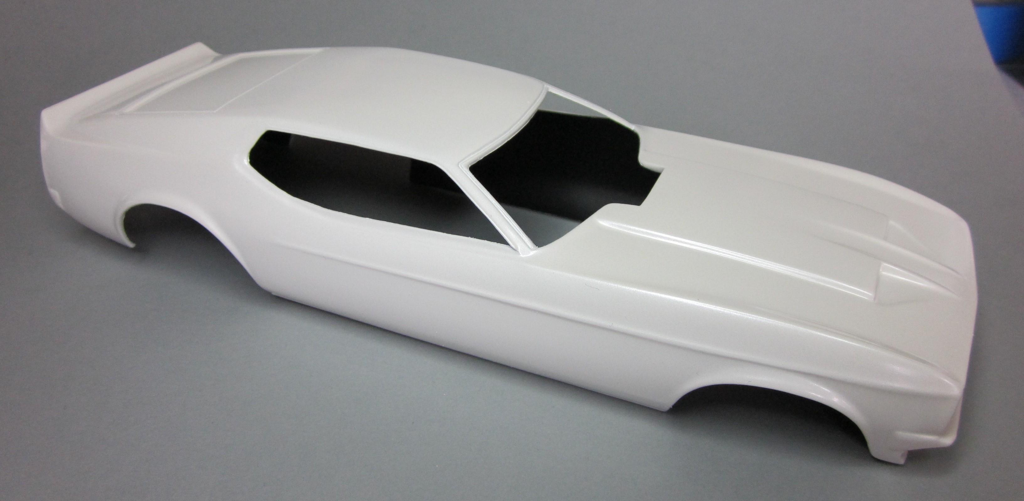

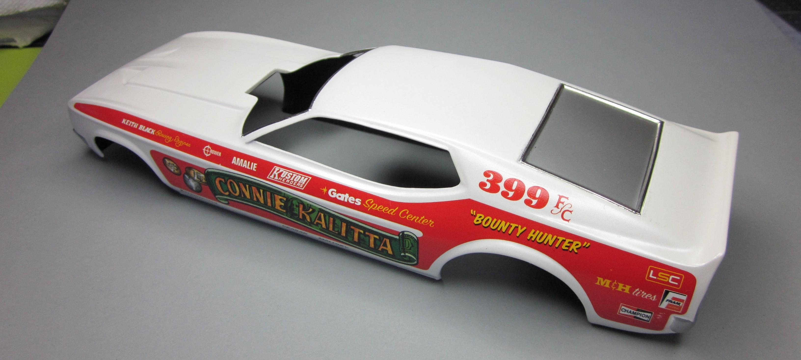

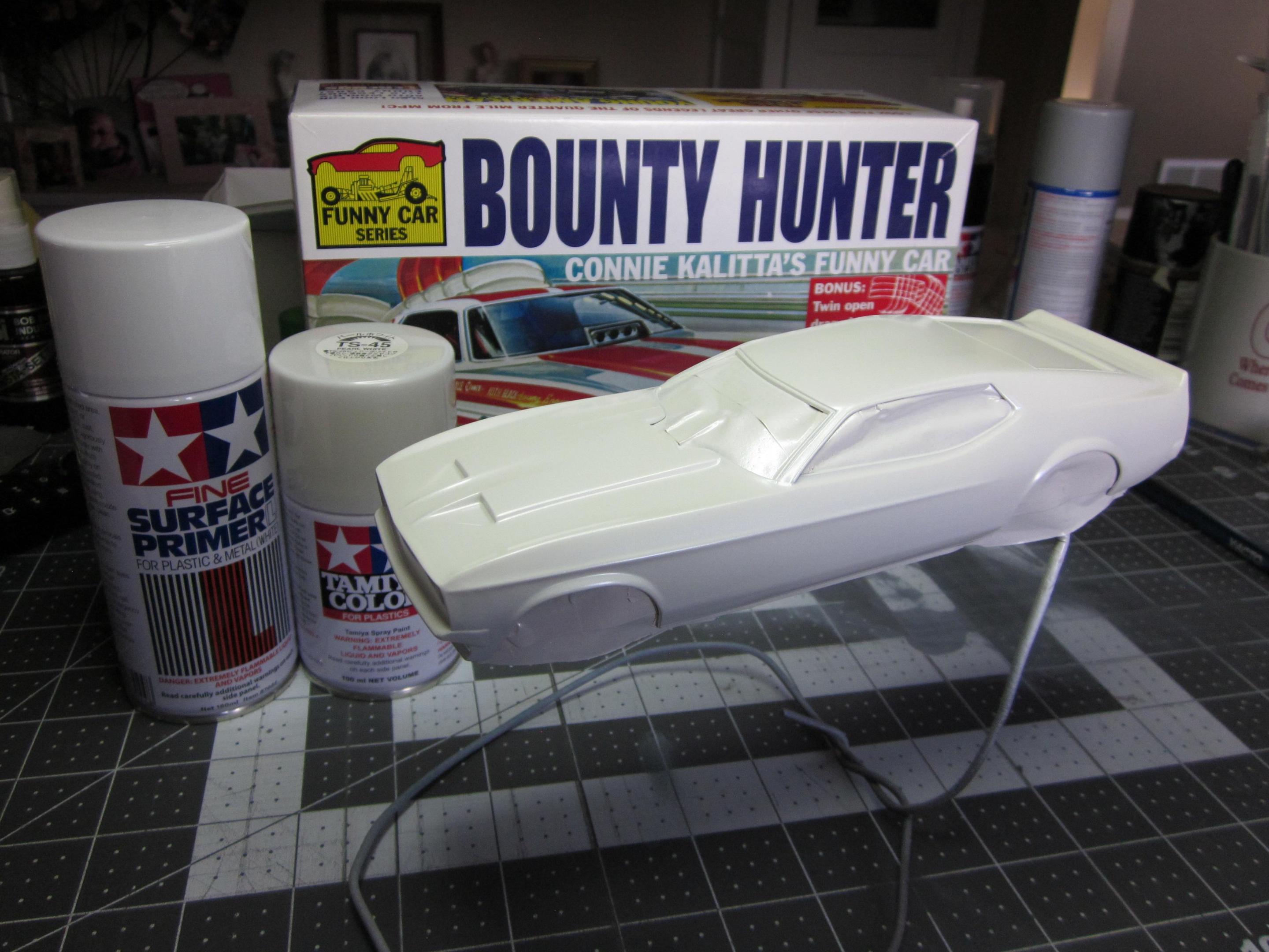

Speedpro Posted May 7, 2024 Posted May 7, 2024 I recently did a test to see if I could paint a body in one hour from start to finish using tamiya paints. The paint I chose to use was TS-45 Pearl White over tamiya white primer. As stated, all painting was done in a 1 hours' time giving 15 min between coats. Body was first cleaned up removing all parting lines and flaws. It was thoroughly washed with joy dishwash soap. First light coat of white primer was laid down Waited 15 min. Sprayed the next coat of primer with a good cover coat. Waited 15 min. Sprayed the first light coat of pearl white. Waited 15 min. Sprayed the second and last coat of pearl white. Let it sit overnight. You can handle it all you want at this point. The results of my test were very pleasing. Here are a couple pics of the outcome of my test. I could have put down the clear coats, but decals were in the future. Next time I will put down the clear and do the hole paint job in 1.5 hrs and see how it turns out. I waited 5 day's and put some decals down. No clear has been applied yet. As you can see, the paint job came out almost just as good as if I spent a week doing it waiting for paints to dry and sanding between coats of primer and color. I don't use spray cans much anymore as airbrushing is now my norm. This was just a test and your results may vary. As a side note, I feel tamiya spray paints are the best paints to use if you are using spray cans. 1
espo Posted May 7, 2024 Posted May 7, 2024 2 hours ago, Speedpro said: I recently did a test to see if I could paint a body in one hour from start to finish using tamiya paints. The paint I chose to use was TS-45 Pearl White over tamiya white primer. As stated, all painting was done in a 1 hours' time giving 15 min between coats. Body was first cleaned up removing all parting lines and flaws. It was thoroughly washed with joy dishwash soap. First light coat of white primer was laid down Waited 15 min. Sprayed the next coat of primer with a good cover coat. Waited 15 min. Sprayed the first light coat of pearl white. Waited 15 min. Sprayed the second and last coat of pearl white. Let it sit overnight. You can handle it all you want at this point. The results of my test were very pleasing. Here are a couple pics of the outcome of my test. I could have put down the clear coats, but decals were in the future. Next time I will put down the clear and do the hole paint job in 1.5 hrs and see how it turns out. I waited 5 day's and put some decals down. No clear has been applied yet. As you can see, the paint job came out almost just as good as if I spent a week doing it waiting for paints to dry and sanding between coats of primer and color. I don't use spray cans much anymore as airbrushing is now my norm. This was just a test and your results may vary. As a side note, I feel tamiya spray paints are the best paints to use if you are using spray cans. Great looking paint finish and like the decals. The time frame of your coats of paint and I'm sure done in light coats, is how it should be done. My biggest problem is the lack of patience and using to much paint with each application. So today I'm color sanding some runs in the paint I did last night.
