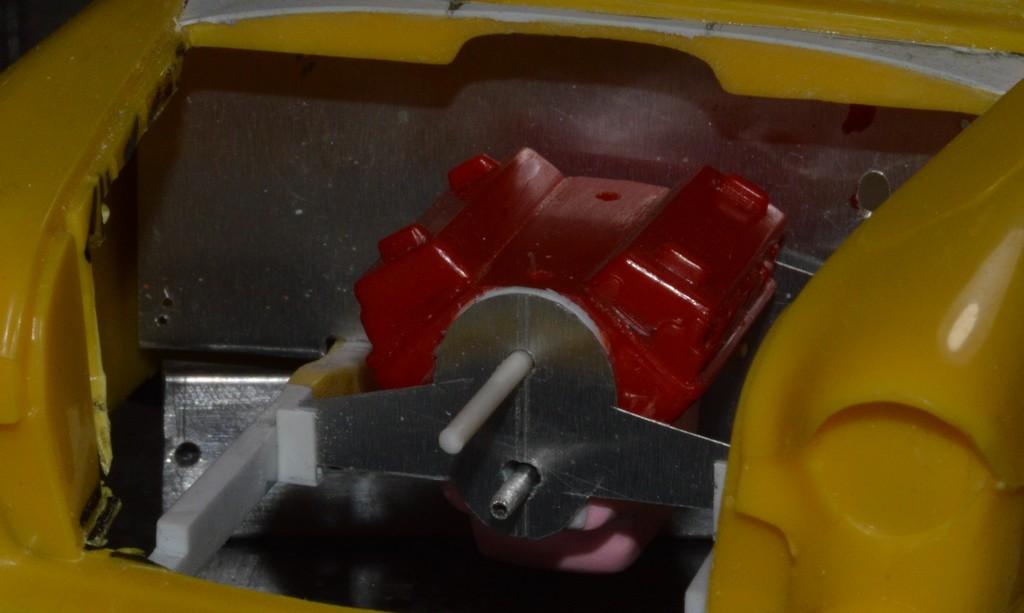

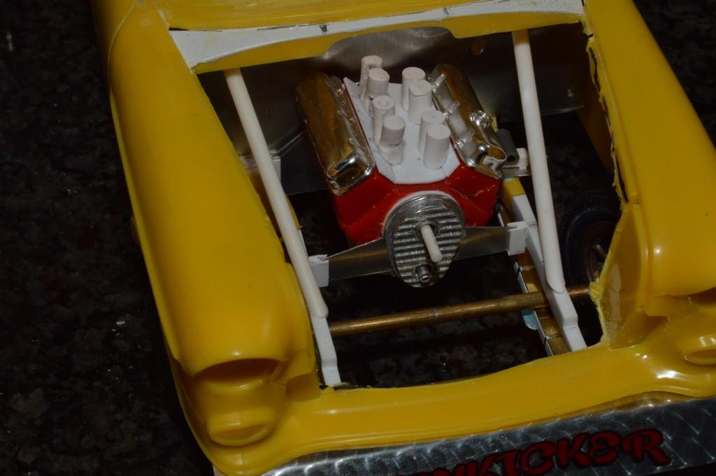

Straightliner59 Posted June 25, 2024 Author Share Posted June 25, 2024 This engine, from the Monogram '66 Malibu (red version!?)has some pretty odd qualities. Both ends of the block are molded at a slight angle. Those angles match up with the angles molded into the front motor plate, and the bellhousing. Weird, wild stuff! Because the kit's motor plate fills the space, there's no cast-in mounting boss for the front cover. I added one from Evergreen. The front cover juts up, past the deck, as it is molded. Adding the pan rail to the bottom of the block put the center of the crankshaft right where it should be, distance-wise, from the deck of the block. I added a couple of bits of split tube, to create main bearings, of a sort, in order to positively locate the rotational centerline of the drivetrain. Now, along with the rod protruding from the differential, I can be sure that the entire driveline aligns, when I am ready to start making the mounts--that shouldn't be too long! I am leaning toward making the pan from this pink foam/Renshape-type material. I've had it a while, but have yet, to use it. I just milled one side of this, where I'd sawn it from the bigger block. That works, wonderfully! Oh, yeah, my cool, new Moon steering wheel! Thanks to all for looking, and for your likes and, especially your comments! 1 Quote Link to comment Share on other sites More sharing options...

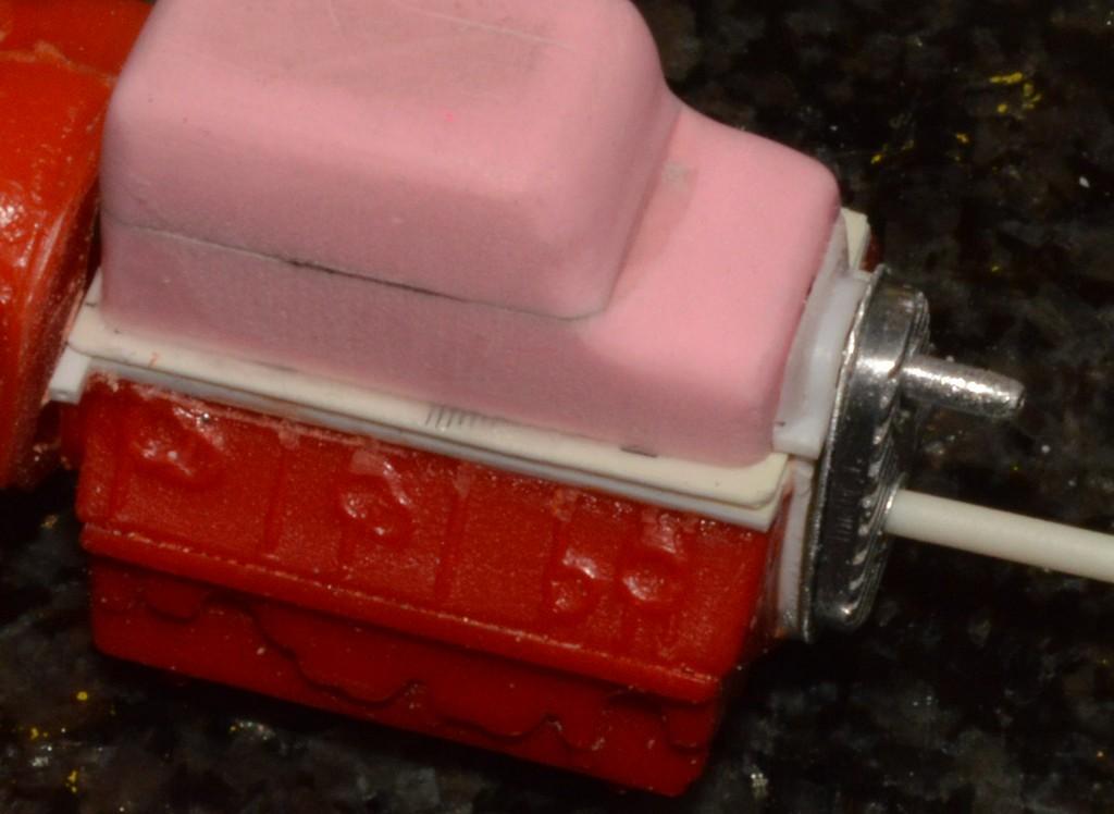

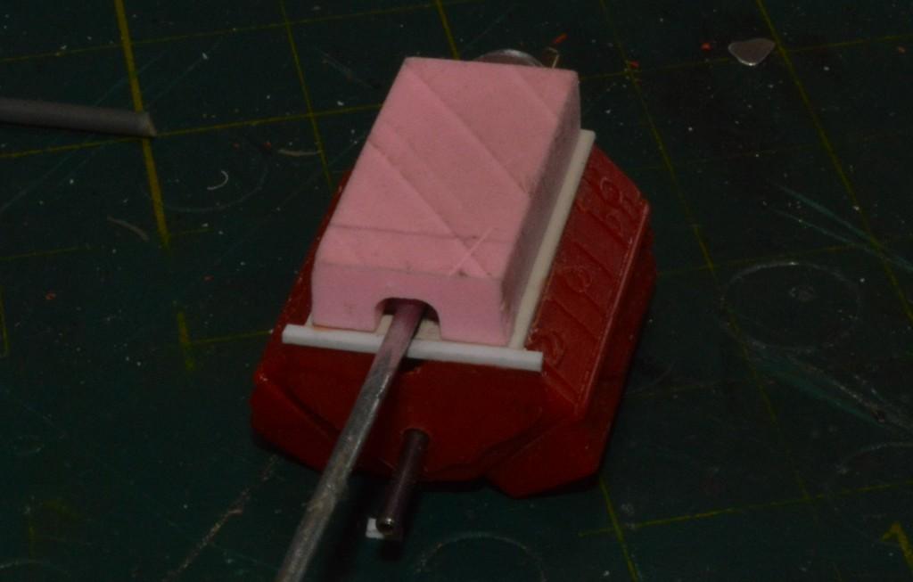

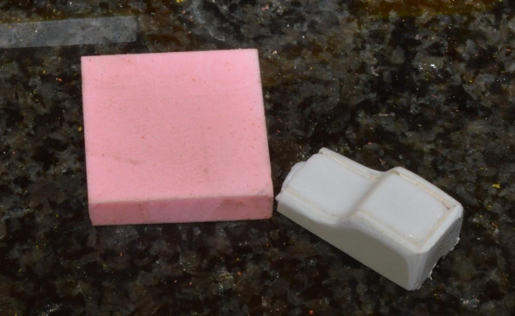

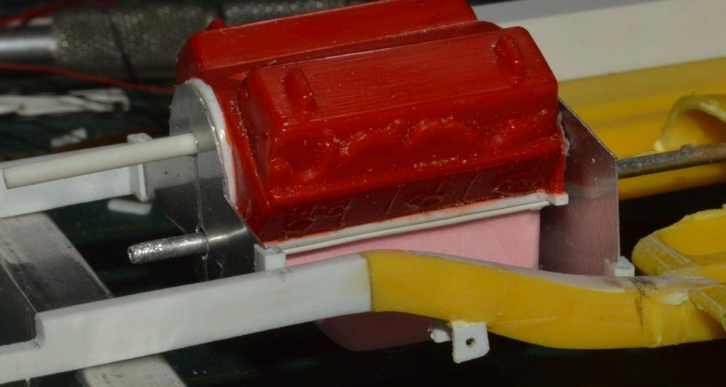

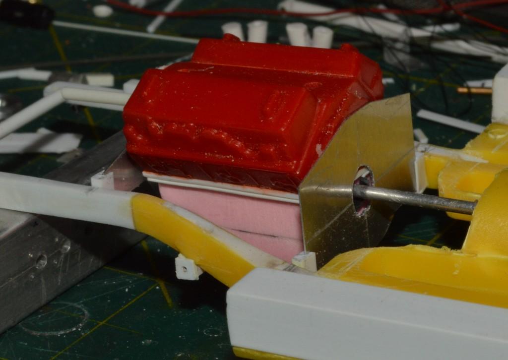

Straightliner59 Posted June 25, 2024 Author Share Posted June 25, 2024 So, yeah! I went ahead and started building an oil pan using that pink stuff.? It's easy to see why it's ideal for prototyping. It machines, and works, fantastically. I still need to add the sump--which I plan to make longer, to match a marine performance unit. Obviously, there's a lot of shaping, to do, and details to add, but, we're getting somewhere--down a sidetrack!?I was just supposed to be doing enough to get it ready to make the motor mounts, for it. The white cylinder head will have the exhaust port details sawn off, to replace the wonky carvings on the '66 Malibu's heads. Just for grins, I set the beginnings of the Crower injection manifold, and valve covers on it--now, we're getting somewhere. No photos of that, yet. Stay tuned. Thanks for looking! 1 Quote Link to comment Share on other sites More sharing options...

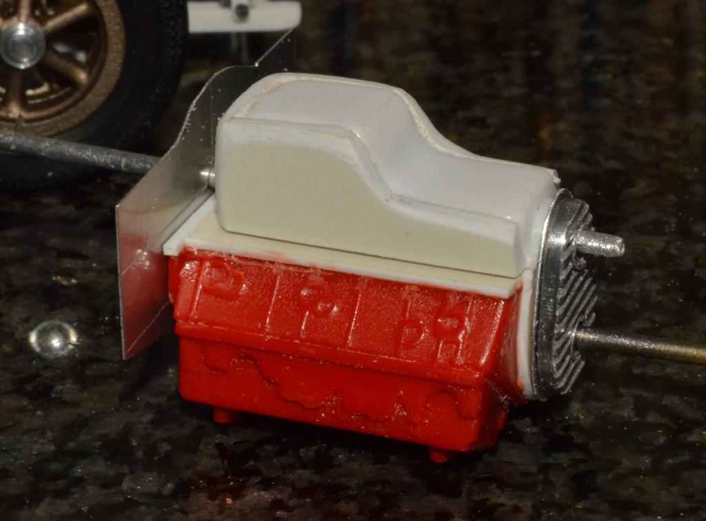

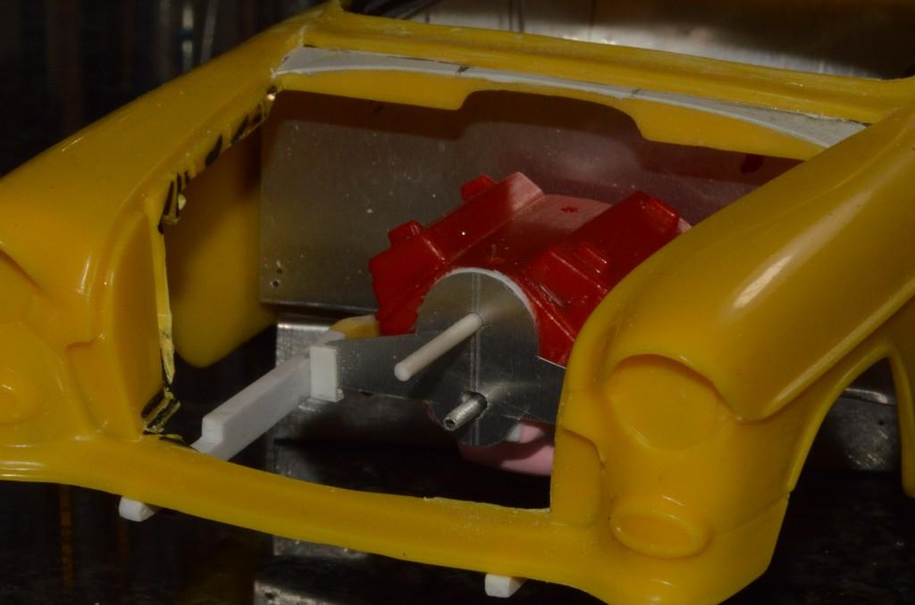

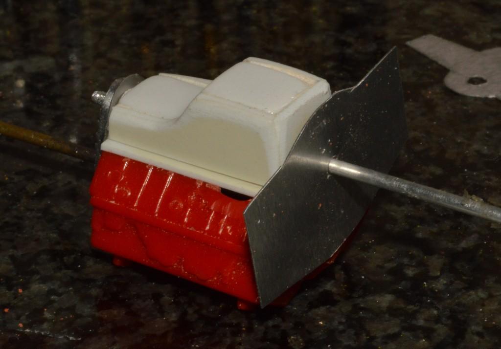

Straightliner59 Posted June 26, 2024 Author Share Posted June 26, 2024 I got the pan mostly shaped, and got the flange and main seals on. It drops right into place, and even kind of snaps in, in perfect alignment. Blind squirrel! I set the valve covers and manifold in place. Starting to look like an engine! I'm working on a design for the mounts for the chassis. I'm shooting for something that will allow me to simply drop in the block/trans assembly. That will make any subsequent test-fitting much easier. It's getting closer to having paint on the chassis. Thanks for looking! 1 Quote Link to comment Share on other sites More sharing options...

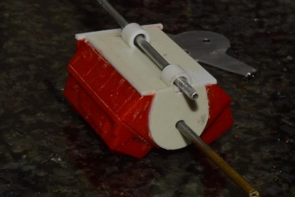

Straightliner59 Posted June 27, 2024 Author Share Posted June 27, 2024 I got the motor mounts installed. I have since removed the rear ones--they need to be lowered about 3/32". I discovered that, once I'd slipped the trans onto the main shaft. Minor setback. I used a .0312" end mill to groove a length of .060"X.125" Evergreen strip. I then closed off one end, so that the motor plates can slip into the channel, and be held in place by the .020"X.060" "stop". Other than that, I need to make the front shock mounts and shocks, and reassemble everything temporarily, one last time, before painting the chassis. Your questions and comments are always welcomed. Thanks for looking! 1 Quote Link to comment Share on other sites More sharing options...

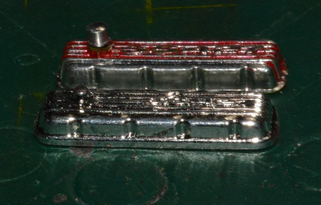

Straightliner59 Posted July 2, 2024 Author Share Posted July 2, 2024 A couple of things I've been fiddling around with. I got the valve covers done, mostly. I turned a new breather cap, and used a loop of Detail Master detailing wire to make a grommet. The new one, alongside an original (albeit not quite the same, as I'd always assumed they were). Thinking maybe I should have just left it alone!? I also made some aluminum spacers for them, to allow for more "rump-rump"! I also got started on the, well...starter. Thanks for looking! 1 Quote Link to comment Share on other sites More sharing options...

Ian McLaren Posted July 3, 2024 Share Posted July 3, 2024 (edited) Some how it figures it would be you who is the only other guy to put Jomar stud girdle spacers under his BBC valve covers. I have a set for my next build as per the photos below. The car we raced in the early70s, I just love the authenticity you put into your models! I appologise for the huge photo but it was sent to me as one image but does show of the spacers quite well Edited July 3, 2024 by Ian McLaren 2 Quote Link to comment Share on other sites More sharing options...
Straightliner59 Posted July 4, 2024 Author Share Posted July 4, 2024 (edited) Well, I could see these valve covers, that I really wanted to use, just weren't tall enough for the cam I plan to install!? Mine are only about an inch thick, though. Your printed head looks excellent! Adding little, authentic details, is such an enjoyable part of this hobby, for me! Stuff like this, is stuff I've seen and thought it would be cool, to do, in the right place. Some guys just throw stuff at their models, because they can--I like to think it through, a bit. Racers don't put stuff on their cars that isn't necessary, mostly. I try to follow that, even though I've never been on a crew, or anything. I've known a ton of racers, though, and getting it right, has always been important! Edited July 4, 2024 by Straightliner59 Quote Link to comment Share on other sites More sharing options...
