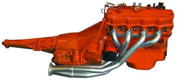

CaddyDaddy Posted April 28, 2024 Author Posted April 28, 2024 Gentlemen........appreciate the thought(s), but I’m afraid that ain’t it. Yes, the Chrysler LA series of engines has the distributor in the back. However, the two inside exhaust ports per side are right next to each other. You could say they are almost touching. A quick look at a set of 340 headers almost appears that there are only 3 pipes. This “AMT” engine has four equally spaced exhaust ports with four equally spaced header exhaust tubes.
NOBLNG Posted April 29, 2024 Posted April 29, 2024 (edited) It is supposed to be a mopar poly head engine available from 1955-1966. These came in a number of displacements. https://www.modelcarsmag.com/forums/topic/188752-amt-‘41-plymouth-optional-engine-trans/#comment-2840900 Good discussion on them here: https://www.motortrend.com/how-to/mopp-0109-chryslers-poly-head-engine/ https://www.forabodiesonly.com/mopar/threads/poly-engine-what-was-good-bad-about-it-and-why-is-the-la-better.504820/ http://victorylibrary.com/mopar/poly-graphics.htm Edited April 29, 2024 by NOBLNG
CaddyDaddy Posted April 29, 2024 Author Posted April 29, 2024 I believe we have a WINNER here Greg!!!!! Thank you very much. Poly’s were a little before more time, so I thus tend to forget about them. My hands on experience didn’t come in until late ‘60’s/early ‘70’s with the LA’s. Anybody running early ‘60’s Mopar stuff around me had big bocks. Correct me if I’m wrong, but there was no such thing as a factory 340 poly.
NOBLNG Posted April 29, 2024 Posted April 29, 2024 (edited) 15 minutes ago, CaddyDaddy said: I believe we have a WINNER here Greg!!!!! Thank you very much. Poly’s were a little before more time, so I thus tend to forget about them. My hands on experience didn’t come in until late ‘60’s/early ‘70’s with the LA’s. Anybody running early ‘60’s Mopar stuff around me had big bocks. Correct me if I’m wrong, but there was no such thing as a factory 340 poly. You’re welcome Chas. No 340 cid…check the motortrend link I just added. It has a list of displacements. Edited April 29, 2024 by NOBLNG

Dave Darby Posted May 8, 2024 Posted May 8, 2024 You have to remember that this kit was designed during a very low point in AMT's history. I believe that engine is purported to be a 360. (Albeit a very inaccurate one.) It lacks the scalloped rocker covers of a poly, and few people ran polys in the 70s. I think the design team just didn't do their research. The whole kit is a bit on the crude side, especially the chassis and running gear. But it's the only game in town if you want a 48 Plymouth, and it certainly is workable.
