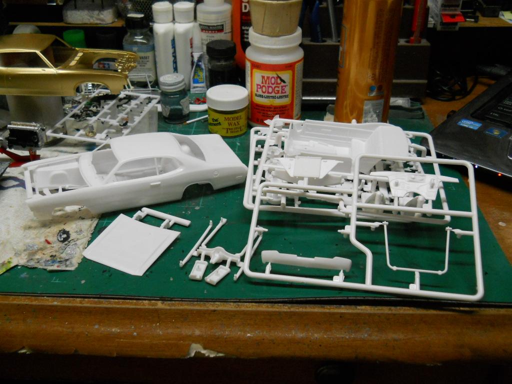

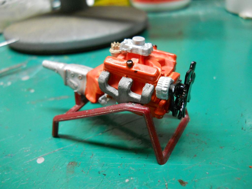

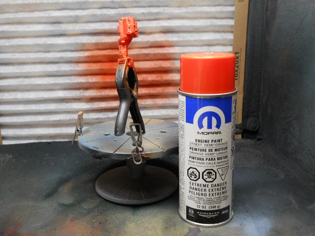

mrmike Posted April 29, 2024 Author Posted April 29, 2024 I started on the Demon 340 by assembling and painting the engine. I cued up my Mopar painting guide and it said blue. The instructions said orange and I Googled what color it should be and it depends on when the engine was built. As you can see, I painted the engine orange. I spent some time dry fitting various parts and pieces and studying the instructions and now I am ready to go and assemble this kit. 3

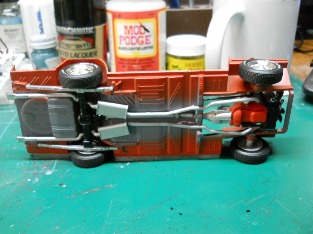

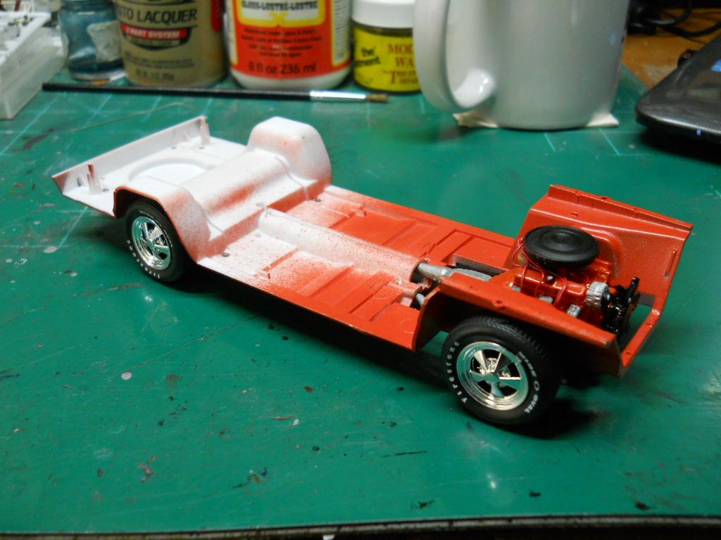

mrmike Posted April 30, 2024 Author Posted April 30, 2024 Been working on the Demon 340. I got the engine assembled and it is waiting for plug wires and some plumbing. I replaced the distributor since I ruined the kit distributor trying to drill it out for plug wires. The rear end assembly has been paint detailed including Alclad II Chrome paint for the exhaust tips. I wrapped the pipes with tape and lightly sprayed the exhaust tips and they came out excellent! I started on the chassis and I mocked up the rear end assembly on the chassis. 5

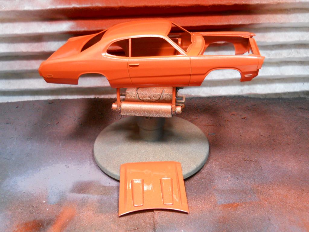

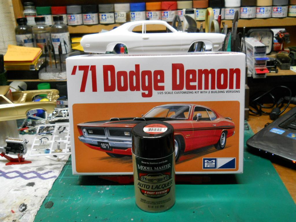

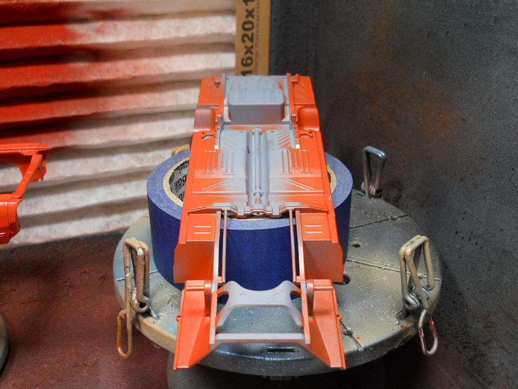

mrmike Posted May 1, 2024 Author Posted May 1, 2024 I fired up the paintbooth and the paint was flying today! I painted the body and hood, the chassis, the interior and some random parts with my spray cans. 6

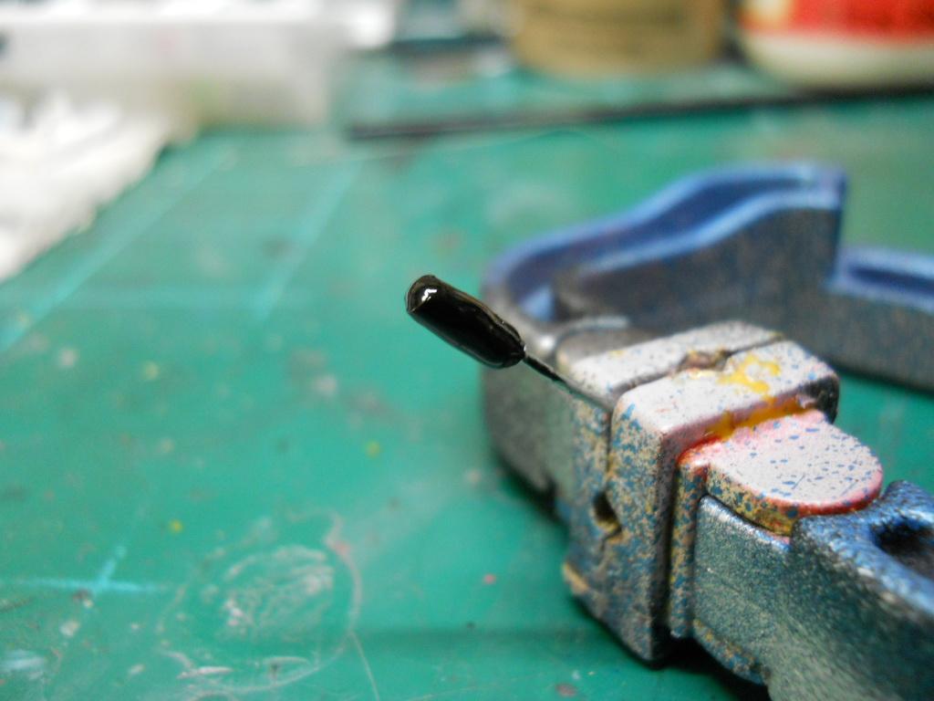

mrmike Posted May 2, 2024 Author Posted May 2, 2024 One thing missing from this and many other kits is the ignition coil. I went and made one for this kit since this is not one in the kit. I used a piece of sprue painted black and wrapped a piece of Bare Metal Foil around it. I drilled a hole in the middle of the sprue for a length of ignition wire and glued it in place on the engine manifold. 2

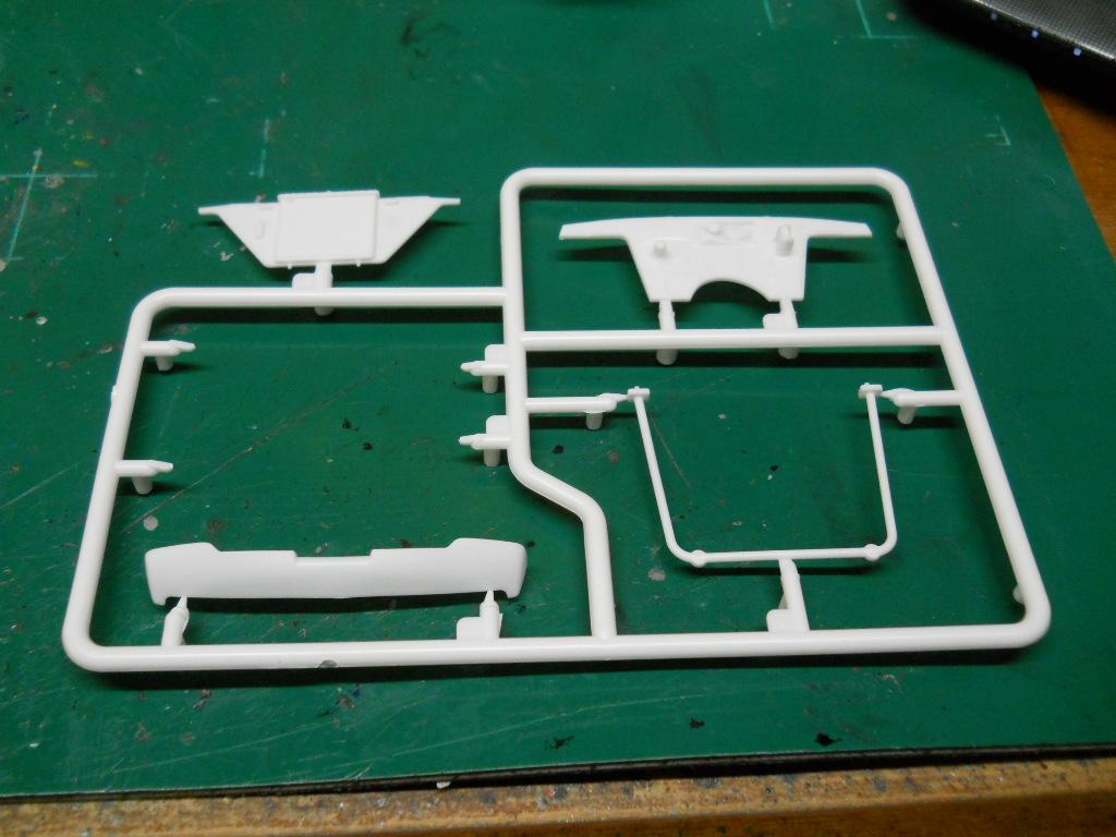

mrmike Posted May 3, 2024 Author Posted May 3, 2024 The chassis is almost complete. I usually forget to paint the side view mirrors, but not this time. I forgot the rear bulkhead, core support and the front valance. Bummer! Out comes the paint and primer. 2

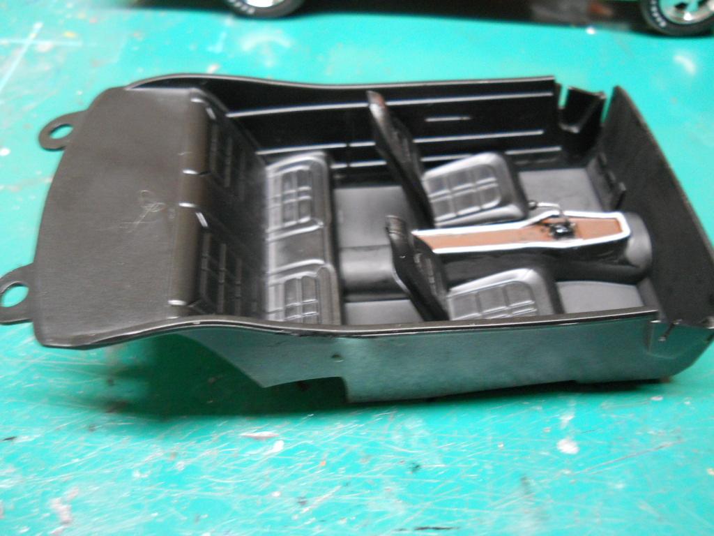

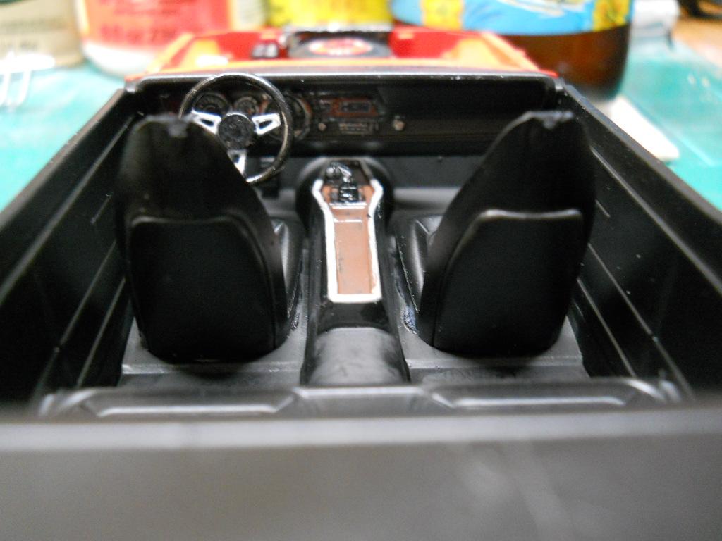

mrmike Posted May 5, 2024 Author Posted May 5, 2024 I painted my missing parts and I decal the dash, but the decal didn't settle into the dash like I hope it would. The speedo and gauges were too tall and I used a lot of setting solution just to get the decal were it is. I have seen pics of one, but I have never actually seen a manual shifter with a console on an A body car.
Moparman18064 Posted May 6, 2024 Posted May 6, 2024 7 hours ago, mrmike said: I painted my missing parts and I decal the dash, but the decal didn't settle into the dash like I hope it would. The speedo and gauges were too tall and I used a lot of setting solution just to get the decal were it is. I have seen pics of one, but I have never actually seen a manual shifter with a console on an A body car. When they retooled this kit, they should have eliminated the console, or make it optional. A bodies dropped having consoles for 4 speeds at the end of 1969. I wonder if you carefully sliced the decal where the wood grain meets the gauge if it would lay in there better. It might be too brittle now though. I will have to keep that in mind when I build one of mine. What color orange is that? In some of the pics it almost looks like vitamin c. 2

mrmike Posted May 6, 2024 Author Posted May 6, 2024 14 hours ago, Moparman18064 said: When they retooled this kit, they should have eliminated the console, or make it optional. A bodies dropped having consoles for 4 speeds at the end of 1969. I wonder if you carefully sliced the decal where the wood grain meets the gauge if it would lay in there better. It might be too brittle now though. I will have to keep that in mind when I build one of mine. What color orange is that? In some of the pics it almost looks like vitamin c. Rich, the color is Model Master Hemi Orange Lacquer. The decals are on with a lot of setting solution. Thanks Rick, David and Carl! 1971 Dodge Demon 340 I have finished the chassis and the interior. I should have painted the wood grain on the dash and then used the individual decals in place of the entire decal strip. The body is next! 3
