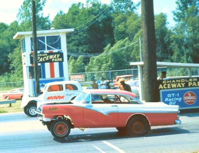

Or, better yet, anyone know the car and have more info or pics? I am looking to build this, or something very close. I just can't find any info on it other than this pic from George Klass Remembers. I am guessing it is a 312/stick car, or maybe another Y-block. It might be possible that it has a small block Chevy swap. With that weird scoop I am guessing a 3x2 carb, 2x4bbl, or fuel injection set up. I am also dating the pic as being between '60 and '63 or so. I have most of the stuff to do this car, just not sure about the engine. It looks like the car is black. Maybe a black or black and white interior? In my book, this is just plain cool! Any help appreciated.

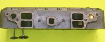

The 312 Ford had kinda odd stacked intake ports and didn't flow as well as some of the engines listed above, so it would have been easier to get power out of something else. And it's heavy.

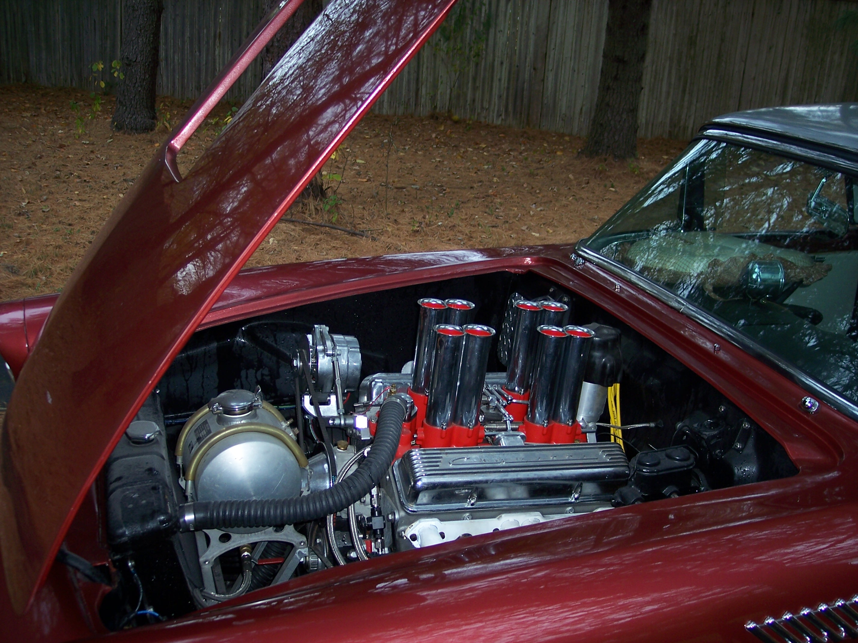

EDIT: A cost-no-object build might be a bored and stroked Chevrolet smallblock with Hilborn injection and lots of engine setback. It'll fit under your photo's hood.
I think this is a perfect opportunity to build it based on the info Ace gives in his response since it was possibly a local racer since no other pics seem to exist of it. Lots of info available from just looking at it. Note the long traction bars, the squared exhaust outlets and the weird hood scoop. You can also see a roll bar crossbar.
I say have at it. I'd enjoy seeing a build sequence of it.

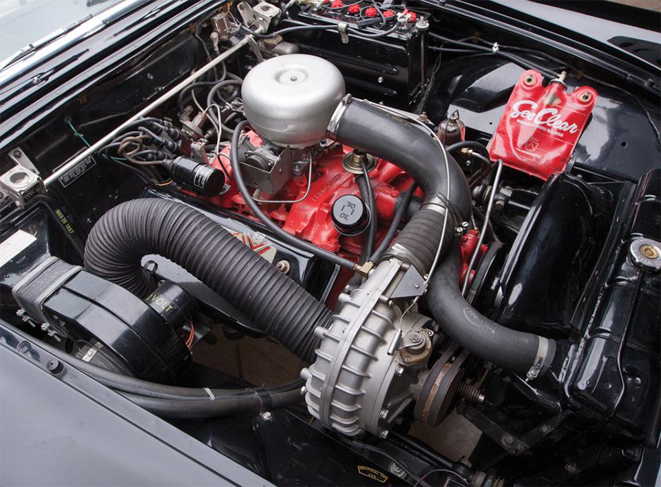

If it was my guess, there would be a 312 with a factory supercharger under the hood. The hood scoop is there to make it look more racy. I don't think to many of these t-birds were getting cut up yet.

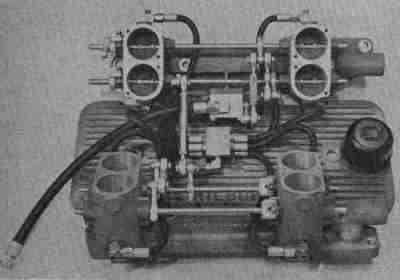

If you want to stay Y-block, of course they could be bored and stroked like anything else to get the displacement up to the class limit.
There was some pretty trick stuff for the old Y, like this extremely rare Hilborn injection setup. Note the orientation of the special twin-shaft throttle bodies because of the Y's odd intake passages.
