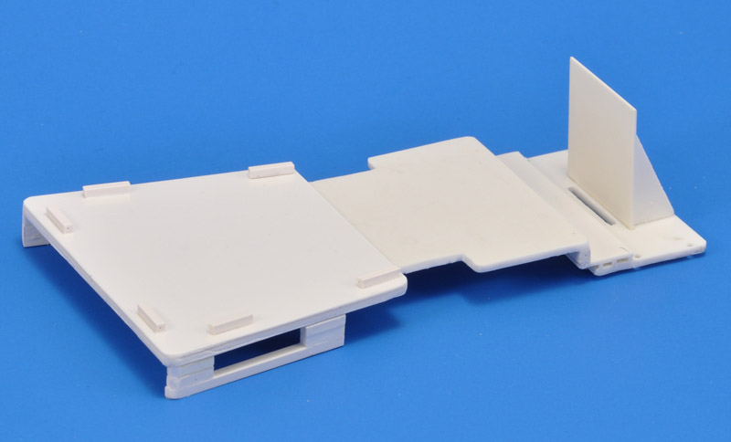

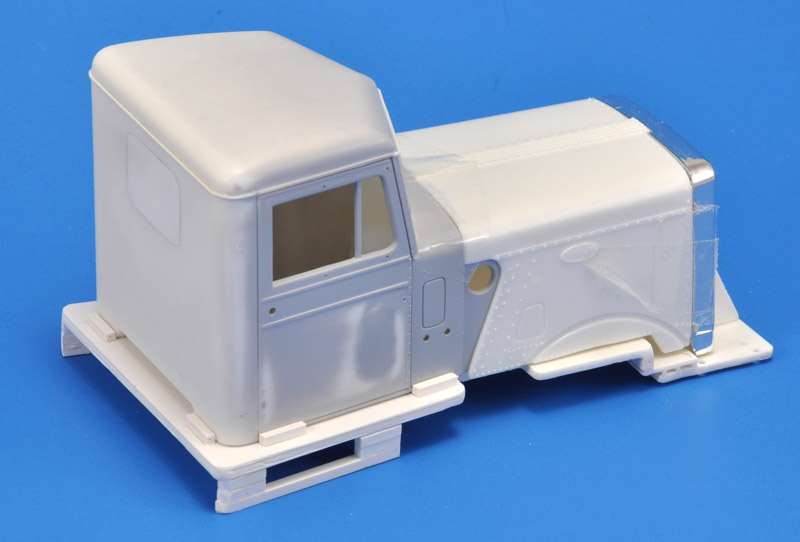

robdebie Posted May 1, 2024 Posted May 1, 2024 (edited) I'm preparing to do a 'needle nose' conversion of the AMT Peterbilt 359, in order to create a 281 (the 'Duel' truck). With new parts required for the hood and radiator, I was pretty sure I would lose the aligment of cab, hood and grille. Therefore I built a jig that held these parts in place. The jig has three steps. Here's the jig with the kit's cab, hood and grille (taped together) placed on the jig Now my question: what width should the narrow grille have? Does anyone know that figure? I have three reference values: 1. in the 1984 FMS article, the author narrowed the grille bij 1/4", making it ~42 mm / 1.65" (or 41" in reality) 2. I measured the grille width in a line drawing in an old spec sheet, and found ~34 mm / 1.32" (33" in reality) 3. I plotted a drawing of the wide AMT grille over a screenshot from the movie, narrowed it until it fitted, and found ~35 mm / 1.38" (34.5" in reality) As expected, three different values.. Help? Rob Edited May 1, 2024 by robdebie
