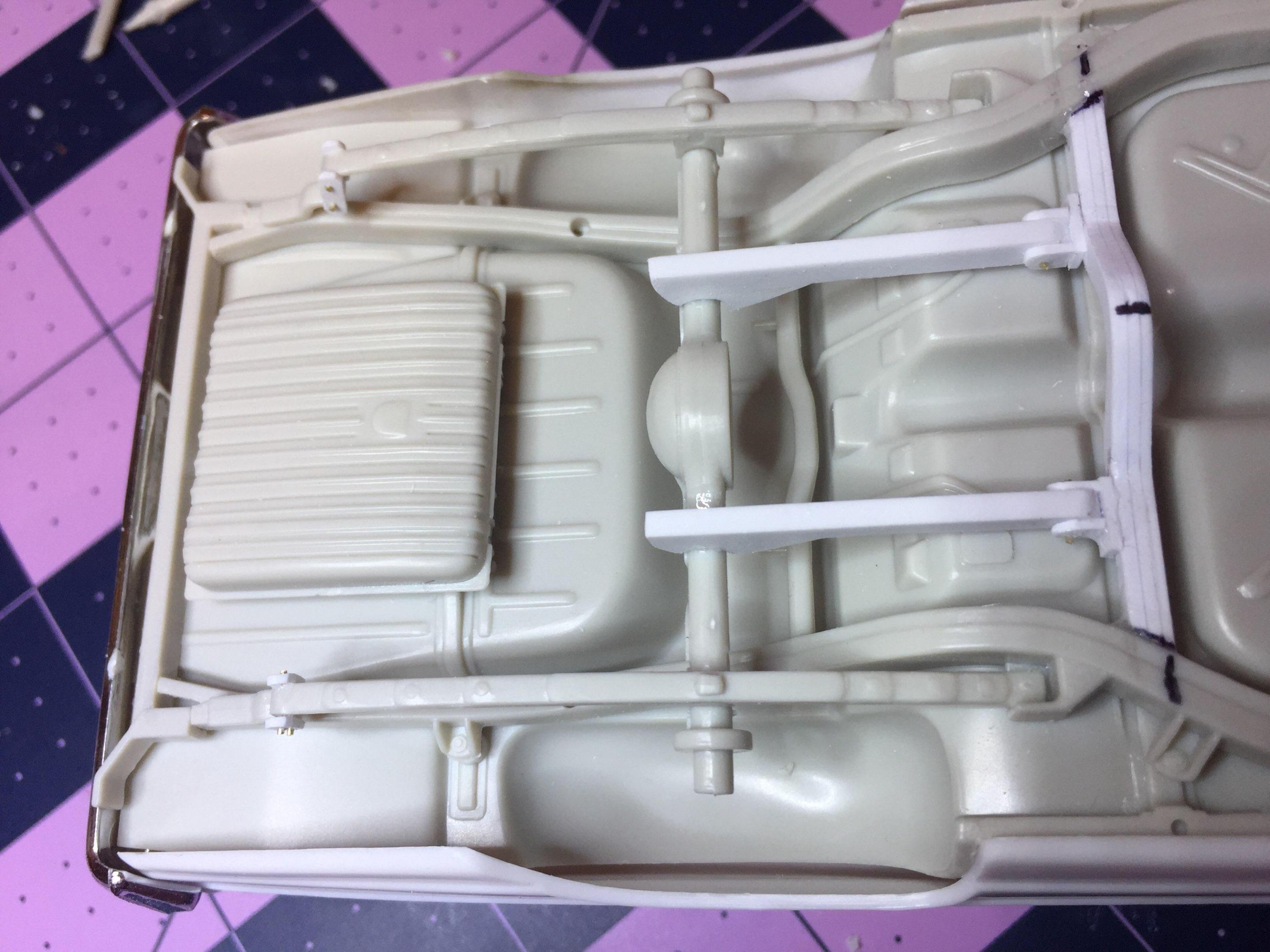

The first thing I had to do was straighten the floor pan using the Starliner body as a reference. I won't bore you with the details. Then the frame. Anyway, that all worked out okay. After that I noticed the 1:1 shows the rear spring shackles are either reversed or replaced with aftermarket parts to maybe make room for the slicks so that was the first mod. Second, I fabbed up a traction bar set-up using the thunderbolt part, loosely, as a pattern. The floor pan needed to be trimmed slightly behind the rear axle and shortened a bit. The gas tank had to be moved forward and the frame was shortened near the bumper brackets. The "screw bosses" have been shortened to ultimately get the bumper brackets to work with the bumper and to get the stance established. I observed in the photos that the 1:1 rear hub aligns with the lower character line of the body, so that was my target. It seemed wheels on the 777 were mostly reddish steelies and white wall tires appear on the front. I borrowed slicks from the AMT '62 Bel Air SS 409 and married them to the '60 kit's wheels. On the front are the '63 kit tires on the '60 inner wheels with the '63 chromies on the outside, painted. The rears needed tweaking to get the tires in a bit and I buzzed the inside of the wheel openings too for a little extra clearance. Hopefully, the photos will clarify anything I have not explained well. The help I will need is about the next thing- the radiator support. I am not sure how to go about this and any help will be greatly appreciated so....feel free!

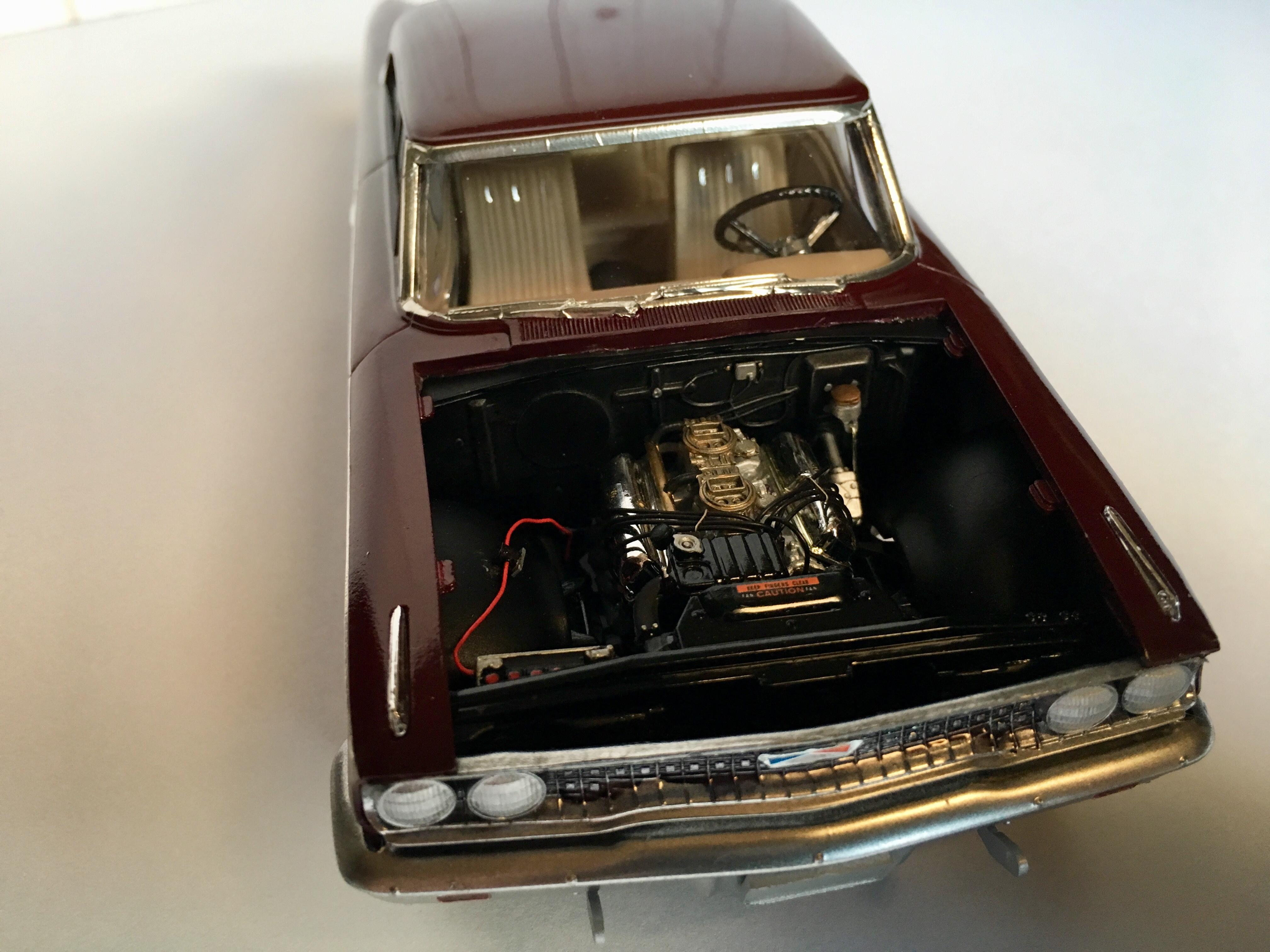

Got some stuff done tonight on the radiator support. I ended up removing the entire '63 screw boss partition. I found I was able to fit the '60 support along with the top piece attached with only slight tweaks on the top corners of the support. I don't know yet if I need to do anything about the way it looks but it fits just fine. I did need to move the engine back about 2 mm. due to the very slight interference with the expansion tank, which is part of that top piece.  I removed the mounting from the transmission crossmember and installed a new pin maybe 2 mm back to locate the transmission.  I am optimistic ?. Next thing is the firewall. Not sure how to proceed on that and I am hoping for some informed suggestions. You have all weekend; I'm back at it on Monday.  Also, I am going to need the MCW lightweight interior and they don't have it in their on-line catalog ?. OK, I'll check ebay ?.

Things are coming along nicely, Jim. I noticed you were able to get the radiator support to work with the 63 grill and headlights piece. I always end up removing the two curved pieces, that sits behind headlights from the Starliner radiator support in order to get my grills to fit. I suppose there is more than one way to skin a cat.
Also those slicks would not be legal back in the day on this car. Speed City sells nice 7” wide Racemaster Super Stock cheater slicks with two treads going around the tire. These would fit with almost no clearance issues at all. On all the cars I’ve built with this chassis, I had to remove the wheel stops on each side of the rear end, in order to push the wheel backs further on the rear. This eliminates any tire clearance problems that I encountered. I’ve built a few that were not built to the exact rules of 1963, and used wider tires on the rear.
Can’t wait to see more progress.

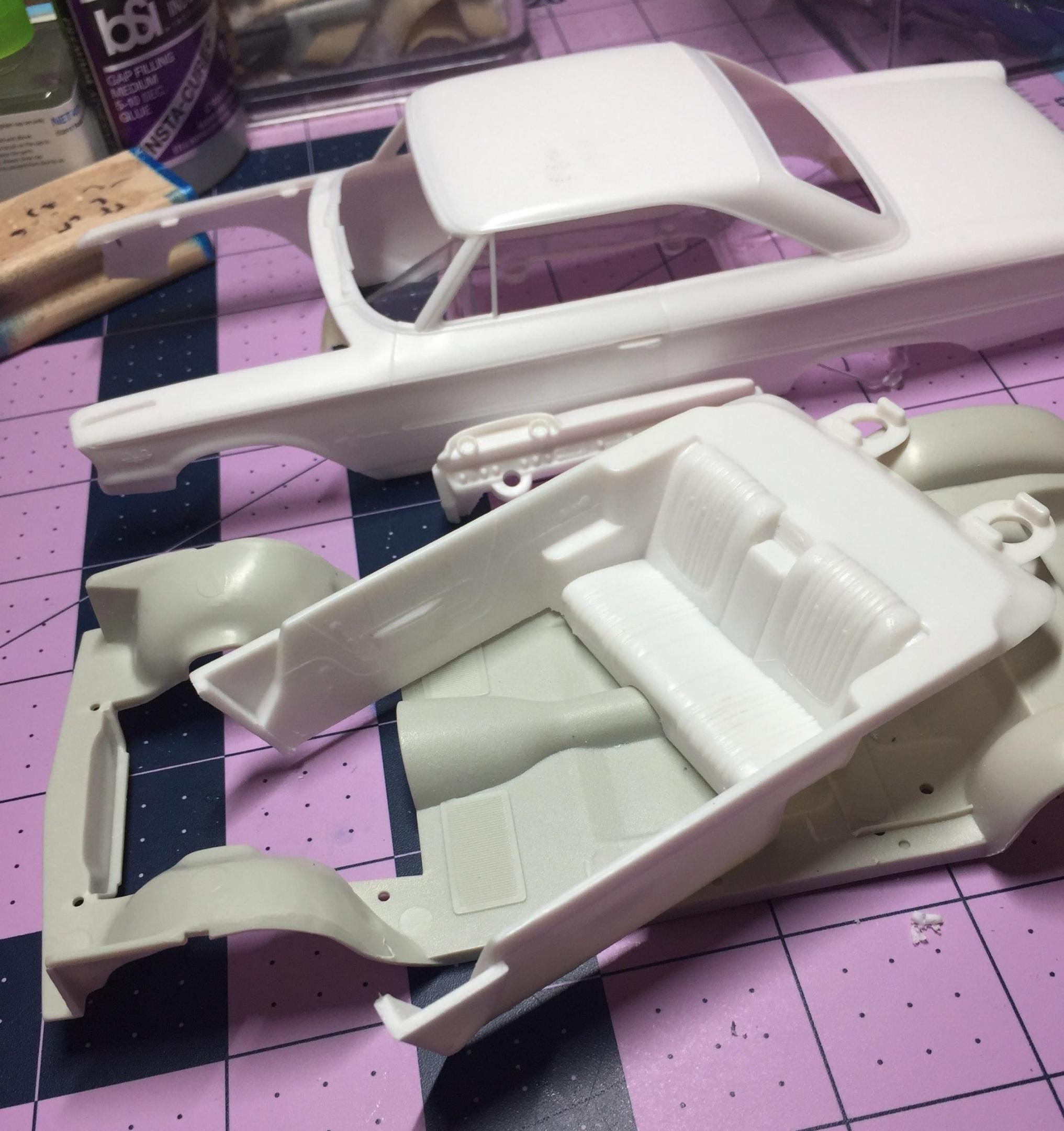

All right then, here's some. I don't have much hope of obtaining an MCW interior so I have opted to modify the kit tub. I cut the floor out of it and trimmed it down a bit to work with the '60 floor.
IMG_5953.thumb.jpg.6488c88d3bb24c1bfc17e9c8f9c2be38.jpgIMG_5950.thumb.jpg.4201b8d6d395bf6ad2cff13521010f27.jpgIMG_5951.jpg.3fe67b77edaae7b7014ec8b50169c8ef.jpgIMG_5949.jpg.9221f09b526130568017f9dfe9528b64.jpgIMG_5952.jpg.faf38825ddbc6fffe8e523dfdda47174.jpg

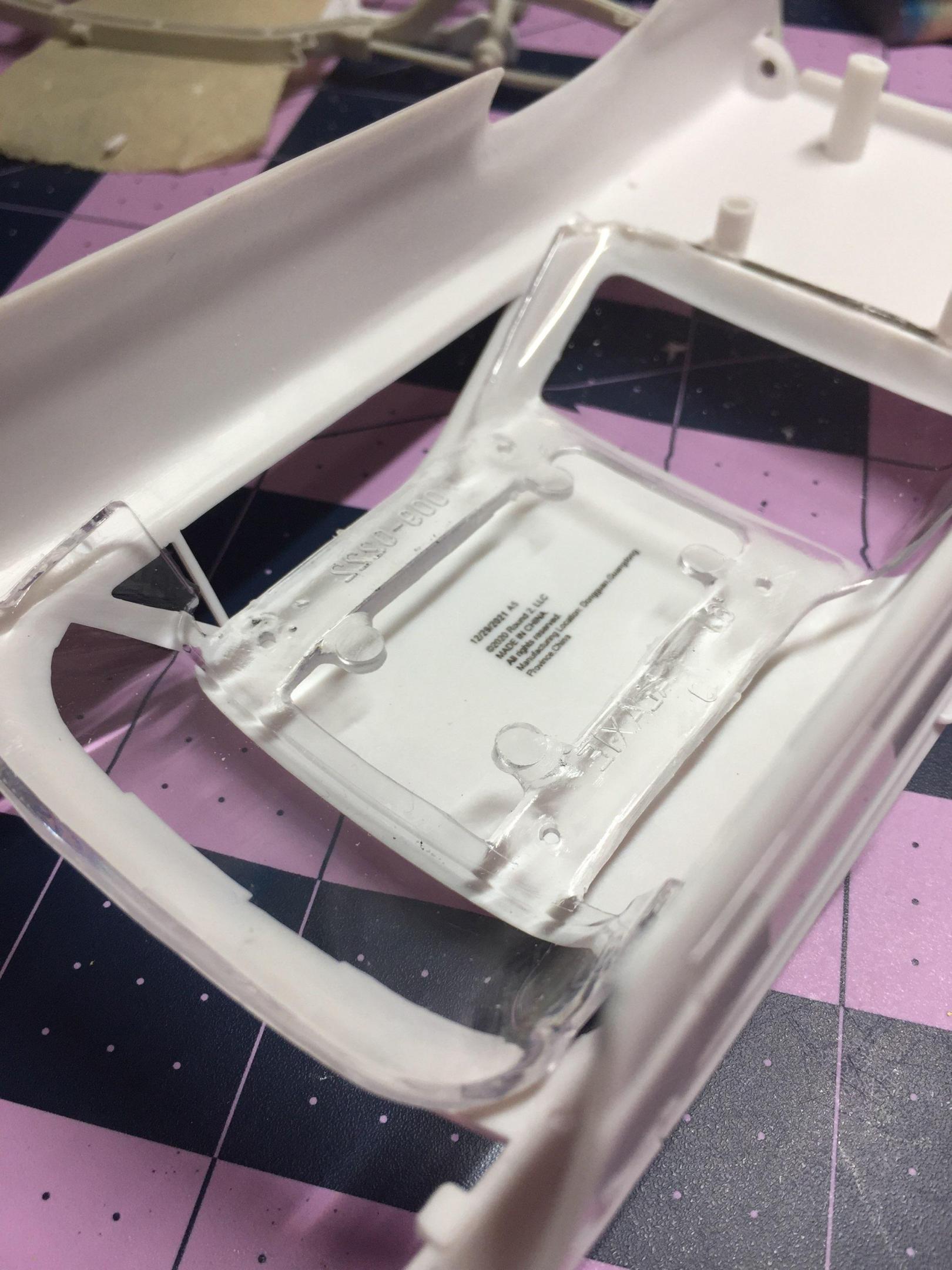

I had to do some grinding on the top of the tunnel and the bottom of the seat (at the arrows). The plan is to remove the arm rests and most of the somewhat lackluster detail and fake in my own.  The '60 kit had some warpage that had to be dealt with earlier but I just found a new one which may turn out to be beneficial. The glass.
When I mocked up the interior using  the dash and glass, I found if I forced it into place both panels fit up into their places nicely. I may just epoxy the glass despite having to force it. The mock-up seems good with everything fitting well. The firewall looks like it may be a bit of a challenge and it's next. Thanks for checking in.

The build is looking great! I did notice an issue, the traction bars on that car are rear mount, I can see them in your photos. You can see them in these photos also. Here is a pic of installation, FYI...  I think the AWB Falcon has a set
Edited by Sledsel
  • Like 3
Andy. I do believe you are correct.  I misinterpreted what I saw in the photos. You have just ruined my day. And maybe saved it. I have some work to do. Thank you.
Honestly, I did not mean to ruin it. It was an observation that I merely wanted to point out. Every racer back then did something unique.
