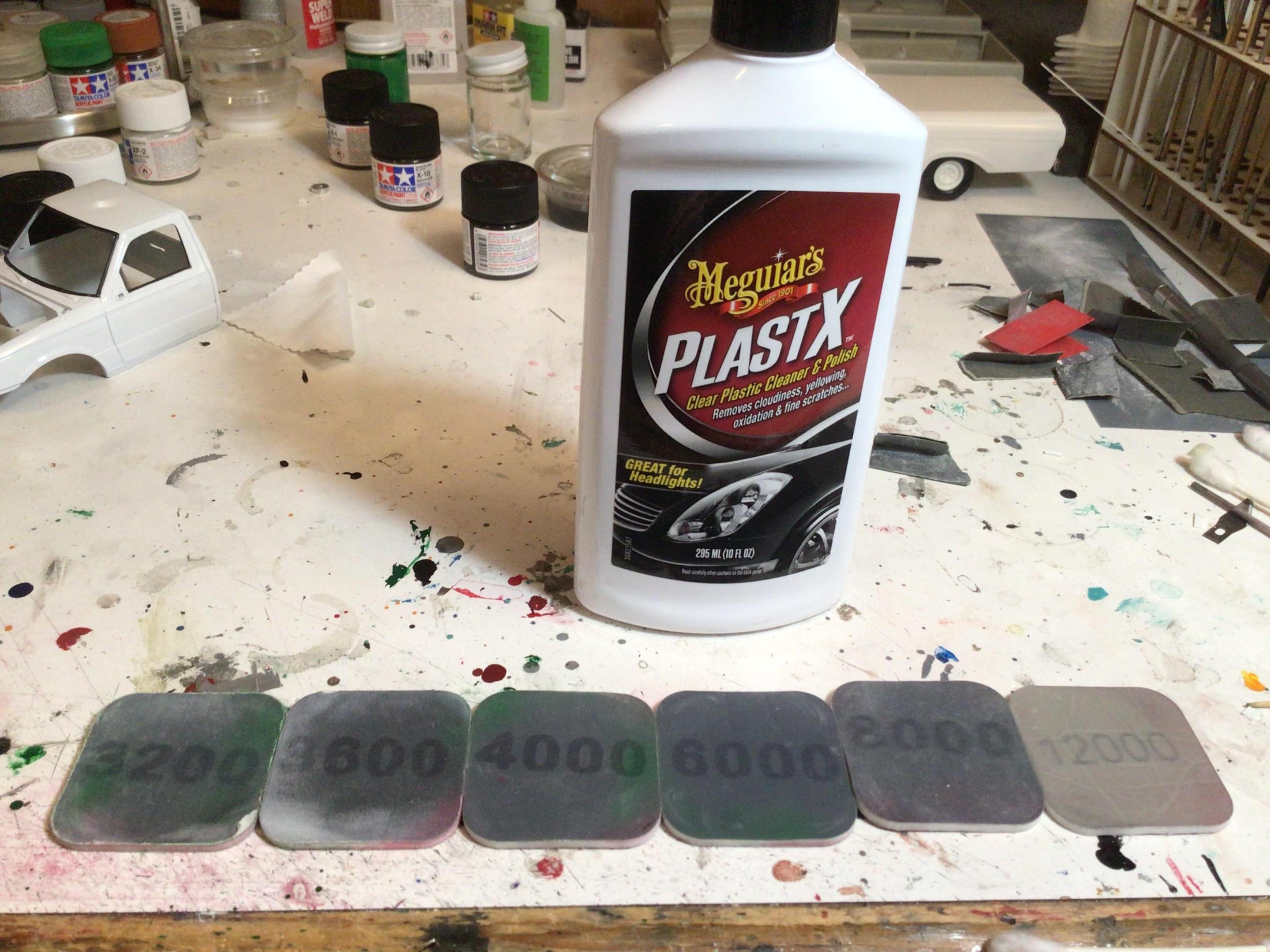

Radretireddad Posted August 31, 2024 Posted August 31, 2024 I use these polishing and buffing pads I got at Hobby Lobby. They start at 3200 and go to 12000. Meguiars PlastX works well for removing swirls. 1
