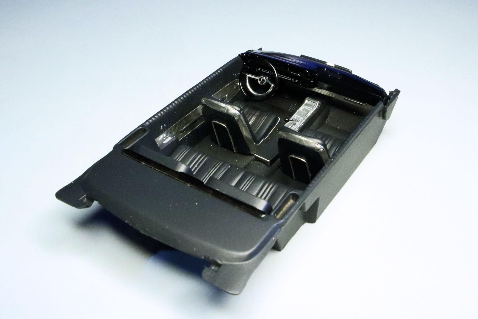

On 6/15/2024 at 6:31 AM, David G. said:
Hello Everybody!
It's time for the next Ford Galaxie update!
The interior is completed!
Basic black upholstery with chrome trim accents. Simple and to the point.
Though no one will likely ever see it, I did manage to work some dashboard detail into the scene.
As always, thanks for taking the time to look and please feel to post any comments you may have.
David G.
Kudos for finding a great way to replicate those seat backs.  Your solution wouldn't have even occurred to me.  Also really like the rest of the interior, especially the dash.  Do any "recent" releases (Jolly Green Gasser) have a speedometer decal, or is that sourced from ebay?  (I think I've seen them there).  Either way, it looks great.   Lastly, I made notes of what you did with the wheelbacks etc to improve the stance and make the poseable wheels/tires work more accurately, so thanks for that as well.
  • Like 1
Thank you very much for your kind comment Monty. I don't know for certain what is provided in other versions of this kit. I did have the Gasser kit in my hands at my LHS the other day and I did notice that AMT got the hood scoop the right way around on that one! :D
The dashboard is so deeply hooded on this car that I doubt if anyone will notice the speedometer or much of the dash detail once it's all assembled. Still, I detailed the speedometer using my usual method of painting it then scraping the paint away from the numbers allowing the white styrene beneath to show.
I'm glad to know that my WIP helped you in some way Monty. When I started building models again back in 2009, I got soooo much help and inspiration from this site and others like it. It's good knowing that I can help others in a similar fashion.
Thanks again,
David G.

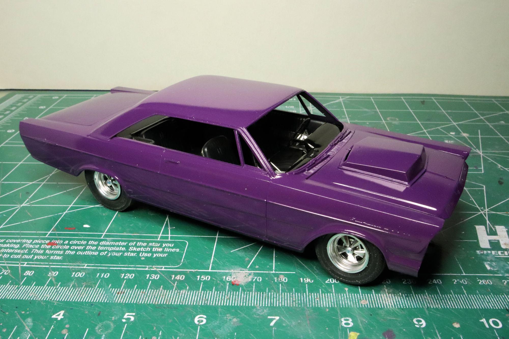

Hello Everybody!
It's time for the latest update on the Ford Galaxie.
After color sanding and a good wash and dry, the second coat looks pretty good.
Even the panel lines I scribed for the fuel door came out well.
Unfortunately, the strange paint flaws are "back in the hood" so to speak. I think this may be the result of me trying to remove the hood scoop so I could more easily clean up the previous flaws. I used some Tamiya cement as a solvent on the inside seam hoping to soften and release the bond. It didn't work. So after sanding out the first flaws, I cleaned it up and repainted. Only to have the flaws return with the second coat. :(
As always, thanks for watching!
David G.
It’s coming along nicely David.? Interesting treatment method for the grill…I’ll have to try that on something. Thanks!?
9 hours ago, David G. said:
Hello Everybody!
David G.
David
I would agree that’s probably because of the solvent.  May have been some that wasn’t  fully cured in the seam of the scoop when you did the second coat that wicked out into the paint. I would throw it in the dehydrator for a while before you lay on another coat.   You’ll beat it into submission yet?
Thank you Greg. That process works most of the time, if the chrome is in pretty good shape to start with. The rear bumper on this kit has some awkward casting seams so I ended up stripping the chrome on it. After I file the seams down I'll probably prime and polish it then hit it with some Rustoleum chrome spray.
14 hours ago, LennyB said:
David
Right now the hood is on its third or fourth day in the Purple Pond. The Purple Penalty Box maybe? I checked on it after the first day and after a good scrubbing with some Dawn dish soap and a toothbrush there was still some paint stubbornly clinging to it so I decided to let it languish in the luxury of the Lavender Lake until it can get its purpose in life sorted.
I'm hoping that the extra time in detention will help to change its attitude.
"Now you just sit in there and think about what you want to be when you get out!" :D
Seriously though, I'm hoping that allowing it to soak for a few days will let the solvents leach out or completely cure any residual chemical interactions going on.
David G.

Hello Everybody!
AMT's 1965 Ford Galaxie 500 XL, here's the next update!
I've sanded out the flaws near the hood scoop and a few others I've found. Looking at the way these defects sanded out, I'm thinking that they are actually casting artifacts.
After sanding them smooth and spraying a fresh coat of paint, the flaws remain. :(
Even the ones on the front are still there. The paint is beginning to get too thick and I'm done mucking about with it. Into the Purple Pond it goes!
As always, thanks for taking the time to look and please feel free to comment.
David G.
  • Sad 1
Those flaws on the hood scoop and at the front of the hood are giving you a hard time David . . . If the Purple Pond can't sort it, nothing can !
David W.
My 2 cents: if the next paint job ends up the same way I would take Carl up on his kind offer and if you must put a scoop on it, use CA and give it a day or two curing time to be safe. This is so frustrating and who needs that?  I'm so sorry, Dave; I know it would make me crazy ?
  • Like 1
Thank you Jim, I appreciate your thoughtful comment. I believe that I will find a way to make this work, it's just going to take a little more time and patience than I originally planned.
And who knows, I may learn something!
David G.
