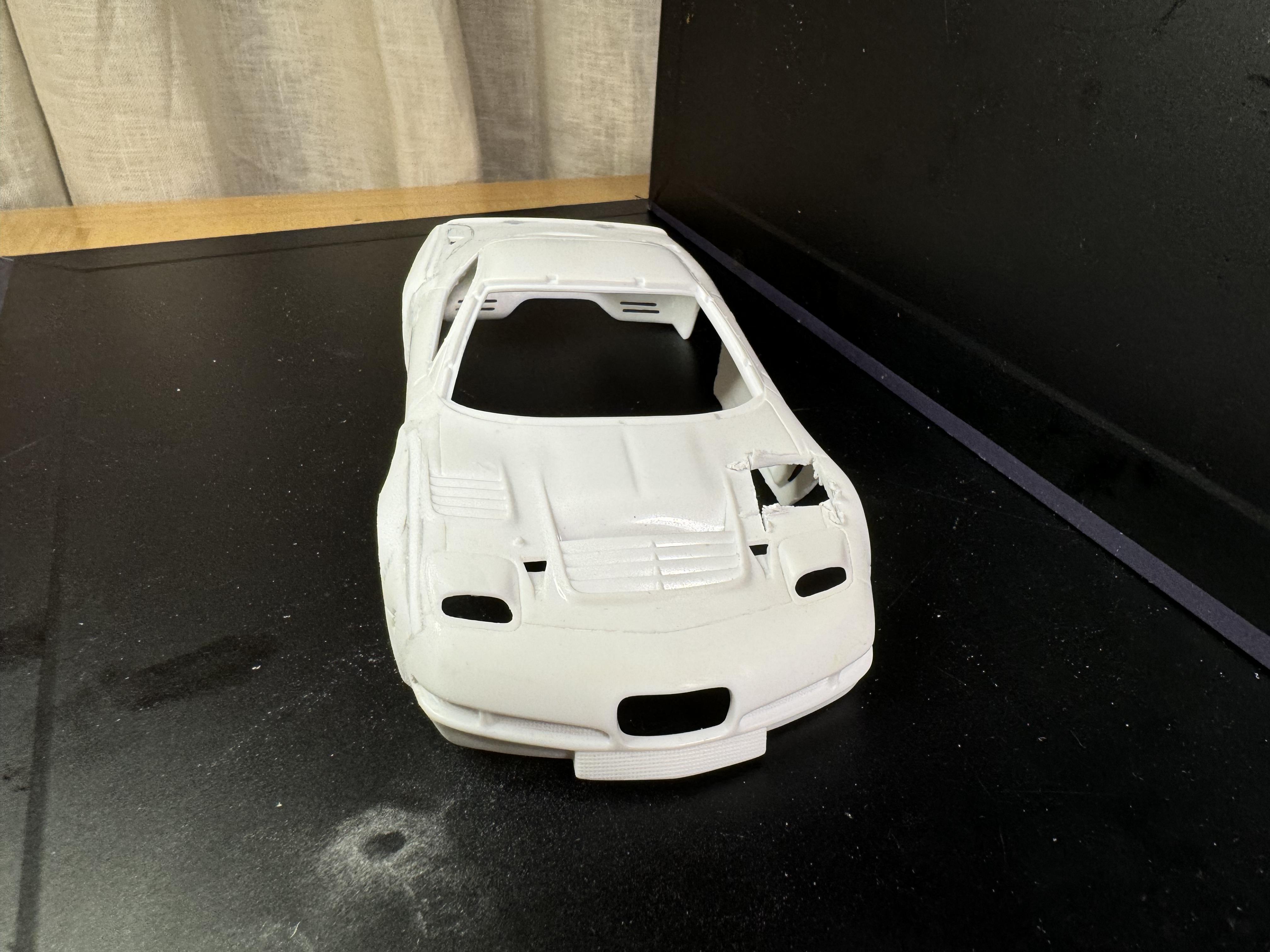

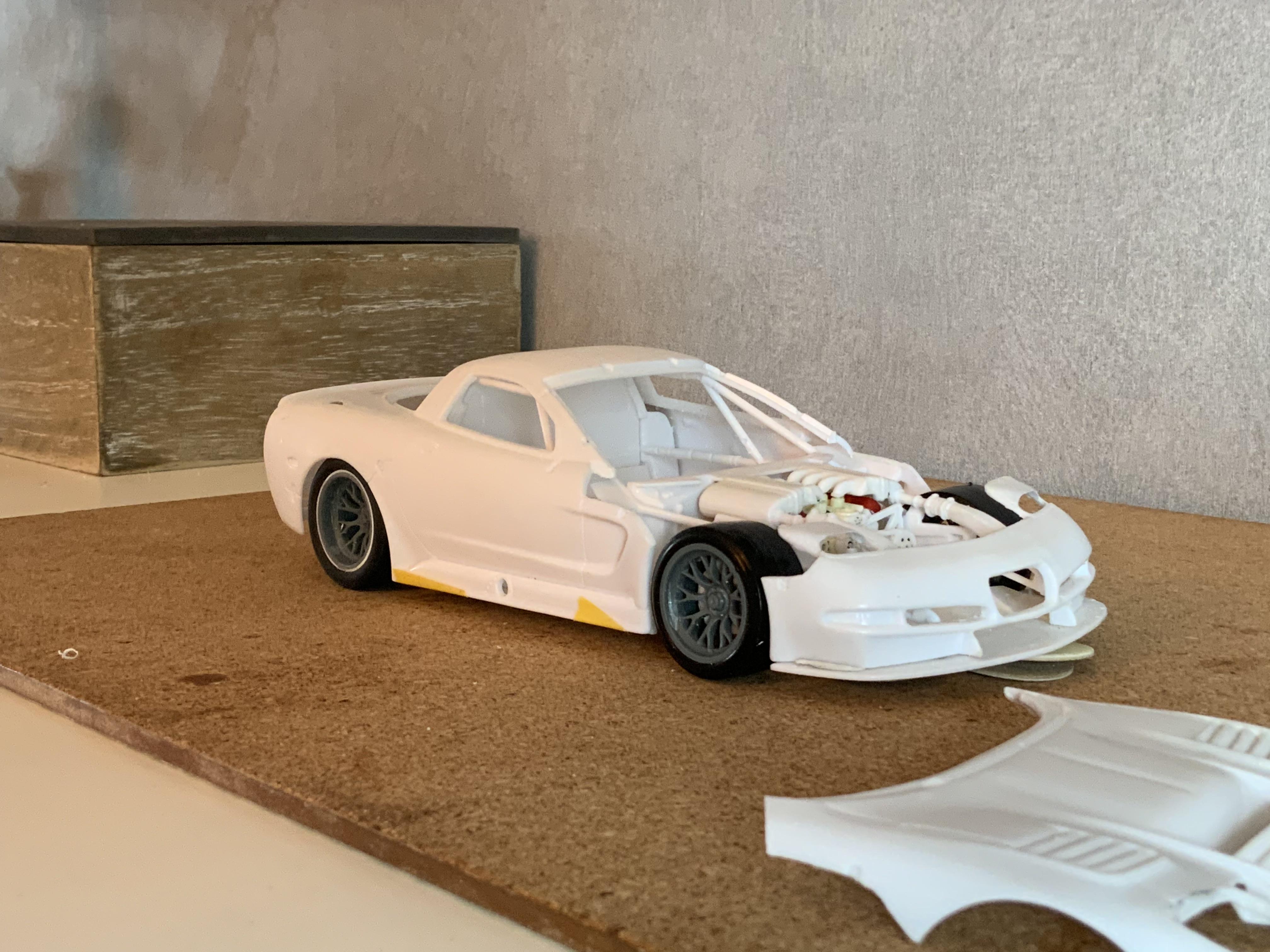

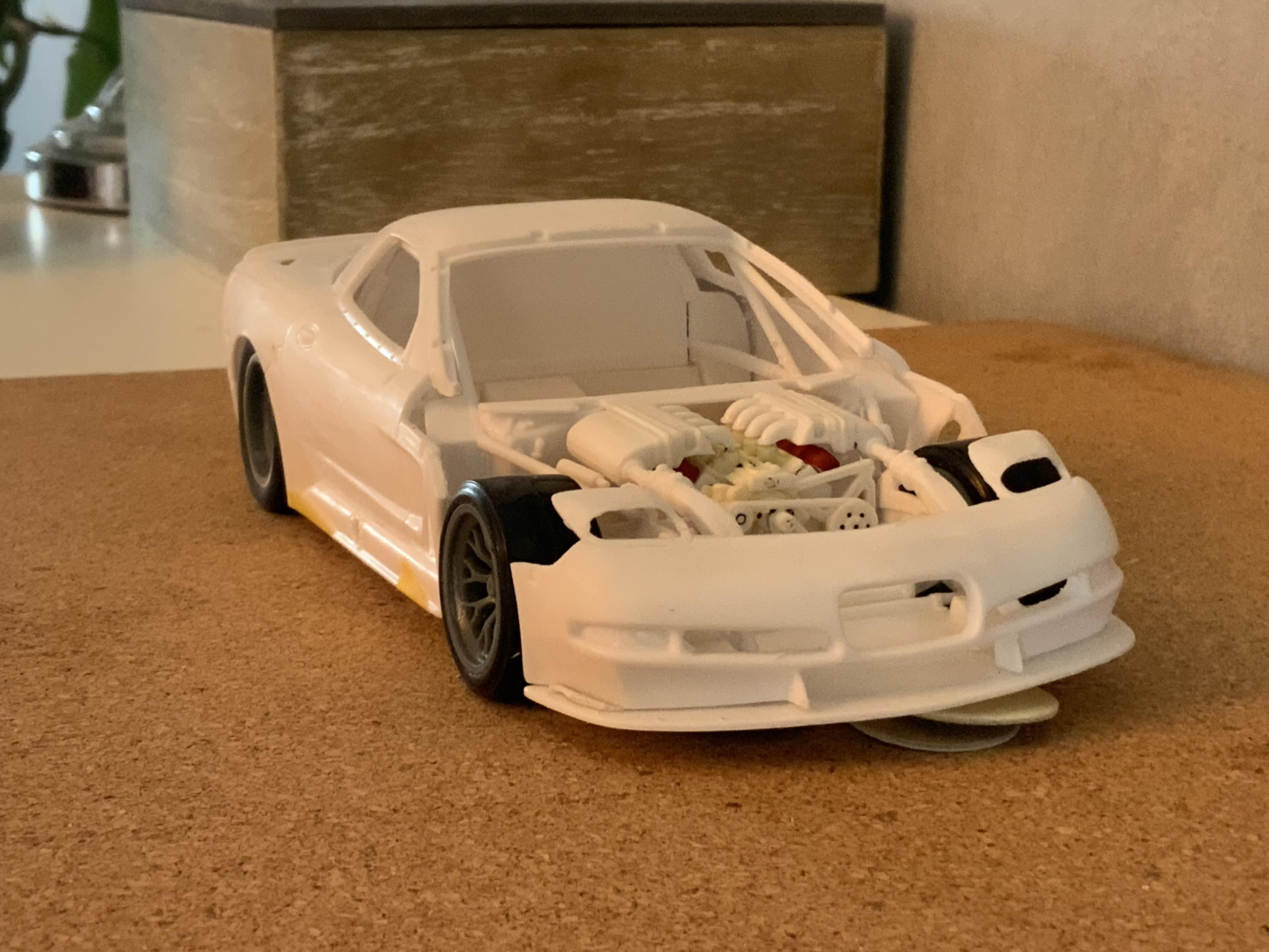

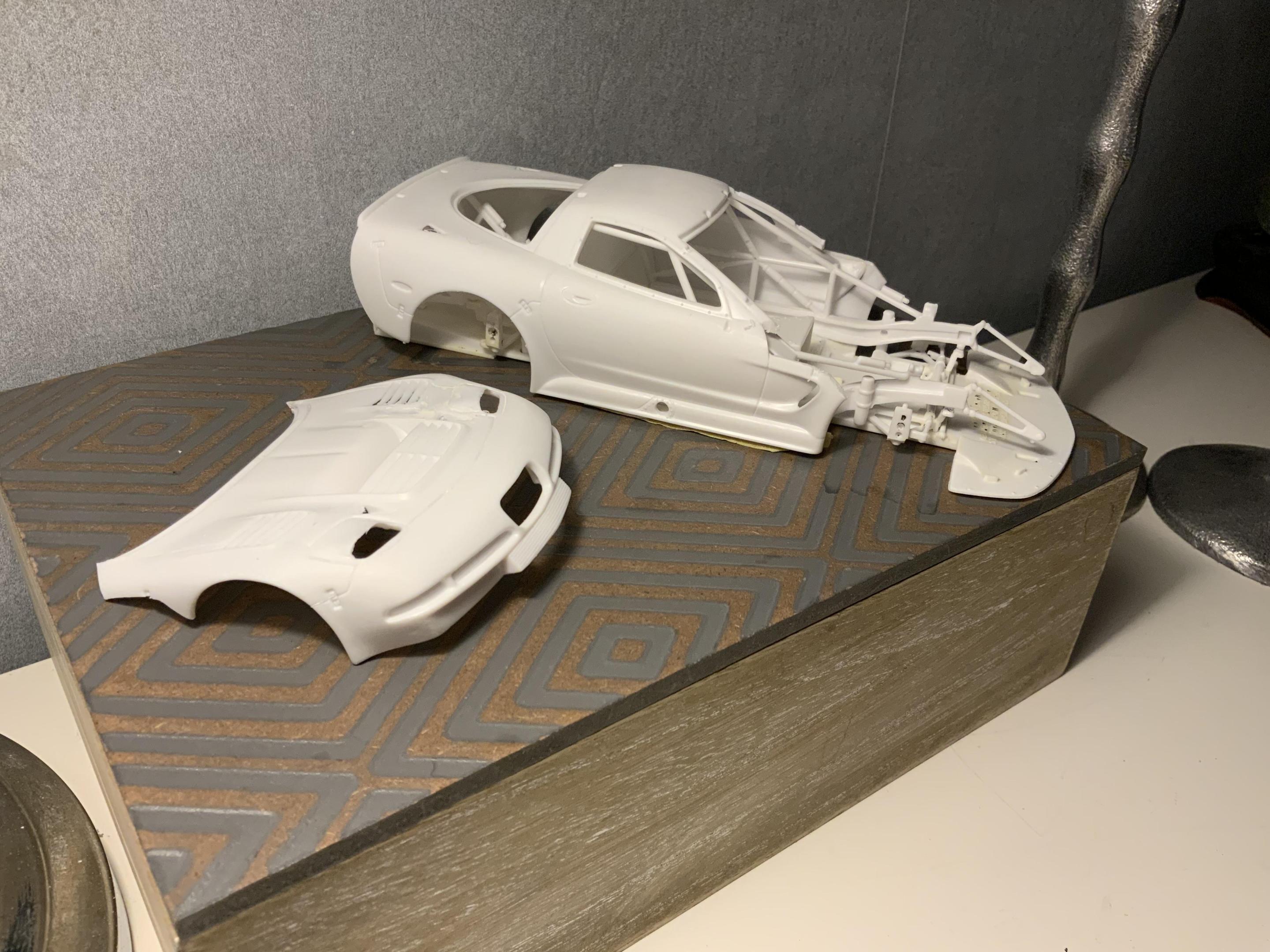

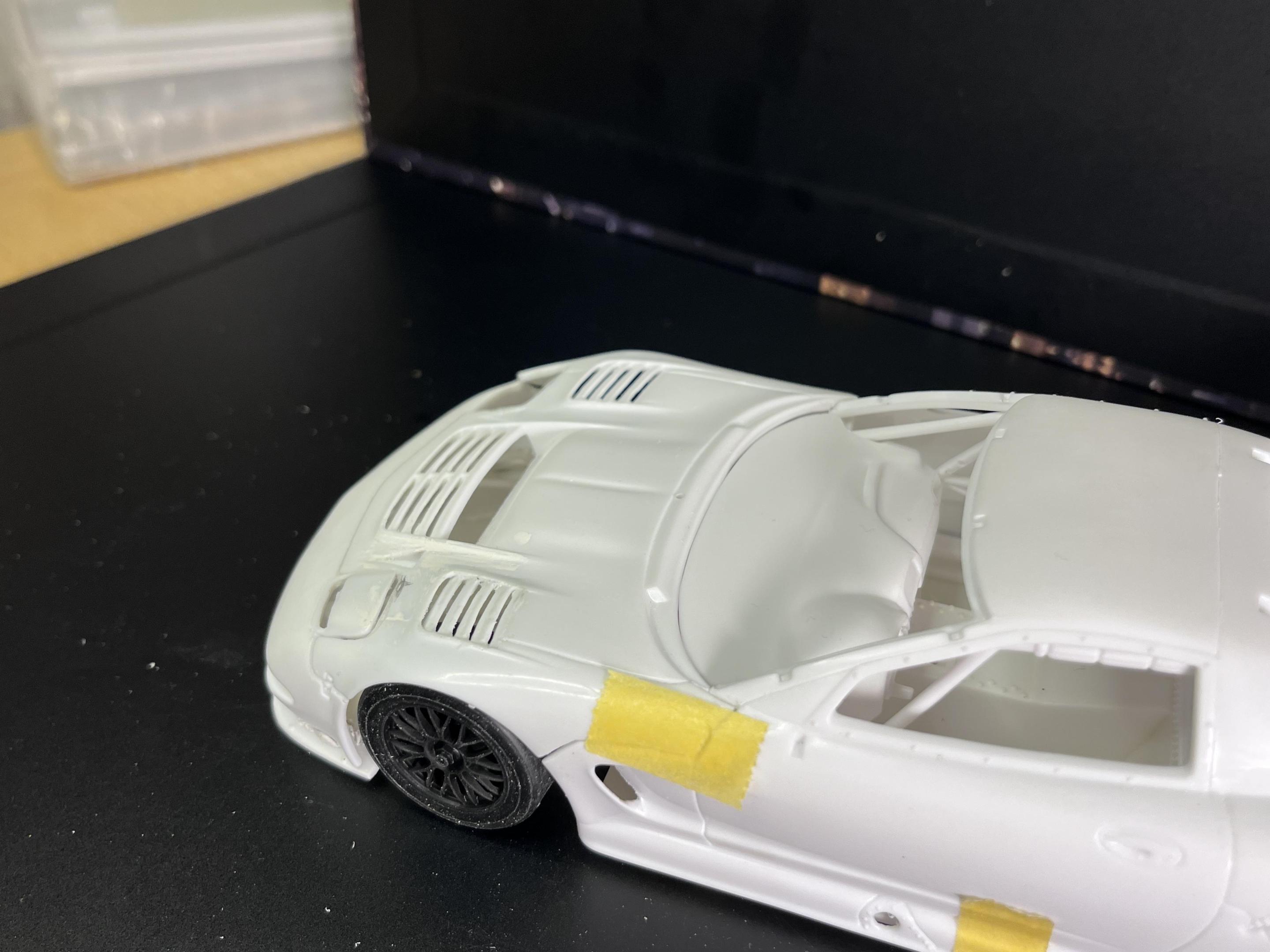

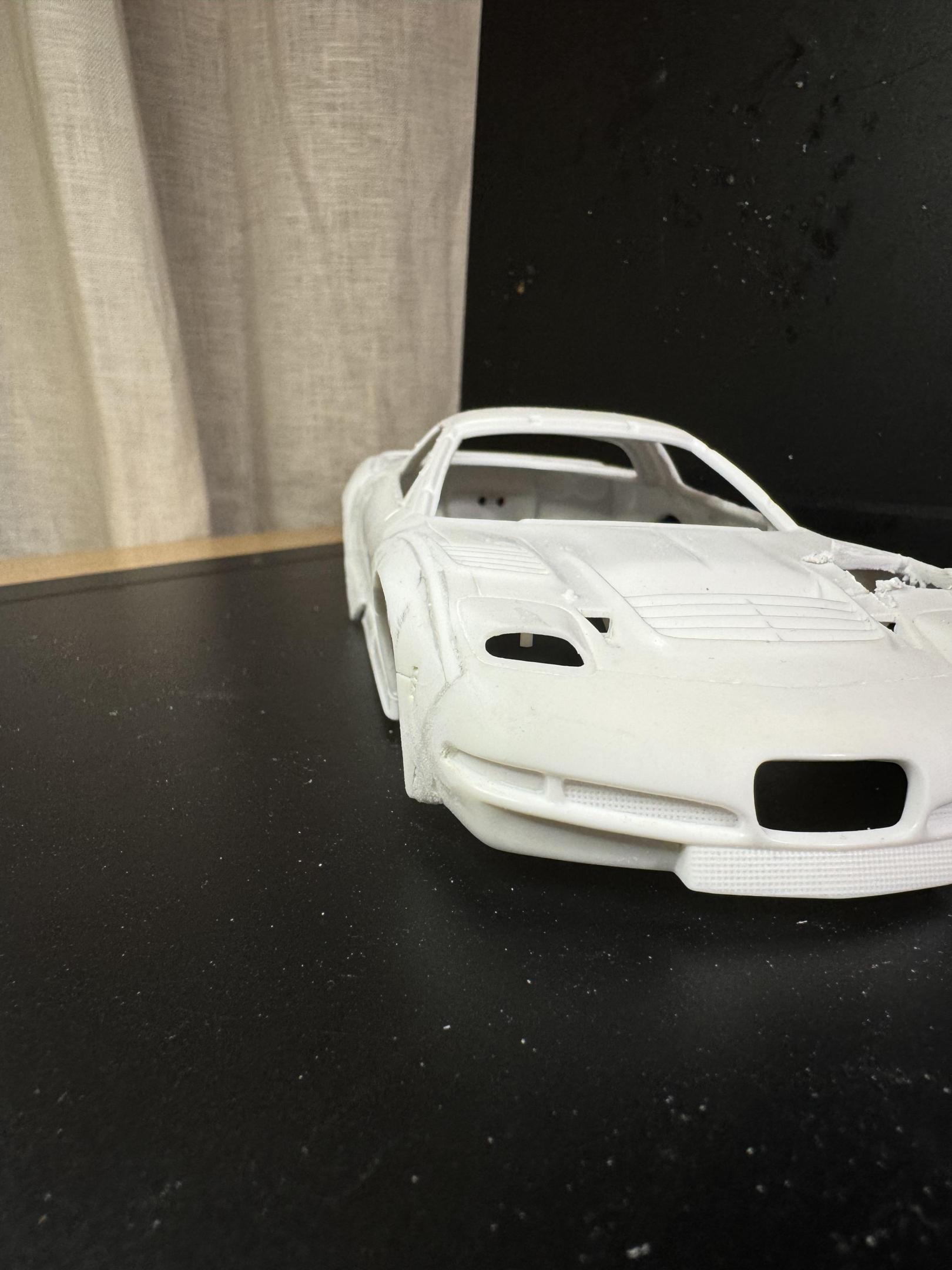

well on to the progress, I tried to thin out the body in many places to be able to look more in scale, but I went to hard in one spot on the hood, thought I had to do a nose transplant from the C5R Silverado body that is left over from before, but I managed to salvage this one.
I then cribbed the hood out and I am now in the progress of filling the gaps a bit with CA and baking soda.
I have opened up all vents in the front but decided to leave the sides of the front grill so I have them as support when making my mesh.
Right now I working on relocating the filler since the LM cars have it on the LH side behind the drivers door.  And only a mesh outlet in the back.
I will also be making the later intake since I like the all carbon intake. That will also result in relocating the coils.

D9841CF5-B483-4A94-ADB4-84D31E4F9BF6.thumb.jpeg.8a470785cfeec0682ad38843416f40a4.jpegF99BB06E-4A98-4D02-A287-6B29B130FDB6.thumb.jpeg.6df77fd3a85dd291a90925c3c9c835ee.jpegC4EFBB02-4736-4CEE-ABB9-3D904EF0E60C.thumb.jpeg.bd64a4c74aac7fc91643820e8b89598d.jpeg

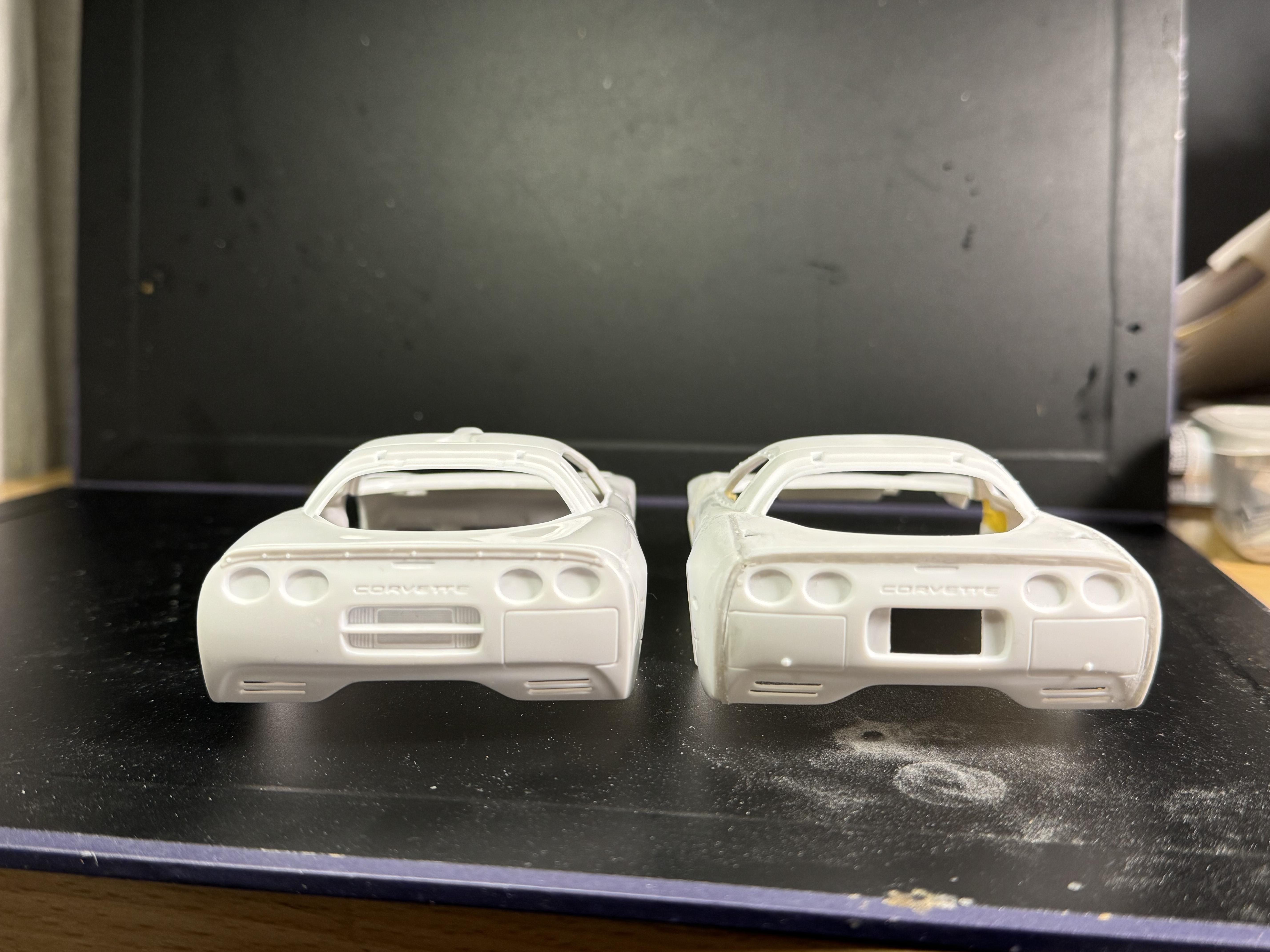

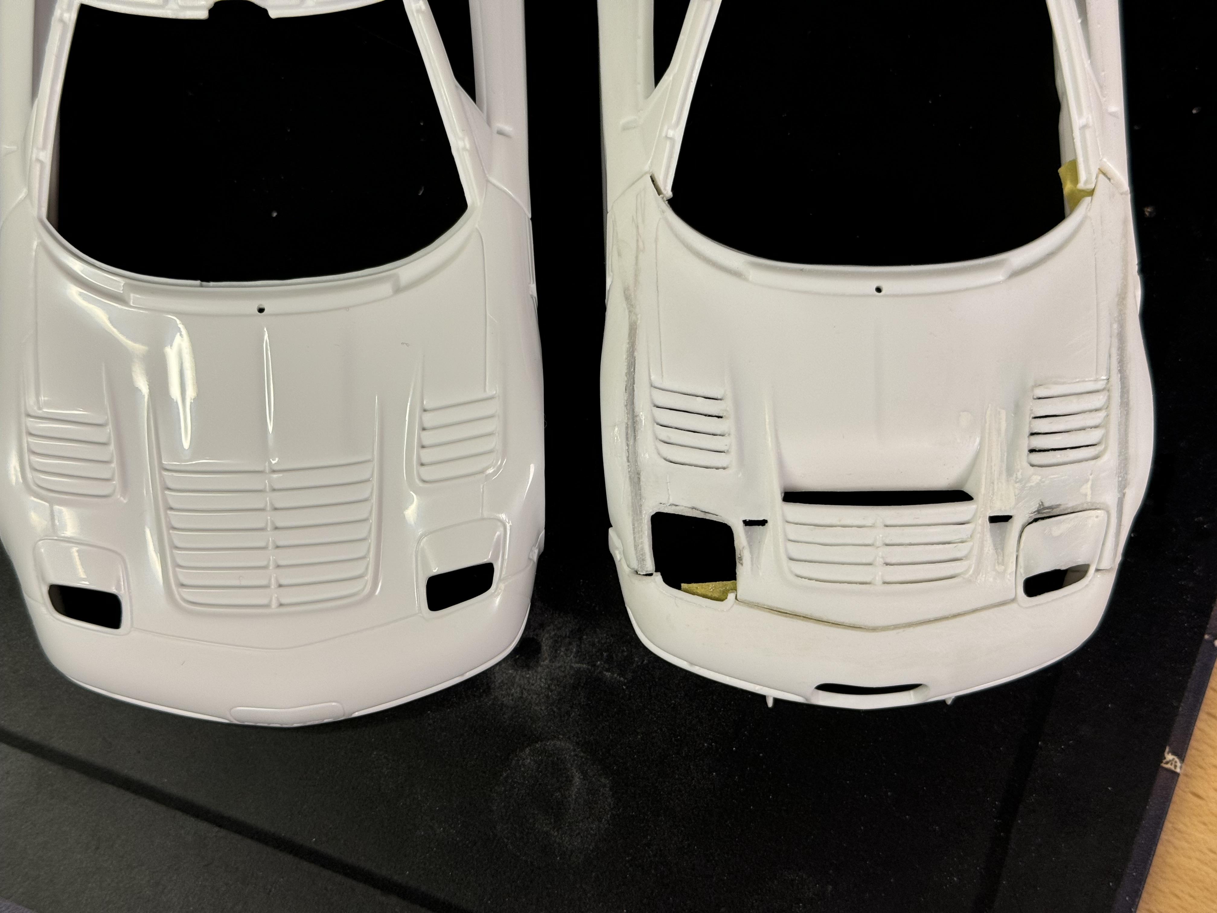

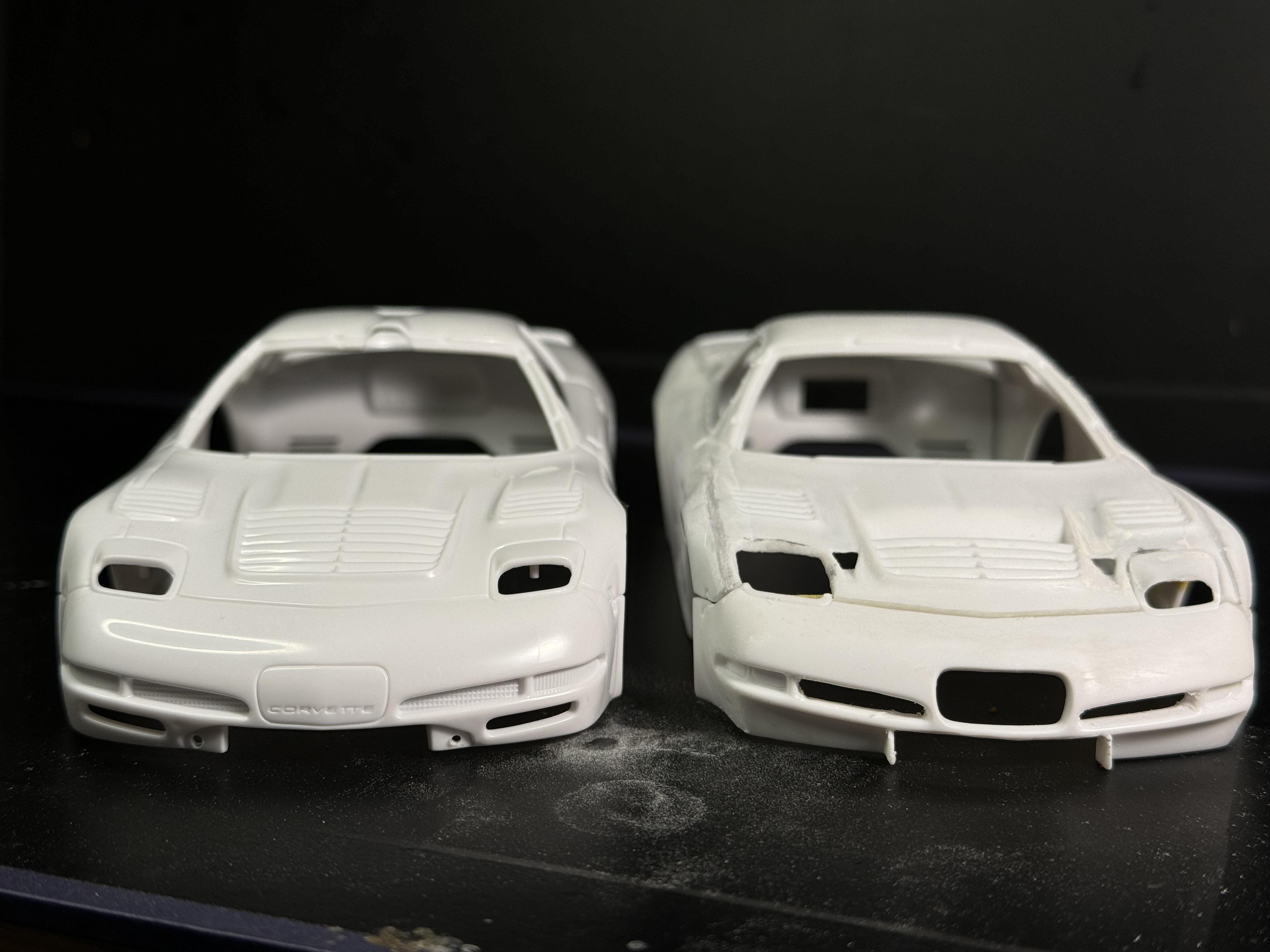

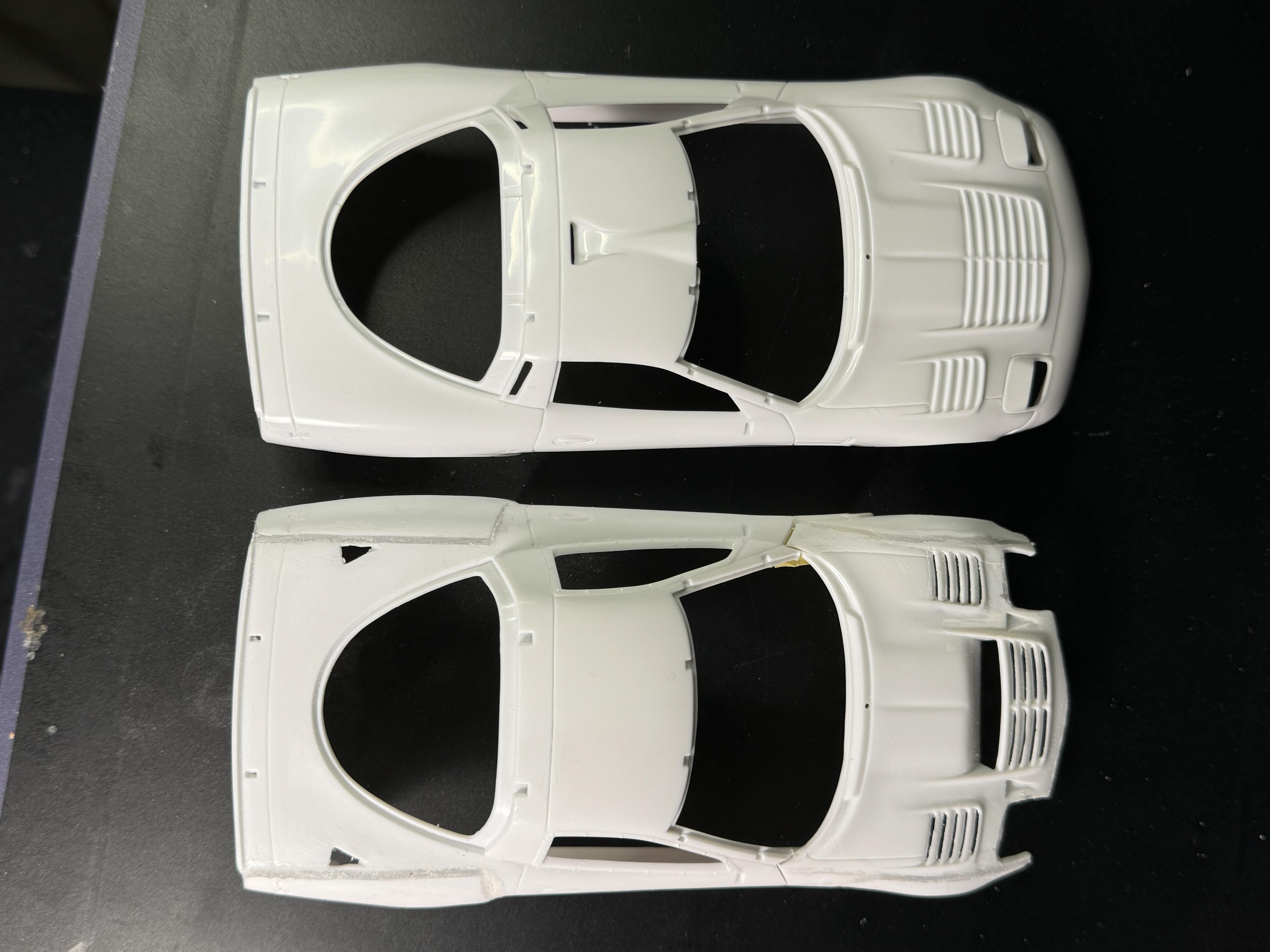

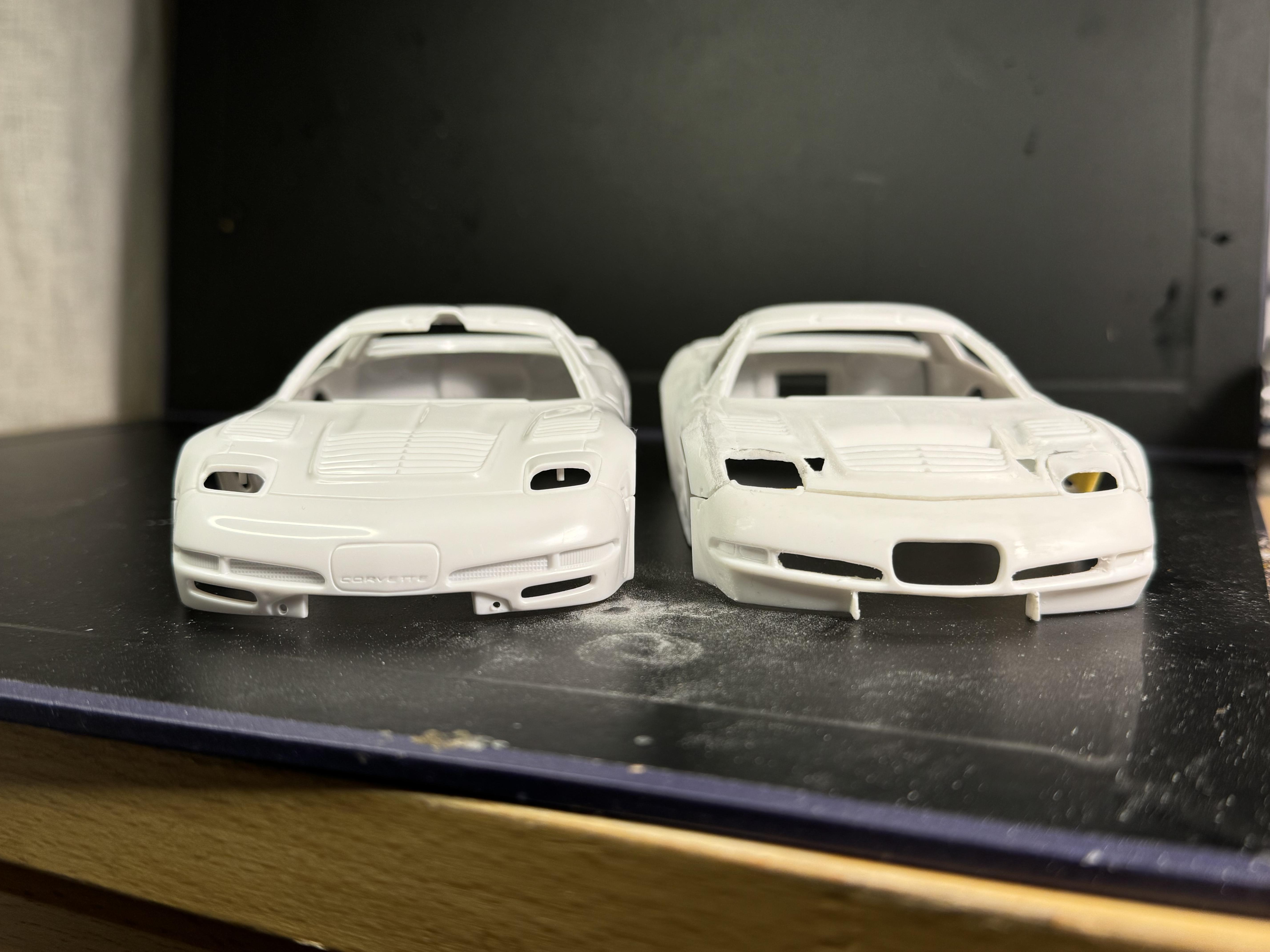

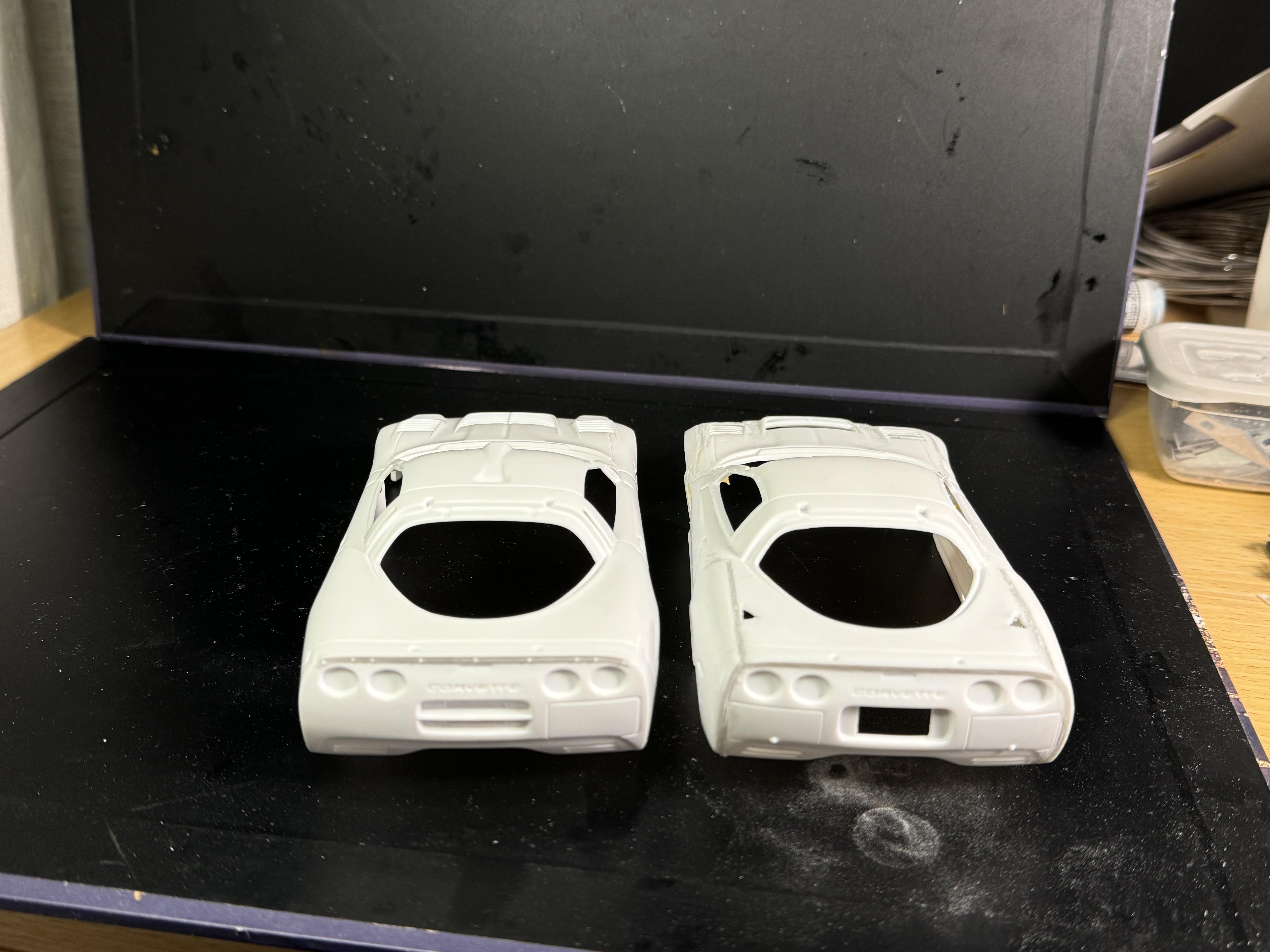

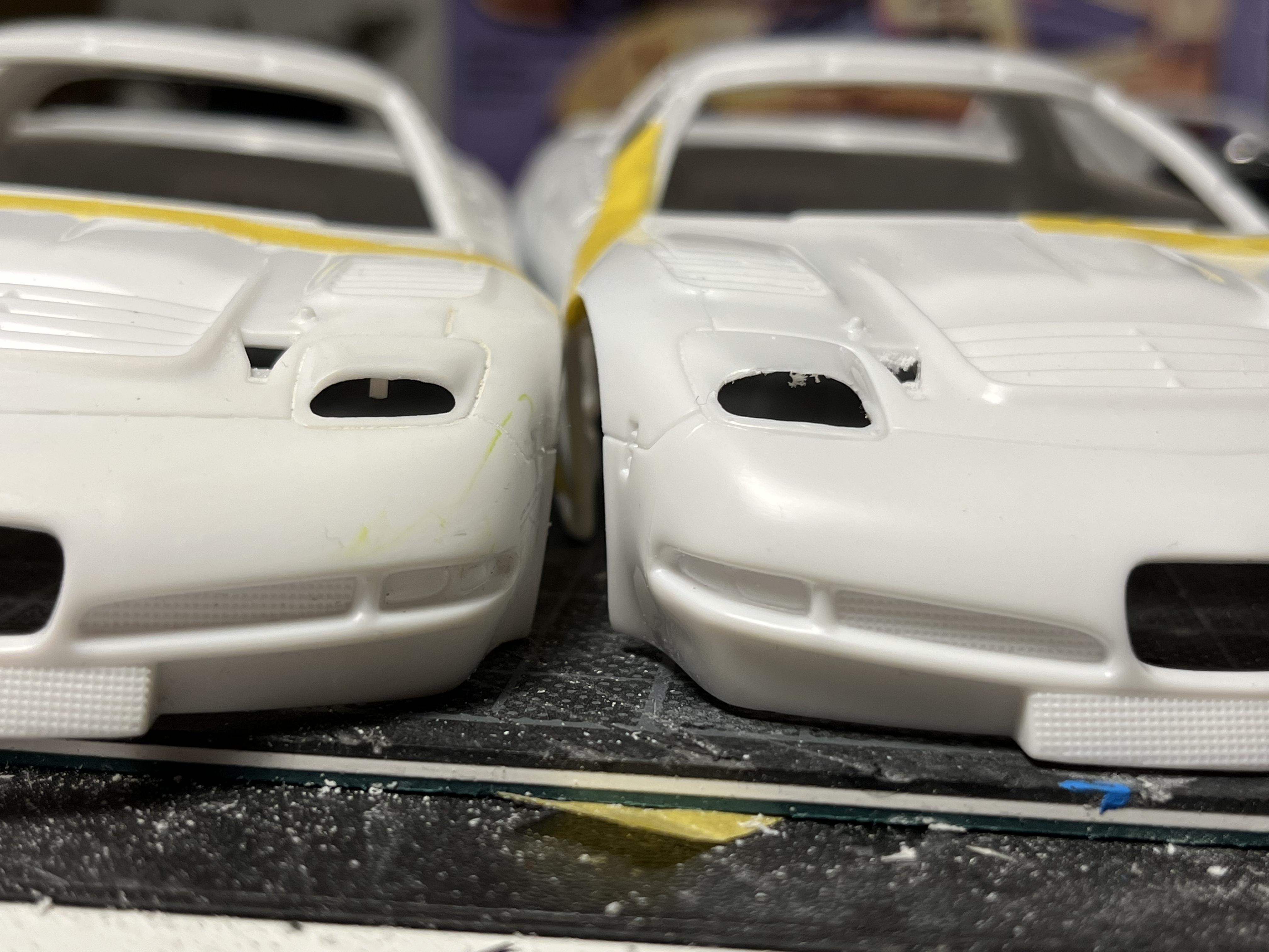

i am trying to improve all the areas I just can’t stand on the revel body. The window frames toils have been 25mm thick if equal in 1:1. Also the air outlets are to small. As well as the lights are way of.
Here are som comparisons.

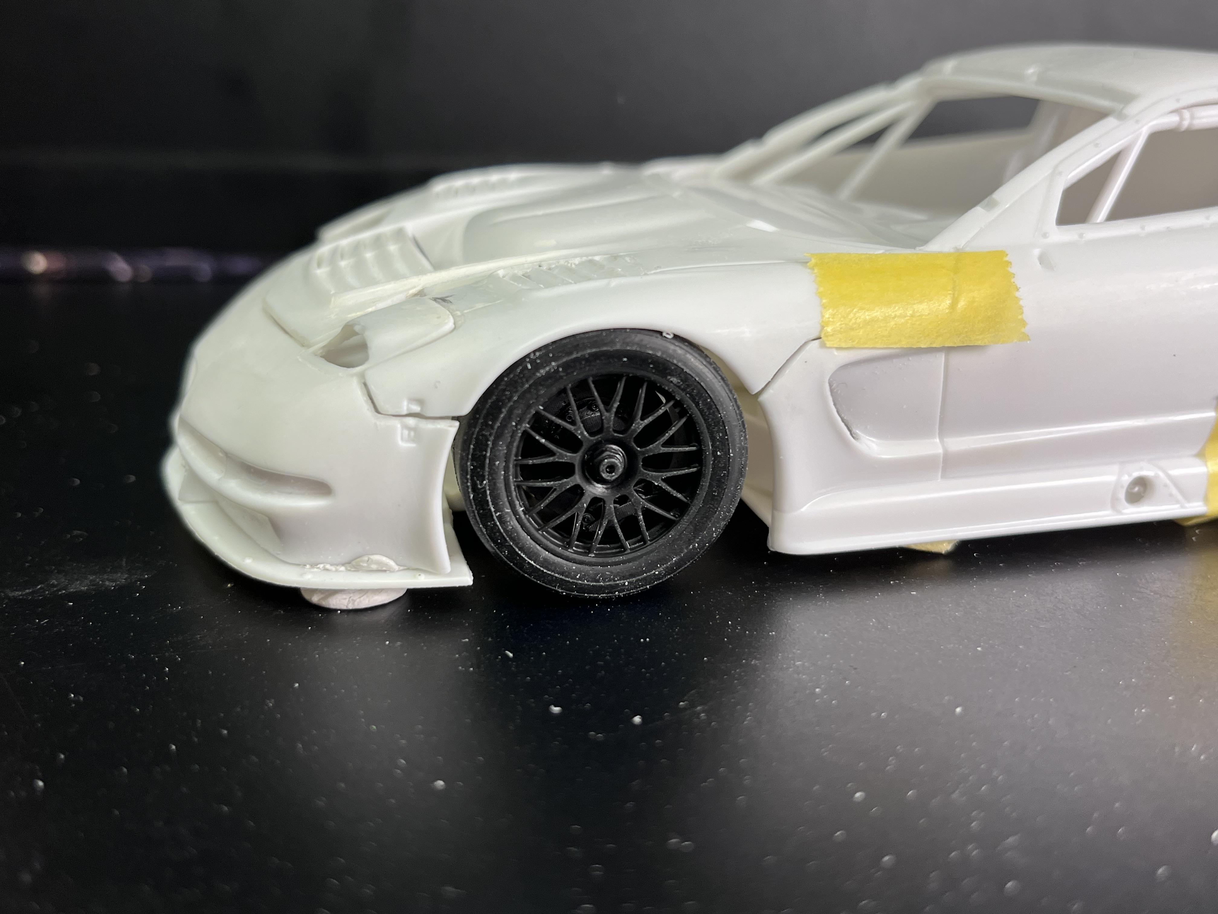

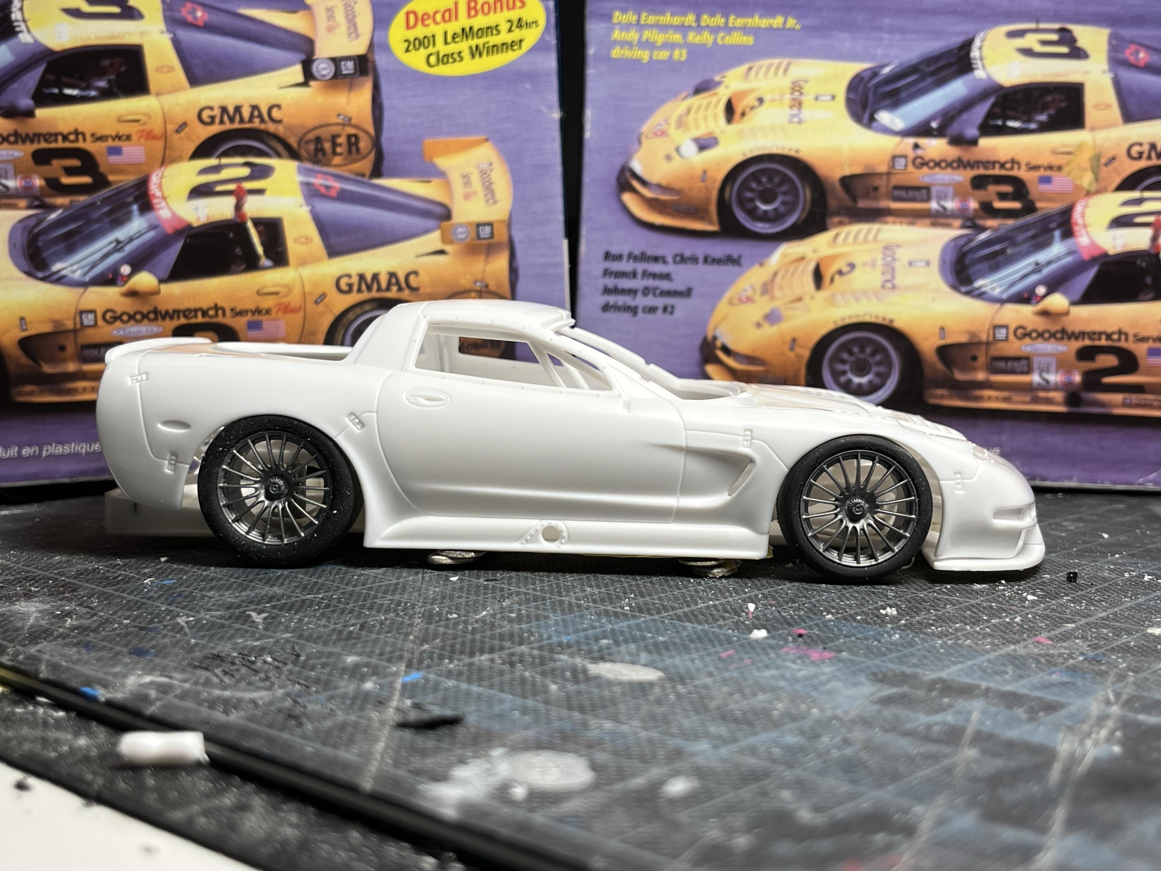

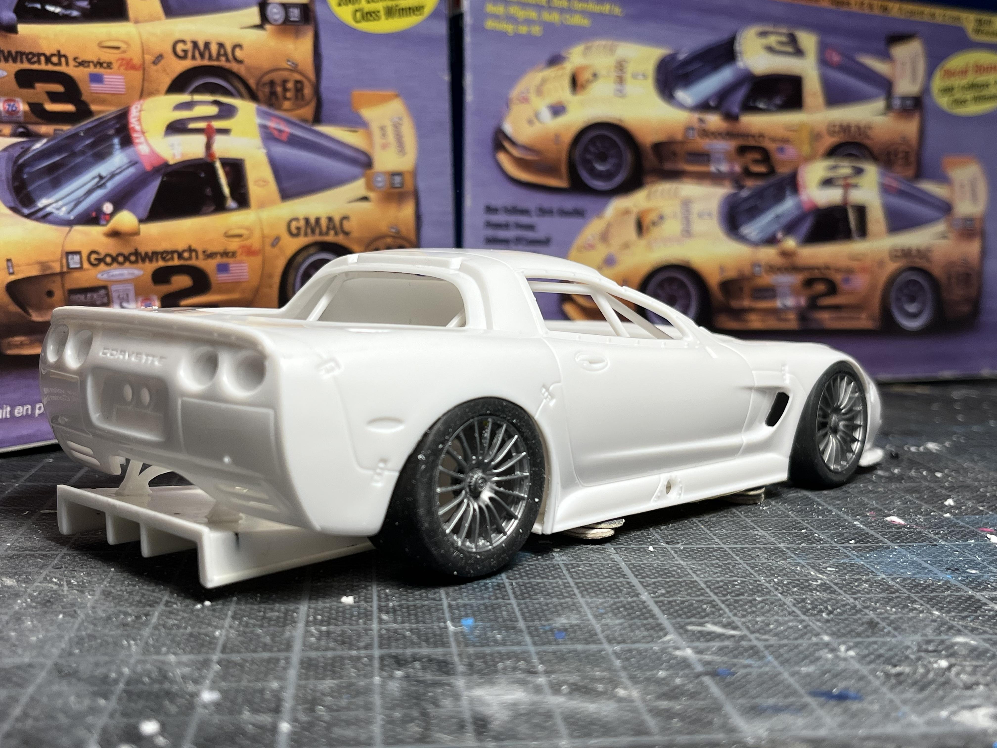

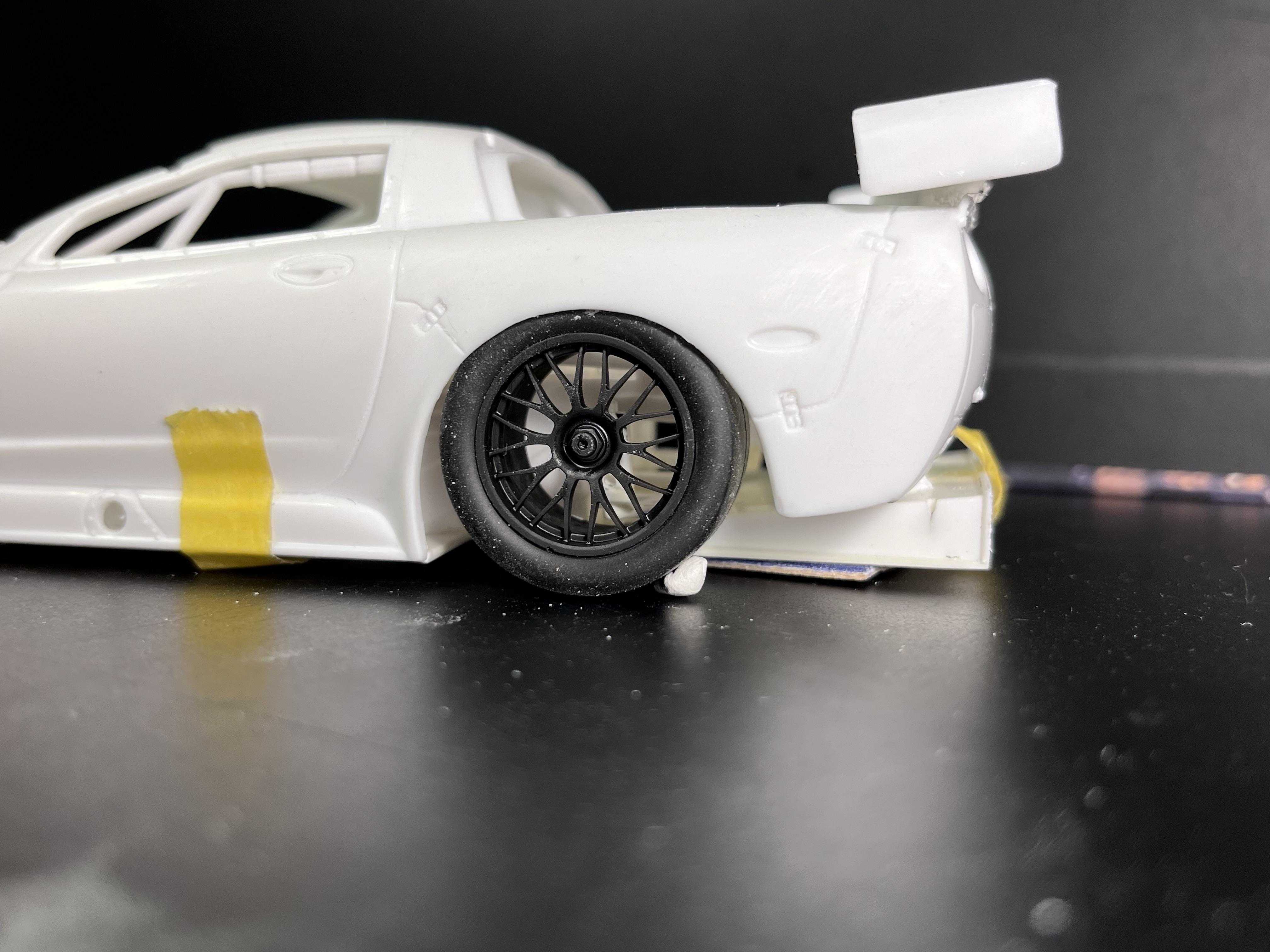

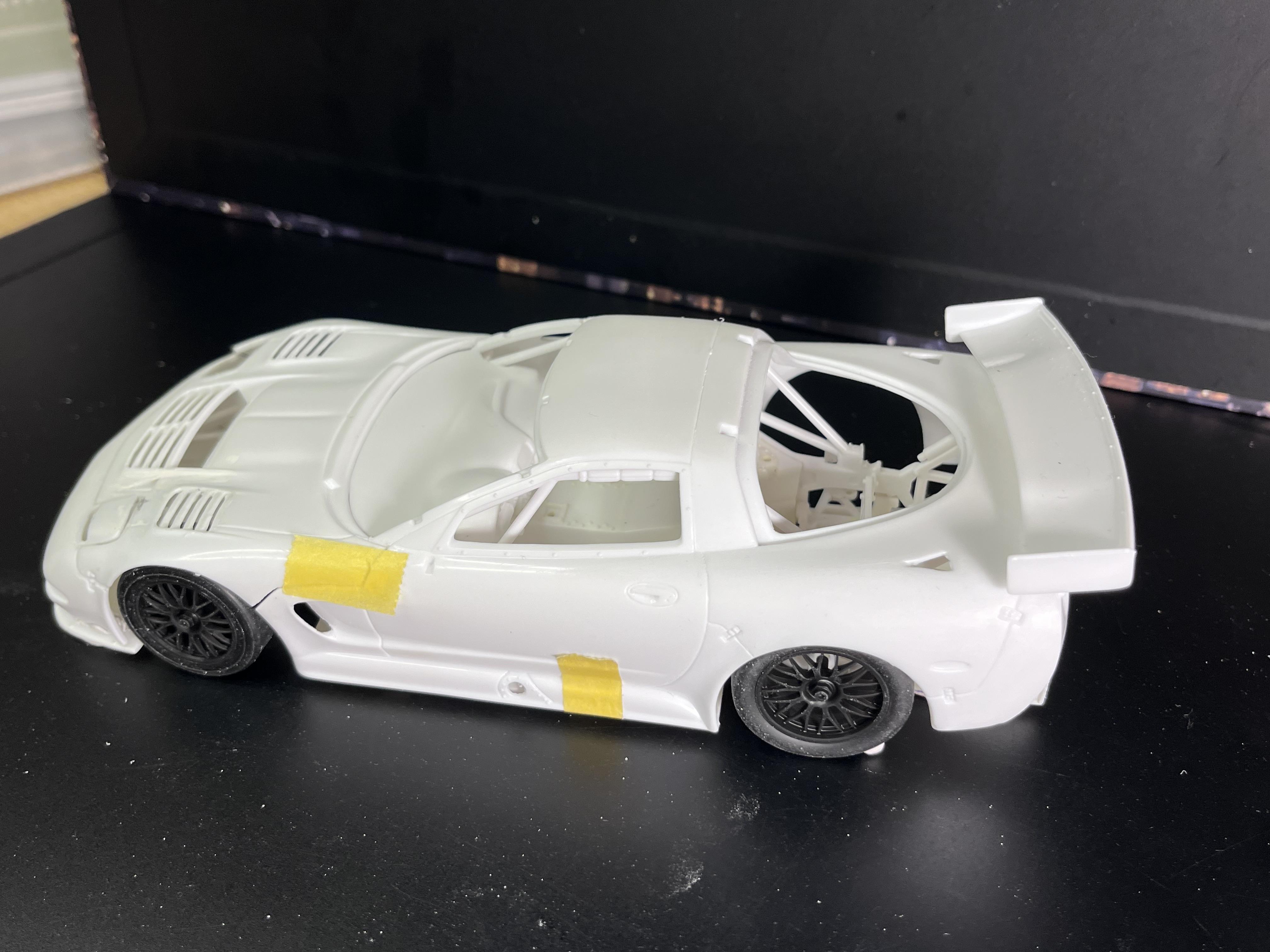

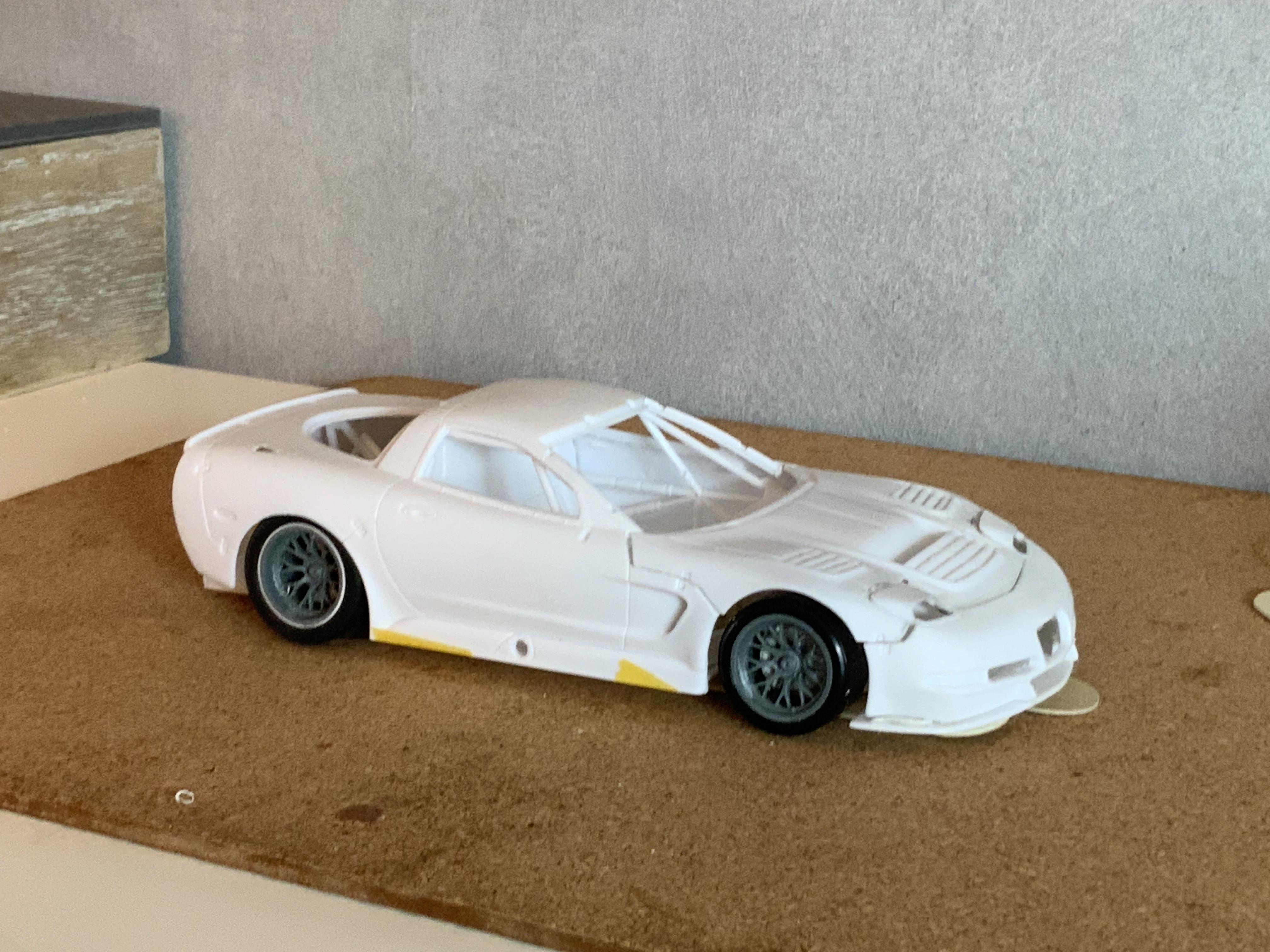

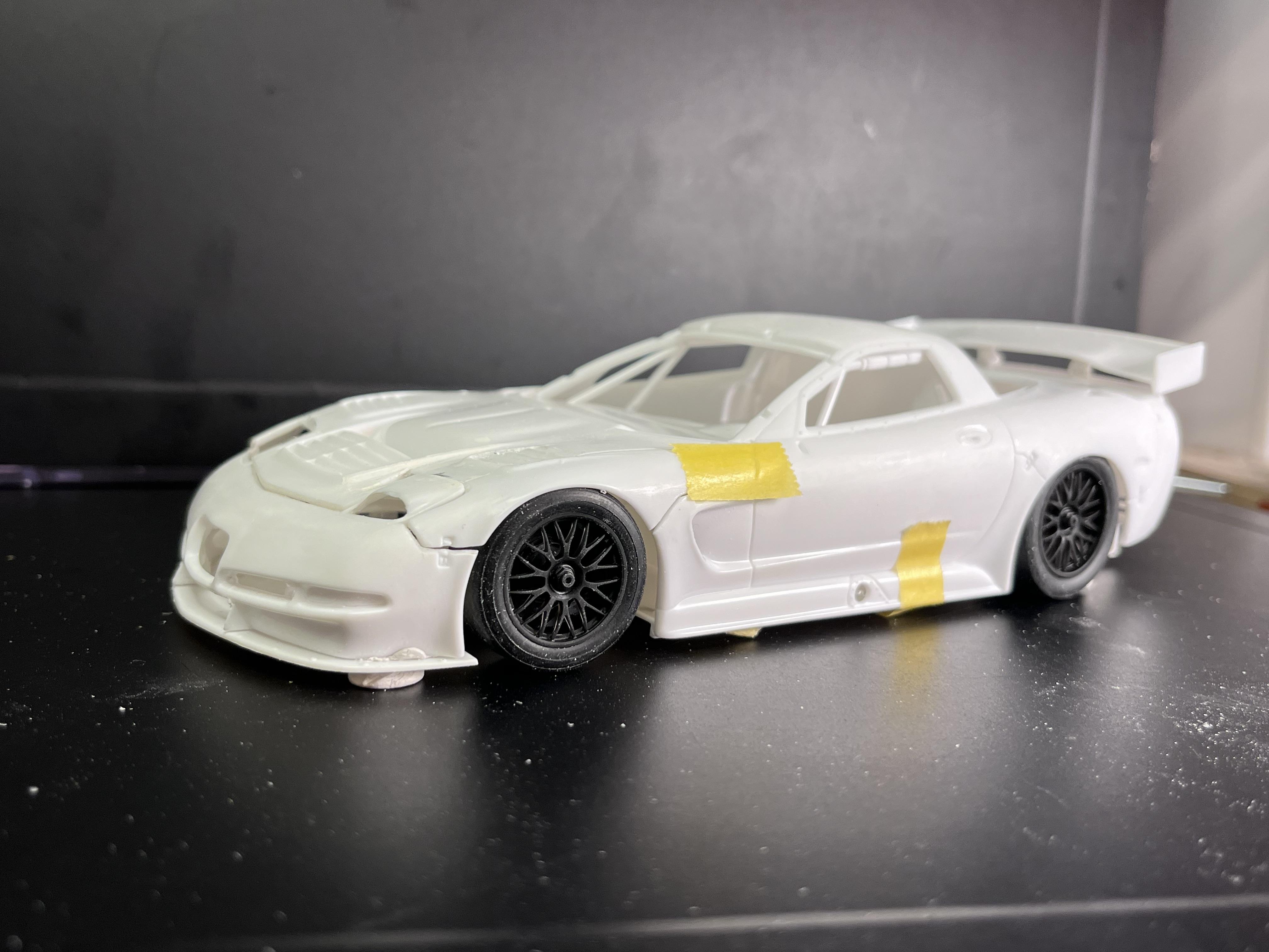

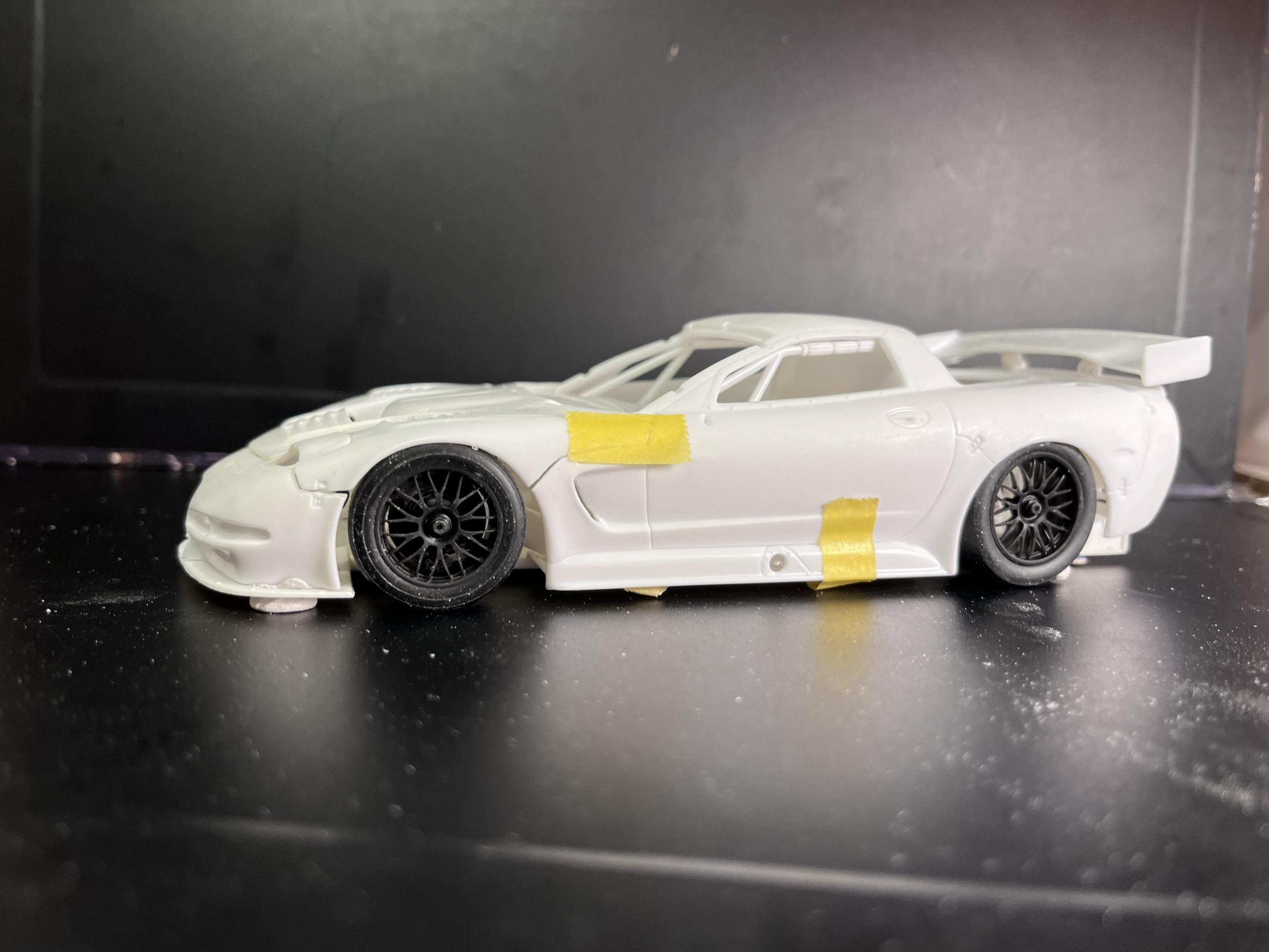

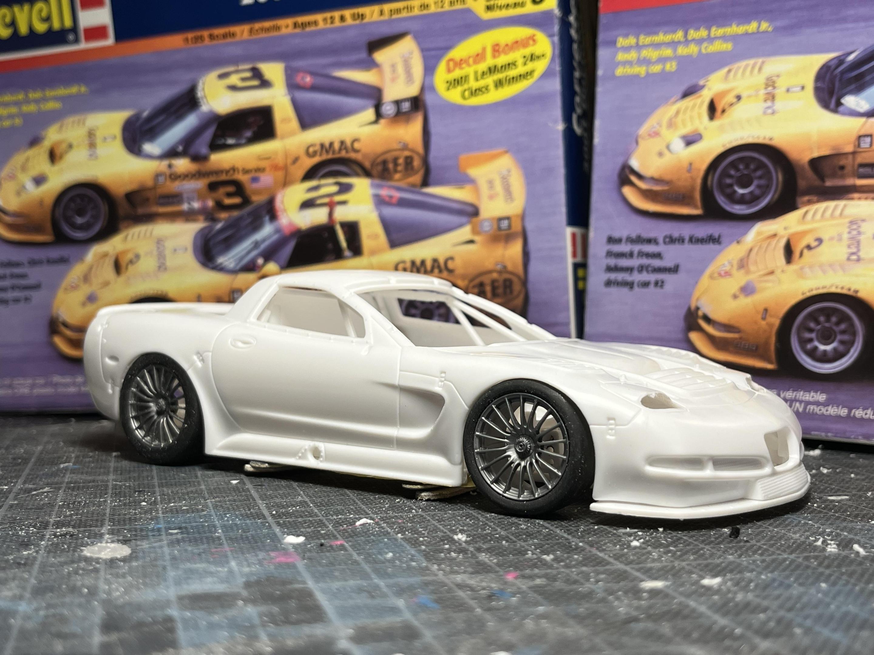

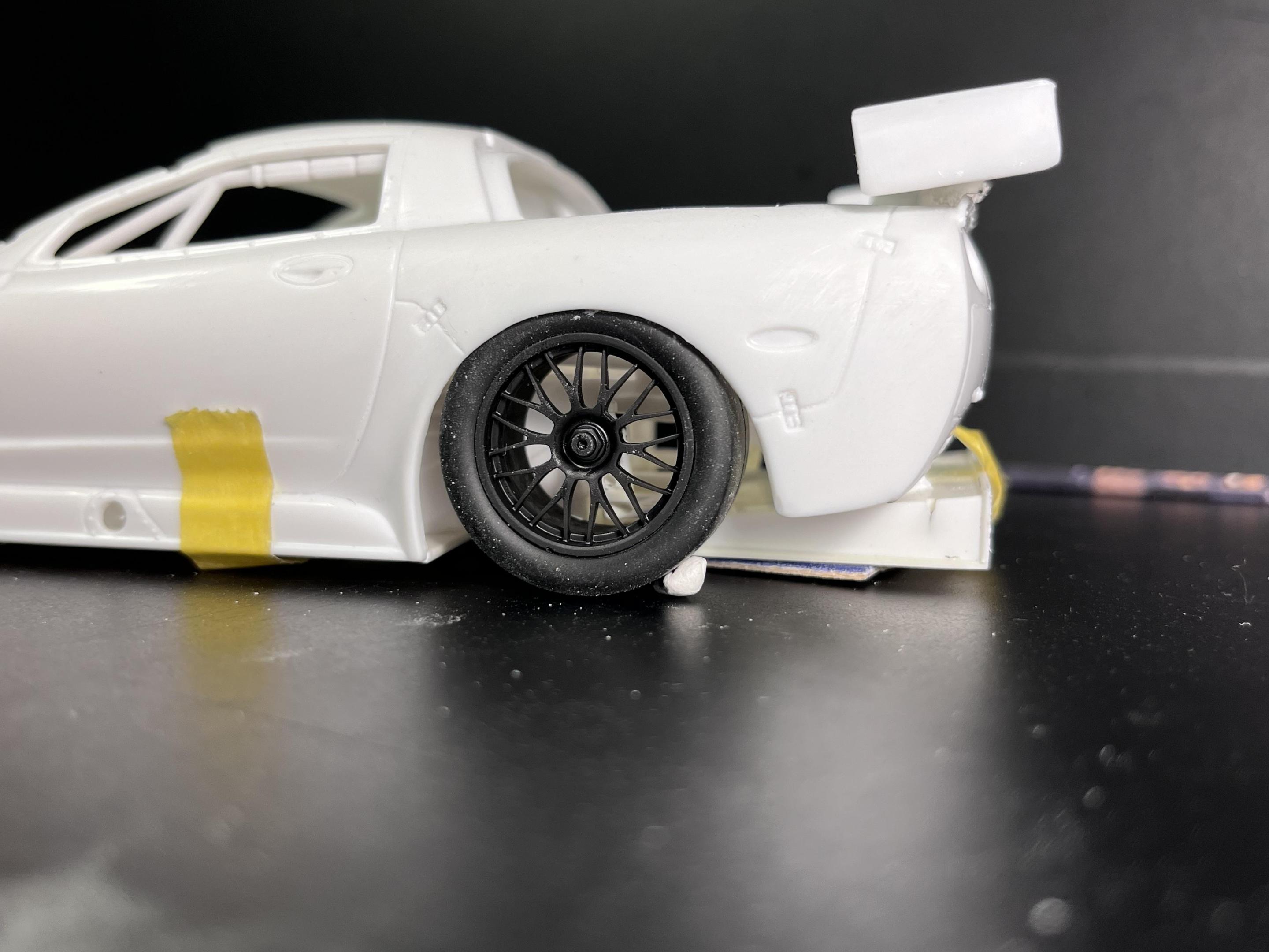

Som pics from today’s progress and with the BBS wheels. Here can be seen that the ride height up front needs to be adjusted.. and I would like to have posable steering. I sorted that on the race truck in one way, let’s see if I can fix that here as well. Body seems to ride high on the rear supports for the wing which results in quite big gap between diffuser and body. I think I need to upgrade the front brakes, they look to small in my eyes.
IMG_0819.thumb.jpeg.02a38131f652a661d802c30a535b40a2.jpegIMG_0821.thumb.jpeg.35e4e2a97cc388e3d3f73ce912c79972.jpegIMG_0822.thumb.jpeg.0018649825ad111b35bfe08aa05ec59f.jpegIMG_0823.thumb.jpeg.c0b08747dfd6bb0a4c9f21b9be3ab91e.jpegIMG_0826.thumb.jpeg.51eaac70da9637311d6f1416e41a836b.jpeg
Any one else that have built this kit, does it seem like the body is to tall? I am reffereing to the cage that is clearly visible in the side window. Also the difusor seems to be to close to the ground and to long for the LM variant.
I know the later cars hade completley differnt diffusor and intake system. Thse also ran an other air inlett during 2002 at least but at Lemans they did have the naca ducts.

Here is the ride height of mine since i lowered the front, the gaps are also looking better.

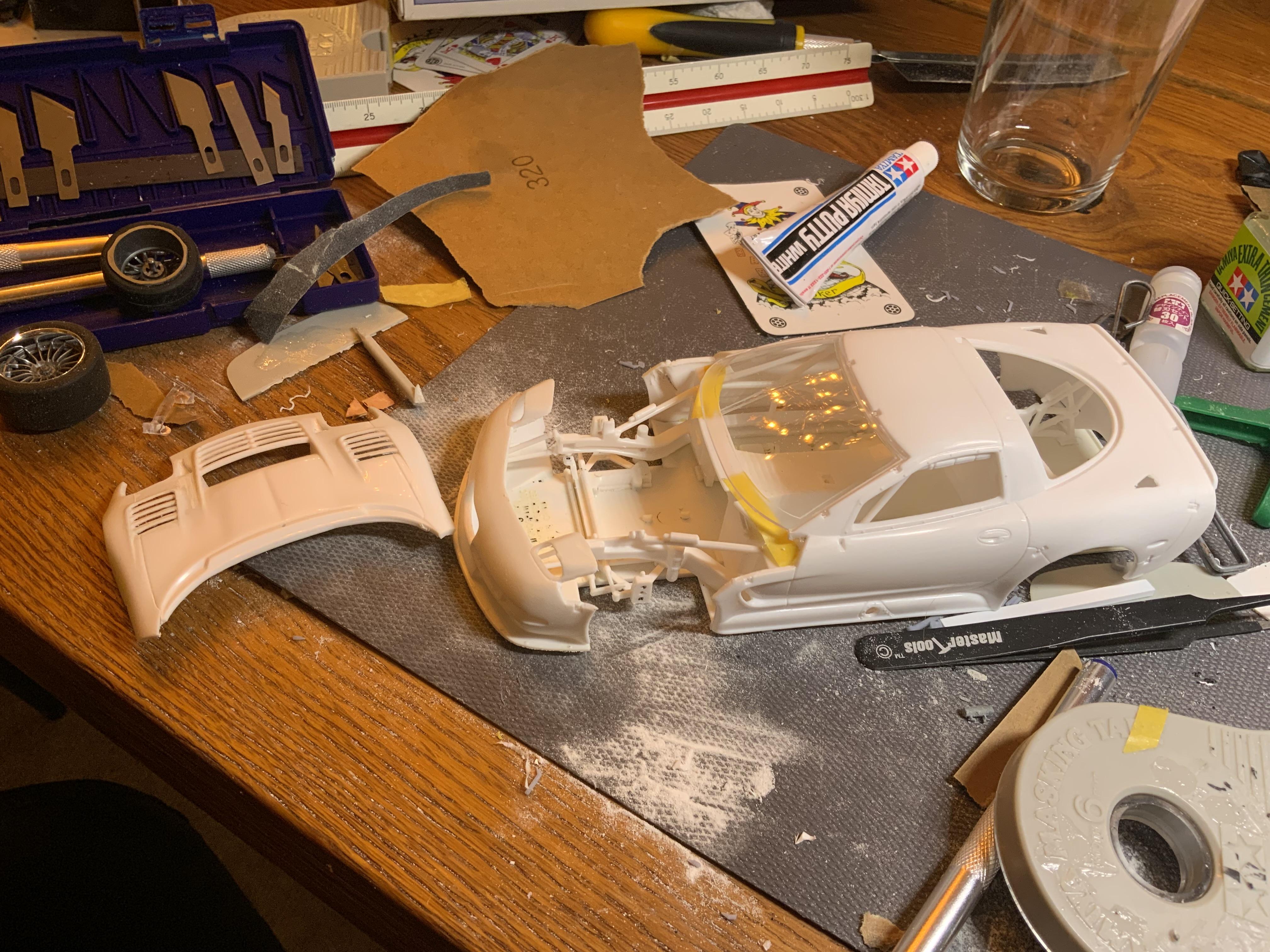

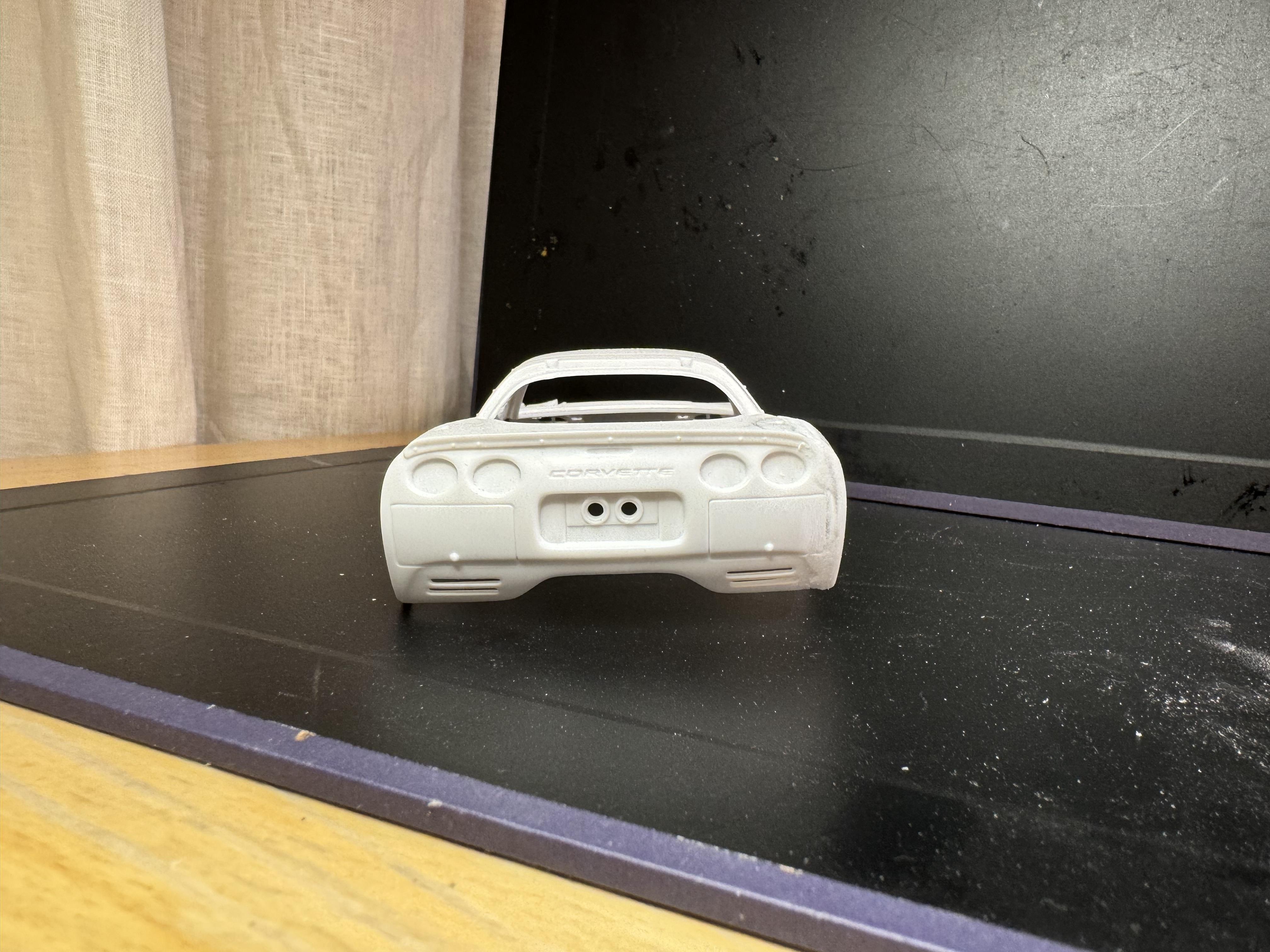

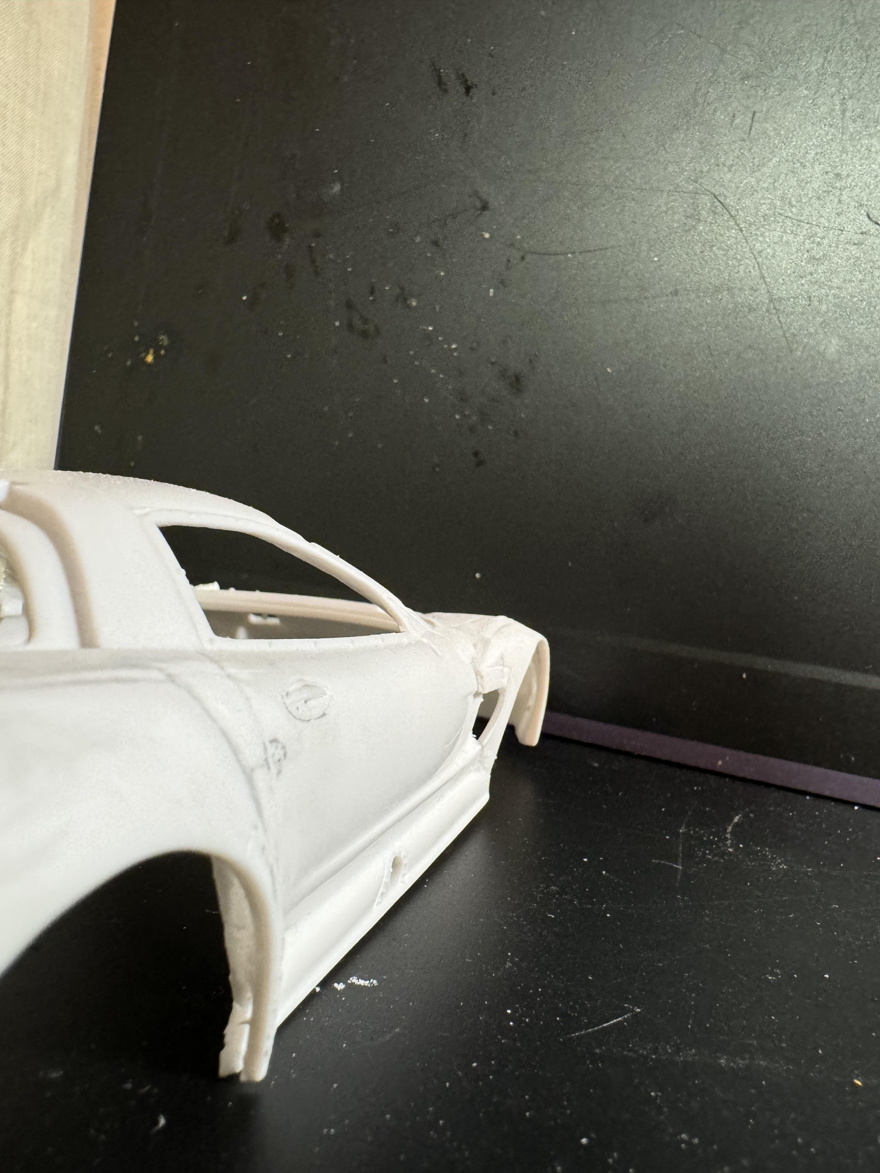

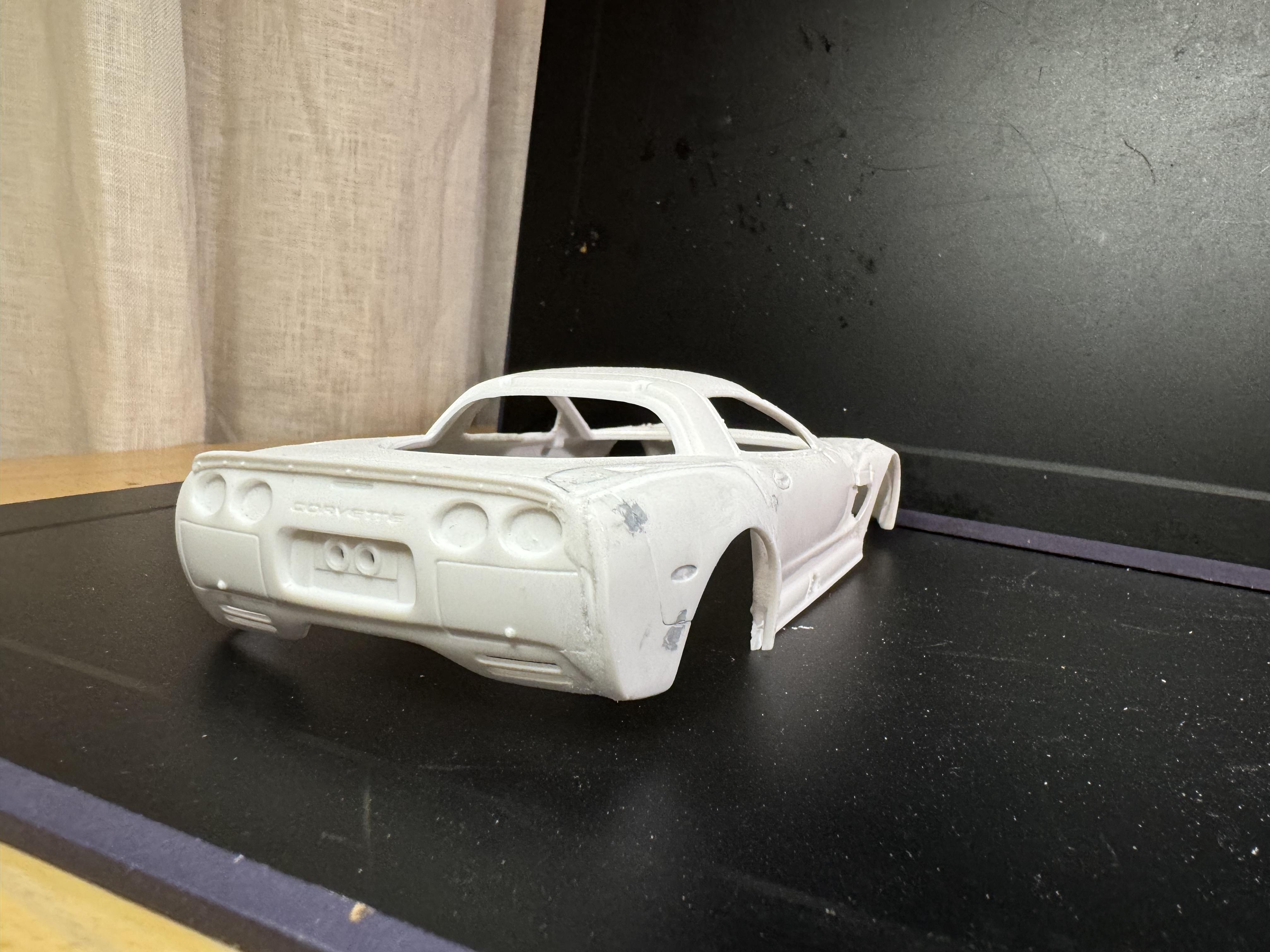

I have, as I wrote, had a problem with the body since the kit actually is chassis 001 and 002 with the narrow body. And in late 2000 they built chassi 003 which is the one racing in 2001 and which also has the most wins, 10 out of 17 races.
So the 003 chassi and all the later ones are actually 3 inches wider than the two early cars.

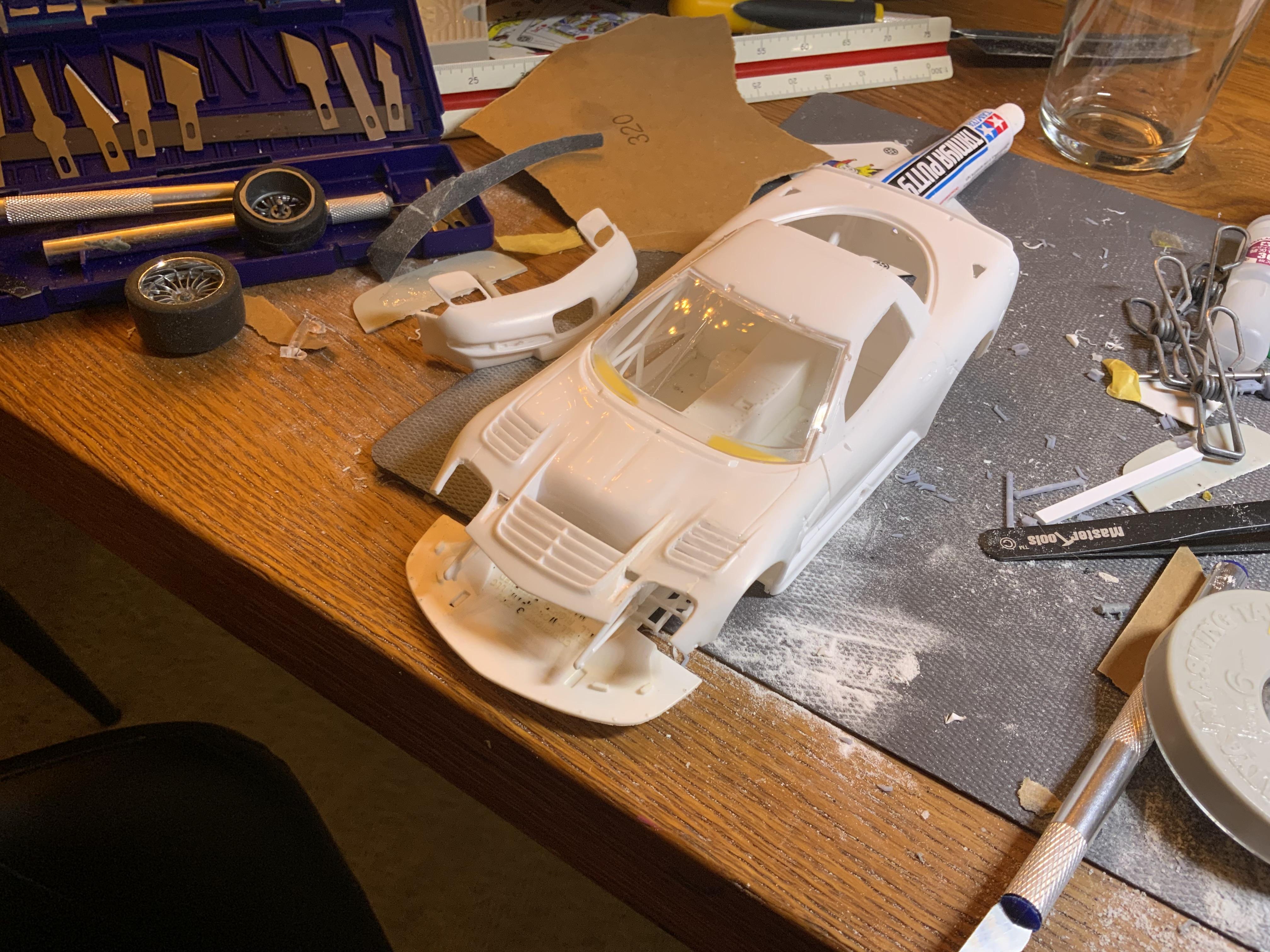

I wanted to replicate that wide body and after studying al photos I can find on these which I have managed to gather allot! I draw the cut lines on the spare body and went ahead. I extended the gap with a 1,6mm rod which compensates for the cut as well.  So after the test run I will try the same on the actual body.. I just regret not doing this before cutting it in al its parts!!

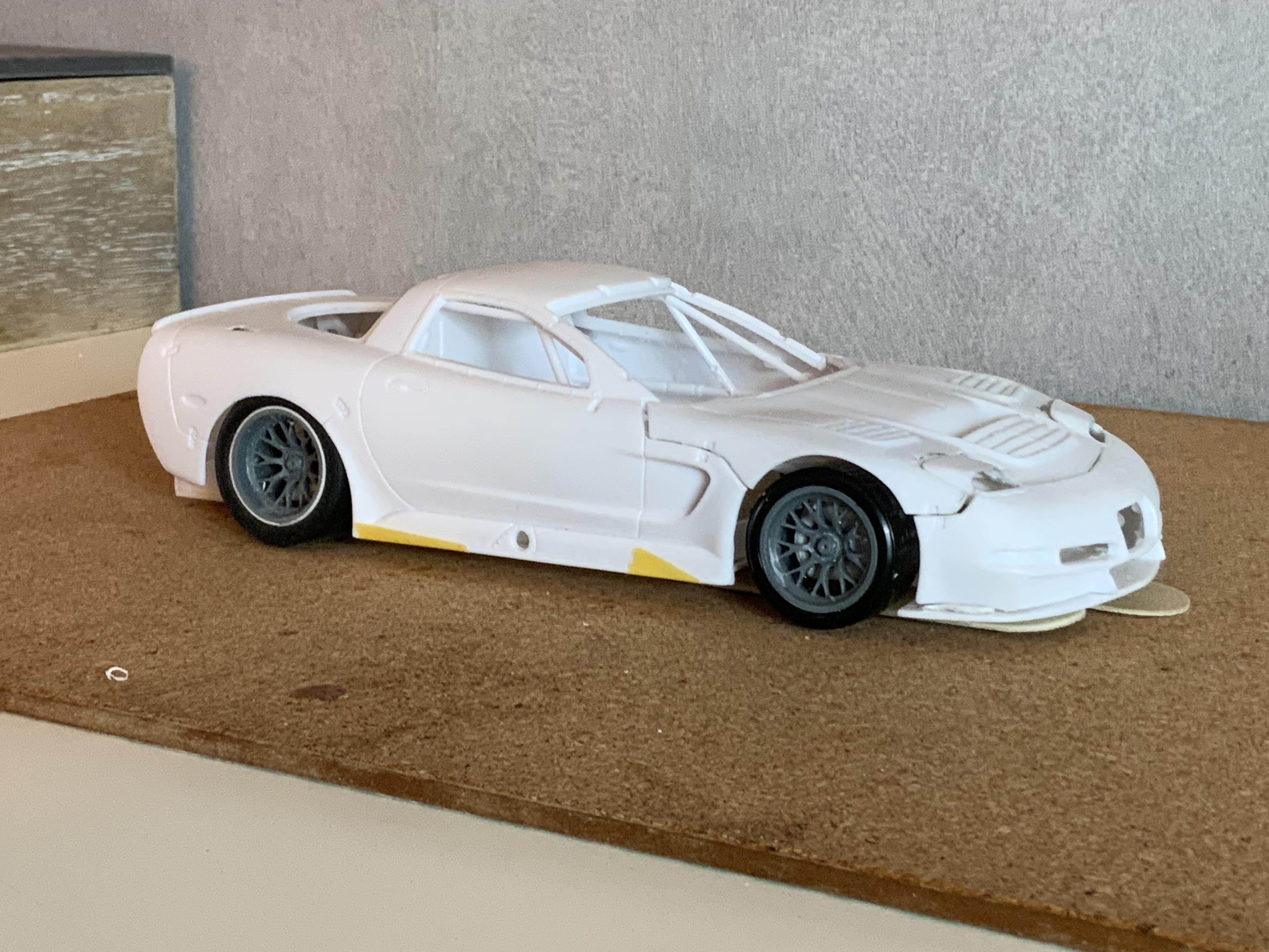

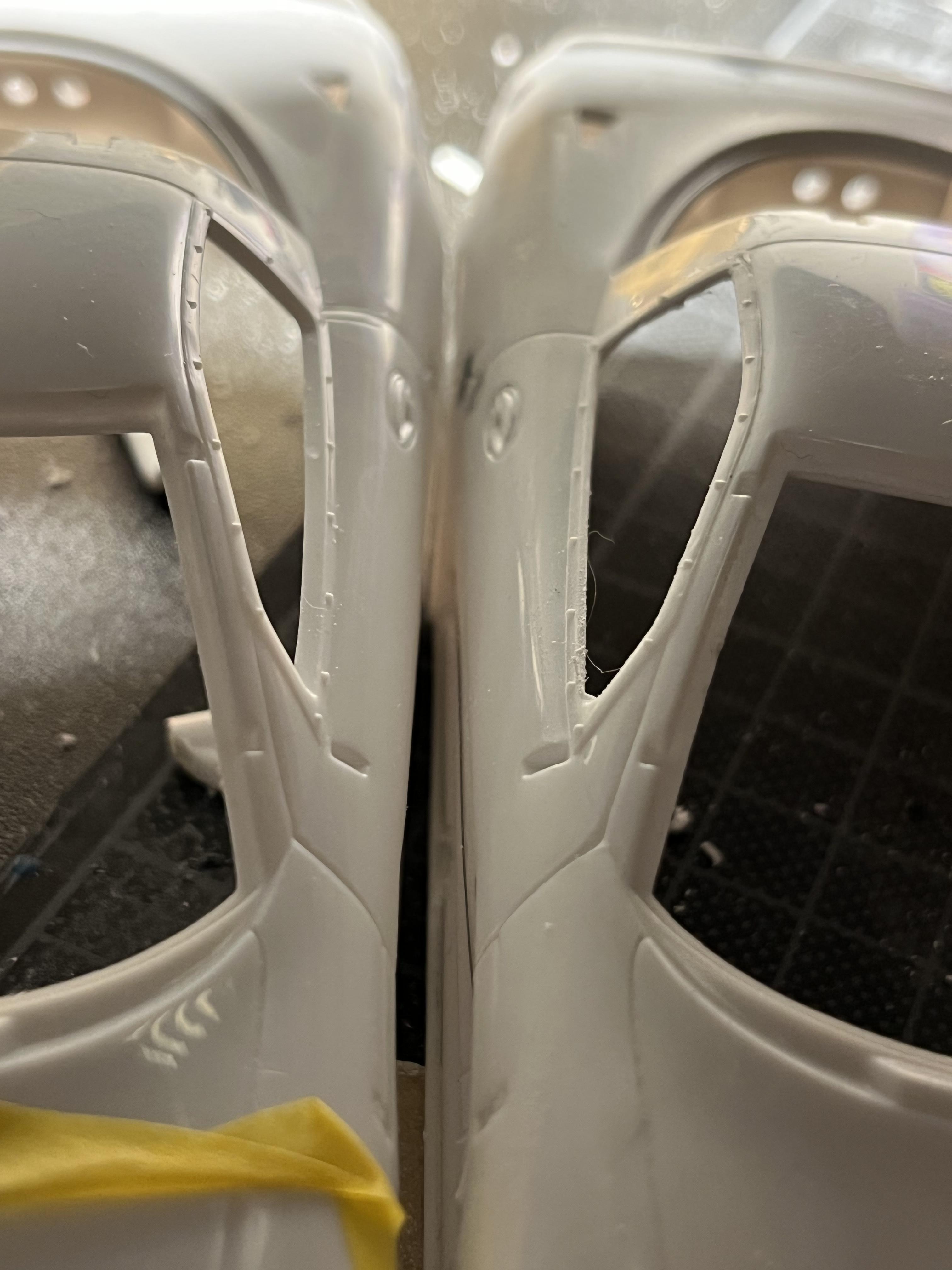

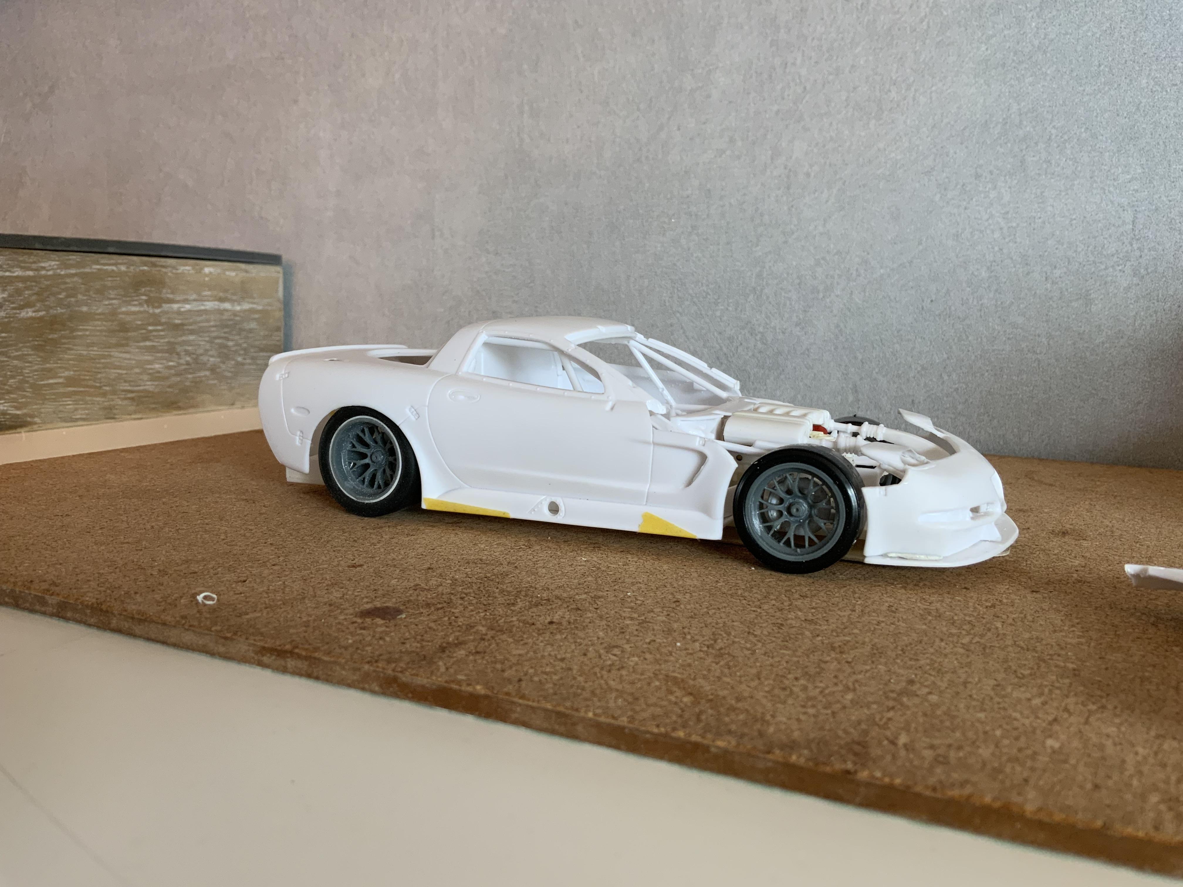

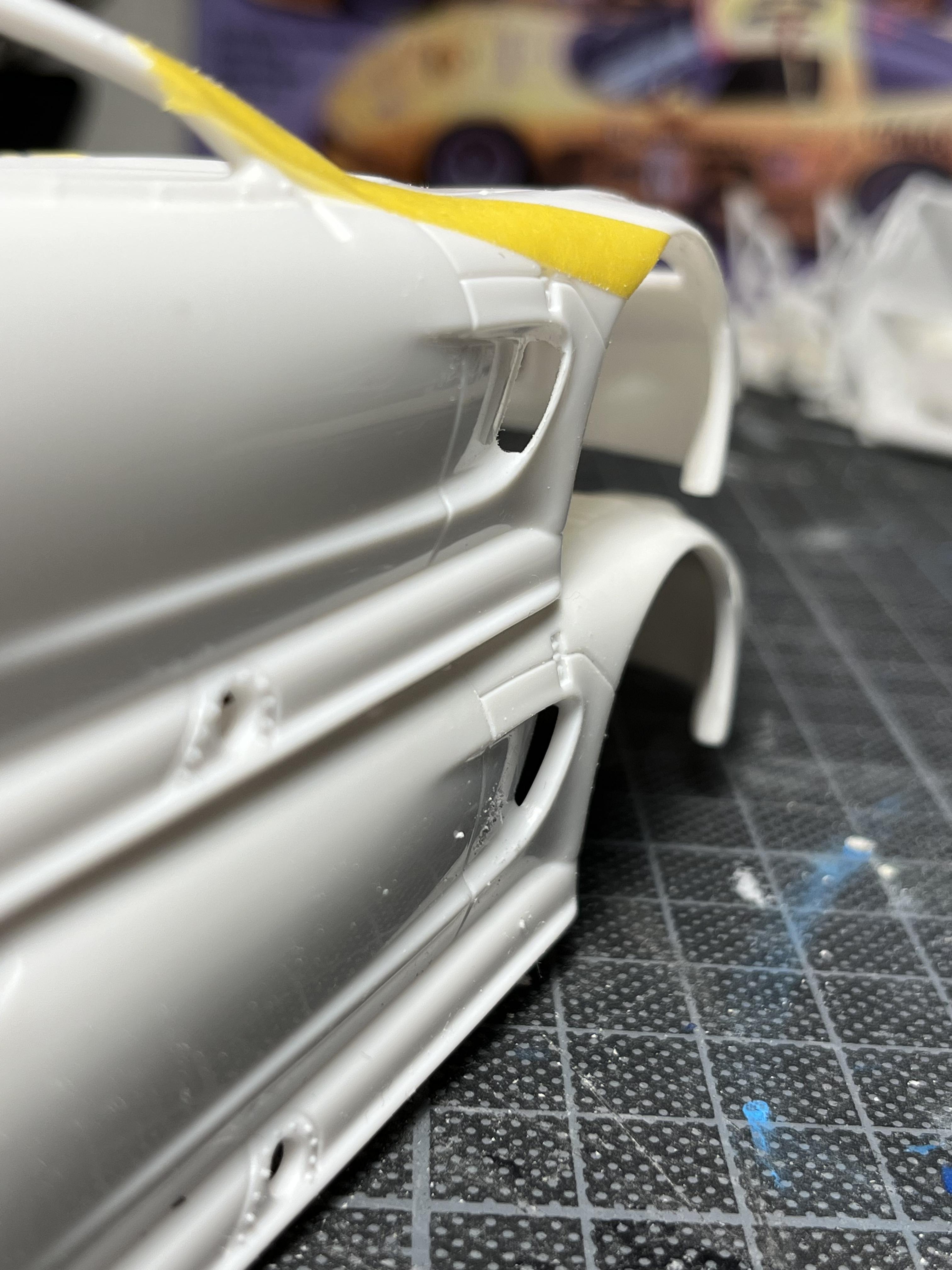

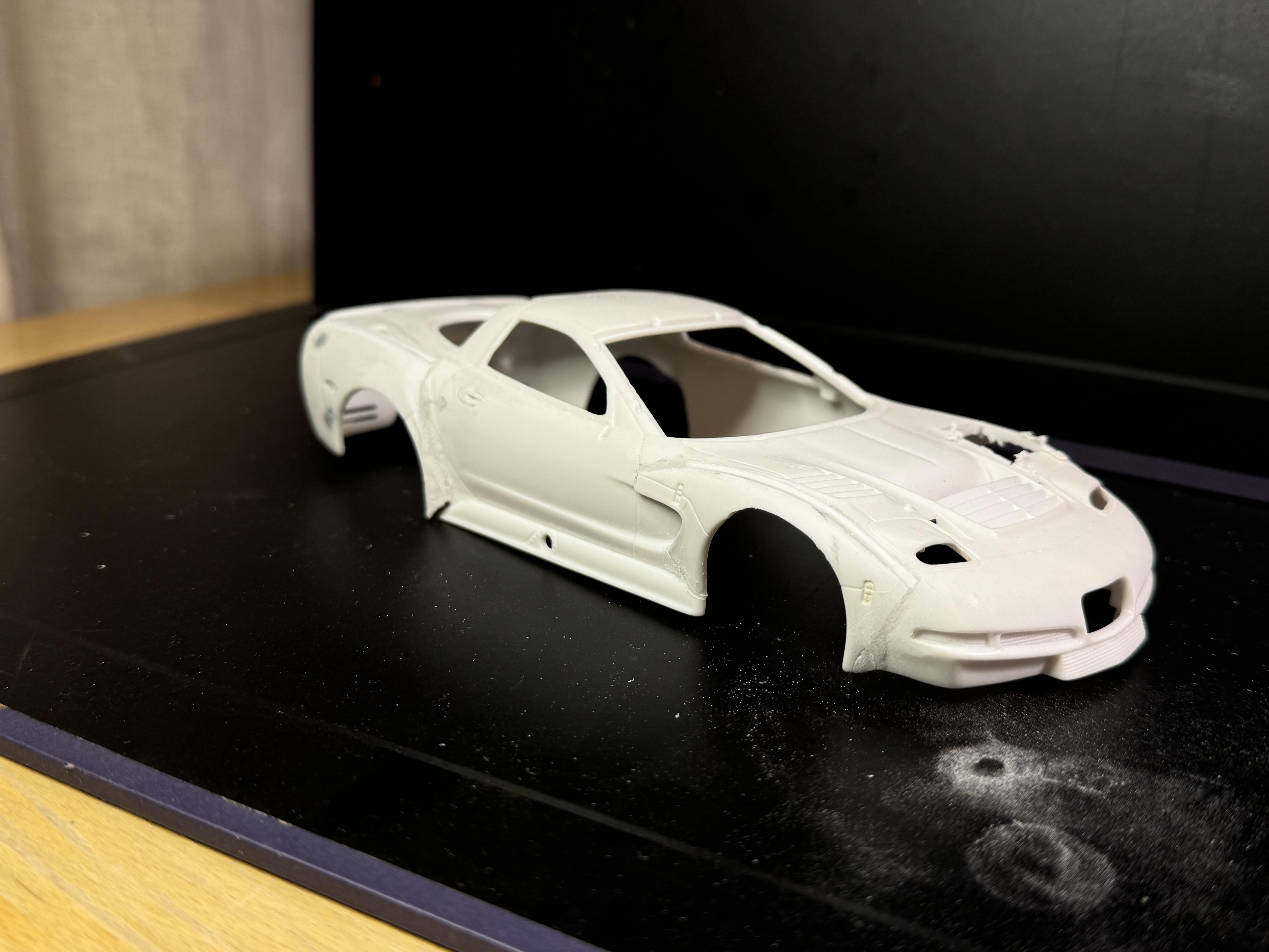

So i have cut up the body and made it 1mm wider on each side, front and rear as the original chassis 003 and 004. Which made the lines to blend better than in my experiment above.  here it can be seen next to an other kit body, which would repressent version 1 of the body and hood if i have understood my sources correct, my thought was to build 2000 LM and 2001 LM but the body that comes with the decals for 2000 LM is not the correct one, the 2001 body is actualy more correct ecept for air intakes i guess which was different on chassi 001 and 002.
