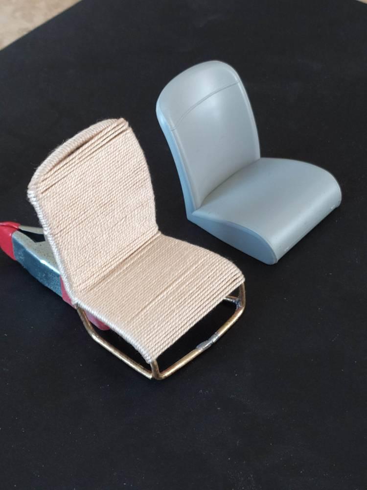

So i made a frame in brass rod and i made a first trial. I just took some wire and wrapped it around the frame. This is the result, shown together with the original seat.
IMG_20220517_163753.jpg.001676ceb9d1468aaa70ab7b763d1354.jpgIMG_20220517_172002.jpg.d60b9d792a467f84727e4c0c82e50528.jpg
It was immediately clear that this solution was too simplified and was lacking visual appeal.

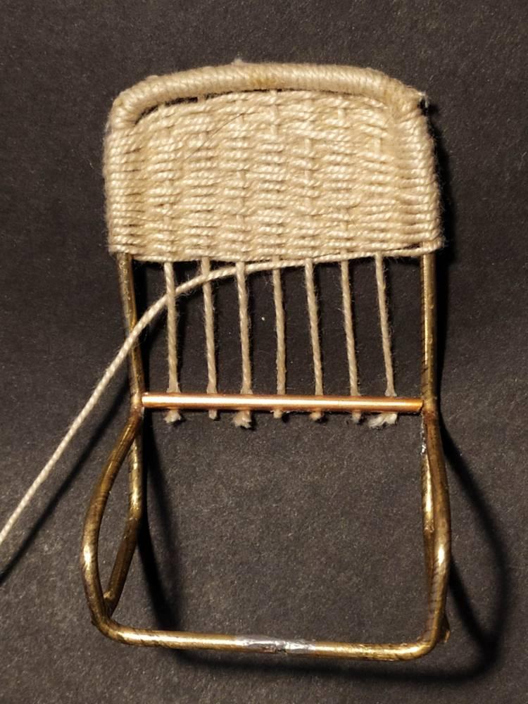

So i tried a better procedure. I crossed the wires, in the same way of the original seats. I prepared just a small part of the seat.
In this case the wire was completely out of scale and the aspect was very poor. The sewing thread also was very furry, really ugly to see.
I went shopping for a better wire, but i faced the same furry aspect. I received a lot of suggestions: the member of a local forum suggestd many different solutions, such as welding wire, nylon fishing line, dental floss ( ! ). At the end, a clever friend told me to try the wire which is used by navy modelers for the intricate spider web of wires on sail ships. This was the right one, The appearance was less furry and the wire itself was easier to handle. I used wire by 0.75 mm for the vertical threads and 0.5 mm for the horizontal ones, crossed on the seats using a big sewing needle.
At the end this is the result. Far from perfect,  but this was my very best. It took six different trials for the driver's seat. Once learned the trick, the other seats were easier to make. As i said, far from perfect, but once you see them inside the car, they are very nice to look at.

Here below I enclose a couple of pictures that I failed to post. This is the rear bench seat. You can see how I made the wicker seats. Some vertical wires (0.75 mm) were glued to the brass frame with CA glue. By trial and painful errors I learned that the vertical wires must be a odd number. If the number is even, the wires will cross in a wrong way and you are forced to undo your boring work and to restart from the beginning. Once the vertical wires are in position and well glued, you take a big sewing needle and the wire (in this case 0.5 mm) and begin to pass through the vertical wires.
