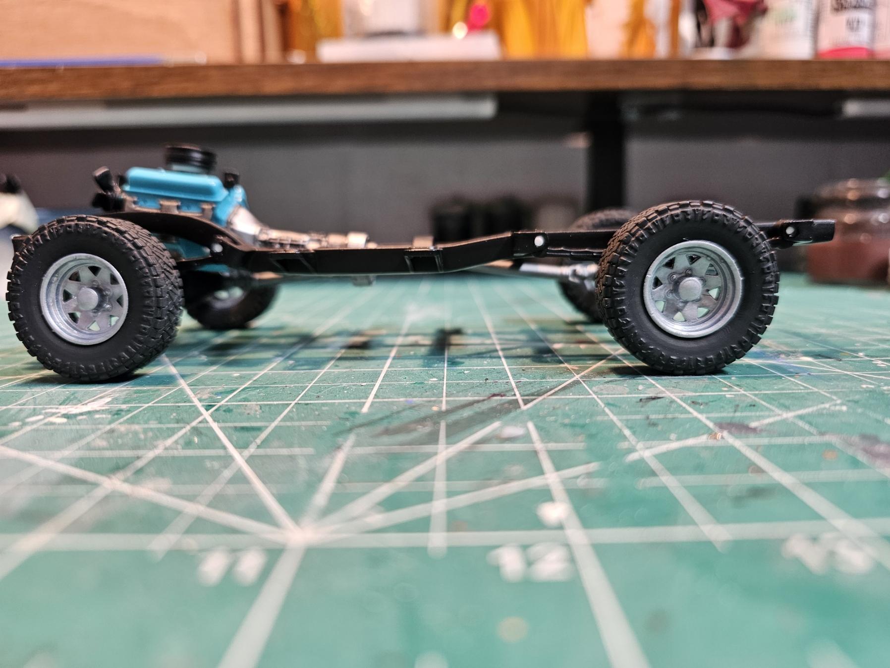

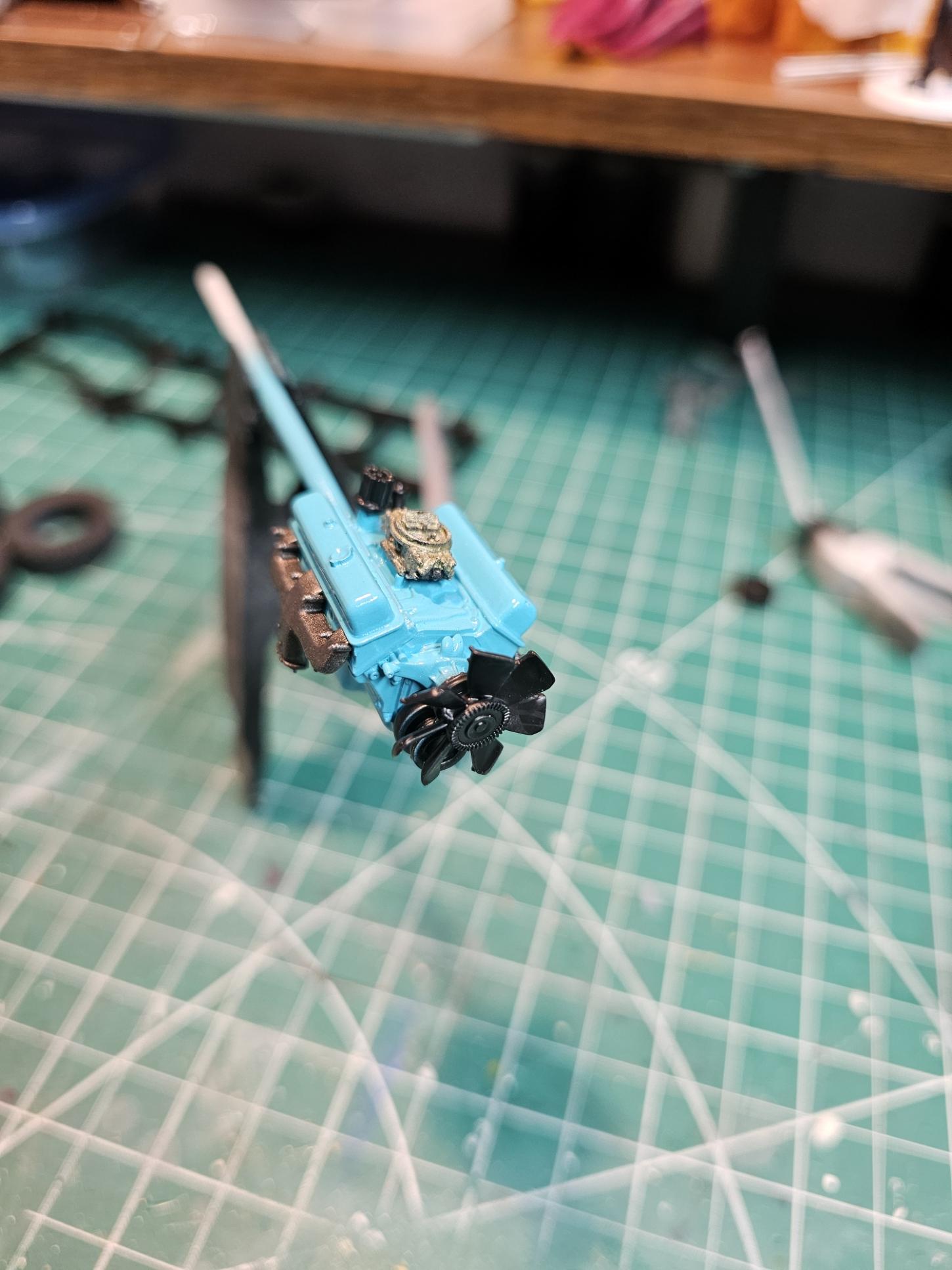

Rade8boy Posted June 2, 2024 Author Posted June 2, 2024 Quick update, I had a minor mishap, while the primer was drying on the cab, I knocked it off the table I use to set drying parts as I was moving another project, resin does not survive a fall in a Tamiya paint stand from 3 feet up onto a tile floor. But I am printing a new one at the 0.2 resolution as suggested by iamsuperdan, thanks for that suggestion. Work has progressed on other parts, here are the wheels (Pro Acryl Silver with Vallejo Metal varnish) and tires (Tamiya Rubber) and motor (Rustoleum Turquoise, sorry purists). Still working on the chassis, I printed 2 engine blocks so the mockup for motor mounts is being done with the second one, and this one should just drop in, as it always does in model building. ?

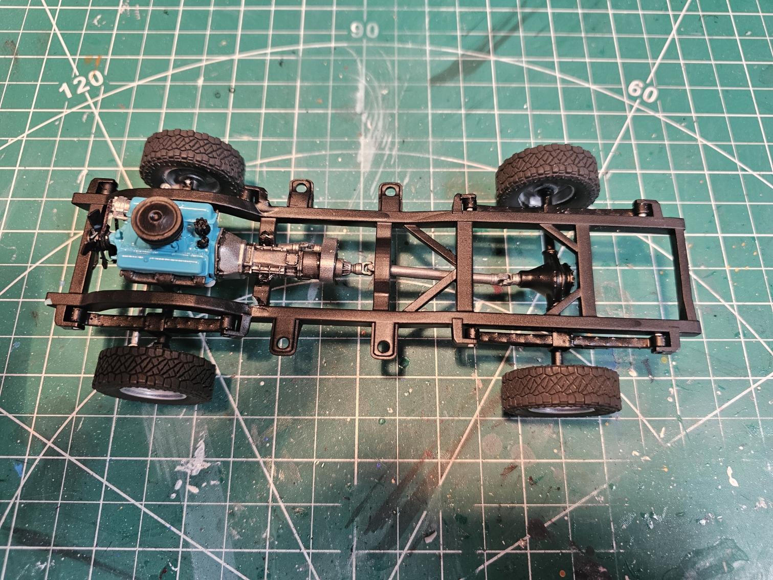

Rade8boy Posted June 16, 2024 Author Posted June 16, 2024 A little update, I've reprinted the cab, but I have not done anything to it yet. I have done some work on the interior and chassis. This is what you would call an out of the box build, no wires or other details except for the shifter on the floor. 7

oldnslow Posted June 18, 2024 Posted June 18, 2024 Just something I noticed and have a question about , I know the frame is not stock , but shouldn't the transmission crossmember be under the transfer case ? beautiful work , by the way
Rade8boy Posted June 19, 2024 Author Posted June 19, 2024 Kenmojr, in regard to resin printing, my best advice is to find a good friend who has a resin printer. ? It can be dangerous if not treated with respect and I print in my garage in a corner on an old table covered in plastic. Also, it generates a lot of dangerous waste products like contaminated gloves and paper towels and alcohol, unless you live in a super dry area I don't recommend water washable resins, I live in SE PA and humidity can be a problem, alcohol evaporates much easier. It's great when you get beautiful parts out of it and a PITA with resin and waste. Oldnslow, the transmission/transfer case only fits above the cross member as it is bowed down to hold it, I looked at the file makers pictures, and it is meant to go on top. I do believe the frame is a bit generic, I also have the 65 GMC pickup and the reframes look almost identical, but I have not printed it yet to compare. 1

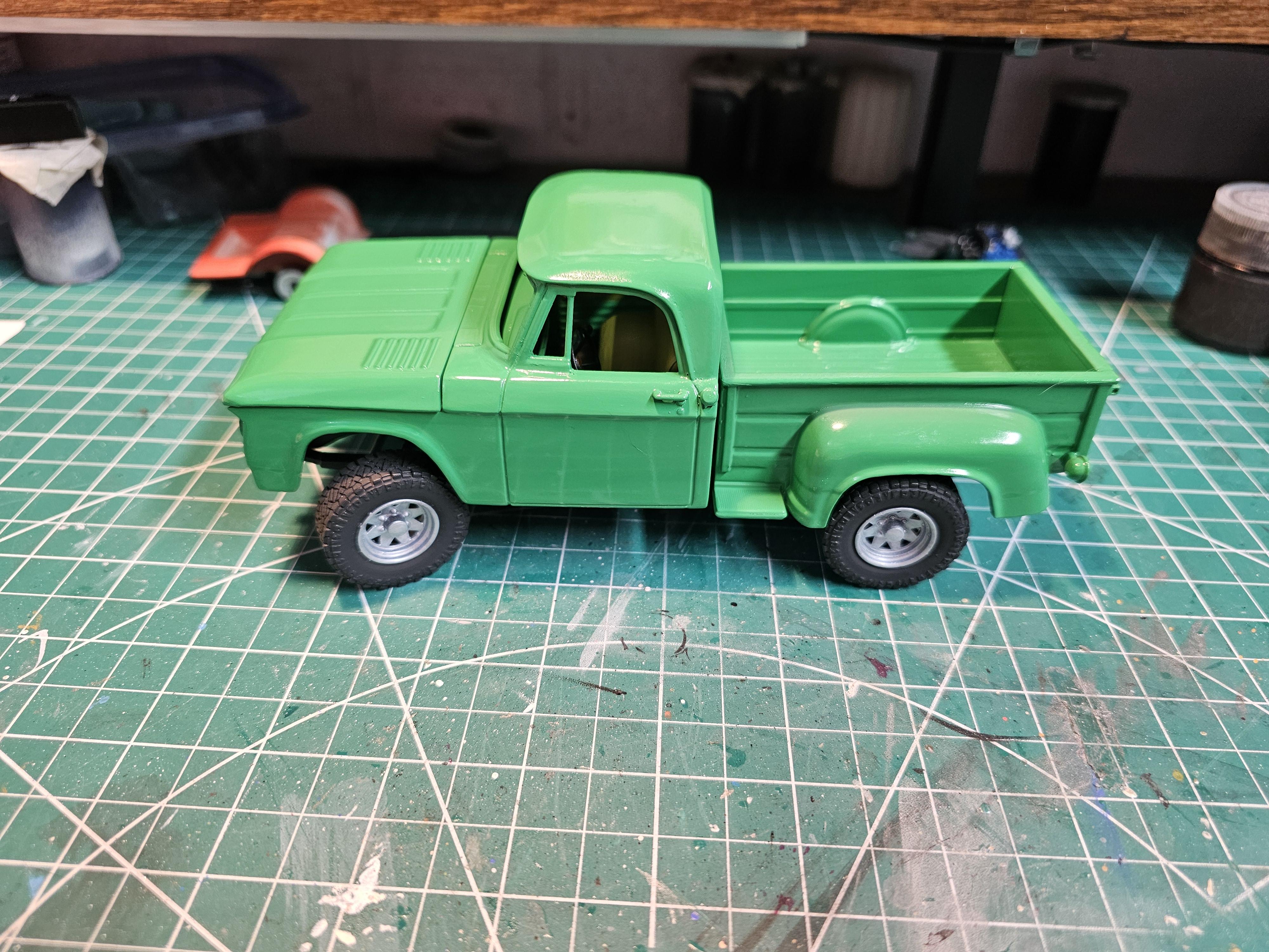

Rade8boy Posted June 22, 2024 Author Posted June 22, 2024 Another quick update, everything in Tamiya rattle can TS-35 Park Green, no clear coat just the paint sprayed from the can. I tried to 3D print the windows in high clear resin, it was not a success they are not clear enough, so I will be printing them in regular resin and then vac u forming them. At least that's the plan. 6

Rade8boy Posted August 10, 2024 Author Posted August 10, 2024 Sorry for the delay, it's been a busy summer. Plus, I had to experiment with trying to 3D resin print clear parts for the windows and light lens. I did not have much success with 3D printing clear parts, they always came out frosted, I tried 2 brands of resin both stated "HIGH" or "WATER" clear. I am 99% sure it's me or the printer/slicer settings I just never got it dialed in and used up the bottles. I switched to printing the parts in standard resin and then vac u formed them, again a trial-and-error process, I got acceptable results and glued them in, not as clear as I'd like but I build at a 75% is good enough for me rate. The last on the list is figuring out Painting the Dodge emblems on the hood and tailgate and the chains on the tailgate, steady hands are not my strength, and eBay turned up no decals that I think would work, I looked at Ray's kits decals and he may have something that might work. Not perfect and I think the chassis has a bit of a twist or something to it, chalking it up to resin building learning process. I have the files, from the same designer, to print the 2020(?) F-250, 2024 Mustang Dark Horse and 2023 Dodge Ram TRX. 6
stitchdup Posted August 10, 2024 Posted August 10, 2024 its looking good. if you want clear to print better try lowering the layer height and printing it as normal. then after cleaning, but before curing brush a little of the clear resin over them and let it settle. now when you cure the parts the lines should be gone. you can also use clear paint but it takes a lot longer. this works better on small parts than windows

Chariots of Fire Posted December 30, 2024 Posted December 30, 2024 (edited) Just a tip for doing the DODGE lettering on the hood. Before painting cover the letters with Bare Metal Foil. Trim it close to the outside of the letters but don't bother going in between. Then do your usual painting. After the final coat, use a Q tip and thinner and gently remove the paint on the top of the letters. Just dampen the Q tip. You don't want the thinner running onto the other painted surfaces. Tailgate letters might need to be done with decals. here's what it looks like on a '66 W-300. Edited December 30, 2024 by Chariots of Fire 1
