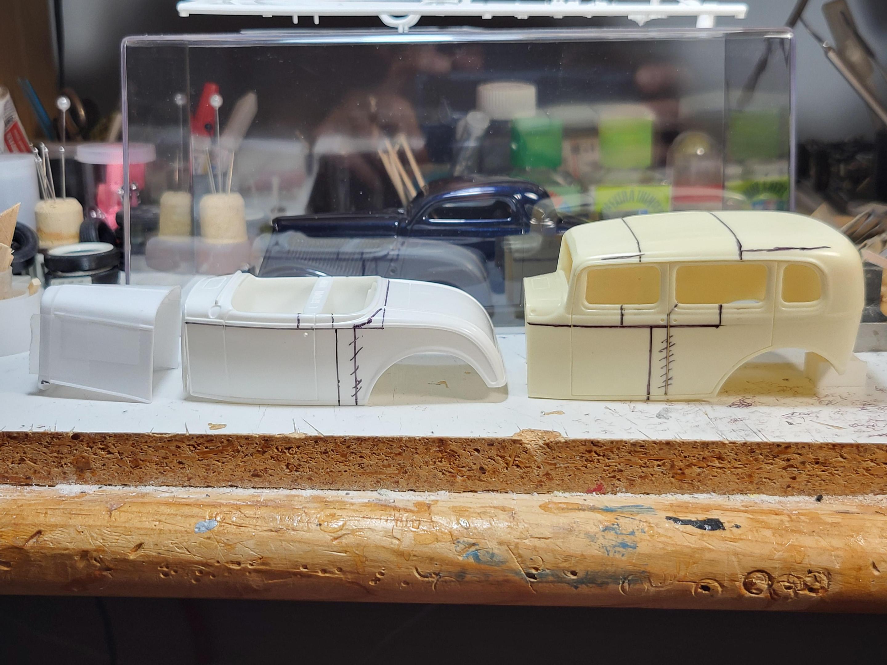

Kit Karson Posted June 12, 2024 Posted June 12, 2024 (edited) I too will be working on a pair of deuce sedans! One will be based on the @Dennis LacyDrag City chopped 4dr body and the second starting with my R&M of MD chopped 2dr body. Where's my Sawzall? -KK Edited June 12, 2024 by Kit Karson 1

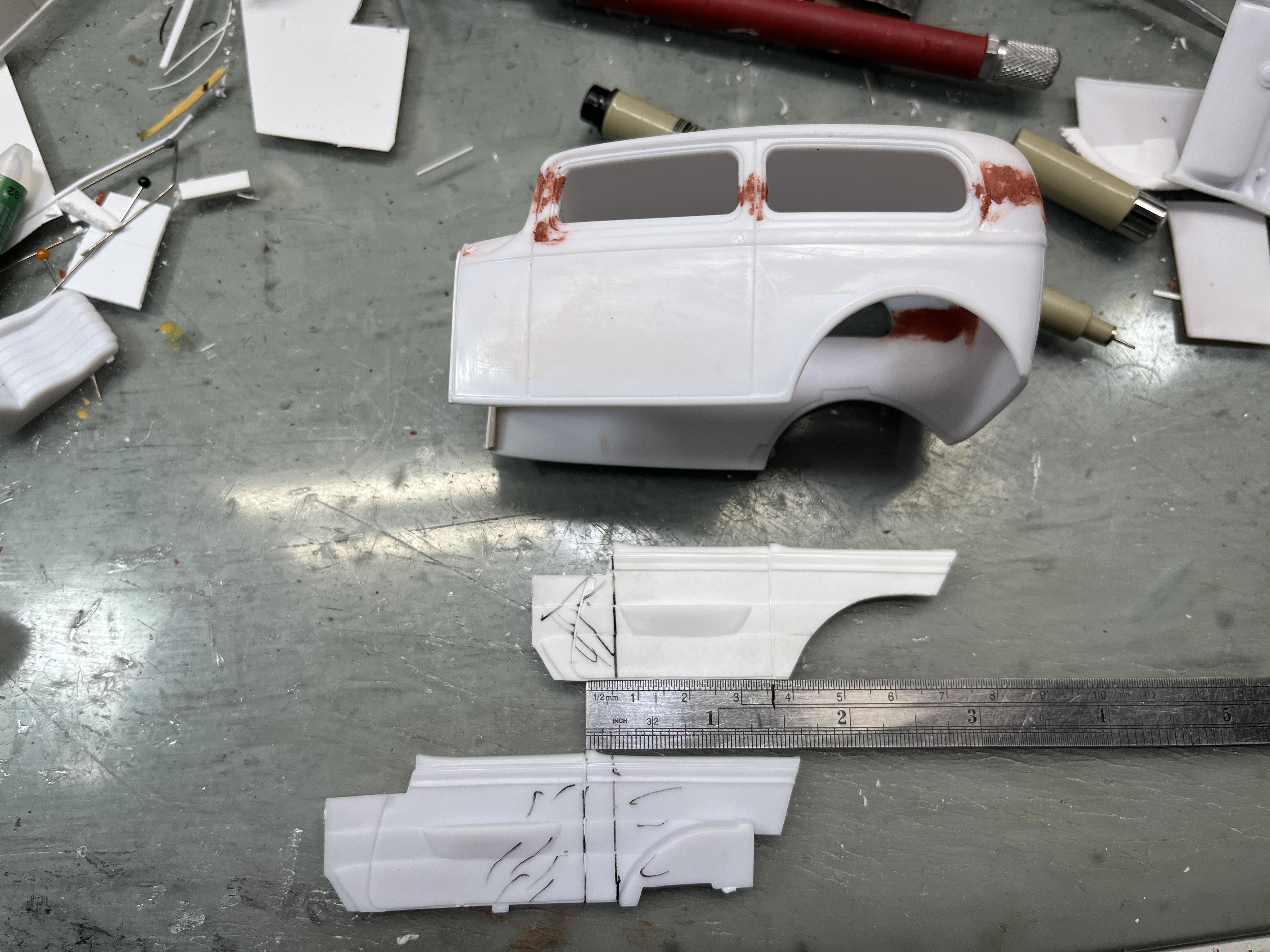

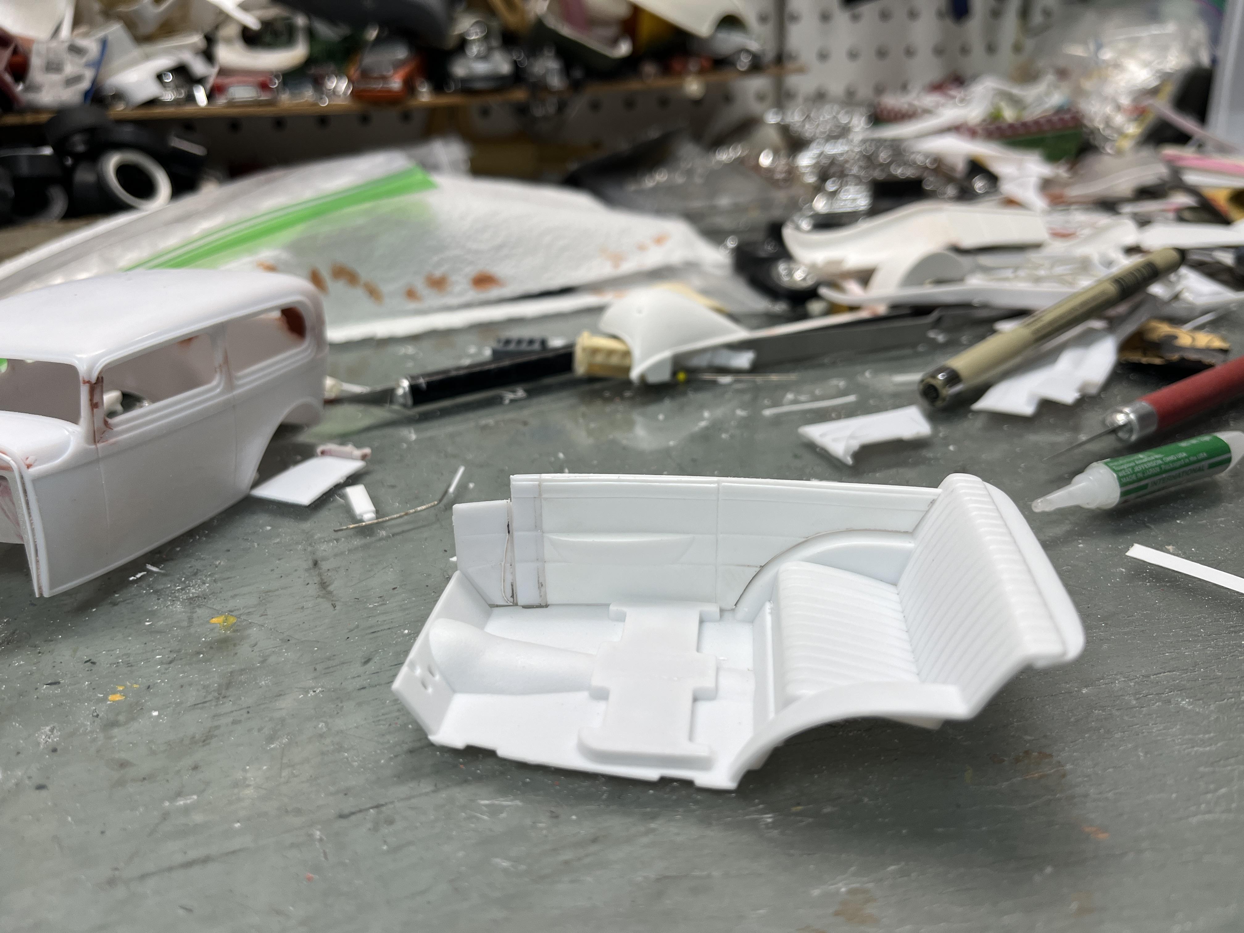

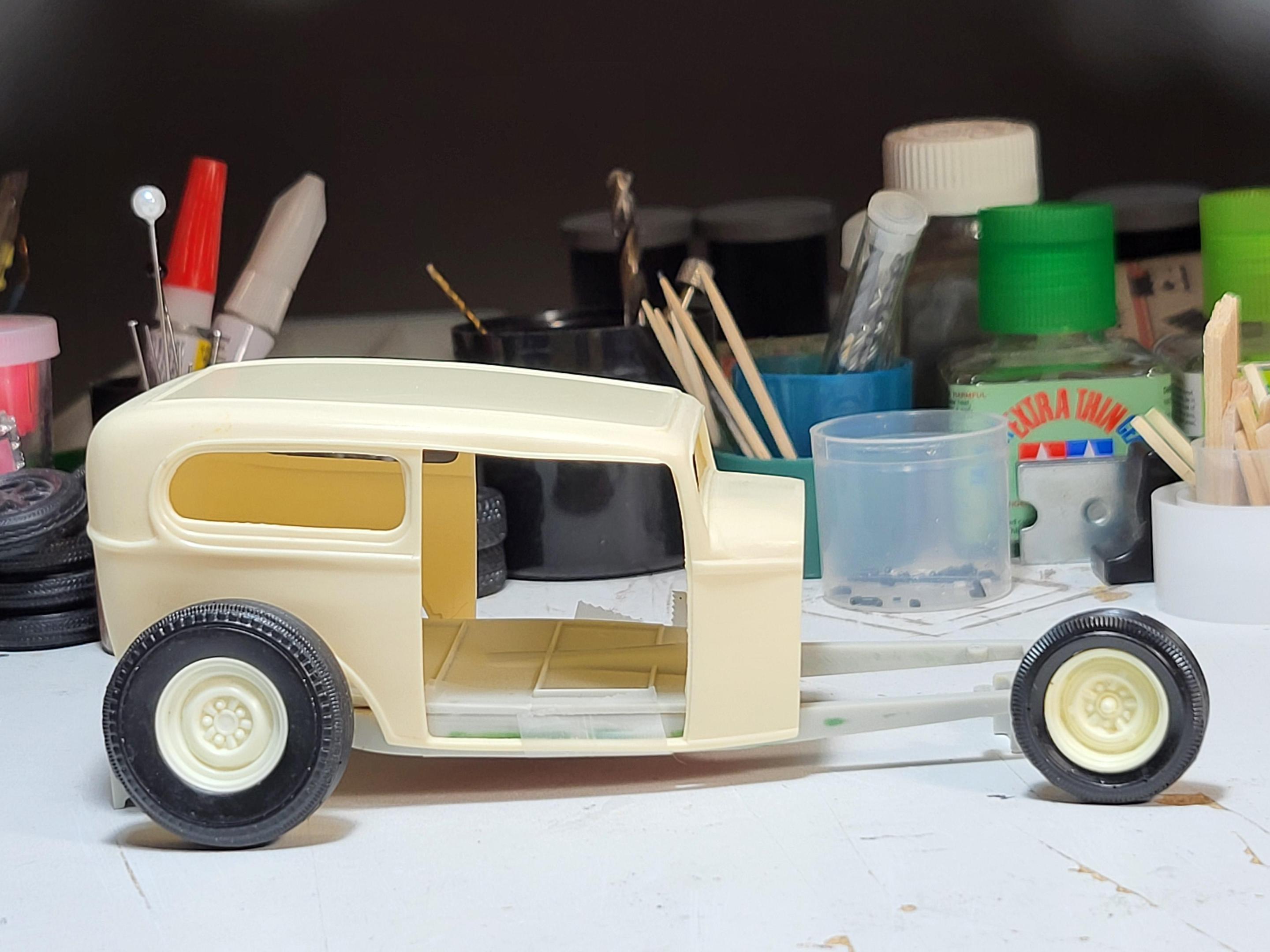

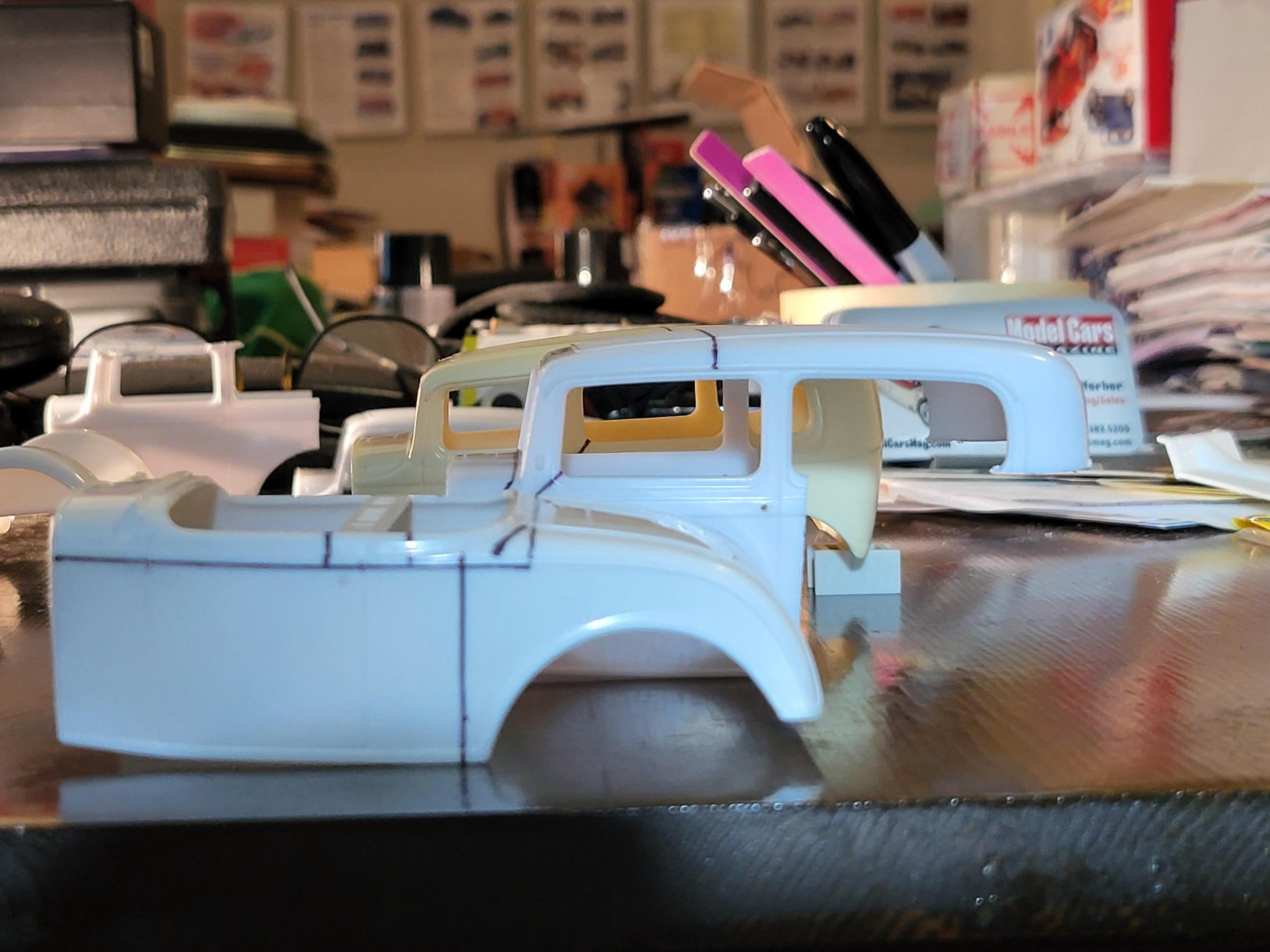

Rocking Rodney Rat Posted June 15, 2024 Posted June 15, 2024 I've been chopping away.... The firewall from the AMT Phamtom Vickie [sic] is being used. I stripped off the 'pre-painted' paint. -------------------------- Chopped the top about this much.... --------------- Using the Speedwagon seats and door panels which needed to be stretched using two sets.... ----------------- A few schmears of putty will bring that all around.... more later.... -RRR 7

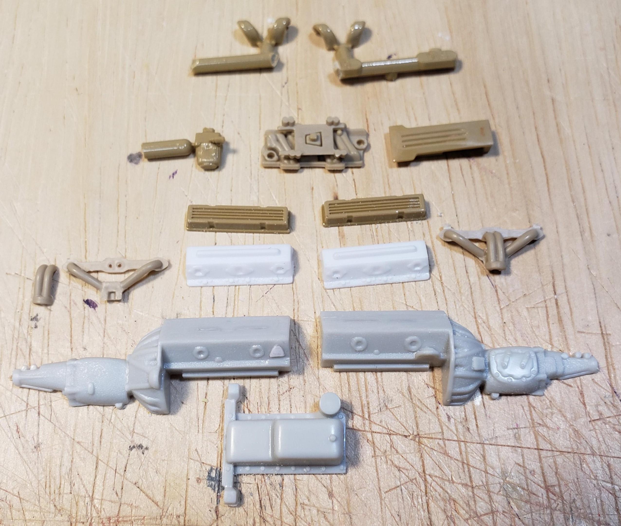

DJMar Posted June 15, 2024 Posted June 15, 2024 I cobbled together this collection of engine goodies from the parts box for this build. The block and oil pan are from the AMT '34 Ford Street Rod kit. The block is cut up a bit (missing the fuel pump, as well as the locating bosses for the cylinder heads) but it will work. The oil pan is useful because the motor mounts are built in, although I don't know if I'm going to keep the molded-on oil filter. I'm 90% sure the heads are from one of the Revell '64/'65 pickups. All the tan bits are from the AMT '72 Vette Street Machine, circa 1993. The valve covers and most of the TPI unit already had the chrome removed sometime in the distant past. The exhaust headers look a little small to me, but I'll probably still use them. Everything dry fit together pretty well. I still have to scrounge up an appropriate distributor, accessory belt and front cover/water pump. 6

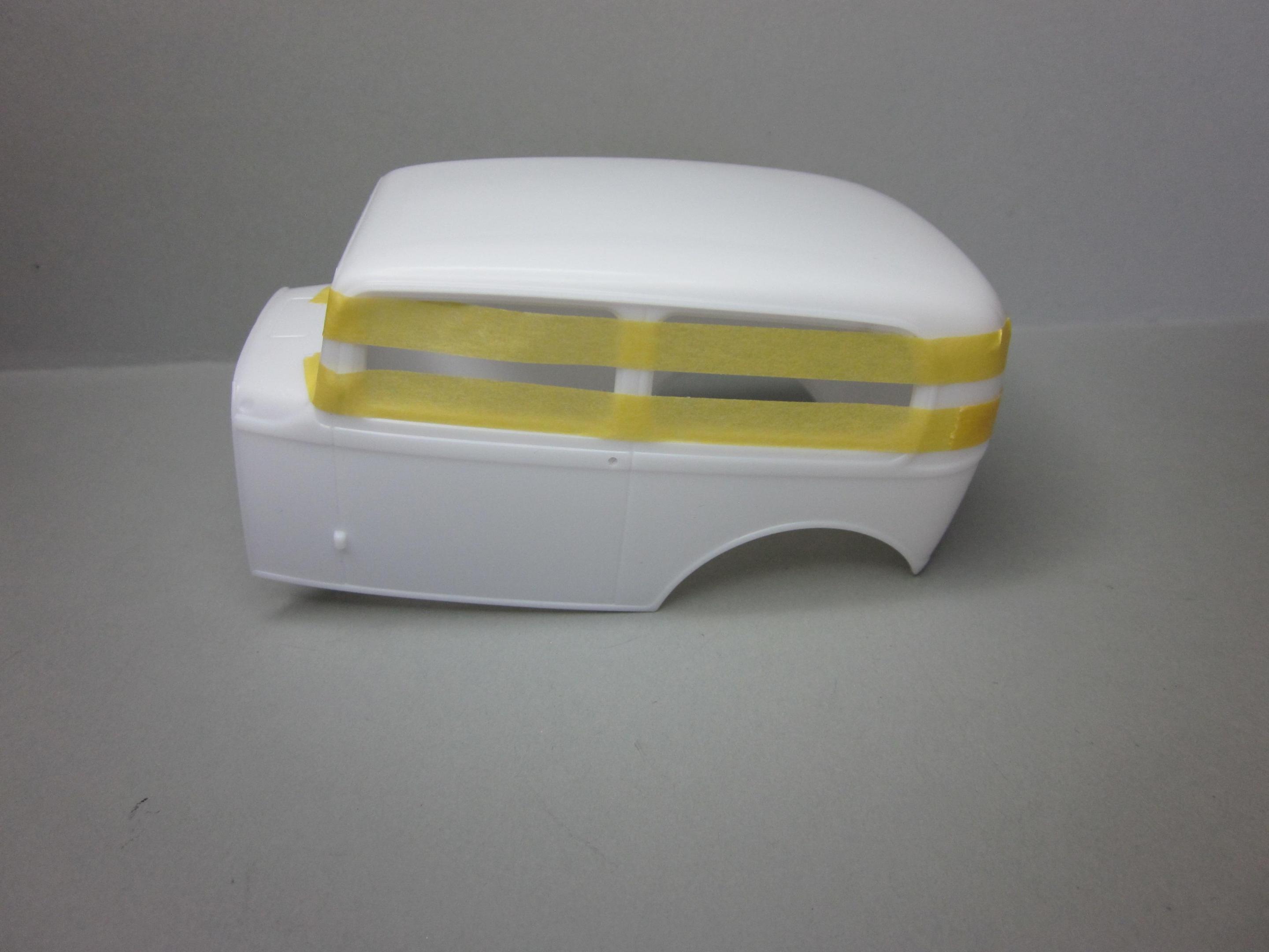

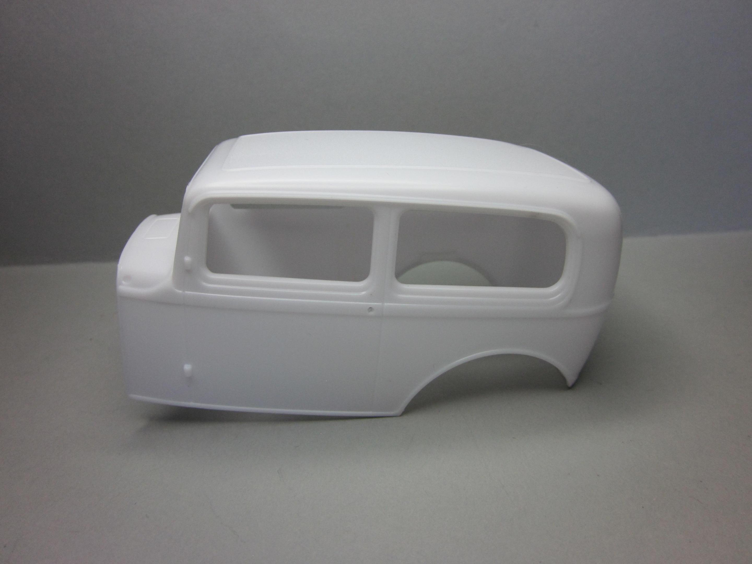

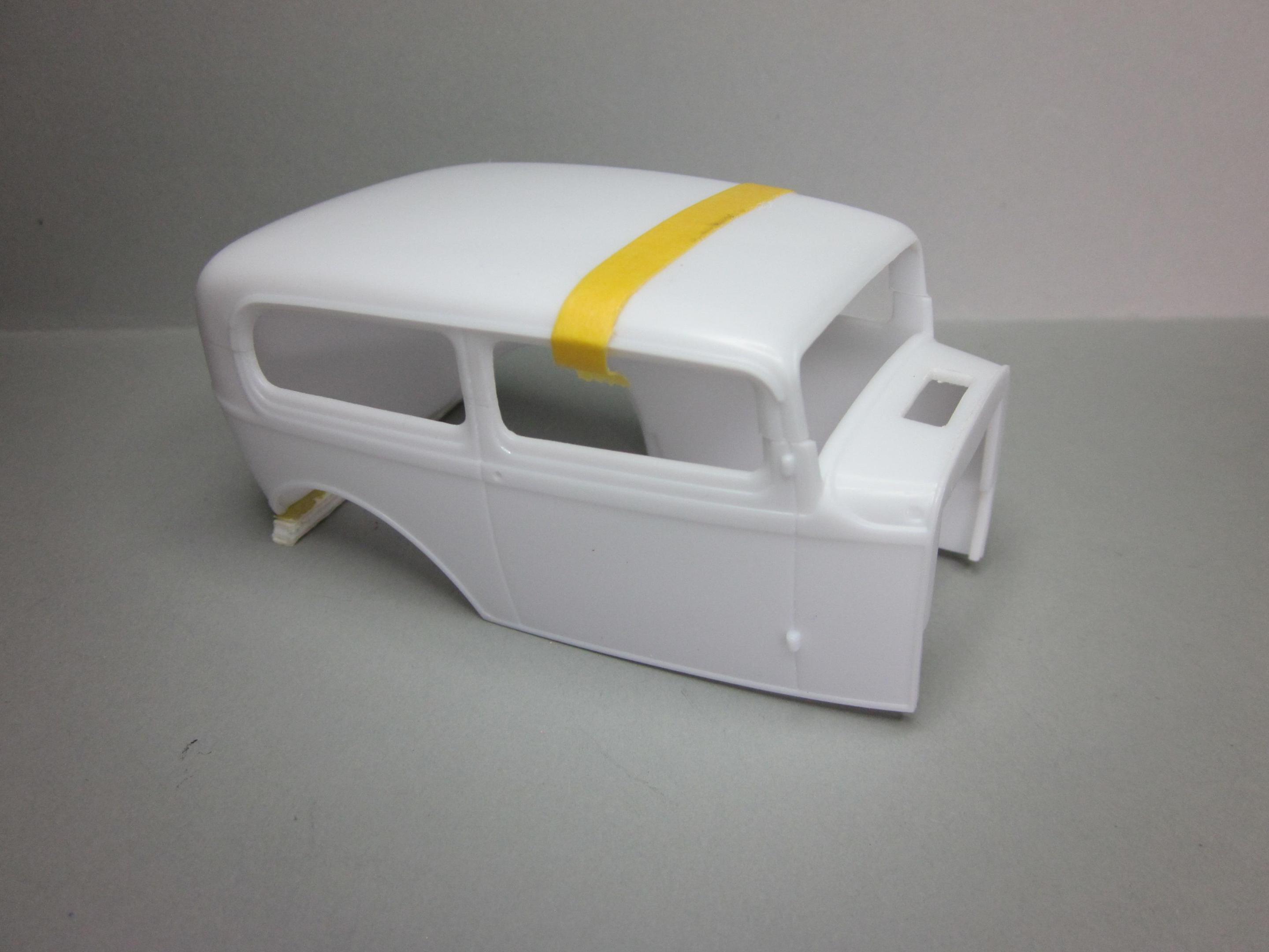

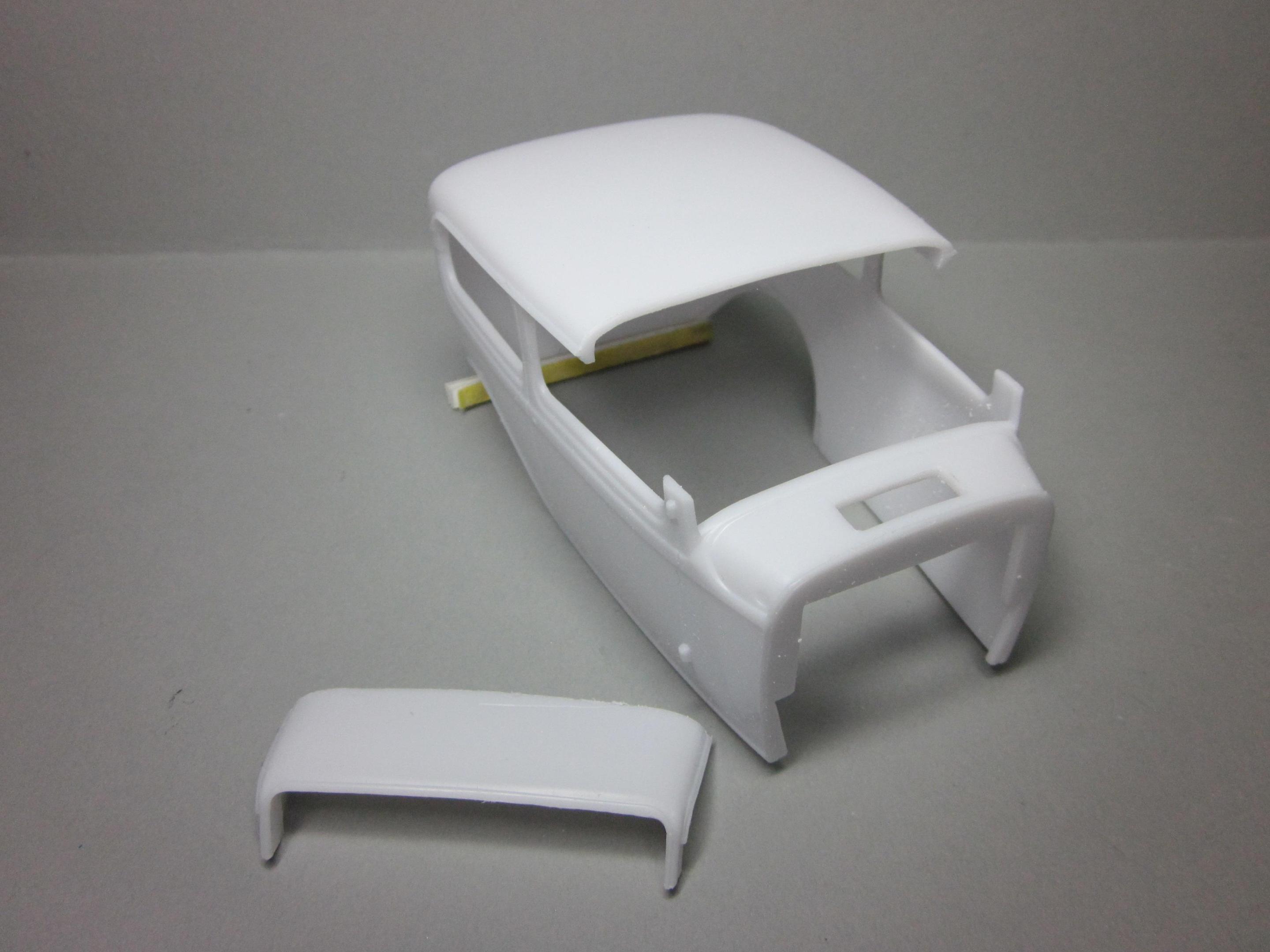

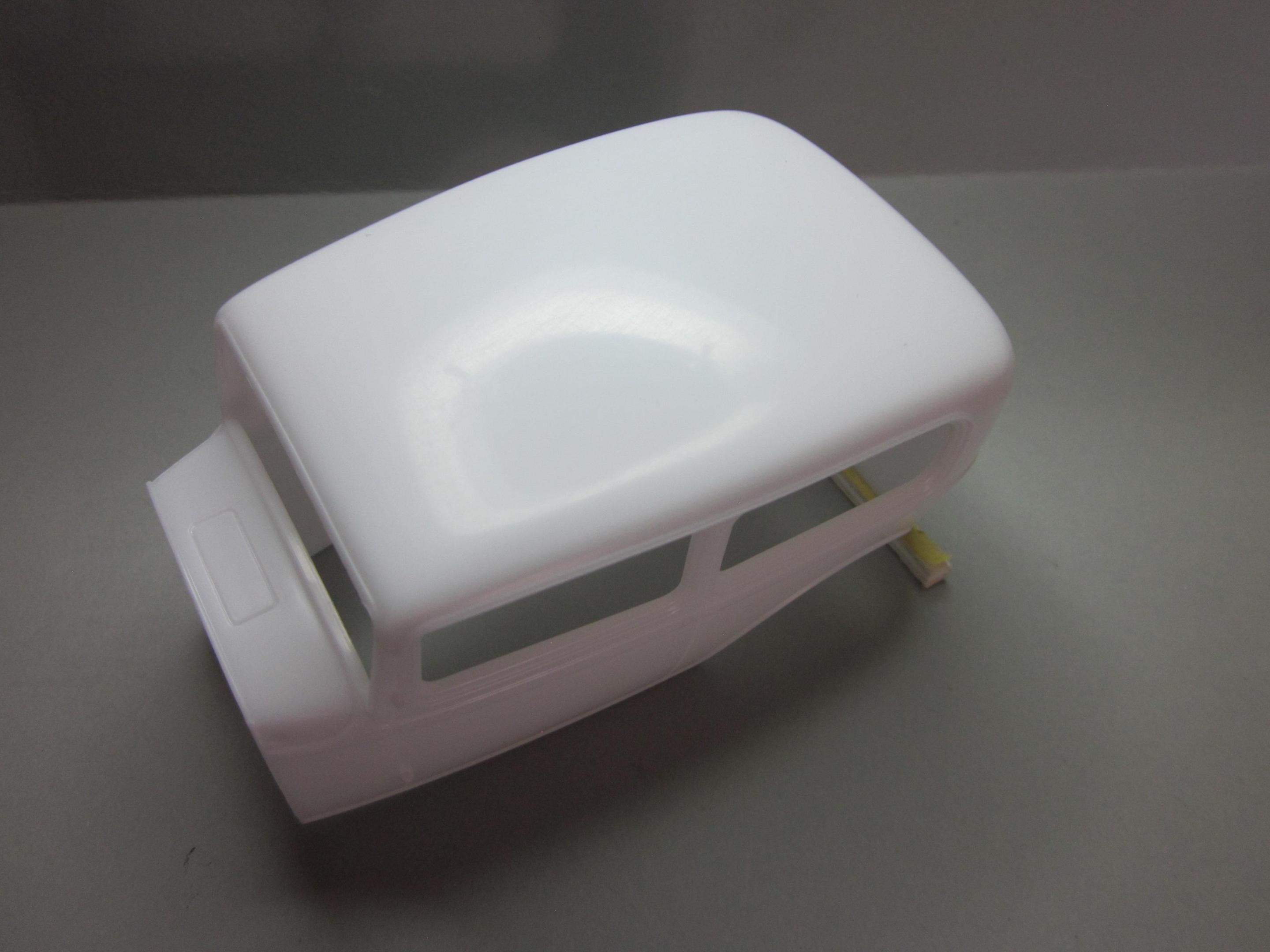

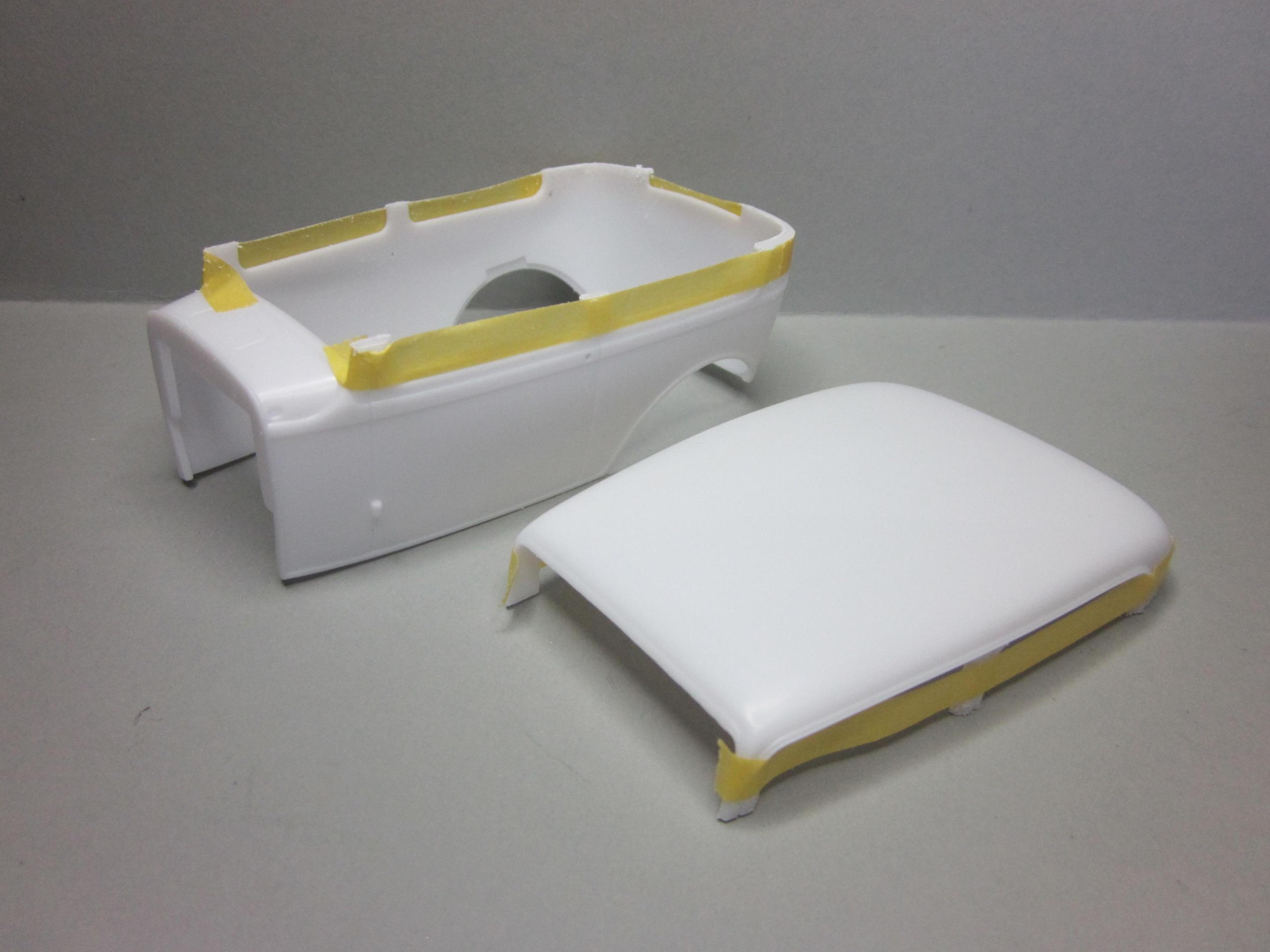

Speedpro Posted June 16, 2024 Posted June 16, 2024 I'm off and running. I'm glad we have till Oct to finish our builds, because as of right now I have no solid plans. I'm going to take things one step at a time and see what happens. The first item on the list is to chop the top of course. Not too little and not too much. I just ball parked it with some tape and its ready for surgery. But first the top must be smoothed removing the insert. I sanded the top with a couple different sanding sticks and the polished it out to 12000. Now the top chop can proceed. The total chop will be around 3". Got all the cuts cleaned up and spent a few minutes looking at how much the top is coming down and does it need to be adjusted. I think it will stay where it's at. It was time to put the top back on. Since the pillars don't line up anymore at the front, it's going to take an adjustment to get it back together. I saw where @Rocking Rodney Rat and @bill-e-boy both modified the A pillar. I've chose to cut the top and add a filler as I would like to keep the original windshield angle. I figured I would start gluing the top back on starting at the rear and working my way forward. The back is completely glued and finished at this point. The B pillar is glued but still needs more work. I also cut the vent door out. It's time to cut the top now............... Thats it for now. I figure this should keep me occupied for a little bit. 10
Rocking Rodney Rat Posted June 16, 2024 Posted June 16, 2024 1 hour ago, Speedpro said: I've chose to cut the top and add a filler as I would like to keep the original windshield angle. I rarely do this, it's just too much work for me?...-RRR 2

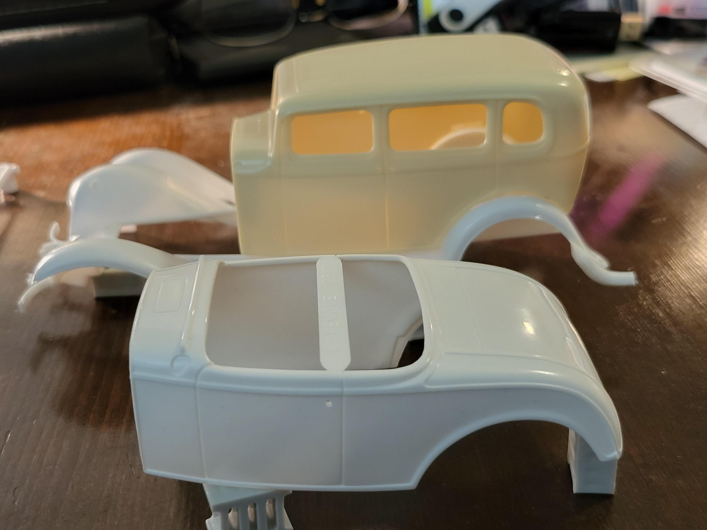

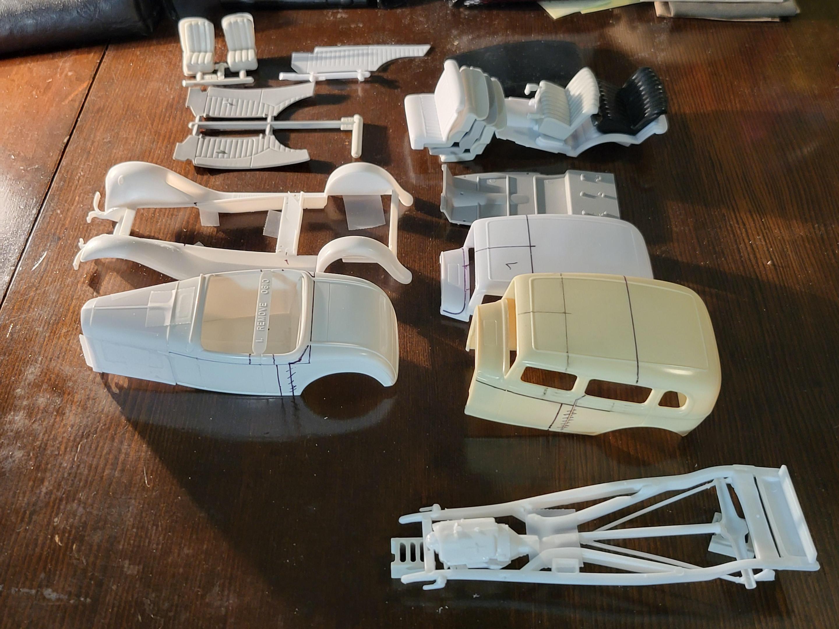

carnut Posted June 16, 2024 Posted June 16, 2024 Here are some of the main parts that I will be using. Mine will be similar to but not exactly like the first version of the Lil Coffin. 6
Tim W. SoCal Posted June 17, 2024 Posted June 17, 2024 2 hours ago, carnut said: Mine will be similar to but not exactly like the first version of the Lil Coffin Sweet idea! I can't wait to admire your finished model!... 1
Kit Karson Posted June 17, 2024 Posted June 17, 2024 21 hours ago, carnut said: Here are some of the main parts that I will be using. Mine will be similar to but not exactly like the first version of the Lil Coffin. 3

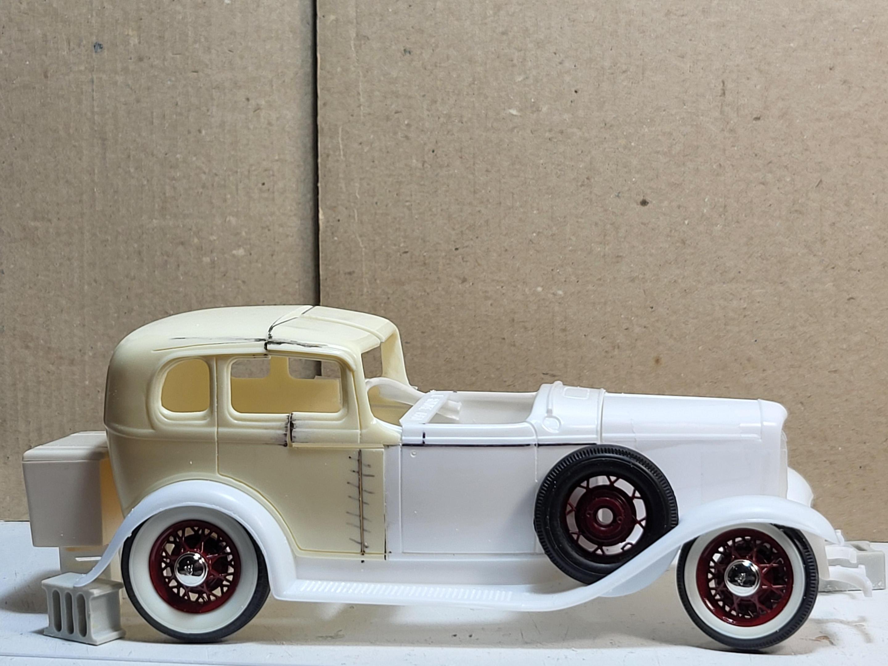

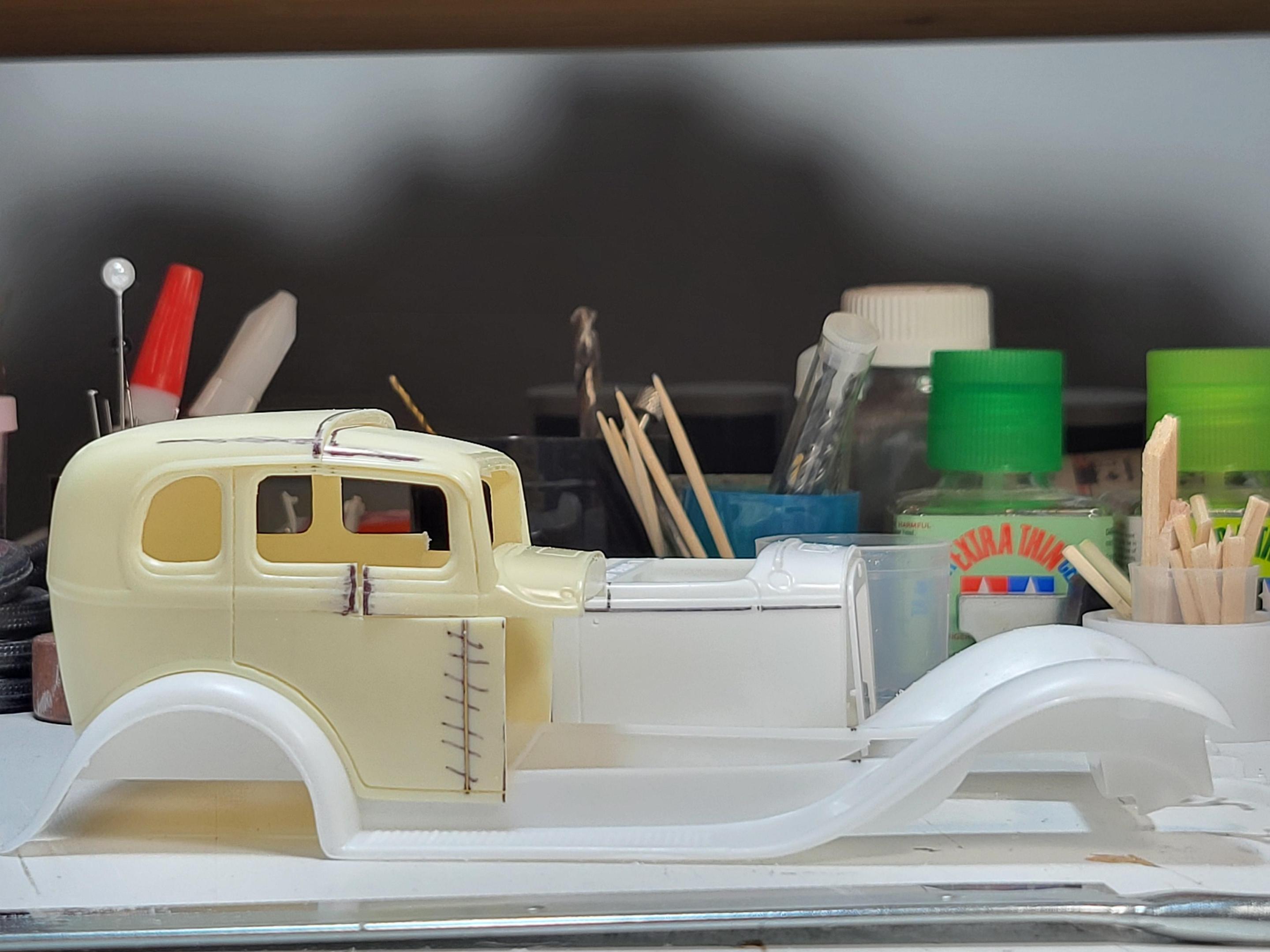

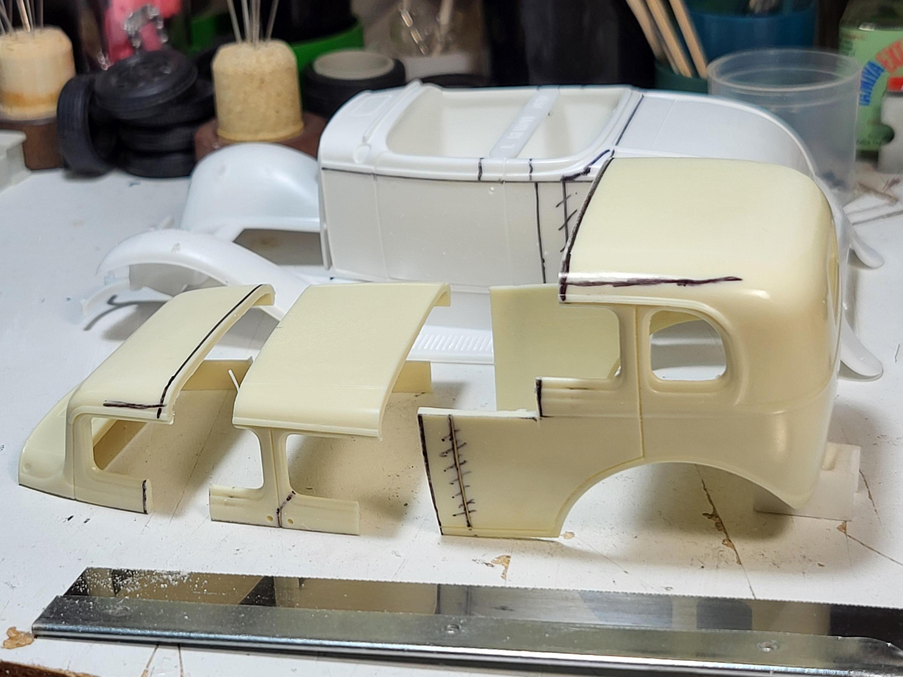

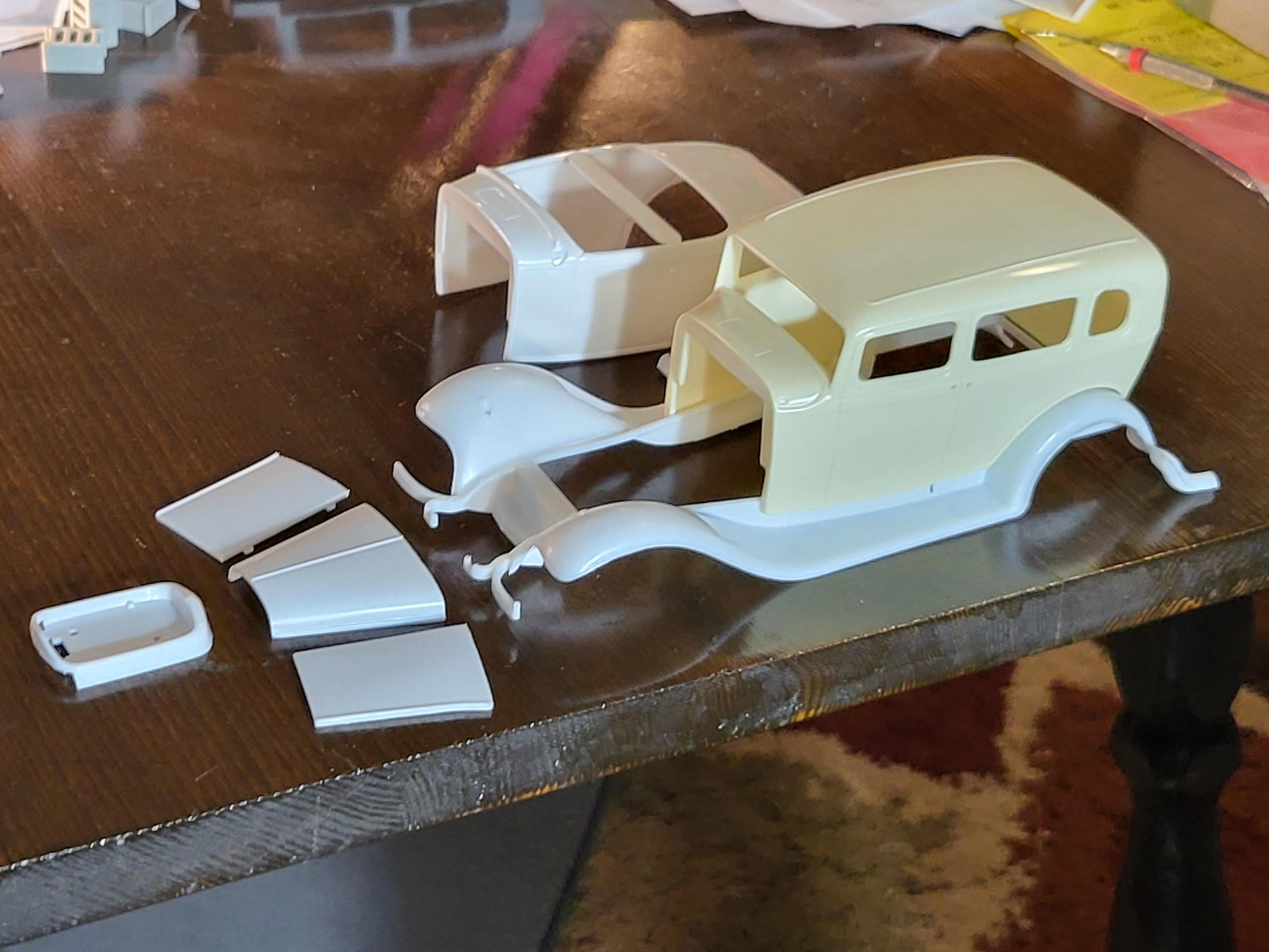

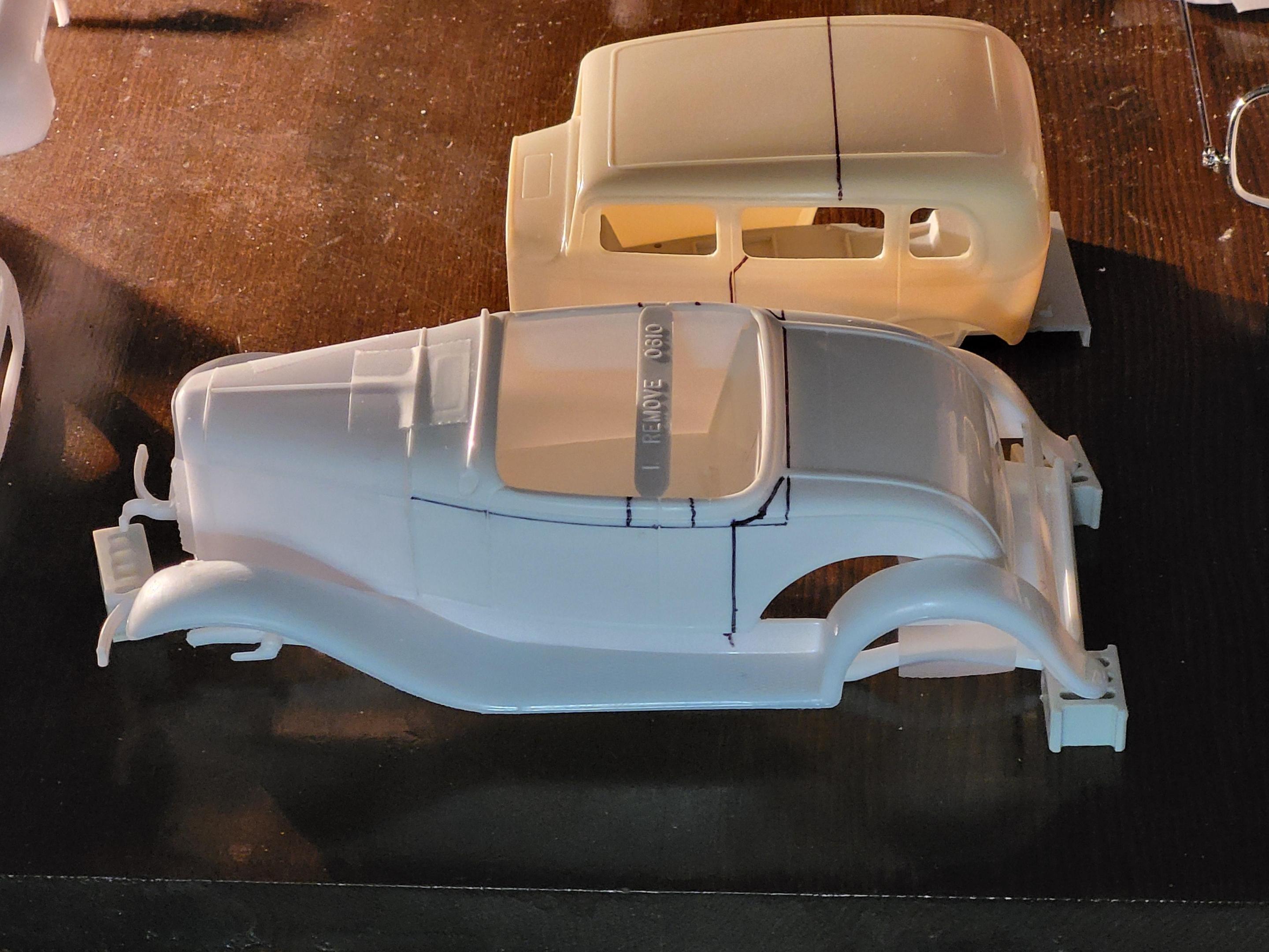

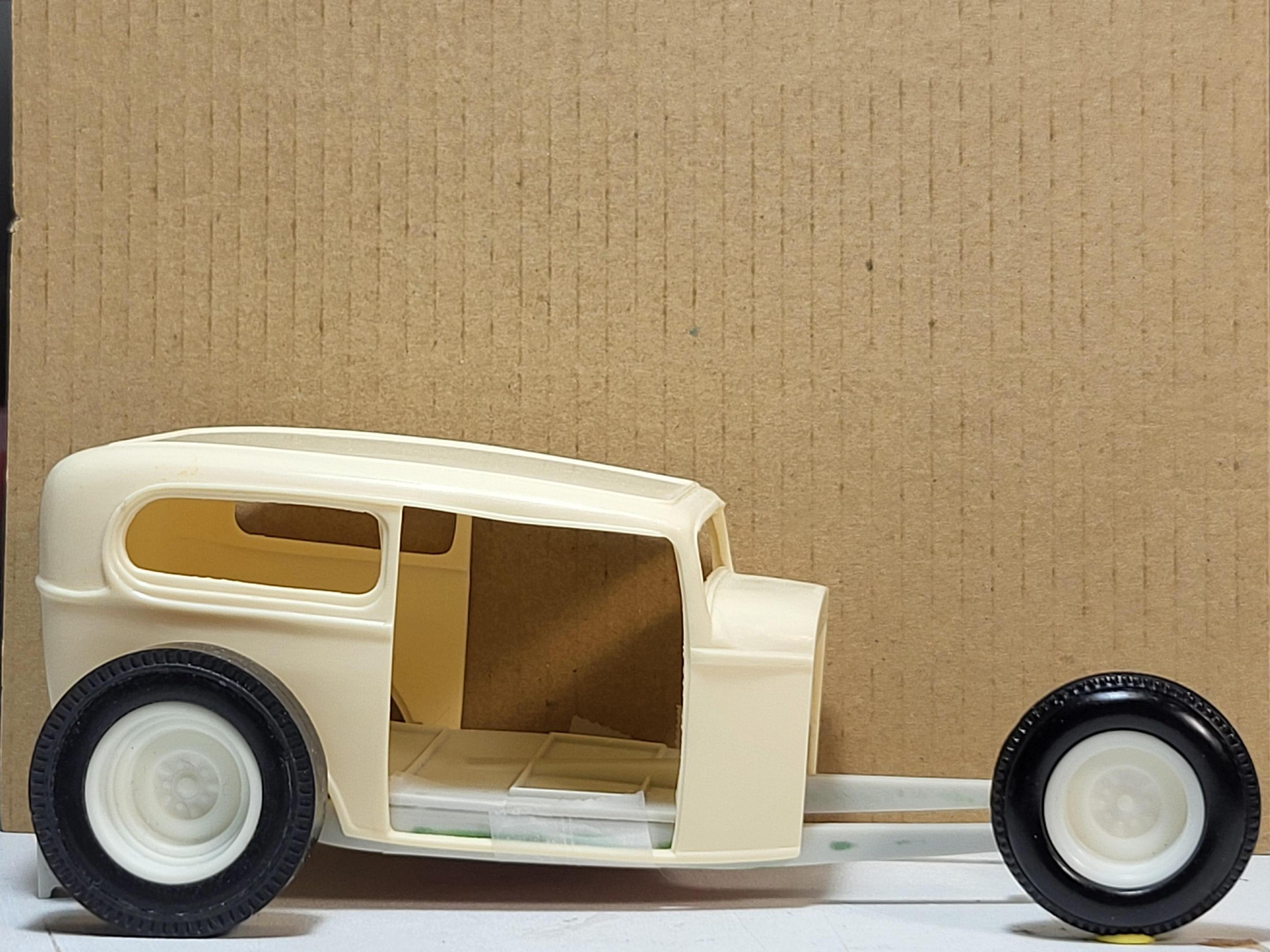

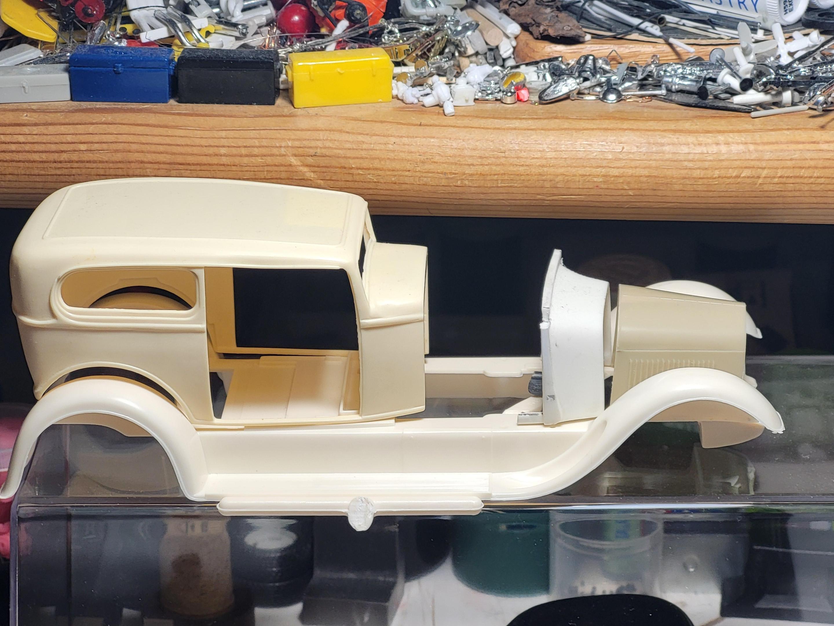

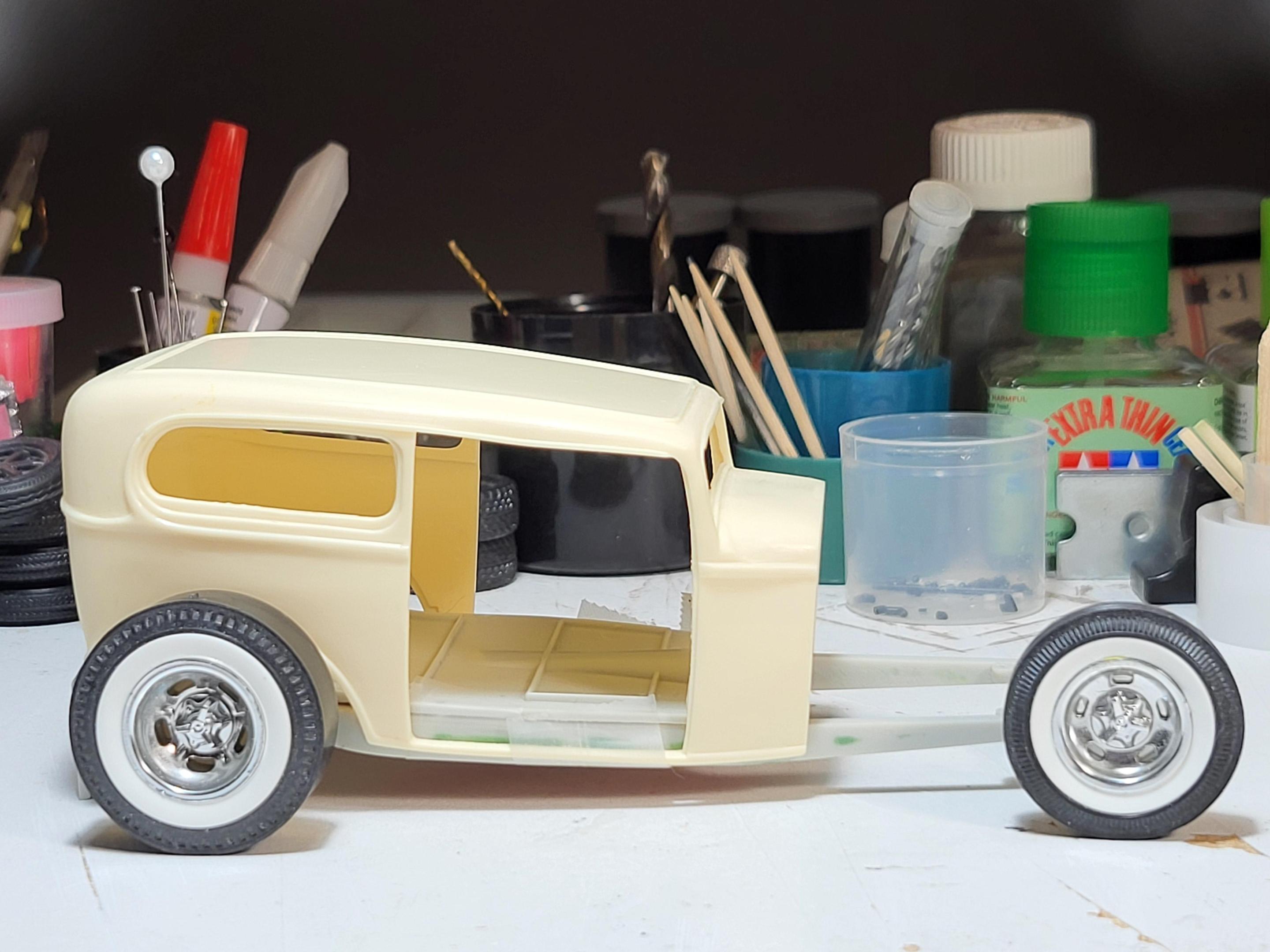

Kit Karson Posted June 17, 2024 Posted June 17, 2024 and... this is a before & after done in the last 4 days: '32 Ford Chauffeured Town Sedan -KK 8
Flatout Posted June 18, 2024 Posted June 18, 2024 4 hours ago, Kit Karson said: and... this is a before & after done in the last 4 days: '32 Ford Chauffeured Town Sedan -KK Oh My! 1
