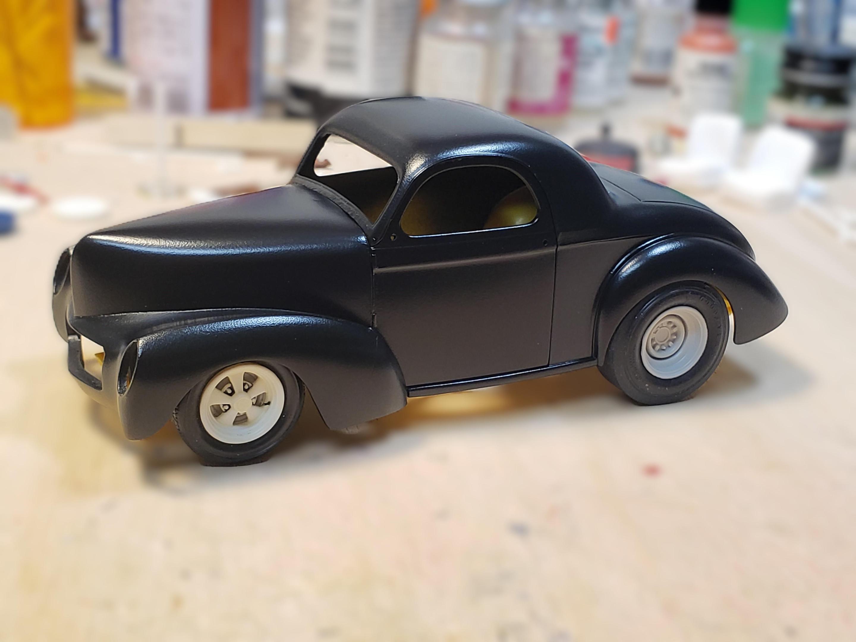

DJMar Posted June 5, 2024 Author Posted June 5, 2024 3 hours ago, mchook said: Looks great, I hope to see more soon. 2 hours ago, Zippi said: Now that's down my alley. Great looking 40 Willy's so far. 2 hours ago, SpeedShift said: Good build. Thanks, y'all! Appreciate the kind words. I actually got this shot with some satin black tonight, so I'm waiting for it to dry so I can mock up and post some more pics.

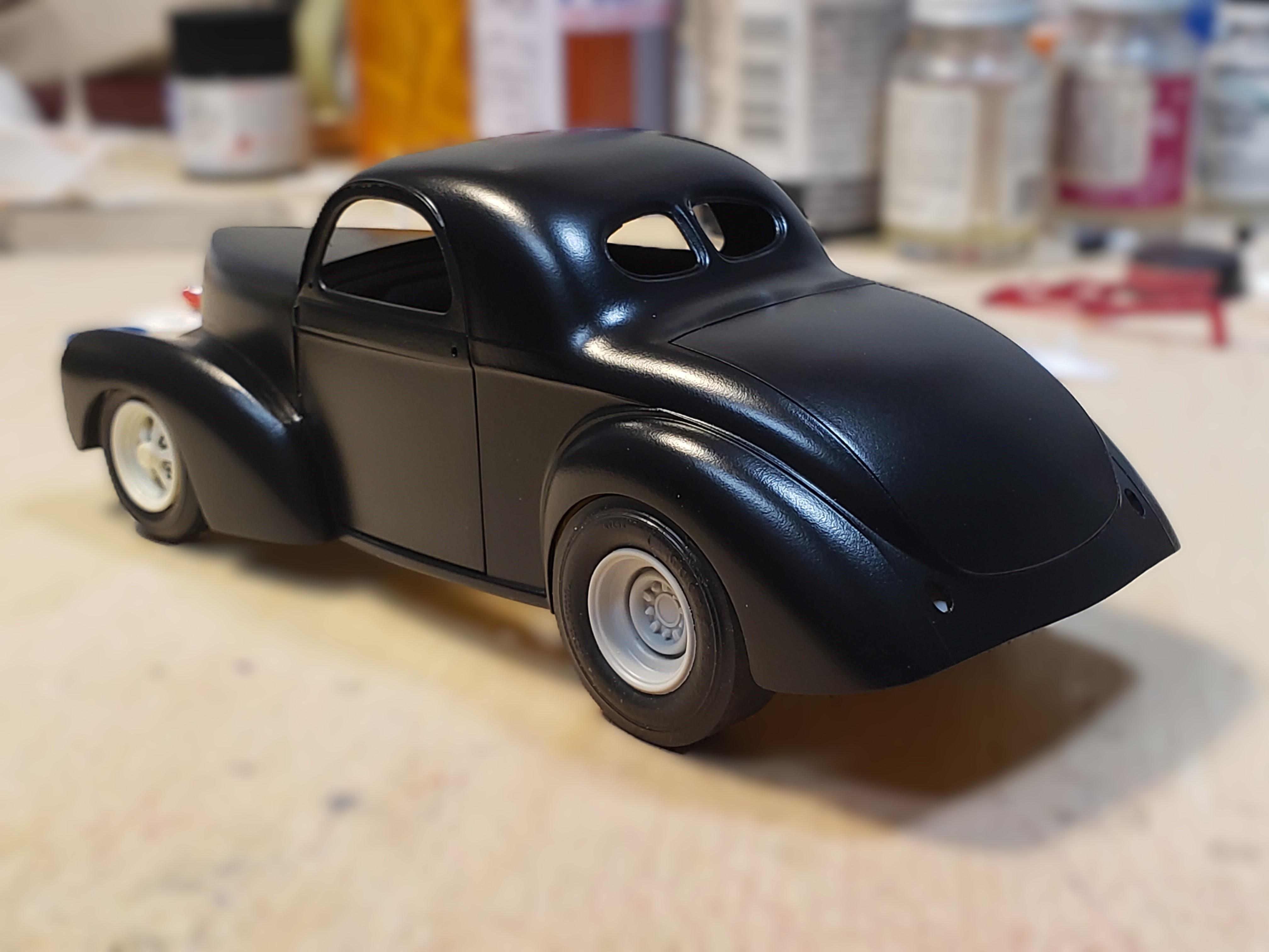

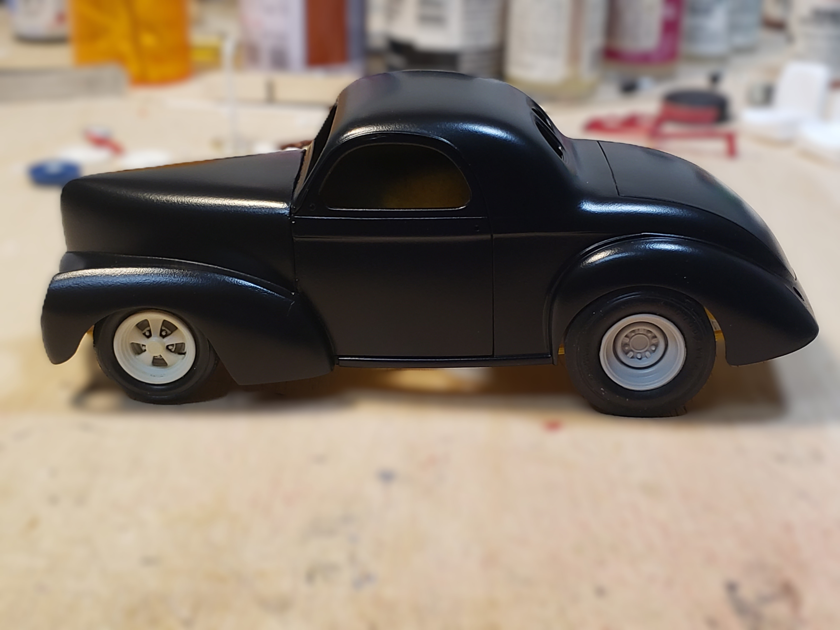

DJMar Posted June 5, 2024 Author Posted June 5, 2024 I got the first coat of color on last night, and to be honest, I don't love it. I'm not crazy about the black and I really don't like the sheen. The paint also didn't lay down as flat as I would like. It's not moon crater bumpy, but it certainly isn't smooth. I was going for a nice satin black. I usually shoot a few coats of flat black, followed with light coats of semi-gloss clear, until I get the sheen I want. This time I went with Colorshot satin black (because I had a can sitting around) sprayed into to my airbrush bottle with a little thinner, and then on to the model. The end result is way too shiny for my liking. I have a few options. I can shoot a flat coat over the top of this to see if it tones down things a little, but I'm afraid it will just look like flat black. Or I can use the black as a basecoat for a darker, shiny pearl topcoat, like a purple or blue. Lastly, I could just strip it and start over. I mean it's only a few coats of primer and topcoat, right? I'm going to let it dry for a week or so before I decide. 3
Zippi Posted June 6, 2024 Posted June 6, 2024 I hear ya on the paint DJ. It just really bugs me when my paint jobs don't turn out like I was expecting. You'll get it man, just keep after it.
DJMar Posted June 6, 2024 Author Posted June 6, 2024 6 hours ago, Zippi said: I hear ya on the paint DJ. It just really bugs me when my paint jobs don't turn out like I was expecting. You'll get it man, just keep after it. This was the universe reminding me not to deviate from my standard procedures! ? 1

Edward Gore Posted June 8, 2024 Posted June 8, 2024 Your body work is open point! The sheen of the paint doesn't look too bad from here but seeing it up close on the bench probably looks different. Maybe your idea with a light coat of flat may help. 1

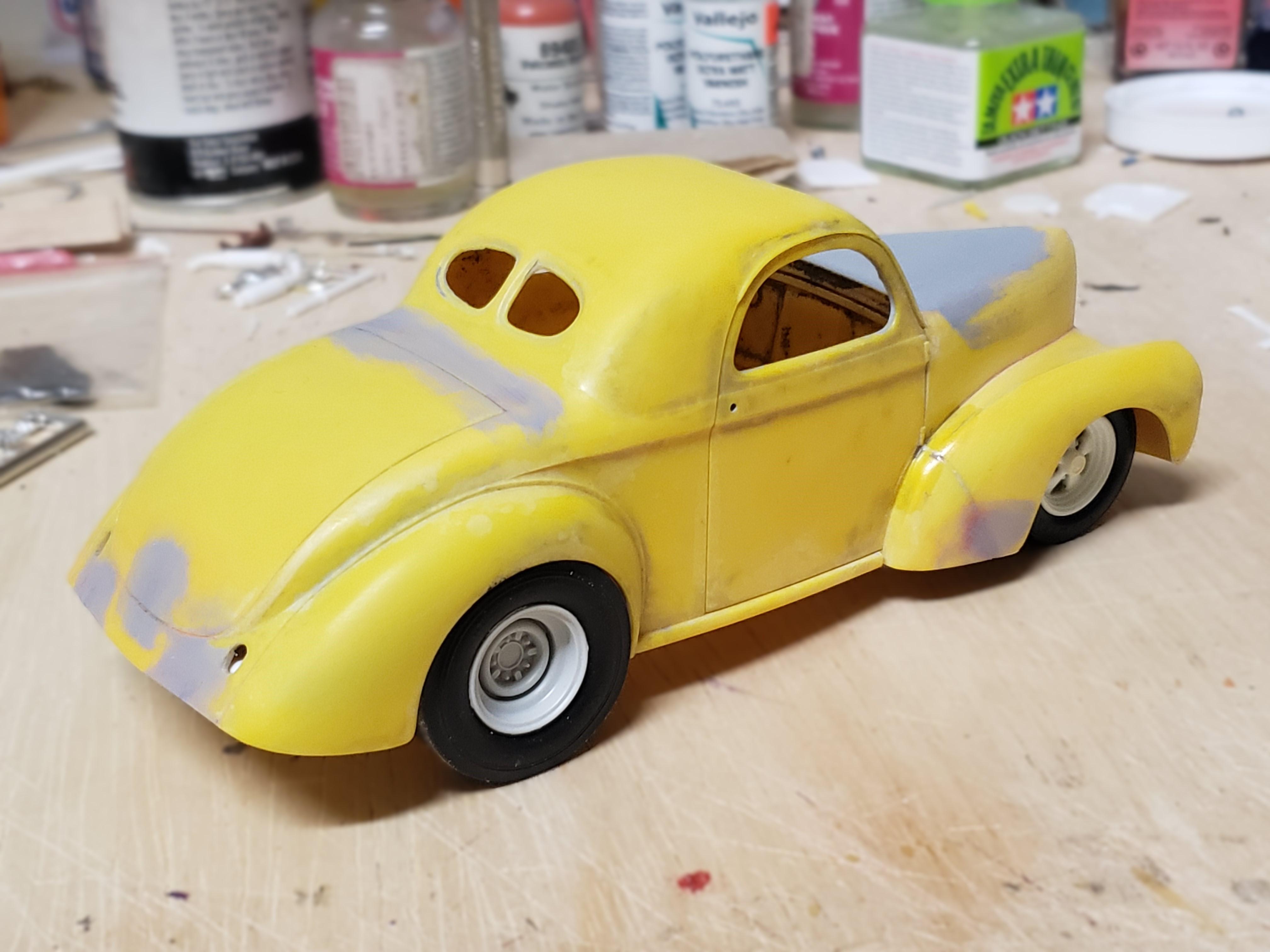

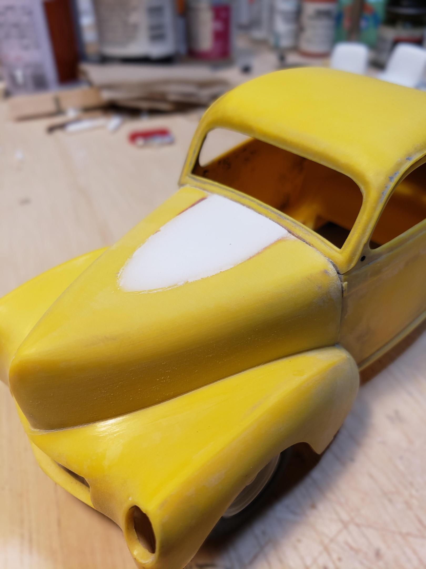

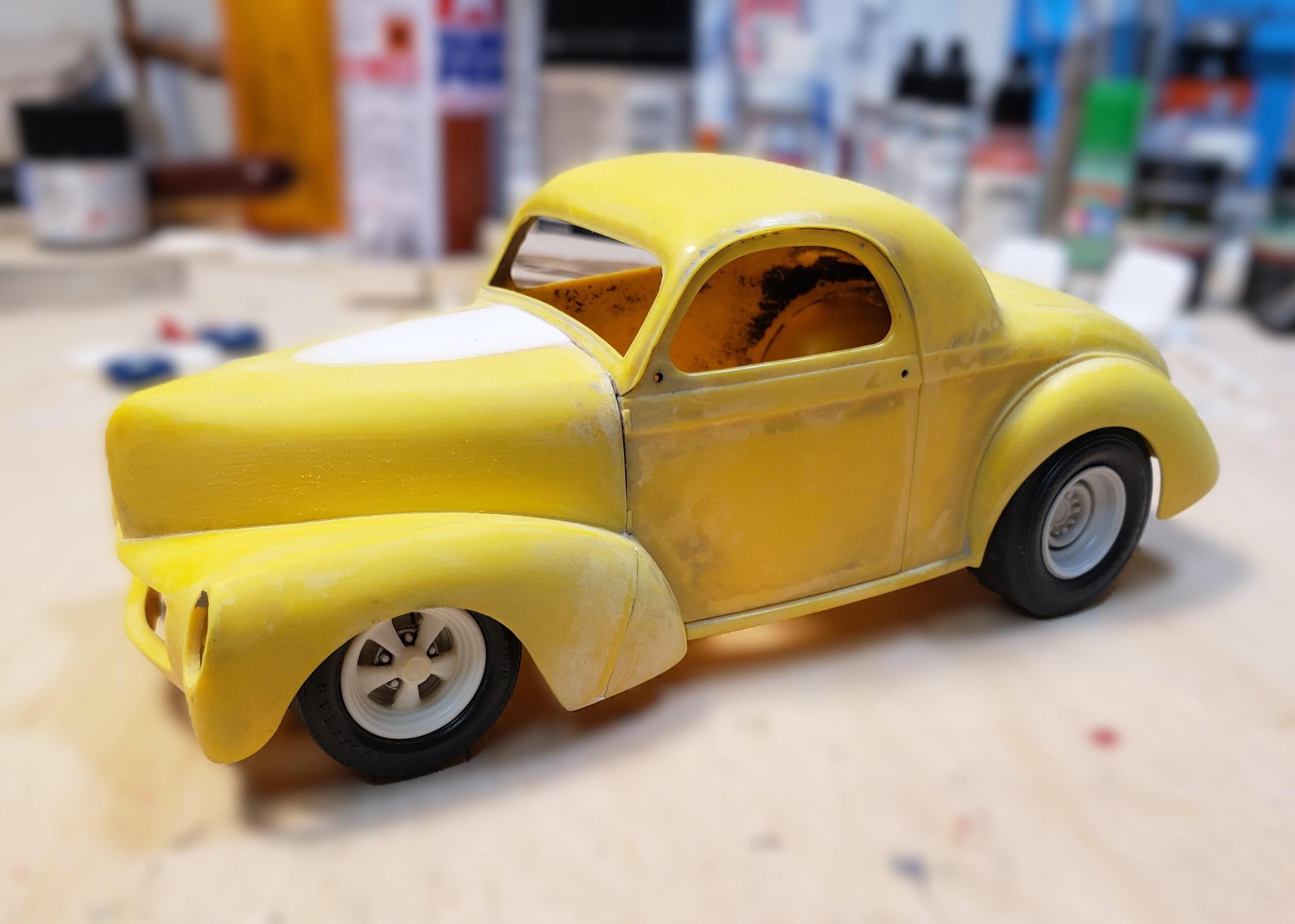

DJMar Posted June 15, 2024 Author Posted June 15, 2024 (edited) A little update for today. After letting the paint dry for a week or so, I decided that I was going to strip it and start over. I noticed a few areas of missed bodywork (a dip here, a gouge there) and I really, really disliked the black. It was way too shiny and it just didn't look good to me. After two heavy coats of oven cleaner & some scrubbing, most of the paint came off without too much trouble. Now I'm back to bare plastic. Some side effects of the oven cleaner - it totally eats solvent based putty and even some superglue. This means some more bodywork for me, including gluing the front fender seams together and smoothing out the styrene cap covering the hole in the hood. It's a bit rough at the moment, but I'll be working on getting things ironed out in the days ahead. Right now, the glue on the front clip is drying. Also, after looking through a bunch of old car mags, I came across this Willys in an issue of Traditional Rod & Kulture Illustrated. I like the color enough that I'm going to shoot this in some sort of light/medium metallic blue, this time around. Edited June 15, 2024 by DJMar spelling 1

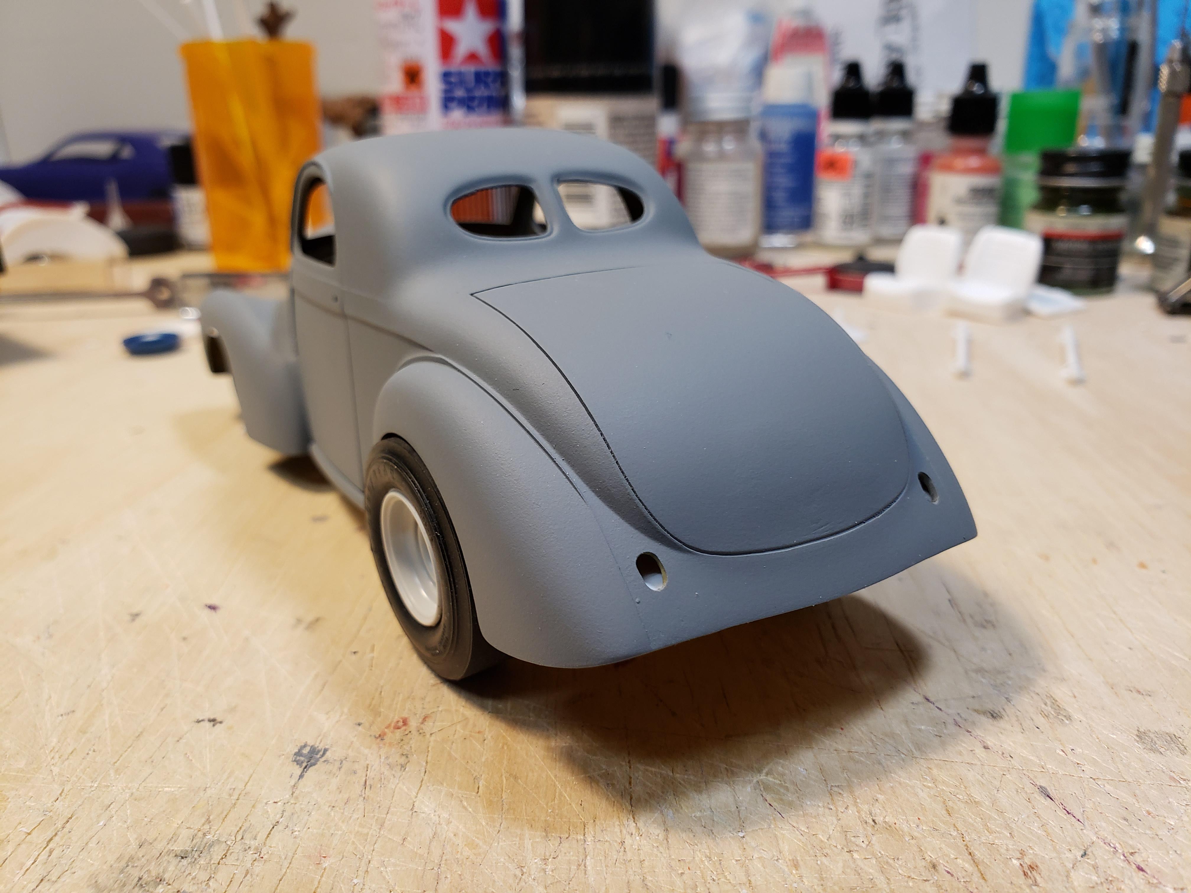

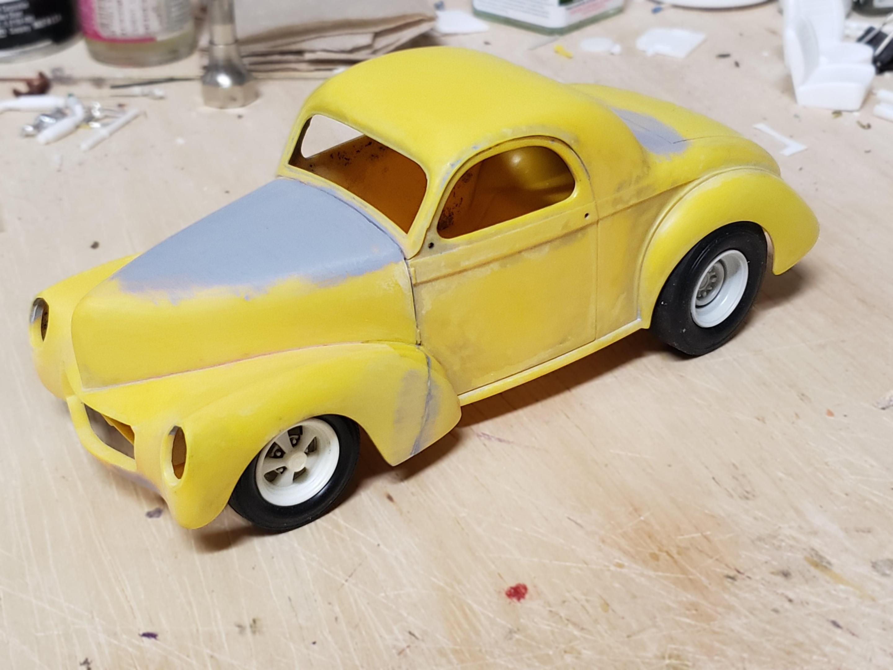

DJMar Posted July 21, 2024 Author Posted July 21, 2024 A little update on this one, as it's been languishing at the back of the workbench for far too long. Basically, all of the bodywork had to be redone. The front clip needed to be reattached, as it had come loose during the stripping procedure. There were seams to be filled, putty to be applied, and a whole lot of sanding. I've got most of the work covered in a coat of Mr. Surfacer 1000 to check my skills. Some areas need a little more finessing, especially along the fender/door area, which appear as shiny spots because I've got them coated in some liquid cement. Then it's back to a full coat of primer, and maybe one day, color. It ain't pretty, but we're getting there. 2

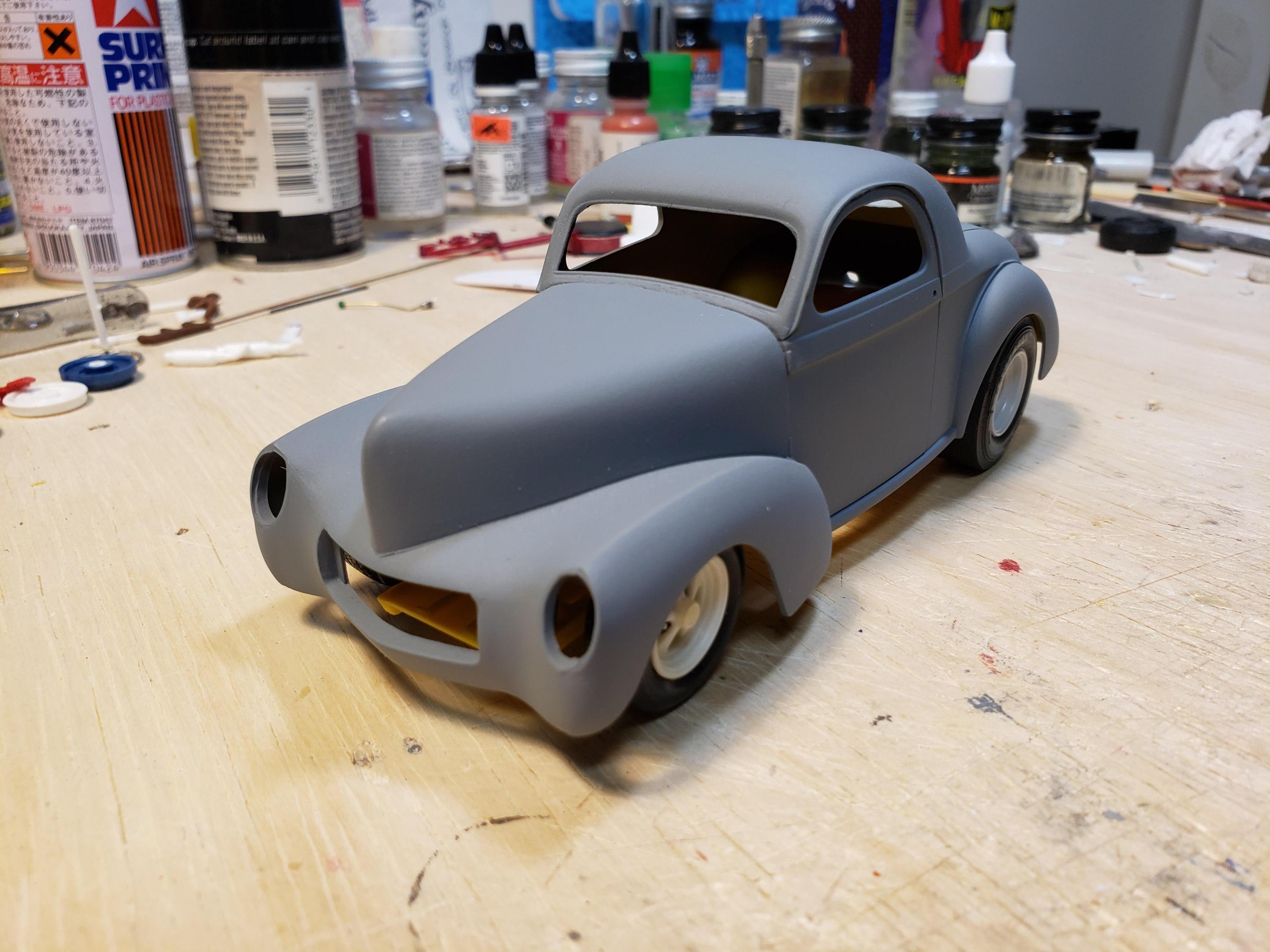

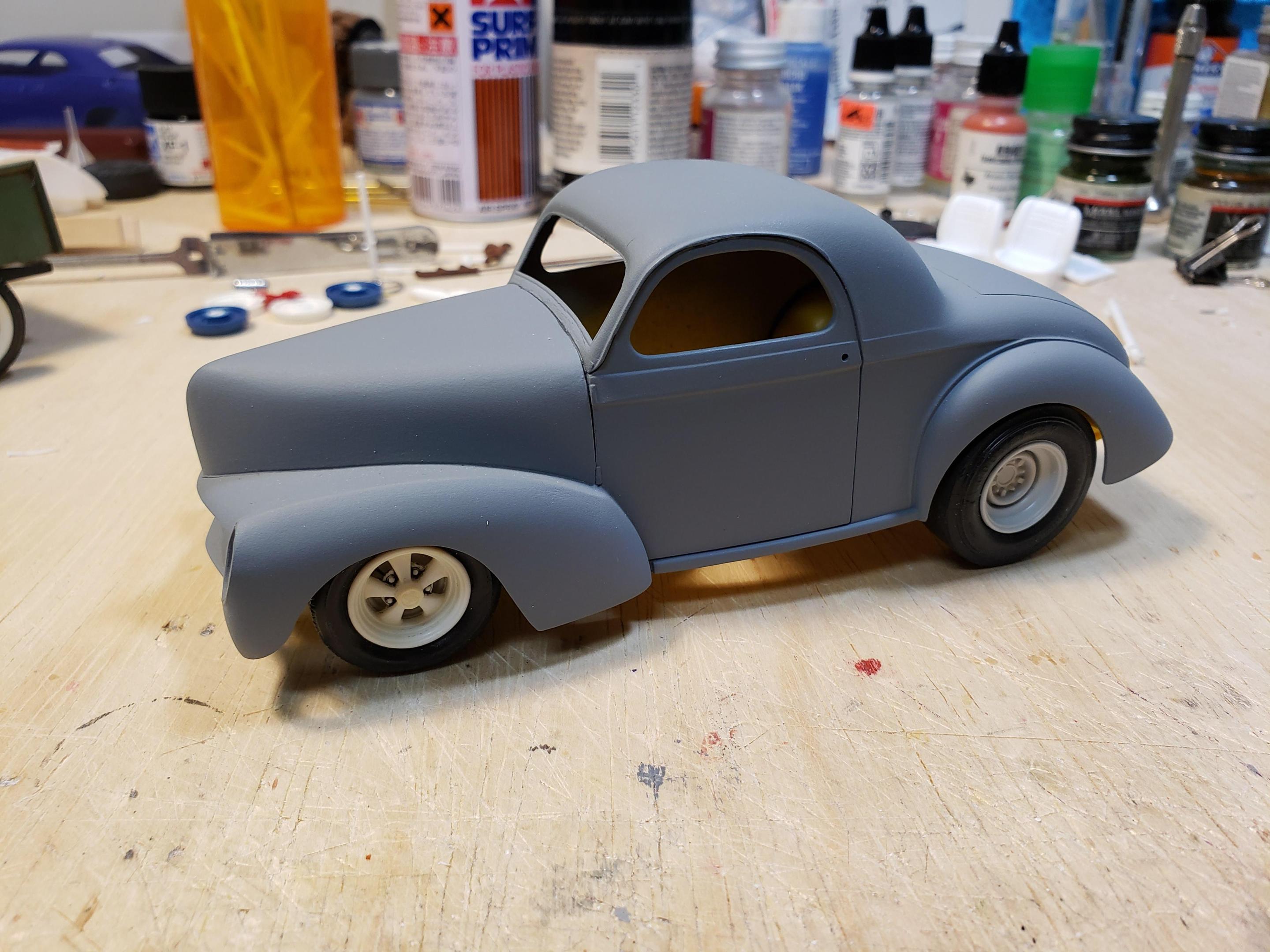

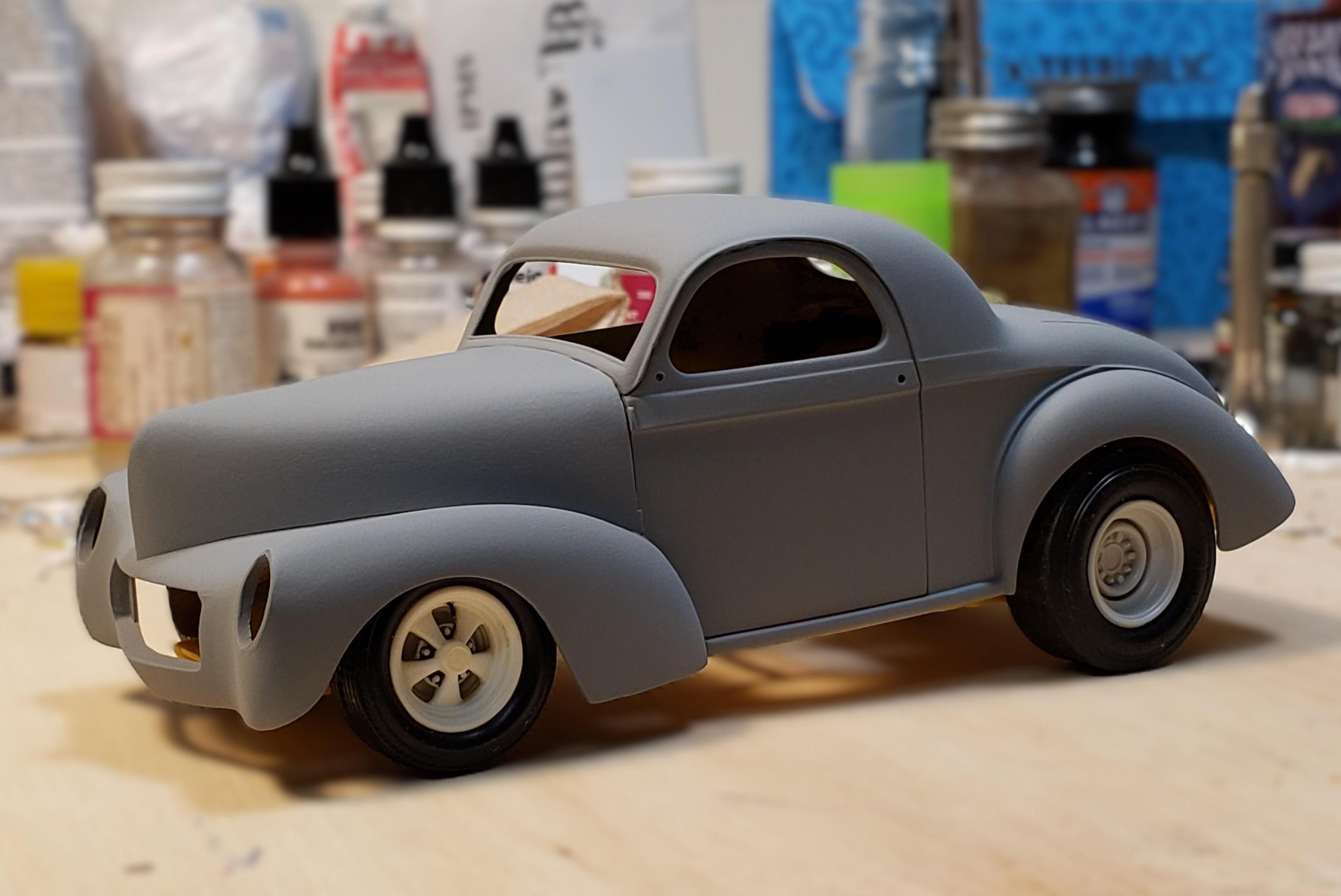

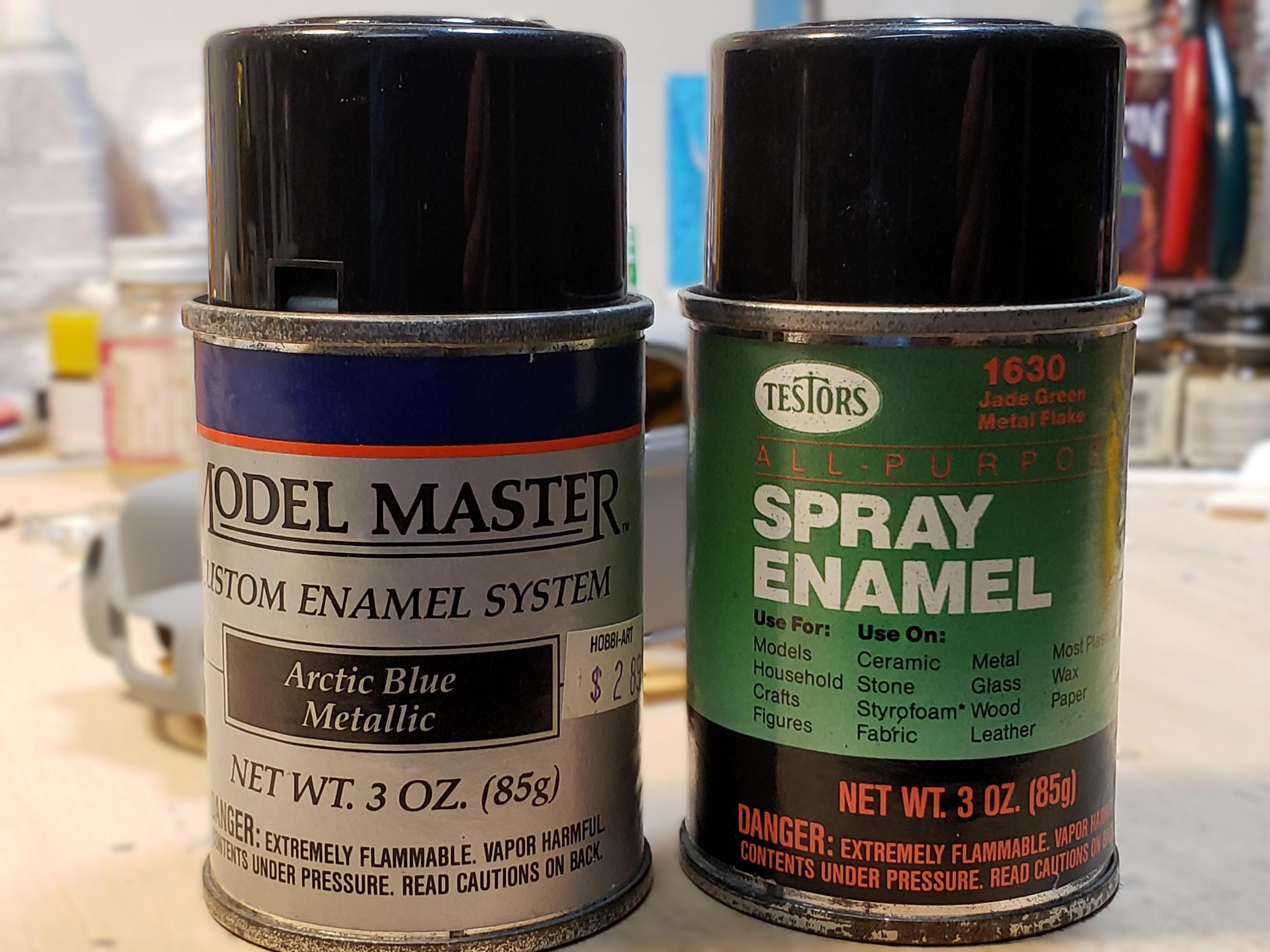

DJMar Posted July 29, 2024 Author Posted July 29, 2024 Finally...back in primer. Still need to let her cure fully and sand her down. Now, about that paint... I found these two ancient cans of spray on my shelf. The Testors Jade Green Metalflake is probably from the mid-80s, with the Model Master Arctic Blue Metallic maybe a decade fresher? Both are way past their prime, but I'm sorely tempted to warm them up, shake them out and see if they'll shoot. So what's it to be, the blue or the green?
LennyB Posted July 29, 2024 Posted July 29, 2024 Not to make extra work for you but I would switch to a white primer to bring out the color better. And my choice would be the green if it cooperates
Tim W. SoCal Posted July 29, 2024 Posted July 29, 2024 Nice Willys, DJ. I think the blue would look bitchen on that body. 1
DJMar Posted July 29, 2024 Author Posted July 29, 2024 56 minutes ago, LennyB said: Not to make extra work for you but I would switch to a white primer to bring out the color better. And my choice would be the green if it cooperates Normally, I would agree. IIRC, both those paints are sort of translucent, so I'm going to spray them out and see how they cover first.
Zippi Posted July 29, 2024 Posted July 29, 2024 I'm diggin the blue and like Lenny said, use a white primer.
