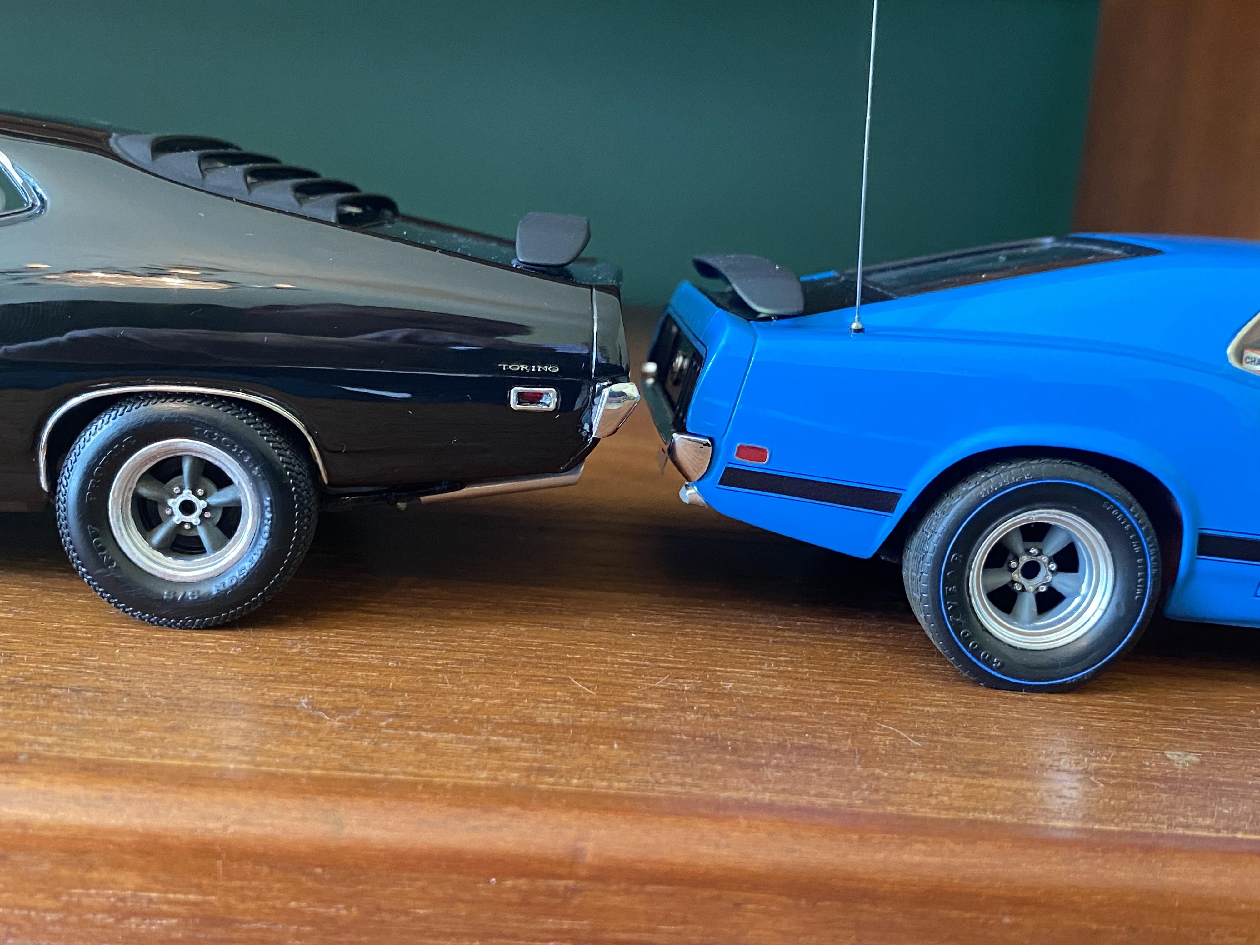

Bainford Posted June 10, 2024 Posted June 10, 2024 (edited) The colour seems to have changed throughout the years. The wheels from the 60s/70s appear to be a light flat grey, while the later wheels from the 80s on wards appear to be a much darker flat or satin grey. Whether there have been just these two variations, or many variations of grey over the years, I can't say. For early period builds, I go with the lighter grey. Greg's suggestion to use primer for this would work well. Additionally, they are frequently painted and could conceivably be any shade of grey, or any other colour for that matter. There may be actual specific colours for the different eras, and perhaps someone will chime with specific knowledge. A flat or semi-gloss finish seems pretty much standard across the board. On the two examples below, the Torino is wearing an unknown dark flat grey, and the Mustang is wearing a lighter custom mix of Tamiya Tank Grey and Flat White acrylic, approximately 70/30 mix. Edited June 10, 2024 by Bainford 1
Charliem53 Posted June 10, 2024 Author Posted June 10, 2024 Thanks for the responses. The Torino has the wheel color I'm looking for. I'll try a few different primers and see what I come up with. Charlie

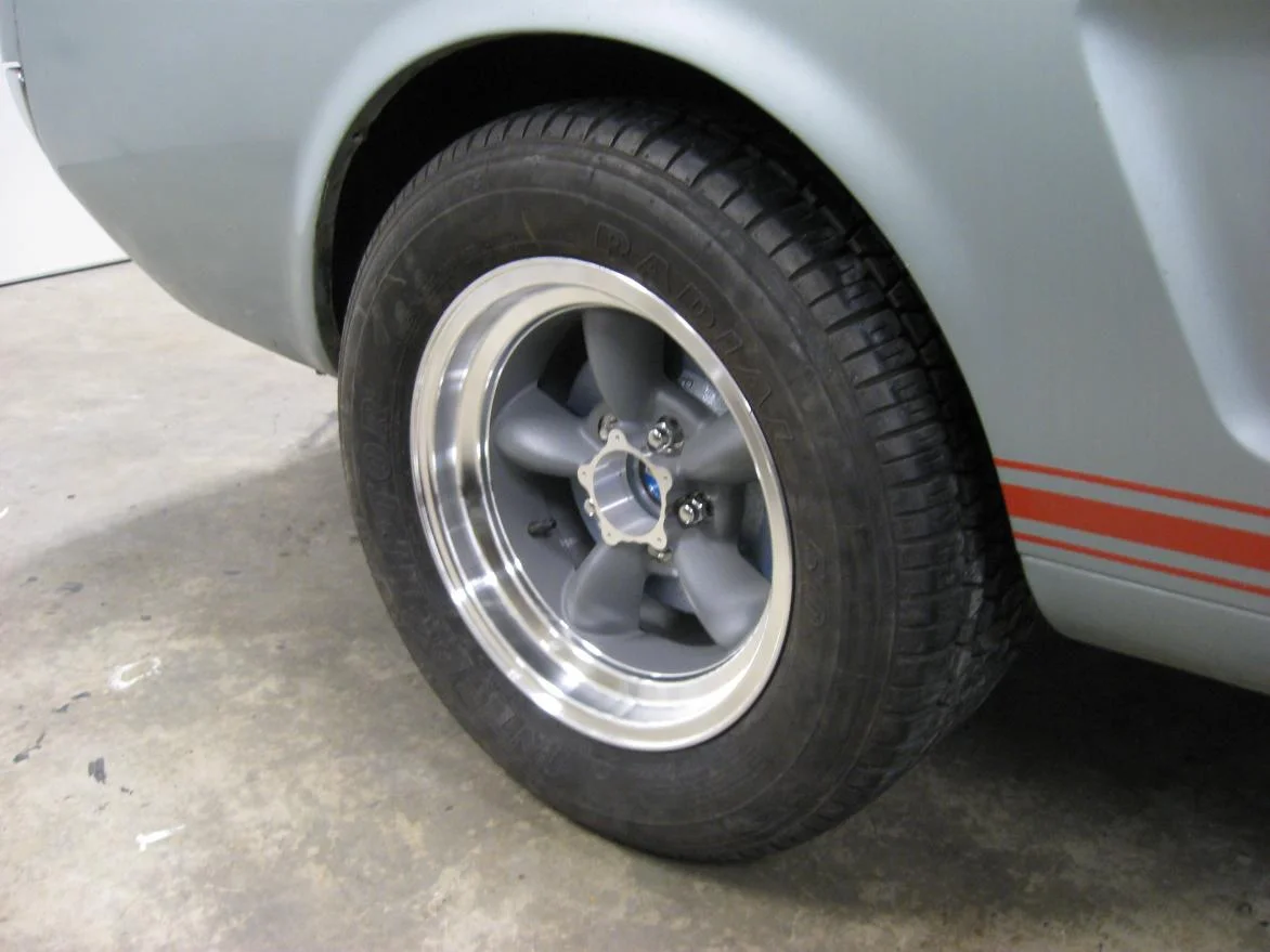

bill-e-boy Posted June 14, 2024 Posted June 14, 2024 And some are fully polished And some have painted centres with polished rims And most are painted centres with a machined finished rims which are satin ally
