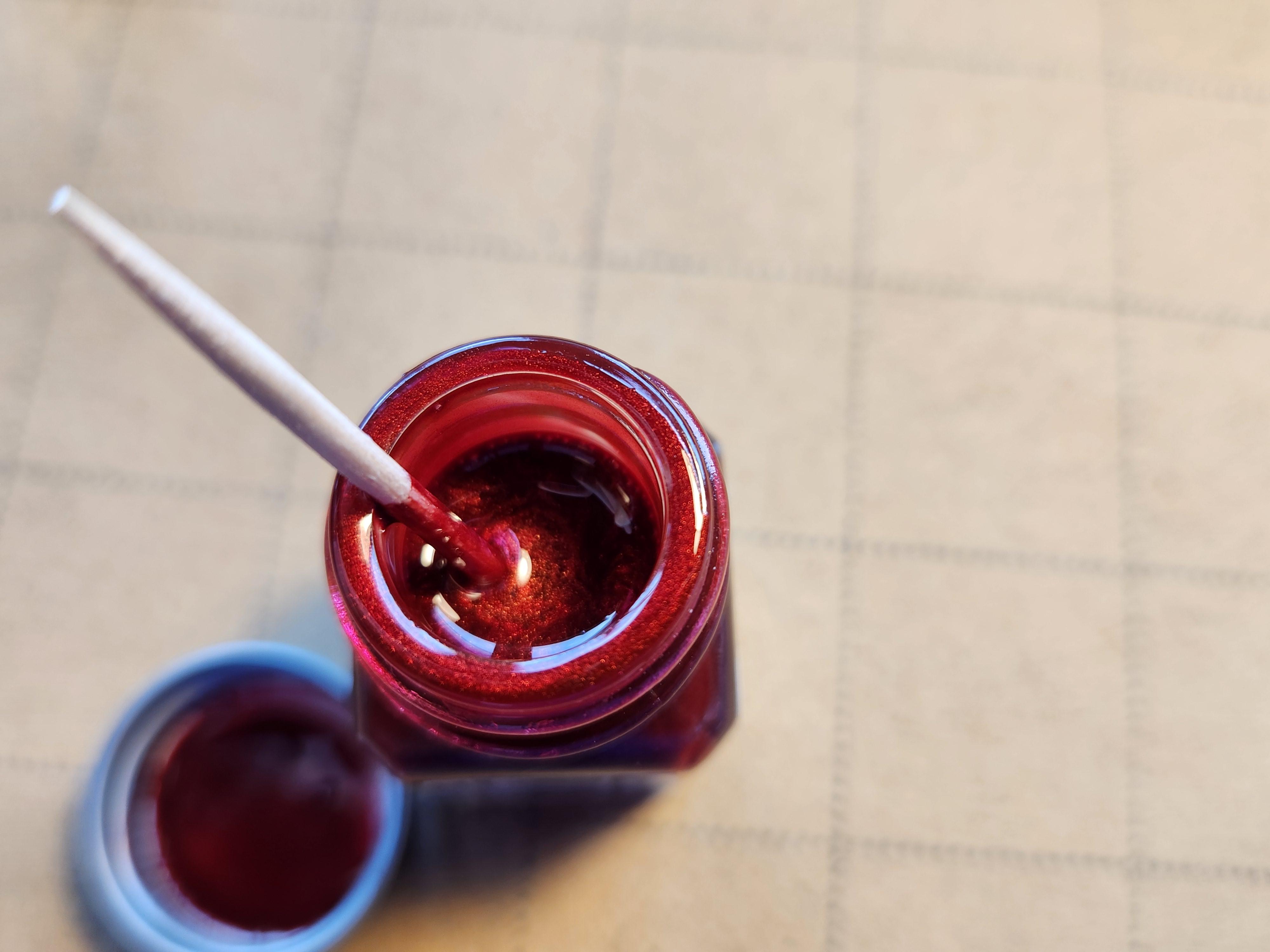

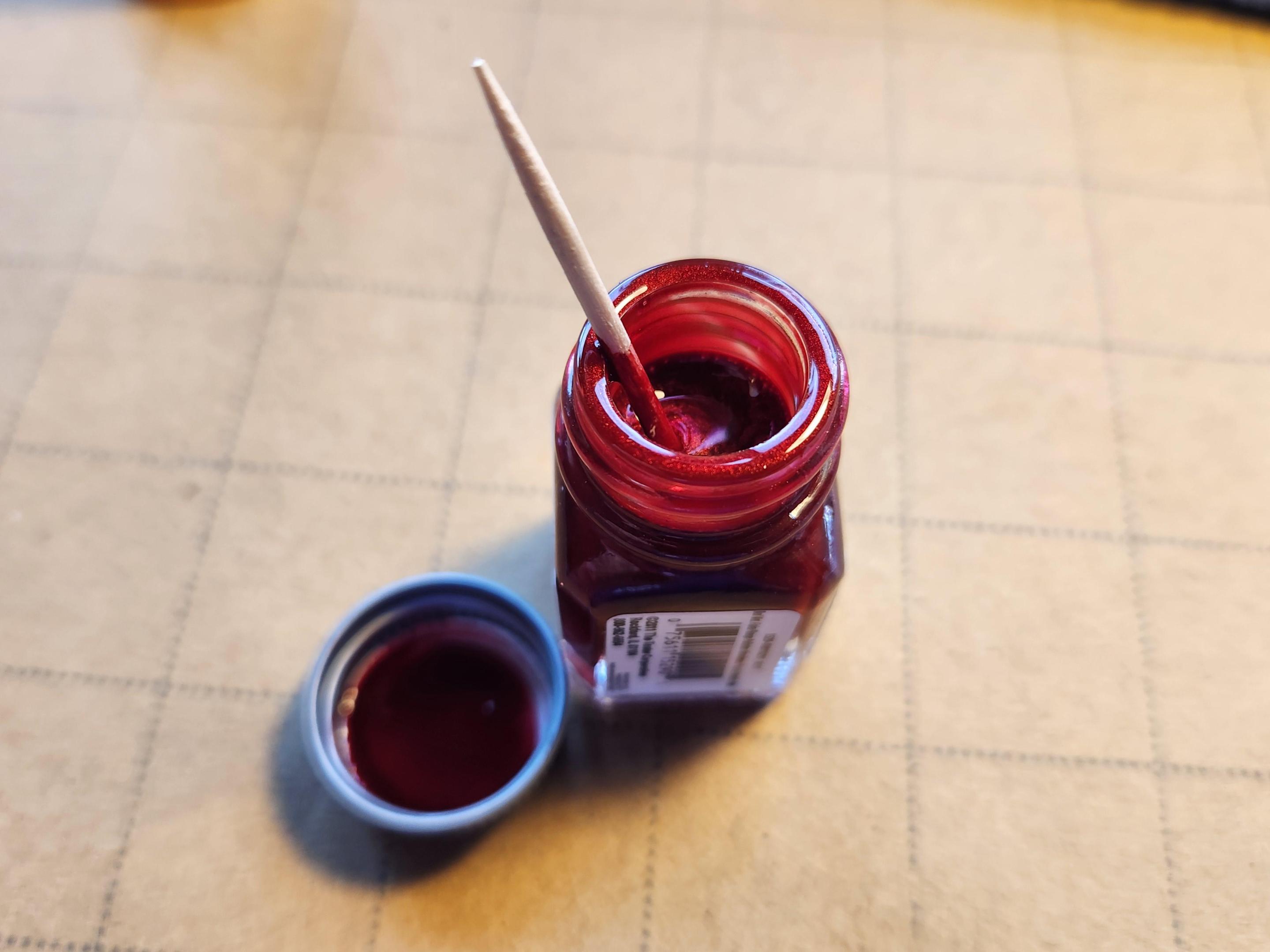

FoMoCo66 Posted June 11, 2024 Author Posted June 11, 2024 59 minutes ago, Skip said: I've shot a ton of paint through airbrushes doing sign work, custom automotive stuff, and model stuff over about a 30 plus year spread; it depends on what you are painting and the overall appearance you are looking for. High Shine - Either Enamel or Lacquer, thin both with Lacquer Thinner (Reducer) The High Shiny Luster comes from the after paint and clear coat wet sanding either color sanding or wet sanding over the clear coat. Medium to Shiny Luster - Acrylics + an Acrylic Clear Coat - Flat - Med. Luster - Shiney Clear Coat, you can use an Enamel, Lacquer or 2K Clear Coat over acrylics, In my opinion, I don't think they look as well as the Acrylic Clear Coats. You can buff the Acrylic Clears with a microfiber cloth or I have even heard of people using coffee filters to buff acrylics out to achieve more shine. Brands - Vallejo Acrylics, Model Air or Game Air are the two go to pre-thinned paints that I use for acrylic painting. I do on occasion use thinned craft paints thinned with either or both Vallejo Reducer or Vallejo Flow Improver. Thin the paint to just slightly thicker than skim milk, so say whole milk should just about right to begin with, adjust the paint thickness once you start spraying to get a good spray pattern. Use a good Automotive grade lacquer-based primer, white, red oxide, gray or black matched to the color you are shooting. If you shoot a Lacquer Clear coat test the stacked paints Primer-Color Coat- Clear Coat for overall compatibility, I've never had an issue with acrylic compatibility, but I still do test it for overall compatibility, so I don't get caught in a bind at the last minute. Enamels and Lacquers - MCW Paints, Scale Finishes, Splash Paints, Tamyia, Testers and a few others are what I usually shoot through the airbrush for bodies and some interior colors again there are clear coats in the flat, med and shiny ranges from the manufacturers line or another that is tested compatible with the color coat that you are shooting. Use a good Automotive grade lacquer-based primer, white, red oxide, gray or black matched to the color you are shooting. Testing overall paint stack up, I always check the paints used Primer-Color Coat- Clear Coat for any compatibility issues, there have been times when I have been caught in a bind with Lacquers and Enamels reacting even after testing, often it is an issue of too much thickness of the clear coat reactivating the primer under the color coat, depending on how severe the reaction is you might get lucky and jus sand the orange peel out, other times it involves a trip to the purple pond for complete stripping. Rattle Can Paint Straight From the Can - I still use Rattle Can paints right out of the can, painting with a Rattle Can should be your first paint delivery system that you master. Doing to may require a whole lot of stripping, sanding and polishing but it is the easiest paint system we use in building models. Decanted Rattle Can Paint - Typically decanted rattle can paints are not in my preferred materials, I use them but really infrequently. I do not decant any of the primers that I use, I prefer to shoot them onto the bodywork straight from the can to get both enough coverage and thickness enough to do some finish sanding on the primer. Dehydrator - If you don't own a Dehydrator yet, get one, this is one thing that will help you get better with all of the paints we use, I use my $3-Garage Sale dehydrator on everything that will fit into it. Not only does a dehydrator speed up the curing process, it also in most cases yields a harder paint finish that can be polished out quicker. Make sure the dehydrator you get has a temperature control on it and do not exceed 110 to 115 degrees F. That's probably enough to get you going, and for all the others who have their own patented paint systems arguing about what and which is the best! LoL!! I hope not! The real thing here is to develop a painting system that works for you, where you're at, and with the temperatures you have in your area. That's why sometimes someone will recommend a certain primer, paint, thinner and clearcoat combination; the works like a charm for them, doesn't quite work somewhere else. That's when painting gets exasperating because you are getting sound advice from someone the combination works for them, but you are having problems getting it to work for you. The key to fixing paint issues is taking small steps back to a repeatable condition. Then follow that process every time you paint! Long answer, but hope it helps you on your airbrush painting journey... WOW! That's a lot of amazing information! Right now I am experimenting with testors enamels. I just picked up there metal flake red, it looks amazing. This is the color I plan on painting my kustom 67 corvette by mpc.
Oldriginal86 Posted June 11, 2024 Posted June 11, 2024 That is a very nice color on just about any model. With different base colors, the finished color can be manipulated. Silver or gold base makes the metal flake pop. With a dark base it will come out as a “black cherry” look. That color red is semi transparent so be sure the base coat is consistent all over. Good luck and post the results. 1

Dave G. Posted June 12, 2024 Posted June 12, 2024 (edited) On 6/11/2024 at 4:37 PM, FoMoCo66 said: WOW! That's a lot of amazing information! Right now I am experimenting with testors enamels. I just picked up there metal flake red, it looks amazing. This is the color I plan on painting my kustom 67 corvette by mpc. This color you don't want to thin 1-1. Using lacquer thinner dump the content of the bottle into a mixing cup, fill it ( the empty bottle) a bit over half way with just regular hardware store lacquer thinner and mix that into the paint in the cup. Stir together. This should spray nicely with a medium sized tip and 23 or so lb air pressure. I've even shot enamels up around 30 or 35 psi ! Keep back from the model a bit and fog the paint on. This will disperse the metallic flakes nicely and the paint should self level on the surface. If you shoot in too closely you could get striping in the finish. You can open up the paint flow more on your last pass around the model, which will improve gloss. Just keep going around the model till it's well covered. If you thin too much it won't cover, you won't get the color you're looking for and it will dry duller because the metallic flakes will surface. Someone covered base color ( or primer color/tone) so I won't go there. Edited June 13, 2024 by Dave G. 1
bluestringer Posted June 12, 2024 Posted June 12, 2024 I use the Testor's enamels from time to time. I take the bottle and dump it into a 1oz. paint bottle. I then fill the Testor's bottle with cheap lacquer thinner and shake it up really well. Then dump that into the 1oz bottle with the paint. Shake it well. It sprays great like that, and usually does not require any clear as it comes out nice a shiny. 1
Dave G. Posted June 12, 2024 Posted June 12, 2024 47 minutes ago, bluestringer said: I use the Testor's enamels from time to time. I take the bottle and dump it into a 1oz. paint bottle. I then fill the Testor's bottle with cheap lacquer thinner and shake it up really well. Then dump that into the 1oz bottle with the paint. Shake it well. It sprays great like that, and usually does not require any clear as it comes out nice a shiny. That would be correct for most of their color range. I do something similar. But I've seen that metallic burgundy color thinned 1-1, suffice it to say that I personally would want it just a bit thicker. That's also why I suggested a bit more air pressure. 1
