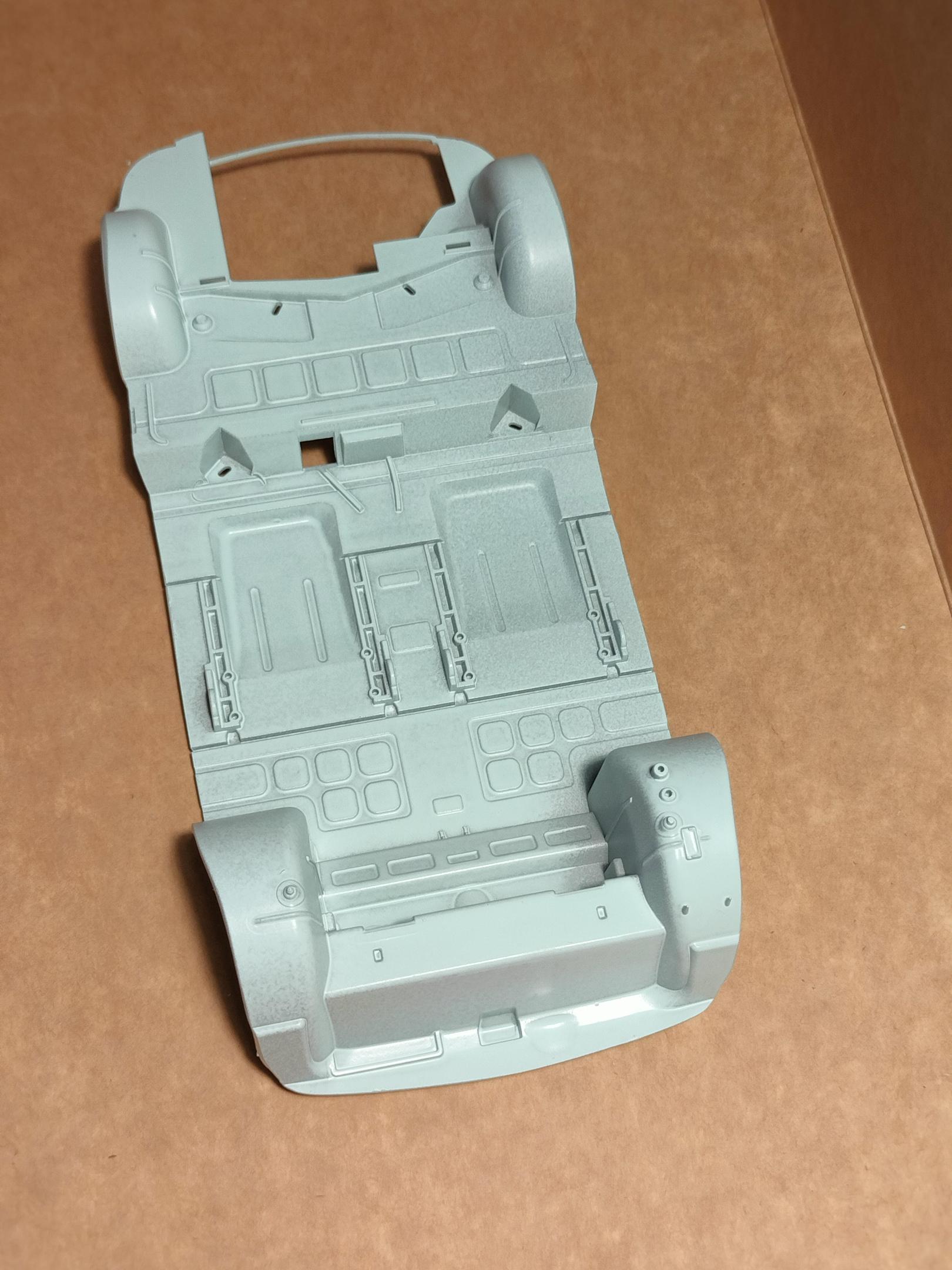

Never mind. This wip is rather autobiographic. Actually this model is a copy of the 500 i used to drive as a youngster.
The starting point is, again, the Italeri kit scale 1/12. The kit is a good one, the only blemish IMHO is that Italeri decided to have some moving parts in the suspensions and the steering system. Apart from the fact that nobody in his right mind will try to play with such an expensive and delicate model, the result is that the suspensions are rather weak and can break very easily. Apart from that, the kit is spot on and the shape of the car is reproduced in an excellent way.
The build will be "out of the box" and i will add some accessories.

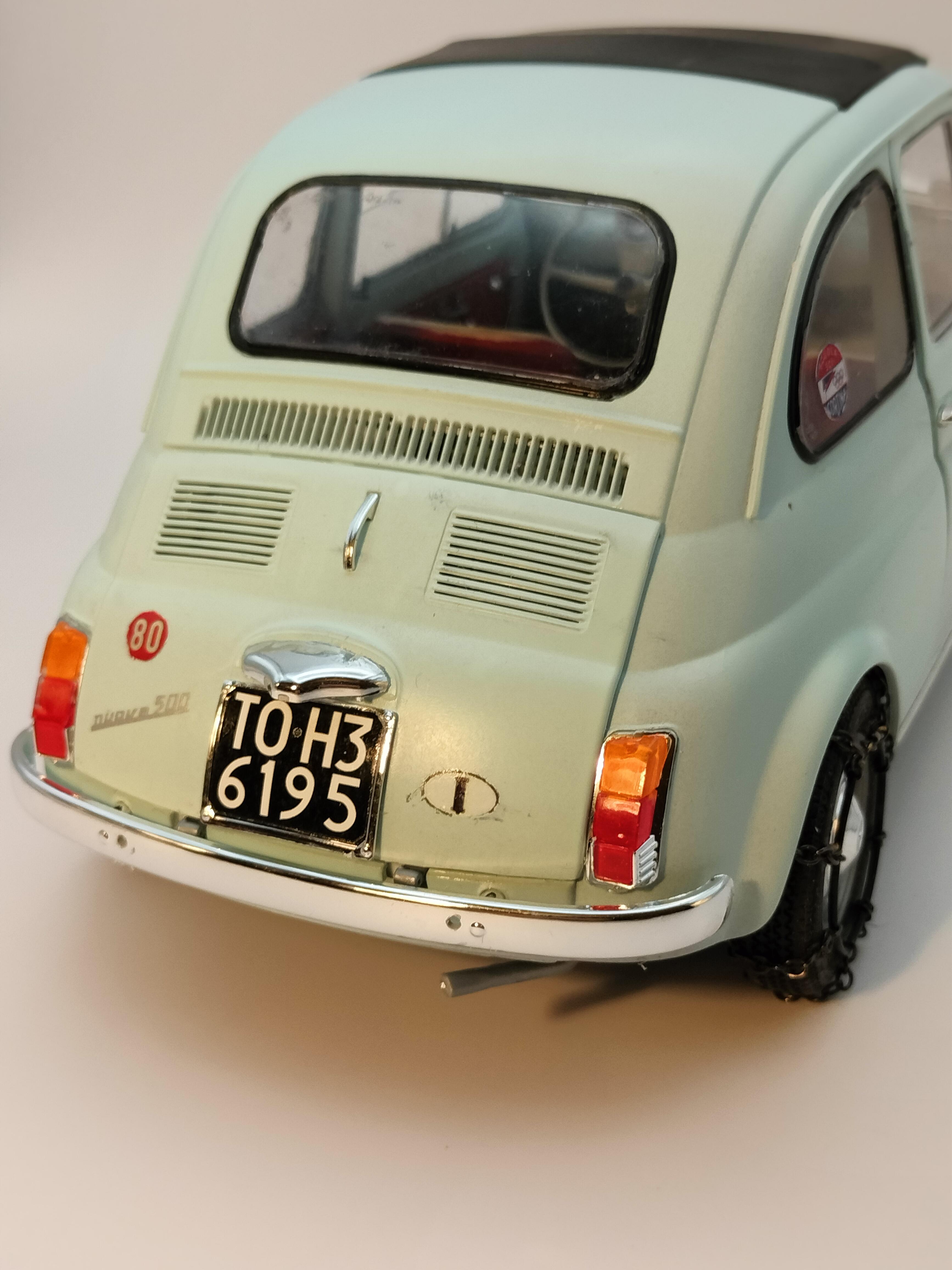

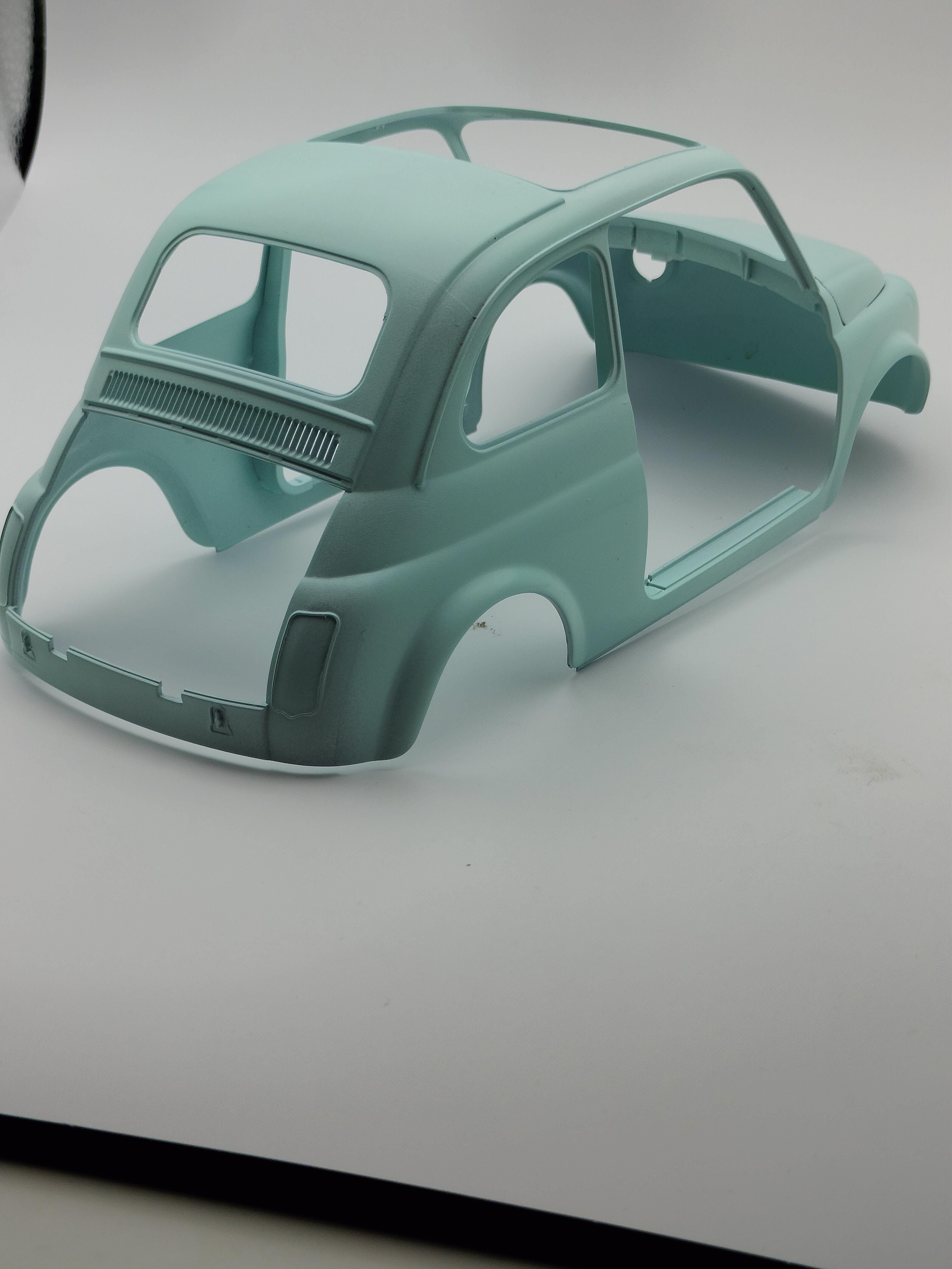

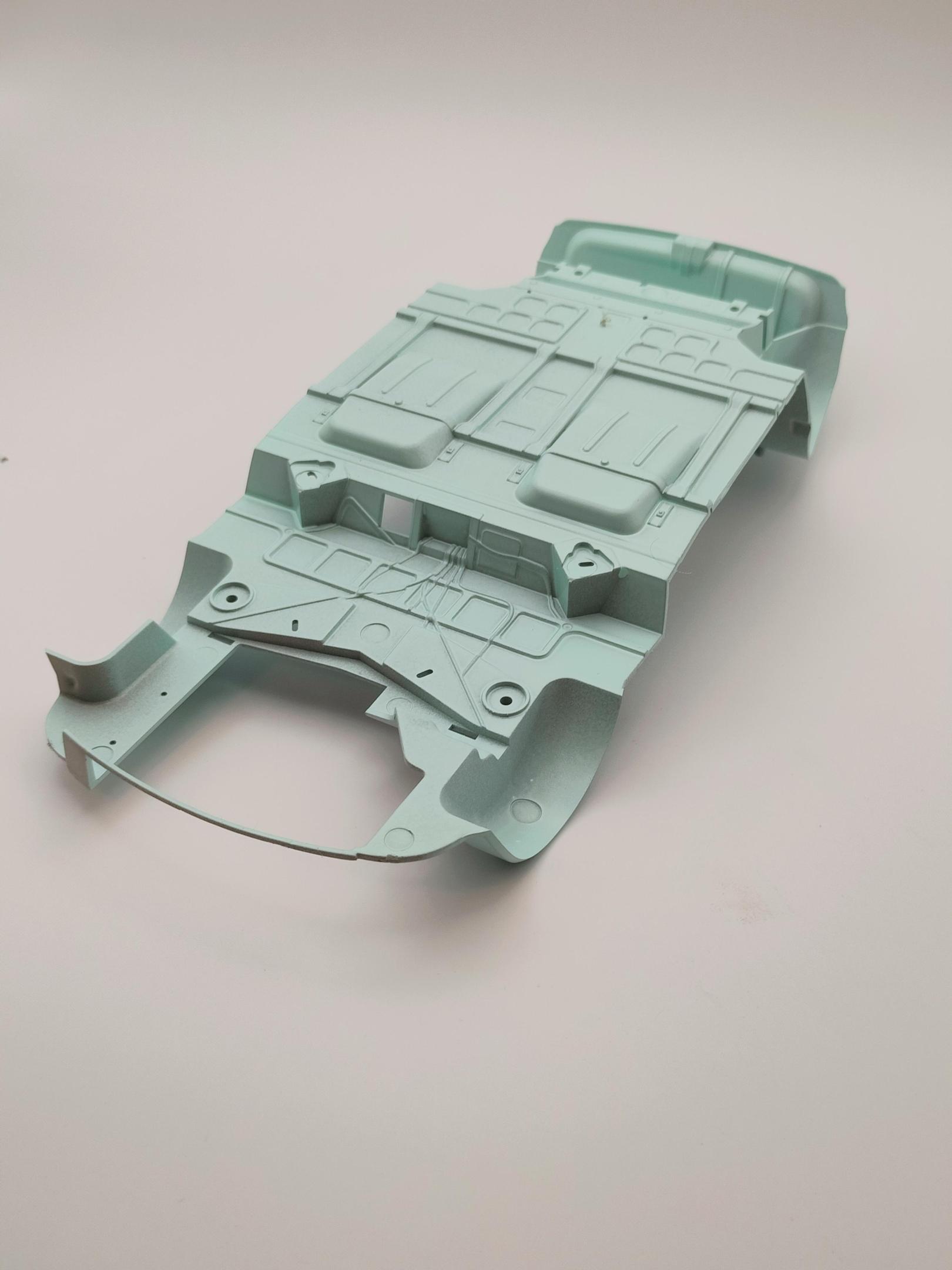

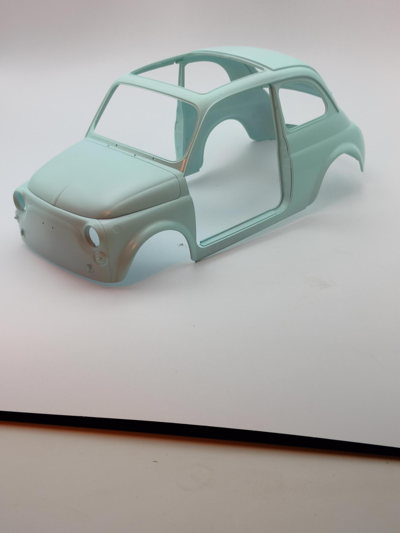

As I said, this is a autobiographical model, so my 500 had to be painted in original colour. To avoid any mistake, I found the proper colour code as supplied by one of Fiat 500 owners Club. The colour is "Celeste acquamarina", roughly translated as seawater light blue. I had one spray bottle custom mixed in a local shop and I was quite happy with the result.
  • Like 3

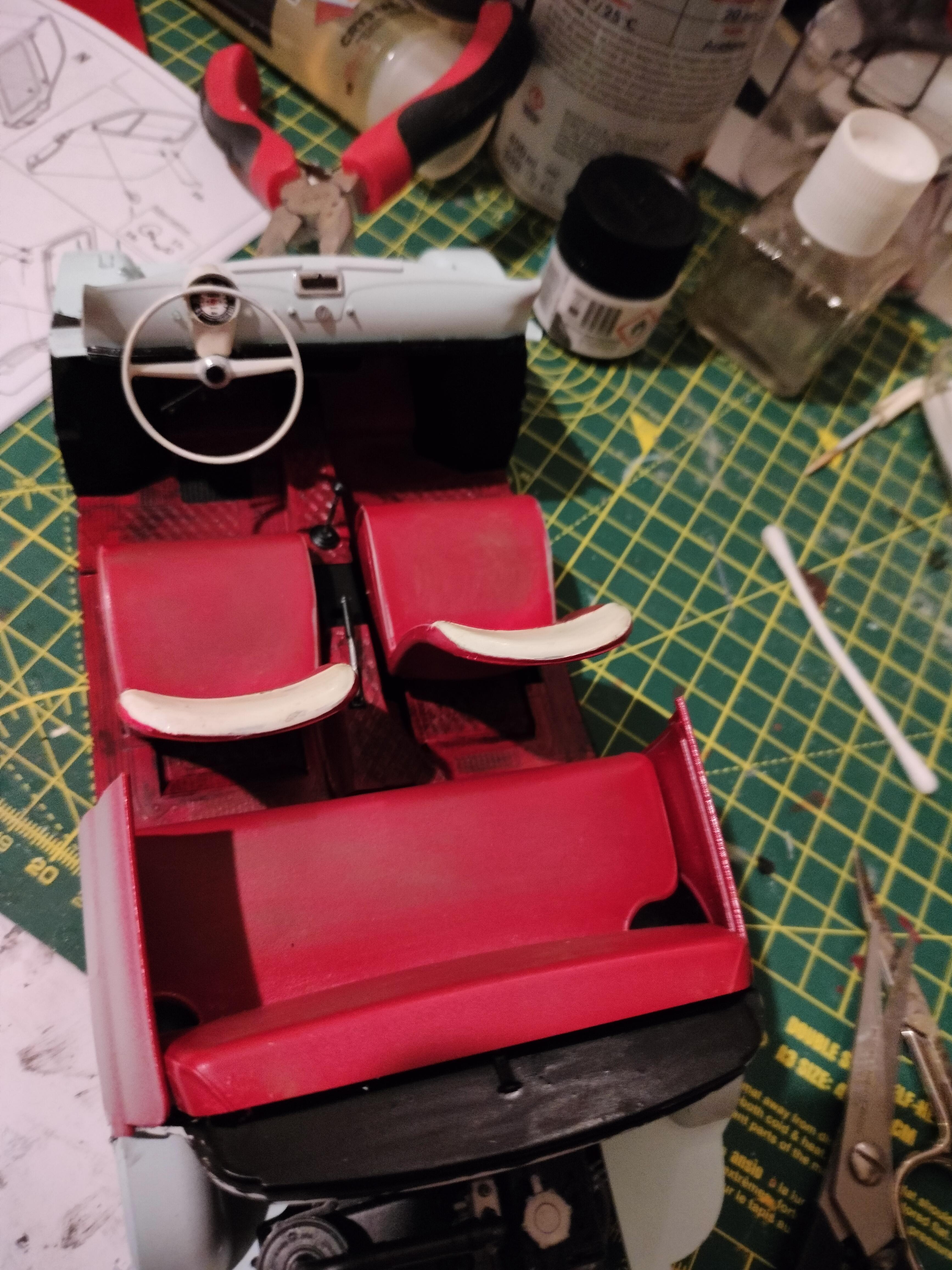

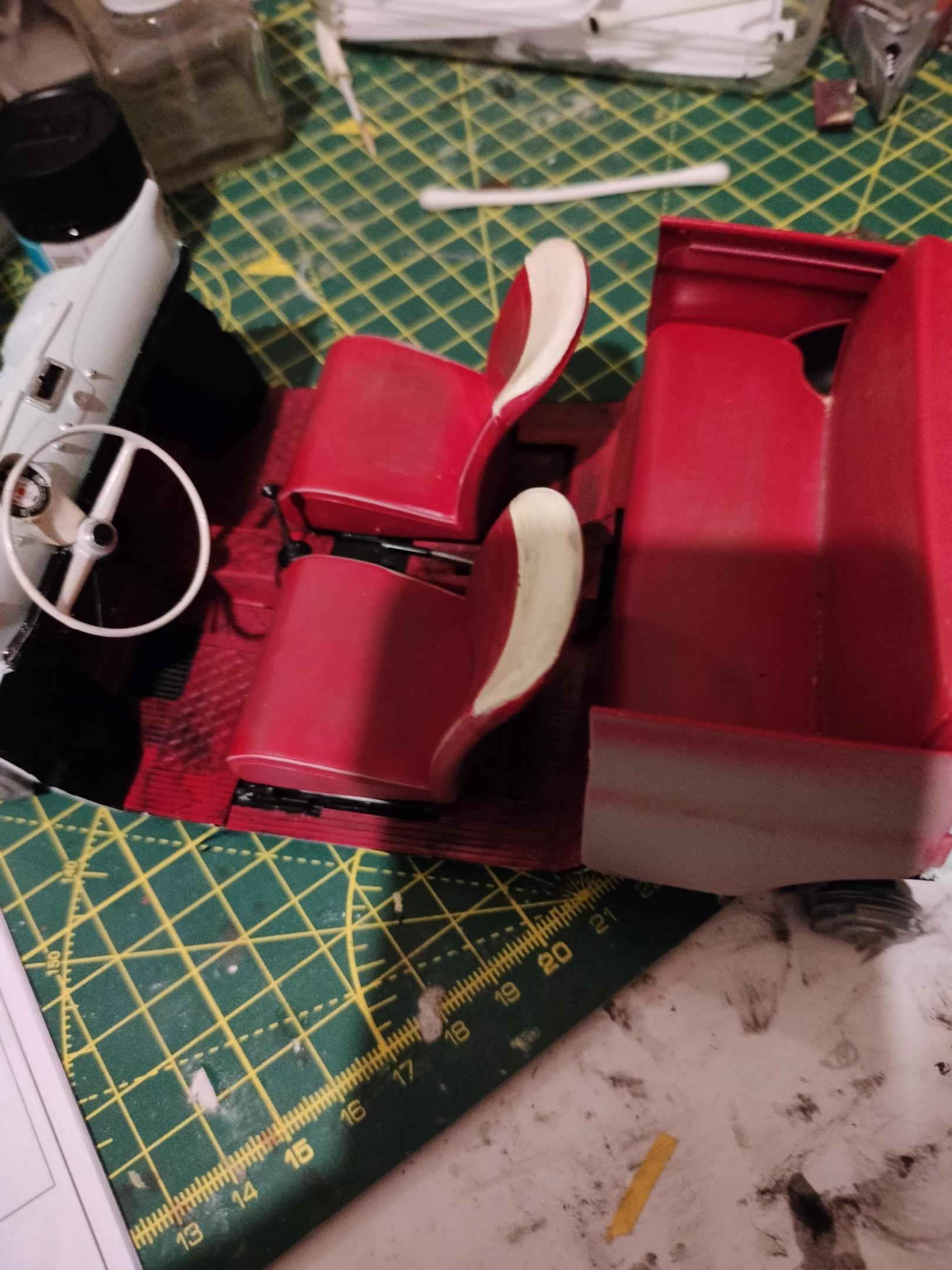

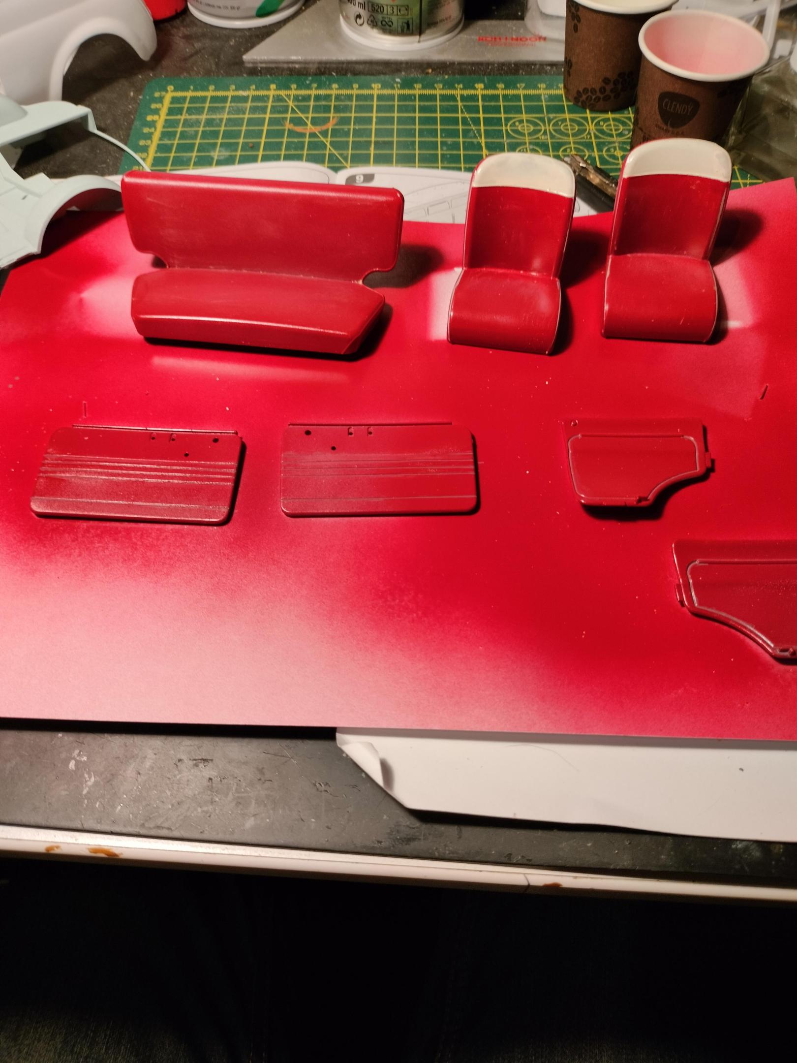

Painted the seats and the door cards. The colours are correct enough. Obviously in this case you don't have any colour code as a reference, so I used some pictures from the net and my memory.
  • Like 1

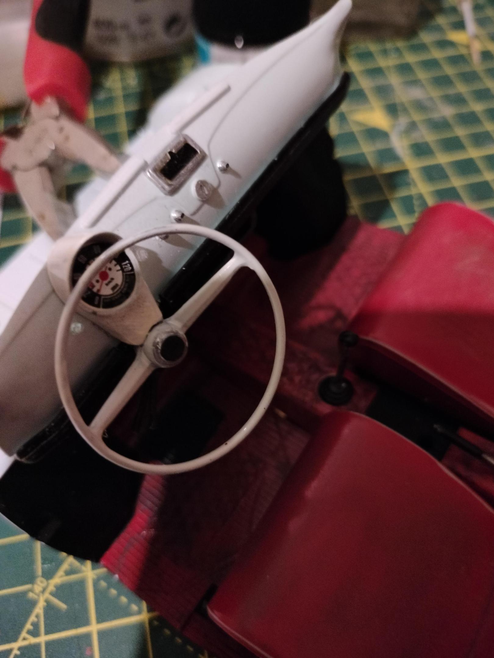

Here are some pictures of the interiors.
Just like to point out the marvelous naivety of the dashboard: one switch for the lights, one switch for the tergi and the keyhole. That's all. Just plain sheet metal, no padding whatsoever (obviously no seat belts either) and the windscreen washer activated by a small manual pump: a rubber button to be pressed vigorously in order to spray a feeble jet of water !
  • Like 1

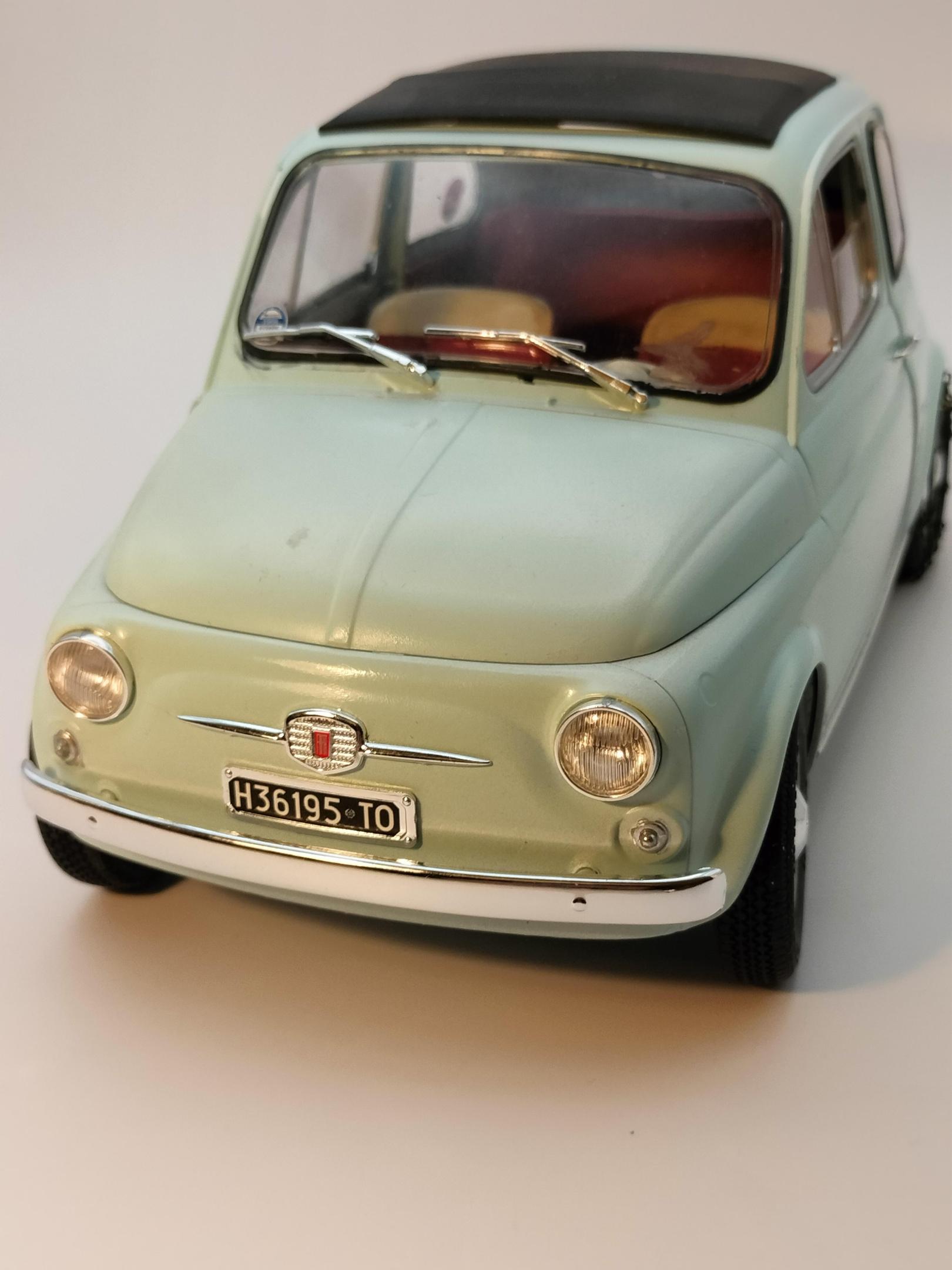

Well. The model is quite completed.
But now let's go to the mountains.

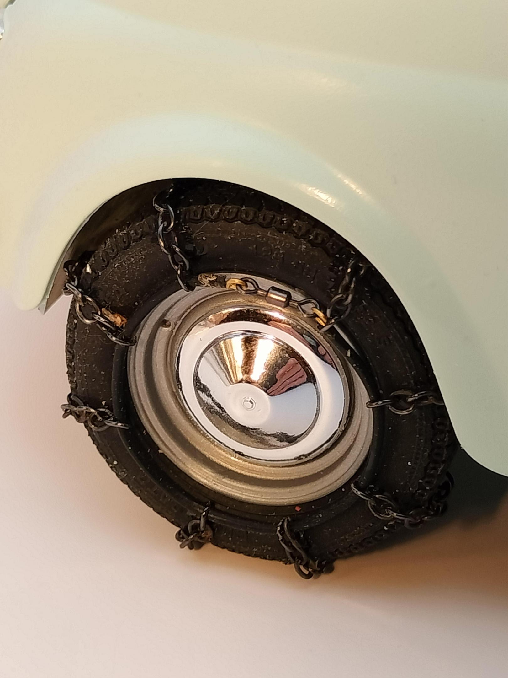

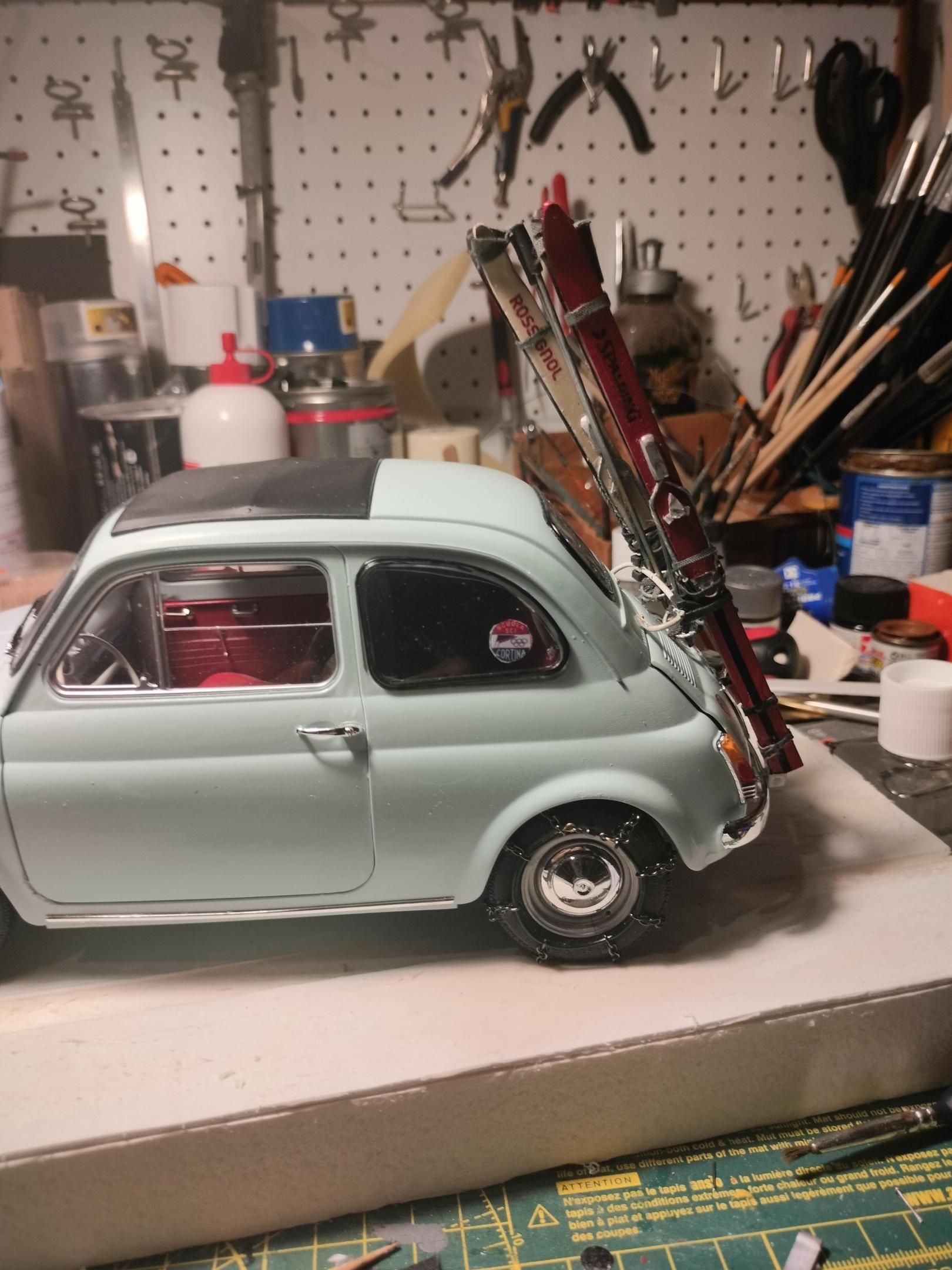

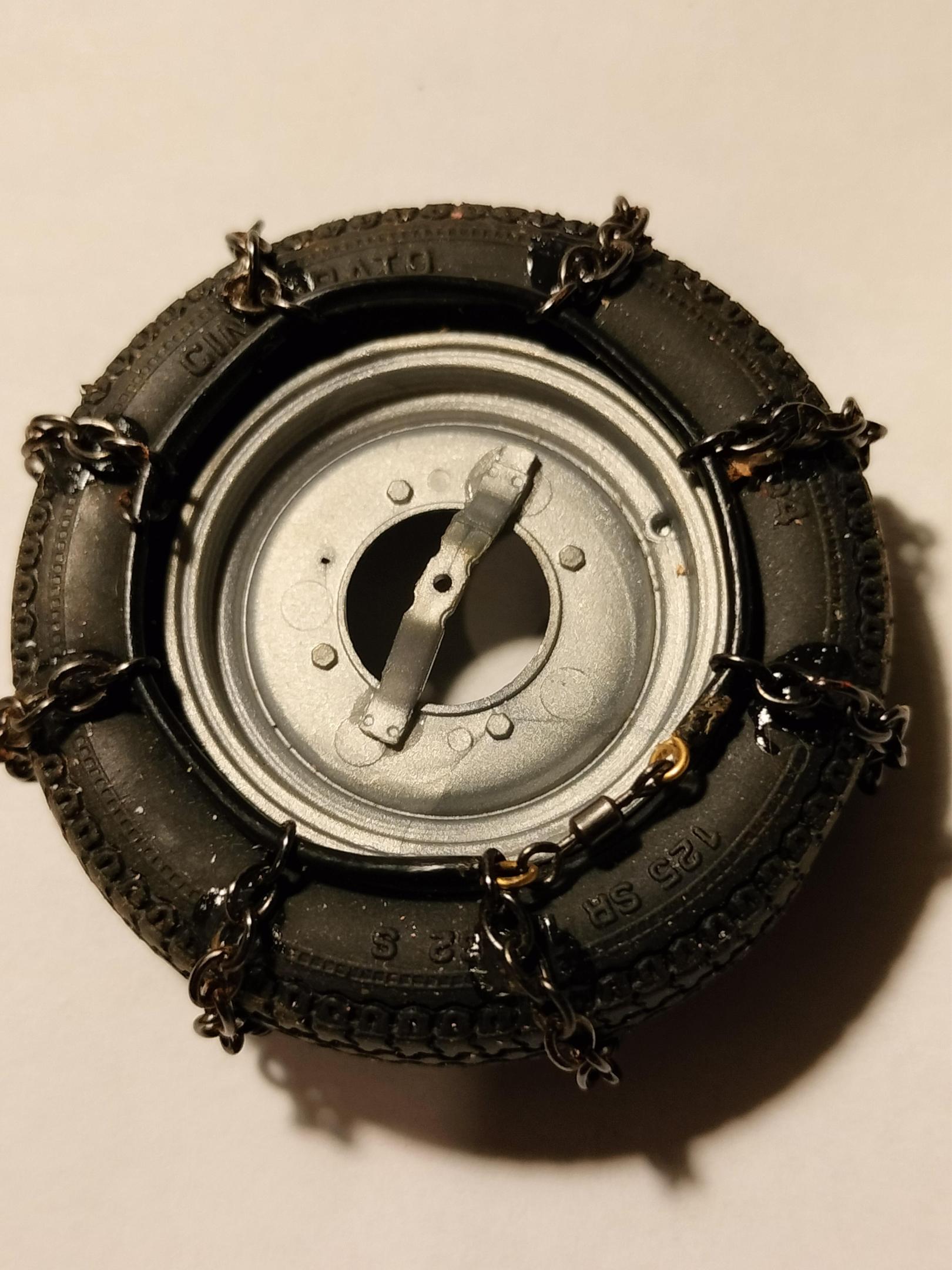

So my model must be well prepared to face the adversities of a winter journey. First of all, we need the snow chains.
To make the snow chains I used some chains sourced from naval models and some small connectors coming from fishing tackles. The result was quite nice.
  • Like 1

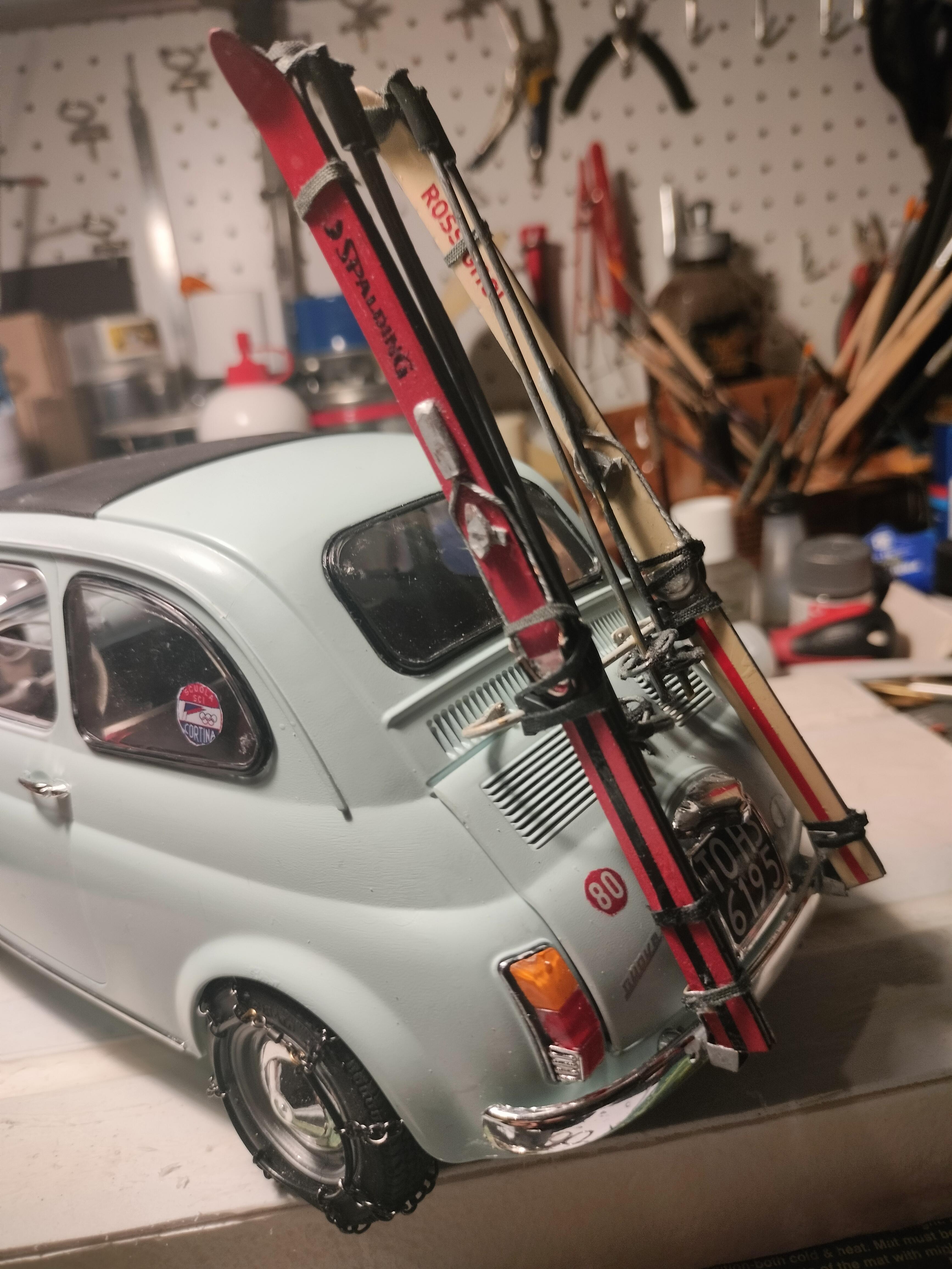

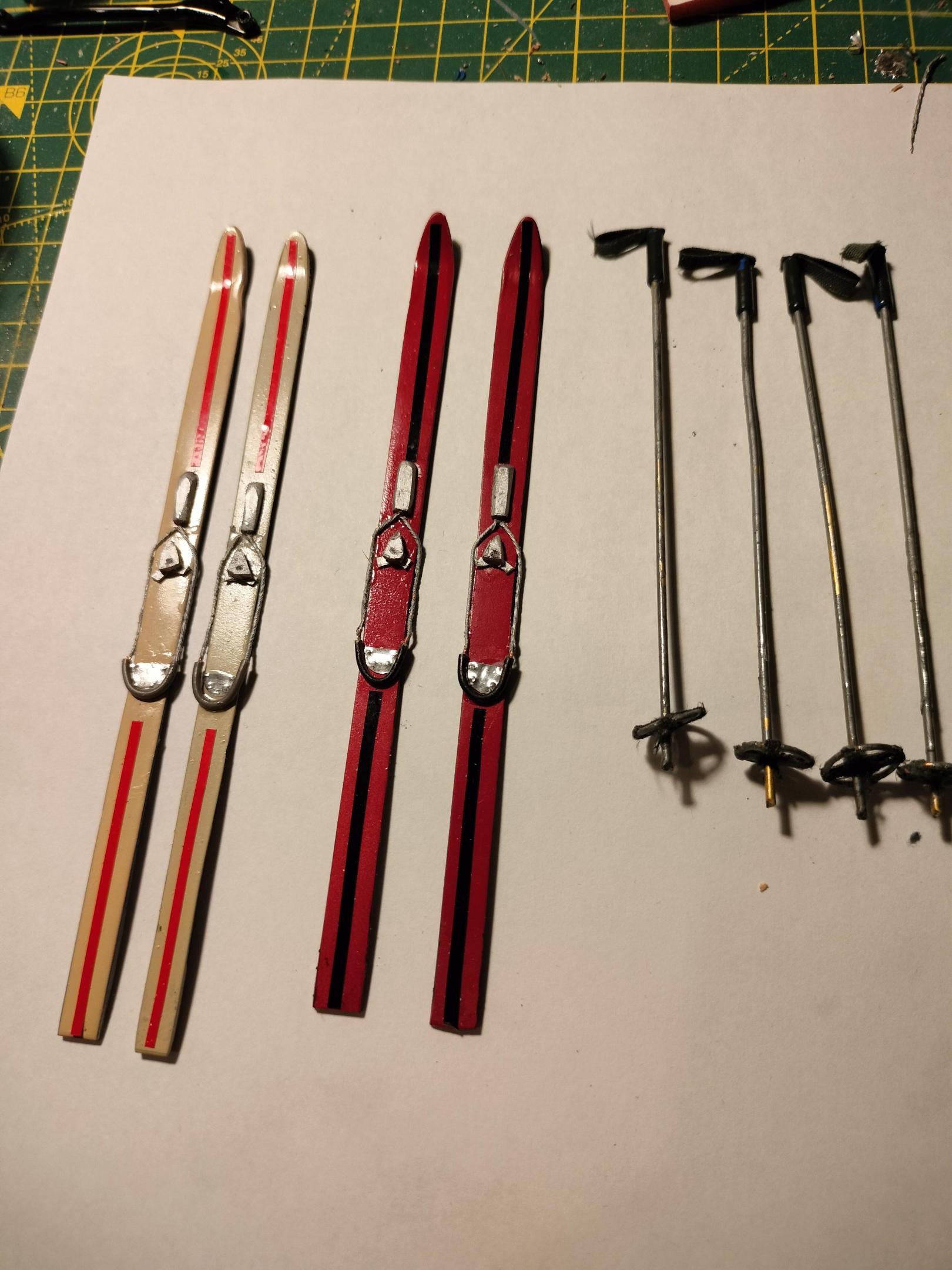

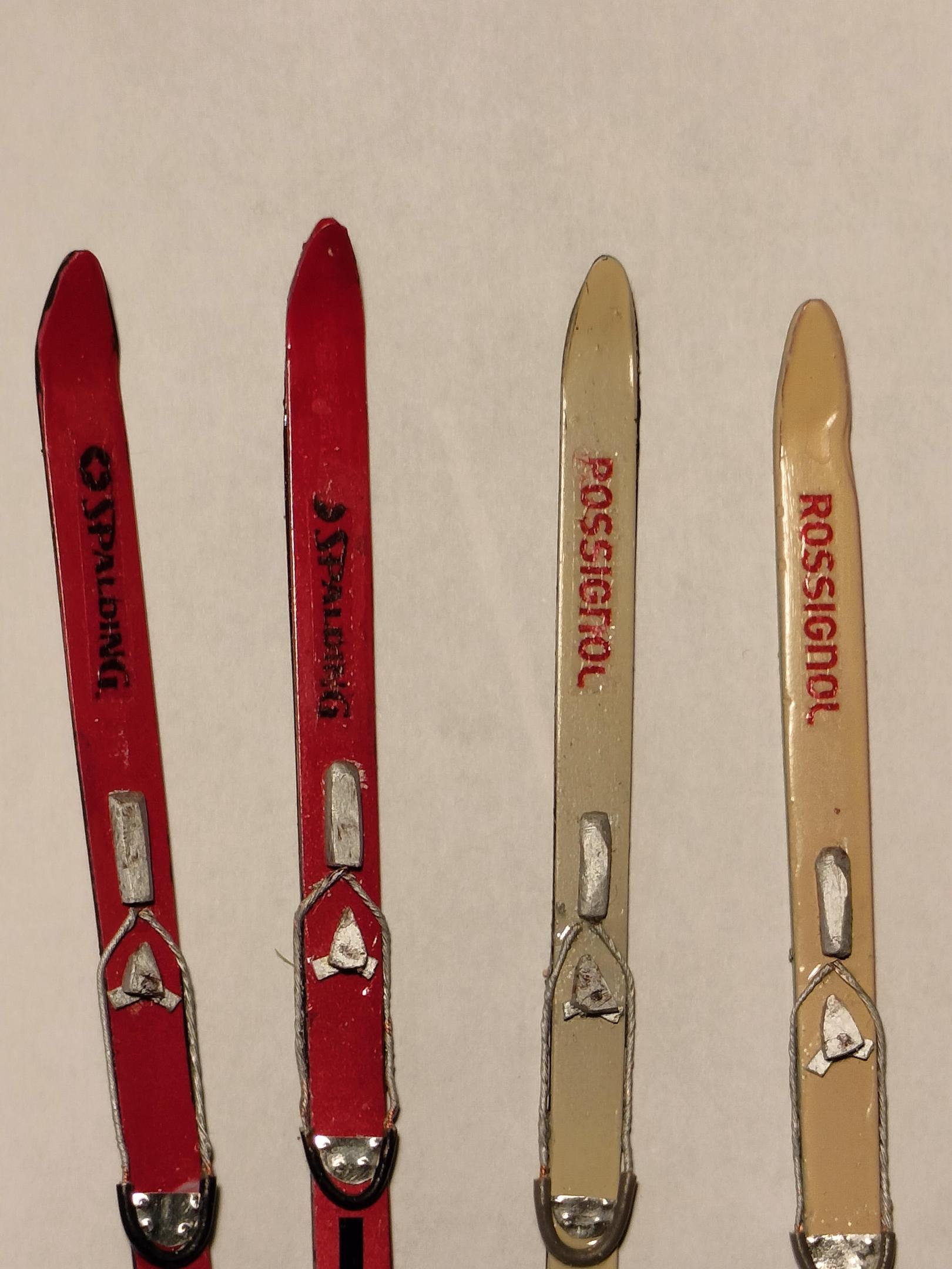

Well, you can't ski without skis. So I scratch built a couple of skis out of plasticard and the ski poles. This is a first trial.IMG20240223212835.thumb.jpg.4ea63636b4c3bc75379a7081d3d93743.jpg
I wasn't completely happy with the result, so I produced some diy water slide decals with logos. Much better.

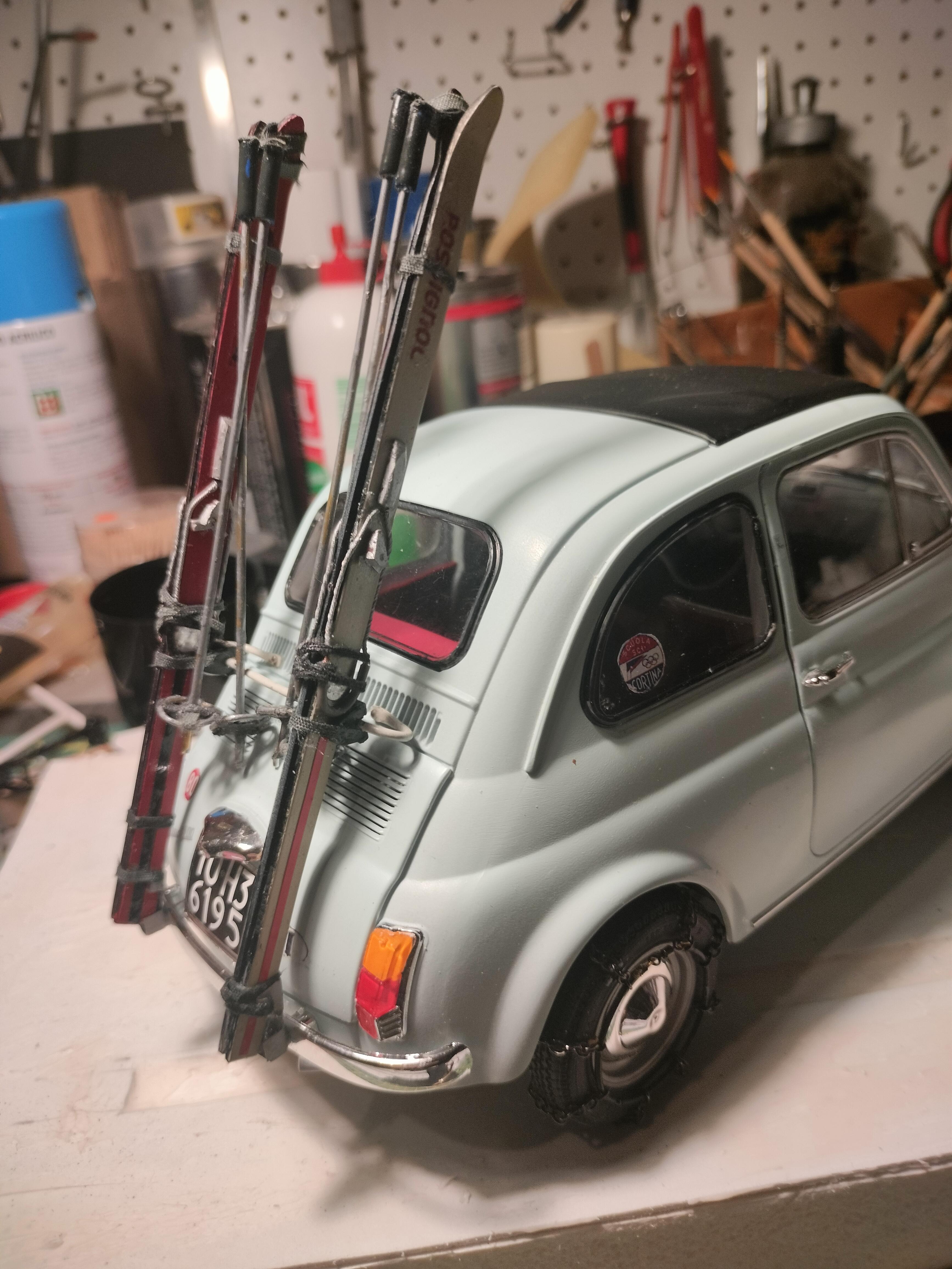

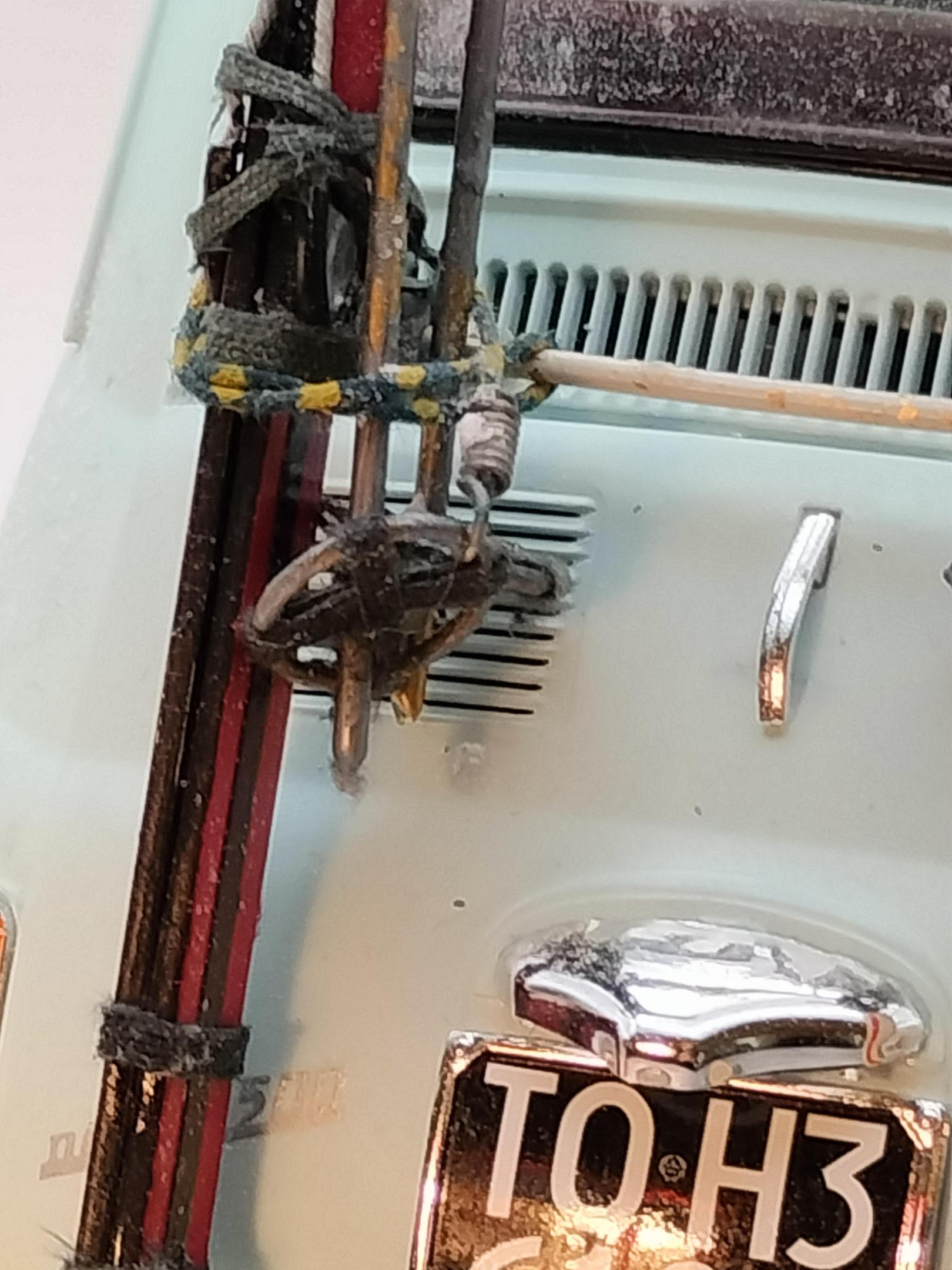

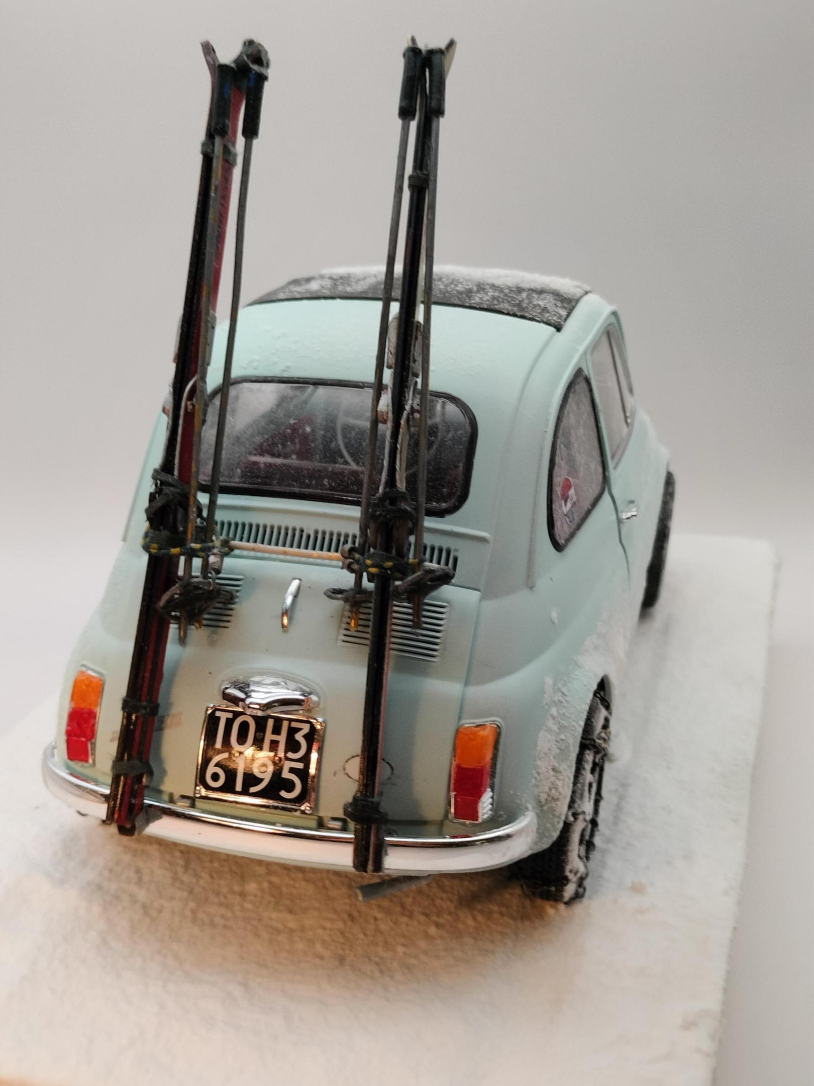

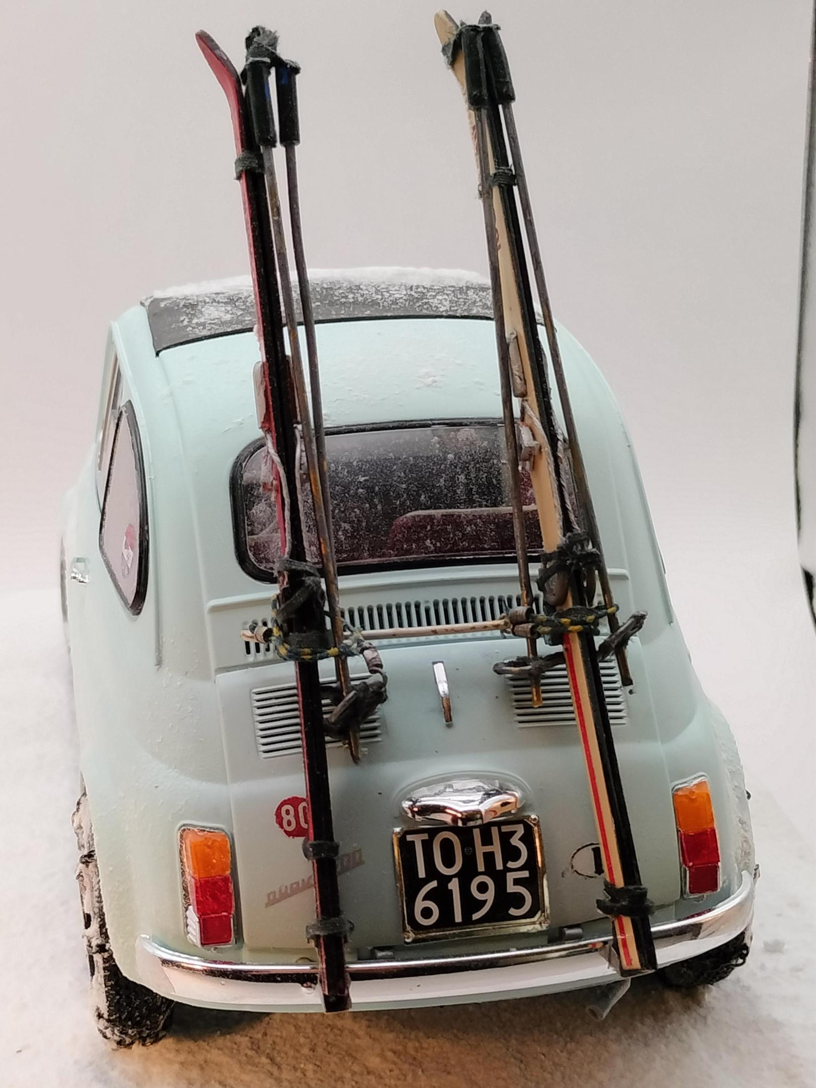

The skis are gone, now it's time to put them on the car. When I was young and impecunious, I simply put a normal roof rack and I tied the skis with some rubber bands. But for my model I decided to replicate  a rack custom made for the Fiat 500.
Here below you will find the car completed with the ski equipment. Later on i will prepare a proper base.

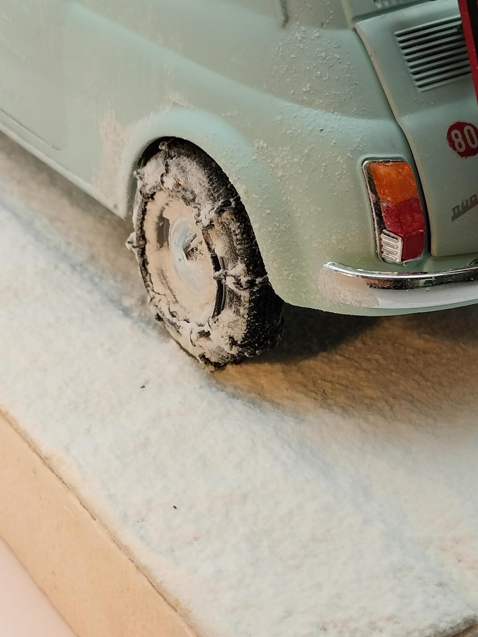

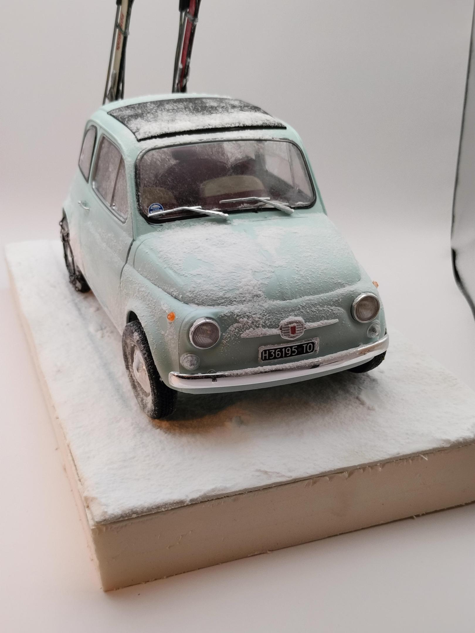

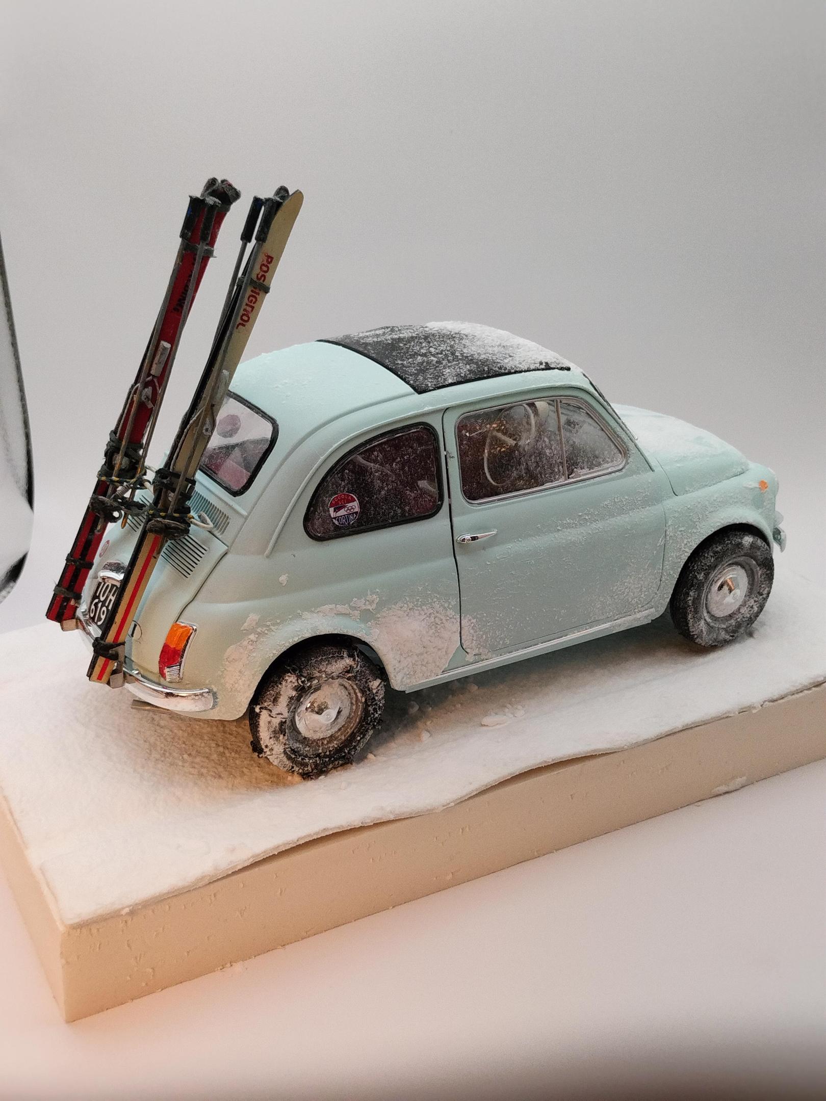

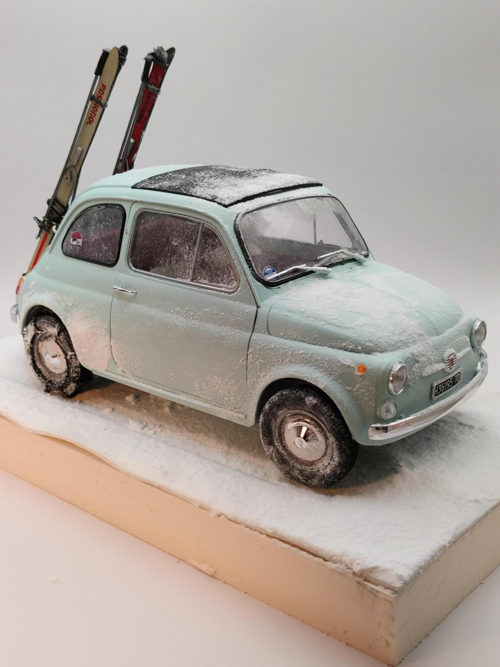

And now..... Let it snow !
With judicious use of vinyl glue and baking soda I obtained a true snow storm.
The wip is now completed. Thanks to everybody for your attention and support.
  • Like 2
Very 'cool' (?❄️) project Carlo! I'm currently working on the 1/24 Tamiya kit, and the 500 is such a charming little thing! I'm very curious of how you made the snow stick to the car and sit in ways and places that look realistic. Can you share a bit more about the process and tools you used?
To tell you the truth, the snow Is the easier part of the build.
You just need vinyl glue
Some baking soda
And a tea strainer
You just mix the glue with some water and brush it on the car. Then you spread the powder through the strainer. Once the glue is dry, you shake the model to remove the excess and you're done. With the brush you can easily choose the places where you want to leave the "snow".
