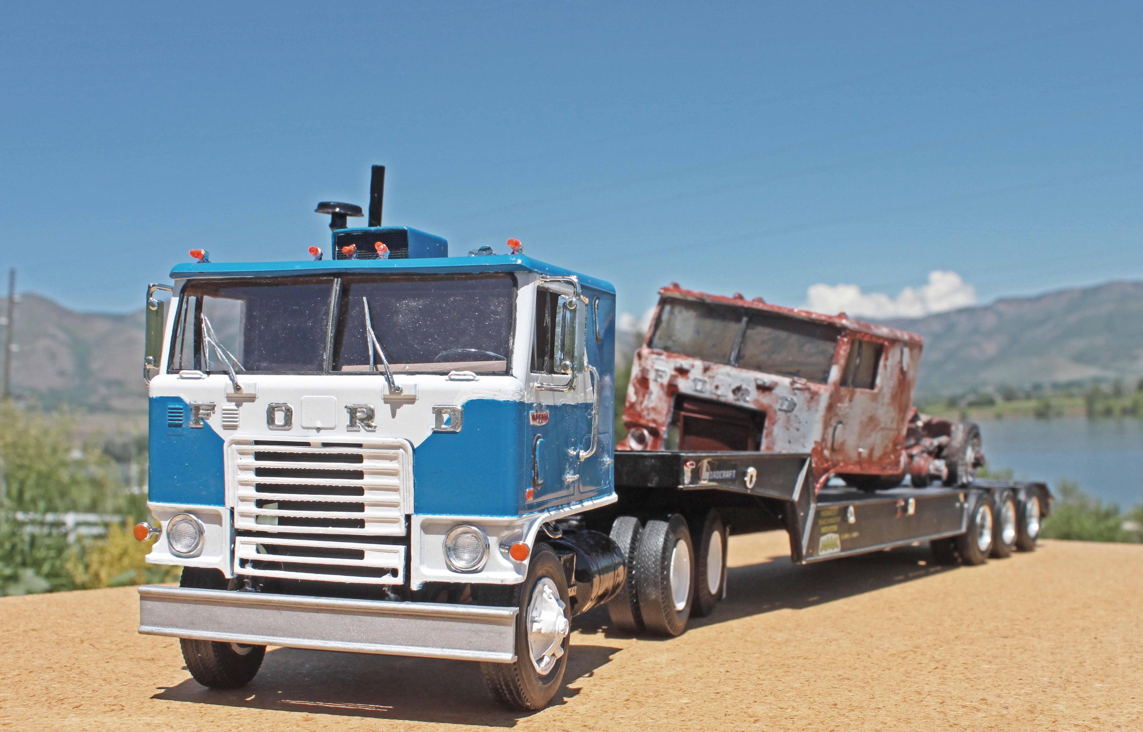

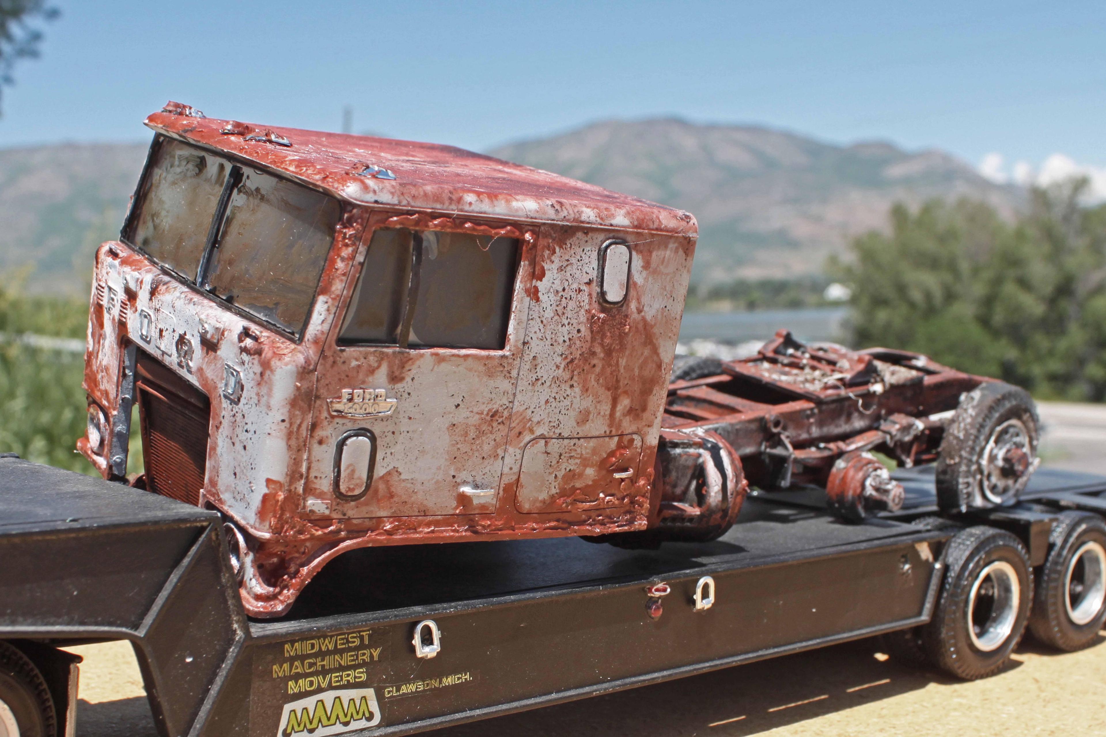

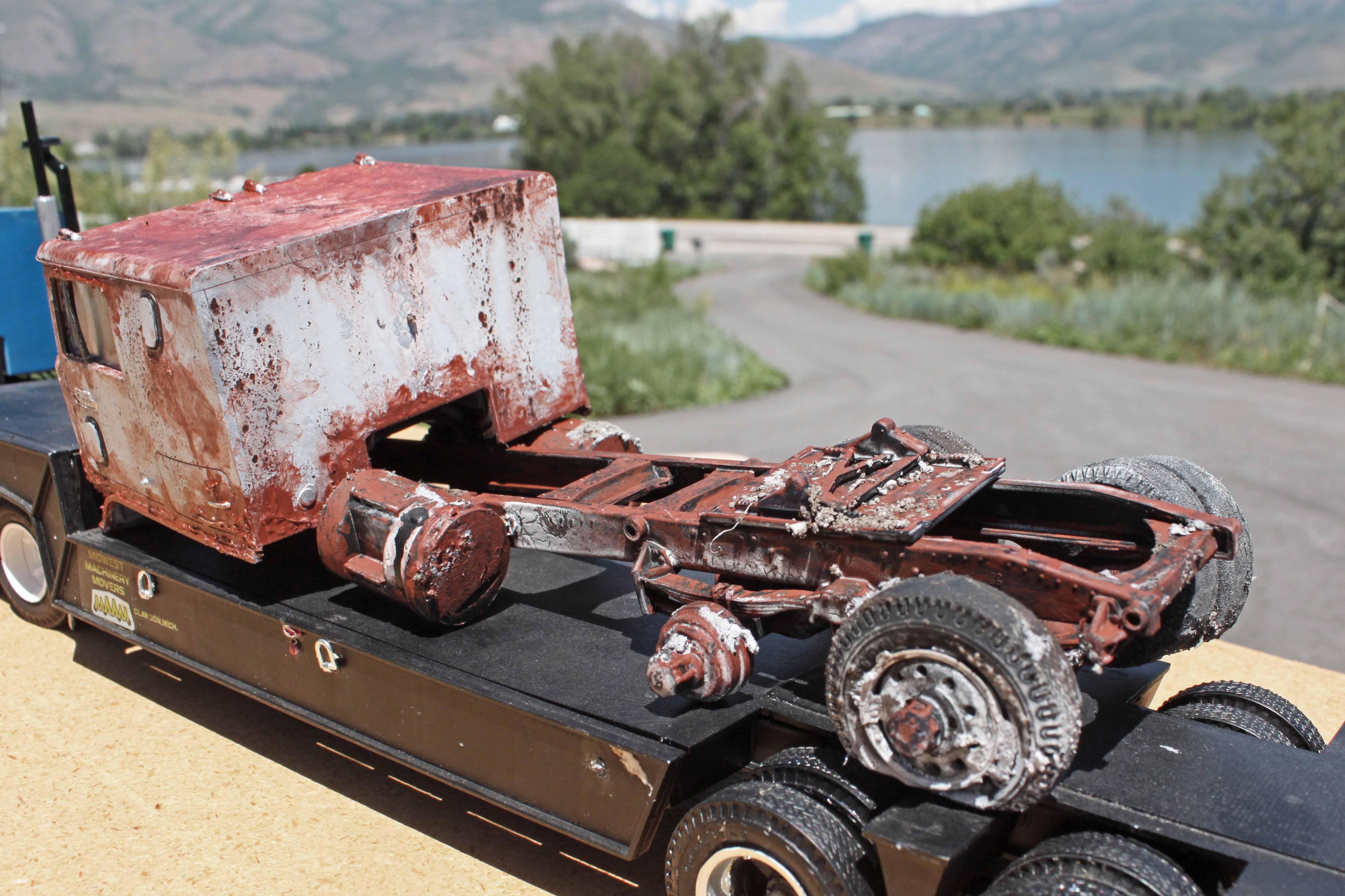

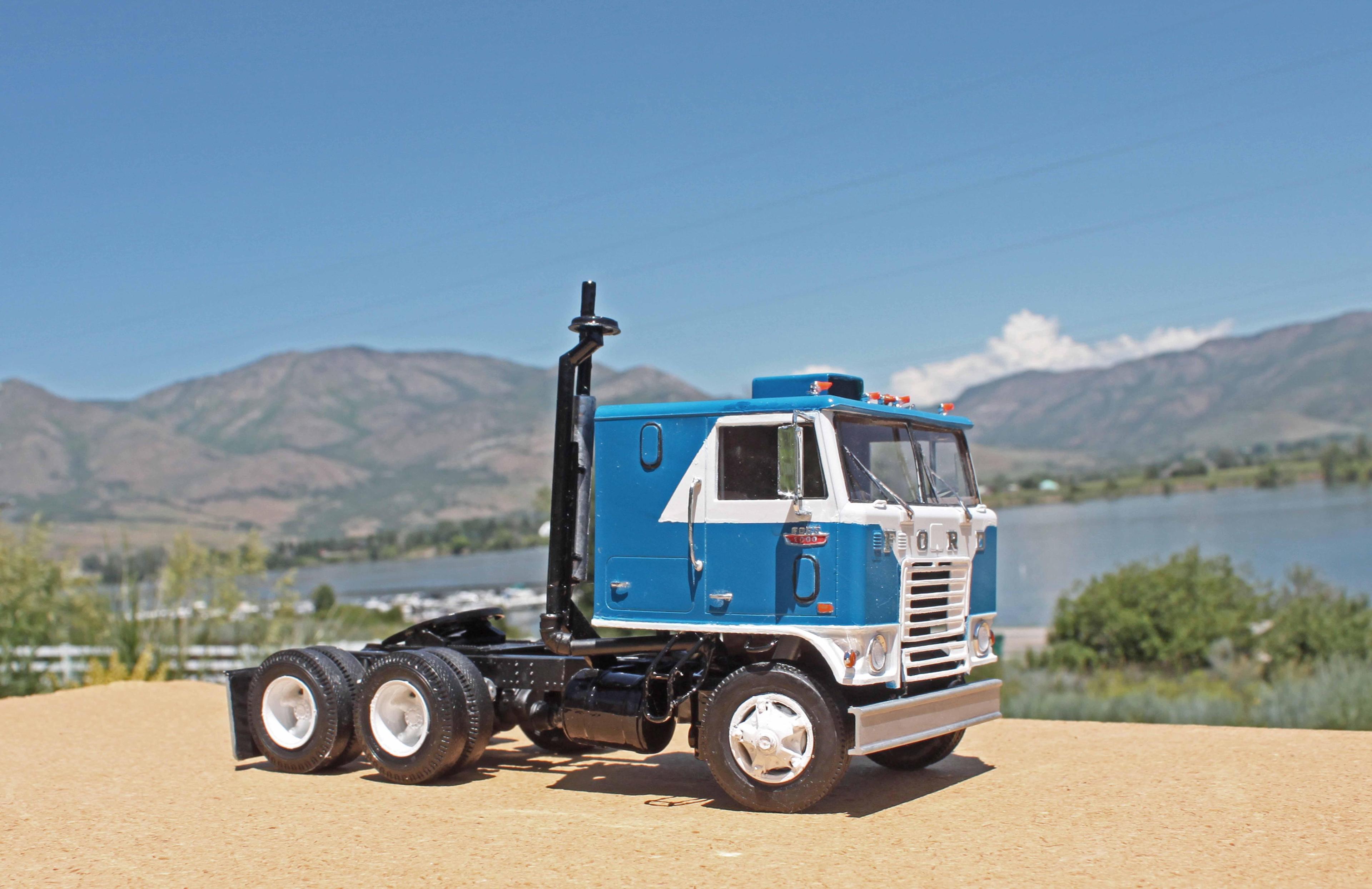

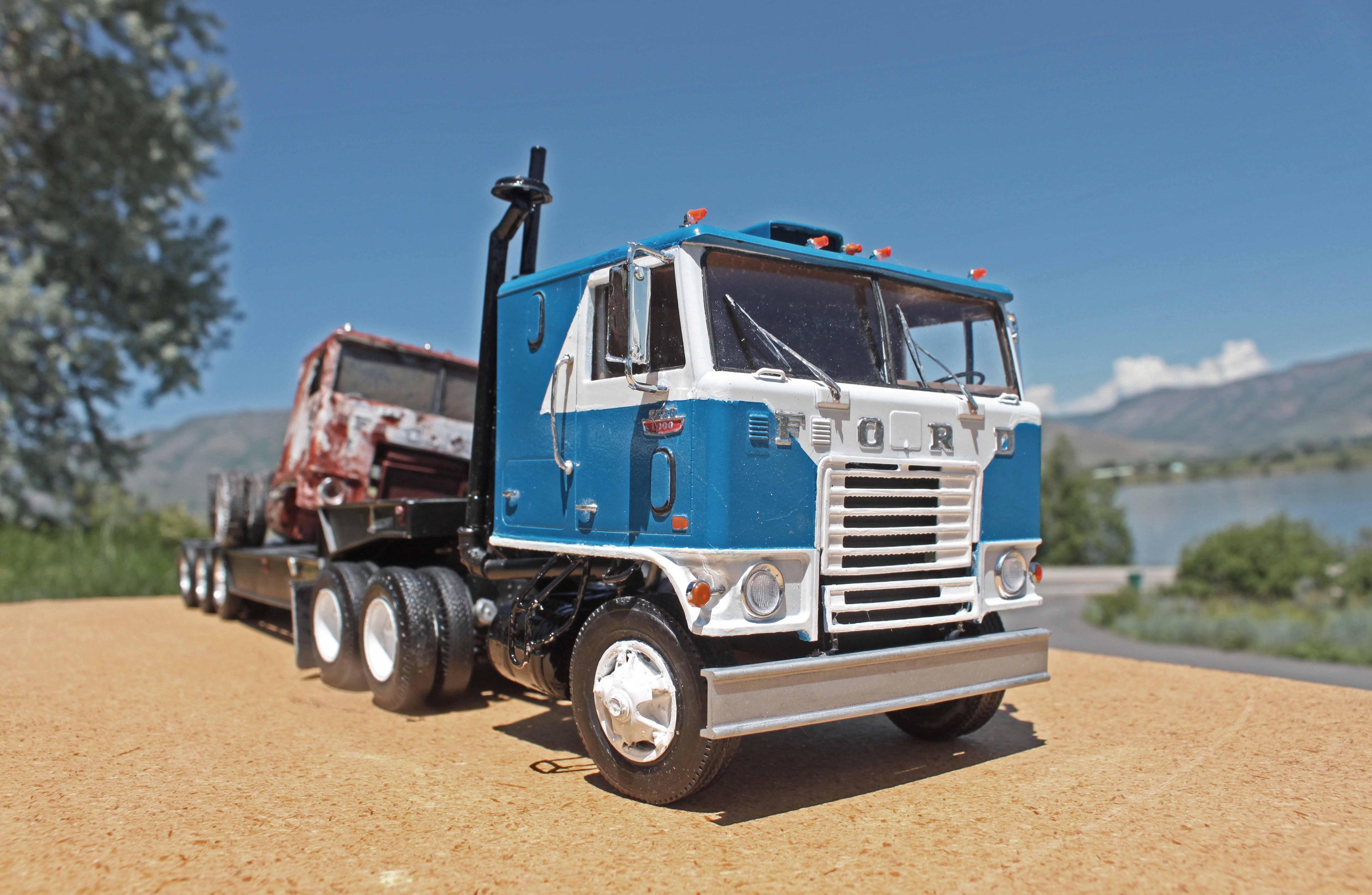

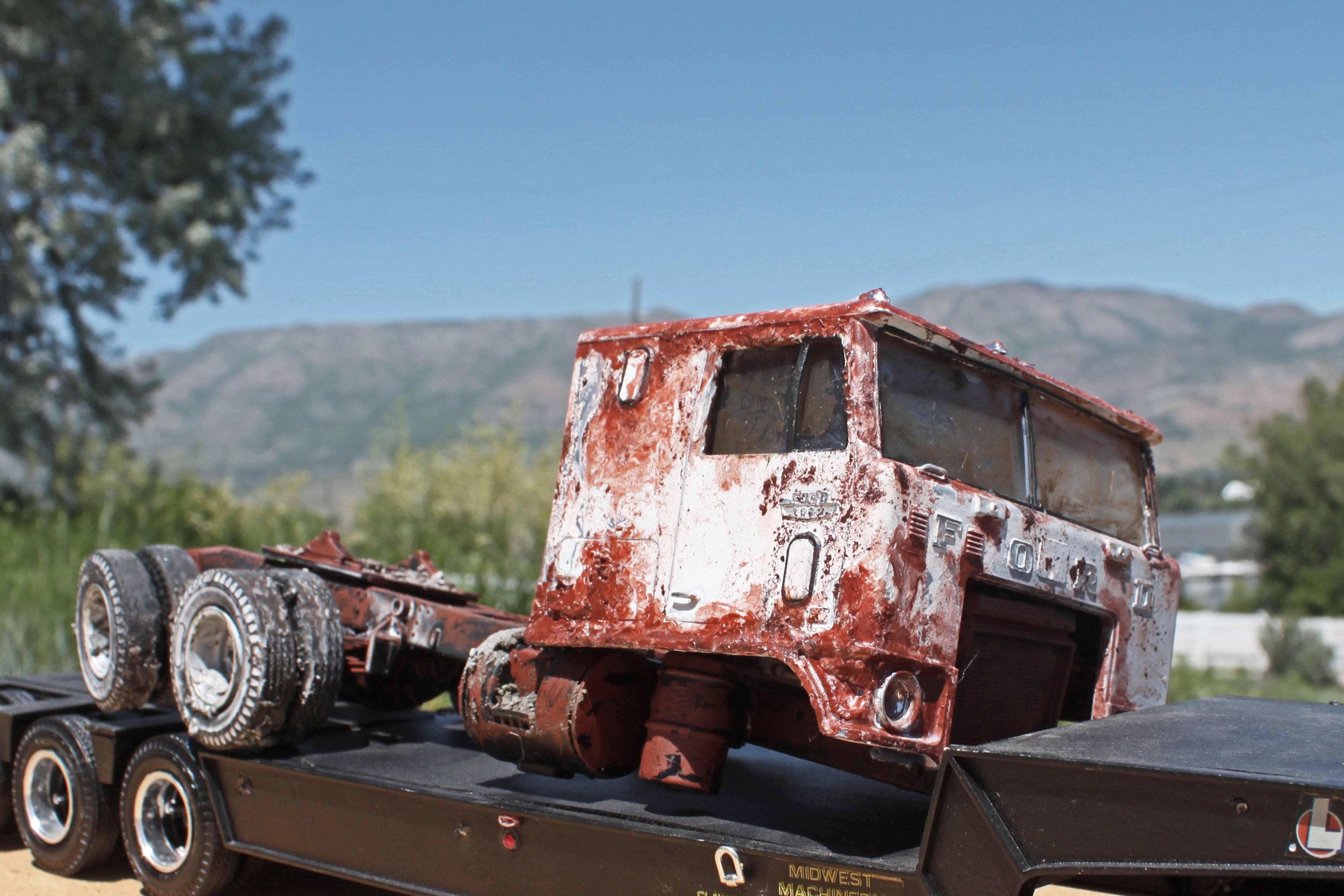

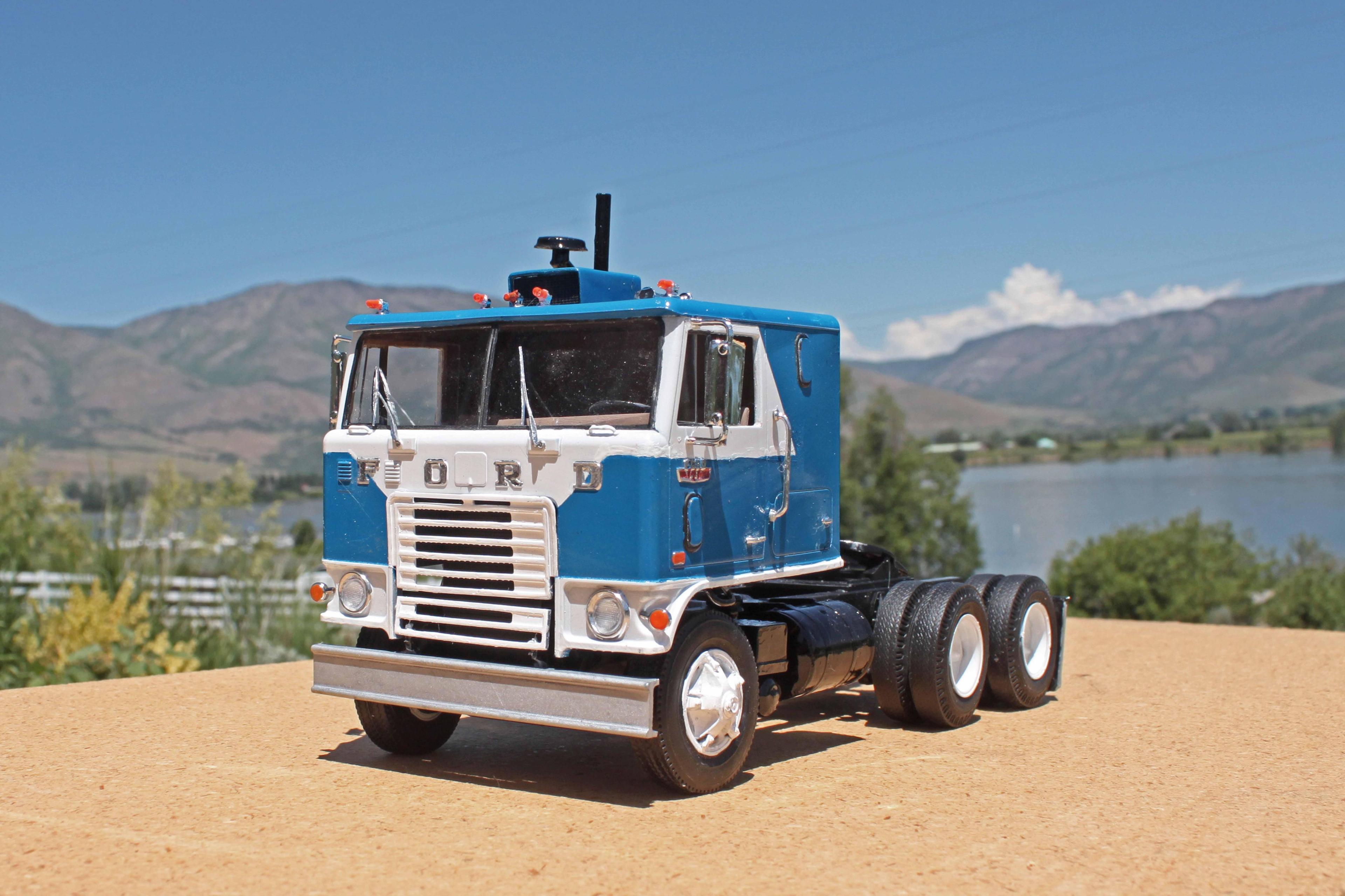

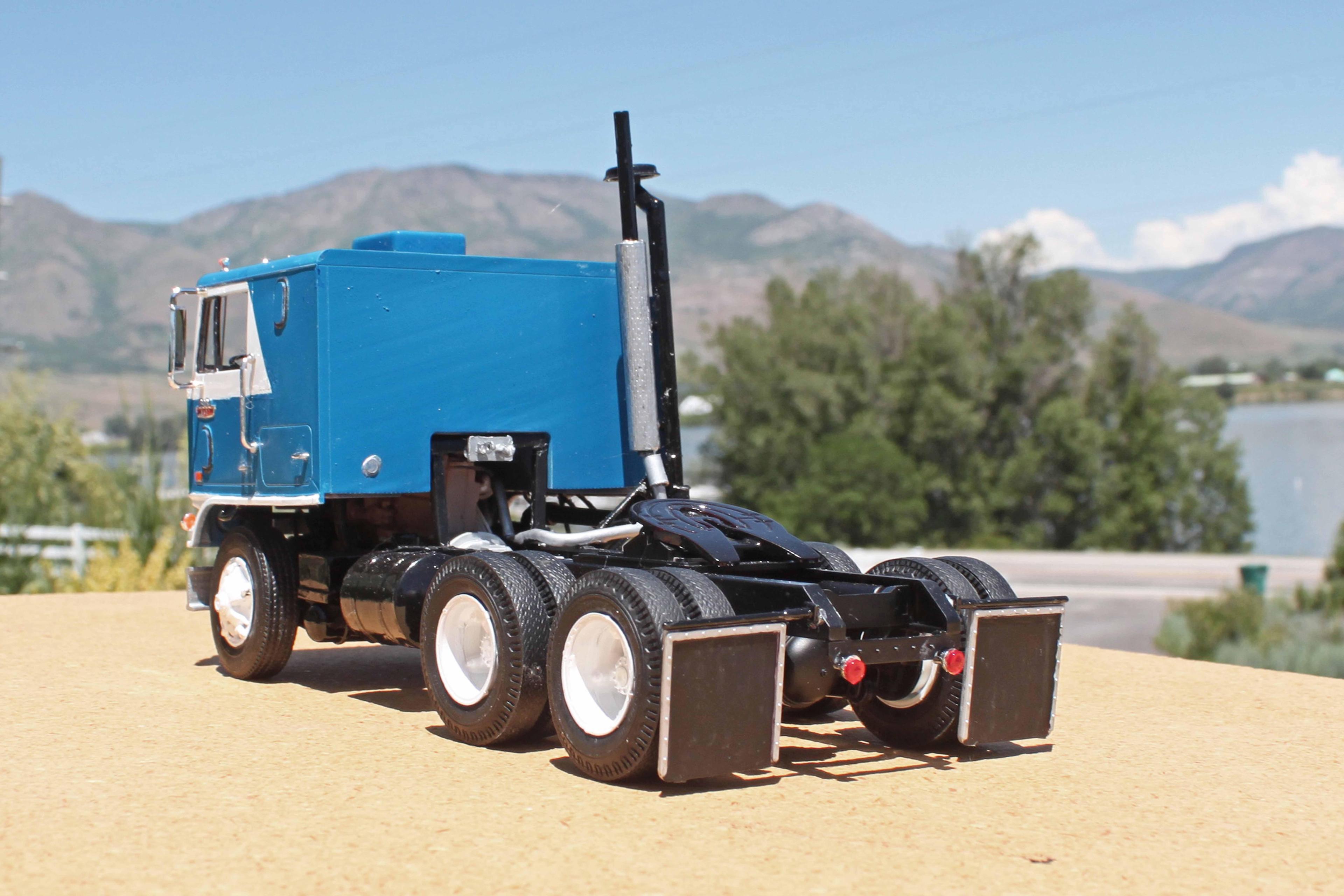

RoninUtah Posted June 13, 2024 Posted June 13, 2024 This time it’s a late-60s- early 70s W-1000 COE. Cab is from TX3D, on an AMT Astro 95 chassis along with a few aftermarket parts and scratch-built things as well. On this one, I learned the hard way that you should NOT soak a 3-D printed model in water to get rid of mold release, etc. like you would a conventionally cast resin piece! First, there is no mold release to get rid of. Second, 3D resin is porous. It soaks up the water and warps. So, the first cab I got warped beyond repair, but Charles of TX3d sold me a replacement at a reasonable price. Not to let even a warped cab go to waste, I paired if with a bunch of parts box stuff to create an old wreck; it’s a hulk of a Ford that had long ago been stripped of its drivetrain and any usable parts and left in a field to rot. Now it’s on the way to a different fate, and as luck would have it, it’s being hauled by its much better cared-for brother. I was very pleased with this conversion kit. It fit pretty nicely on the Astro frame, in fact, it’s one of the few resin COEs I have made that tilts easily! The proportions are correct, the detail is crisp and accurate, and it doesn’t have that annoying graininess that so many 3d prints have. However, like all 3d printed resin, it is very brittle and inflexible. You have to be very careful in removing the rods that are printed in to hold the piece true; work from the front to the back to avoid stressing and cracking the cab. Also, it is printed to tight tolerances, so I had to do some grinding on the interior tub to make it fit easily without flexing and cracking the body. In other words, like all resin conversions, cast or printed, it takes some working and futzing to make them fit. But, I think it’s well worth the effort! 10
Rockford Posted June 14, 2024 Posted June 14, 2024 Sorry to hear about your submarine experience, but you definitely made a great save turning it into a payload. The tidy truck looks excellent. Great job.
leafsprings Posted June 15, 2024 Posted June 15, 2024 Very nice combo build, I like your taste in heavy duty Fords, I need to catch on these cool offerings. Really like the paint scheme detail work and wheel choice, especially the center point front axle, common back in the day when power steering boxes and plumbing was unreliable.

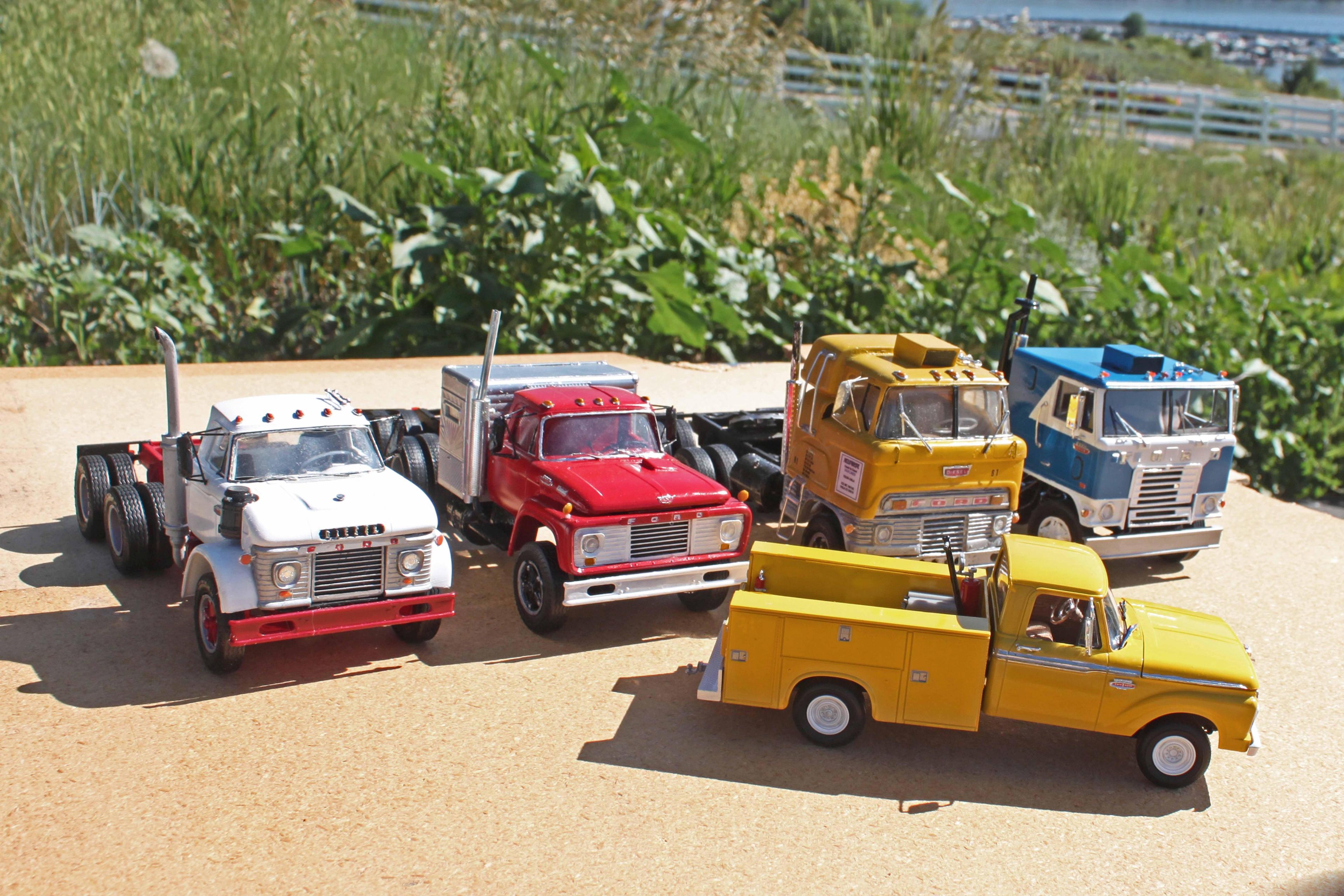

RoninUtah Posted June 23, 2024 Author Posted June 23, 2024 So, here is the '60s Ford family in my collection... 2

DRIPTROIT 71 Posted August 19, 2024 Posted August 19, 2024 Nice looing fleet you have there! Very nice work!!
