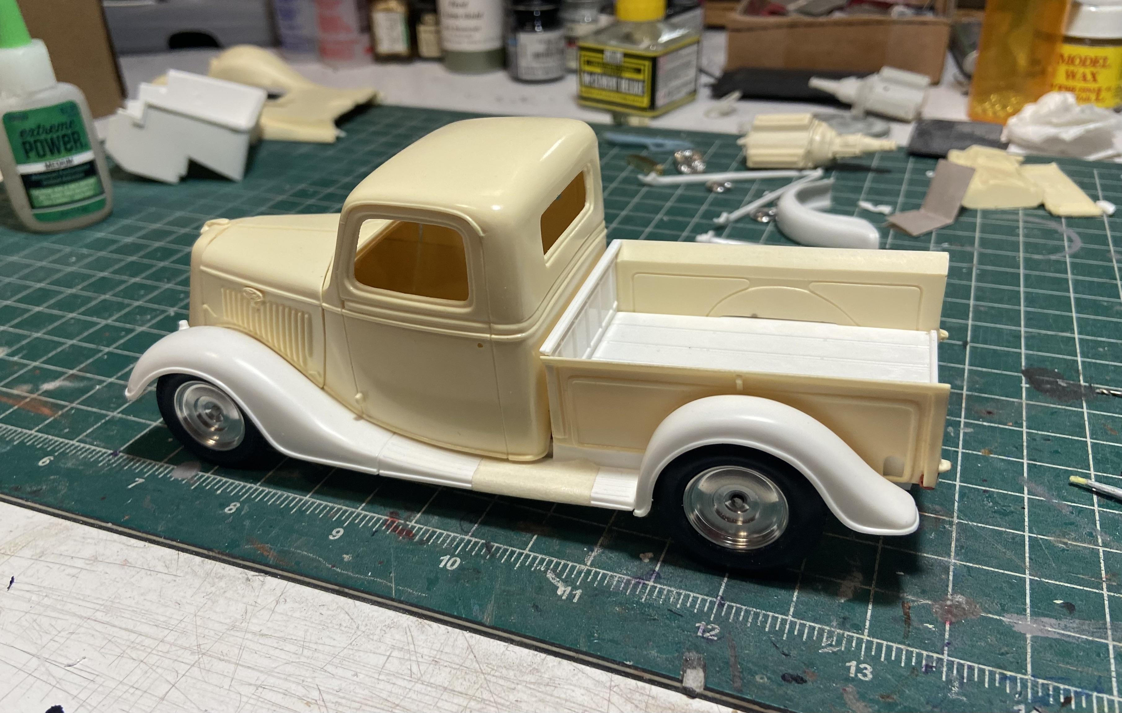

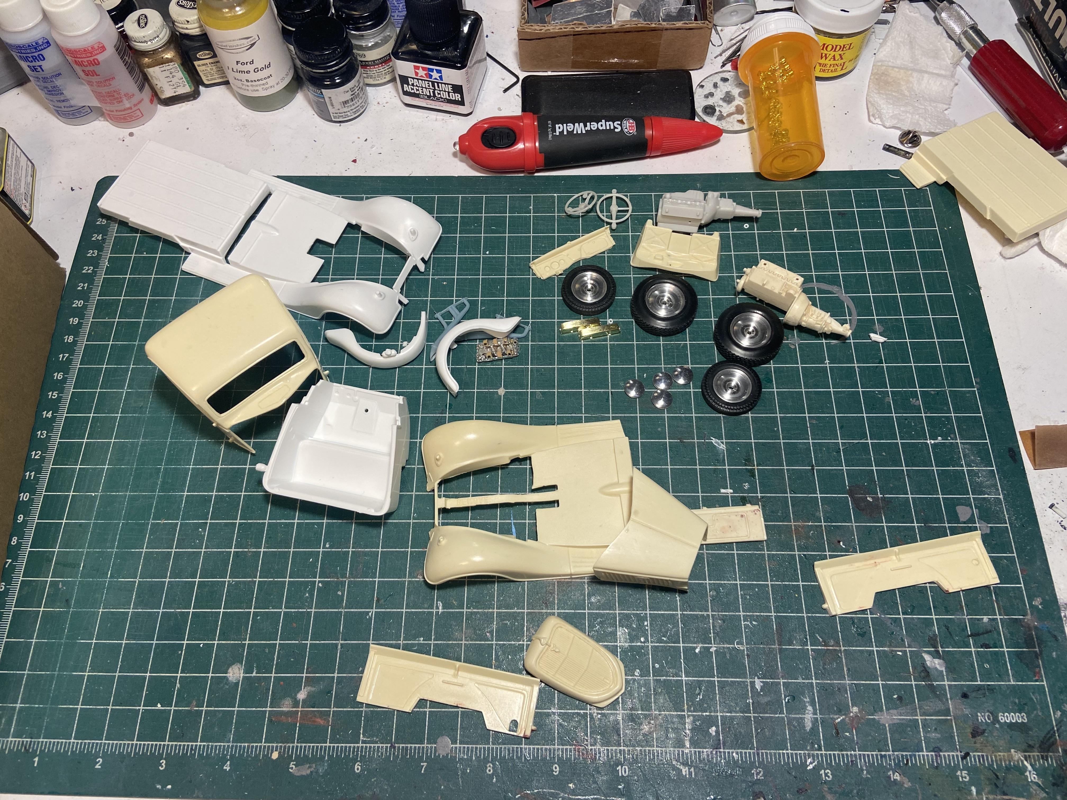

Seen here are the basics, an AAM resin transkit to convert the Revellogram '37 Ford pickup into a '35. I never knew this kit existed. I supplied the '37 kit. Tote contained a small block Chevrolet engine with a 4 speed, Dancing Bear aluminum wheels. Tires are on their site pictured with the wheels, so they probably came from them too.

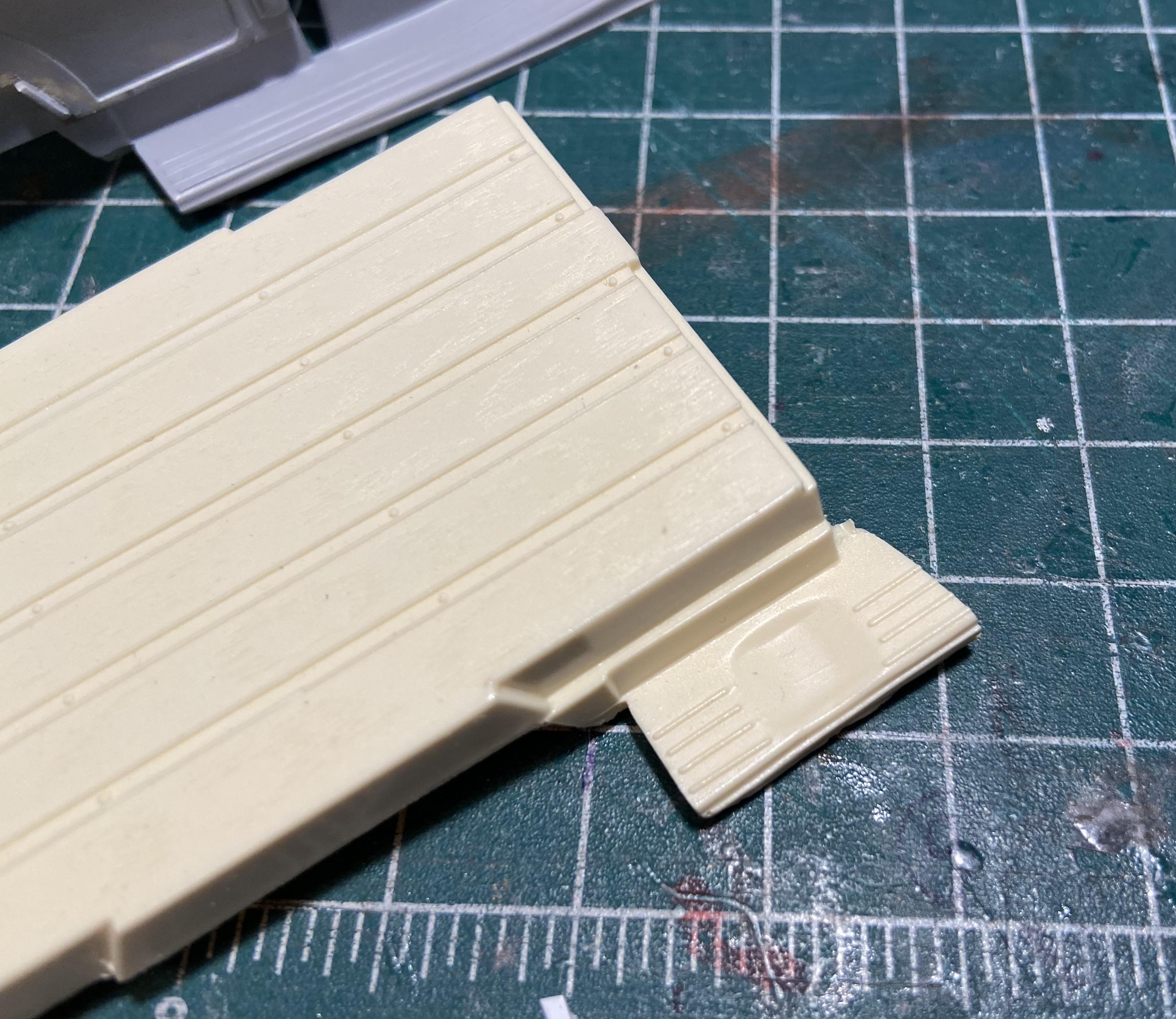

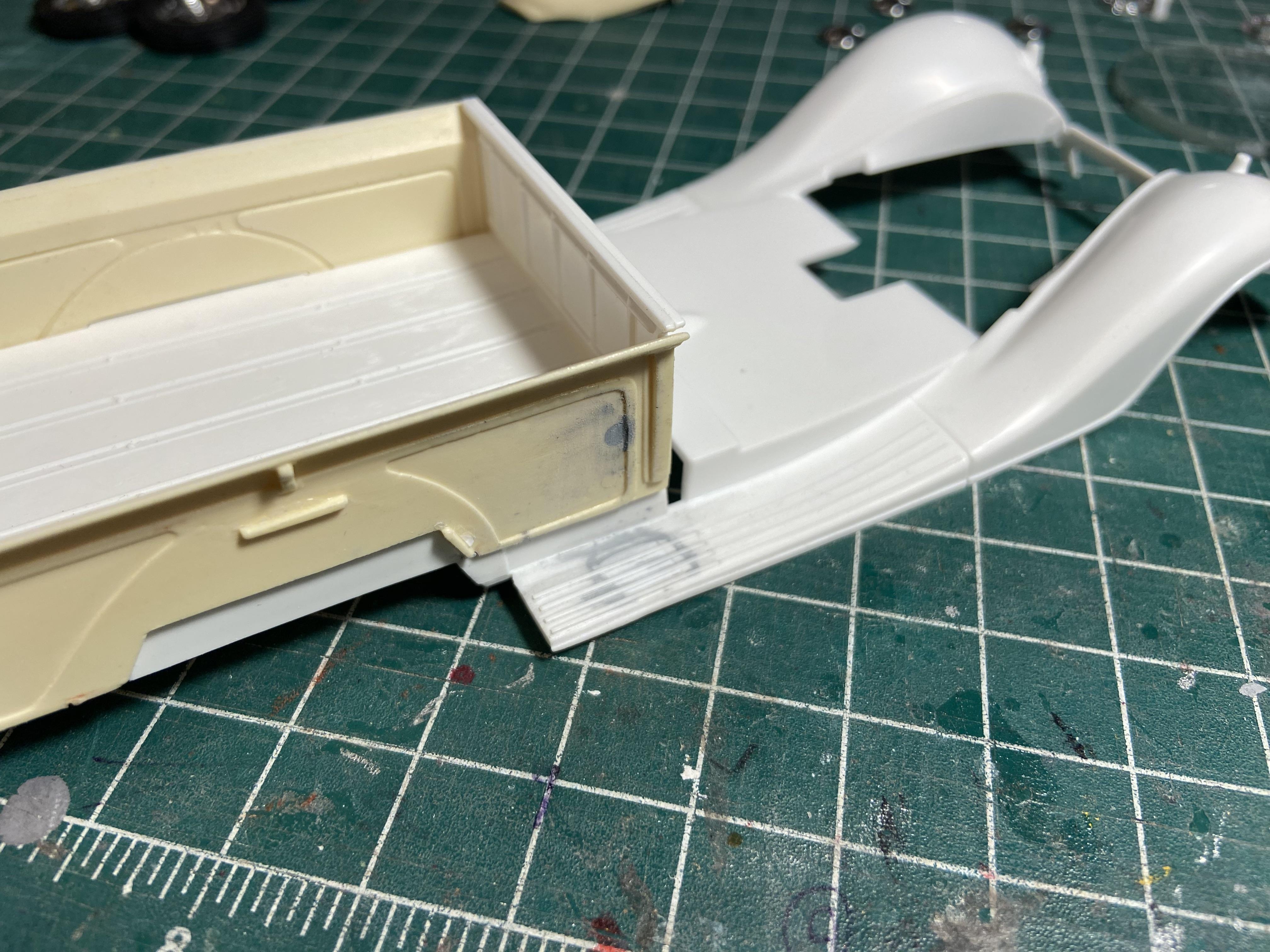

I elected to use the original kit fender/floor/bed unit instead of the resin, as the resin was cracked and required more body work. The only difference was the bed - a bit shorter on a '35, an easy mod. I erased the spare tire recess in the right running board and sketched the ribs back in with Evergreen strip.
No recess, recess.

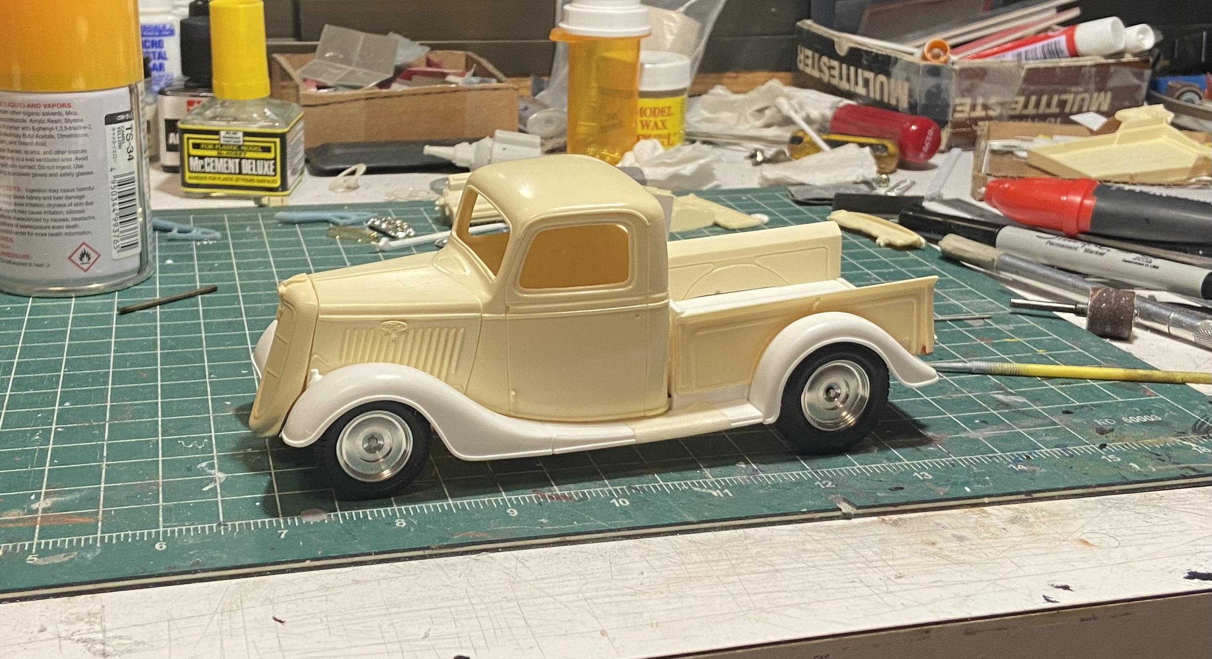

First mock-up with ride height dialed in.

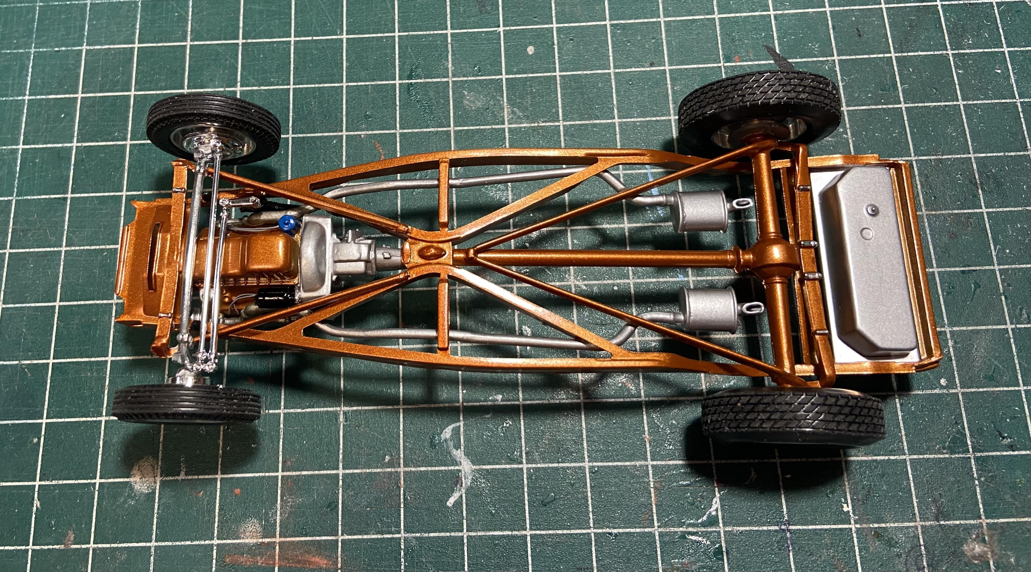

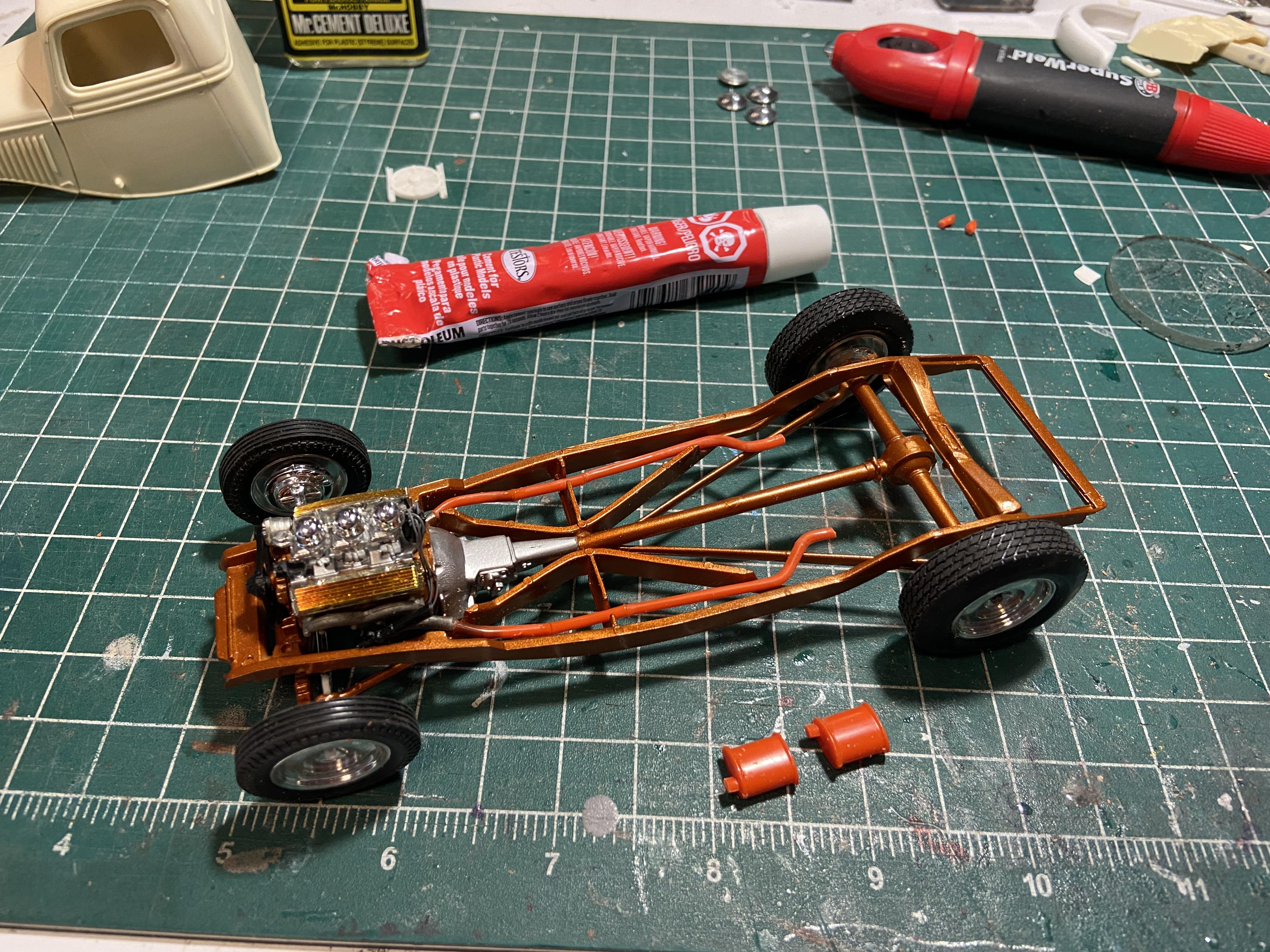

Chassis almost done. I used a Revell '32 front drop axle and de-arched the '37 spring and the height turned out well. Split wishbone. I flattened the rear crossmember and raised it in the chassis to lower the rear. I don't know where the engine came from, but probably the '55 Chevy truck kits. Manifold, triple Rochesters, and air cleaners were in a medicine bottle in the tote. Several manifold setups were there, I chose this one. Valve covers were also in the tote, I added Tamiya clear orange between the ribs. Exhaust is modified '70 Mustang with shortened mufflers, ram horn manifolds were from my parts stash. Driveline/chassis paint is Tamiya Metallic orange. I made the wheels roll by adding axle retainers under the hub caps.

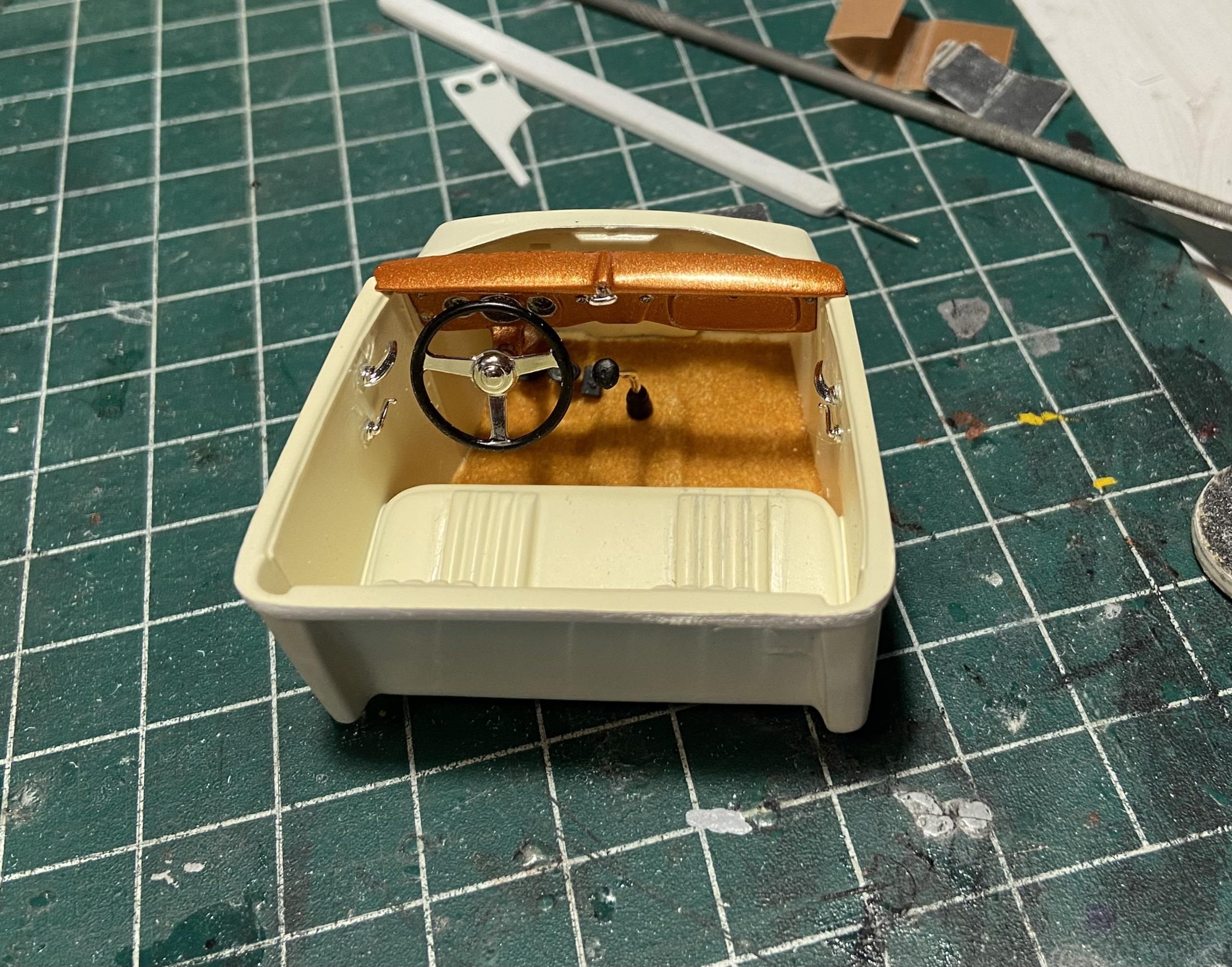

Interior - resin '35 dash, shortened column with parts stash steering wheel, custom mixed flocking. I threw some pleats on the seat and gauge decals in the cluster. Paint is Tamiya Racing White.

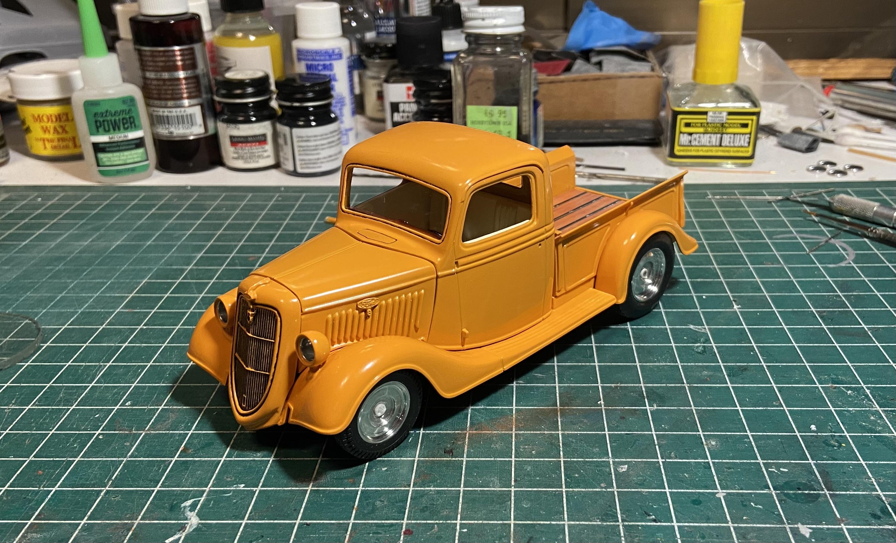

Body is Tamiya Brilliant Orange, AKA McLaren orange, over Tamiya fine gray primer. I was going for a Creamsicle look. First fit to the chassis.

Very nicely done!  Does the Ford emblem on the hood sides get BMF?  Great wheels, stance and color choice.
Thanks. I did the hood and grille emblems in Molotow ink applied with a 000 brush.
