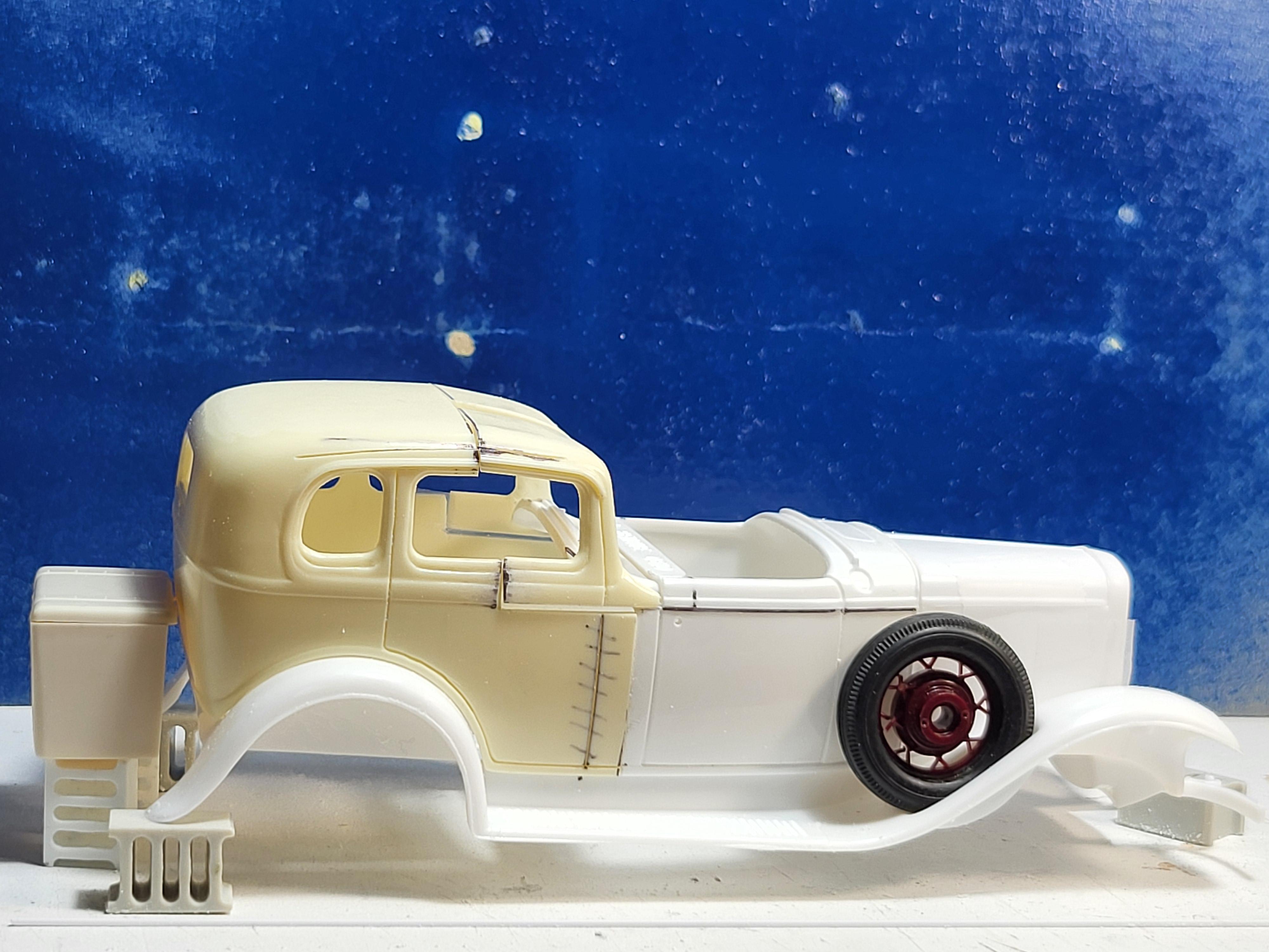

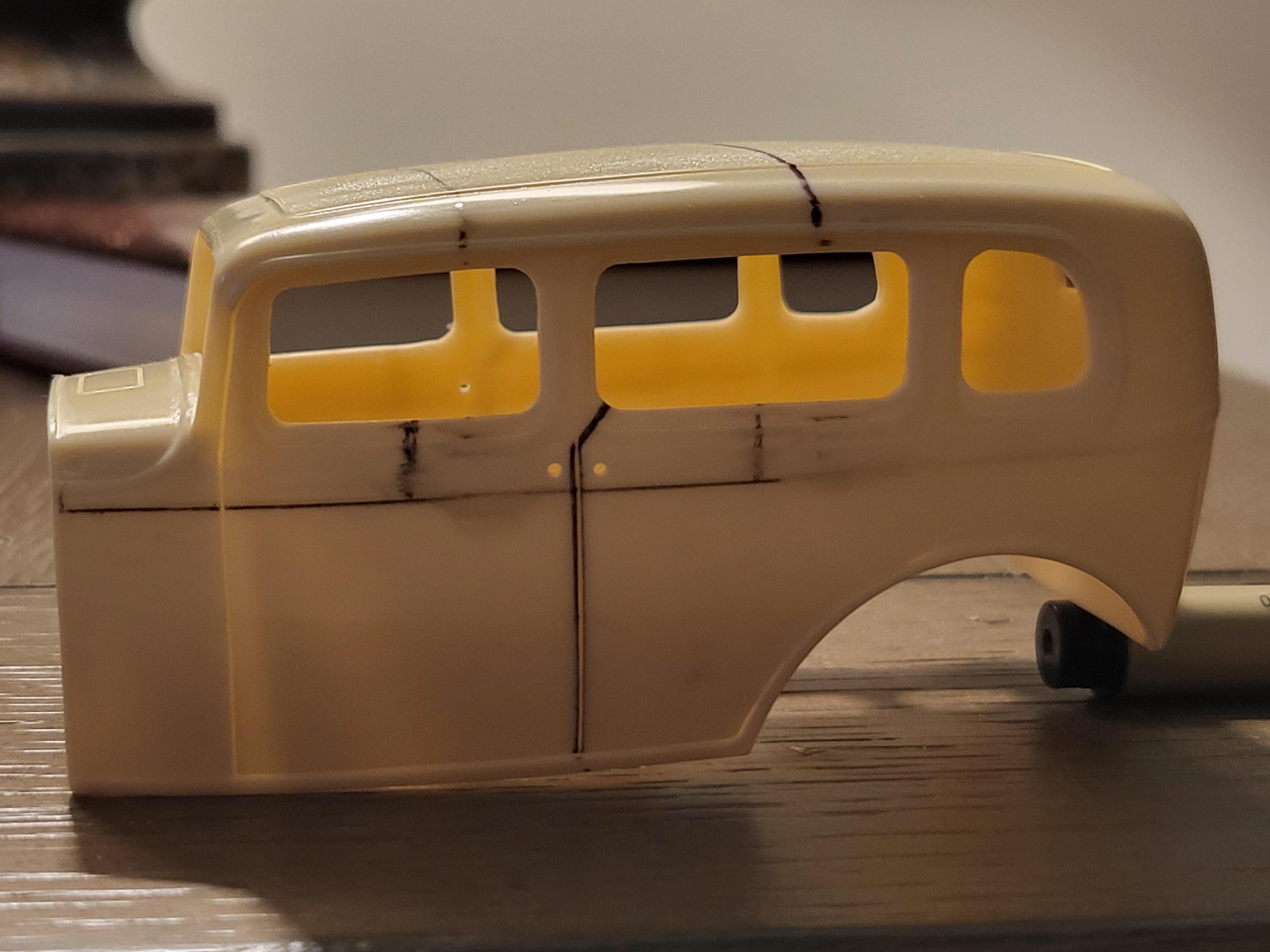

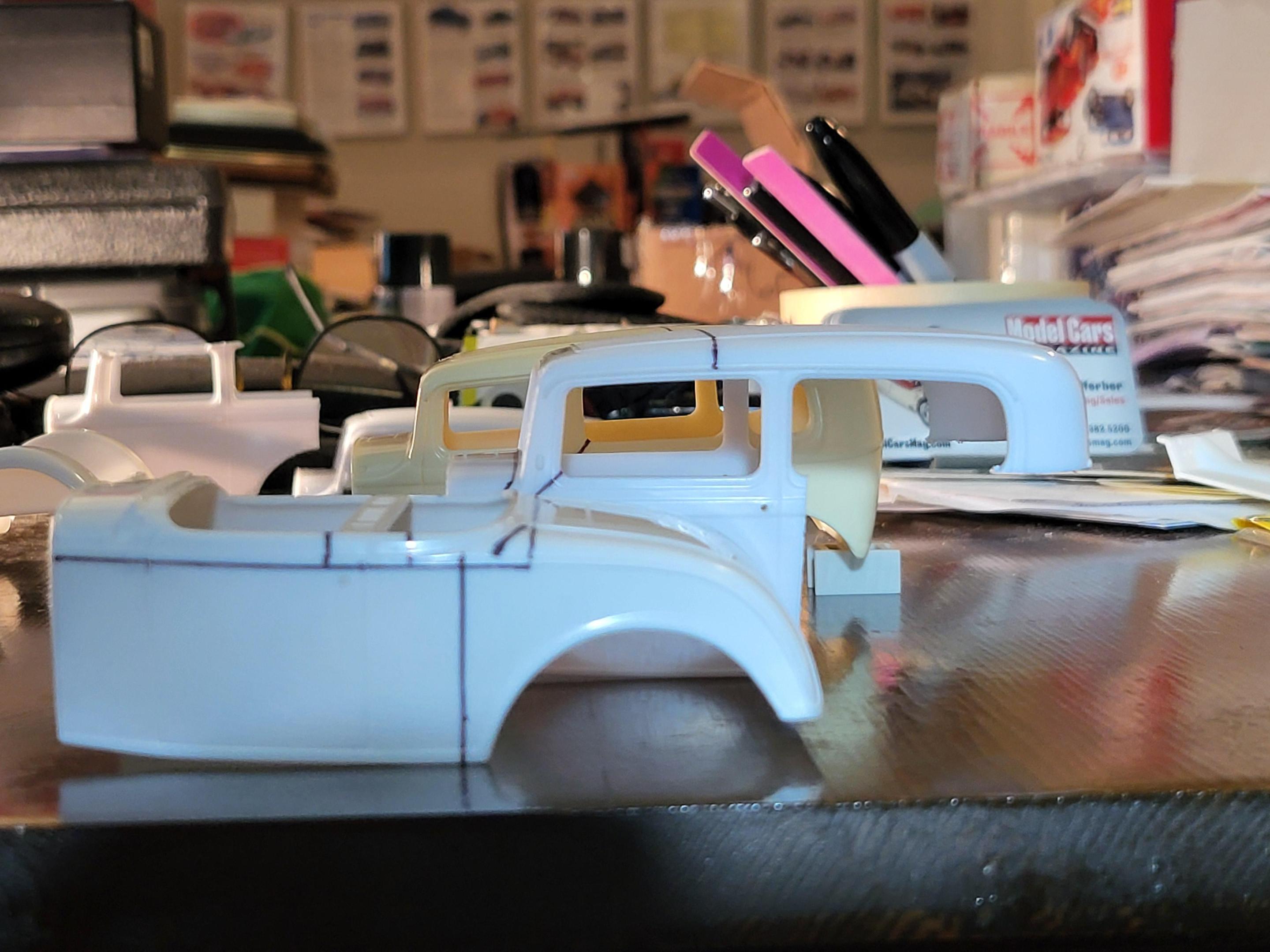

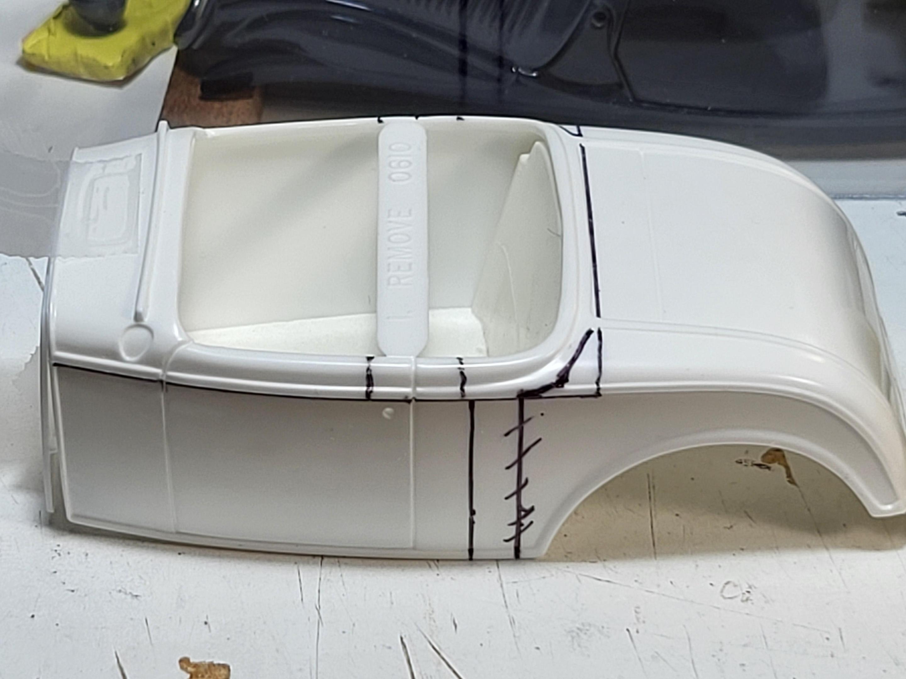

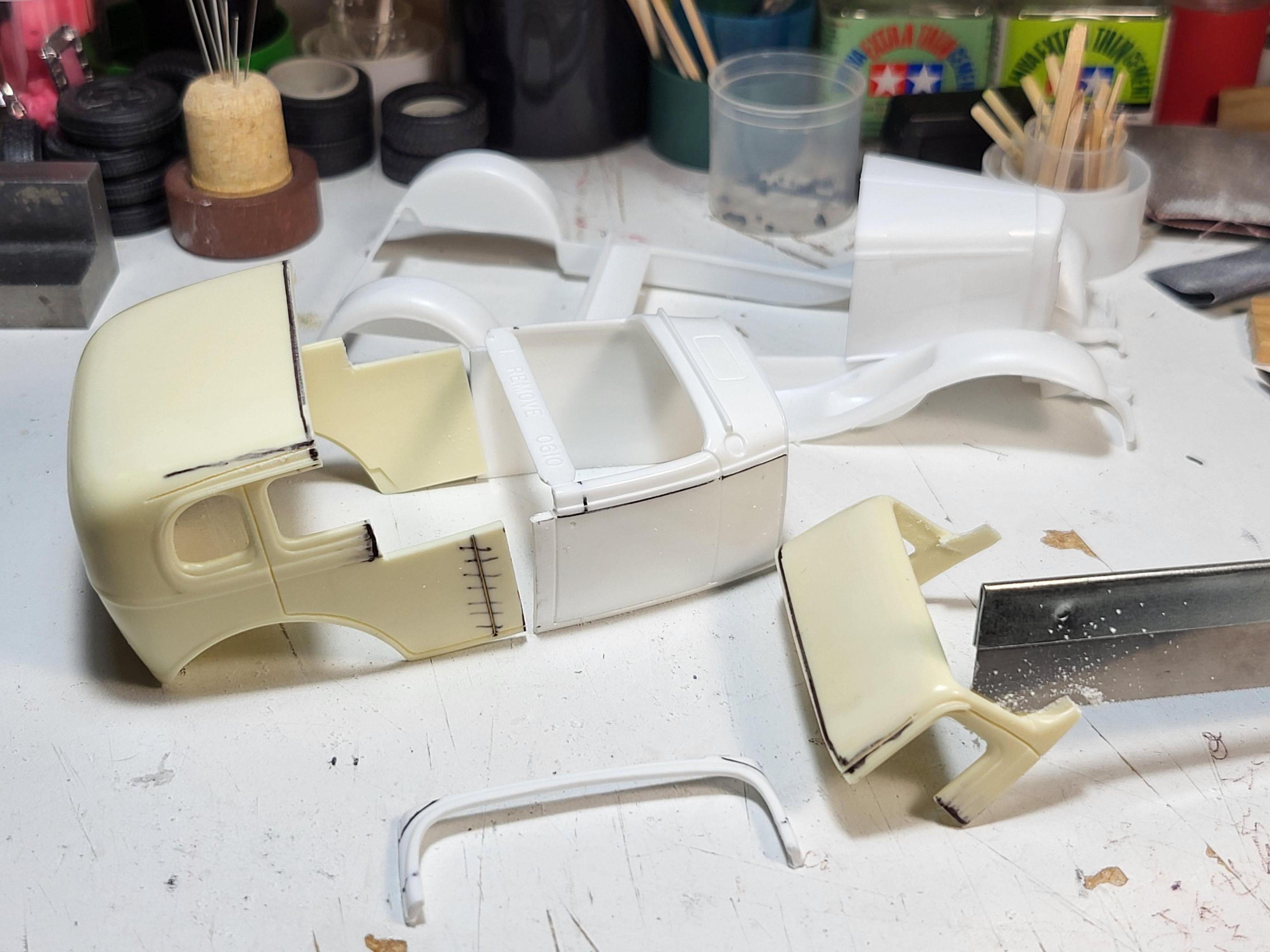

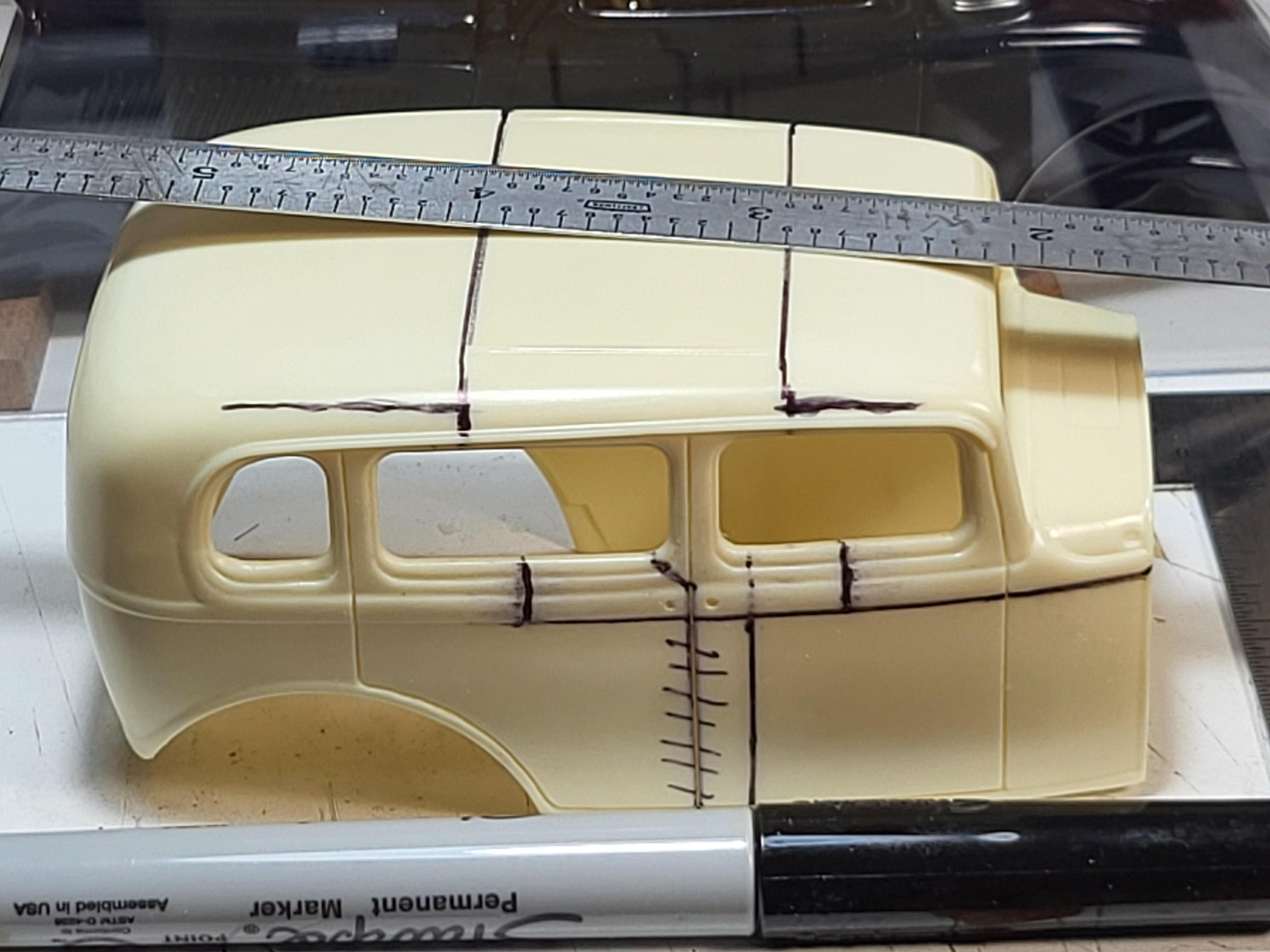

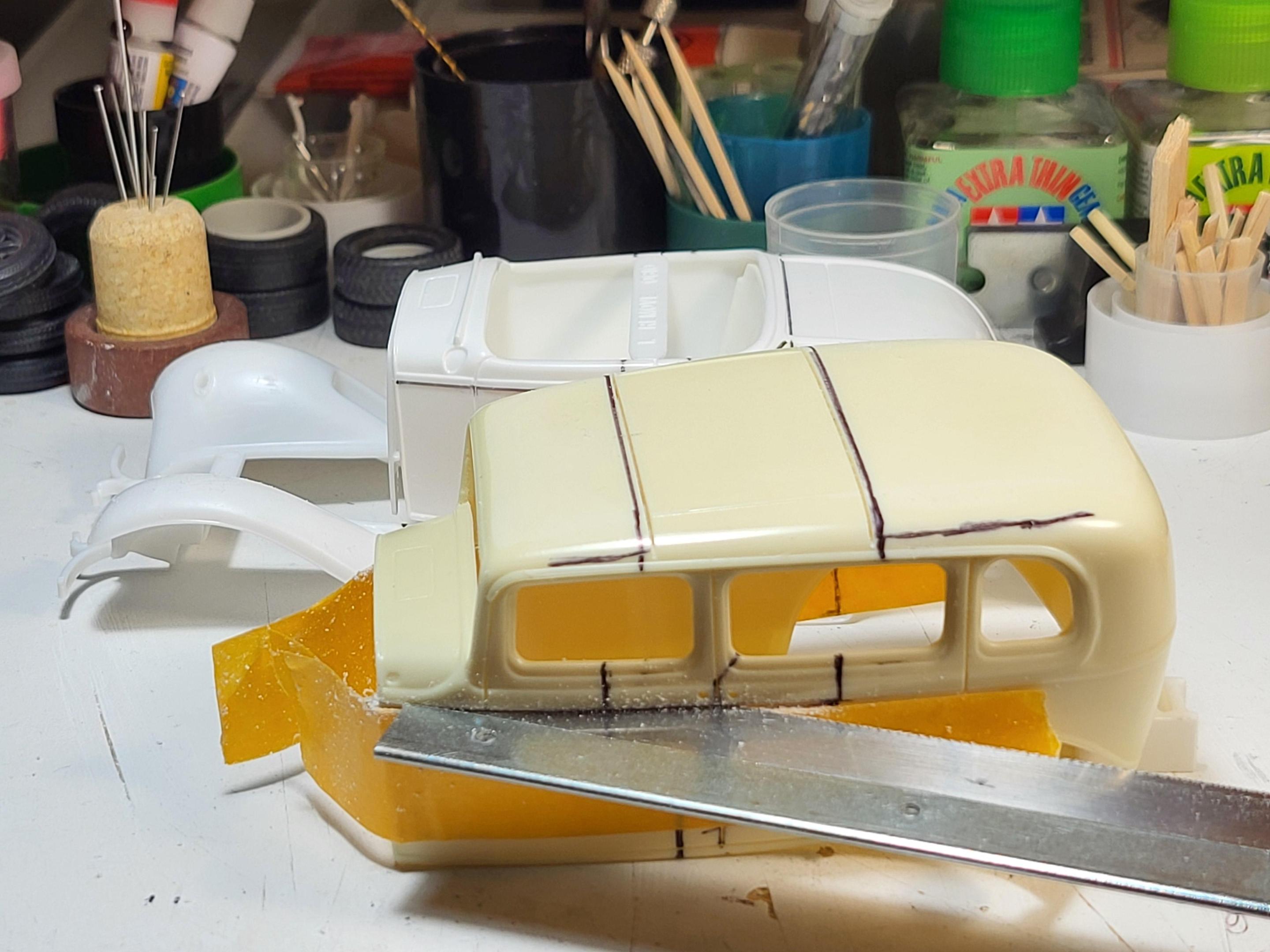

'32 Ford Chauffeur Driven Town Sedan came about while picking parts for the:
Found a bunch of late '20s thru early'30s town cars on the interweb:
and only one 1932 Ford Town Car that was found after the initial cutting and trial mockups were completed.

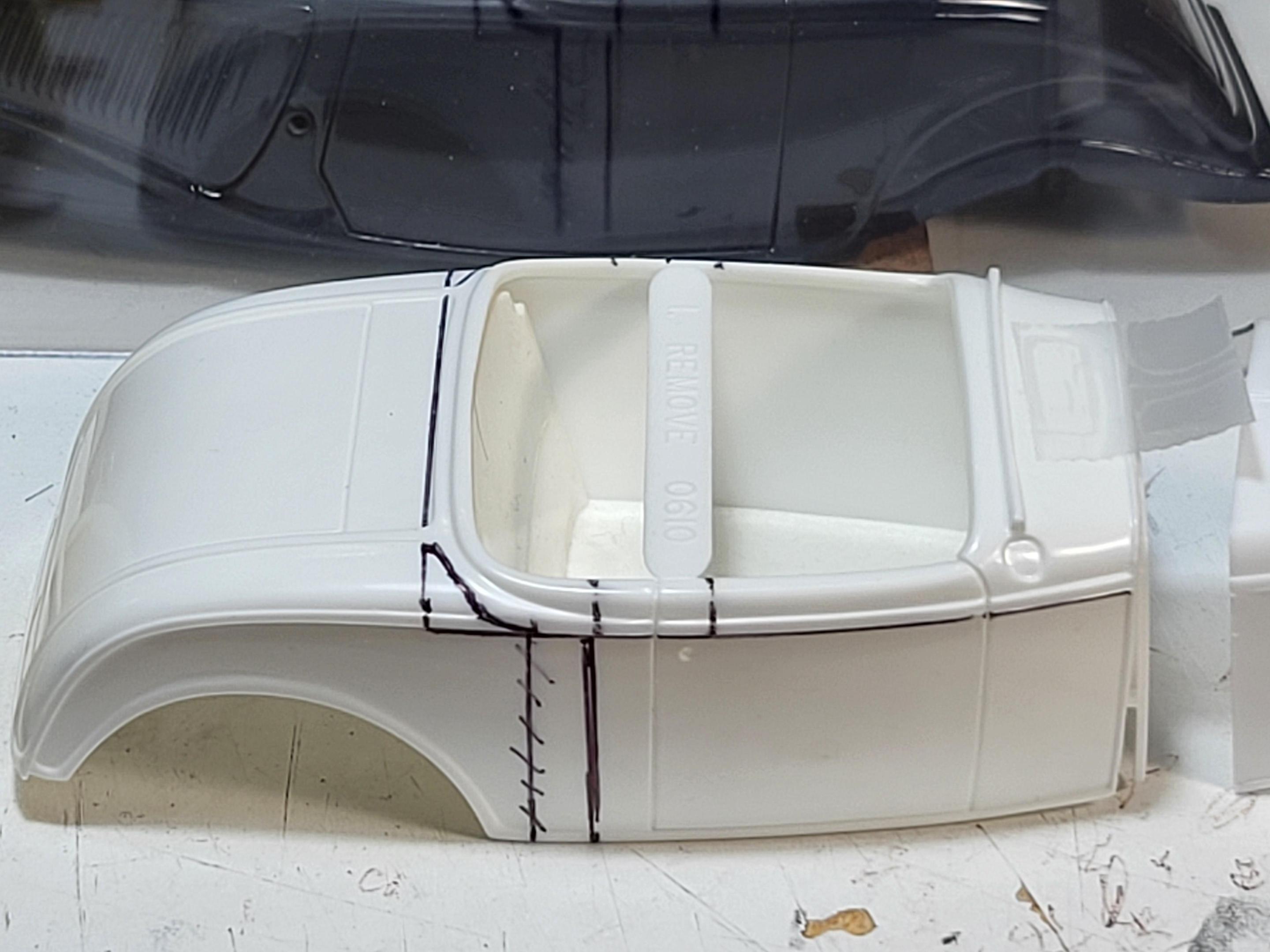

Concept Mockup

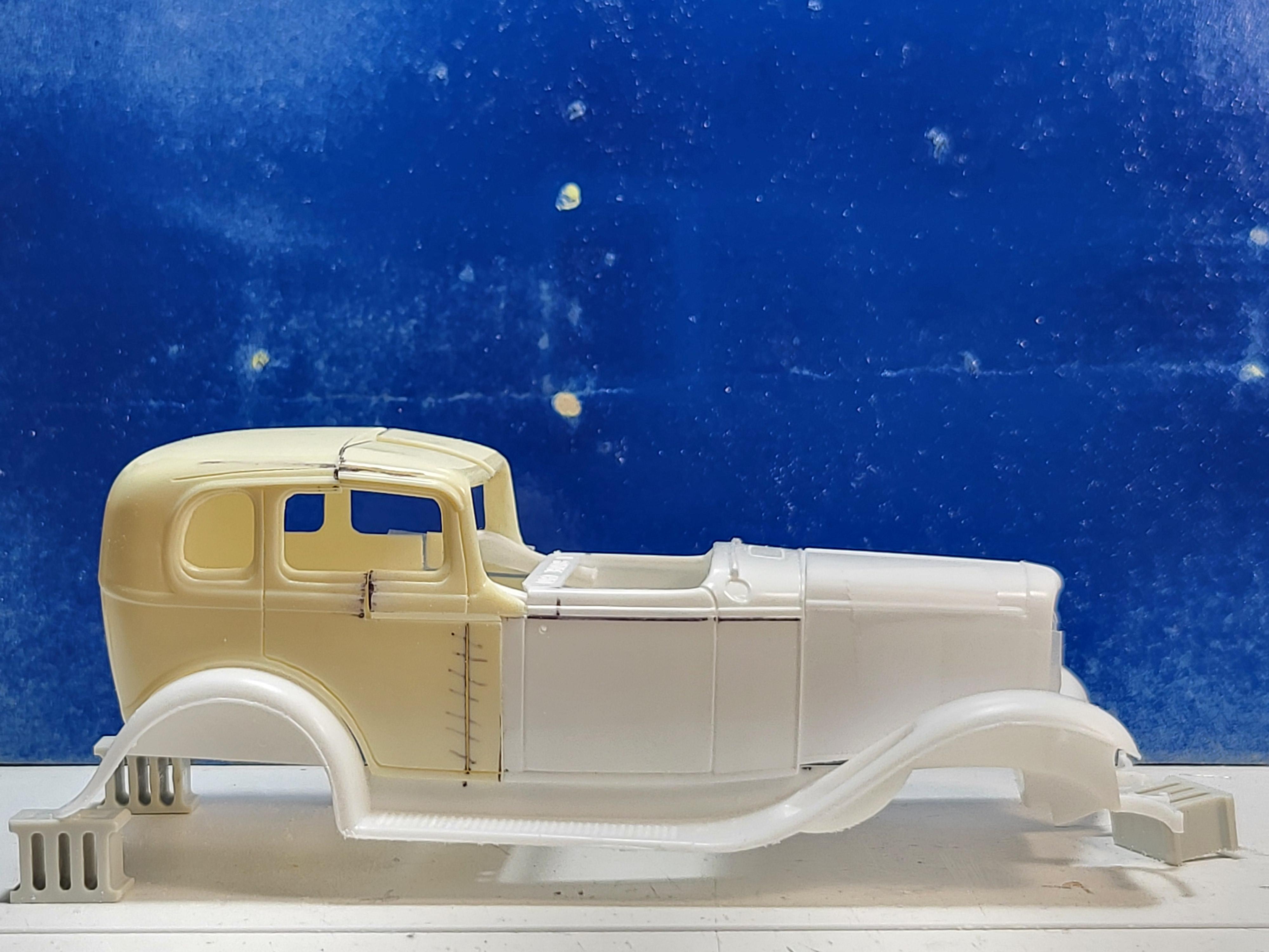

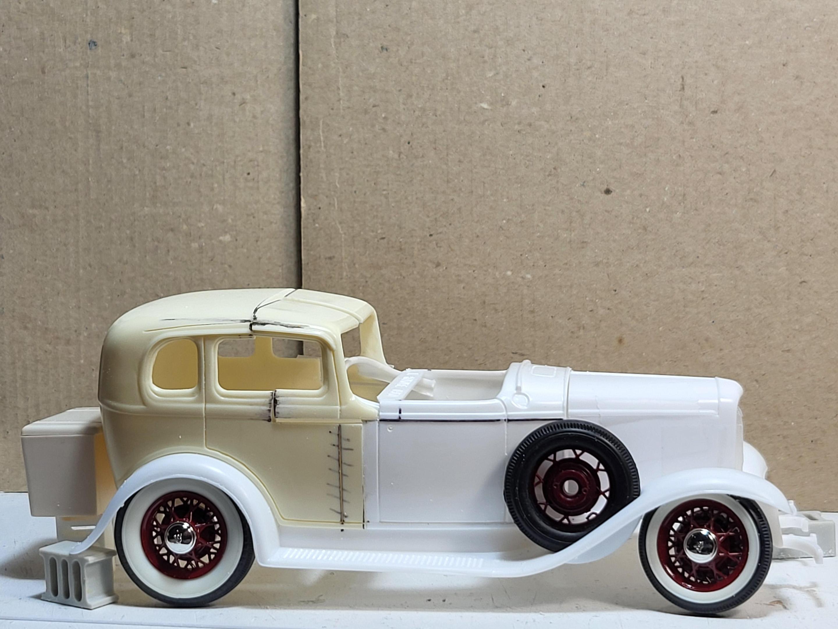

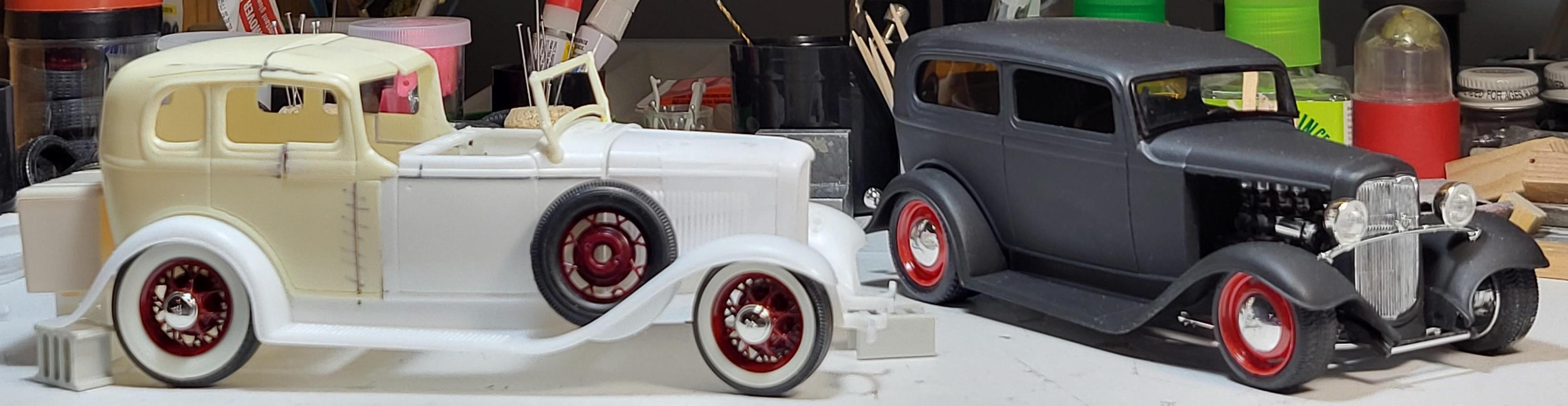

@Dennis Lacy's Ed Fluck '32 Ford Chopped 4Dr Sedan resin body mounted on the AMT '34 Ford Pickup fenders & running gear... and the Revell '32 Ford Highboy roadster body...

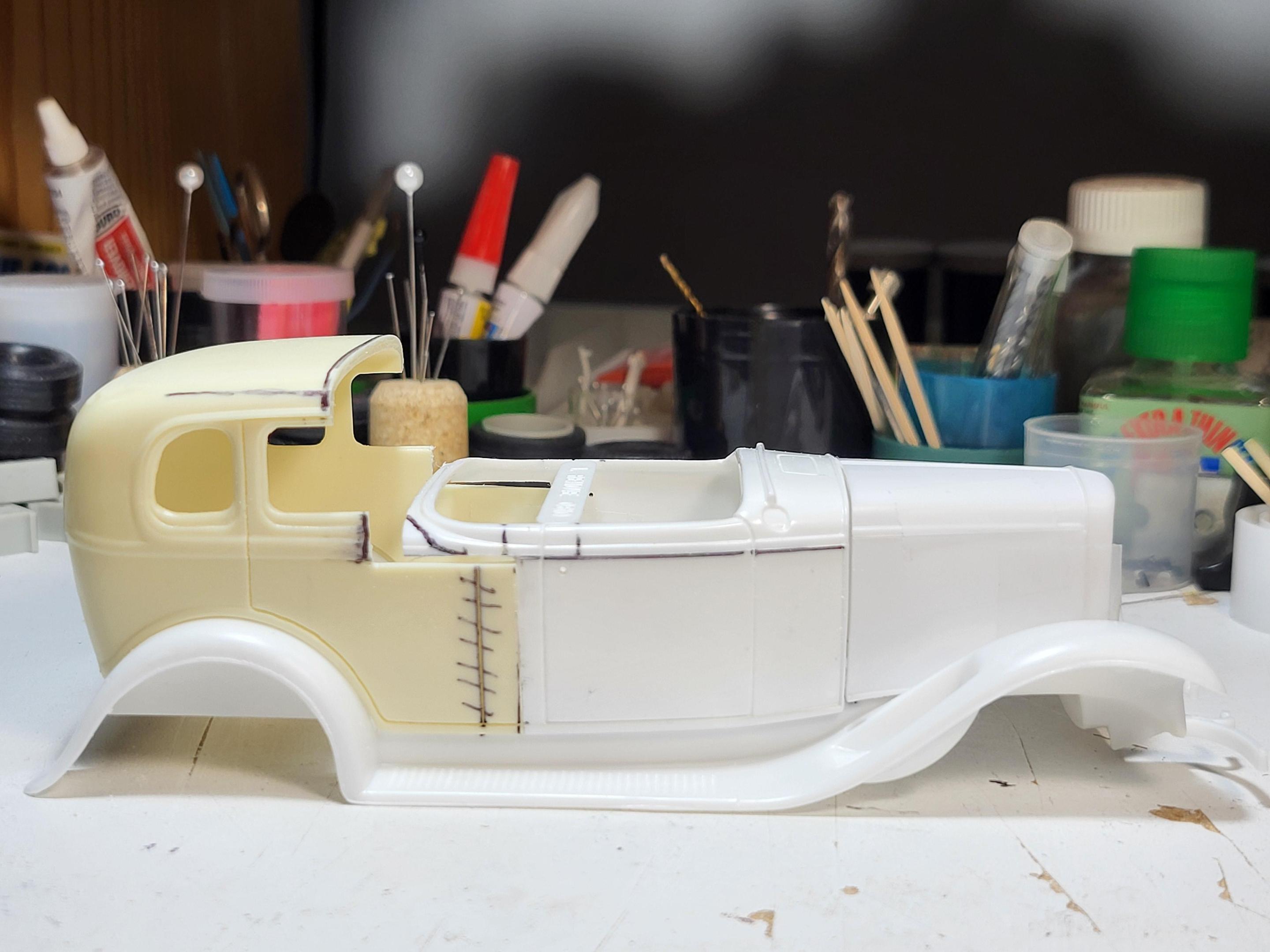

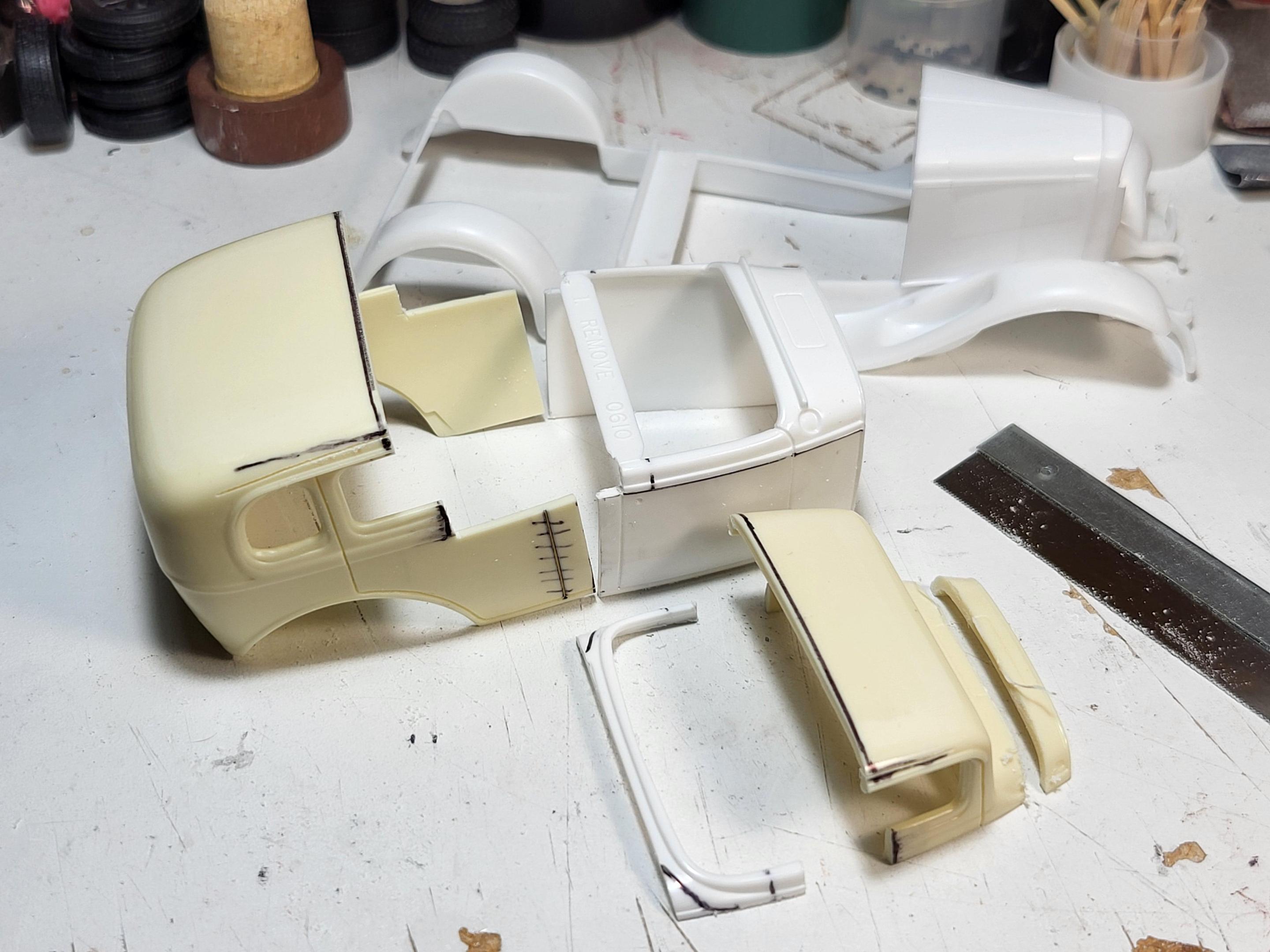

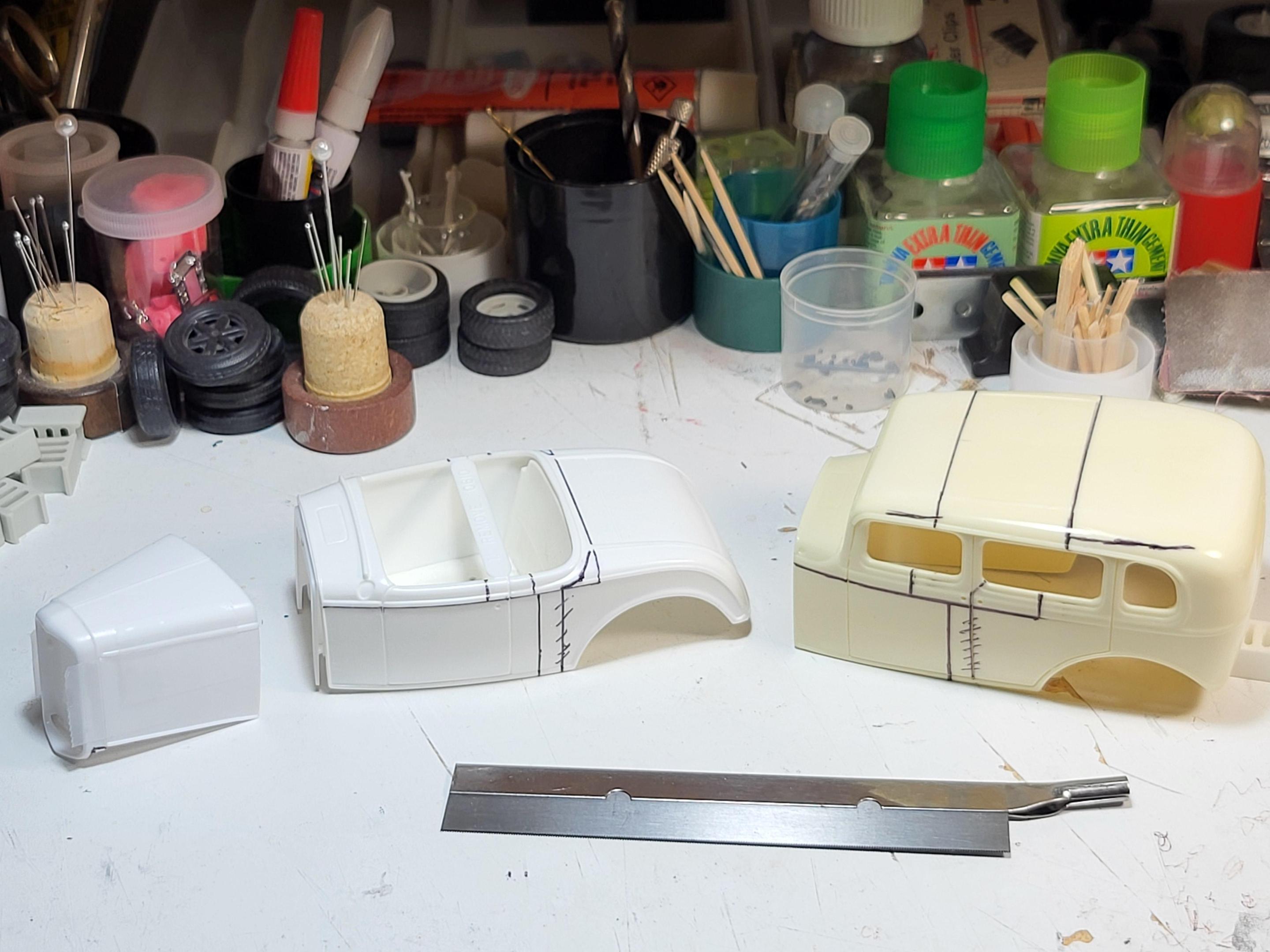

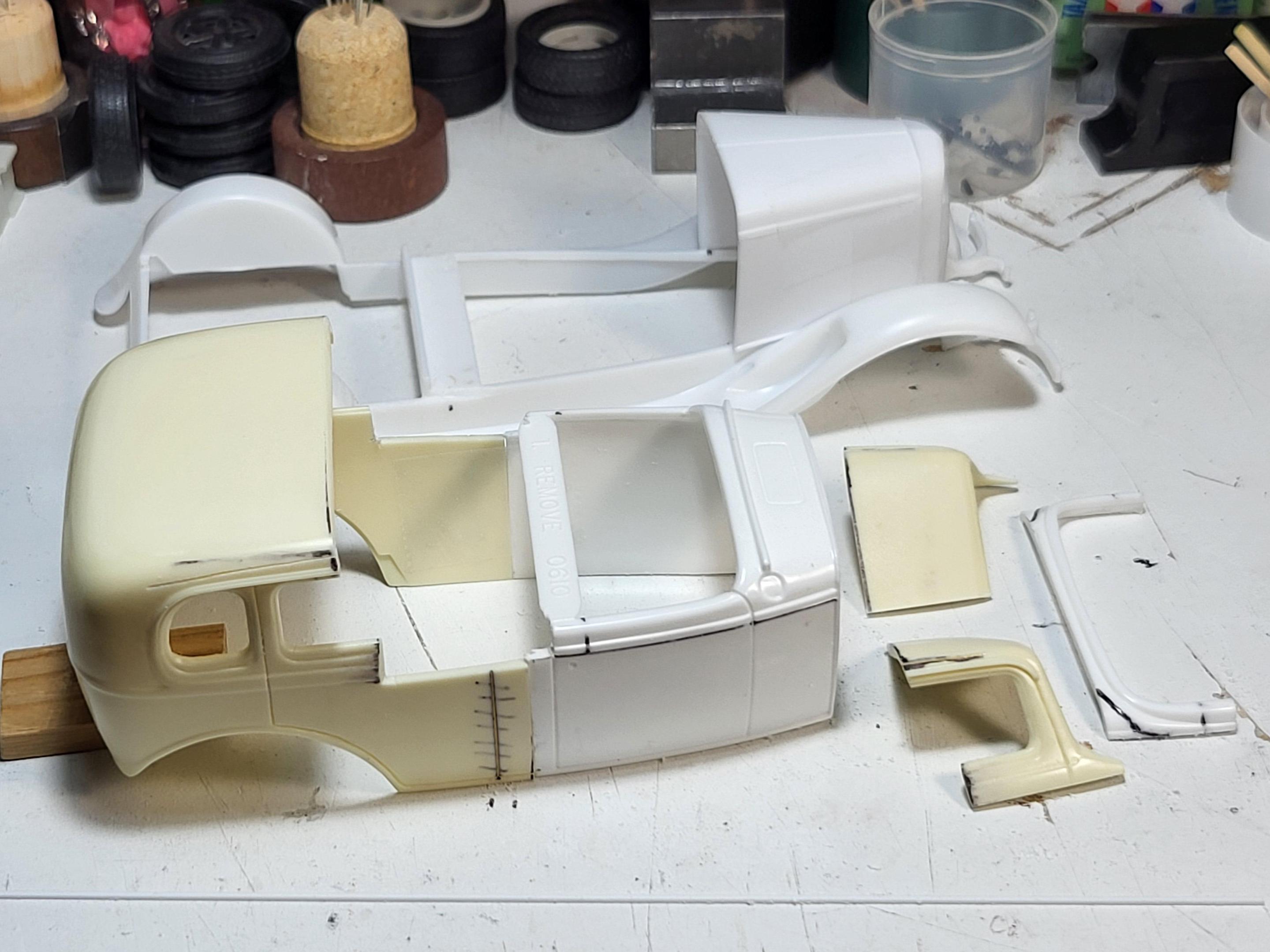

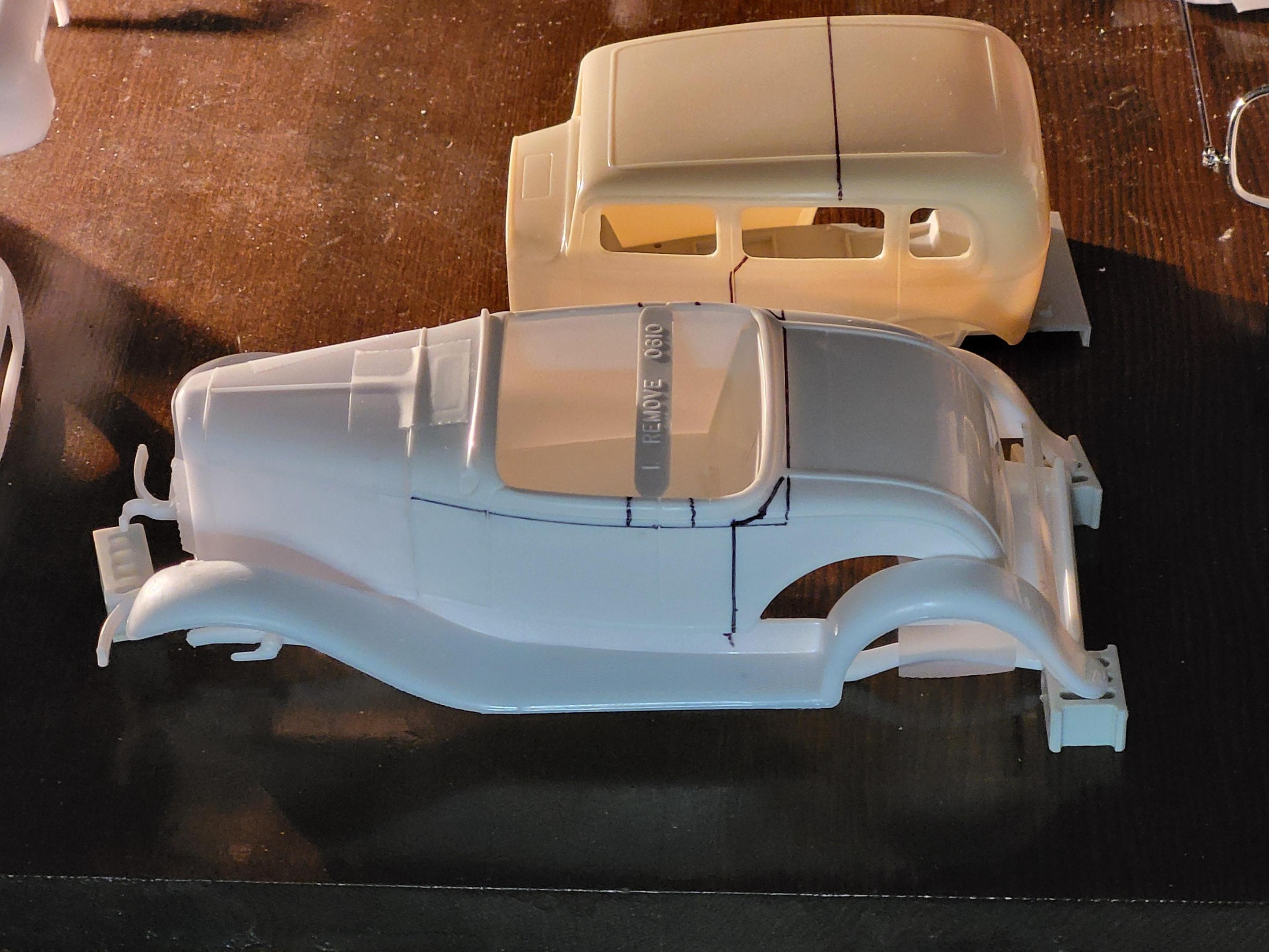

Enough cutting... let's see how the rest of the pieces fit together:

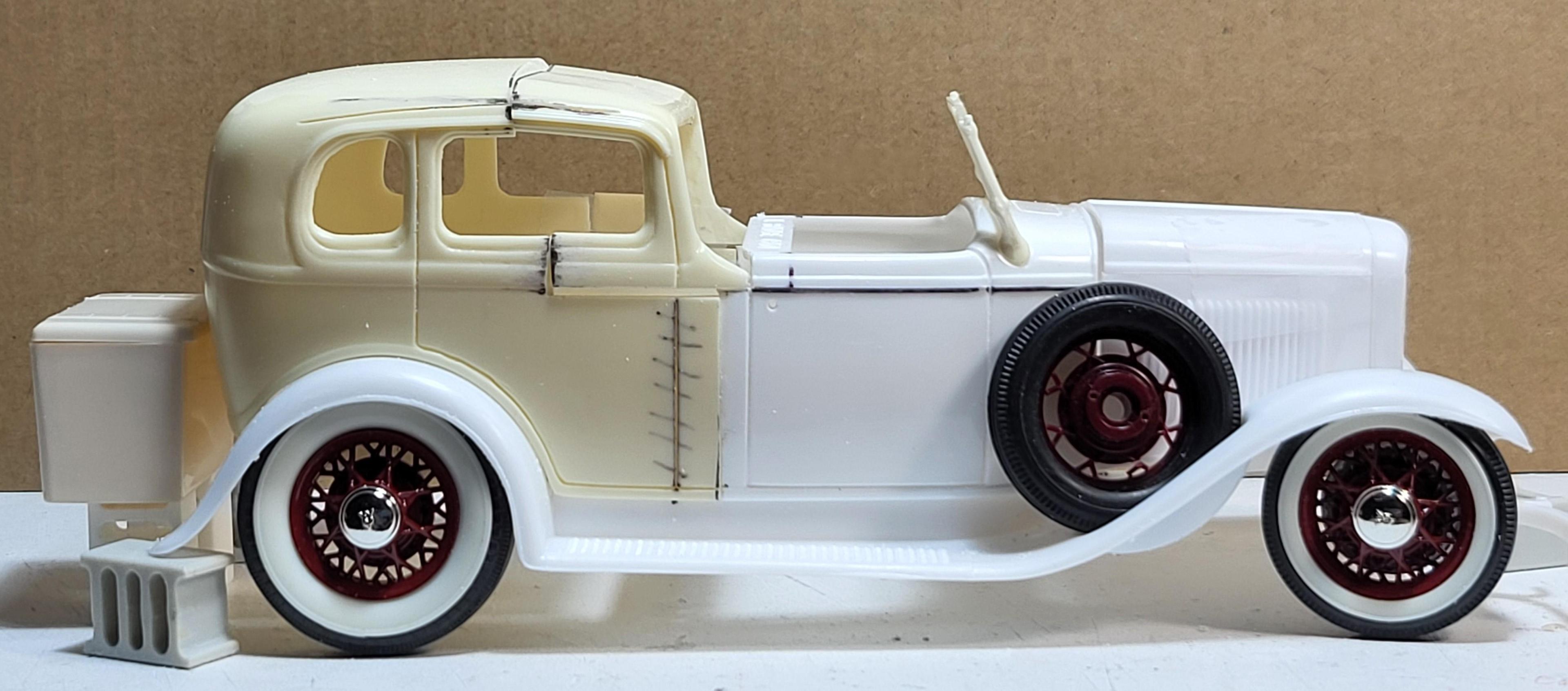

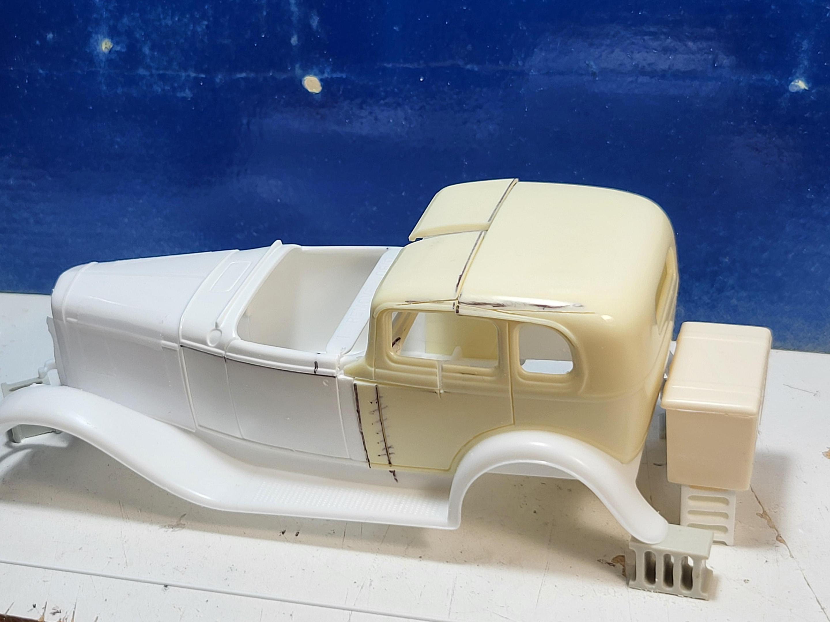

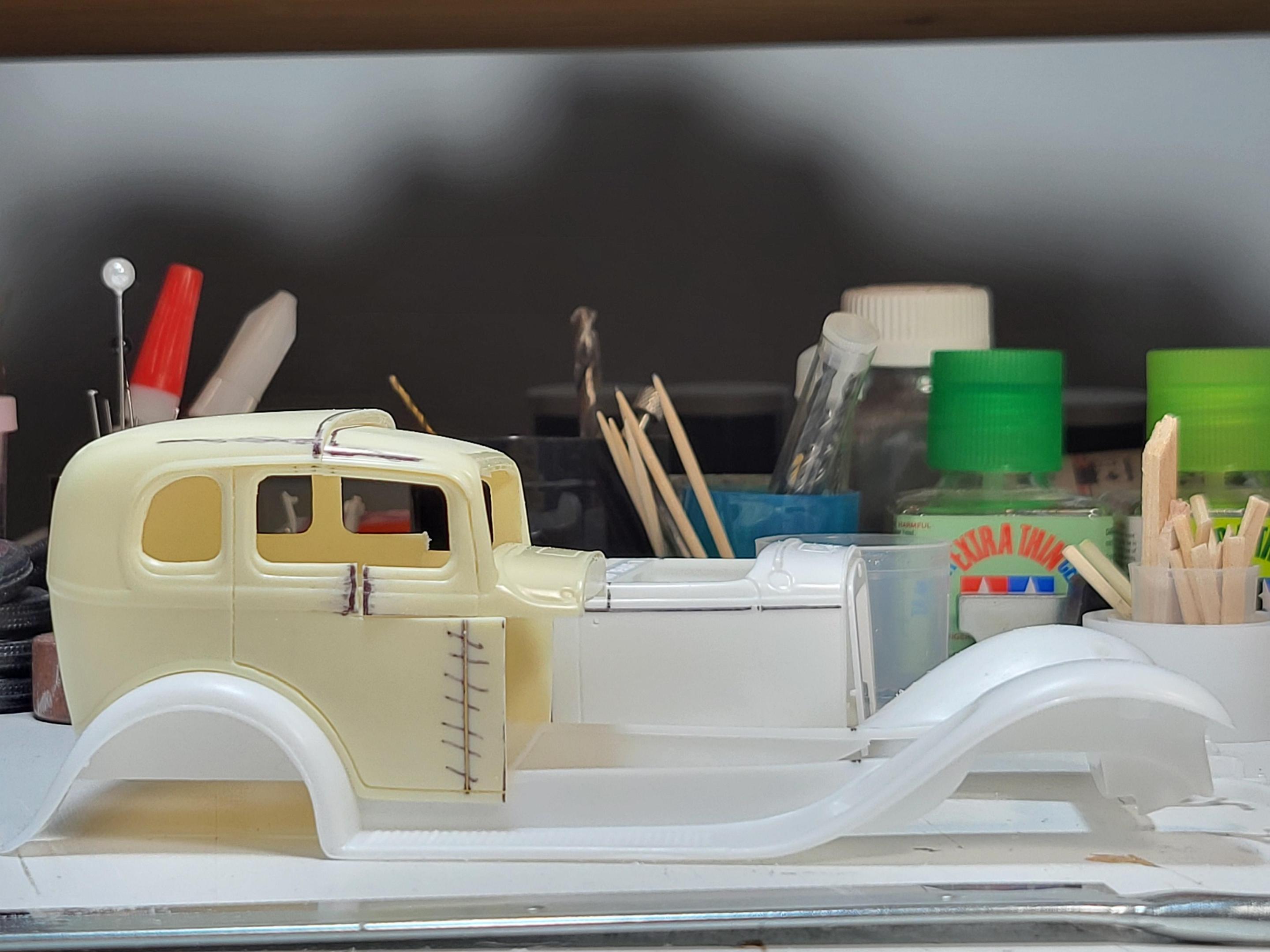

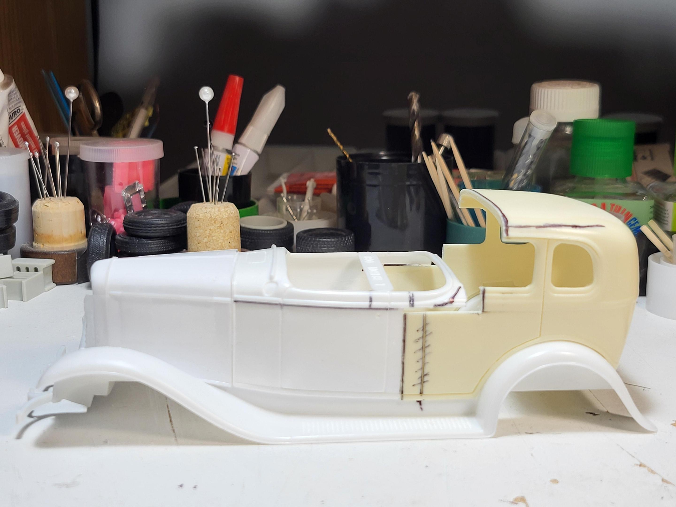

'32 Ford Chauffeur Driven Town Sedan rough cut mockup!
32FordChauffeurDrivenTownSedanwithWindschieldcropped.thumb.jpg.50a90f15dd5a7ed8a91ae03d2c667bc8.jpg

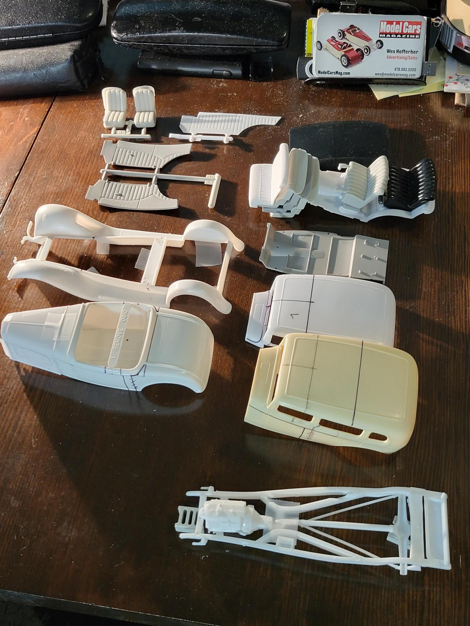

Kits involved include parts from:
AMT 1928 Lincoln Sport Touring
AMT 1932 Chrysler Roadster
AMT 1932 Ford Phaeton
'32 Ford Phantom Vickie
Revell/Monogram '32 Ford Highboy
Revell '32 Ford Sedan Street Rod
AMT '34 Ford Pickup
R&MCoMD Rat Rod Tires & Wire Wheels
2 B continued! -KK

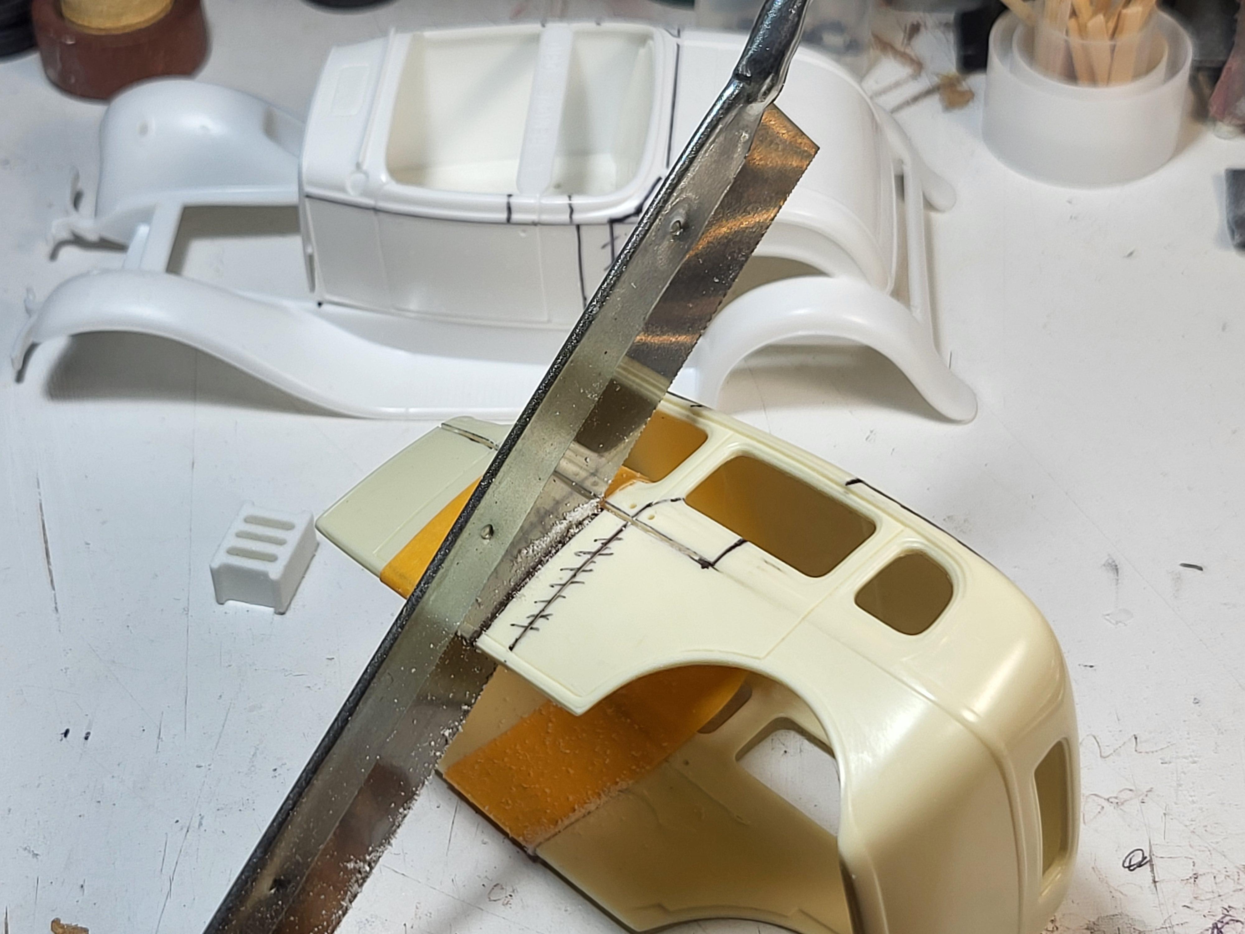

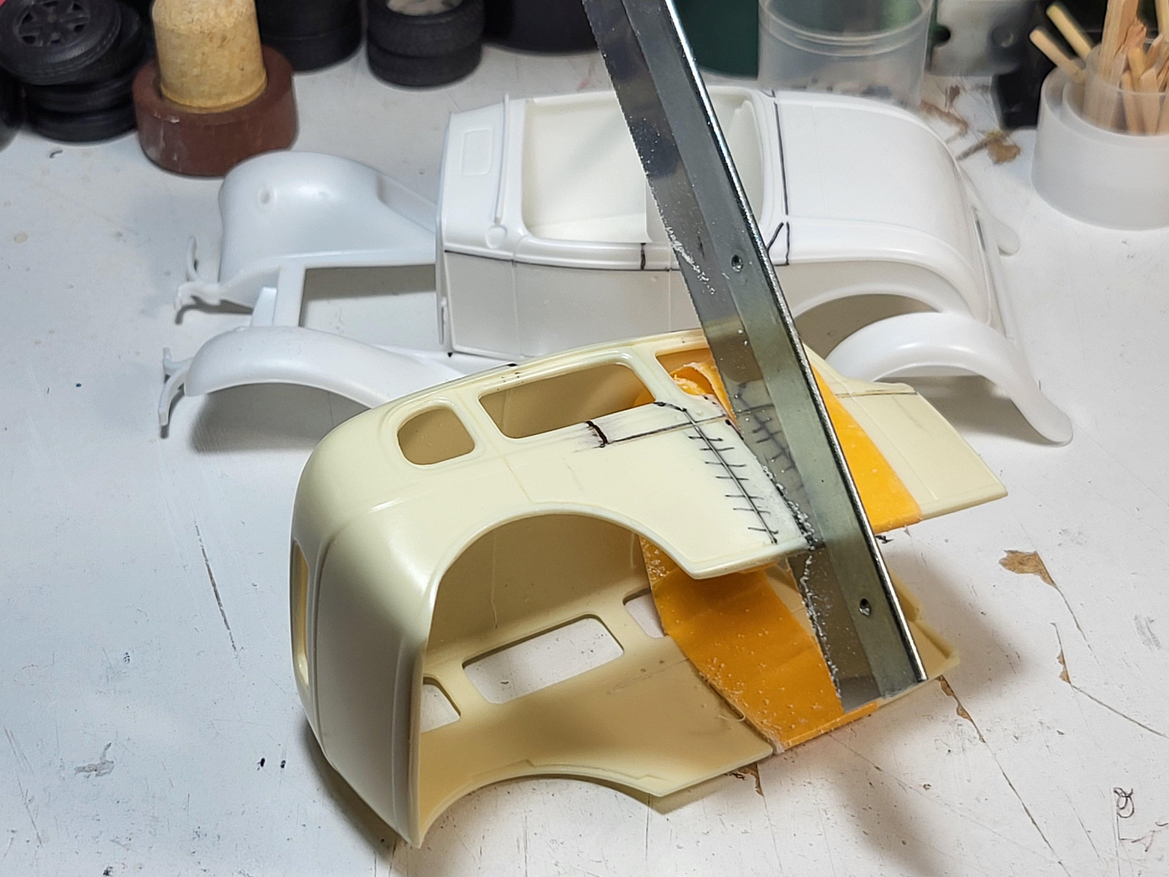

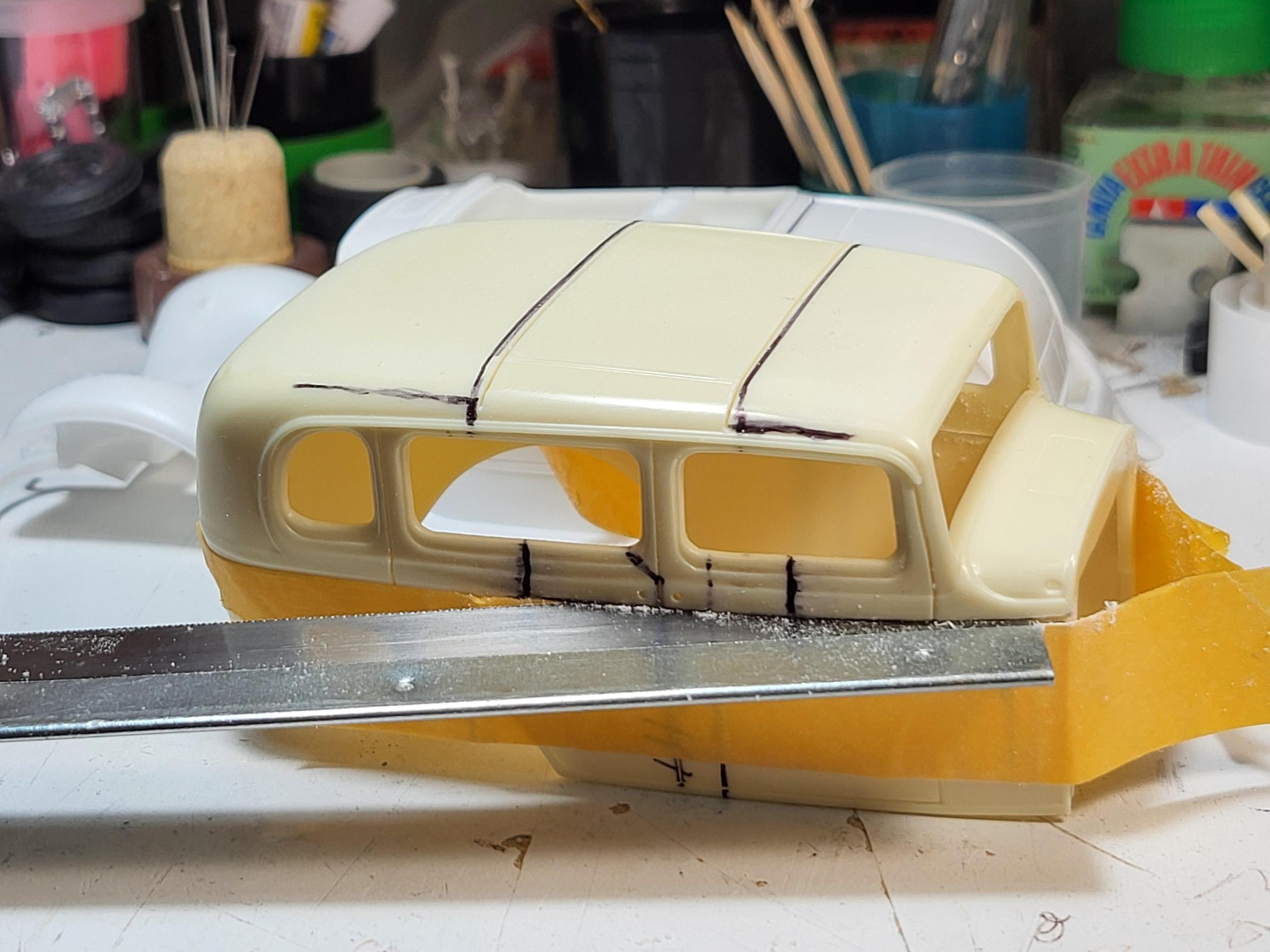

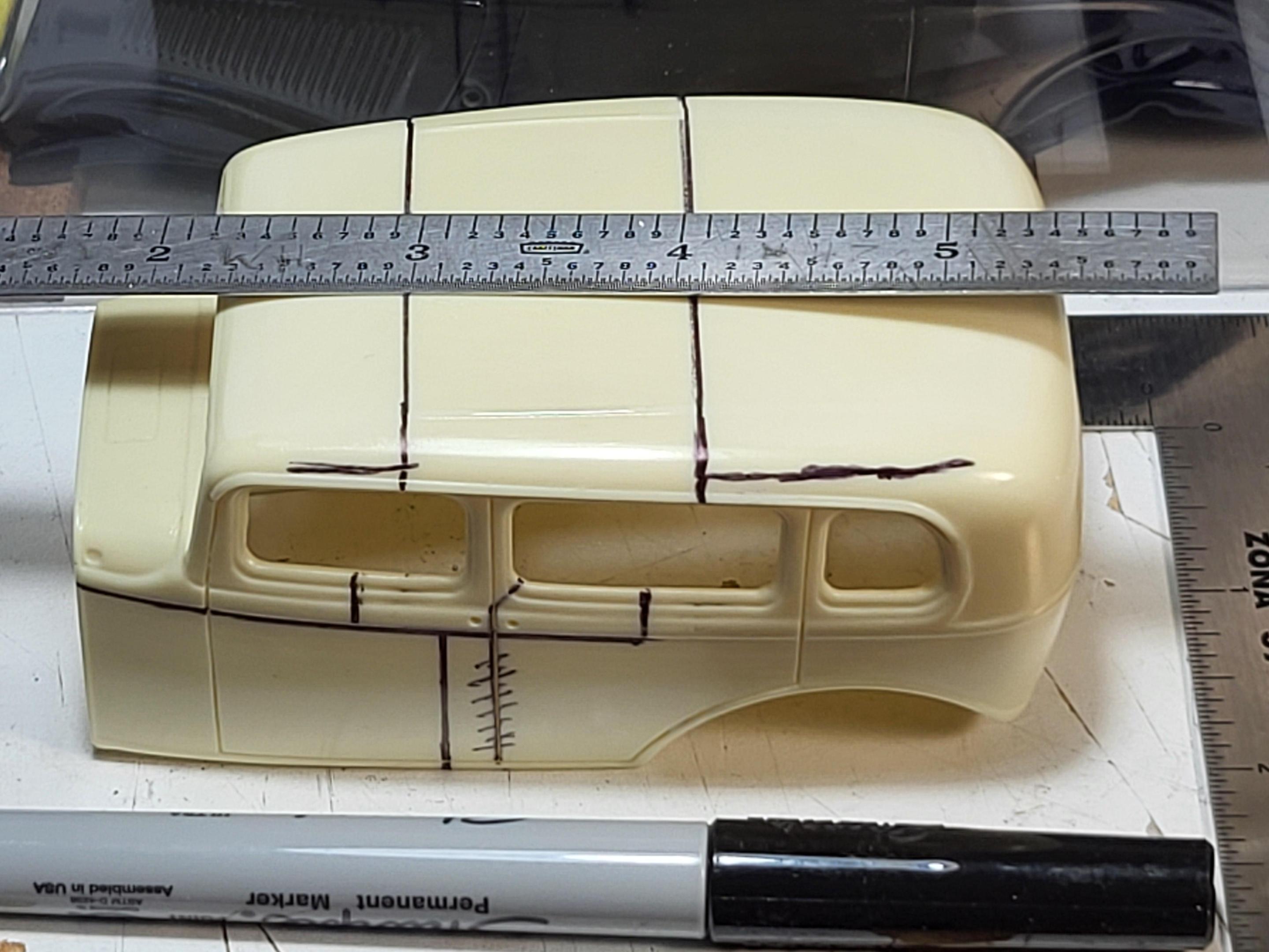

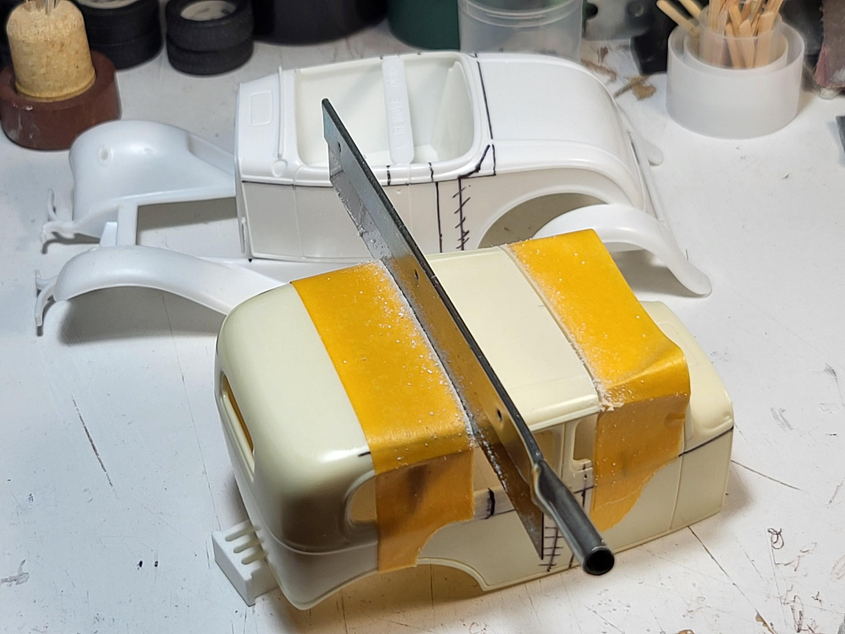

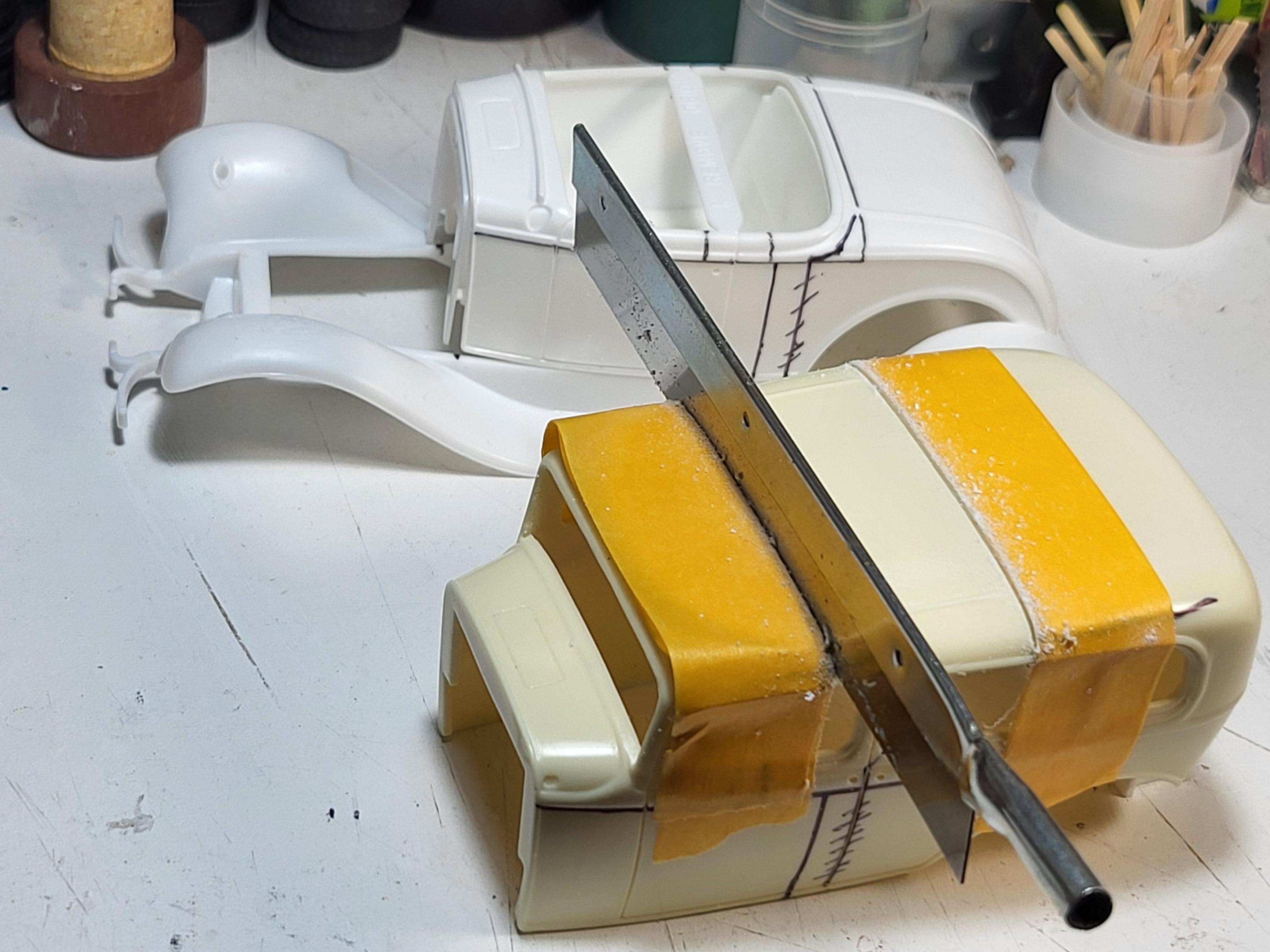

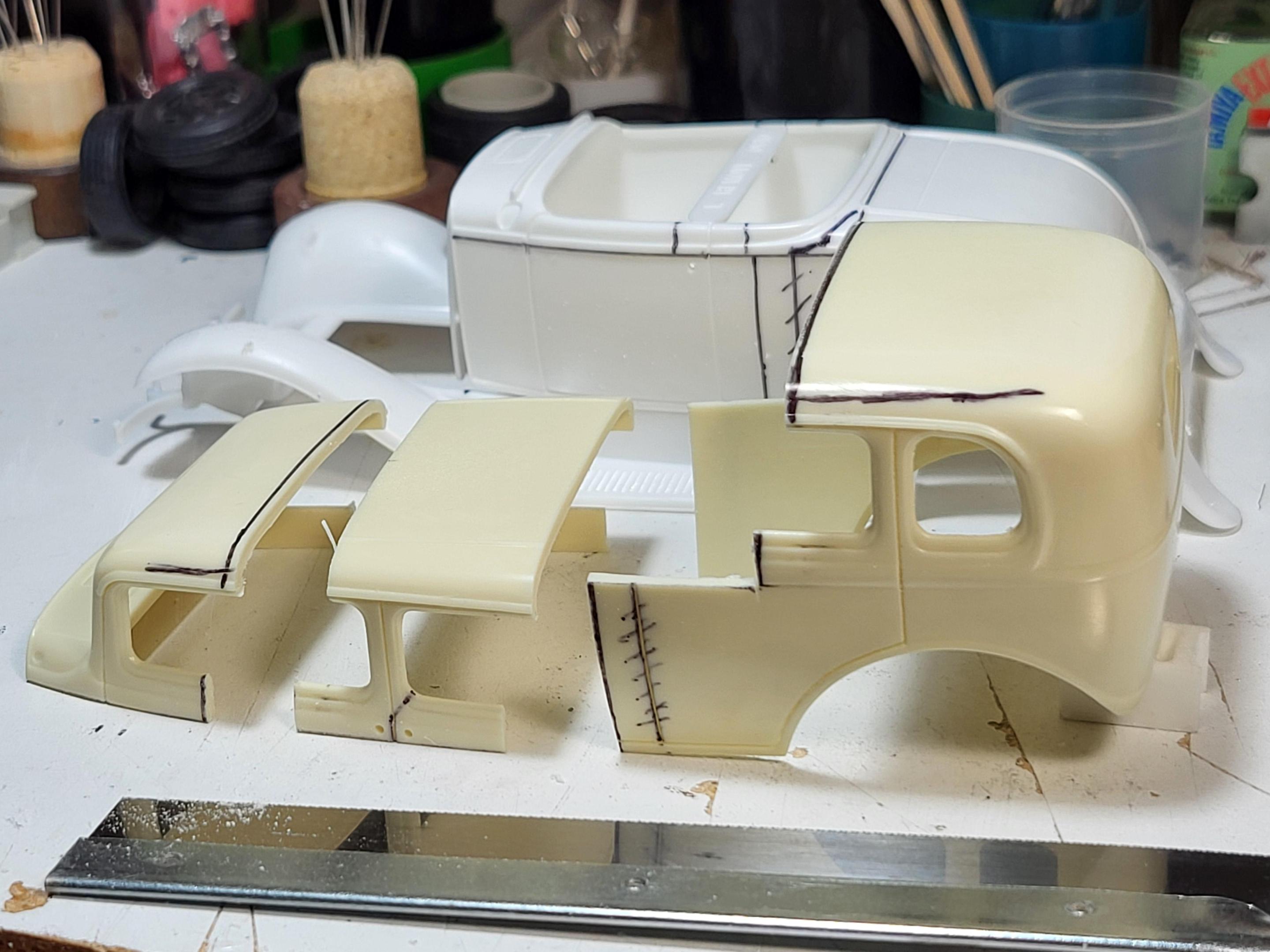

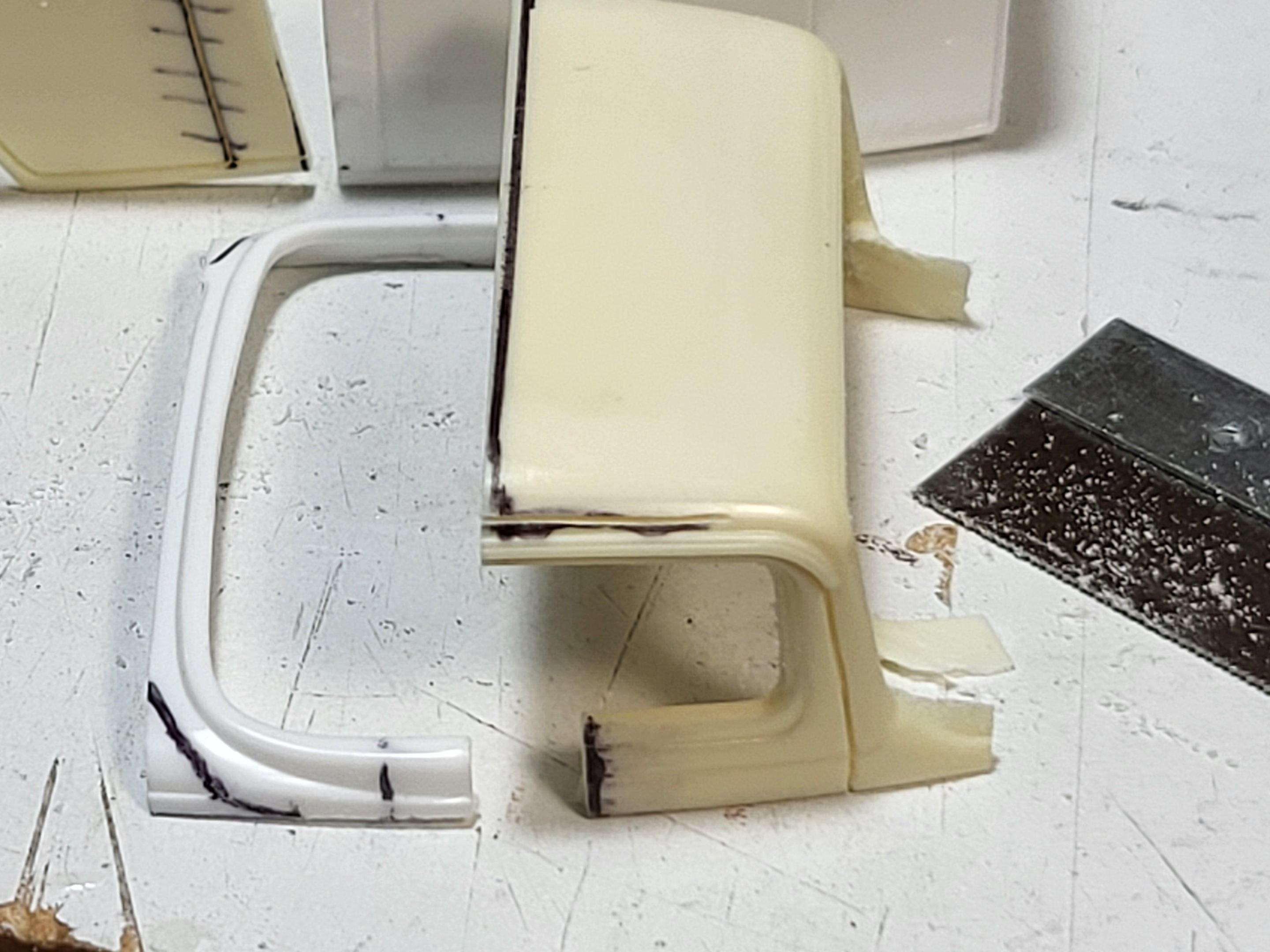

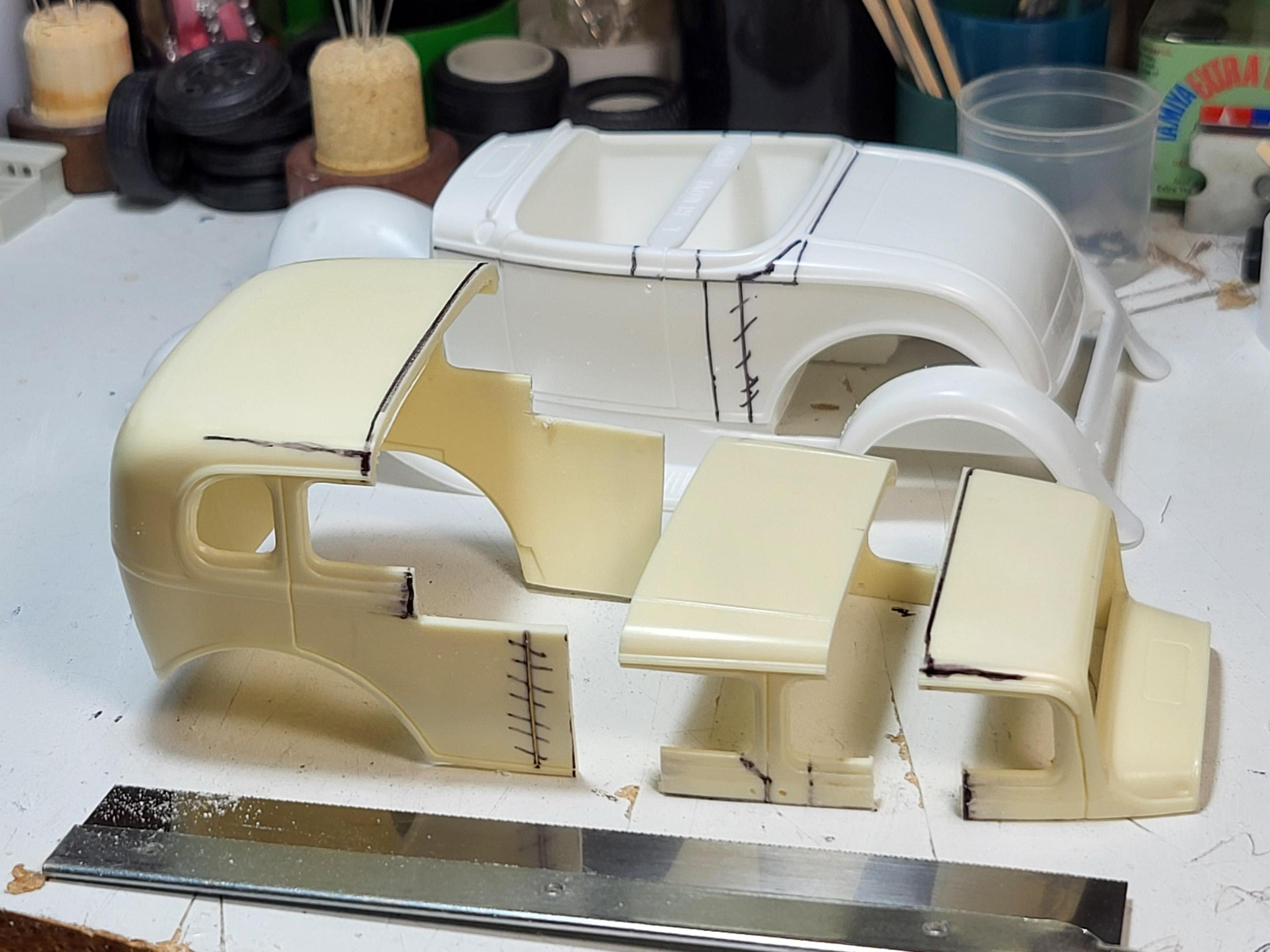

Here are couple of basic rules in cutting up and joining/merging plastic/resin model car bodies:
Measure thrice & cut once leaving material to be filed/sanded to shape/size...
Cut lines: to leave the line or take the line... that is the question. When cutting, is the line to be removed or left, initially; the angle of the cut may also play a part in slicing up parts...
When joining cut parts, edges should be clean and smooth... some joints are flat butt joints and others are beveled or slightly overlapped...
Fishplates: using a backing material to strengthen a joint/splice sometimes is necessary... a piece of note paper soaked in CA glue, or a thin piece of sheet plastic used to bridge the seam secured with liquid bonding cement, could/should be used at the builder's discretion...
With practice, most seams can be finished with very little bondo/filler putty and finish sanding... -KK

It takes a keen eye to do what KK is doing here. He also has a lot of experience cutting plastic up and splicing it back together. KK and I talk a lot about this, for us, it's really the fun part of the hobby, having the idea and then envisioning what can be done with available materials. I have to say, KK is more of a surgeon, I'm more of a hacker, with less finesse than he has (I tend to "mix it in the mix" as they say in the music recording industry). Getting good at it comes with practice, like any skill. I recently watched an interview with guitar shredder Steve Vai. He was asked how it got so good. "Practice". The other aspect of this is proportions. It's very important to get proportions right to pull off modifying a body and make it look "right". You'll know it when you get it.
Looking forward to seeing more of this delicate surgery? here.... -RRR
  • Like 4

You are absolutely correct. Excellent blending and paint don’t cover up awkward proportions. Kit’s got it nailed I think!?

This is one of the most original ideas I’ve seen in a while and you’re just the man for the job, KK! Very much looking forward to watching this evolve.
(You need to find a 1/25th scale Lurch figure for the driver.)
