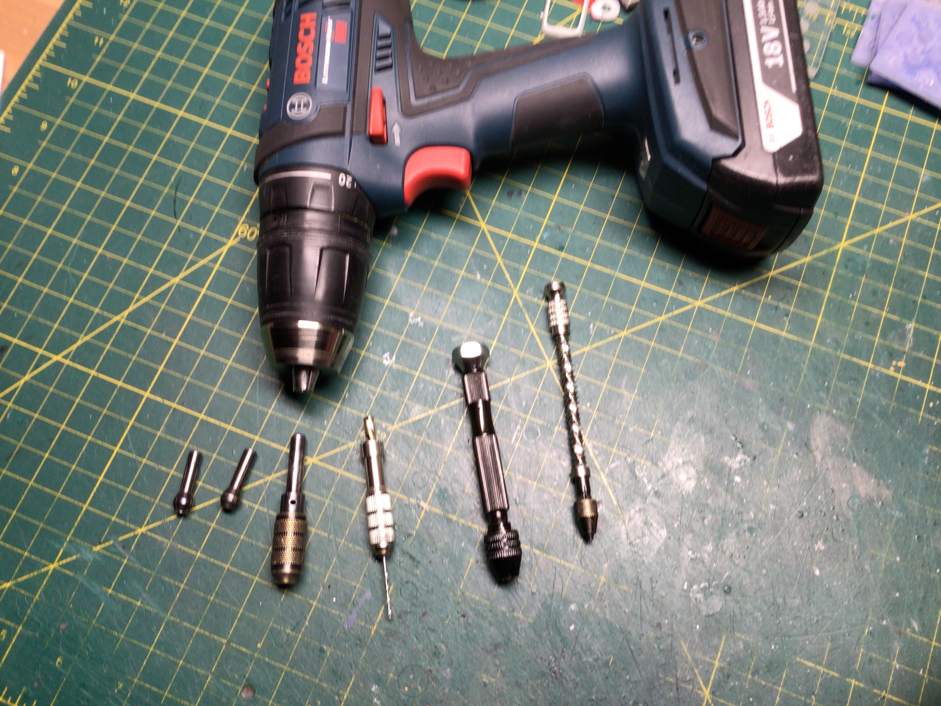

NOBLNG Posted June 23, 2024 Posted June 23, 2024 For drilling tiny holes from #61-80, my preference is the spring loaded push drill on the right. Micro Mark sells them I believe. For larger holes I like the manual pin vise, or my cordless drill. I have a micro chuck with three collets that I can also mount in my cordless drill or even my drill press.

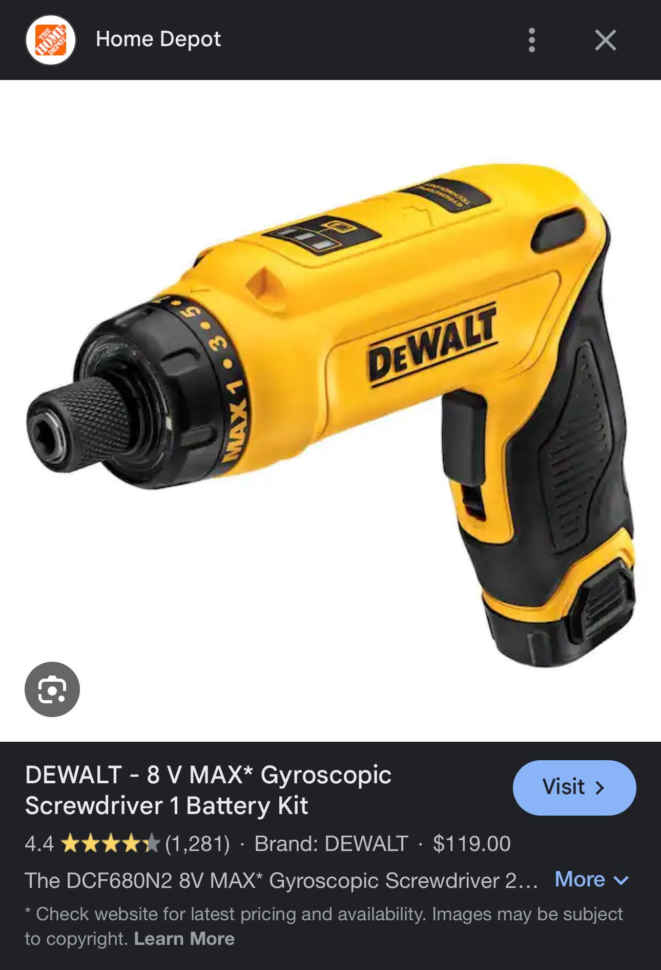

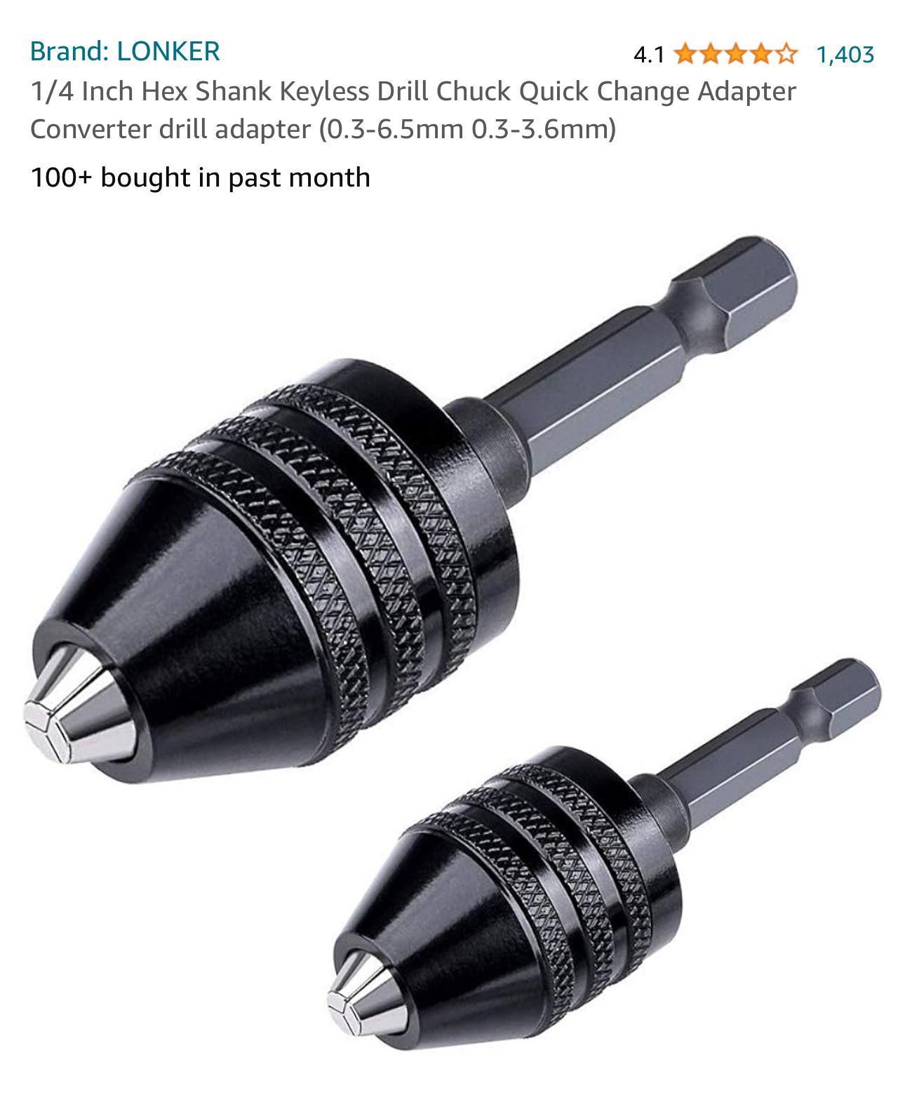

Keef Posted June 24, 2024 Posted June 24, 2024 I use this for everything. Even have a set of Milwaukee drill bits that I use as well.
