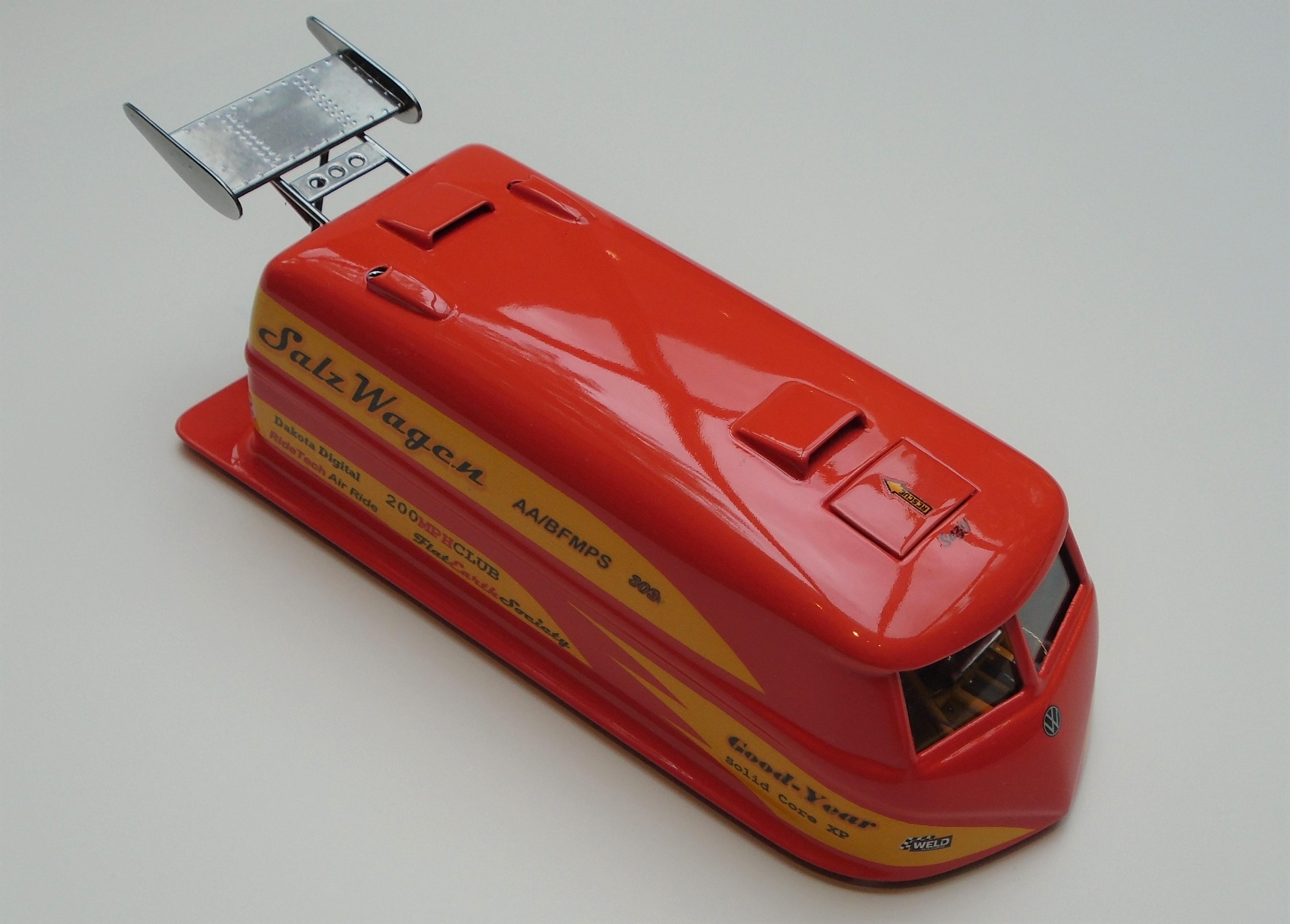

Claude Thibodeau Posted June 25, 2024 Author Posted June 25, 2024 6 hours ago, NOBLNG said: I polished my ‘49 Merc with Tamiya coarse, fine, and finish compounds. I’m not 100% sure which Mr.Hobby clear I used though, it may have been the UV Cut since the paint is lacquer. You could spray some of the Premium on a spoon or junk body to see how your polish affects it. Hi Greg! Thanks for your input. The Premium top coat is WATER based, and therefore, dries "softer" than lacquer clear (such as Tamya or Revell). Hence my search for those of us who actually polished it. Usually, my final clears are so smooth and shiny that they don't even require polishing (see VW salt car below). But on this specific build, it does! CT
