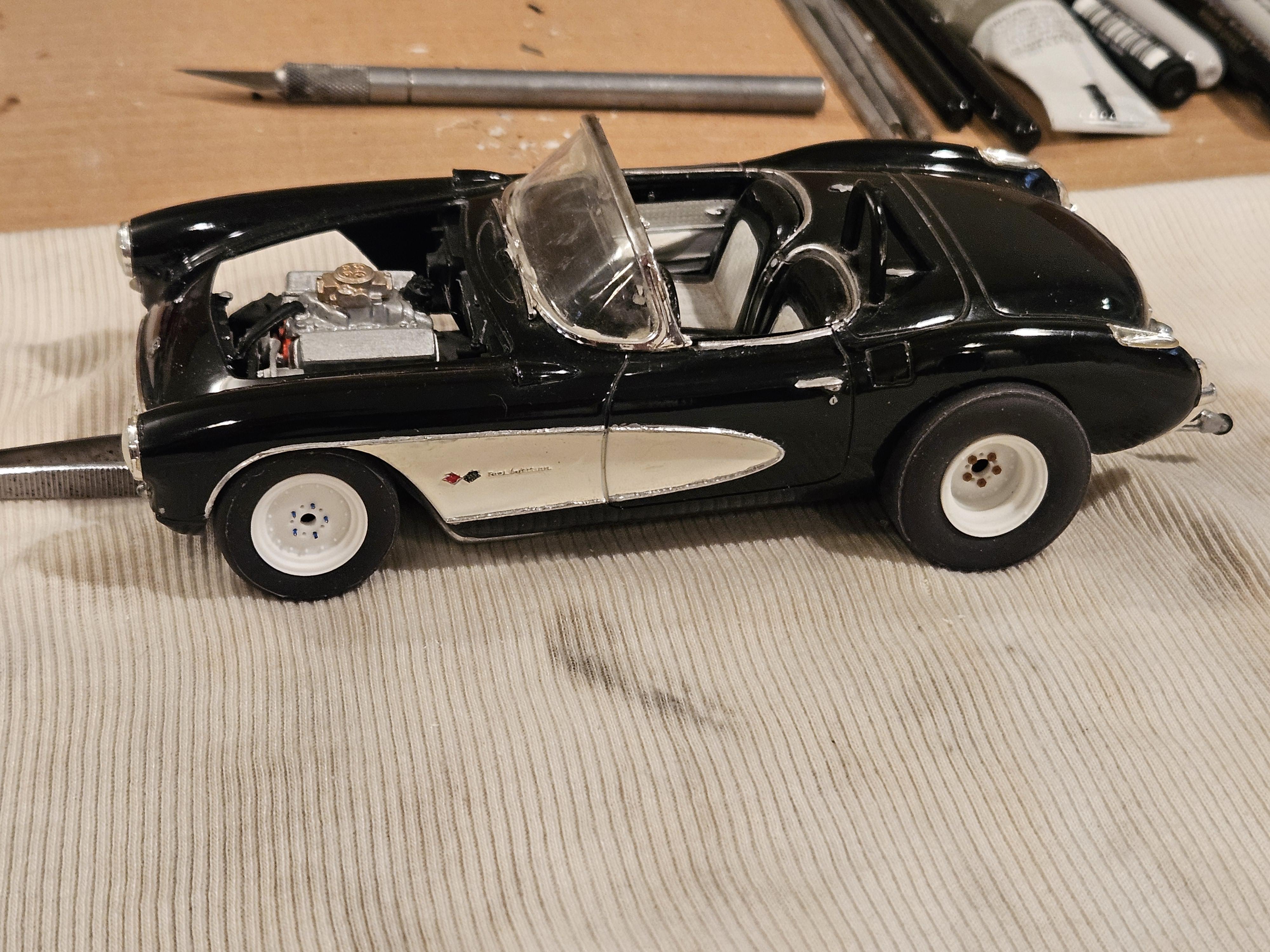

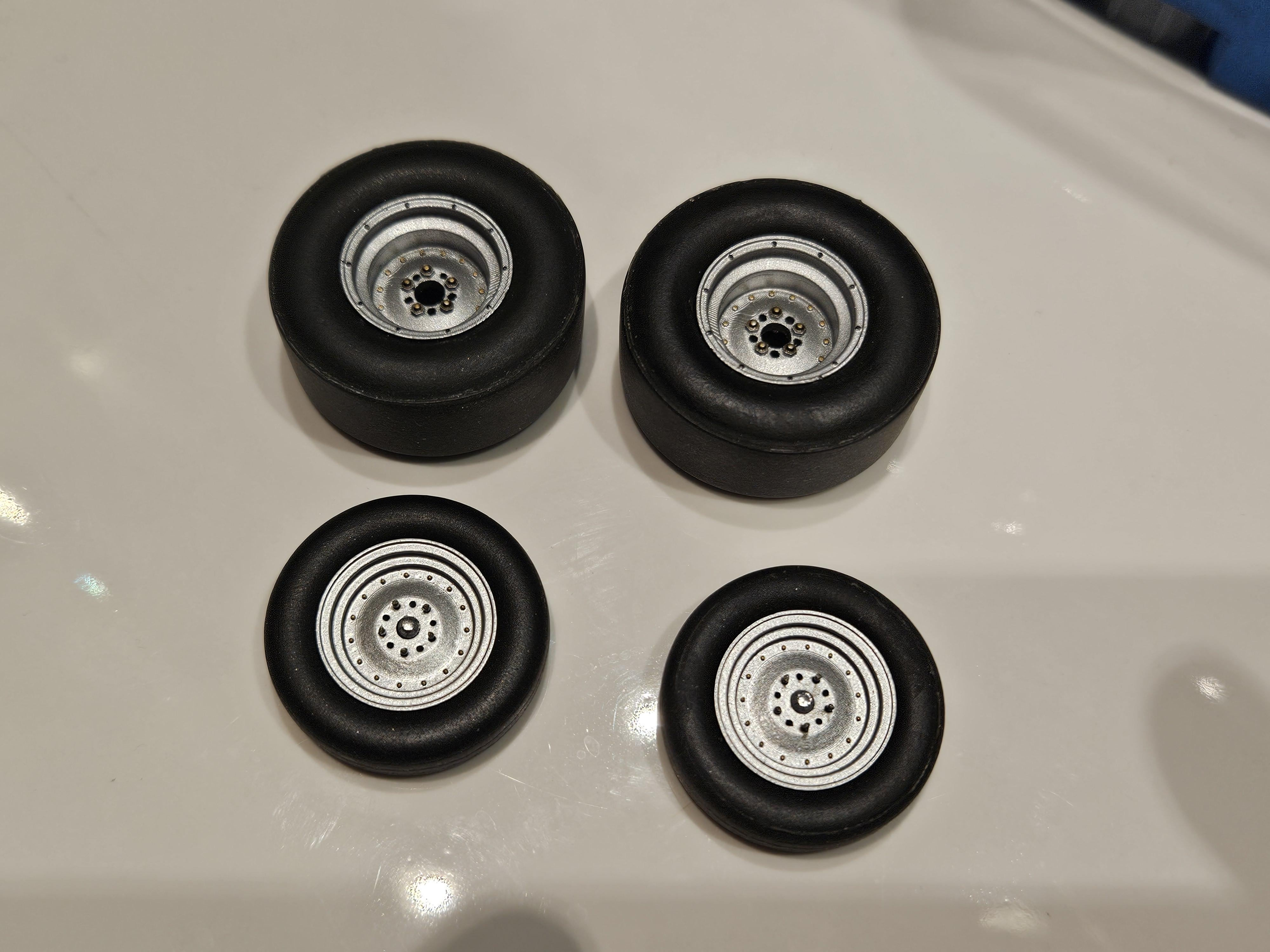

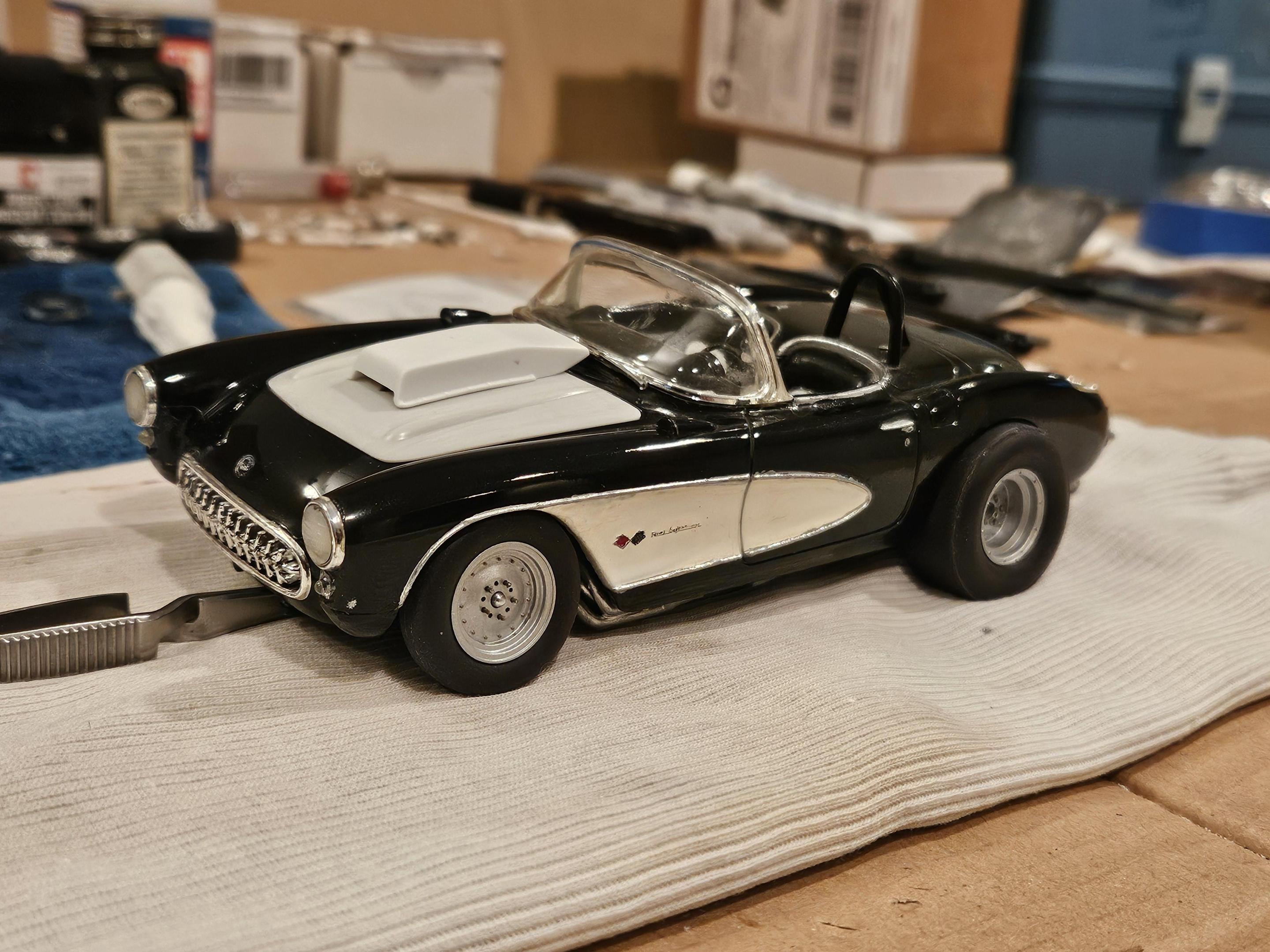

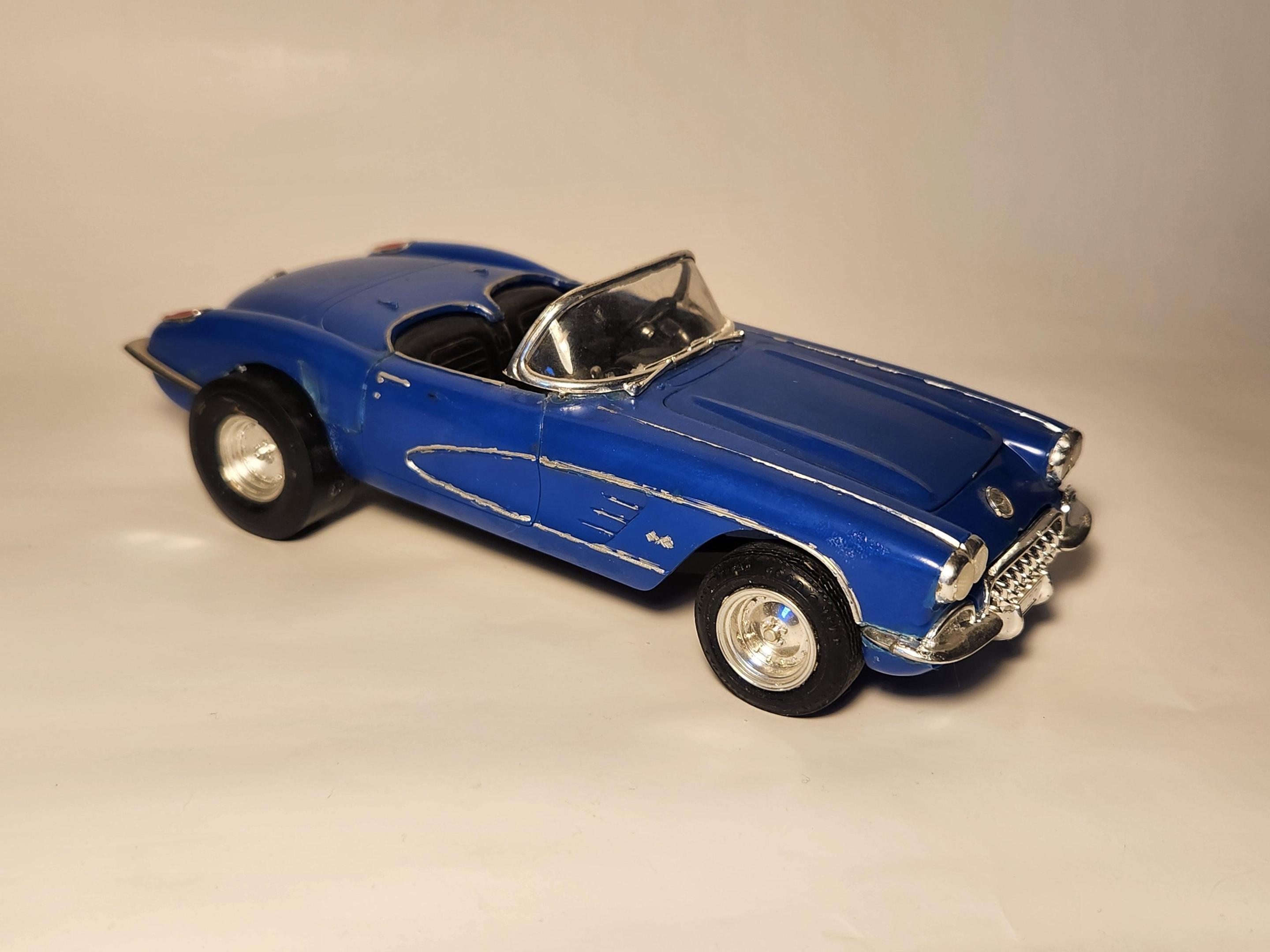

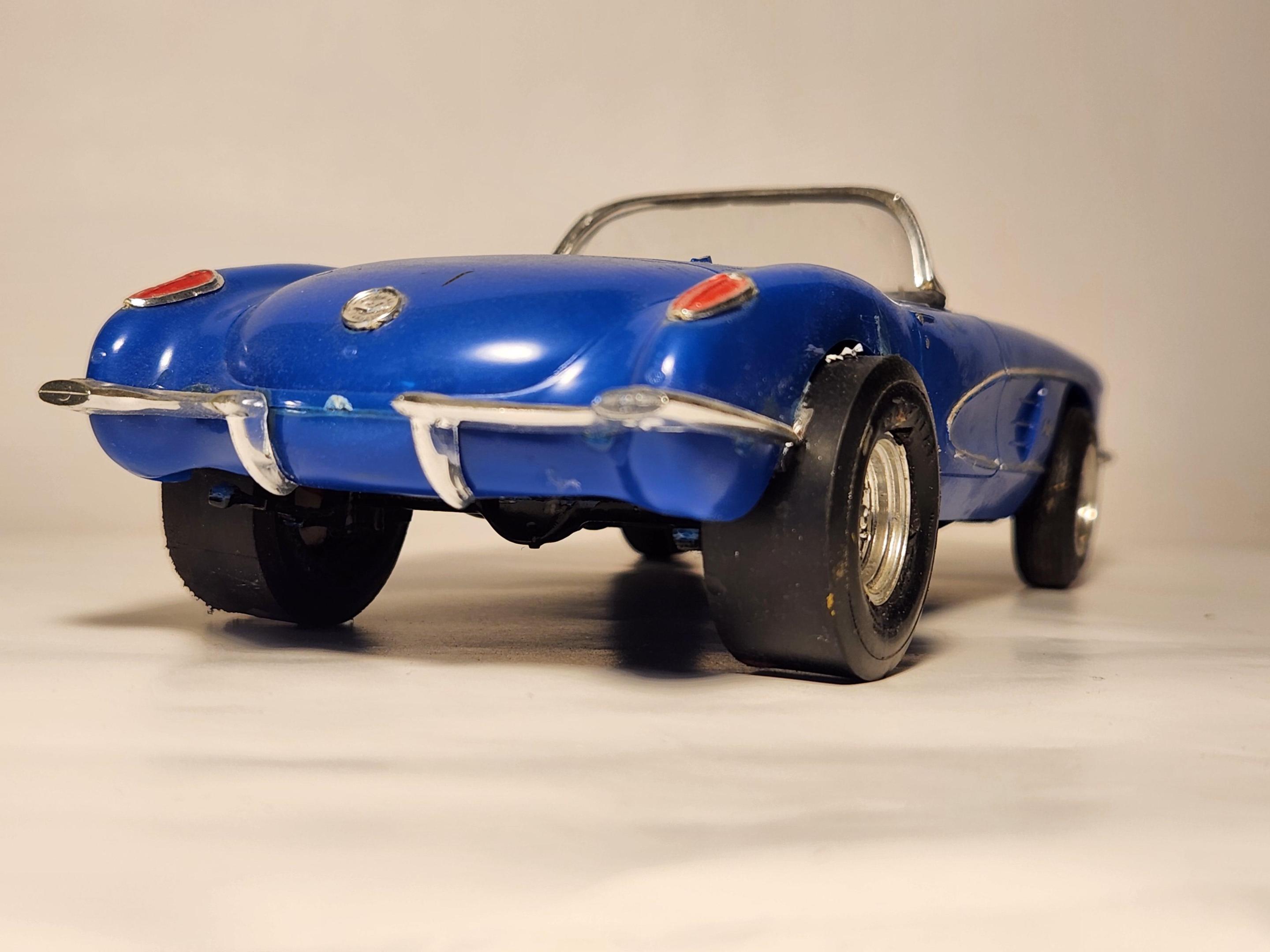

keviiin86 Posted June 27, 2024 Posted June 27, 2024 (edited) To start off, I have several of these AMT 57 corvette street machine kits that I've grabbed parts from over the years so most of them are incomplete and for that reason I used the body of one to test some paint that I was going to use on a different build..but after painting it I realized I wanted to actually build it. Of the 4 kits I have, I only built one back in the late 90s when I was probably 12 years old. So I dug it out of a box and started to use it as a "mock up" for wheels and tires...it's not pretty but hey I was a kid when I built it lol. My plan is to make it a late 70s to early 80s drag car. Going to use the kit big block but switch the trans to a th400 since the trans in the kit is a 4L80e for some reason. I've got a couple different grump lump type scoops that i'll choose from for the hood and going to grab the removable hard top from an AMT 62 corvette kit I have. I'll probably leave the rear suspension as is but chop off the wheelie bars. Then add a 6 point roll bar and a bunch of details here and there. I've centered the build around the wheels/tires which I got from futur attraction since that's what makes the "look" in my opinion. I narrowed the rears a little bit so they fit the 11" wide rear tires better and added some lug nuts since the wheels had none. Trying to decide what color to paint them. I'm between anodized gold or the satin finish for the super tricks. But not sure what the best paint would be for anodized gold. Any suggestions, thoughts, comments?? Edited June 27, 2024 by keviiin86 5
Straightliner59 Posted June 27, 2024 Posted June 27, 2024 Definitely looks the part! The stance is perfect! 1
Zippi Posted June 27, 2024 Posted June 27, 2024 What a kewl looking drag car Kevin. Looking really good so far. I'll be watching this one. 1
Tony Coomer Posted June 27, 2024 Posted June 27, 2024 Great looking Vette. I like the wheel and tire combo 1
FoMoCo66 Posted June 27, 2024 Posted June 27, 2024 Looks amazing, I'll definitely be following! This car reminds me of a car I have from my grandfather, he built this sometime in the 70s. 3

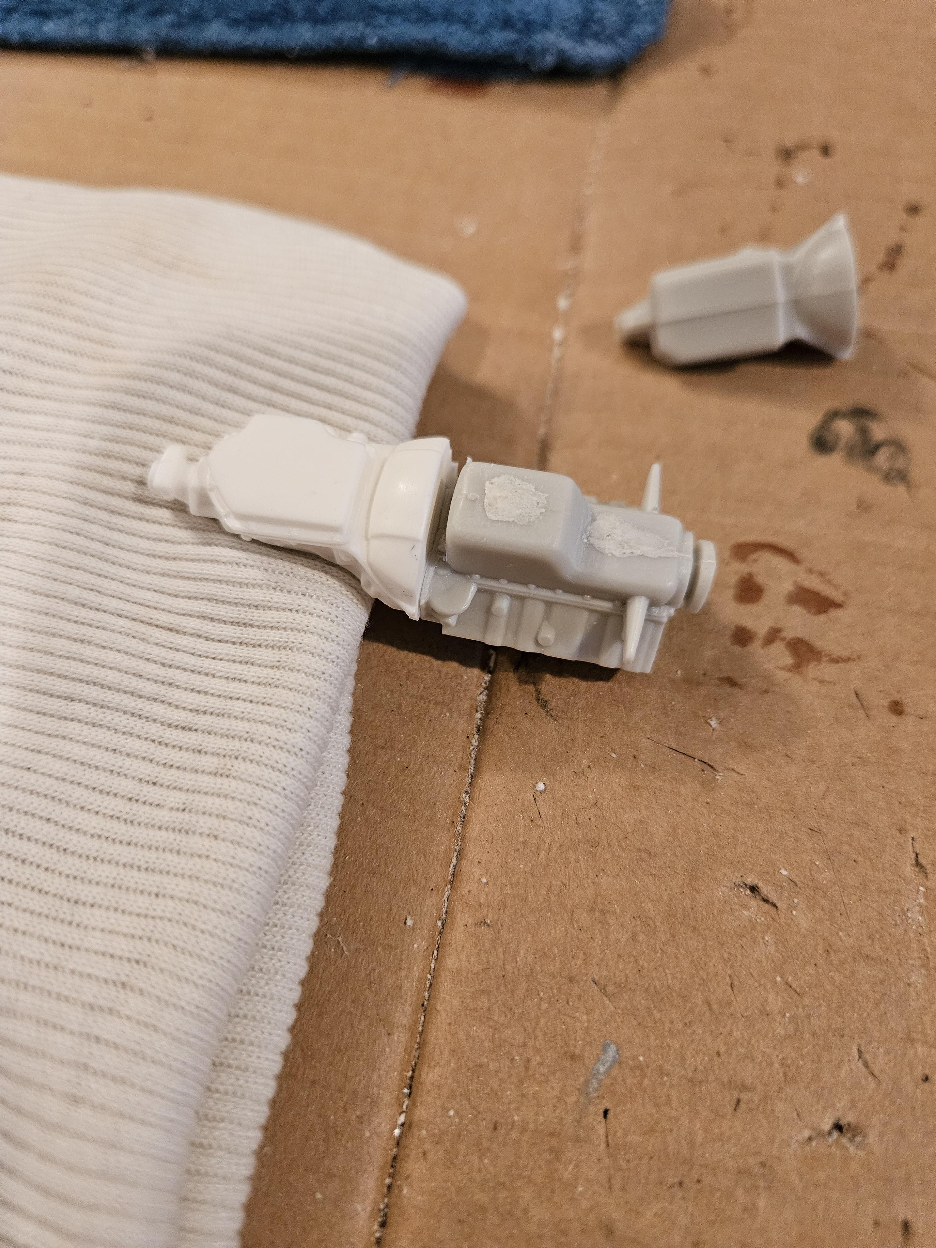

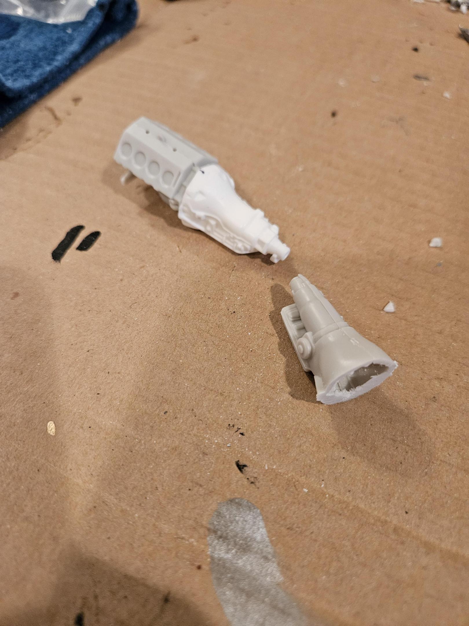

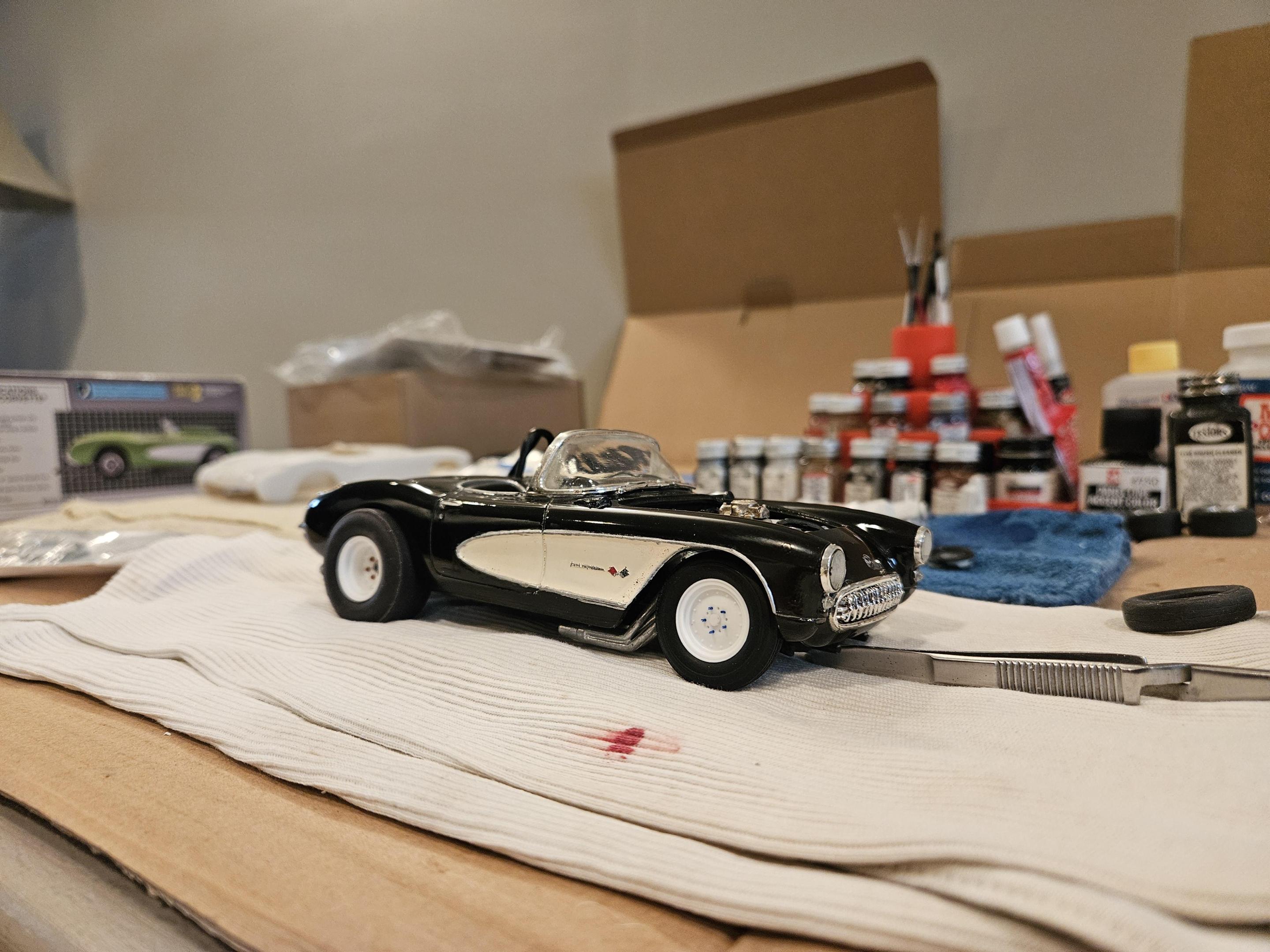

keviiin86 Posted July 16, 2024 Author Posted July 16, 2024 Got the trans cut off and put on a resin th400..also played around with some other front tires I have that are a bit taller and fit better with these wheels..I really tend to over think everything which really drags out the build lol..oh well baby steps. 5

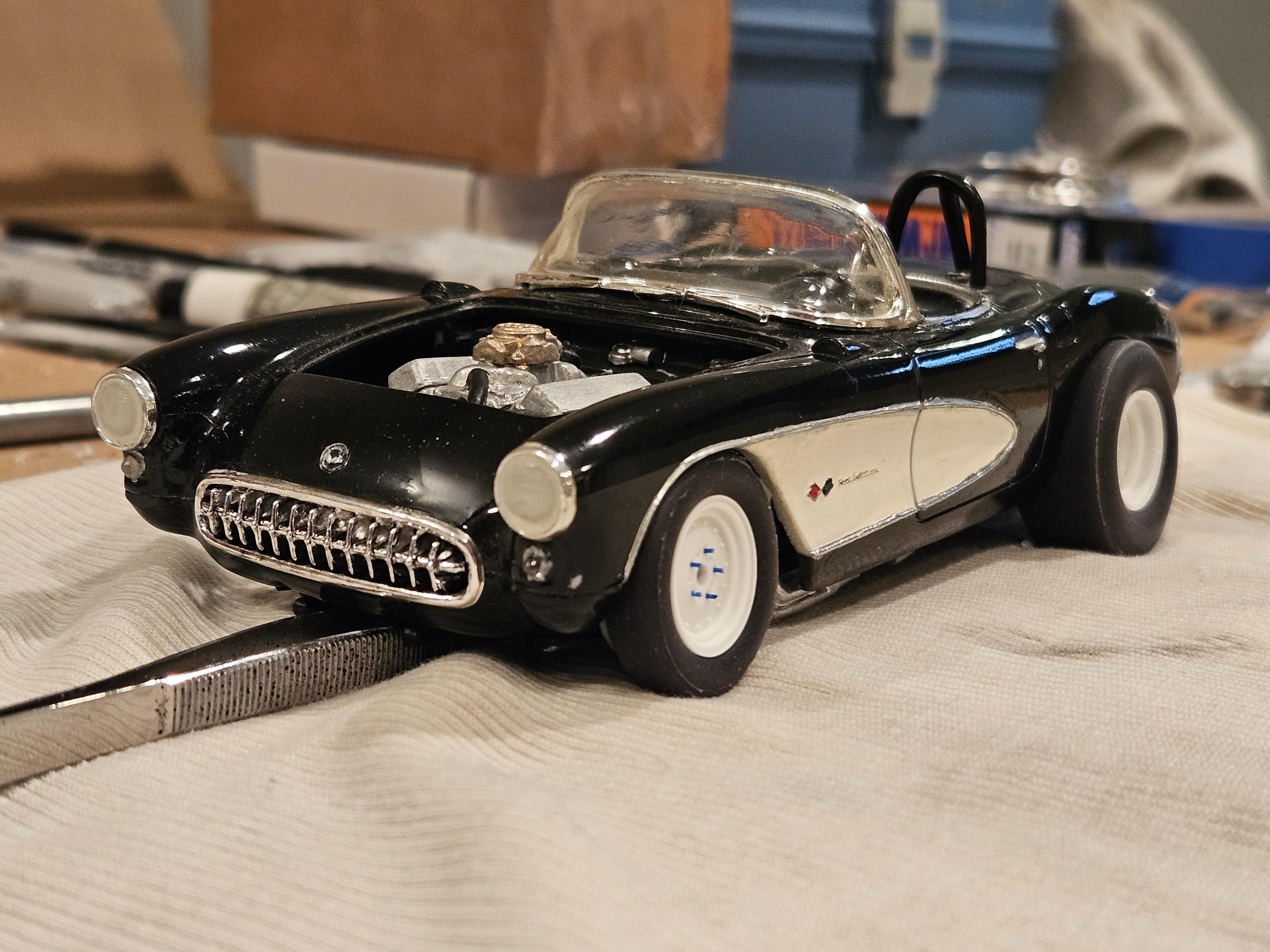

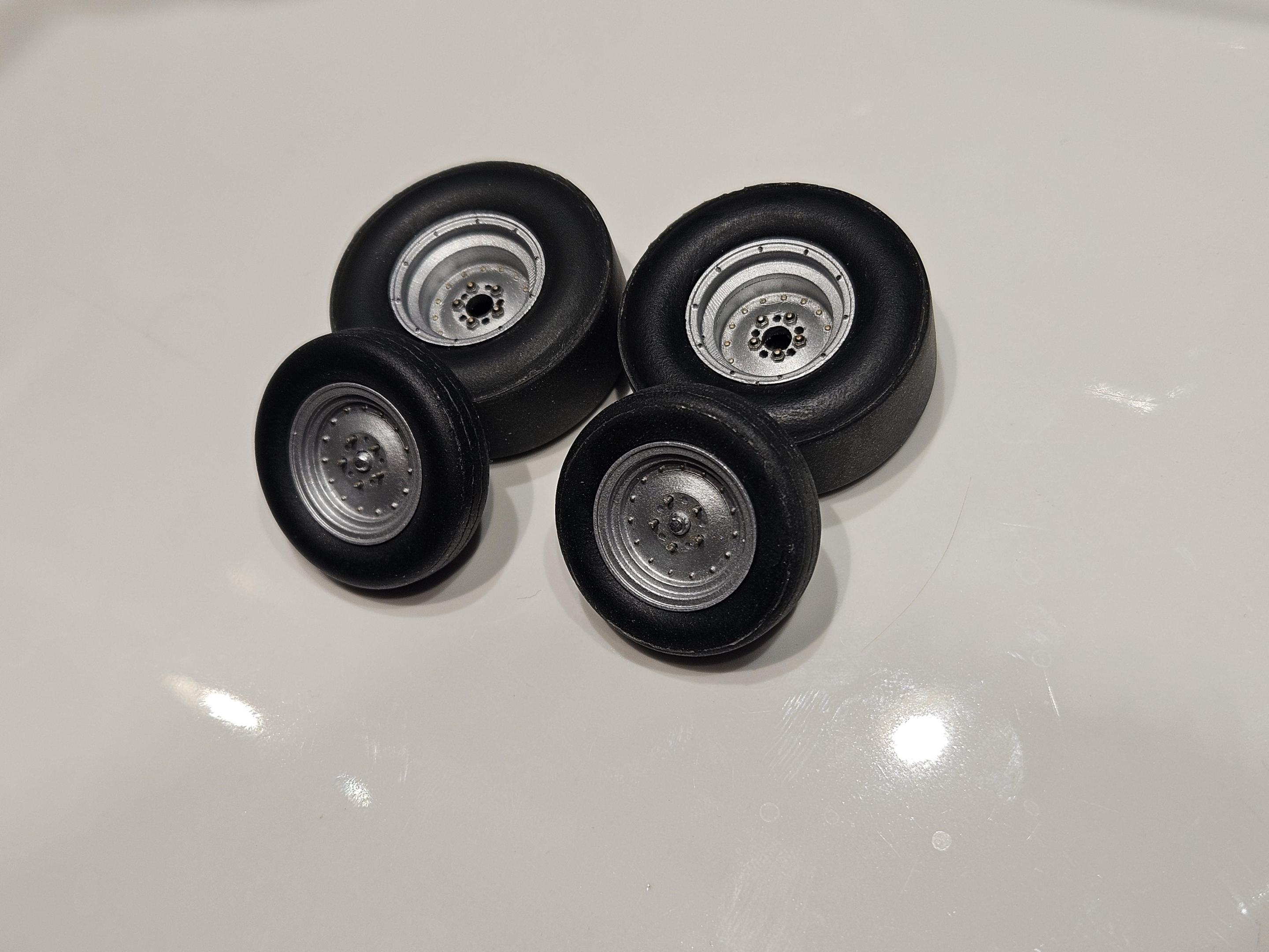

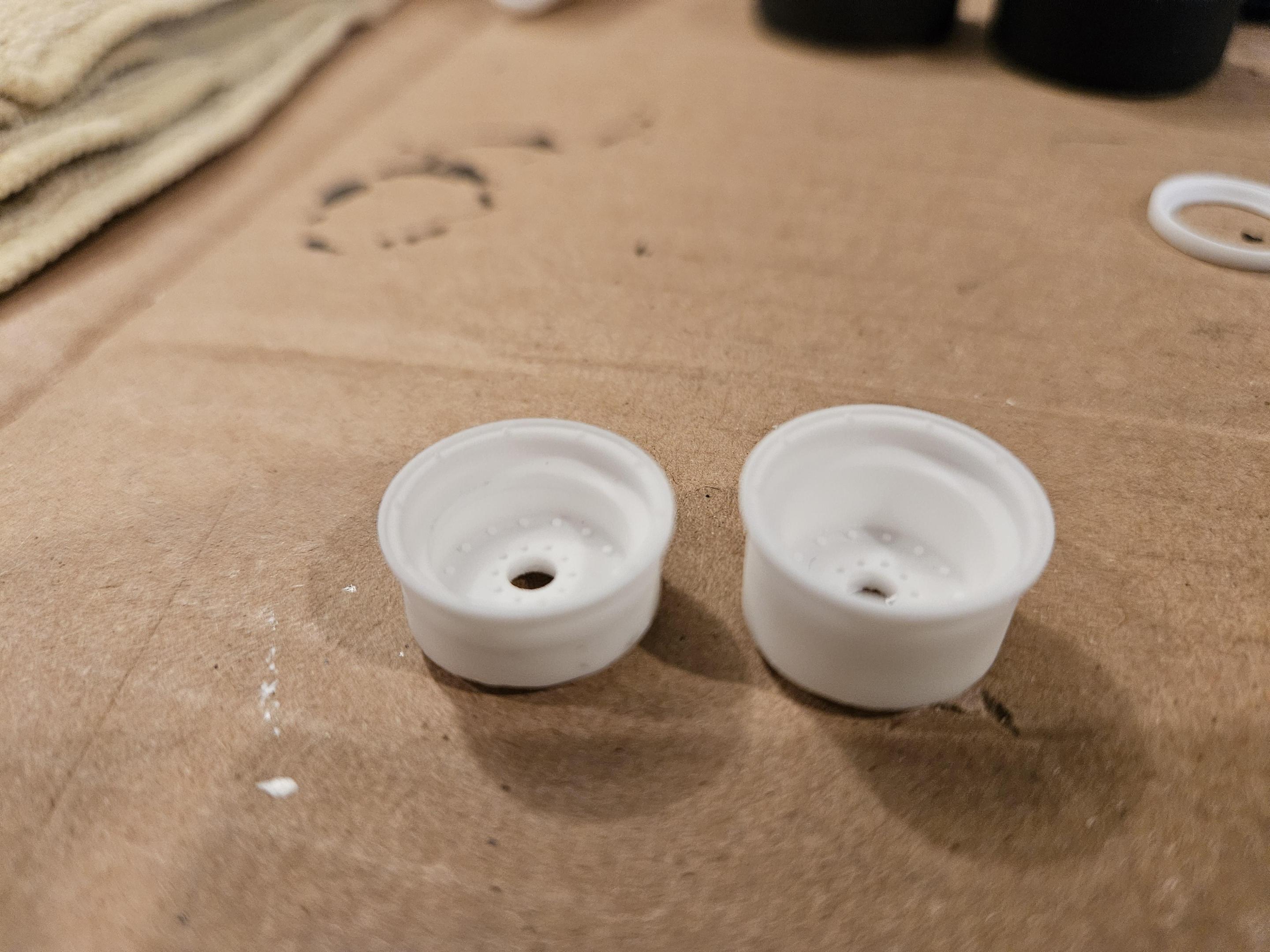

keviiin86 Posted July 30, 2024 Author Posted July 30, 2024 Painted the wheels with VHT high temp silver caliper paint, and detailed them a bit, pretty happy how they turned out. Then mocked up the car again and sat the grump lump scoop on the hood to see how it would look..so far I'm liking it. 1
Straightliner59 Posted July 30, 2024 Posted July 30, 2024 Nice job on the wheels! It looks so right for the time period! 1
FoMoCo66 Posted July 30, 2024 Posted July 30, 2024 Looks good, just so you know VHT caliper paint only fully cures when it gets hot. "Curing: VHT Brake Drum, Caliper and Rotor Paint will dry to the touch in 15 to 30 minutes depending on humidity. It will air dry overnight. The paint must then be cured. After the paint is dry to the touch, bake at 93°C for 20 minutes" (www.svt.performance.com).
keviiin86 Posted July 31, 2024 Author Posted July 31, 2024 7 hours ago, FoMoCo66 said: Looks good, just so you know VHT caliper paint only fully cures when it gets hot. "Curing: VHT Brake Drum, Caliper and Rotor Paint will dry to the touch in 15 to 30 minutes depending on humidity. It will air dry overnight. The paint must then be cured. After the paint is dry to the touch, bake at 93°C for 20 minutes" (www.svt.performance.com). Eh not worried about it, I've read some posts about how it will chip easily from metal if not cured fully..but these won't be handled much at all. This stuff dries almost immediately..it was dry to the touch within a minute probably. I did a couple thin coats.

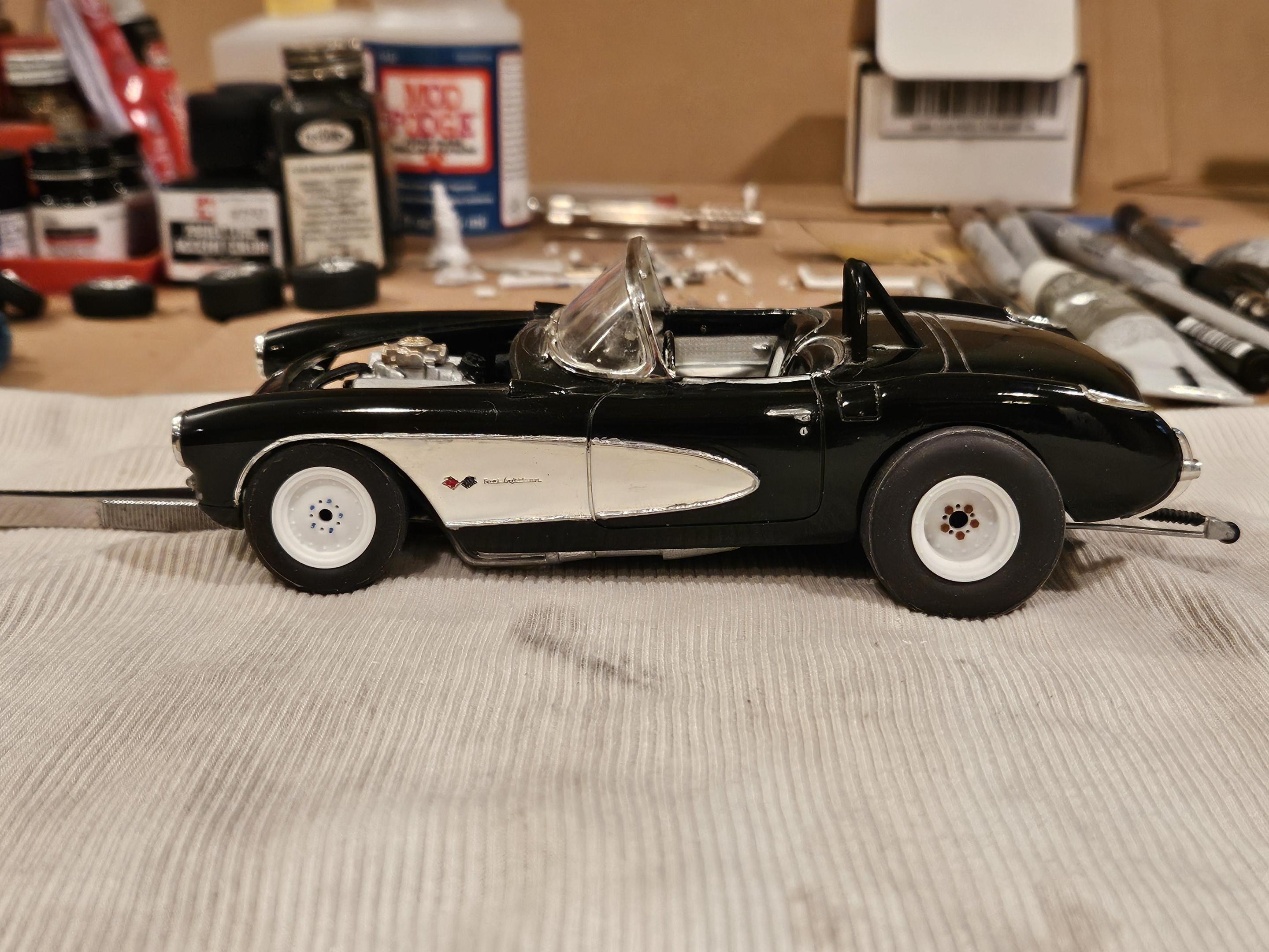

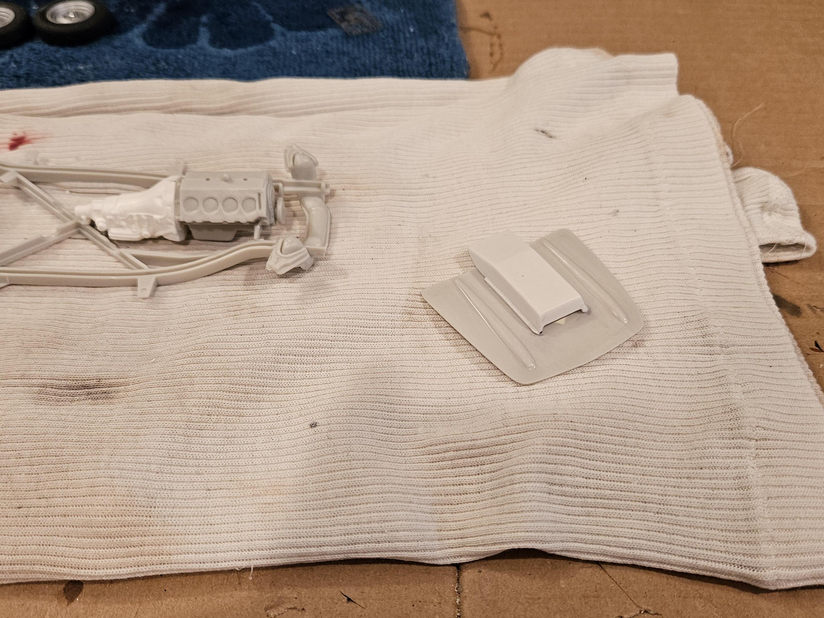

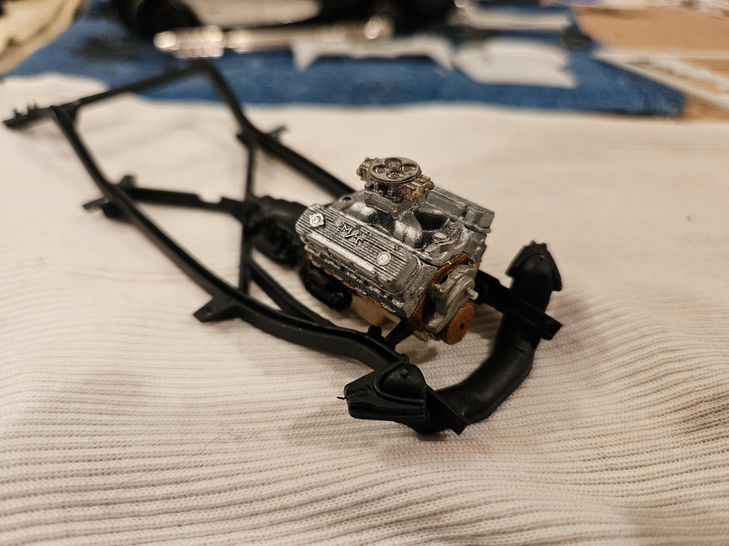

keviiin86 Posted August 23, 2024 Author Posted August 23, 2024 (edited) After looking at the old completed model I realized the engine seems to sit way too far forward..in 1:1 scale it would be about 8-10" probably from the firewall to the back of the block which just looks goofy to me. So I added some mounts to move the engine back closer to the firewall. Also attached the scoop and did some seam filling on the body..about ready for primer. Edited August 23, 2024 by keviiin86
Ace-Garageguy Posted August 23, 2024 Posted August 23, 2024 Really liking this one. The nose-down big-slick look screams "wicked fast", and the wheels are the perfect choice. 2

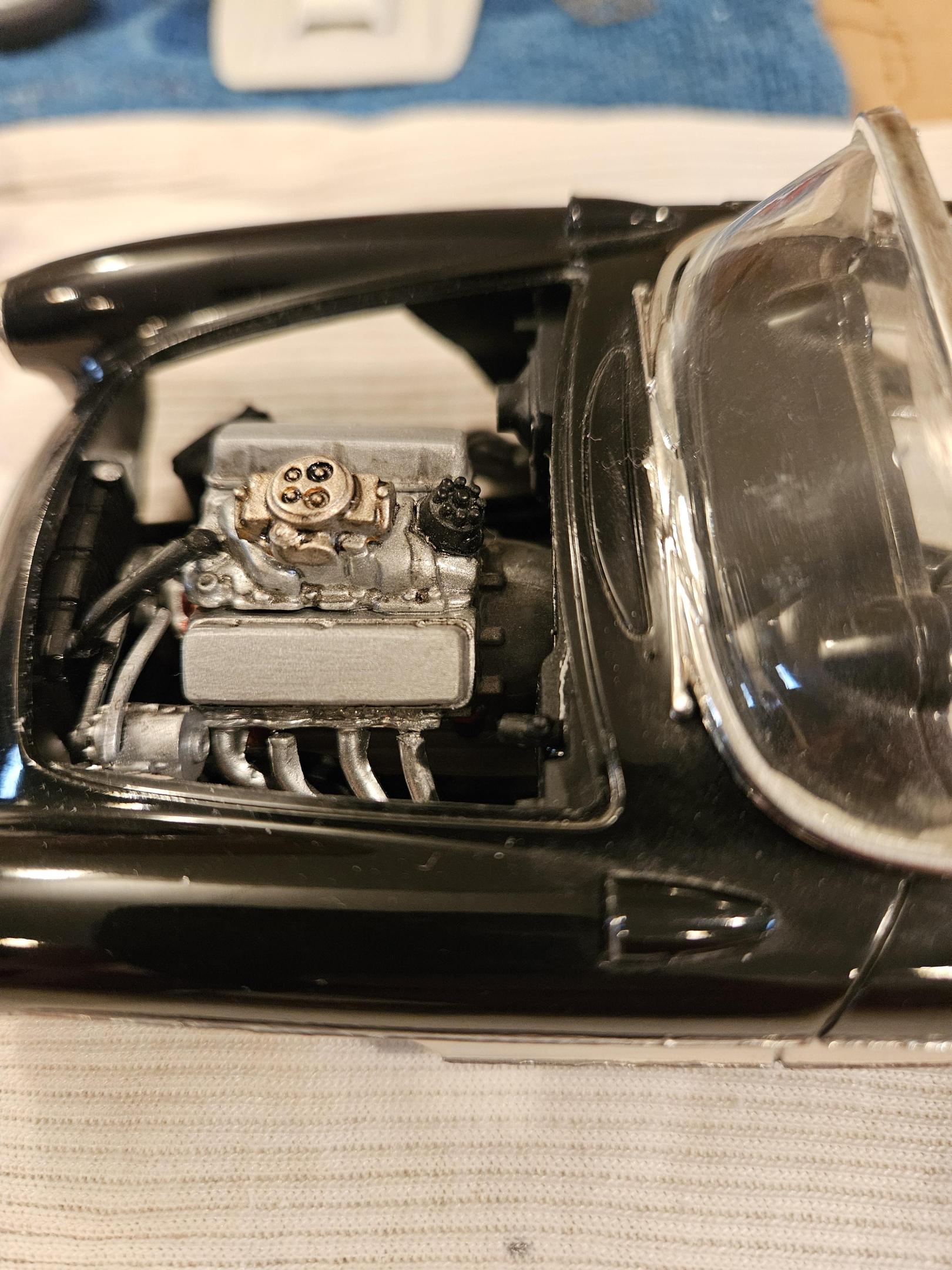

keviiin86 Posted August 27, 2024 Author Posted August 27, 2024 Got the engine painted and mostly put together, haven't decided if I'll use this carb or maybe a dominator. 1

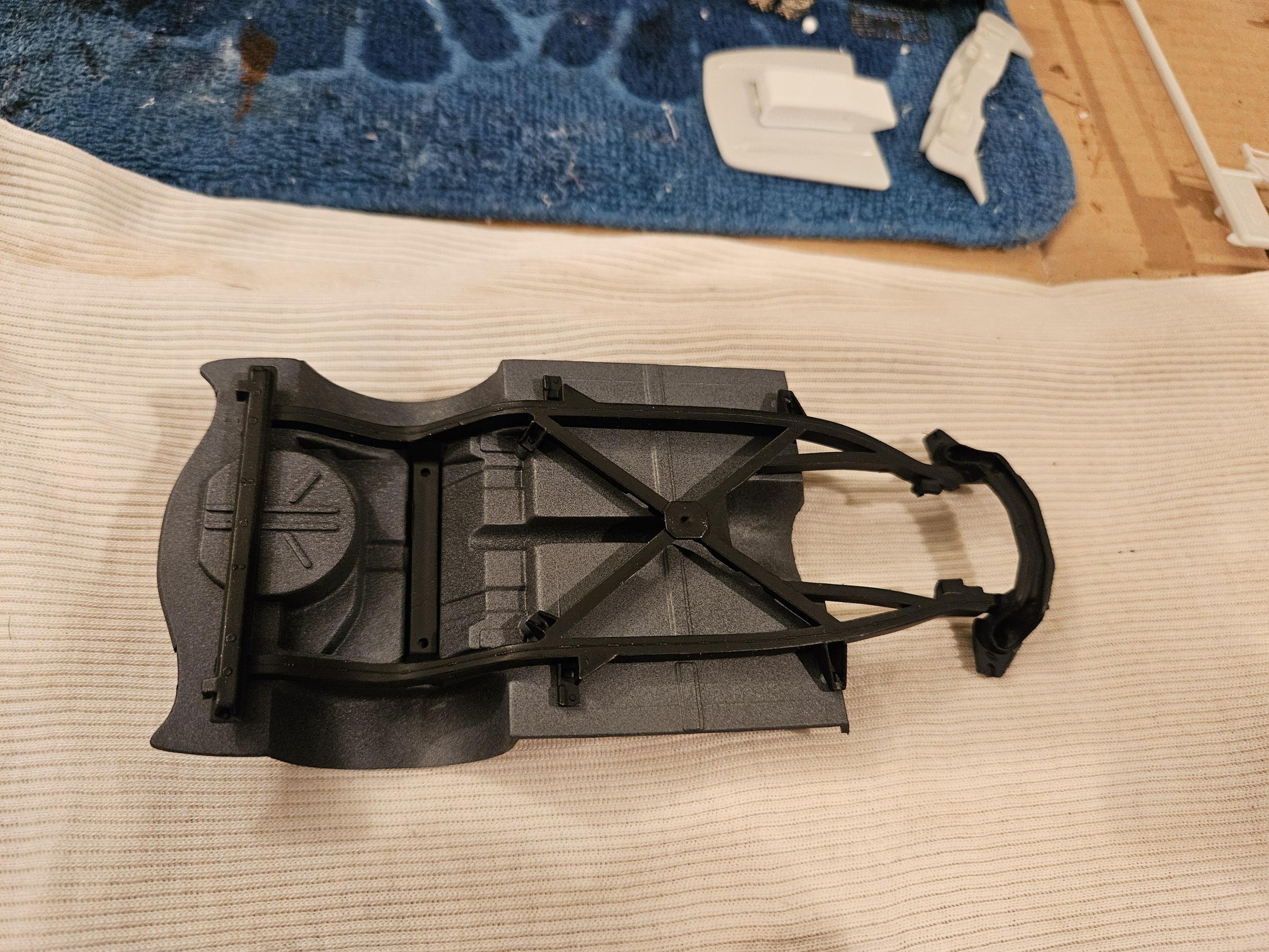

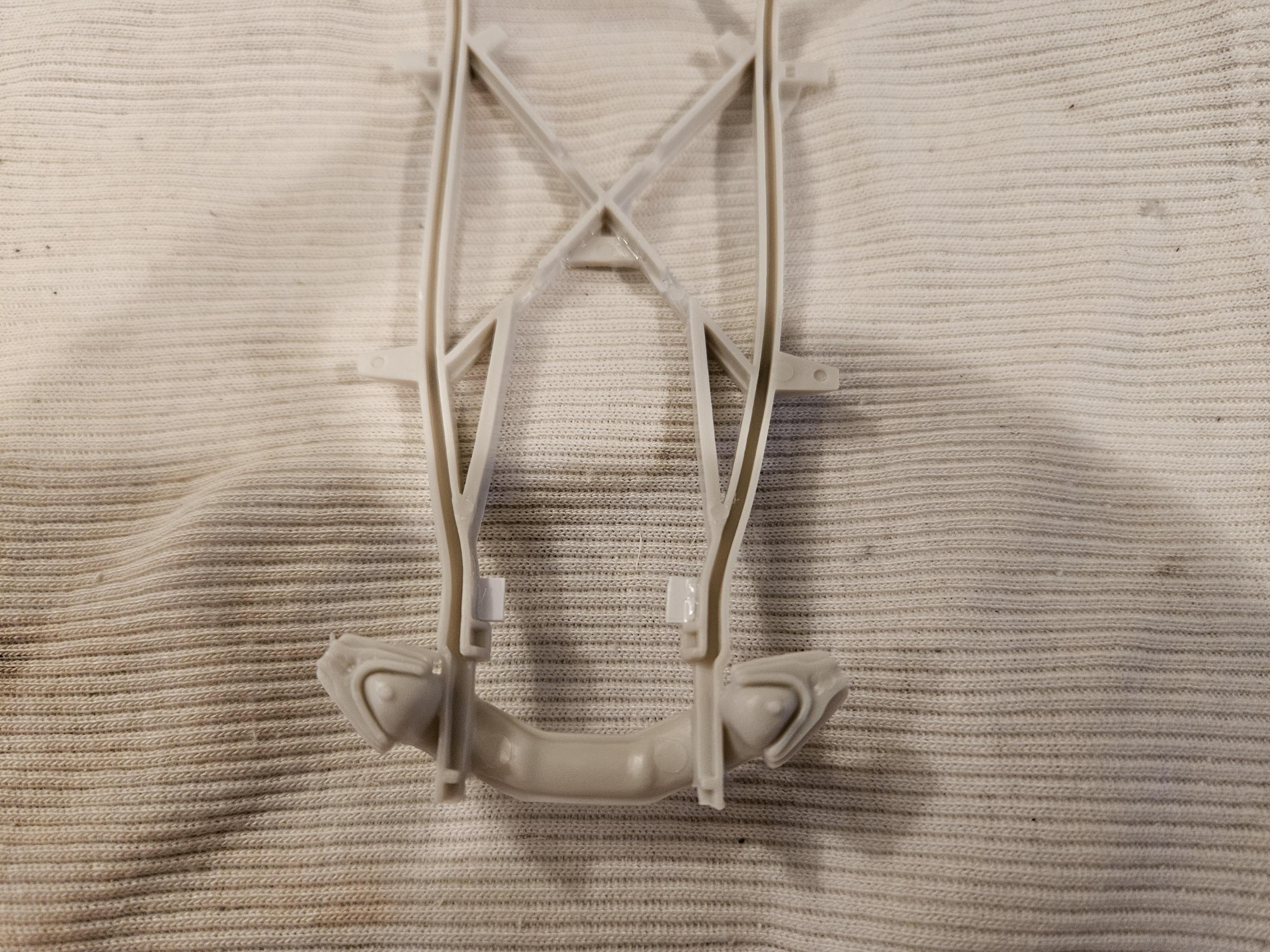

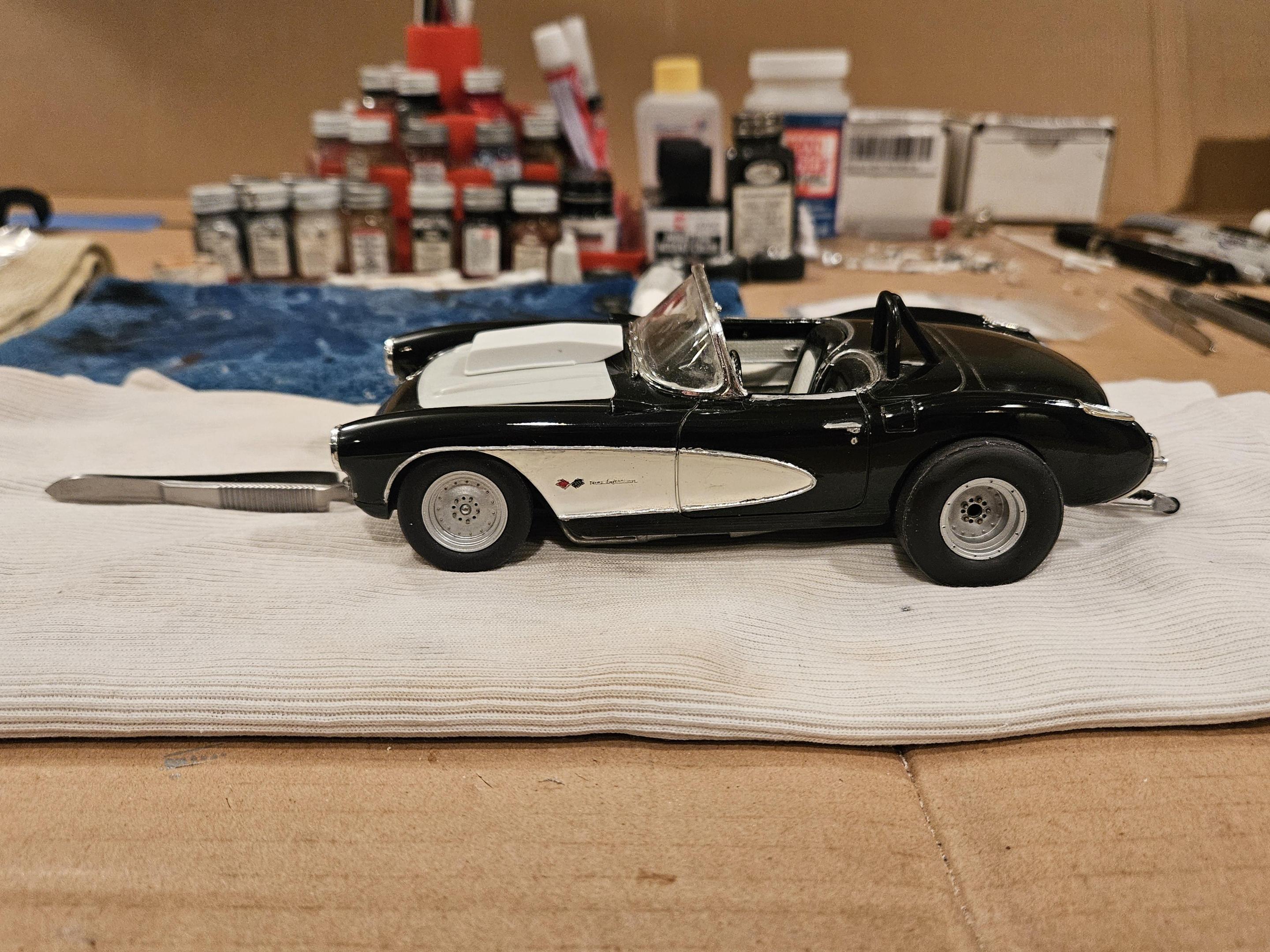

keviiin86 Posted August 30, 2024 Author Posted August 30, 2024 Little more progress, painted the chassis and floor pan. Also put together a resin/photo etched dominator from futur attraction and painted it..I think the dominator suits the engine better.
Len Woodruff Posted August 30, 2024 Posted August 30, 2024 Nice start. What color did you paint the floor boards? 1
keviiin86 Posted August 30, 2024 Author Posted August 30, 2024 32 minutes ago, Len Woodruff said: Nice start. What color did you paint the floor boards? Thanks, I painted it flat black then misted some gray primer over it.
