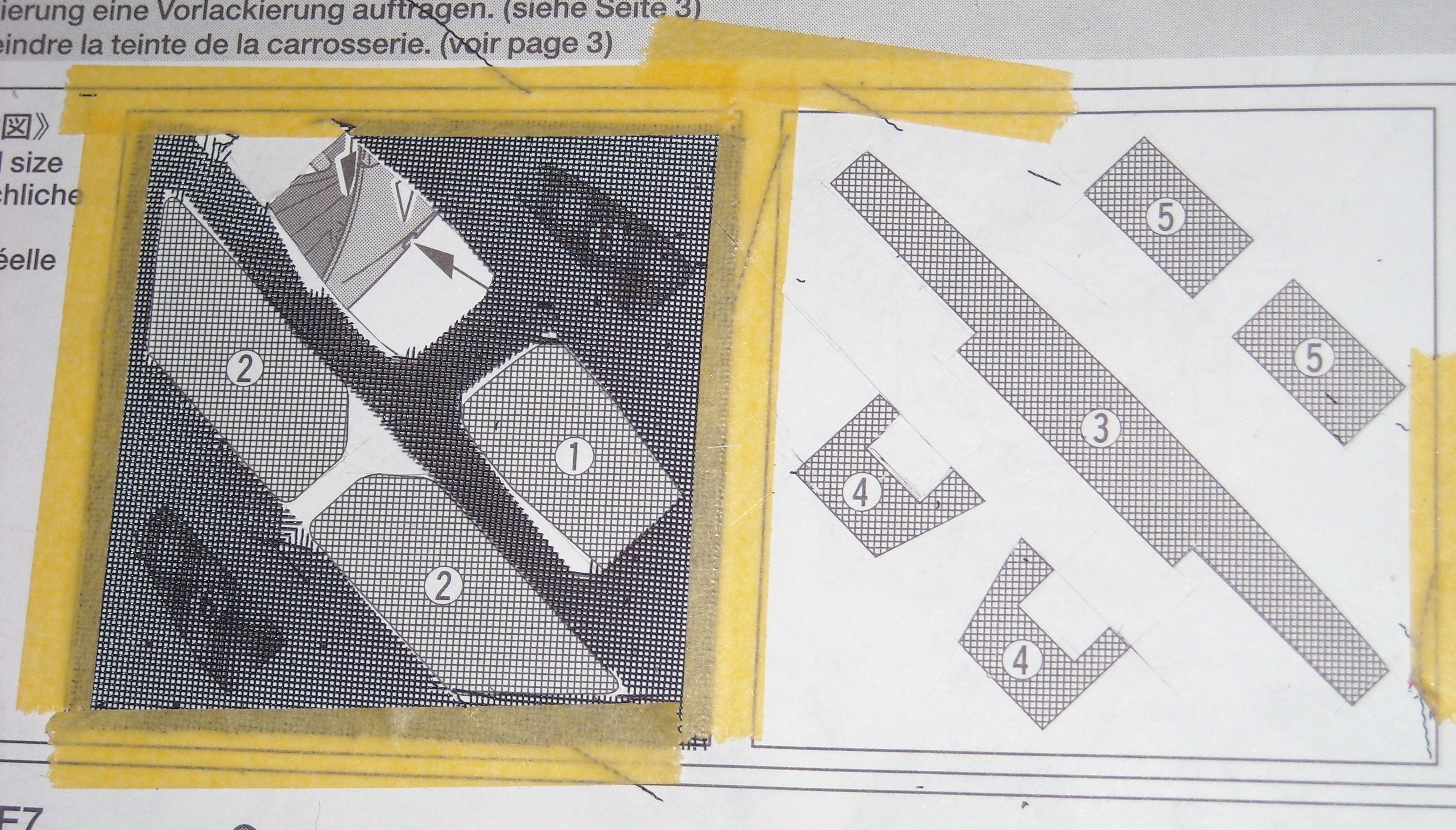

Kit Basher Posted June 27, 2024 Author Posted June 27, 2024 Found some time, so here's the photo of what I'm doing. As you can see, I have to cut diagonally across the mesh. You can also see my attempts haven't been terribly accurate. Thanks for all the input so far!

Kit Basher Posted June 28, 2024 Author Posted June 28, 2024 (edited) 23 hours ago, NOBLNG said: Could you transfer the pattern to some wide masking tape and use the tape itself as the pattern? The tape may help the mesh to keep its shape while trimming. I usually photo copy the pattern before cutting it out so that I have spares. This method worked really well. I stuck Tamiya tape to the instructions, traced the outline of the pattern onto the tape, put the tape on the mesh, and cut it out with scissors. Easy and great results. Thanks, Greg! And thanks to all for your suggestions! Edited June 28, 2024 by Kit Basher
