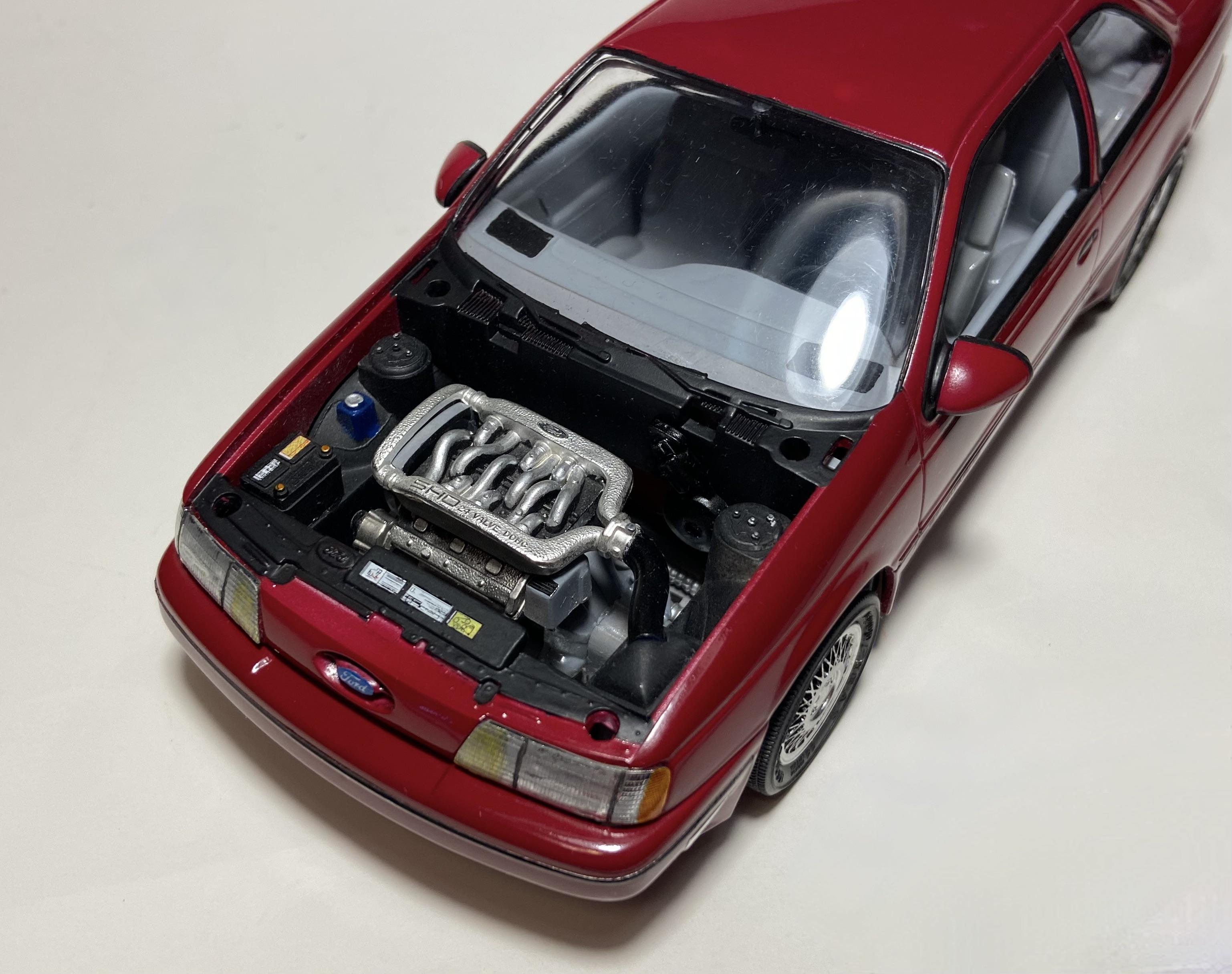

This is a rebuild of a car that I did when the kit and the car were both new. The back story is in the build thread. Taurus SHO converted to a 2 door coupe by rescribing the door lines, moving the B pillars, and moving the rear portion of the roof forward to shorten the roof and lengthen the trunk. Basically, the bondo shrunk, I stripped it to redo it, and eventually did - 34 years later. Better late than never? In my defense, it came out a little better this time. Paint is Scalefinishes 2F Currant Red, a factory color on the SHO. The black strip on the bumpers and side trim is black Bare Metal Foil - hateful stuff to work with - the chrome is far easier -  but it worked well here. These models sit high when built out of the box, so I lowered the front and rear suspension to a stock ride height. Interior tub is shortened to match the new shorter roof, with door panels altered to a 2 door configuration. Headliner and 1/4 windows added, these were never in the original build. The interior was one shade of primer grey, so I added a couple more shades and gloss here and there, and did the carpet in gray flocking to liven it up a bit. The intake tube from air box to throttle body was lost over the years, so I made a new one from heat bent sprue. Engine bay decals added. The rest is out of the box.
Thanks for lookin'.

Great looking body changes. Might have given the Thunderbird a little inner company competition if it went into production. Like the paint color and finish.
Great job. This car was so underrated. I used to work on these at the ford dealer. The engine was amazing. When I test drove them , it was just about as fast as the 5.0 mustang. But smooth. I thought this engine would be fun in the focus. Great job sir.
