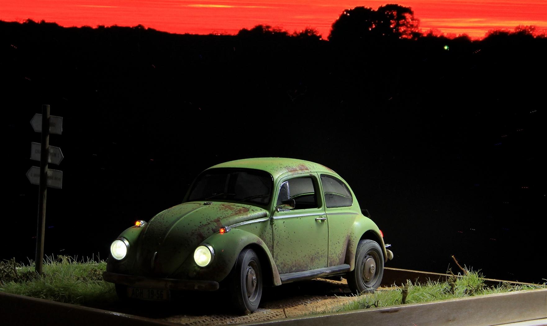

happy grumpy Posted July 11, 2024 Posted July 11, 2024 I use micro leds , you can have them cheap on Amazon and they are pre wired with resistor. I had no problem fitting them in my VW. 1
