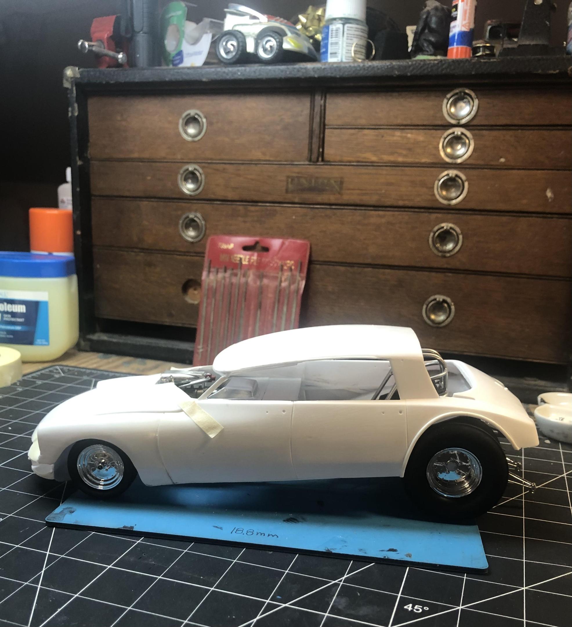

Holeinthehead2 Posted July 13, 2024 Posted July 13, 2024 Doing a car that will require filling door seams etc. I used Tamiya putty a little. Appreciate any info.
