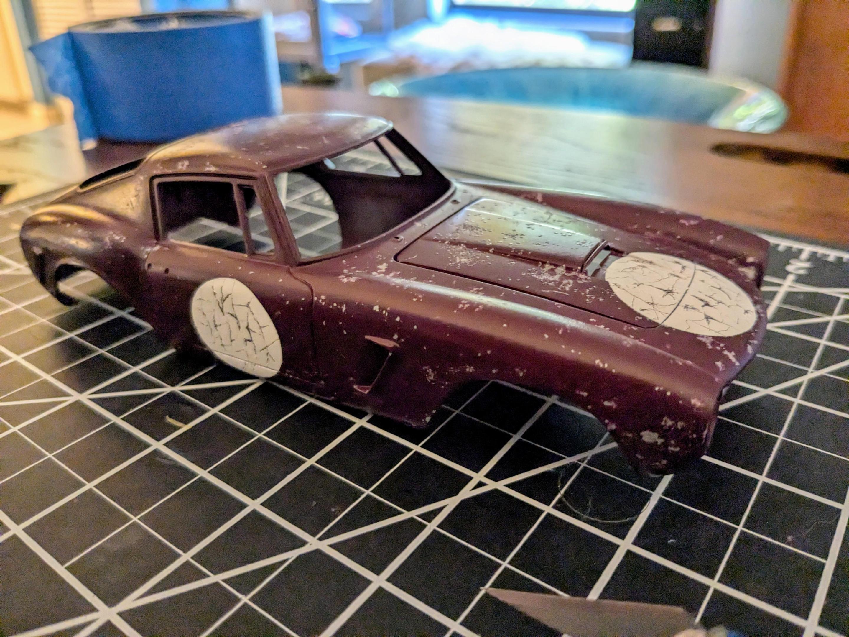

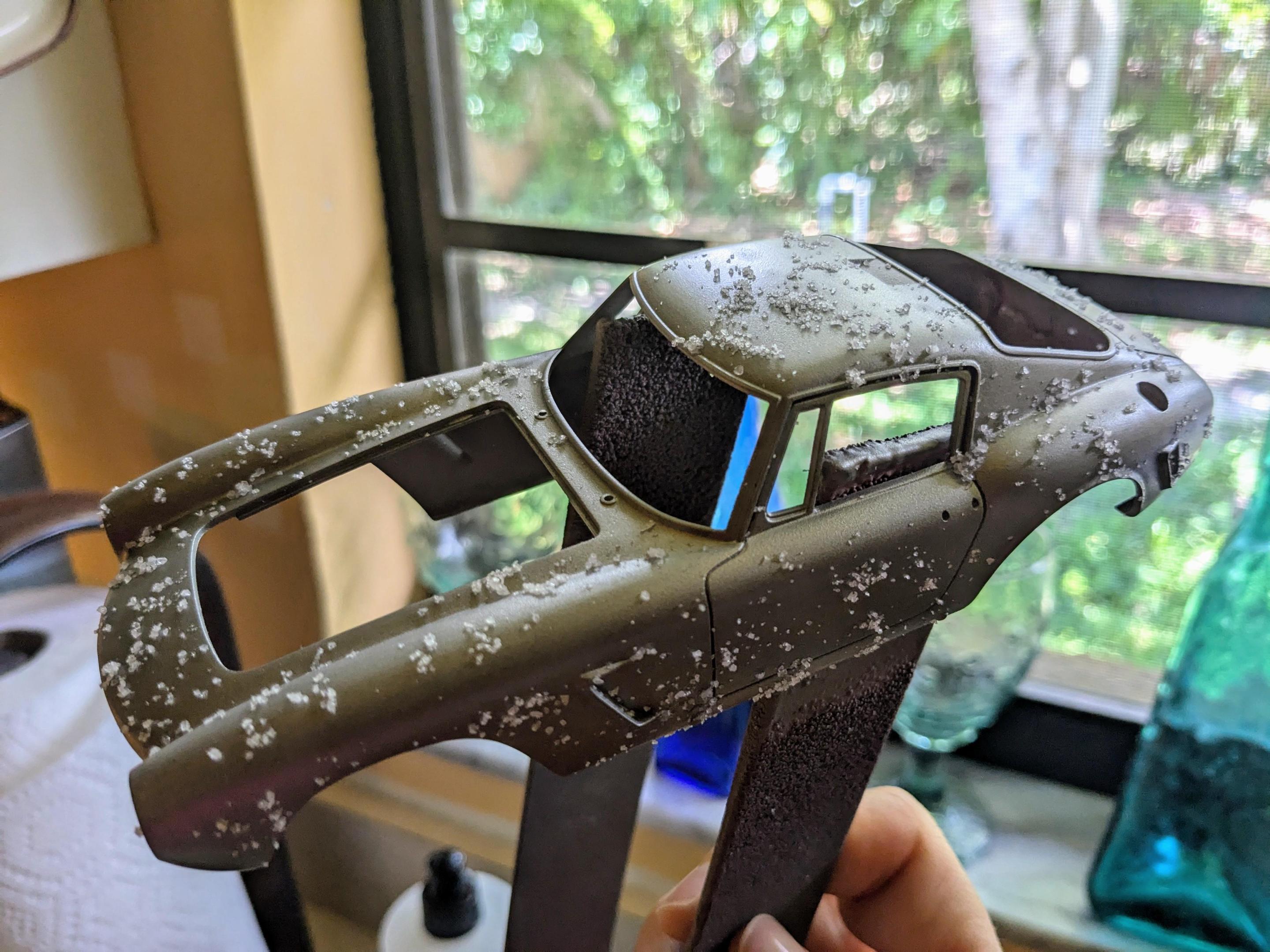

First pics show the salt weathering going on. A base coat of Vallejo flat aluminum has already been applied. Areas of the bodywork are then moistened with water and a little dish detergent and salt is sprinkled onto the lightly moistened surface. Once everything is dry you're ready to paint.

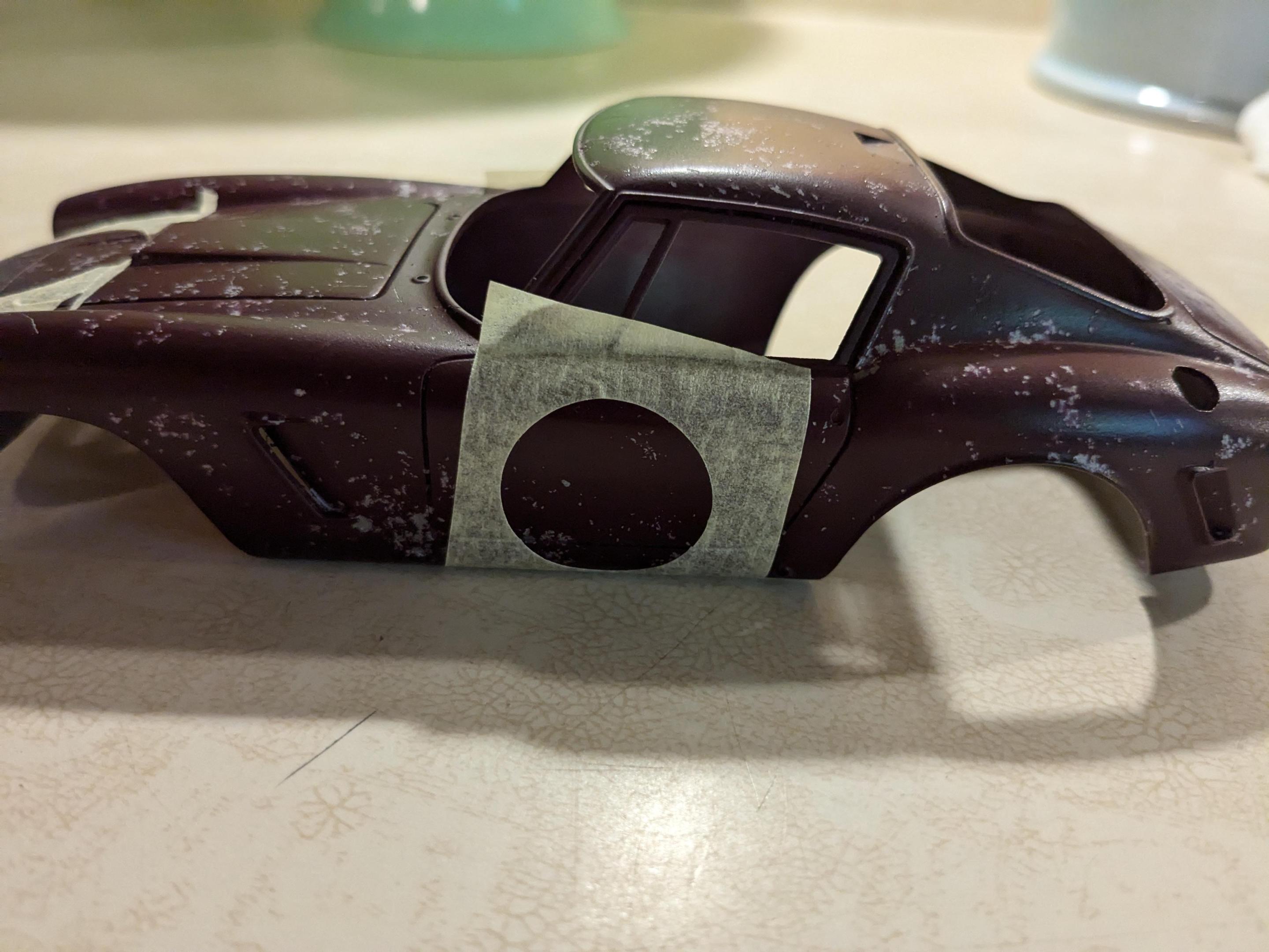

Next apply your top coat, in this case Tamiya Maroon lacquer. Once the lacquer has dried you scrub the salt off the body to expose the layer underneath.

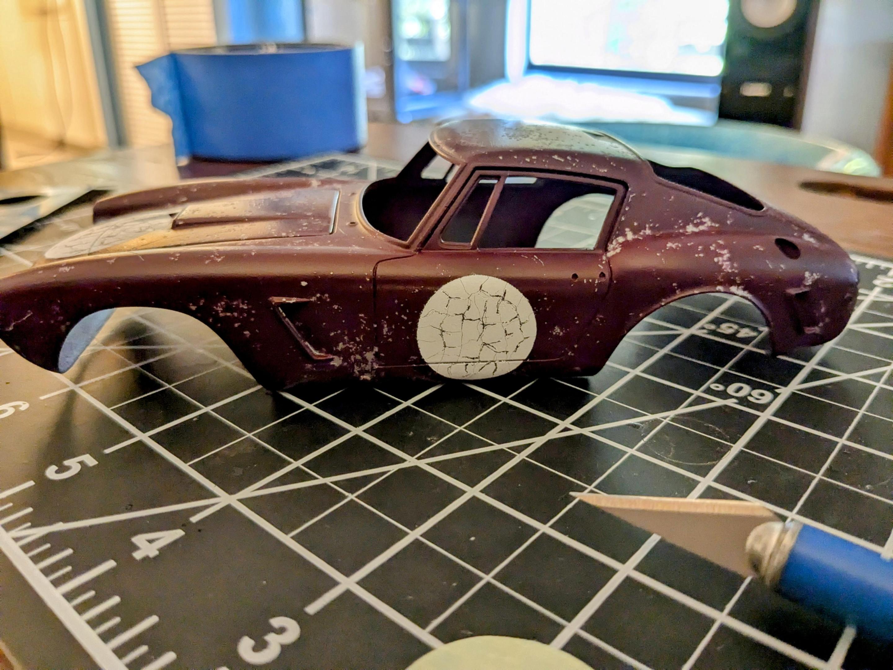

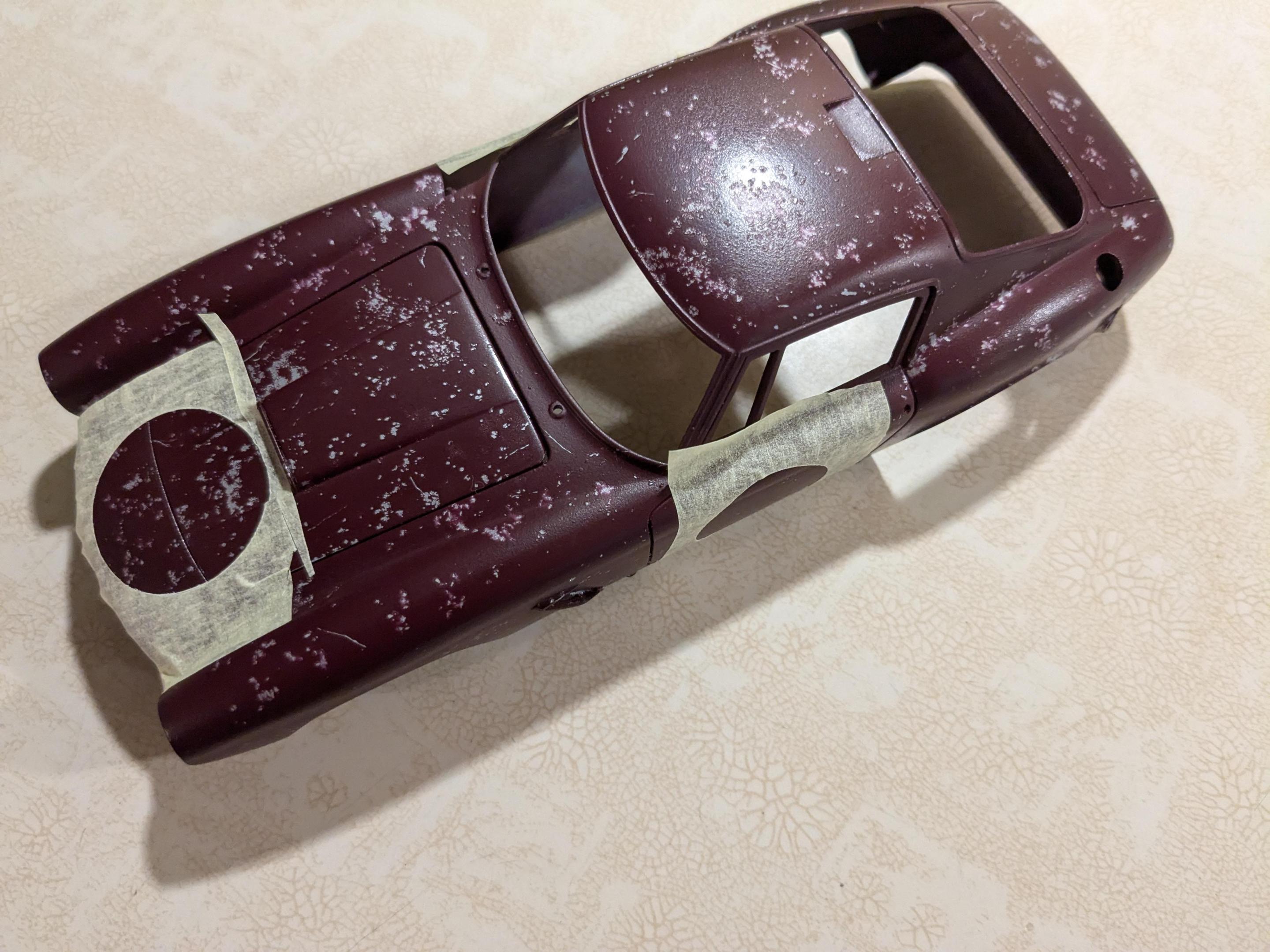

After a coat of flat clear and a polish with Meguiar's Ultimate Polish to bring a low gloss back, I used my trusty Amazon circle cutter to mask the roundels.
PXL_20240727_123609262.thumb.jpg.a0772366a08b05303c6e58fe7b419bc9.jpgPXL_20240727_123255538.thumb.jpg.cf2c22c596be4c59a9bd09d19d82f377.jpgPXL_20240727_123308131.thumb.jpg.28edd9e815bc7dba90562fc778372a21.jpg

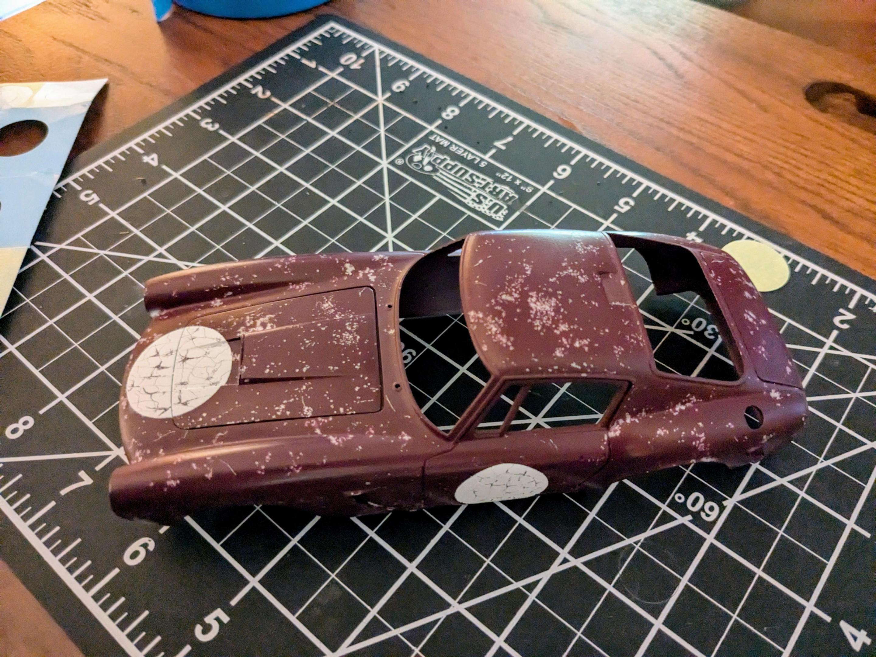

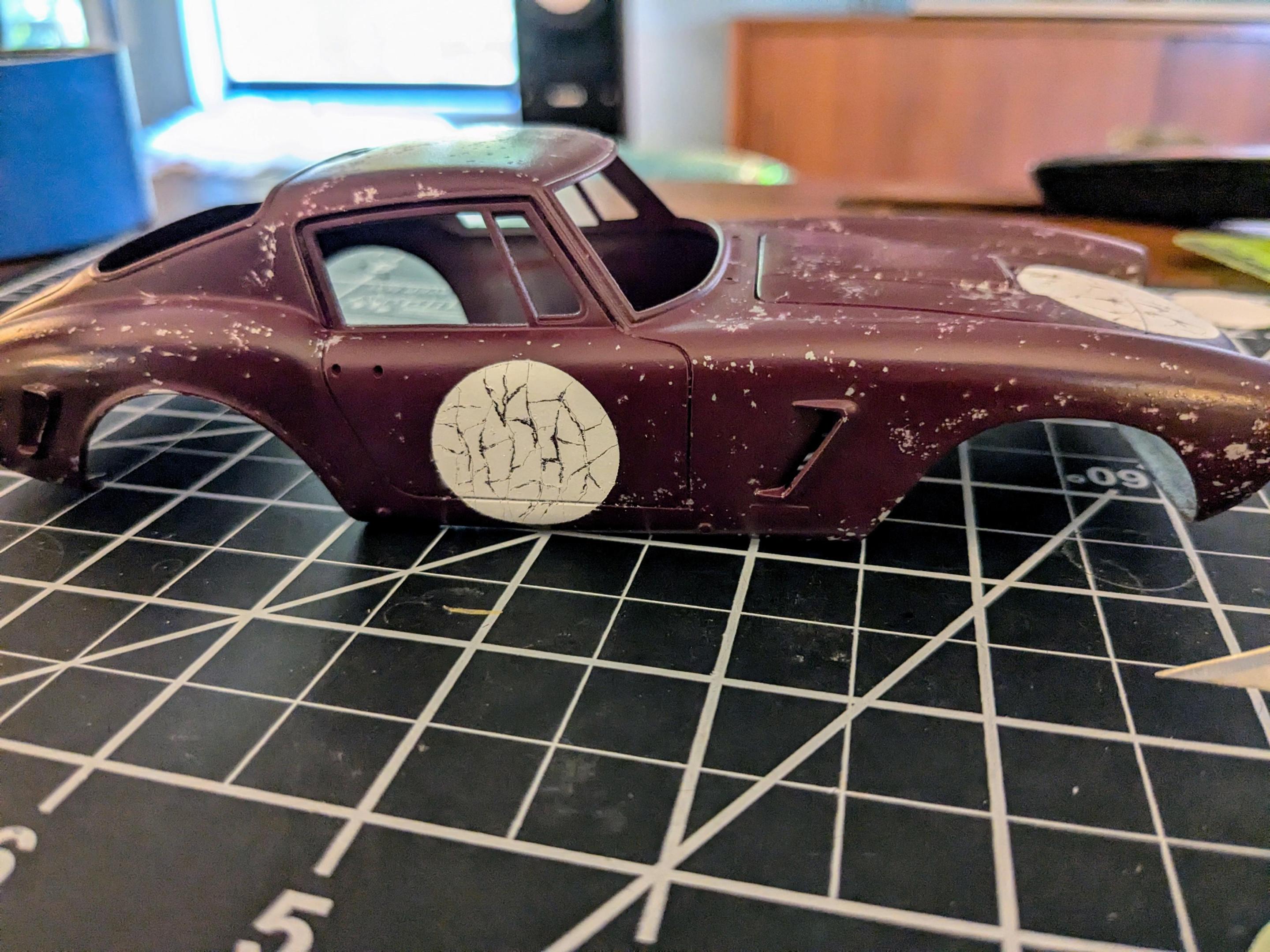

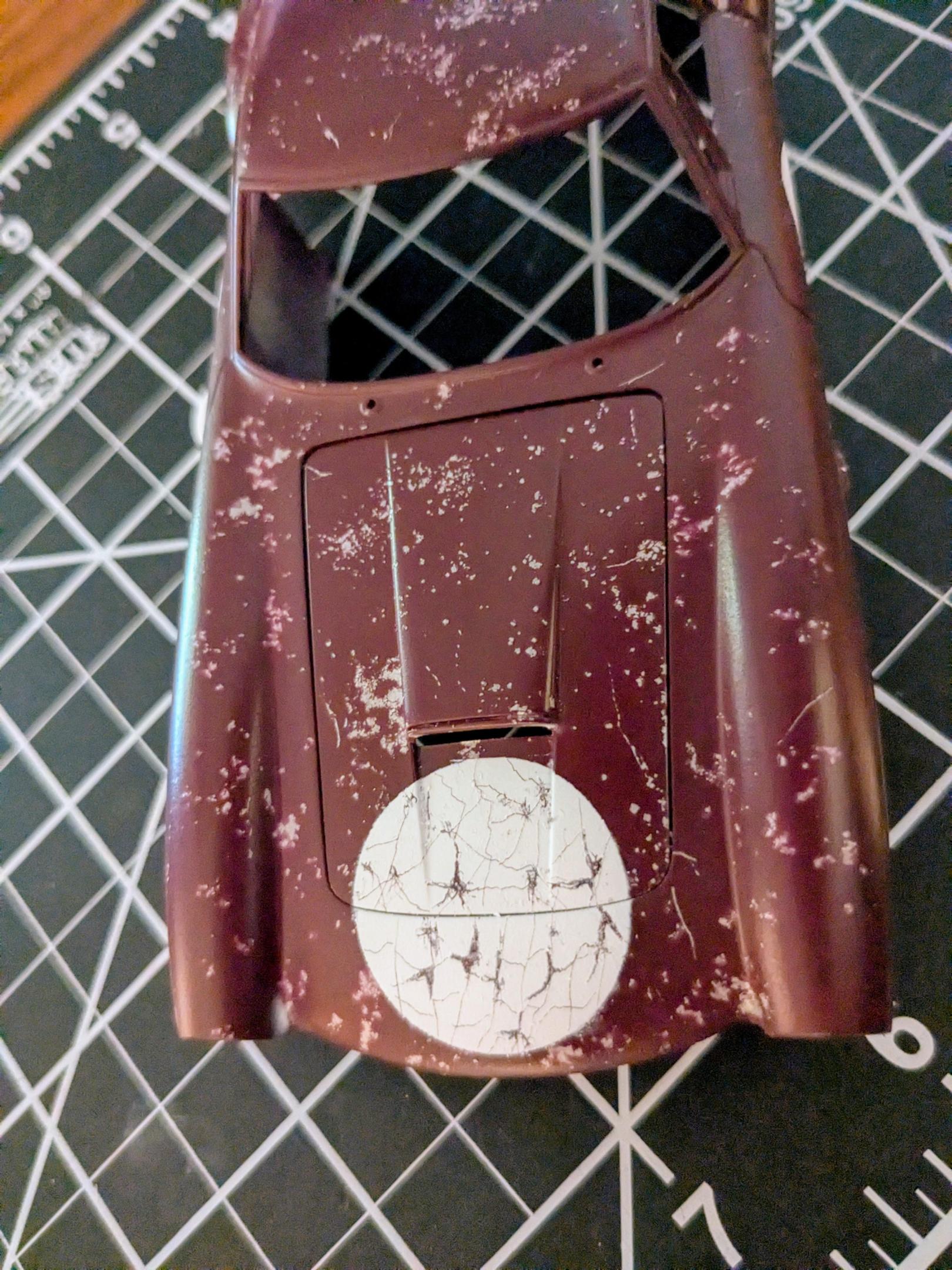

After painting the roundels with Vallejo flat white I used a scribing tool and a flat toothpick to add cracking to the paint.
PXL_20240727_133413019.thumb.jpg.f33b5a1648f4809fbe81047d008b623d.jpgPXL_20240727_1334218002.thumb.jpg.dd9404faa03b35720c331046d4066f9e.jpgPXL_20240727_133432705.thumb.jpg.016d54e97cf62c8ac67fbda8e31aac5e.jpgPXL_20240727_133408581.thumb.jpg.dc5ab1cc168e277f78381bb5b9363bb1.jpgPXL_20240727_133439167.thumb.jpg.fdb11f16cd983185df827b2c63ca1f96.jpg

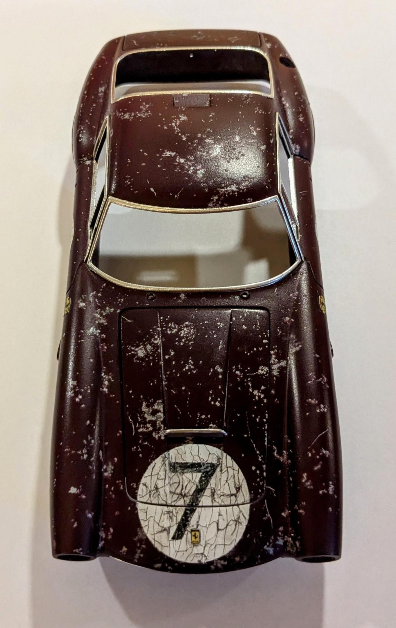

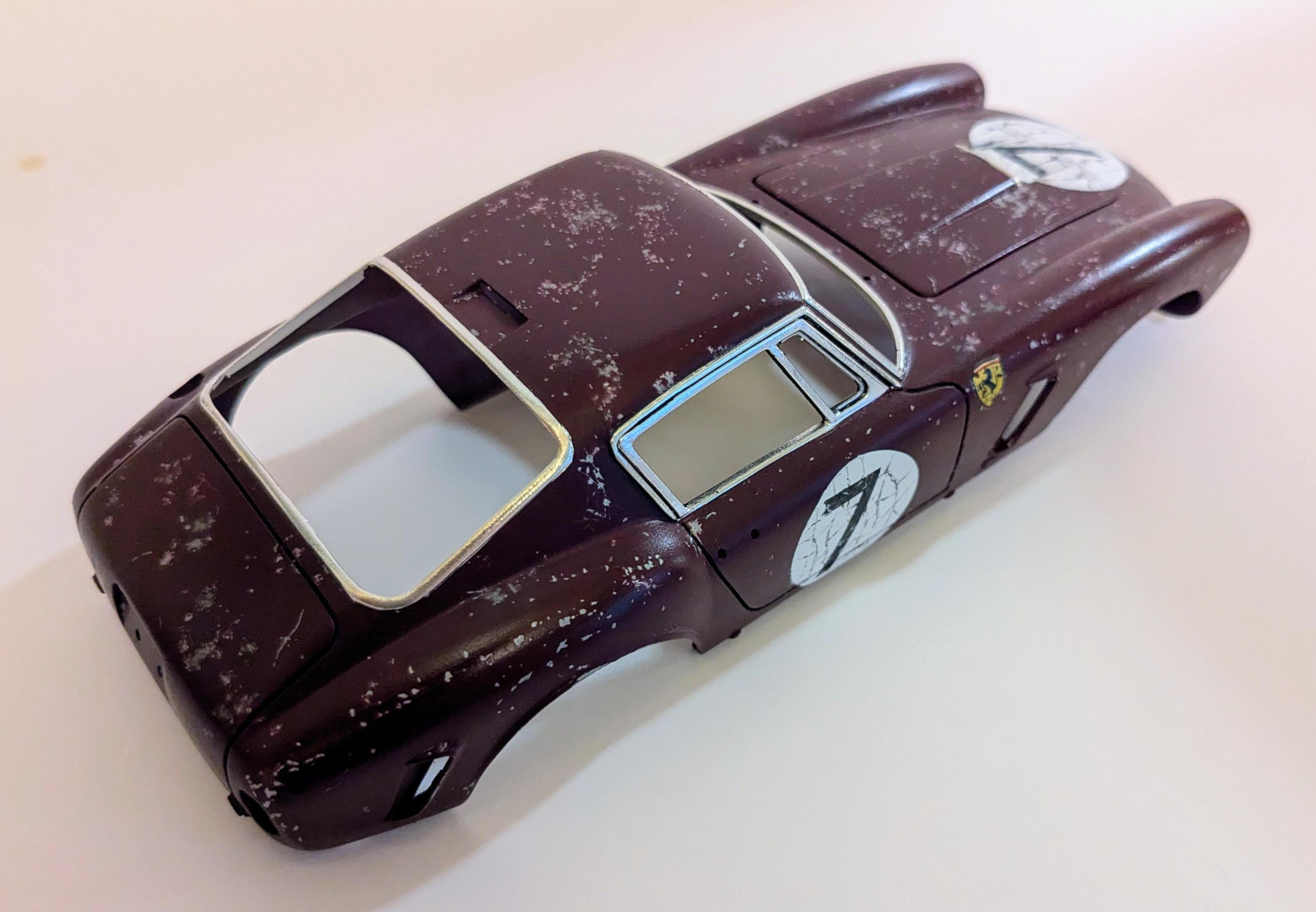

This is where it stands as of now, next I'm going to mask off and dry brush a nice easy number "7" in the roundels and foil the trim on the body. Once that's done it's time to crack on with the chassis and the beautiful Jack's Modeling 3D printed Borrani wheels!

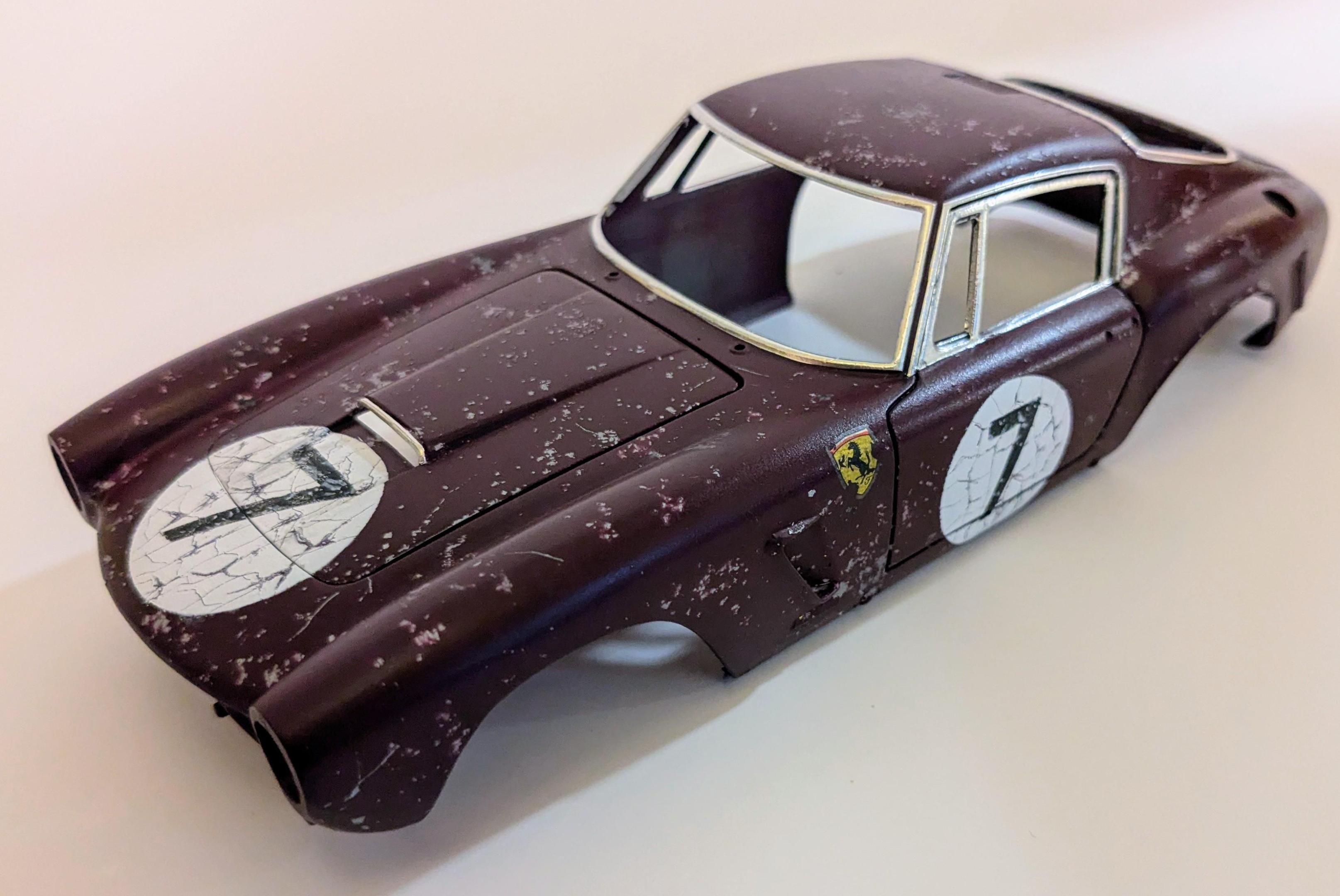

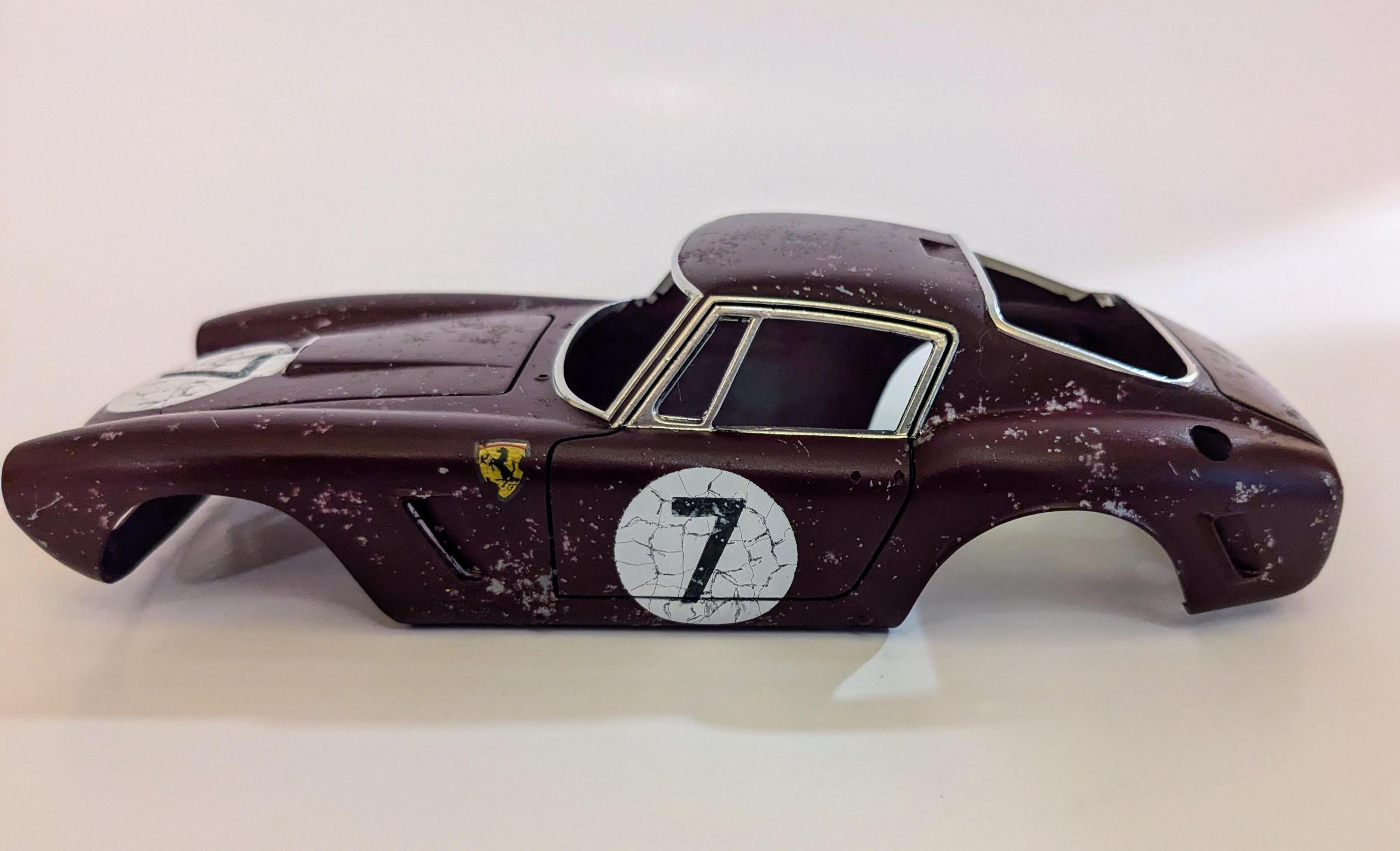

The numbers have been painted onto the roundels by dry brushing slightly thinned black acrylic for a patchy, faded look. I then added Cavallinos to the fenders. I applied BMF to the trim as well, which I'll dull slightly with a Vallejo wash before adding the glass. I'm starting to feel a bit better about the direction this build is taking now...PXL_20240728_223824351.thumb.jpg.38afcd02b518c062d24f60343d0cdd30.jpgPXL_20240728_223830967.thumb.jpg.bce15d681829387e06cfc94e7d7822d7.jpgPXL_20240728_223933717.jpg.a222259f4363ef2cb75b03a024cf2836.jpgPXL_20240728_223840056.jpg.3f37e3230bb20efa465f3ae5fbe62ab1.jpgPXL_20240728_223845518.thumb.jpg.251db1b1a91853684d4c36ec520a1932.jpgPXL_20240728_223915236.jpg.5c87e4e21f32aed80fad58569c1aedb3.jpg
  • Like 2
I am loving the idea behind this project, and it's looking fantastic. Very convincing aging of the finish. This is going to be cool.

Finally a few pics of the exterior with the roundels "dirtied up" a bit with Tamiya pastels. Also visible is a 3D Ferrari badge from Hobby Design. I think I just picked up the only set of these still available in the universe.

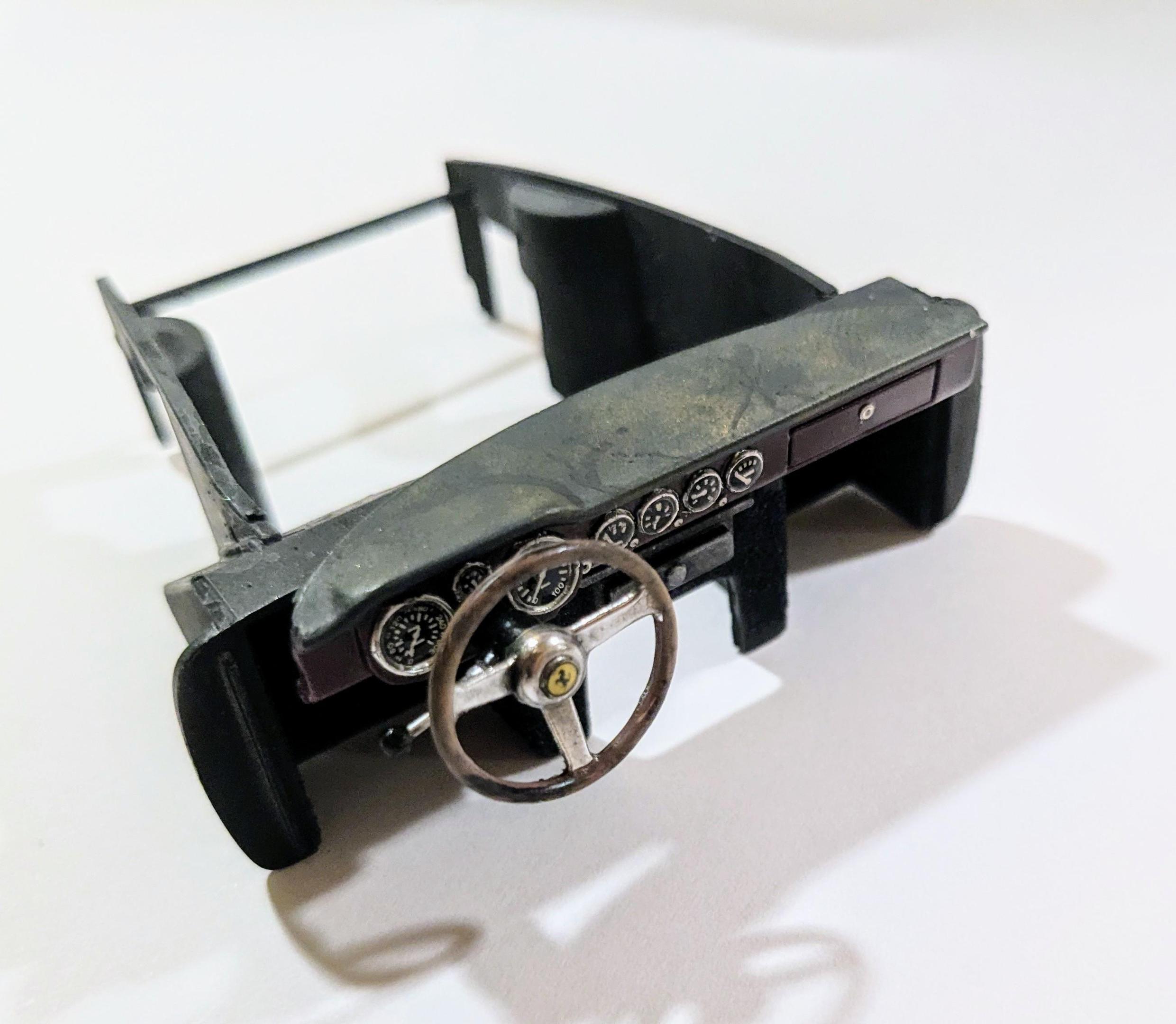

Dash foiled, painted and decaled. Gauge lenses are Bondic UV resin.

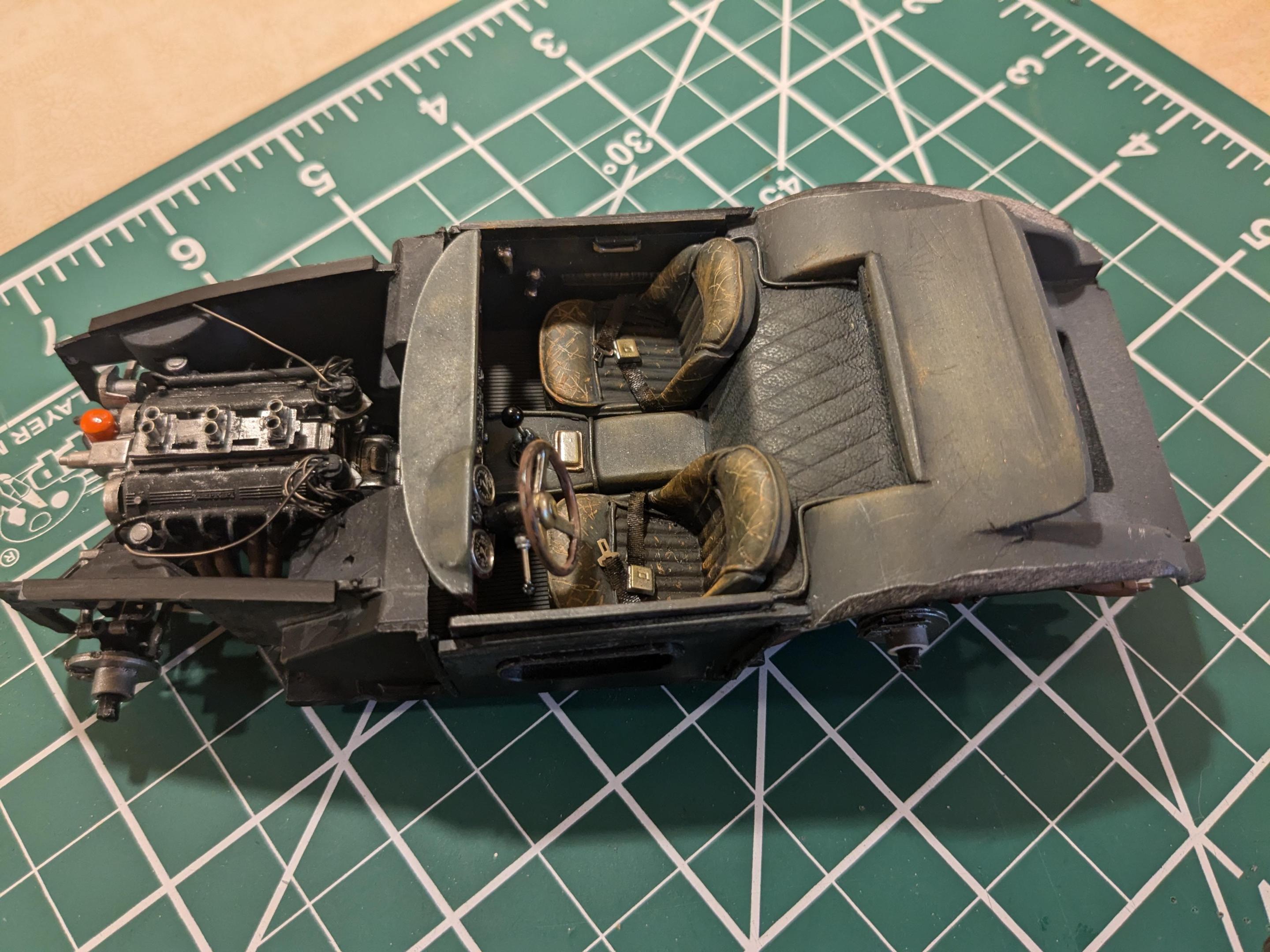

Dash added to firewall/engine compartment unit. The little visible carpeting on the interior is black embossing powder.
The door panels and console/rear bulkhead. The quilted part is thin bookbinder's leather with the diamond quilting done using a straightedge and pizza cutter to emboss it. As with the seats, Tamiya weathering master pastels were used to represent dust and dye loss.
PXL_20240916_182922061.thumb.jpg.f90d56e65b56b642902167b4edc5da89.jpgPXL_20240916_182852255.jpg.46b0941468beed97dd902ff6392e5065.jpgPXL_20240916_182855699.jpg.dcc40a8d29e0e37ad2bb1e79d81c2372.jpgPXL_20240916_182911007.jpg.4f0a821ad311495286c974981e40ea35.jpg
Finally, the completed interior with seat belts in place. Barely visible are the rubber floor mats made from Evergreen styrene.
The chassis is done and sits square and the engine bay is about 3/4 there at this point. The radiator fouls the hood hinges and will be relocated a bit further back. The carb tray has been foiled but I haven't done anything yet to weather it. More pics coming soon now that I'm on the final straight!
