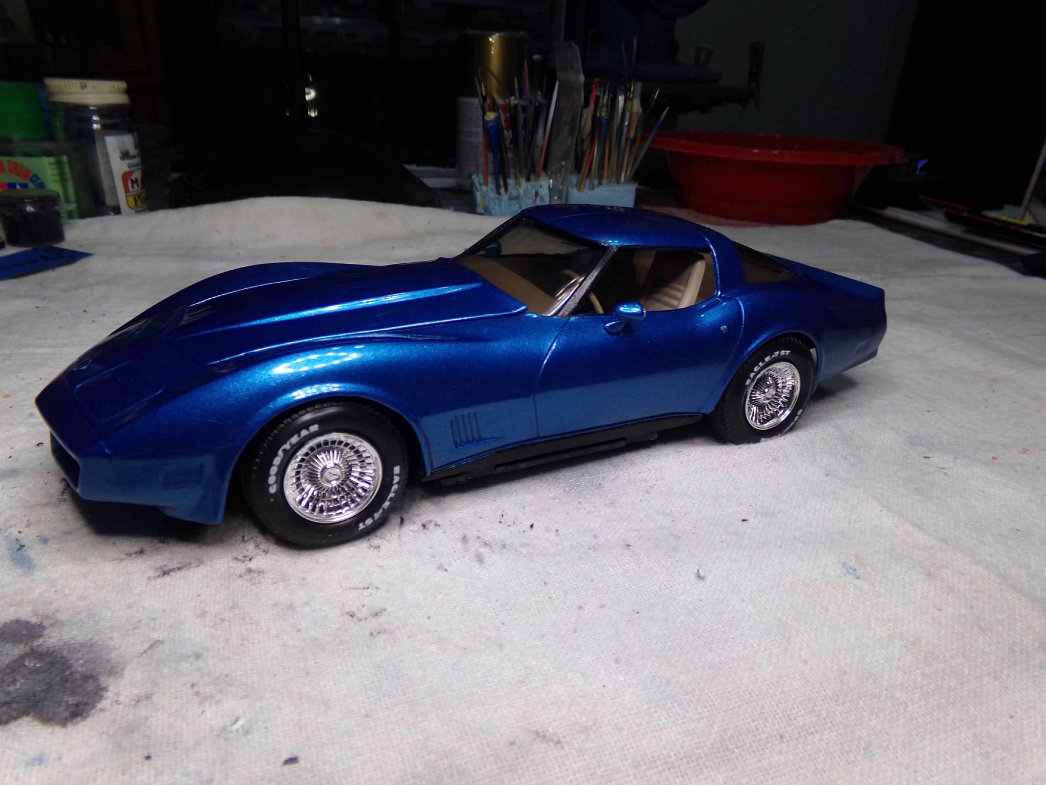

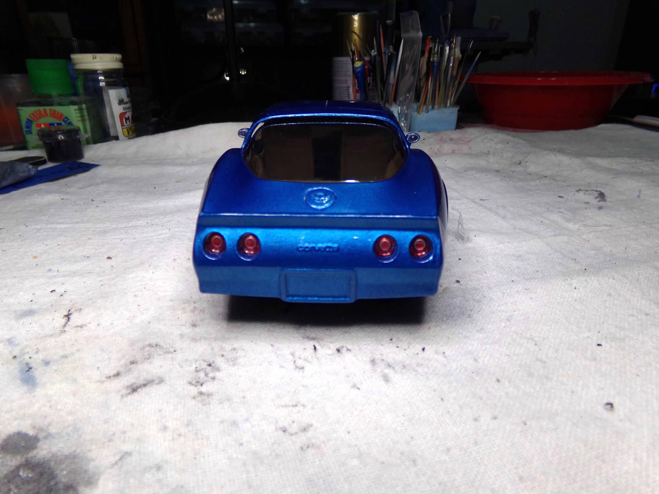

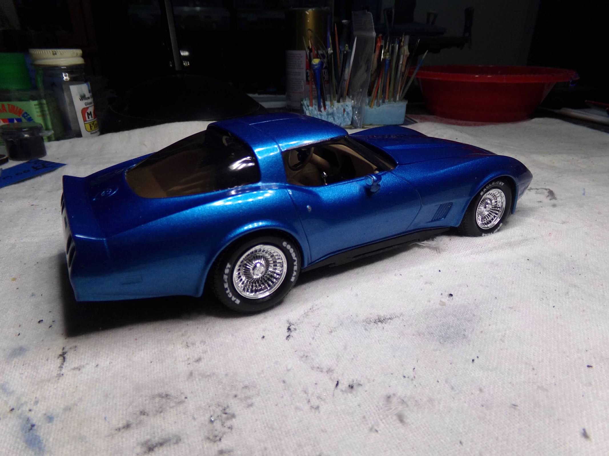

This one is done except for decals. I am also gonna add a piece at the rocker, actually it is a trim piece from the 67 Corvette that I have dechromed and painted black and it is drying now. I rubbed out the urethane clear with 3000 sandpaper and Scratch-X and it looked good to me so that is where I stopped. Its a little thick on the taillight panel so the Corvette lettering will not get any foil at this point as the letters are buried. I should have foiled them before clear. I also need to paint in the backup lights. But I sure do like the finish and I will come back with what I learned on my first urethane clear application. Thanks for looking! ?

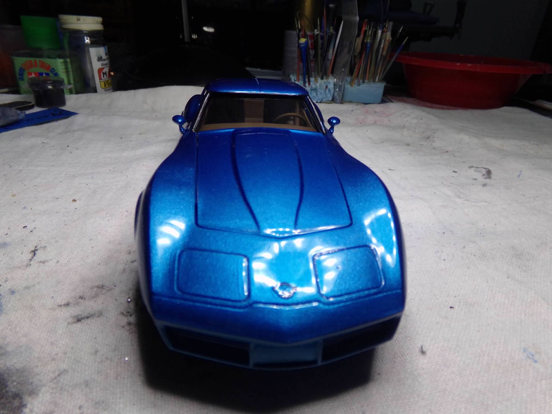

I've finished this one by adding a trim piece painted black at the rocker below the door and adding the decals. Since this is my first try with 2K Urethane clearcoat and I think it was successful, I wanted to reflect on lessons learned. I watched a couple of videos on You Tube before I bought the clearcoat.  They helped in preparing and buying the things I would need to do the airbrushing.
First, in addition to the clearcoat and hardener, I also needed some small, clear plastic cups, something to measure with and some stirring sticks. This may seem very basic but is something that I haven't really dealt with before. Even when I airbrush paint, if it needs to be thinned for airbrush I normally just pour in the thinner in the bottle and shake it up. But according to the videos, even though the measuring doesn't need to be exact it does need to be 4:1 and shaking may cause bubbles in the mix that might affect the airbrushing. So, I found some clear cups in the house in old "picnic and hurricane supplies" box. I bought some 2 ml. plastic, disposable, pipets at Michaels and found some wooden stir sticks in my wife's acrylic painting supplies.
Both videos emphasized using "fast drying" clear coat, so I bought the cheapest quart of clear coat with 1/2 pint of hardener that I could find on Amazon. That along with some 3,000, 5,000, and 7,000 sandpaper that I wanted to buy put the order just over $35 for the free shipping on my wife's temporary membership for Amazon. The sandpaper came the next day which worked out well so I rubbed out the paint on this corvette with it and it was a good experience since I could cut the sandpaper in small squares and just use my fingers on the square to rub out the paint. The cloths although fine for the same purpose always required a foam backing pad and it is getting troublesome toClear grip without my hands cramping up in my old age.
The clearcoat and hardener came in about a week with no instructions and no label except for a white label on each can. The clearcoat indicated 2K Urethane Glamour Clearcoat Quart 4:1. and the other 1.2 pint can read 2k Urethane Glamour Clearcoat Standard Activator 1/2 pint. One video indicated that he used an additional part Mr. Surfacer and the other one didn't.  When I opened the cans they seemed to be thin enough for airbrush so I didn't add anything. But I did make a mistake - I mixed it up in the morning thinking I would paint in the less humid afternoon outdoors. Unfortunately, the clearcoat I mixed with the hardener turned to gel by noon. So one lesson learned - don't mix until ready to spray.
Both videos indicated that you should do three wet coats after a light first coat. One indicated 15-20 PSI for the first coat and both indicated 30 PSI  for the wet coats. I mixed up 20 ml. of the clearcoat and ran out after 2 wet coats. But I am glad that I did since I think I have it on a bit too thick in a couple of places. I think I could have gotten away with 1 wet coat and I probably will do that in the future. One video indicated they had a wide spray pattern and were using a "5" needle. I don't even have a  "5 " needle and my biggest is a "3" for my Badger 150 airbrush. I don't know if a "5' would even fit in my airbrush.  So I think my spray pattern is much narrower and heavier, and therefore, it buried the Corvette logo in the back and I noticed that the headlight covers and door lines were kinda buried a bit.  So I think one wet coat will do it in the future. I rubbed out the finish the next day, using only the 3,000 sandpaper and some Scratch-X and it looks good to me. In fact, the photos don't really do it justice as it is a very smooth, glossy finish. I hope this might help anyone who is interested in using the 2k clearcoat. Final photos in the "Under Glass" section. Thanks for looking! ?
