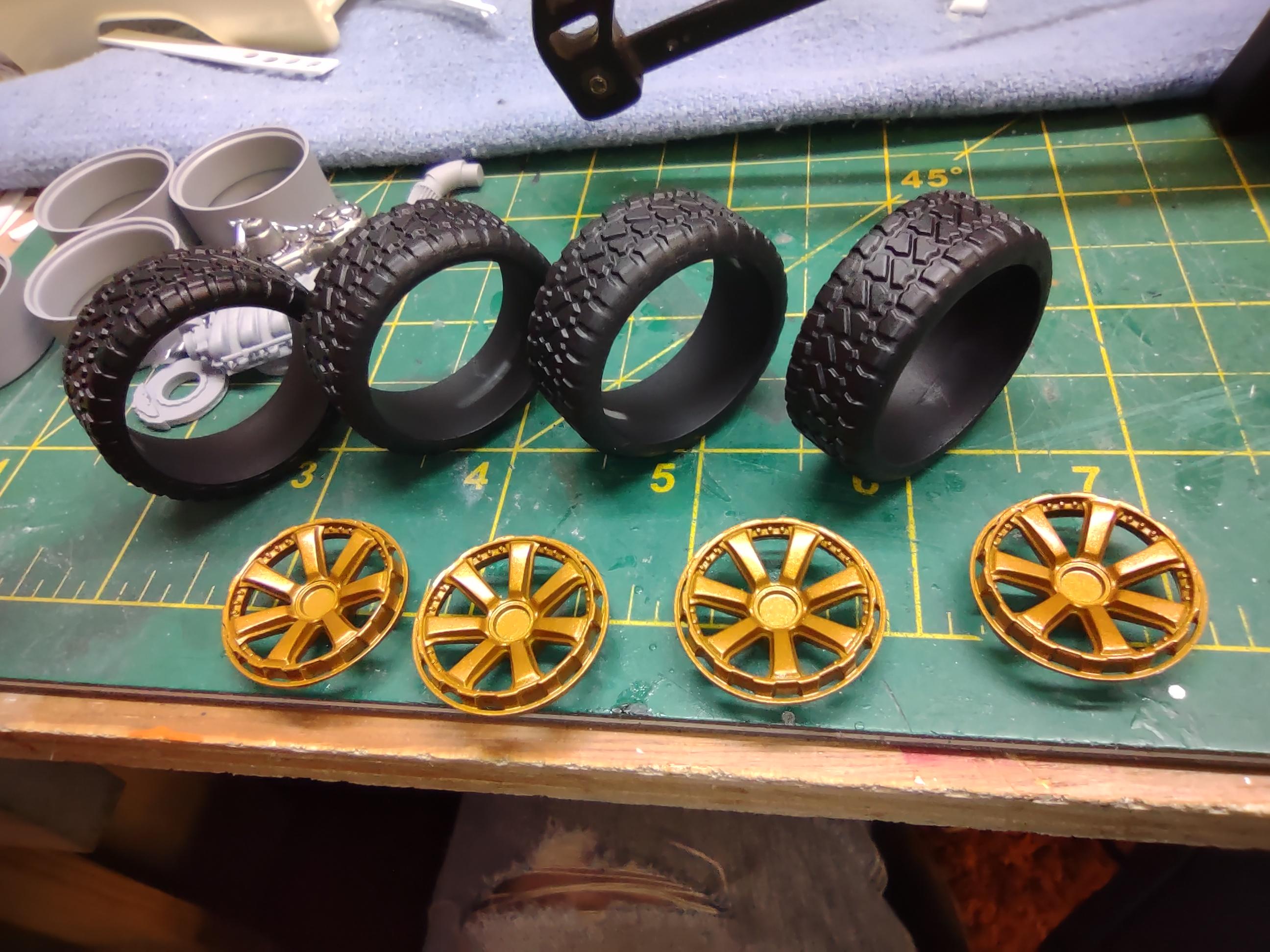

64SS350 Posted August 9, 2024 Posted August 9, 2024 I tried the Tamiya Rubber Black, to me it seemed a little flat, like racing rubber, but maybe my primer base affected the results. I'll have to try a different primer next time, because it sprayed very well. Here I used Dupli-Color flat black, it actually leaves a slight sheen.

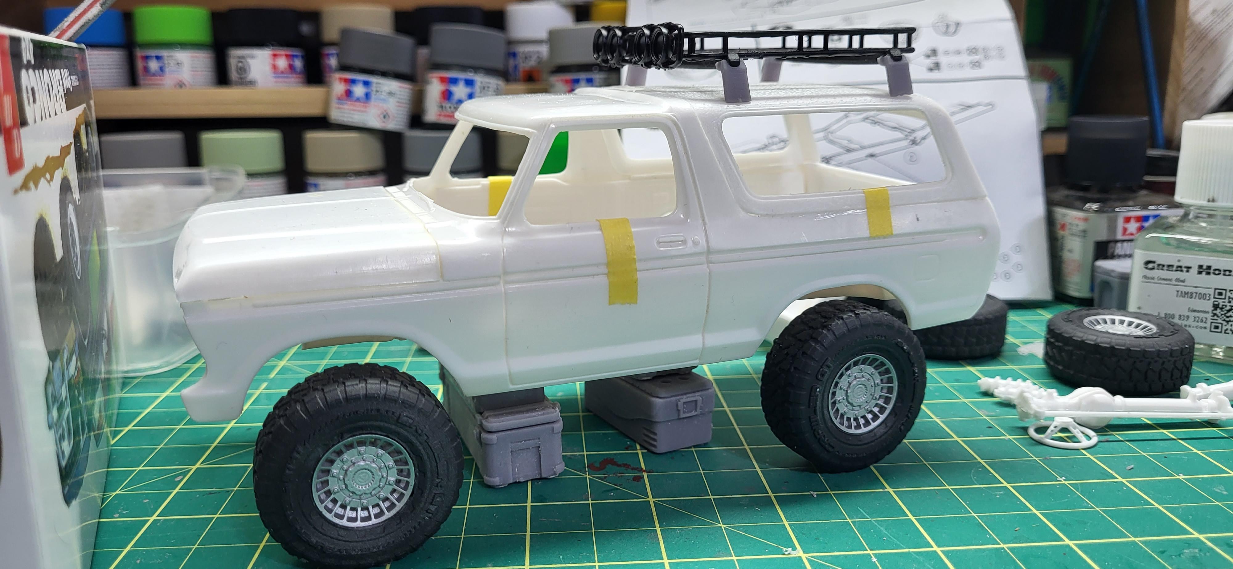

jaymcminn Posted August 10, 2024 Posted August 10, 2024 Tamiya Rubber Black is excellent. I also used Tamiya "Oil Stain" weathering pastels around the treads on these. 3
