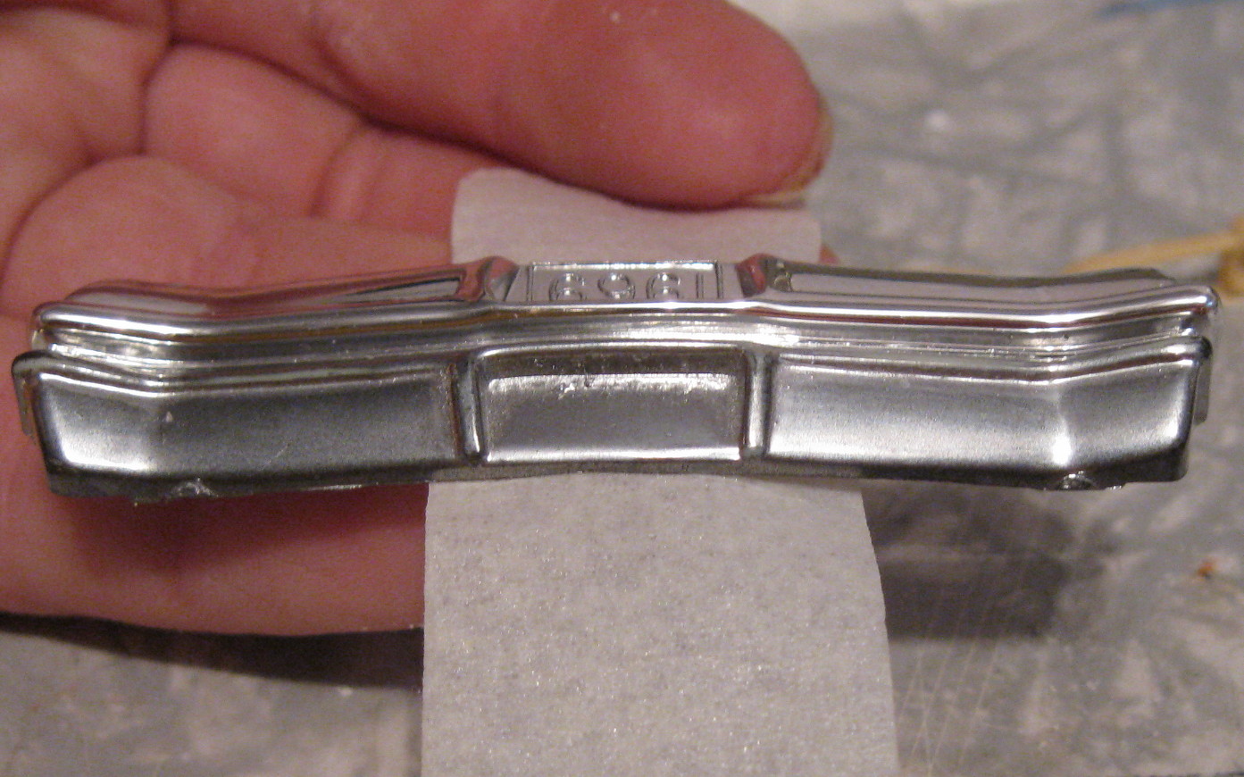

Can-Con Posted August 9, 2024 Posted August 9, 2024 Chris, can you still edit that article, you made a few mistakes. First, There's no separate pan below the rear bumper of the '68/'69 Chevelles. The chassis for the '69 ElCamino was indeed modified to fit the body. Not only in the wheel wells but it was also stretched to fit the Elky's wheelbase then shortened back up after for the following hardtops and the convertible. And the rear bumper for the '70s and following reissues of the '69 kits was not just modified, it's a completely different part. Here's a couple pics of both[with the tail light areas removed]. The original is noticeably wider and with slightly different contours because of that. . 1

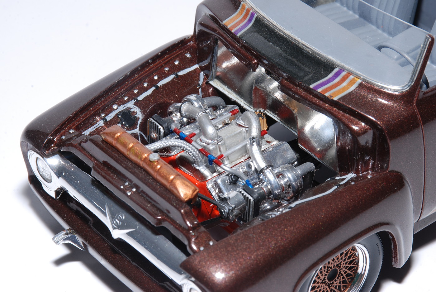

tim boyd Posted August 11, 2024 Posted August 11, 2024 (edited) On 8/9/2024 at 9:00 AM, Fabrux said: I realize that it's been a minute since I've posted a kit history article but I'm getting back in the swing of things. This one took a lot of research but I think I've covered everything and it's a project I'm proud of. If you'd like to check out the article, here's the link: https://www.sprue.xyz/articles/round2-chevelles Or if video is more your thing, you can watch the Model Car Genealogy episode where we covered it. ? https://youtu.be/d6EFCXUTuvE?si=o4zvT4t238F1N-8F Chris....this is a most impressive piece of work on your part. I thought I knew a lot about this kit series but you've uncovered a ton of fresh info, at least for me. Big, big congrats. One comment/possible addition...and I am doing this from memory so take this as unconfirmed rhetoric as opposed to confirmed fact, but my recollection is that at least one of the two 1980s reissues of the MPC 1972 Chevy tooling included optional engine parts to build a dual turbocharged street fighter type powertrain. Here is how that engine configuration appears in as installed in an AMT 1953 Ford pickup model I built back in the early 1980s.... (the air cleaners and radiator hose were later adds, not in the kit engine...): Thanks for taking the time to research and document this kit history. Count me as among those very, very impressed with your efforts here. TIM Edited August 11, 2024 by tim boyd 1
